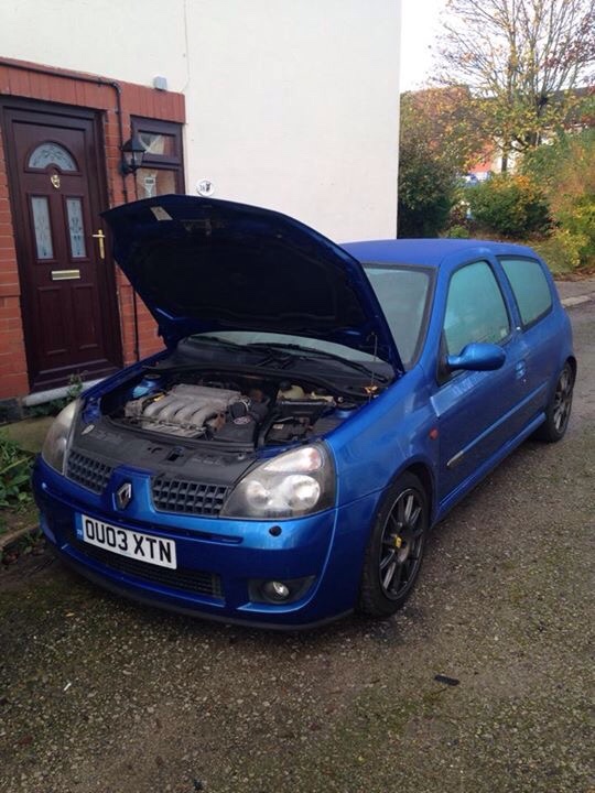

Decided I wanted a clio to throw around track so went in the hunt!!
Finally found a 172cup for the right price after looking a quite a few turds
This is day one
