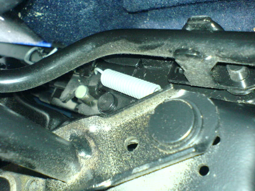

I have a pic from under the seat somewhere, one min.
big pics, sorry.

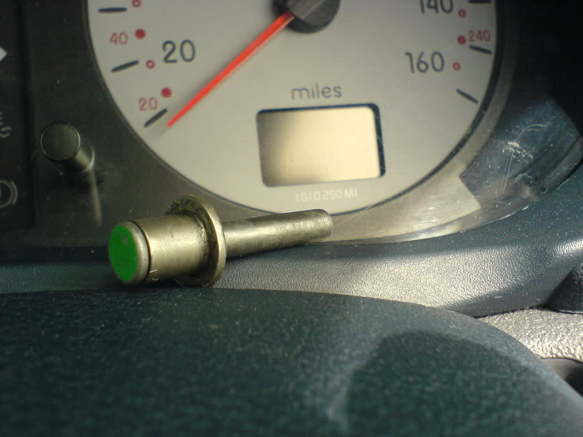

This is the 'pin'. It had fell out on mine as the plastic piece had snapped. I didn't realise what it was but fortuantely I kept it and realised.

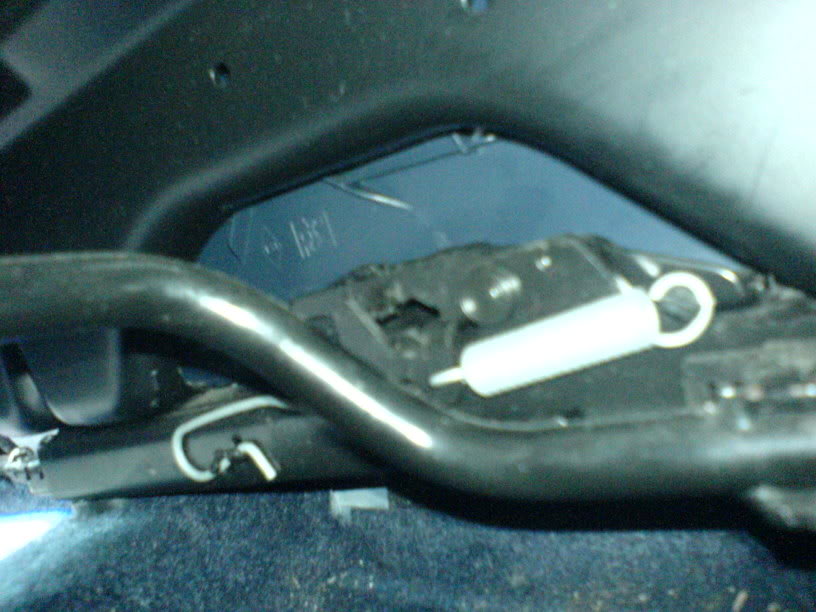

This is where it was missing from.
This is where it should be.
Bear in mind that last pic is upside down under the seat, there should be something about the spring. If it just looks a bit loose, you may be able to push it back in. If it's out it'll be a seat out job to line all the bits back up.
