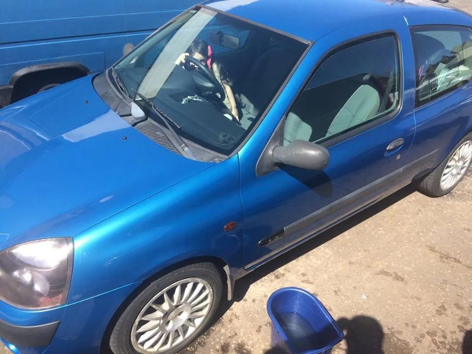

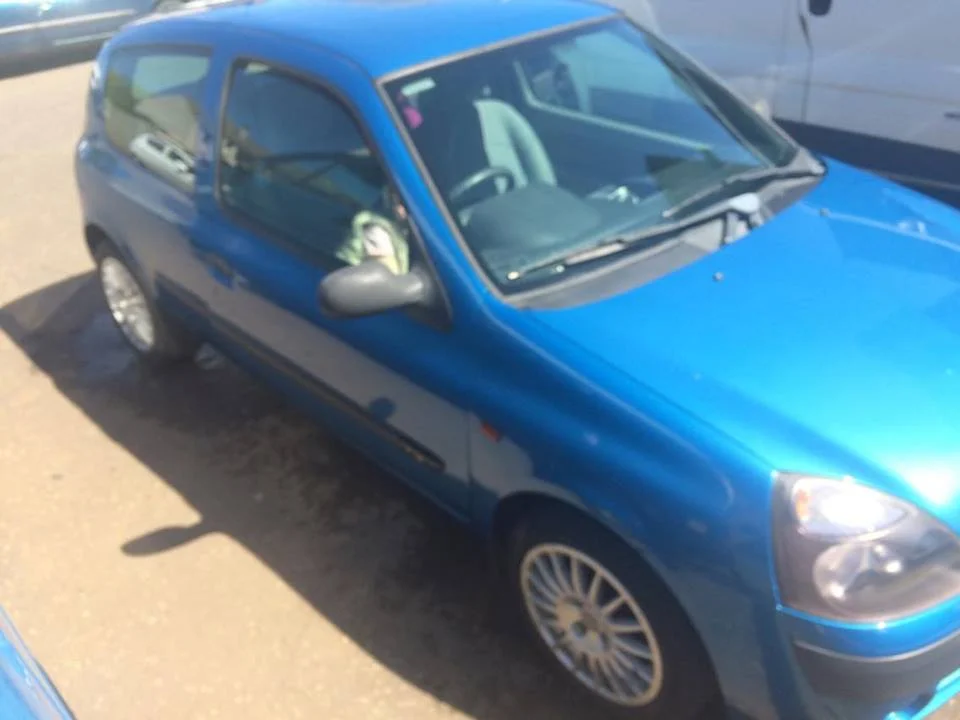

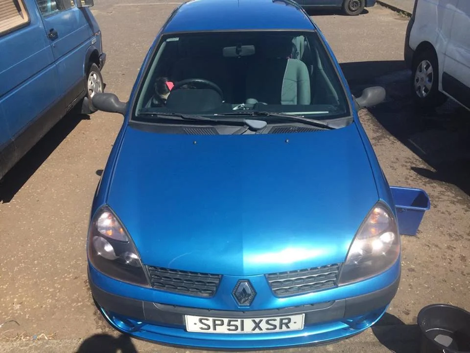

So, the car (washed it to make it look at least presentable!):
Ugly, right?

6= The headlights are cloudy/oxidised, I’ve sorted these before but it was half-assed so I’ll need to do it properly this time around.

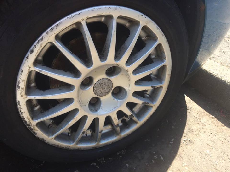

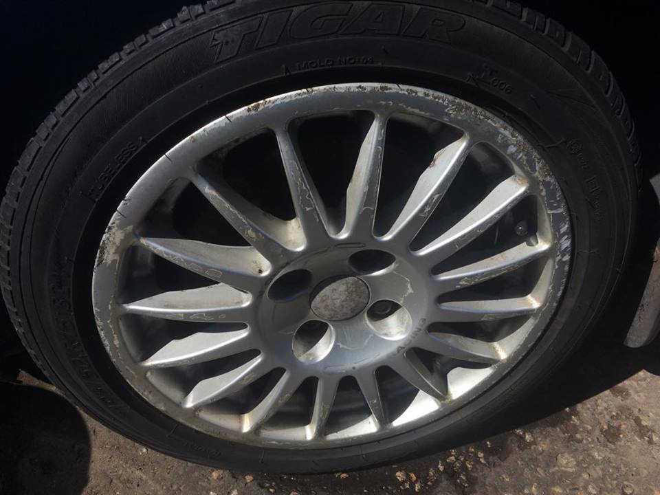

So, my alloys... oh, dear god the alloys...
I'm going to assume some sanding down and good primer wont help these at all?
so my question to you is, what is the best method to get these "paint ready"?
my assumption is to: sandblast, sand with finer wet and dry, primer, base colour coat, clearcoat.
A little guidance (that doesn't cost me too much) would be much appreciated, guys.

If you're wanting to do things on the cheap, I reckon you'll get away with prepping them yourself with rubbing them down and filling where necessary. Don't look to have any big chunks out of them so shouldn't be too bad of a job, although if you end up buying all the paint and spraying them yourself, sometimes it can work out the same or just a little bit more to have them done properly by a proper refurbers.

There's no big chunks out out them, just really bad damage from kerbing them and de-lamination of the stock paintwork.
Any recommendations for good primers and fillers? And is my thought process of how to spray them correct? Don't want it to look shoddy because i've done something wrong on the prep.
Have a search on here, there's a few guides knocking about. I was going to do some f1's I've got but decided against it as I've only got a dusty garage to do them in and didn't want dust getting into the paint which, without a doubt, it would have done.

Have a look in my project thread. I refurbished my track wheels for the price of some filler and black paint.
Key the surface inc the curb marks.
Fill with metal filler.
Sand flat
Prime
Paint
Lacquer

When you say to "key the surface including the kerb marks" do you mean LITERALLY key my wheels?
I'll be sure to update asap when i've gotten round to doing anything on the car!
No! Sorry, keying is the phrase used to sand (with fine paper, p1500+ job dependant) the surface to give the paint something to 'key' (stick) to.
You're not aiming to remove any paint when keying, just to dull the finish. I'll link something later when my stupid internet decides to work
Good! You had me well confused there. (I'm new to this whole refurb/detailing stuff)

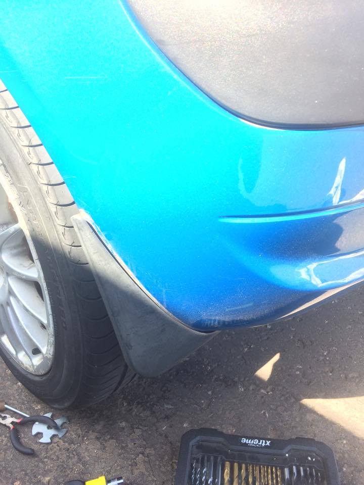

[Update 1] – Mud guards are gone!
These clips:
What a b**ch they were to get off!

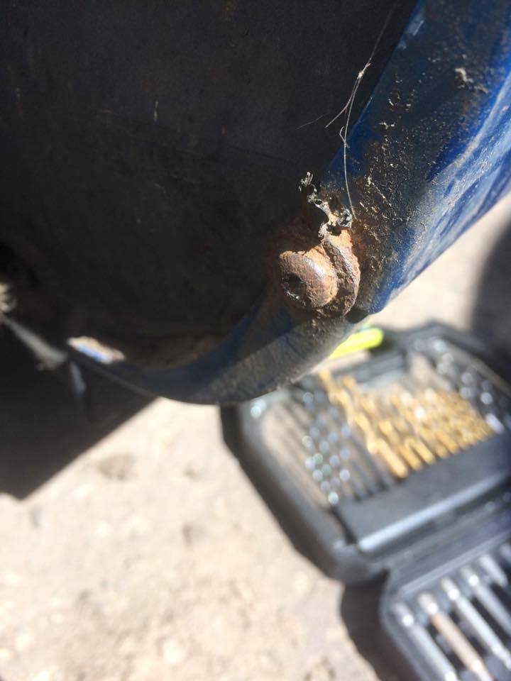

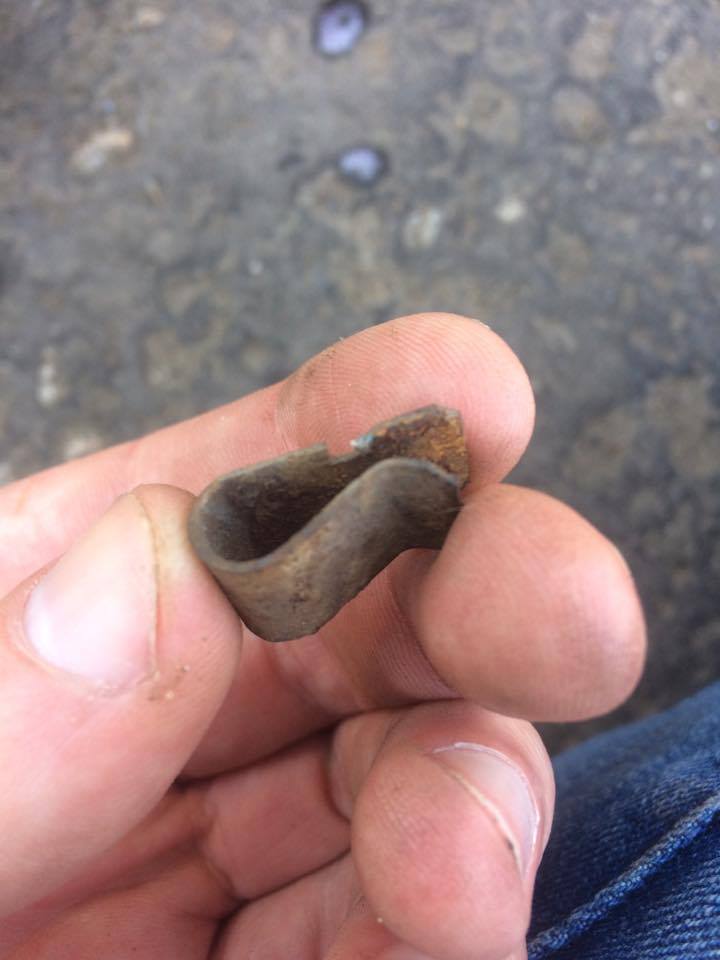

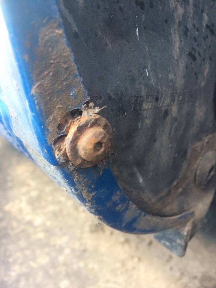

I had 2 rusted screws well and truly stuck, which I’ve had to work around carefully to remove the 2 front mud guards.
Anybody have tips on how to remove these? I rounded off both of my torque pattern bits trying to remove them slowly and i tried to break the s**t down on them.

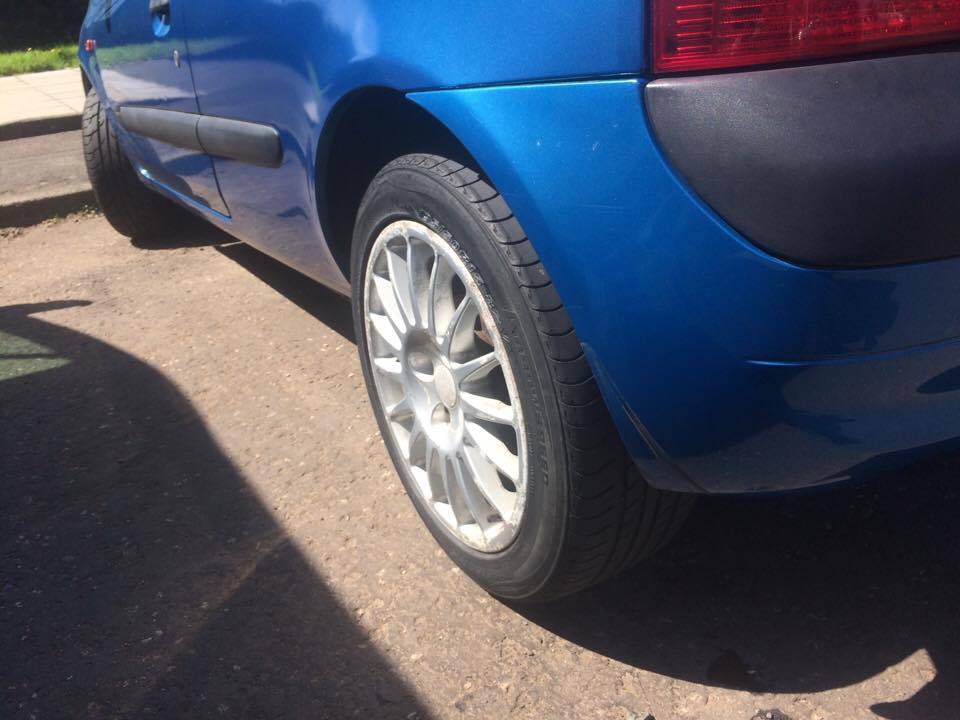

So, before they were removed:

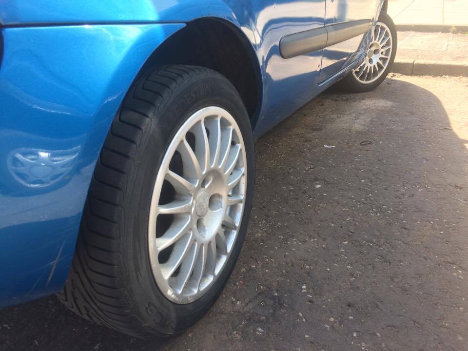

After they were removed:

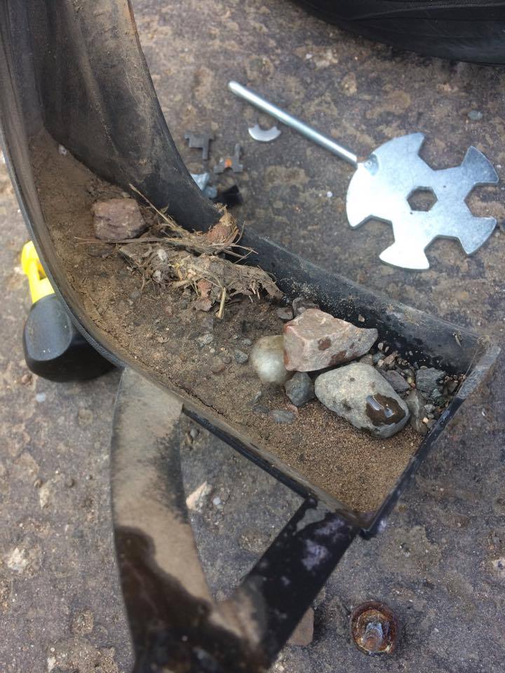

They’ve collected a fair bit of crap too:
Over all I’d say this is the easiest job I’ve done in my life even with stubborn screws!

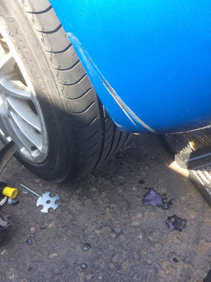

Again, please let me know how to get these out! And how can I remove the evident marking of the guard’s scratch marks? (this wasn’t my doing, I took proper care and time to remove them!)
I think the car will have a slightly cleaner look to it after washing the damn thing again now that the guards are gone.

Mole grips could be of use to get the rusted screws out if you get a firm grip on the head. Worth a try.
Looks good, certainly an improvement by removing the mud flaps.

Yea, they just looked hella tacky, i prefer rally-style mud guards but they'd look dumb on this particular car i reckon.

I'd clean up the guards and put them back on rather than have those marks on the bumper.

It only had 3 mud guards on it anyway, I'll touch up the marks later on when I can get some paint to do so and the wheels are staying on I'm afraid. Even though I could possibly sell them for ~£250-£300! But I can't be bothered doing anything else to this car since I'm only keeping it for a year. I'll take the time to do more stuff to my next car if it's decent.
