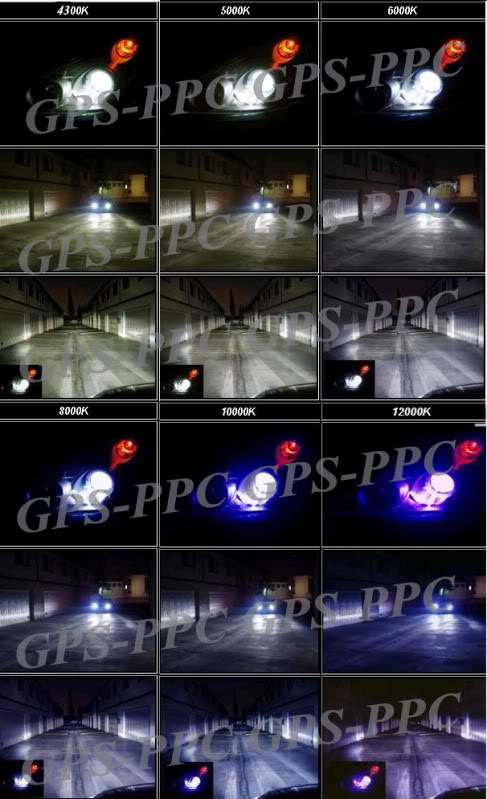

Oh and for the record, 6000K, 4300K etc refers to the temperature rating of the light output, not the brightness of the HID.

Yes but the rating, in watts, will remain the same. K is the temperature colour in degrees Kelvin.
The higher the K temperature the closer the light gets to 'daylight'.

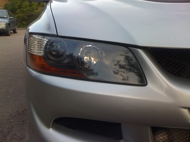

As said by others hid kits in the reflector types like my main beam above are illegal as the beam isn't controlled.

Oh and the K rating is the temperature the light looks like on the kelvin scale not the acual temperature of the light itself.
