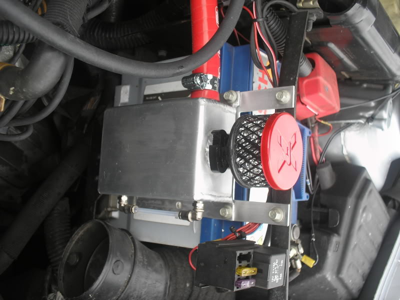

Hi all, since my ITB's were put on the breather hose at the rear of the cam cover has been venting into atmosphere and everynow n then a tiny drop of oil will drip out into the engine bay.
So i decided that i should make my own oil catch tank, Ihad thse before in Mocal form and ive seen some on ebay for sale but i thought id save myself some cash n make one from scratch using material from work:
This is the end result, complete with filteration on the top, fill tube on the side, drain plug on the bottom and inlet boss from the breather hose. I made it but i got a guy at work to weld, i can mig weld and basic tig but not to this level.
Its not 100% perfect because i had to work with metal offcuts here at work, using brand new stuff is a bit cheeky!
anyway, only two pics but you get the idea!
Sorry this one is wonky, photobucket is throwing a wobbly!
JW

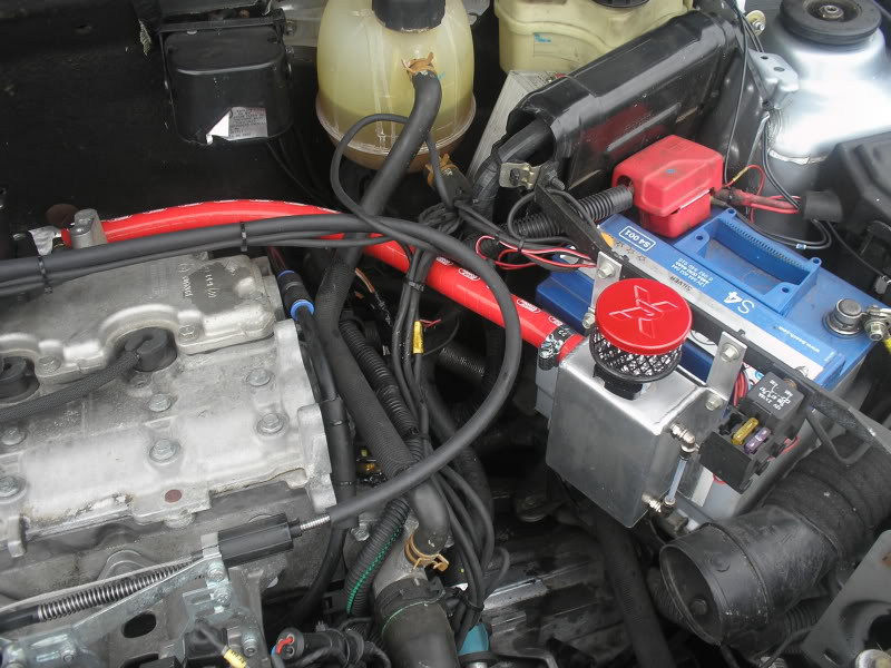

Heres mine that i whipped up the other day!
The old man hasnt noticed i chopped his hose pipe up yet though..

Does having an oil catch tank have any negative points to it? Was speaking to a friend a while ago who used to be a mechanic (old skool one though) and he said having one like that without the pressure of the air going through the airbox/inlet would break seals on the engine? Plus he also said having a little bit of oil as its just really a mist helps the pistons for when they come back up? Im not very clued up about it tbh so if anyone could shed a bit of light that would be nice.
On a side note, looks very nice and neat!

i agree, cant run the breather to itb's!
