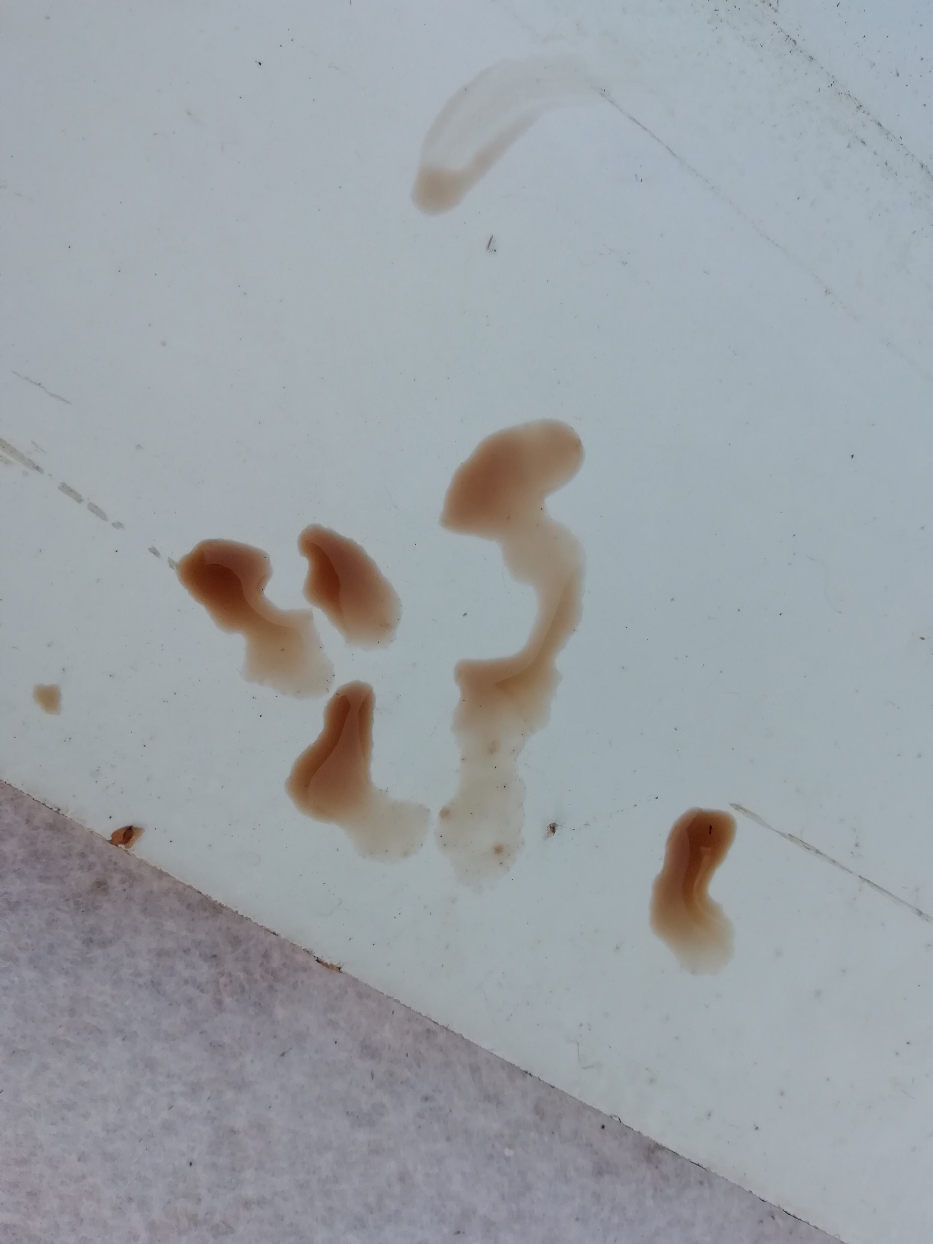

I've just noticed my first oil leak! Yep been quite lucky!!
Question is where is the most likely place it's coming from? Just thought I'd ask before I start to get down and dirty with it.

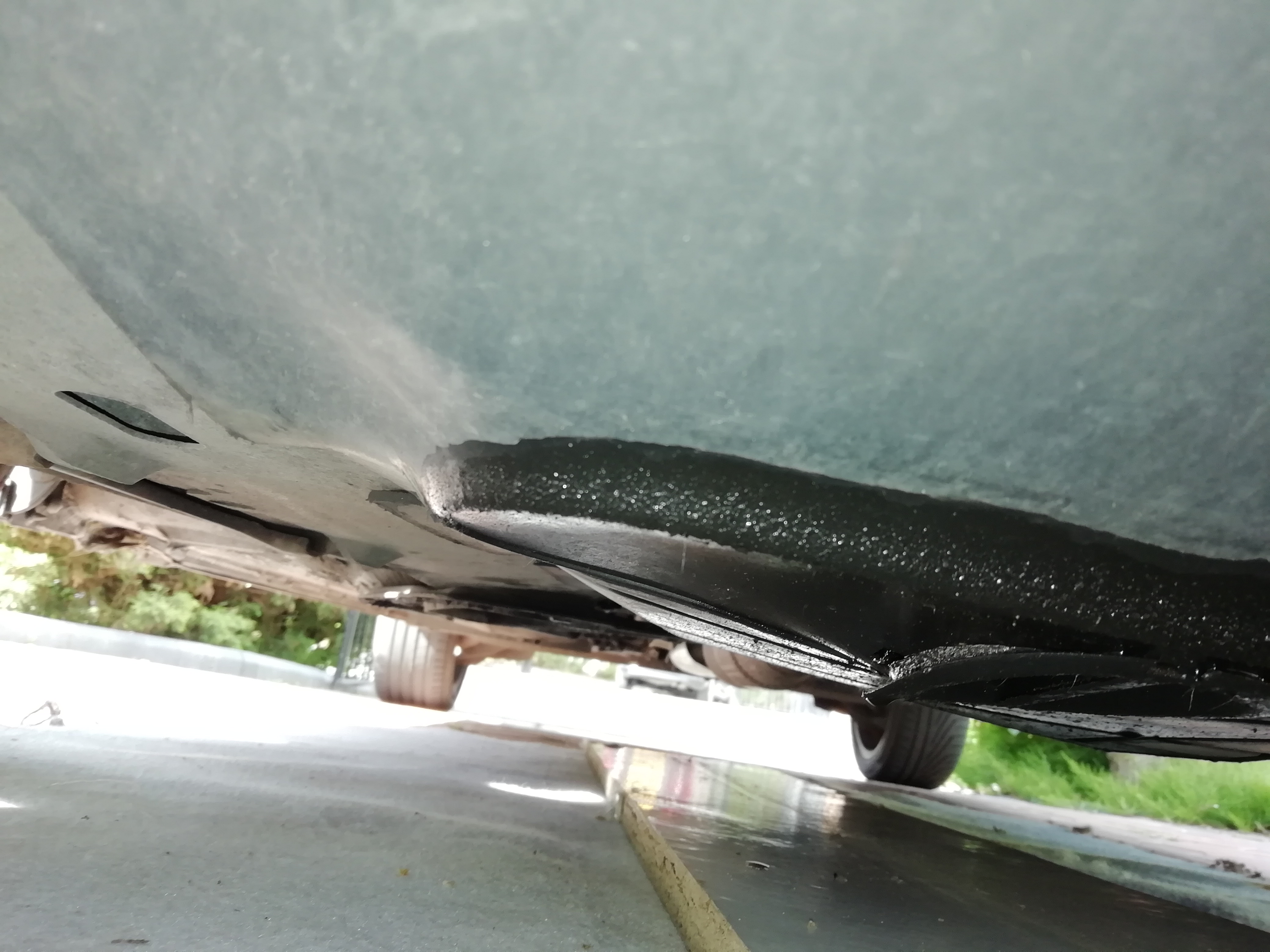

I noticed a few drips on the drive but I reckon the undertray has caught a bit too, oil saying OK on dash and dipstick level looks OK too.

Take that plastic sump tray off, wipe everything down until there's no oil on anything, run the car for a few days without the tray and see where they oil's coming from.
Also prepare yourself for the reality that it might be leaking from more than one place. :ROFLMAO:

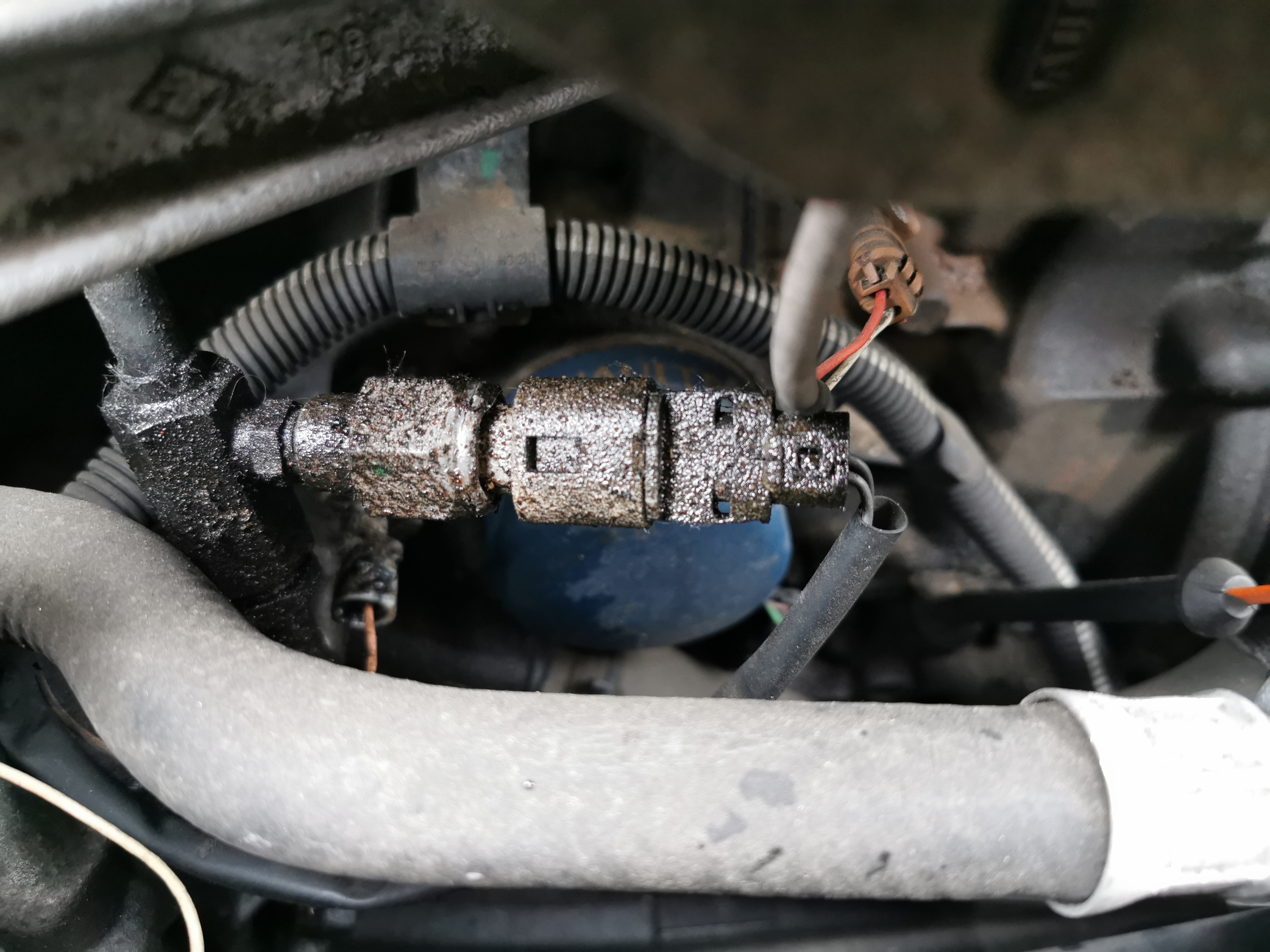

Yea clean that up first. It'll confirm that's where the leak is coming from and you'll want the electrical connection clean to remove it easily, without damage.
You probs need to top up your power steering fluid, so check that now.
If clean it up first and check it is that. Although that said, they’re cheap and easy enough to do anyway.
Yep will clean it up but going to order one anyway as its definitely seen better days and as you say its cheap enough.
