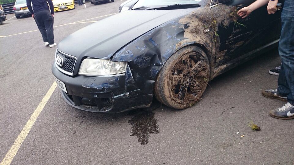

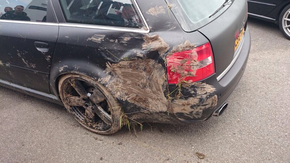

Anyway, half way through my cooling lap, I saw him in the wall. The circuit was red flagged and we all pulled into the pics. This was the result:
Go easy out there! Especially if you're trying to outrun a DC2 in a car as large as that on a tight track. The lad was gutted obviously, I can't see that being a cheap or easy fix.

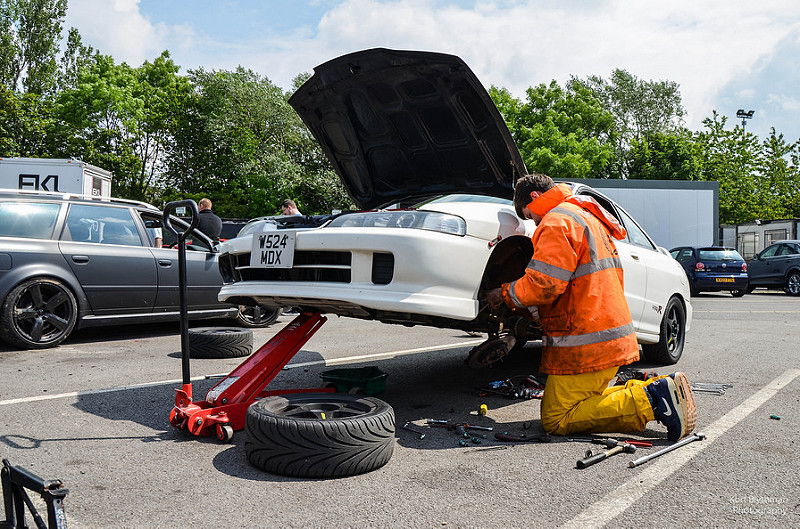

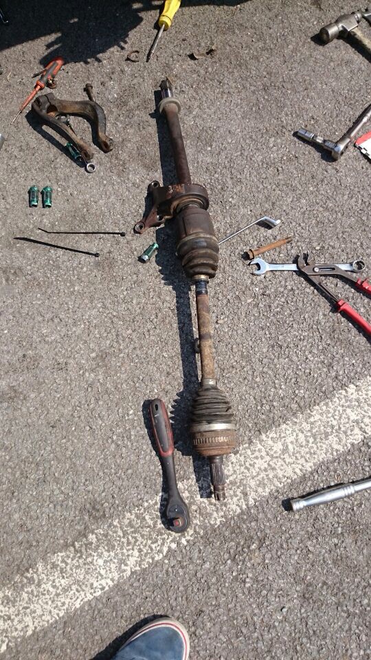

Unfortunately then disaster struck. Pulling out of a tight right hander I felt severe wheel wobble, as if my wheel was about to drop off! I quickly pulled into the pits, and with a bit (lot) of help from various people we diagnosed the half shaft bearing was goosed. It had collapsed completely, and while in gear while lifted up was creating enough force to move the engine side to side slightly.
One of the lads got on the phone to a breaker in Bishop Auckland to see what he had, and we went across to pick up another shaft for a tenner. Got back and fitted the shaft for around 3pm.
Honda Integra DC2 by Kurt Blythman, on Flickr
Unfortunately, although the bearing was obviously much better, it wasn't perfect, and I still have a slight vibration when cornering hard while accelerating, any more track time would have been stupid - so I called it a day there.
Limped the car home (80 miles ish) staying off the motorways, took around 2 hours but the car made it fine.
All that said, I'm still very happy with how the car performed on those first couple of sessions. All the time, money and more money have 'paid' off - emotionally at least.
Now just to get that shaft replaced properly. £186 for a brand new Yunaka OE replacement, which is apparently uprated. Although a breaker has messaged me saying he has a mint one for £30. Always tempting when something is 1/6th of the cost used. Might be worth a punt! Can the bearing not just be replaced? Now that I have a spare shaft at least!

Regarding the shaft, personally, i'd buy the uprated replacement for piece of mind.

Further investigation and it's probably the inner CV thats making the noise. There's a chance it was fitted dry, I bought it from a breakers and never thought to check. DO'H! Never mind.
