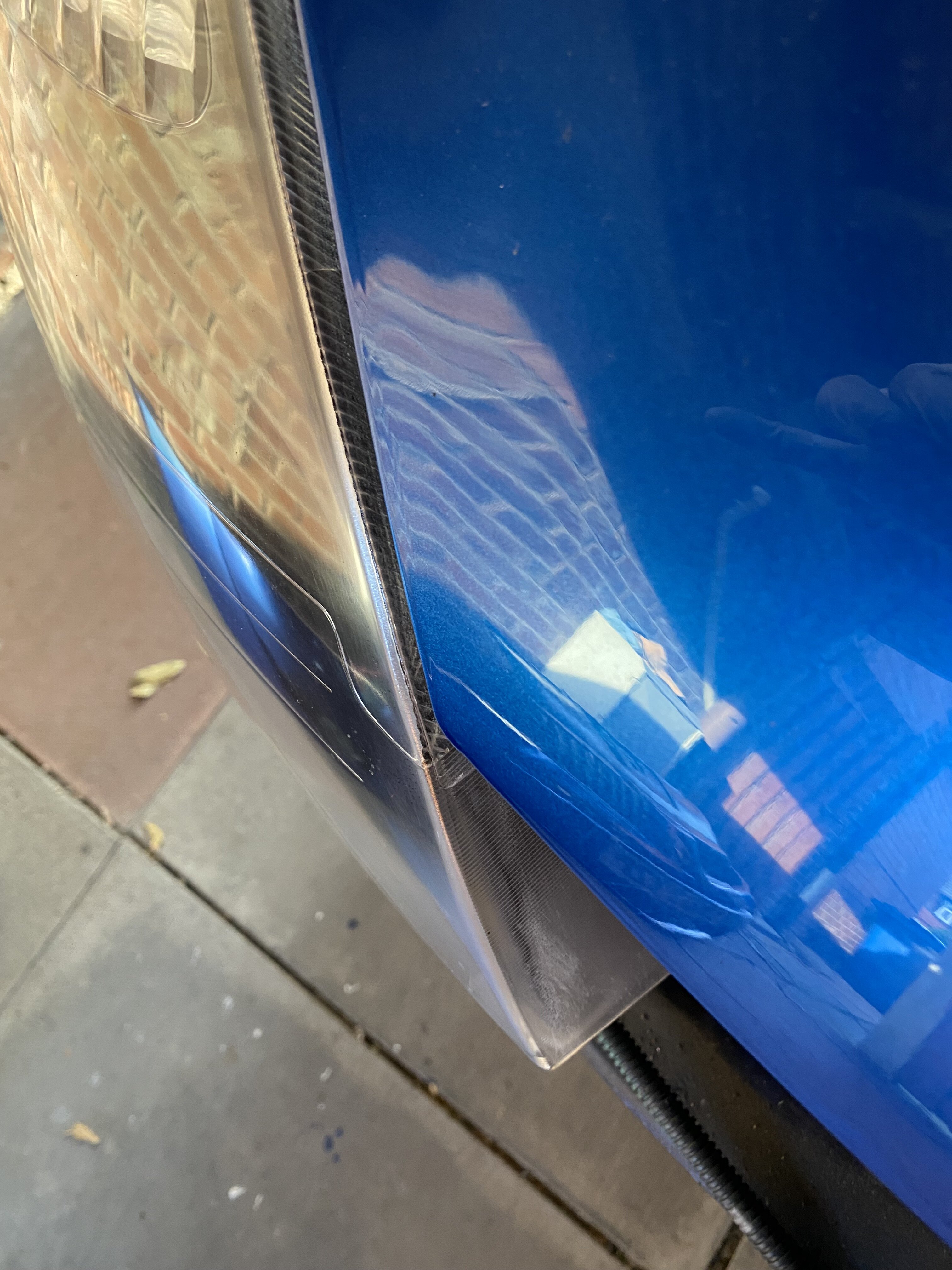

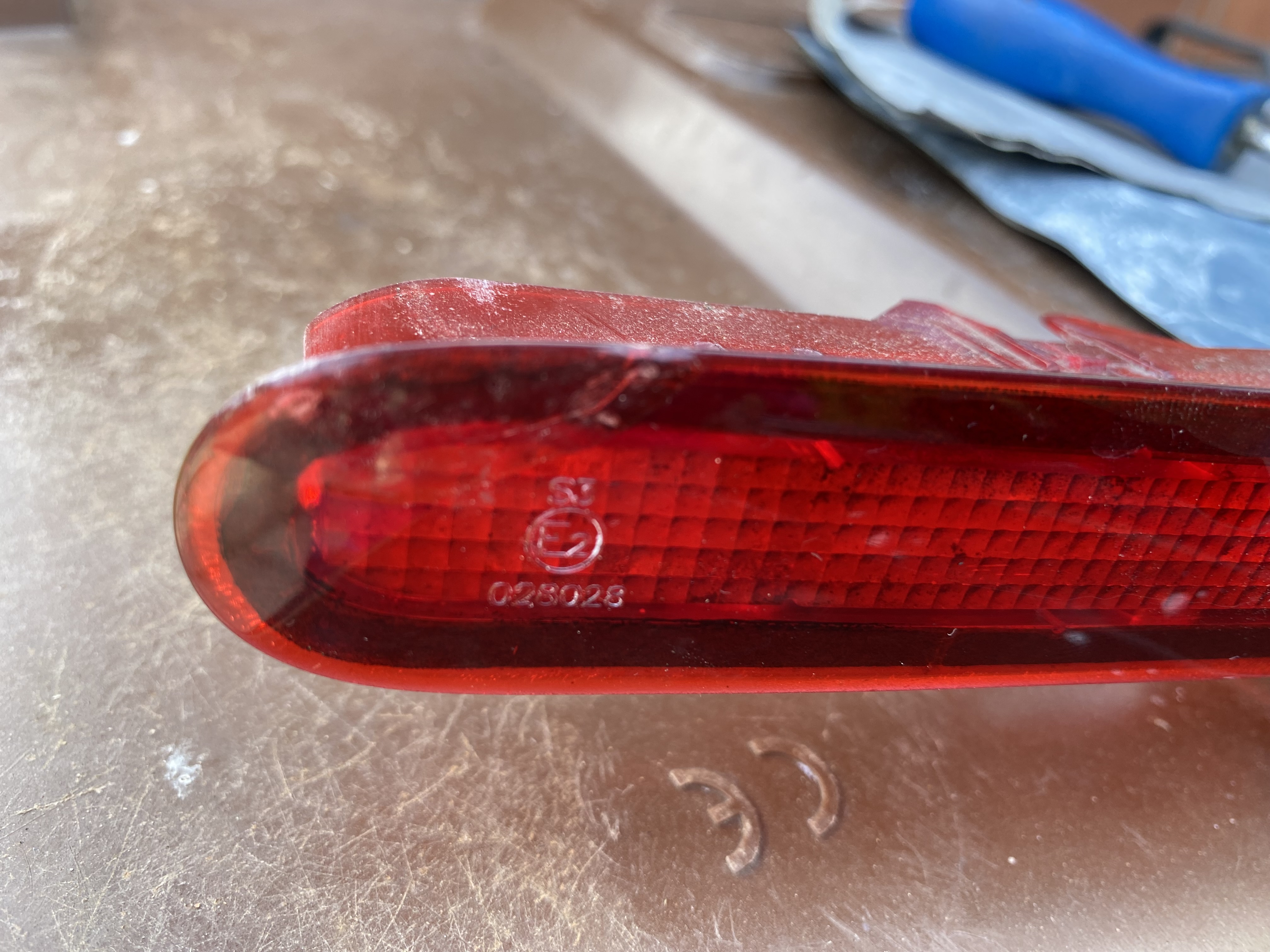

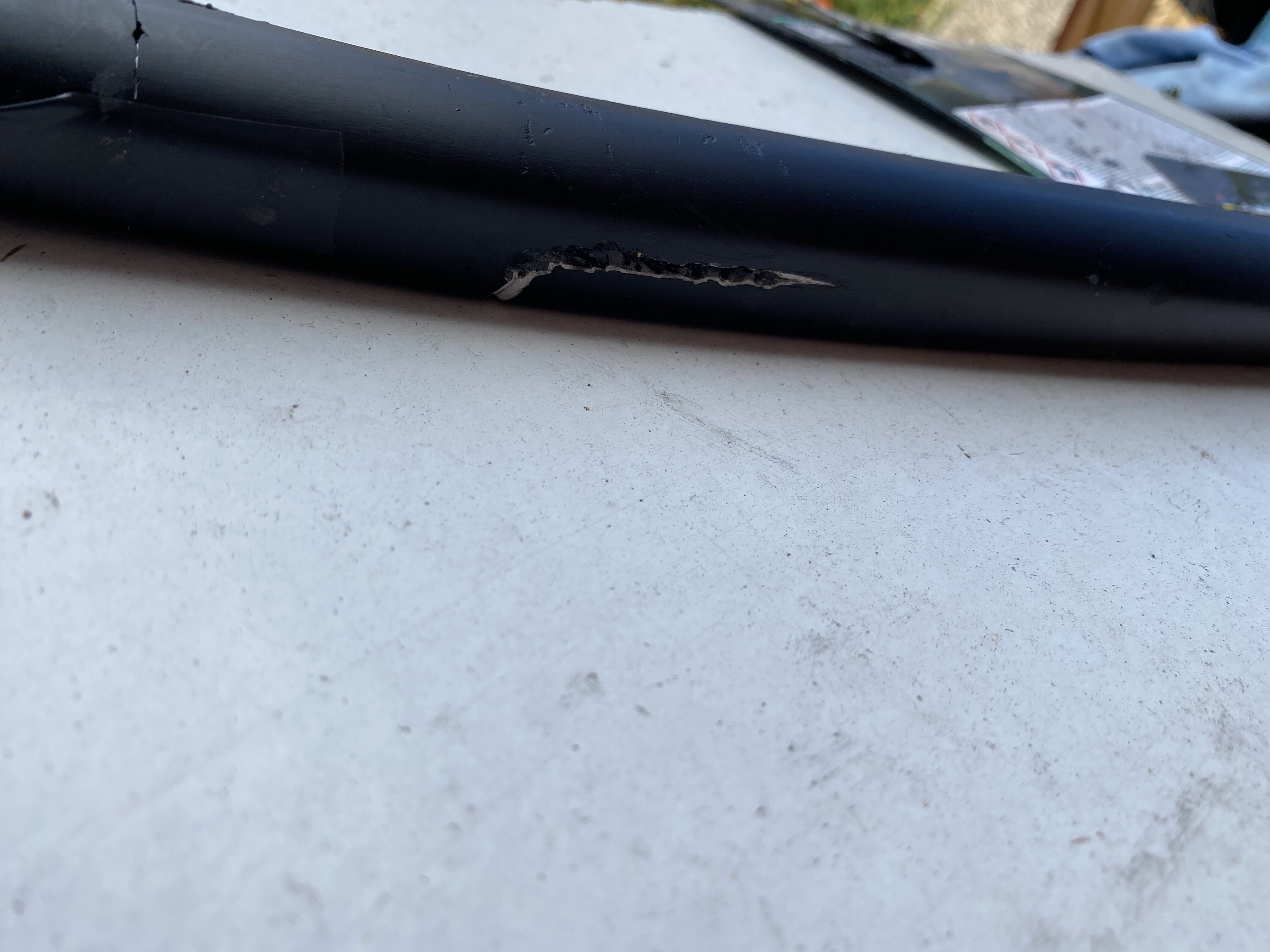

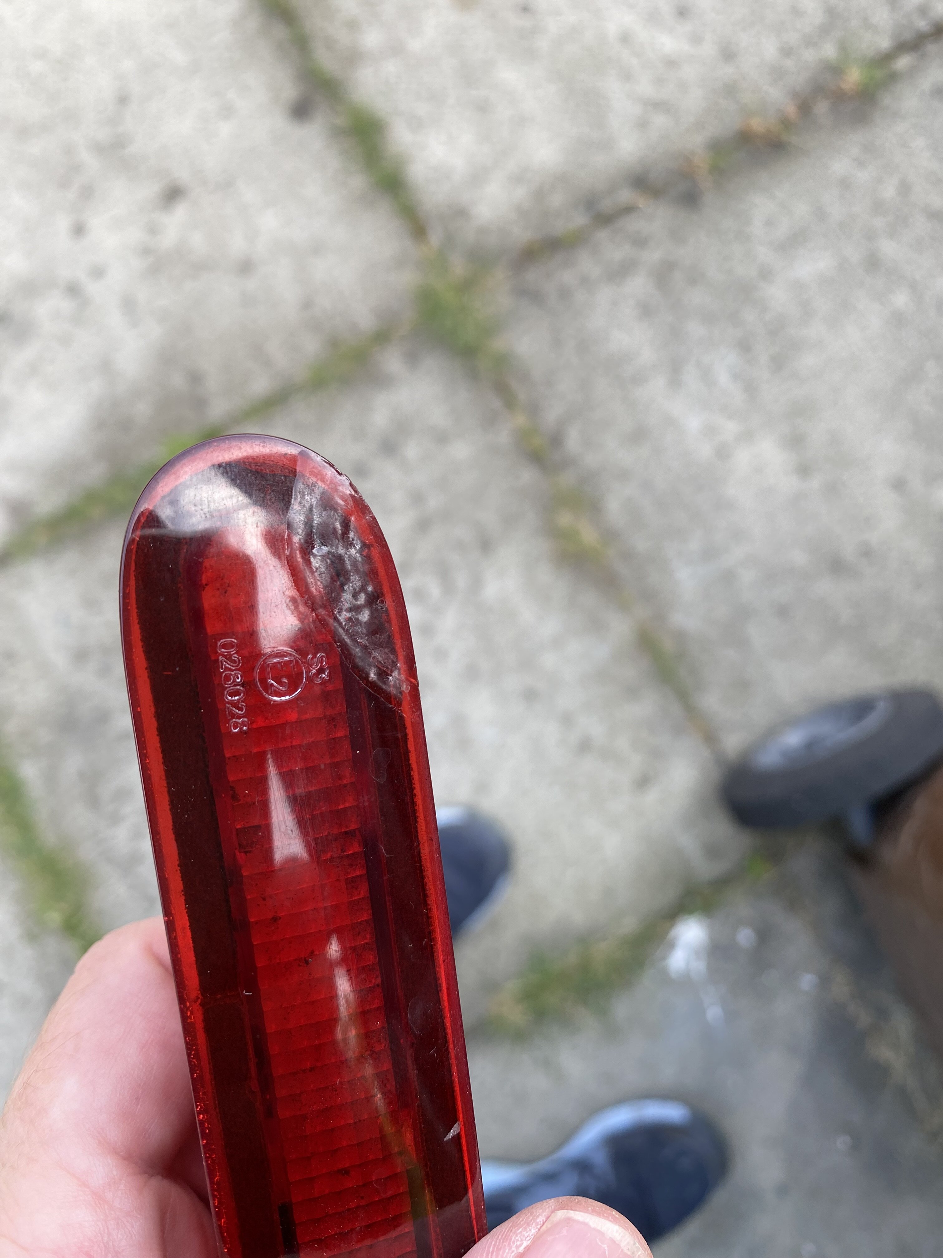

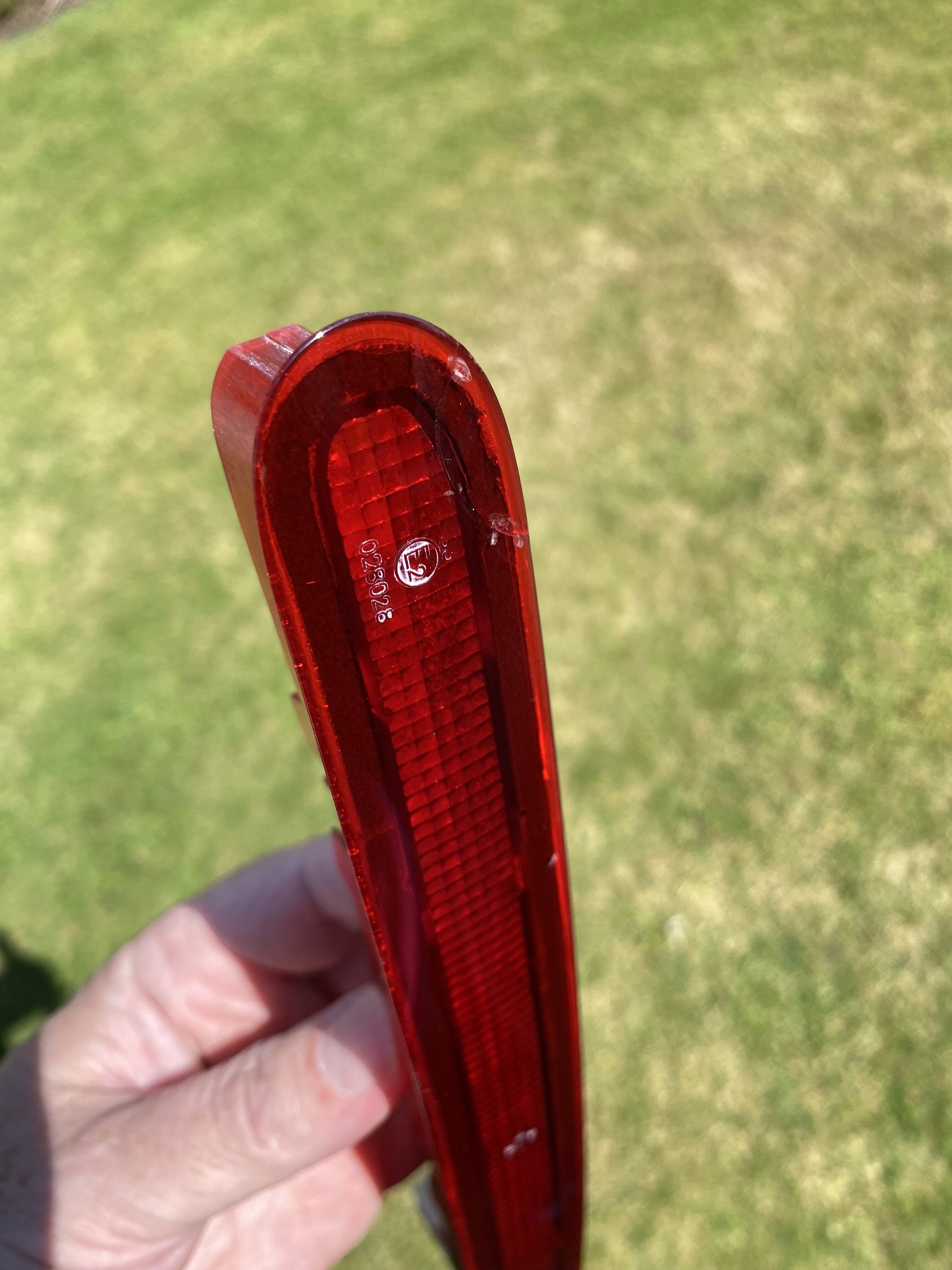

Today was the turn of my spoiler brake light to face the music. The lens is very difficult to get hold of now without paying a lot of money and as mine was cracked on the top left side I decided it would be better to repair it than replace it. I used one of the kits from eBay that uses a resin that responds and sets when exposed to UV light to fix the broken piece and left it for a few weeks. I then sanded and polished the whole of the lens. The edges are very flimsy so I was very careful not to put too much pressure on it. I did this by holding it in my hand whilst I polished it and when I come to give the car another full polish, I’ll have another go at it and get it even better. I didn’t take a photo of the piece that was broken, but this is almost an invisible repair now, if you didn’t know it was broken before. It looks much better than the photos show and the repair kit cost a fiver versus buying an intact spoiler for £120+.

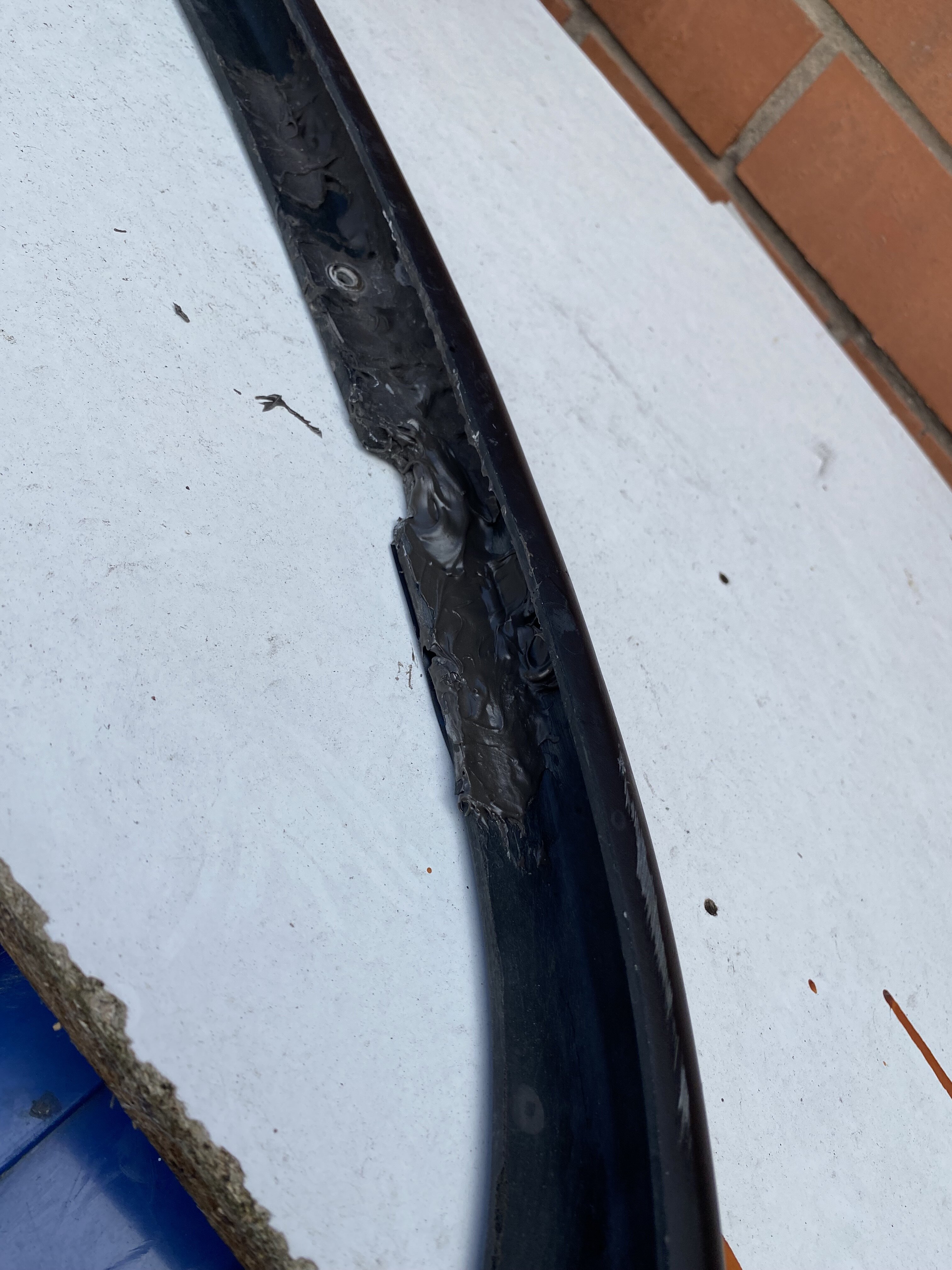

Currently fixing the original splitter, that I had repaired but then caught on the garden gate and snapped in two.
The damage happened in the same place that I’d repaired before so I basically just have to redo everything I did a few months ago. This will be re-fitted when I do my second repair on the bumper. I’ve bought the paint and the colour match from Saint Helens Paints is really good. It will look way better than my Monaco effort a few weeks back. Hopefully the weather holds out when I do it.

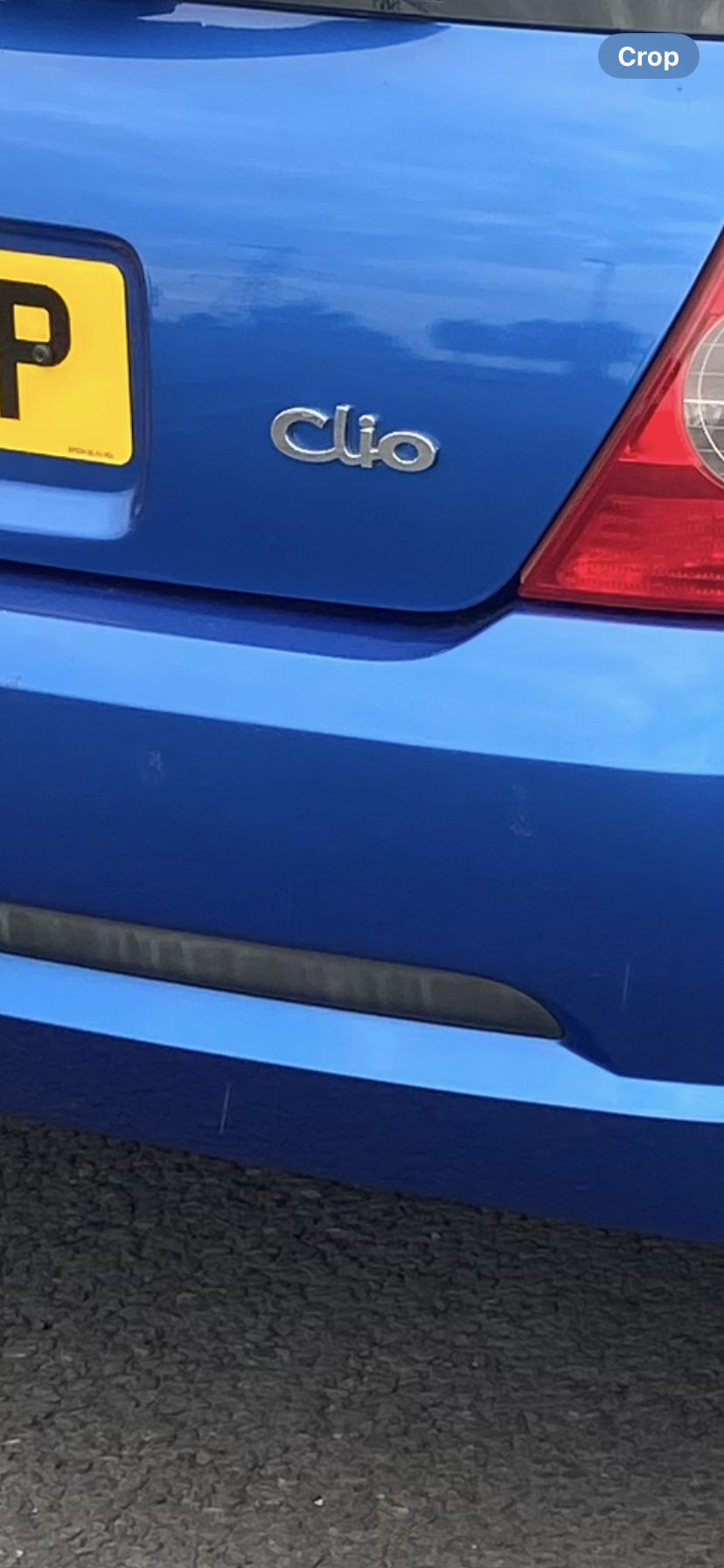

In a few weeks i'm off work so i'll redo the front bumper and repair it (again!) but this time in Mondial Blue😊 I've also some fettling to do with the gear change linkage and a full machine polish. There is a little tidying up to do with the interior and also some underbody bits, but it's getting there.

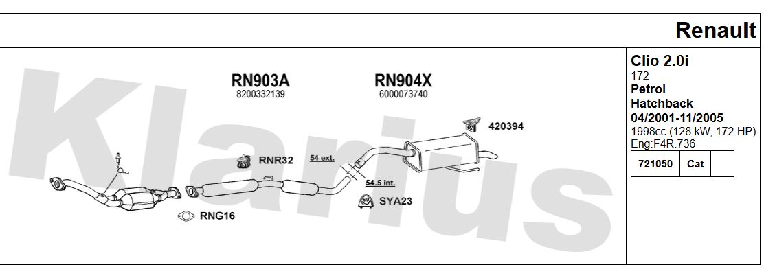

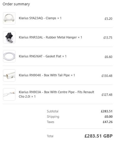

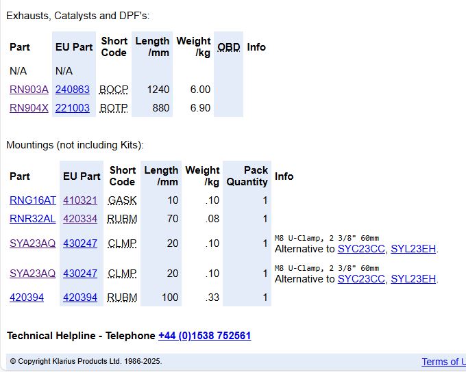

I ordered this from Arnold Clarke as they gave the best price and I couldn't find a link to order direct from Klarius. I got some info from this thread on here...
Here is the info from Klarius...

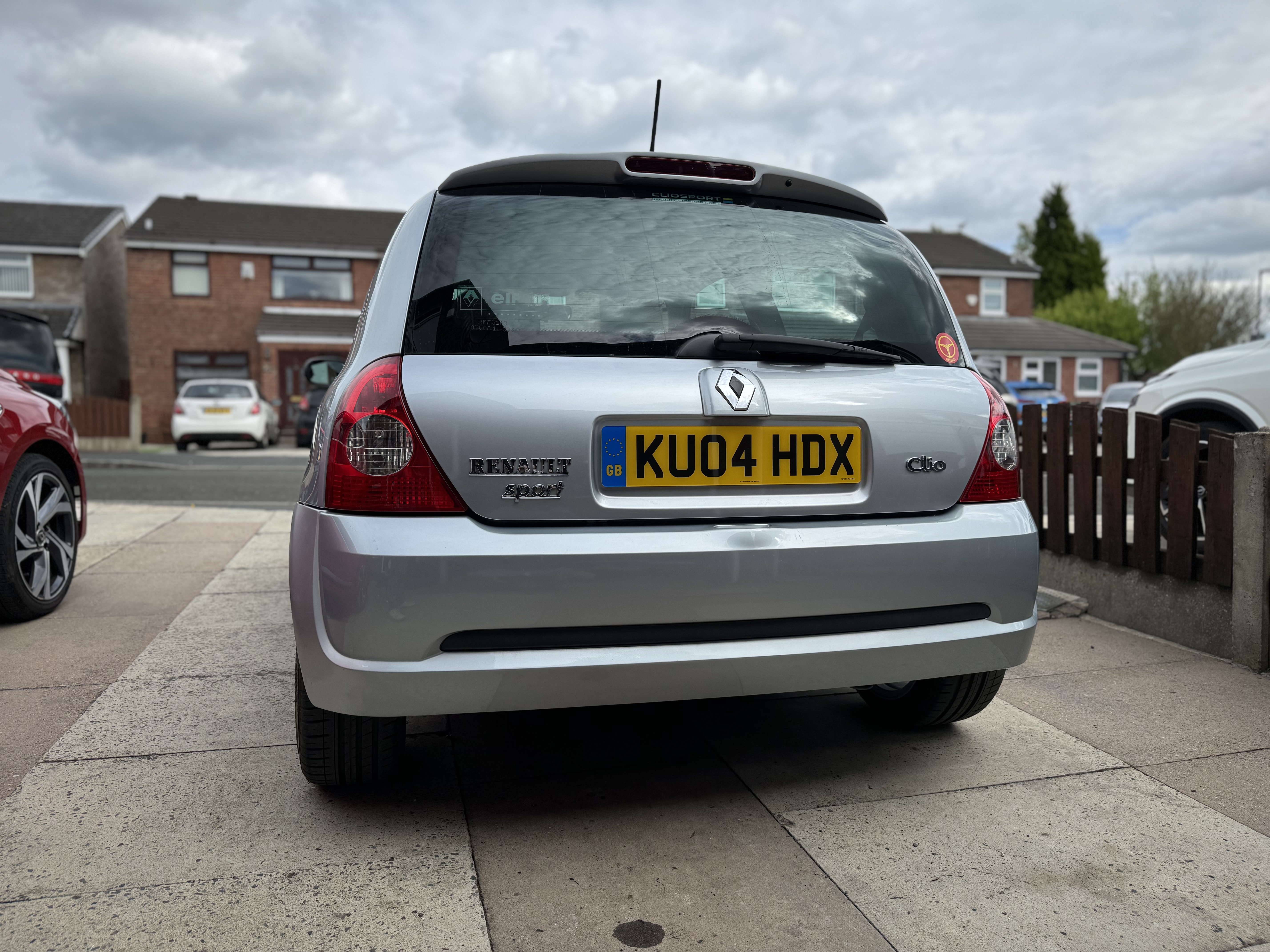

How visible is the back box from the rear of the car on the Klarius? I’d hate to see the box or tip dangling in view of the back bumper.
This is from the link I sent. I don't think you see much and I prefer OEM style rather than seeing any tailpipe at all.
Not the best angle tbf. Will be interesting to see what yours looks like fitted. Also is it stainless or mild steel?

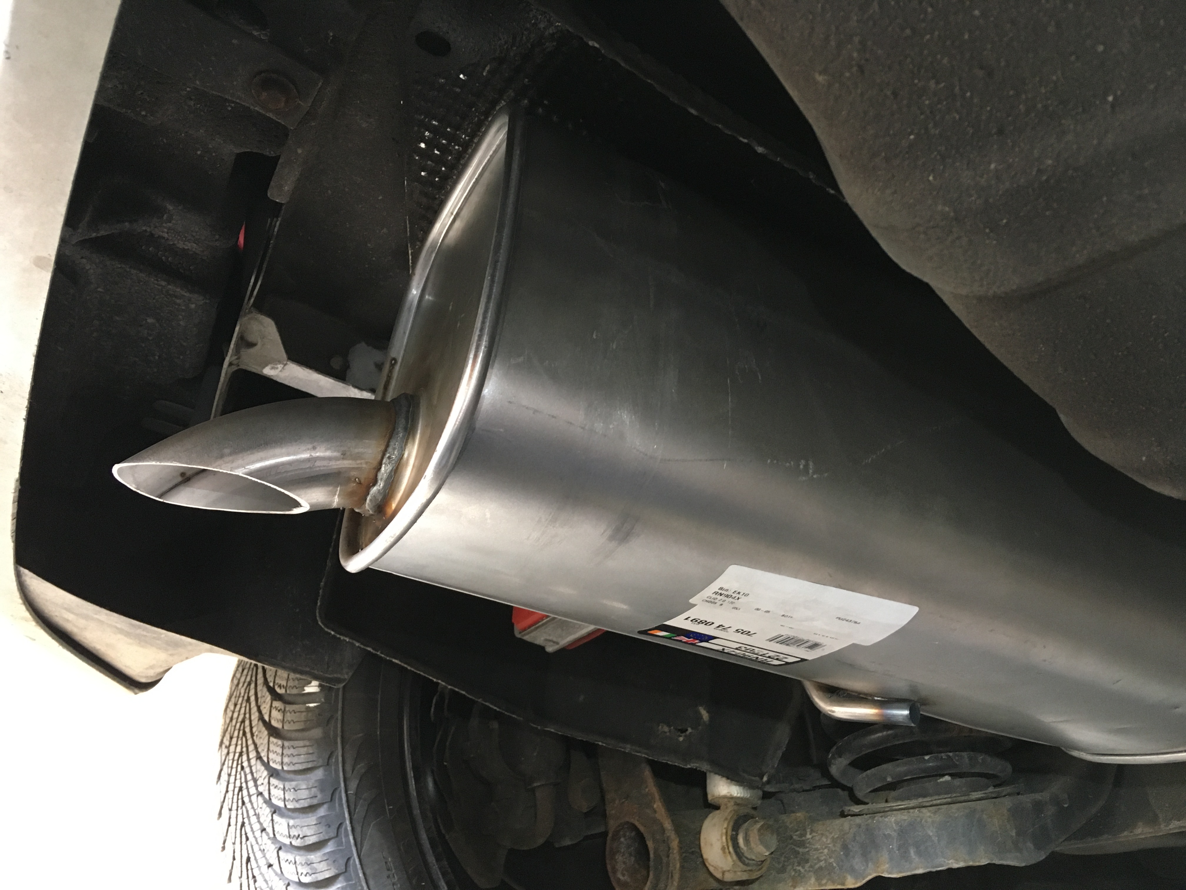

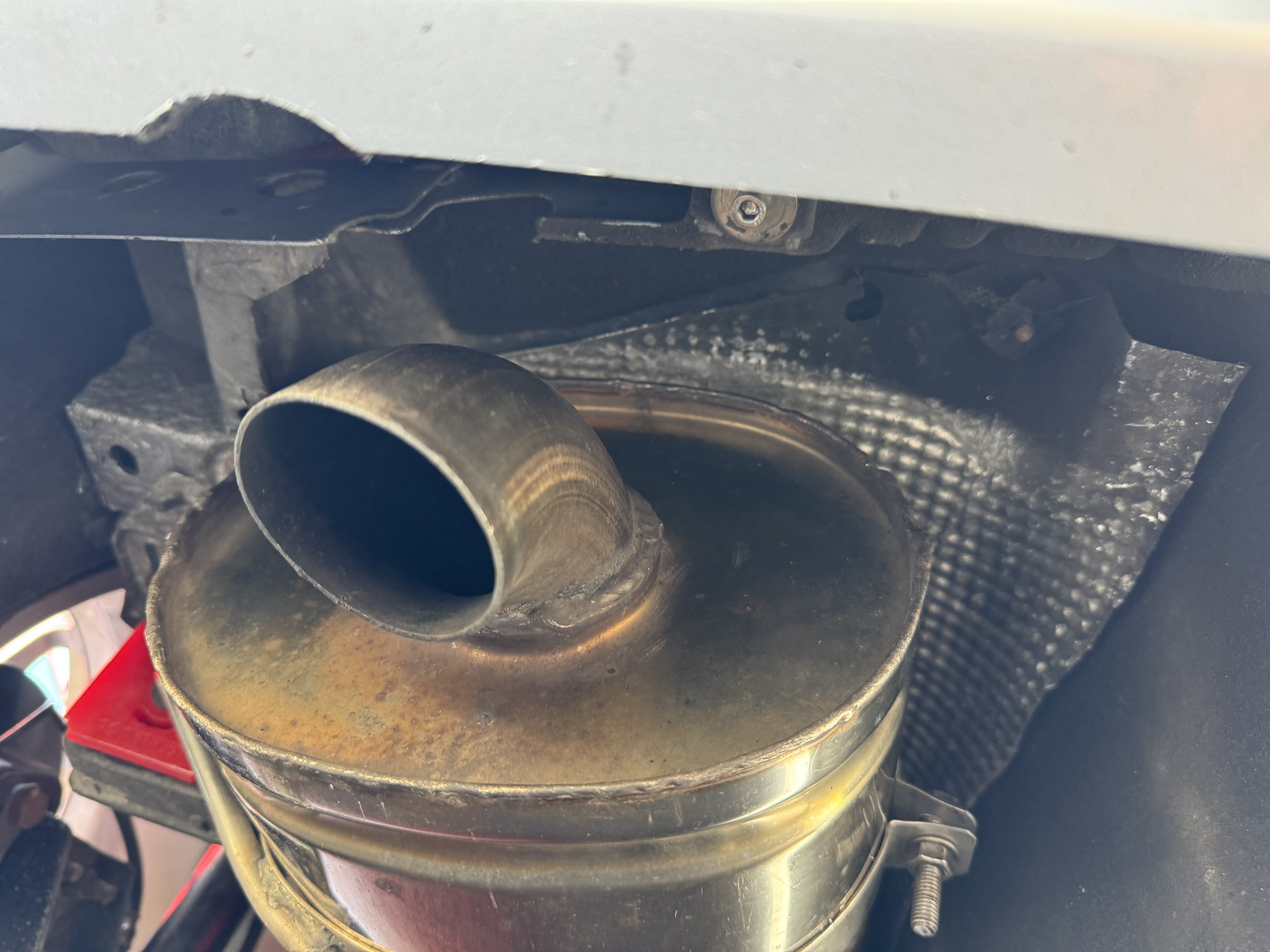

But here’s my ktec, as the back box is oval it made it quite easy to get it tucked right up behind the bumper.

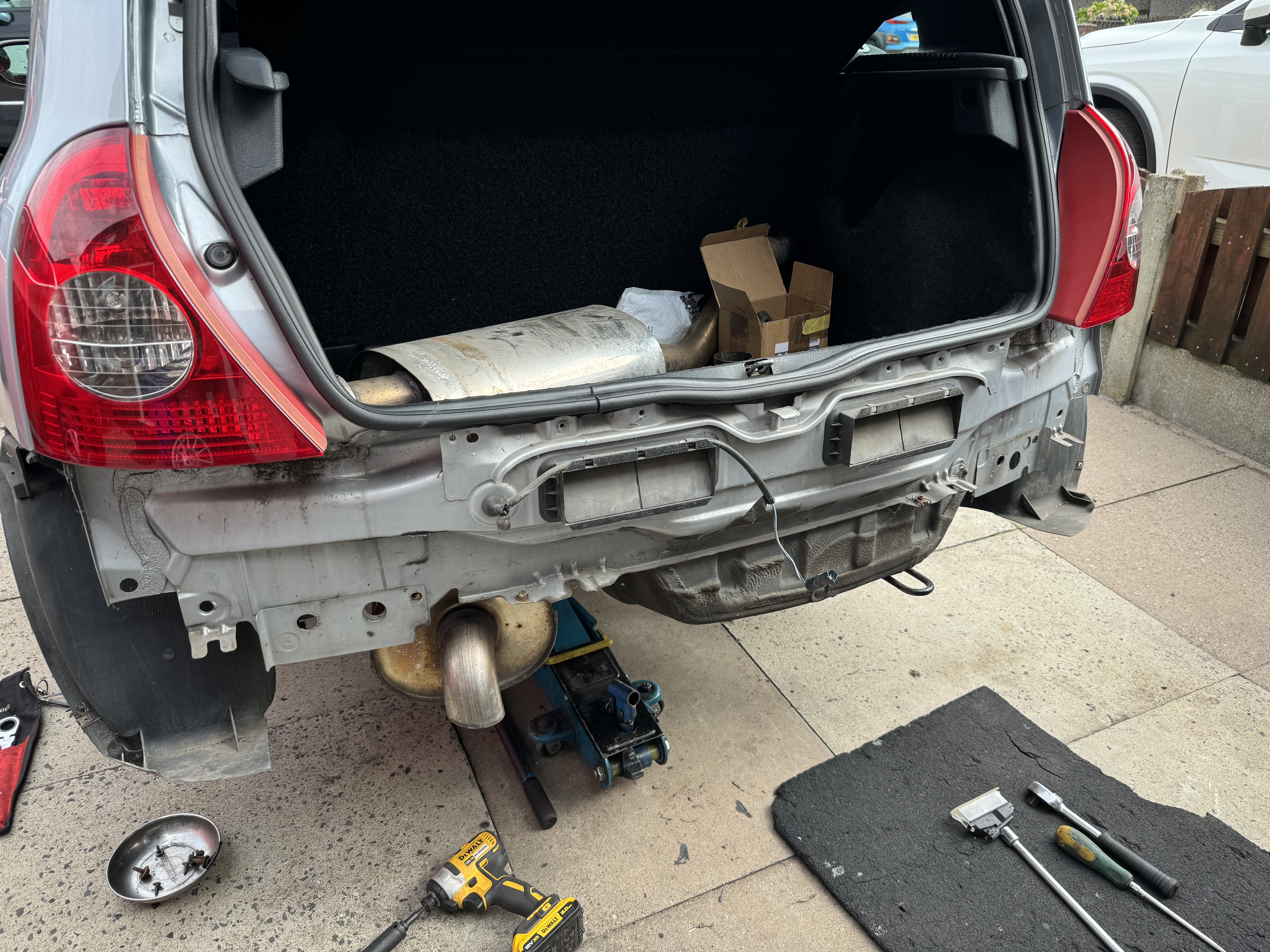

The main reason for going was for them to fit the new exhaust. Everything is new from the CAT back including a new poly bush to the rear exhaust mount. What a difference it has made. Driving back on the motorway it is so much quieter than before. I am absolutely sure that the car accelerates better with this new system fitted as the engine just seems to breathe a lot easier. If the car has only gained a few BHP there’s no way I would feel that but overall it just feels to pick up a lot quicker.I’m really glad I’ve changed it.
This is a great update as I'm looking for an OEM'ish exhaust that's quieter than what I have now.
So, I’m a week into the new exhaust and I can say it’s the best anti-mod I’ve ever made. It’s so much nicer to drive and throttle response seems better. Got the bumper to sort next week (again!) and a few other bits. No doubt it’ll throw a piston by weekend!

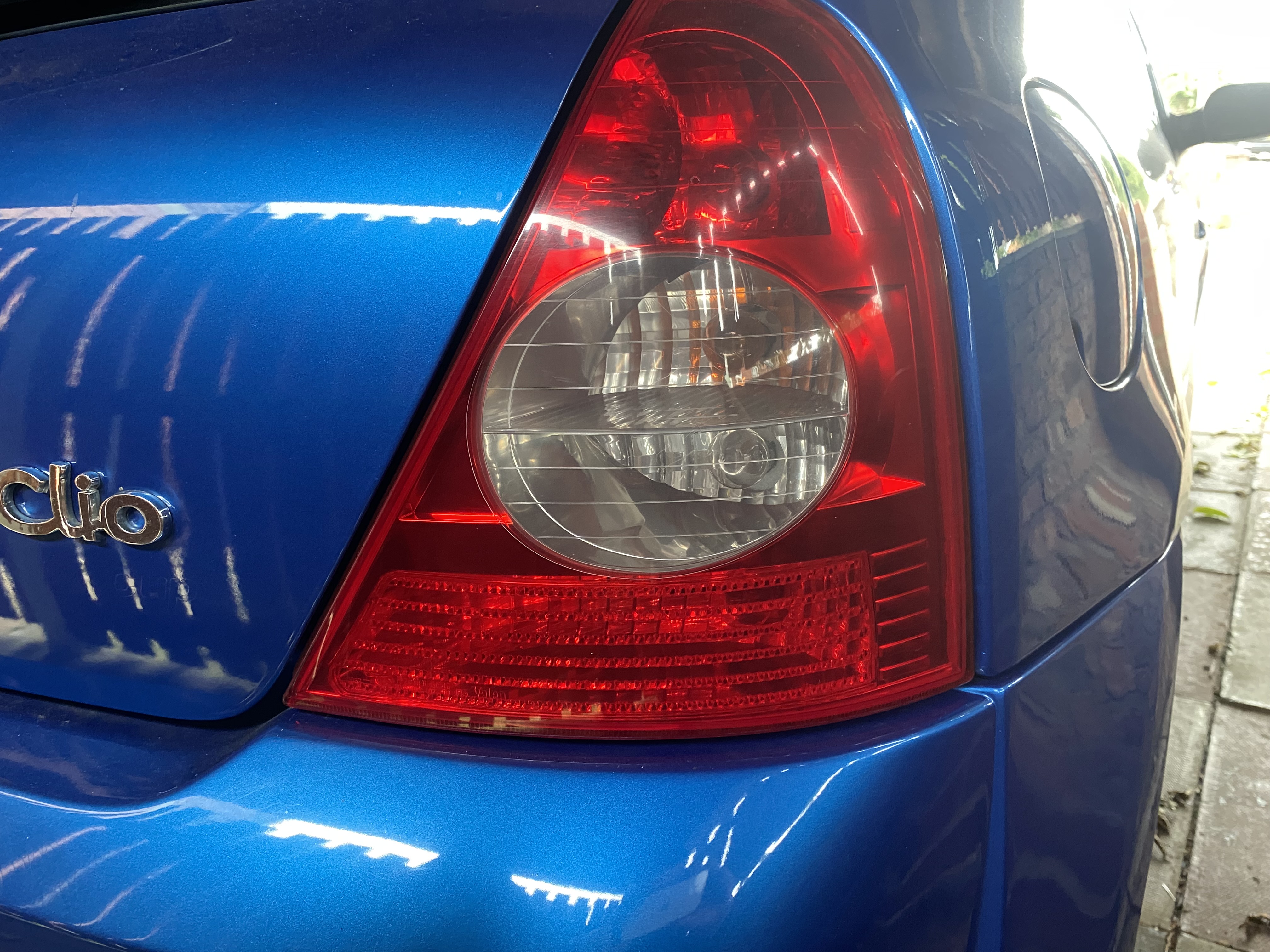

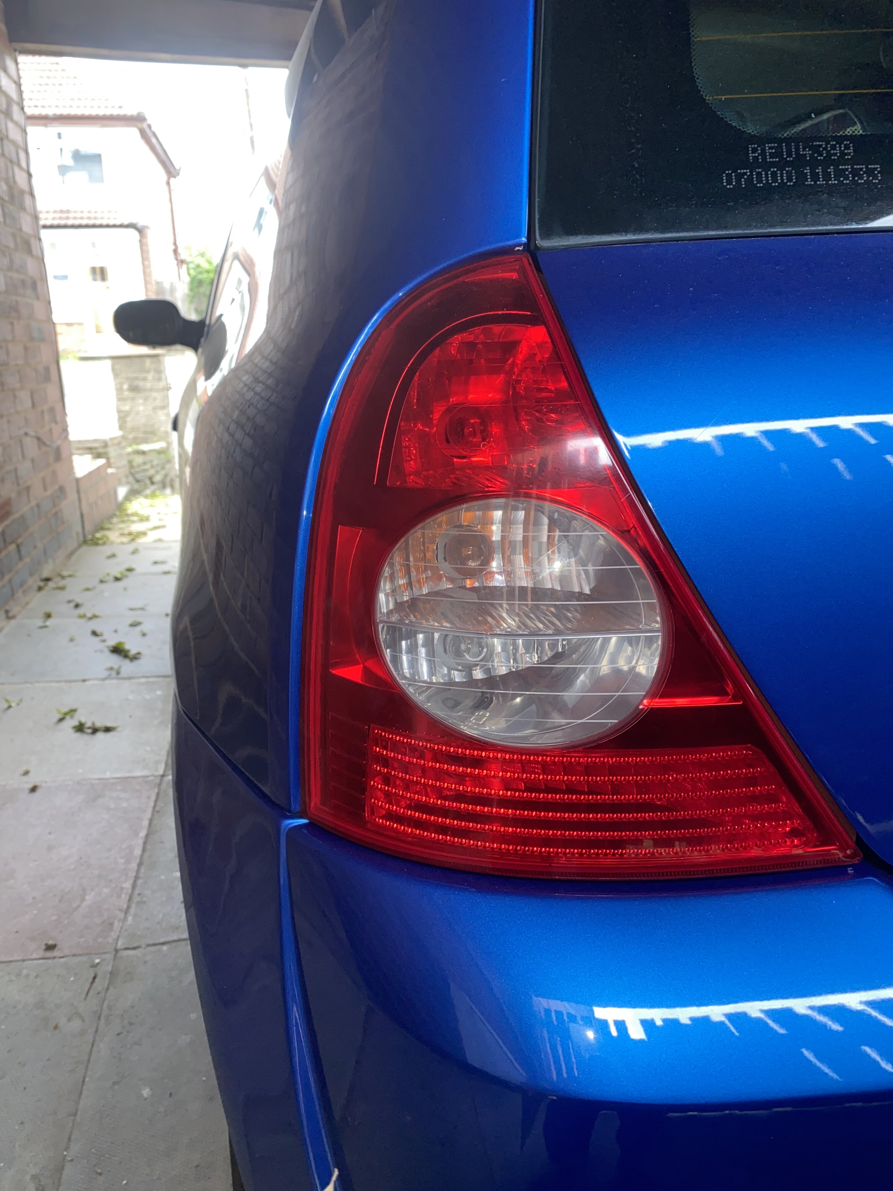

Decided to polish up my rear lights today. They were not too bad so have them a quick rub down with 2000 grit wet and dry and then polish with a light cut polish followed by a finishing polish. Not a massive difference but they look better to the naked eye.

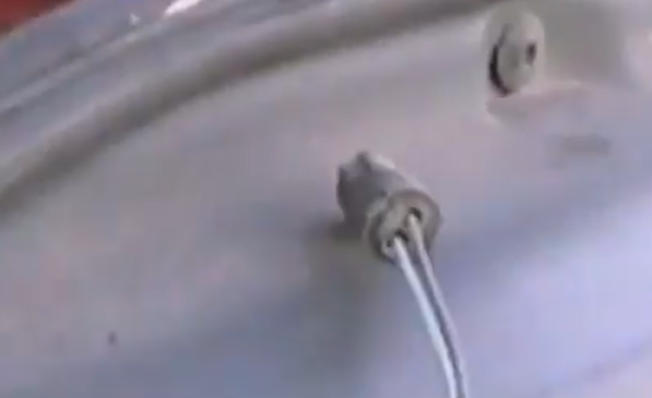

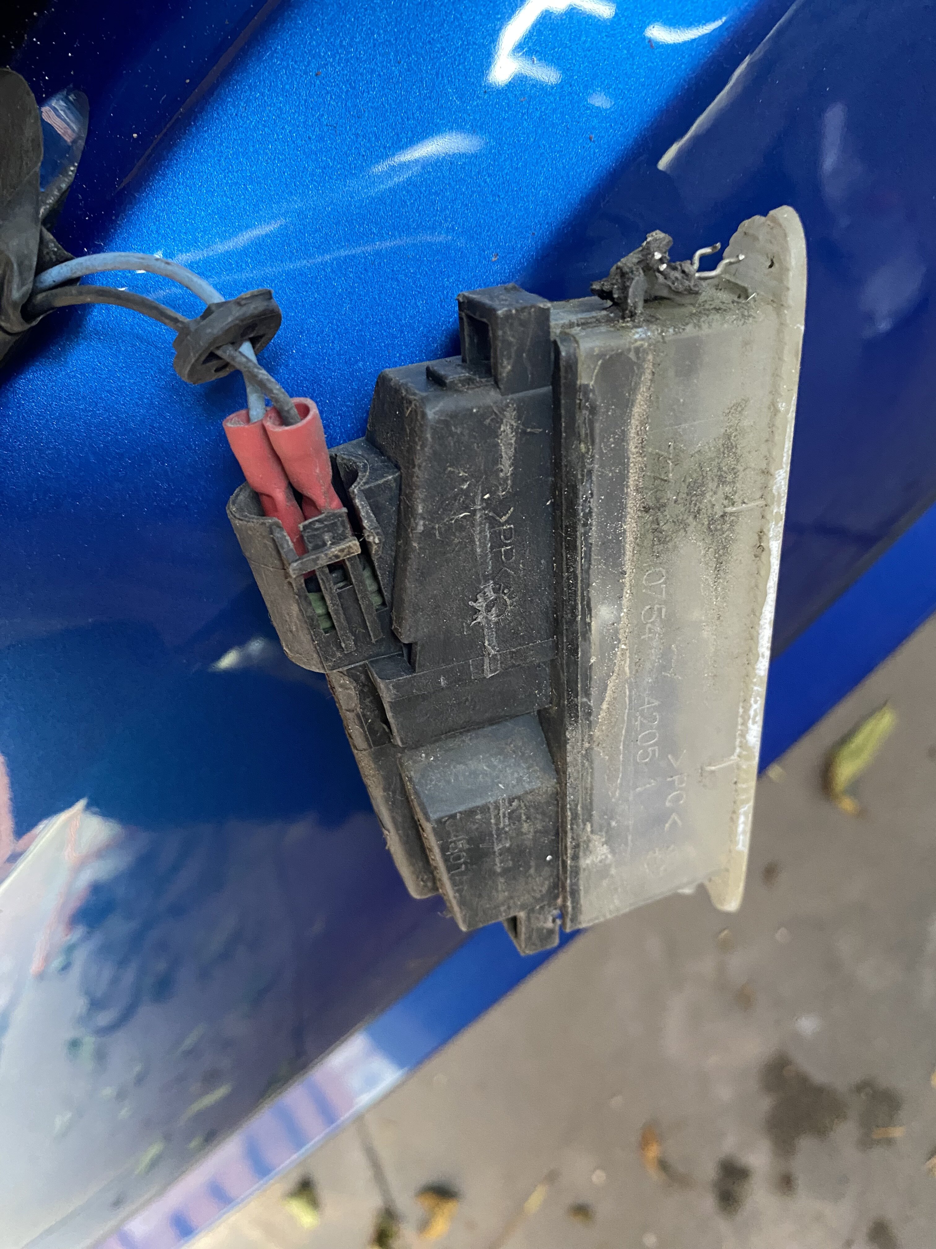

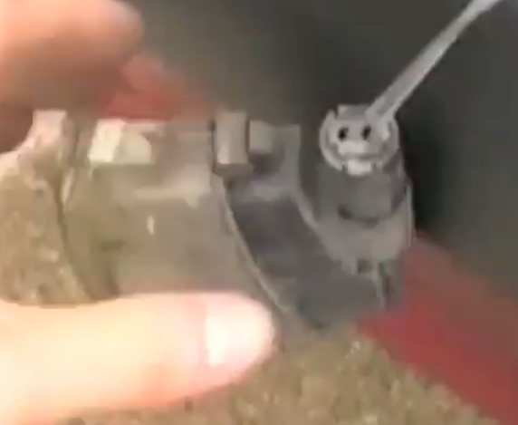

The previous owner has just cut the wires and plug off and crimped some connectors on.
Pic of original connector

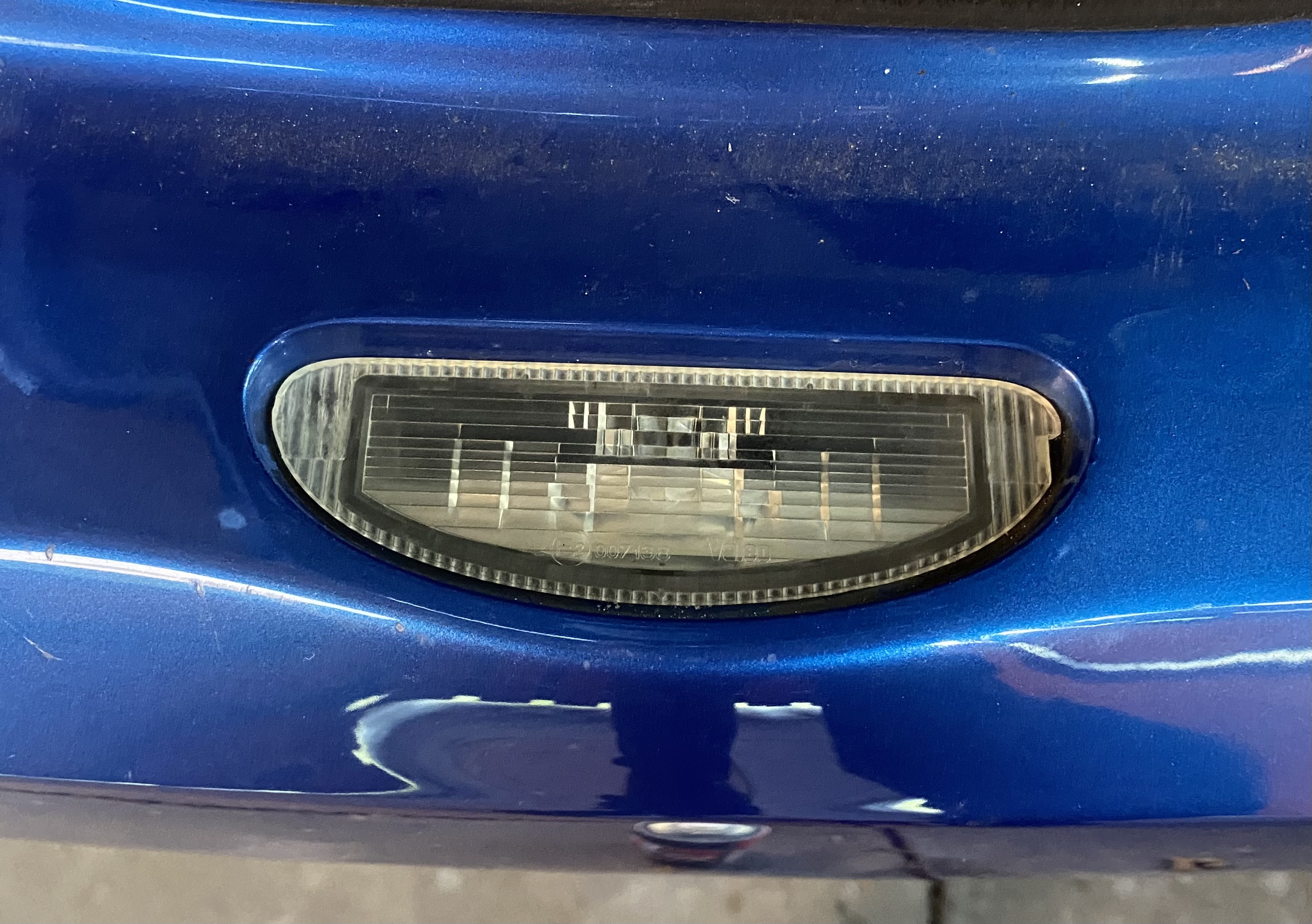

More work today…. First off was cleaning up the rear plate lamp that Matt sorted out for me. It cleaned up great.

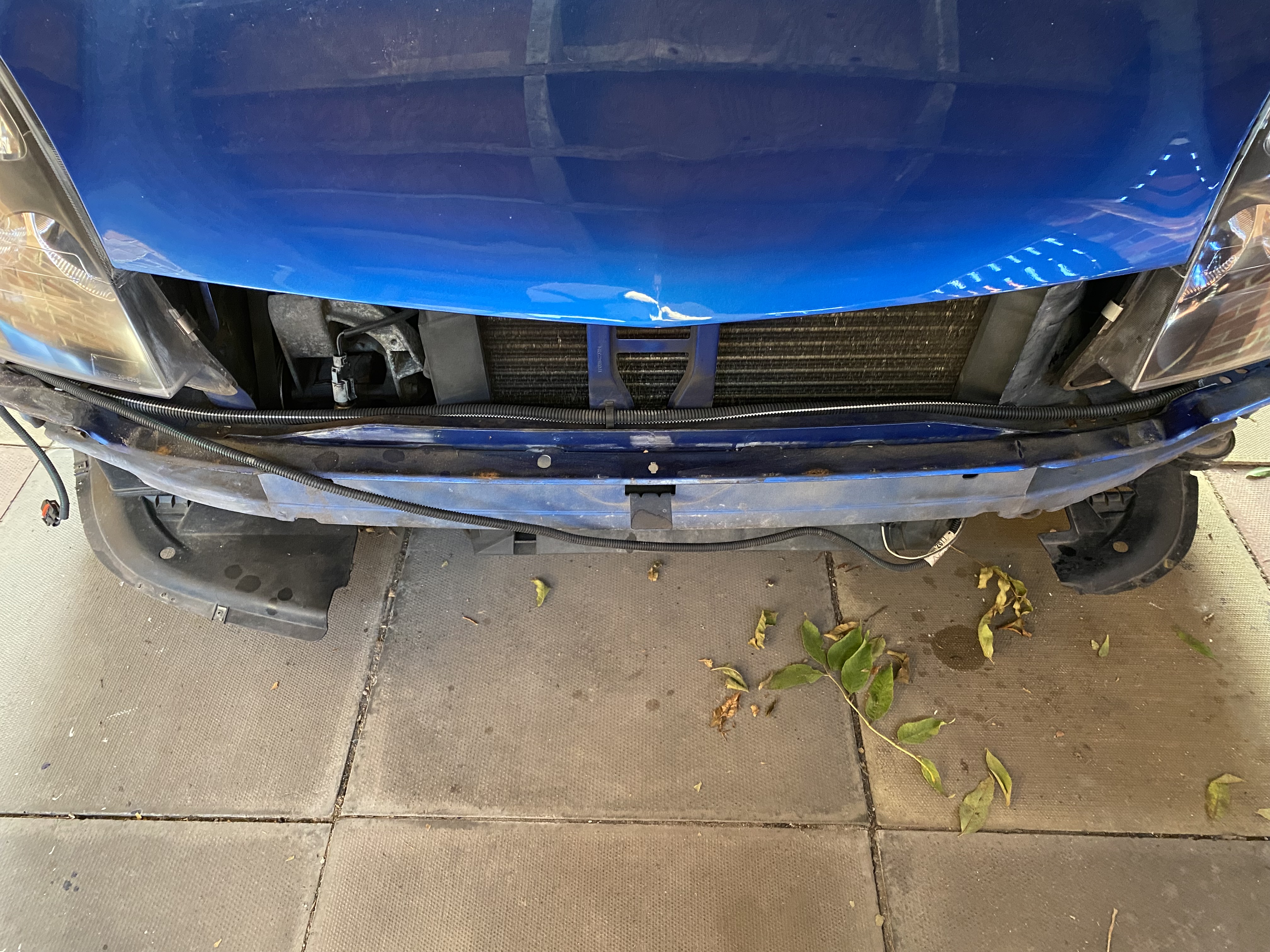

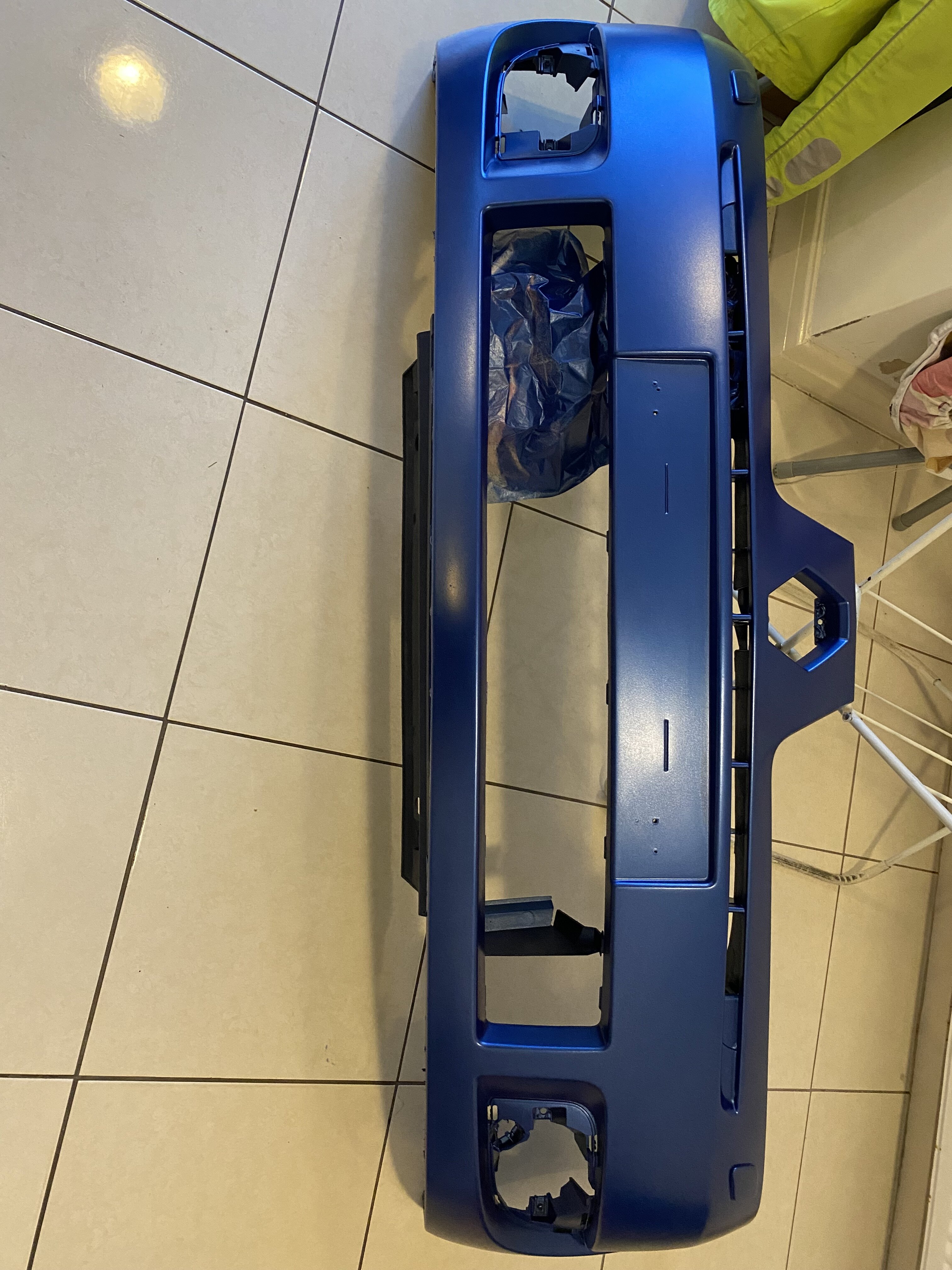

Next up was to remove the bumper and try and align the N/S headlight as the car has clearly had an impact on that side in the past. I’ve done my best to get the distance the same around the bonnet compared to the other side. I’ve had to use a bit of ingenuity as one bolt hole for the headlight bolt is nowhere near in line. It not had major damage but I’ve tried to use a jack to push things straight and there was no chance to get it right. It would have to be jigged but it’s not worth the cost as it’s now not noticeable.
I found that my RENAULT and SPORT badges were about to fall off so I removed them and now I’m waiting for the correct tape to refit them.

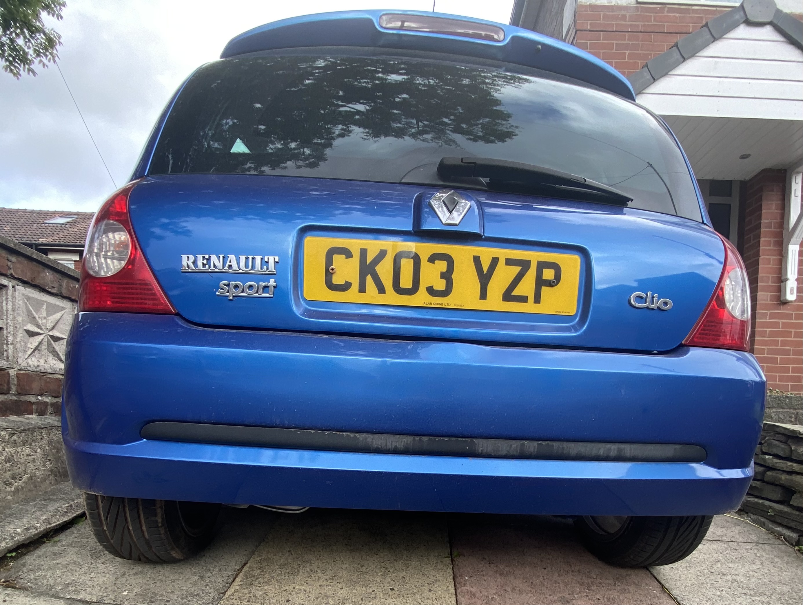

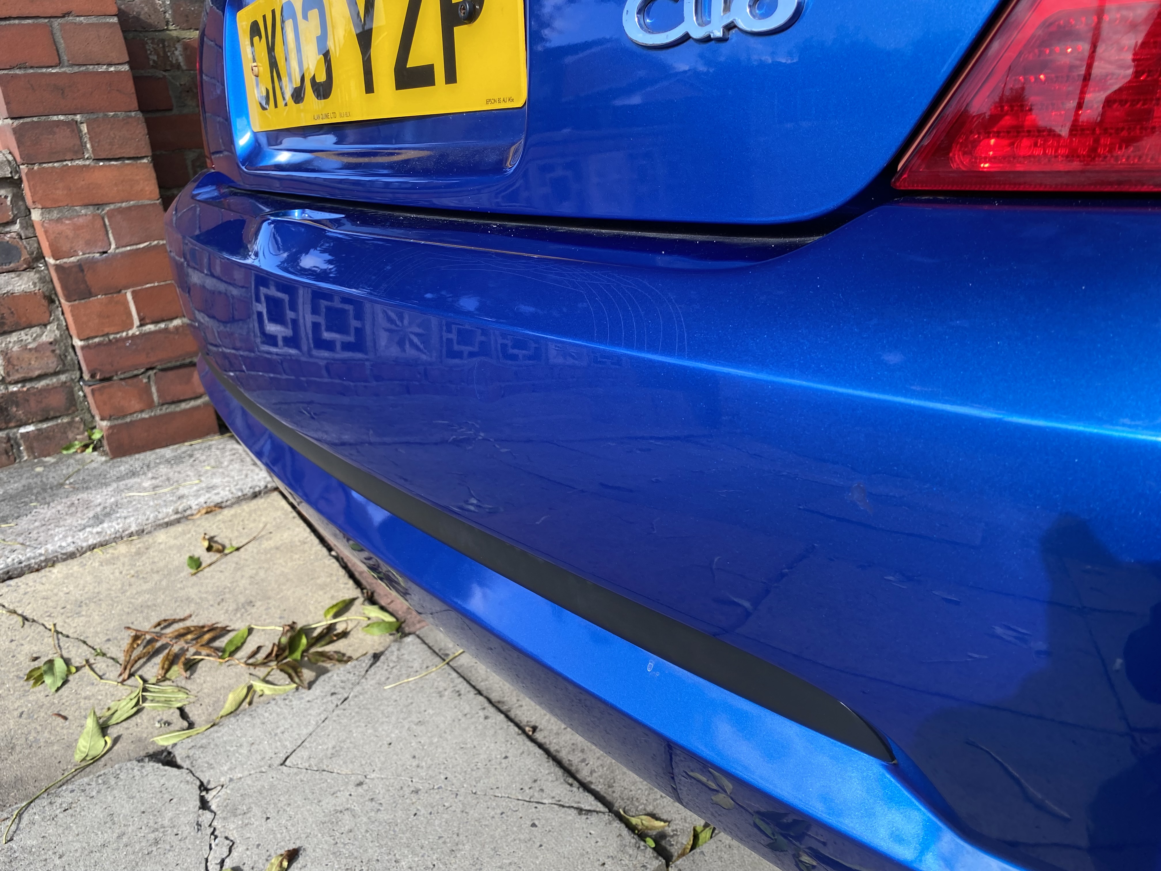

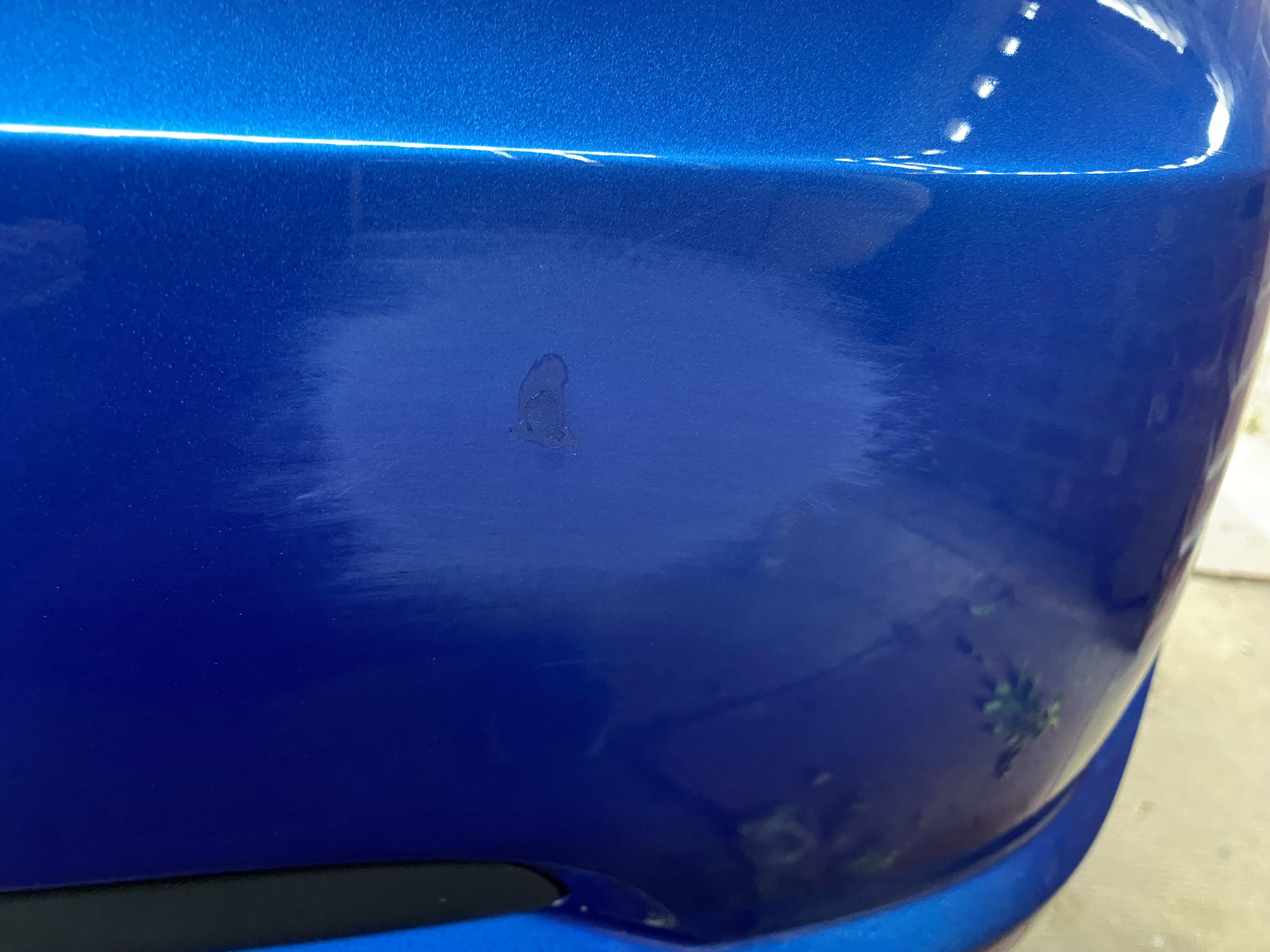

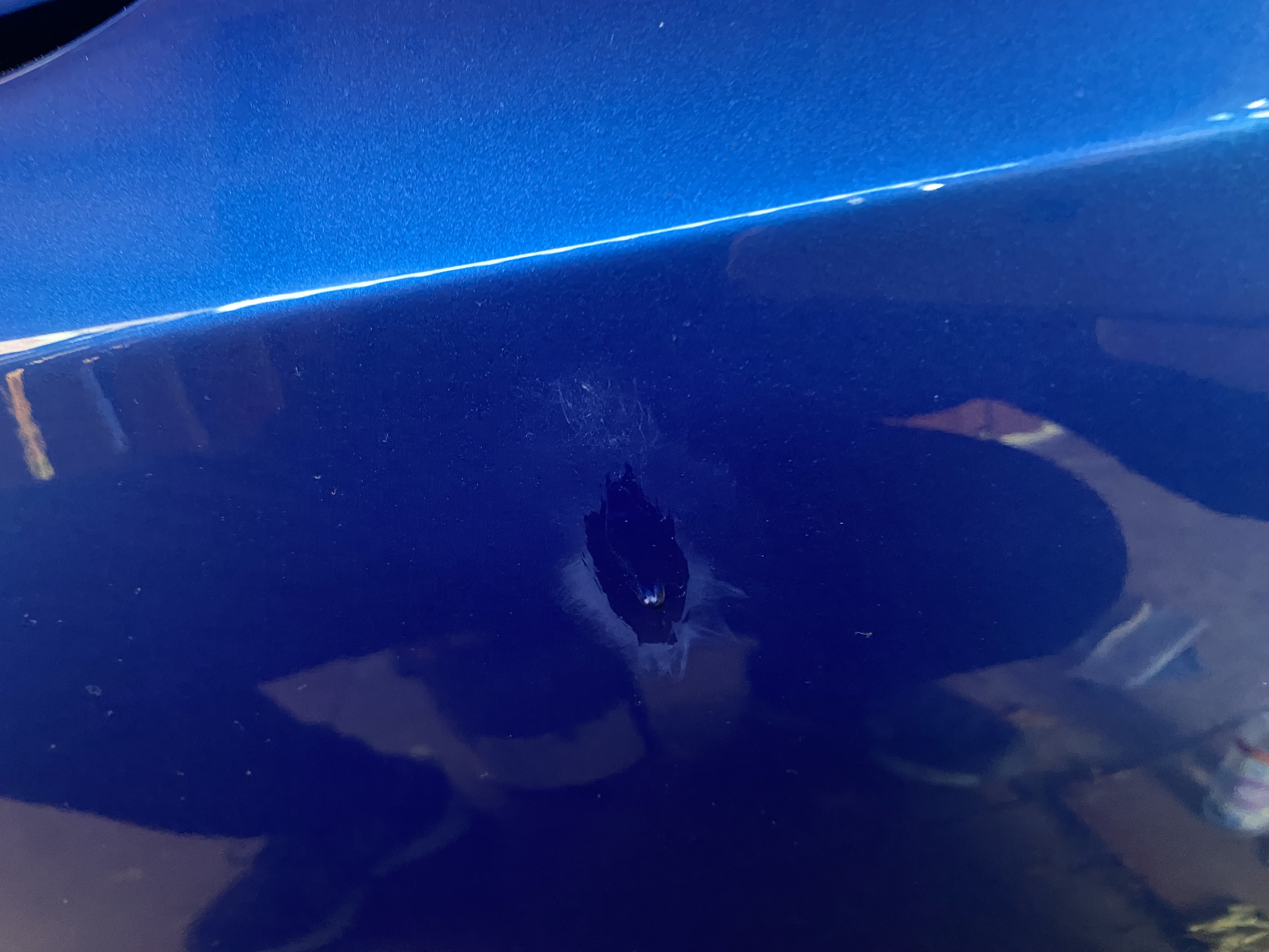

The rear bumper had two marks in it from an impact so I’ve done my best to repair them with touch up paint, wet n dry and my polisher. They are way better now but you can see the difference between original paint and the touch up. The paint has also flexed from an impact and it’s impossible to repair. Only a respray will solve it but it’s not that noticeable unless you’re looking for it. It looks terrible on the photo but I’m not too bothered. I was going to get the car into a body shop where my brothers works, but he’s just left there to become a driving instructor. How rude!

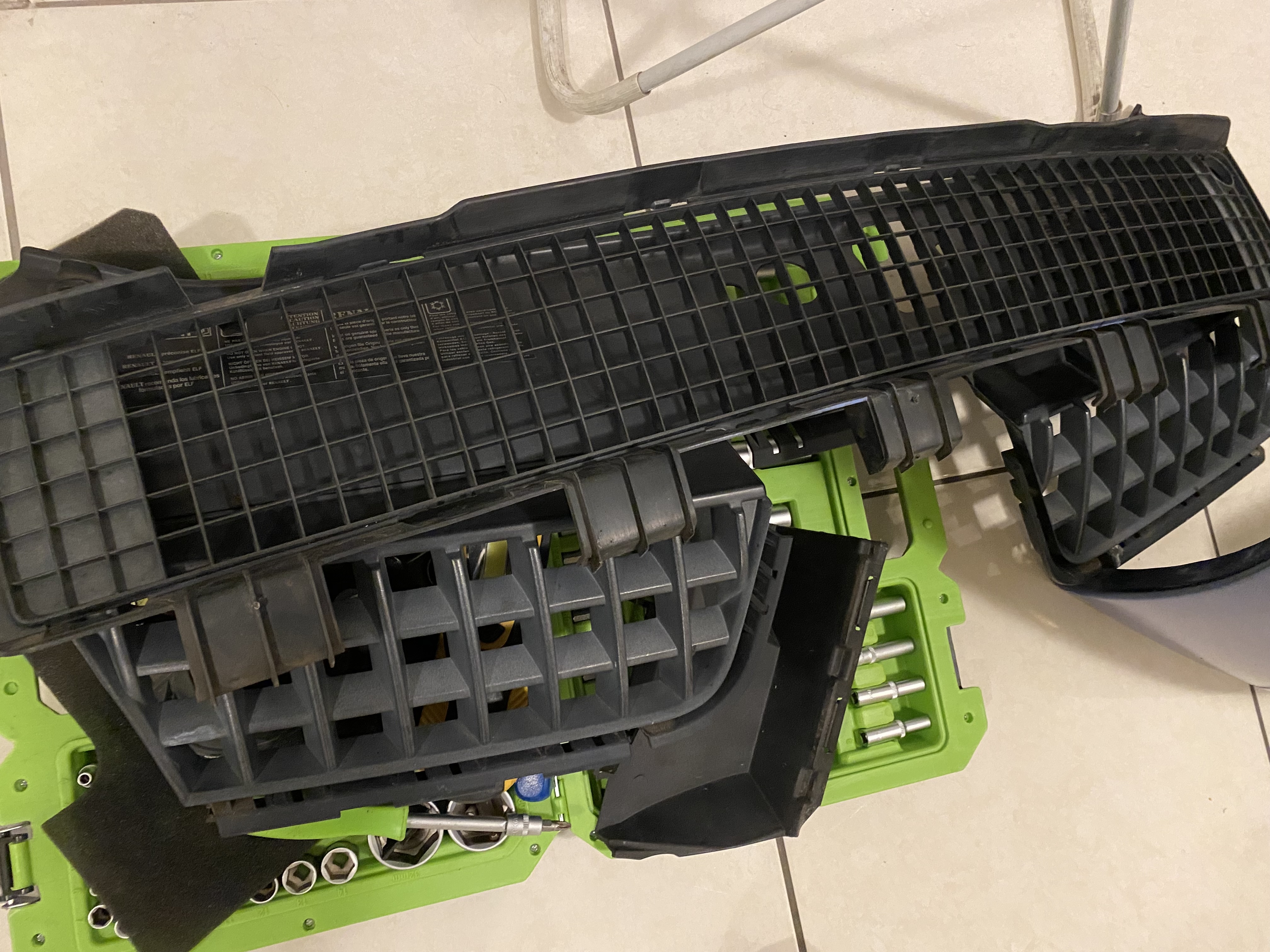

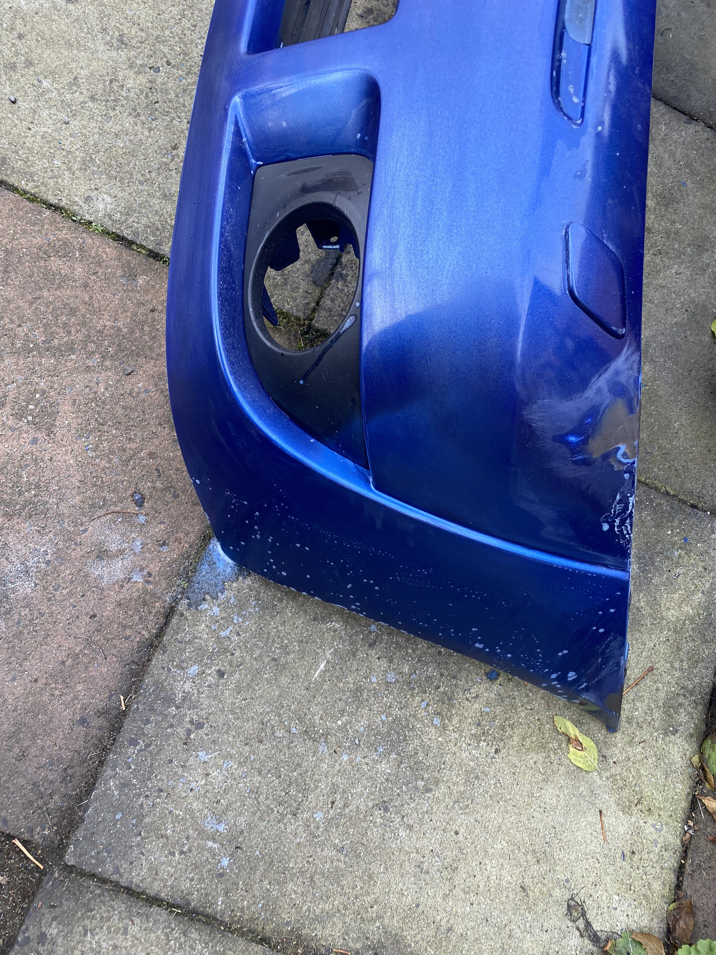

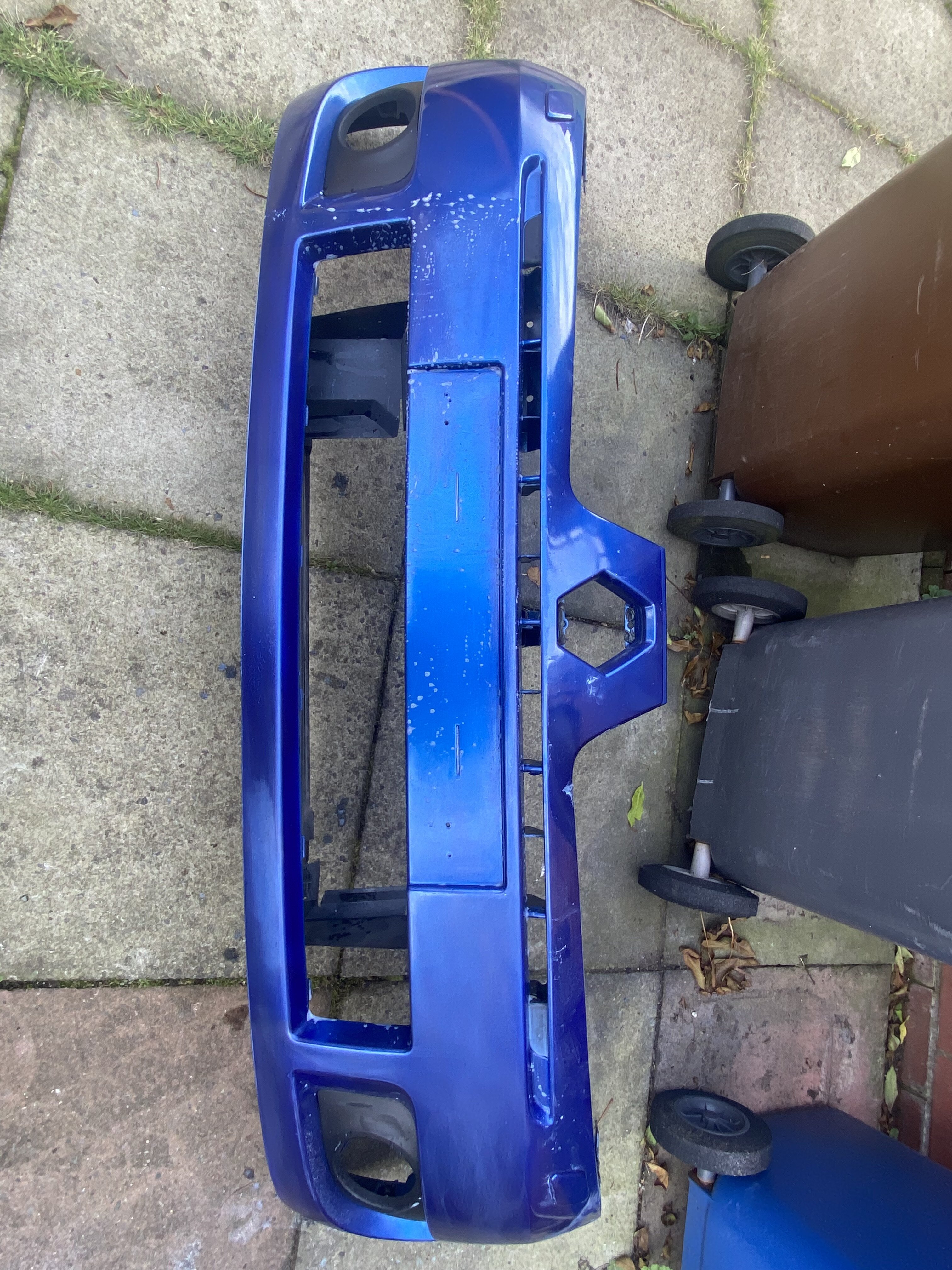

I’ve got the bumper off and started to repair it but ran out of light. I’ve got all the paint etc to get it done and I’ll make a spray booth under the carport to keep dust off. I’ve also got 2K lacquer for it. I was tempted to paint the grill and other dark bits but I’ve decided to keep everything original.

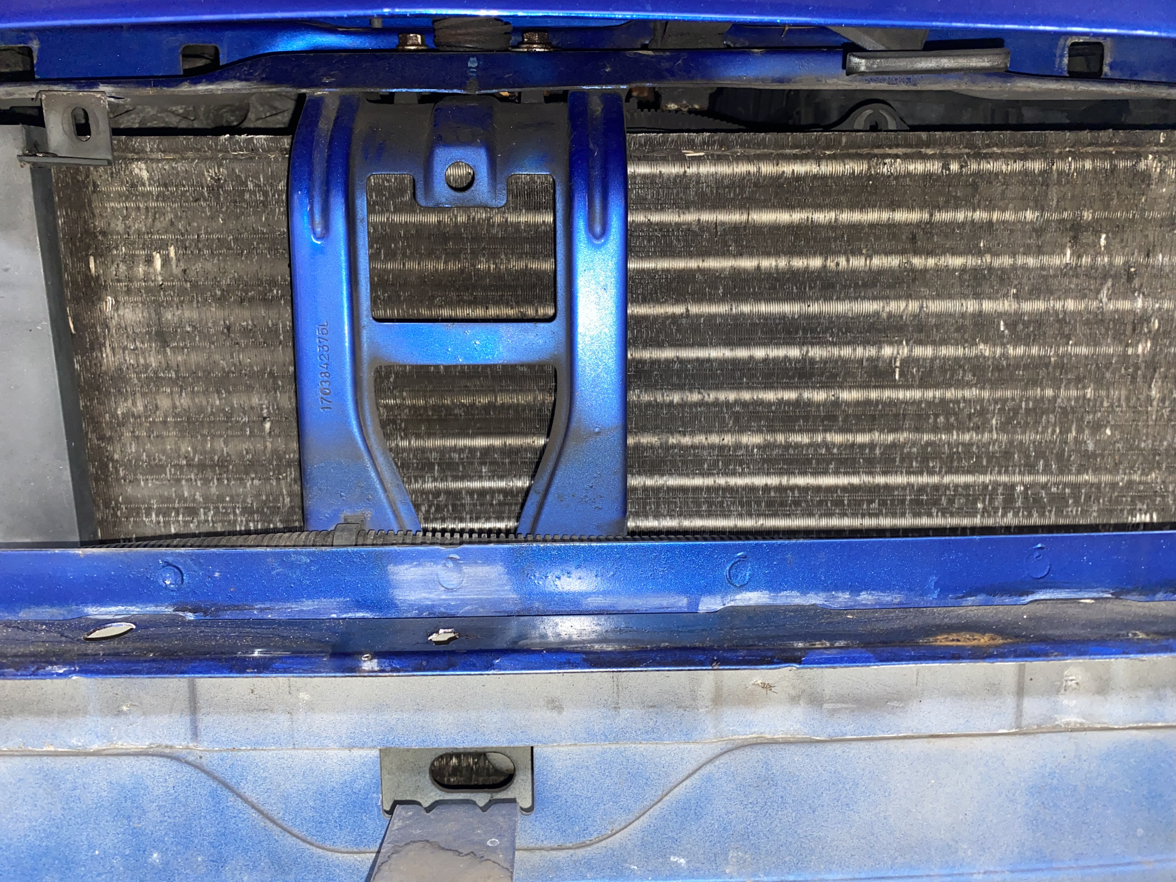

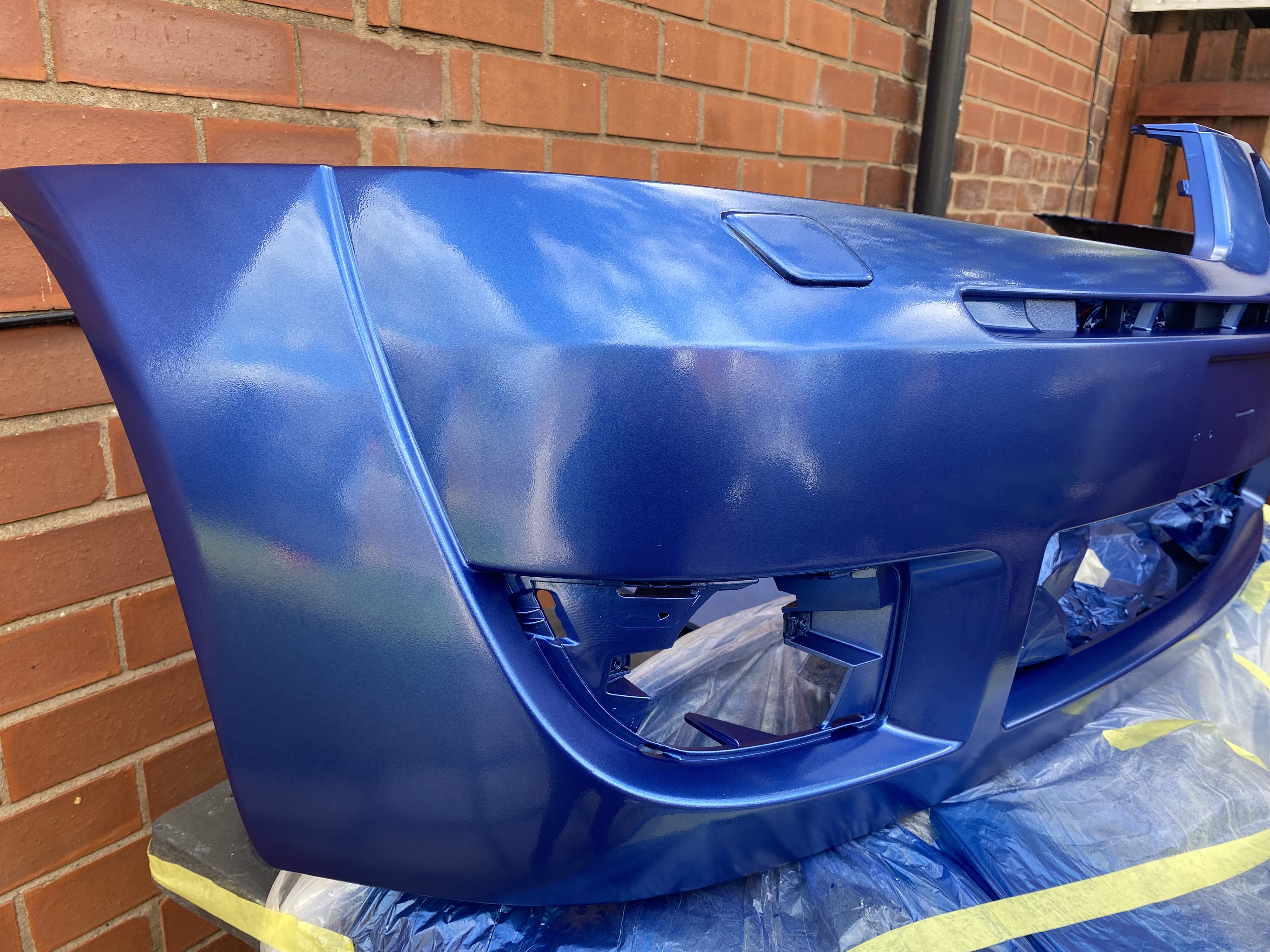

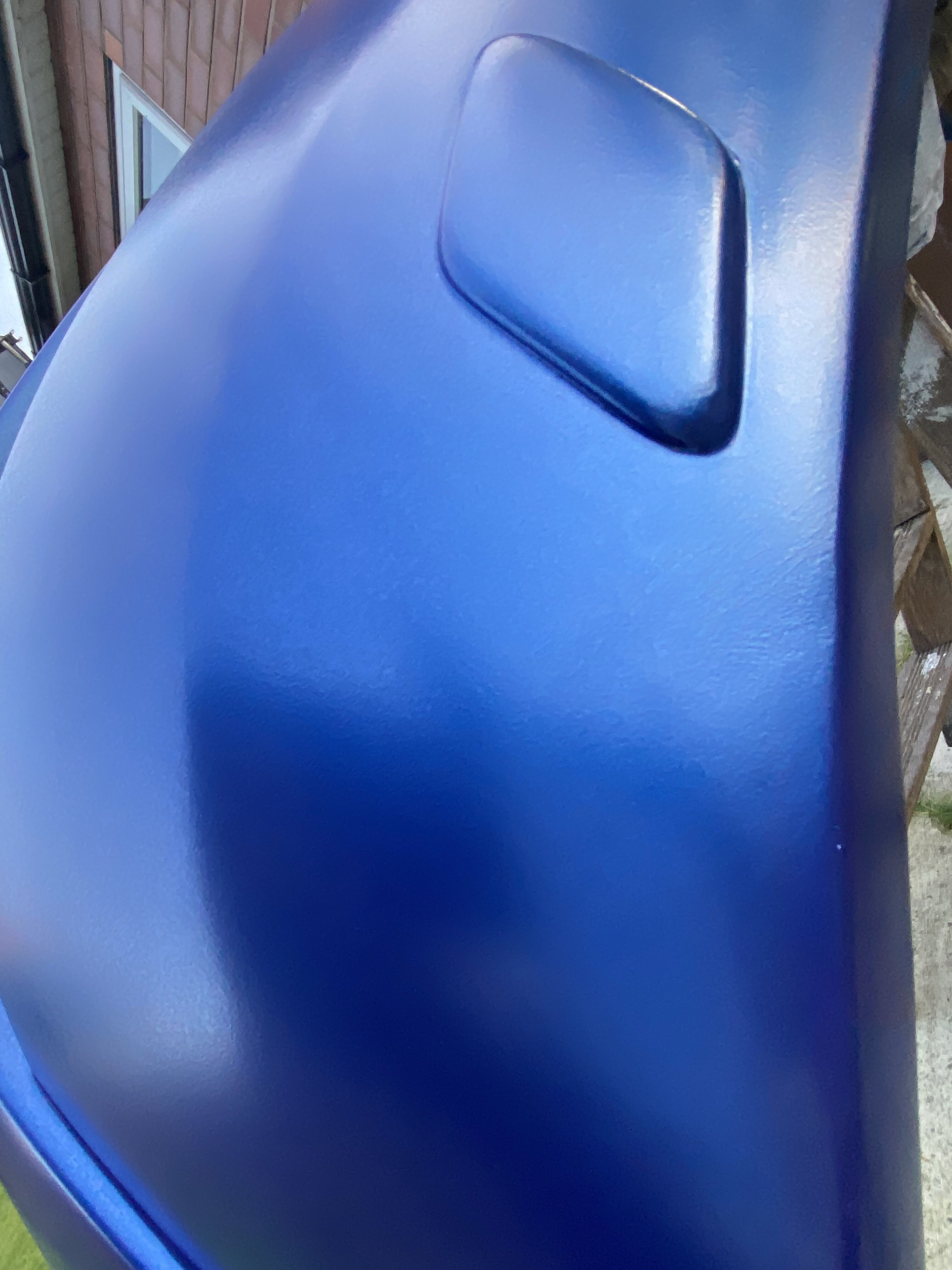

On with the work again today and the first job was to jet wash the radiator with my new Worx cordless pressure washer. I’ve used all the 440v pressure washers years ago (MOT washing low loaders, washing out maggot infested fridge boxes etc) and this one is obviously not going to remove the CUP 172 stickers on the doors. It’s really good for washing and rinsing so used it to shift debris from the fins. I think a new radiator may be in the shopping list for next year….

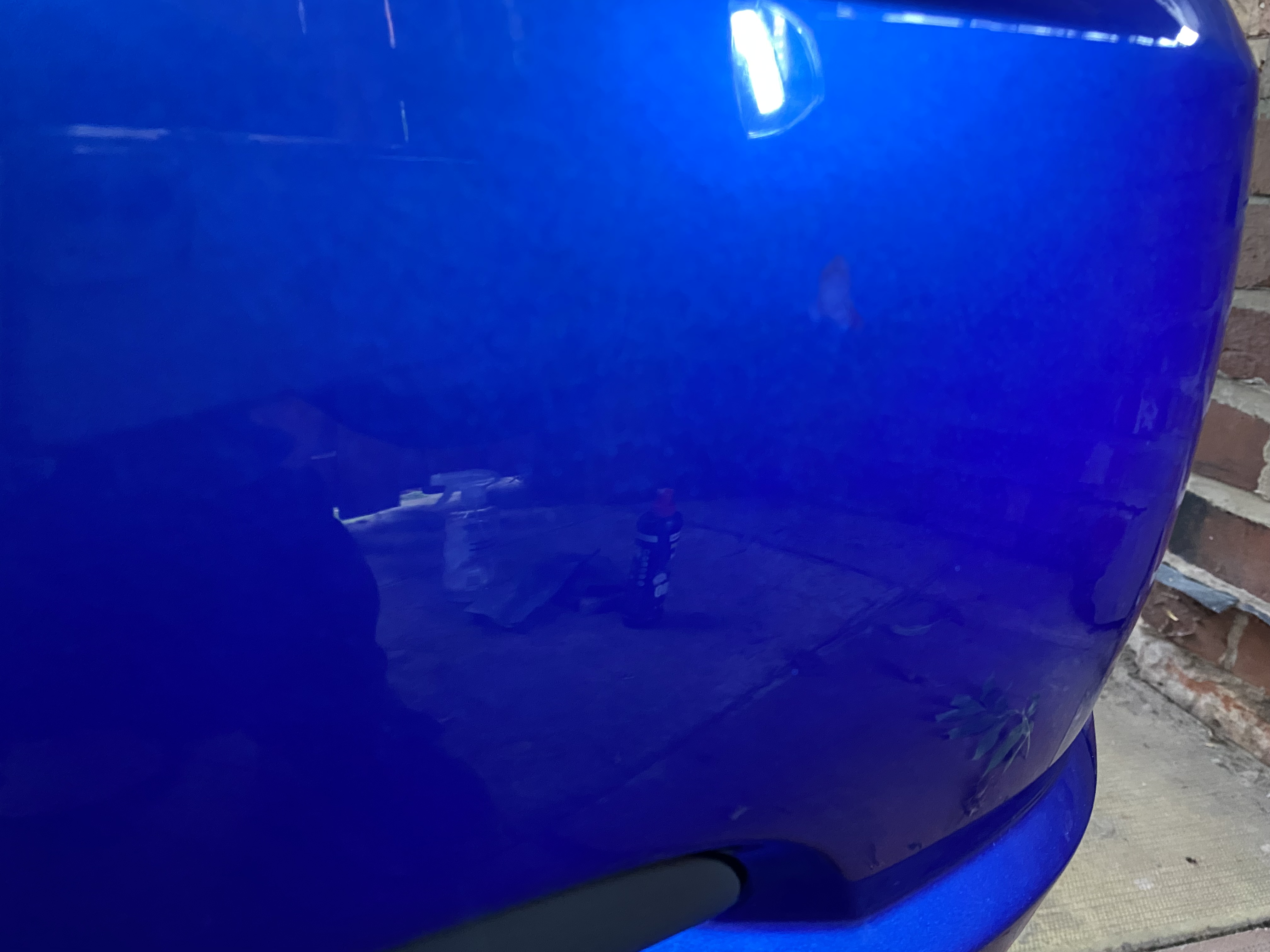

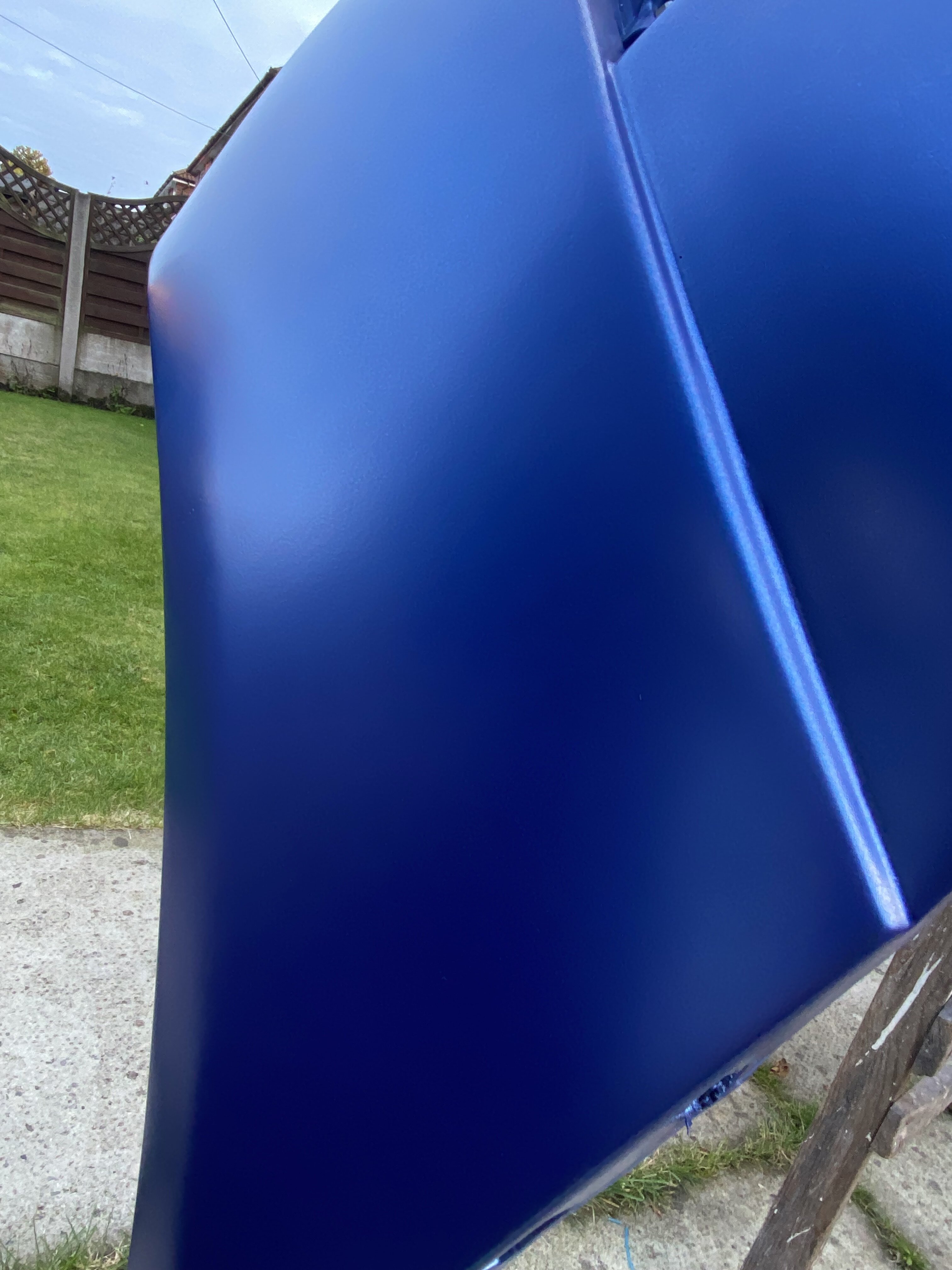

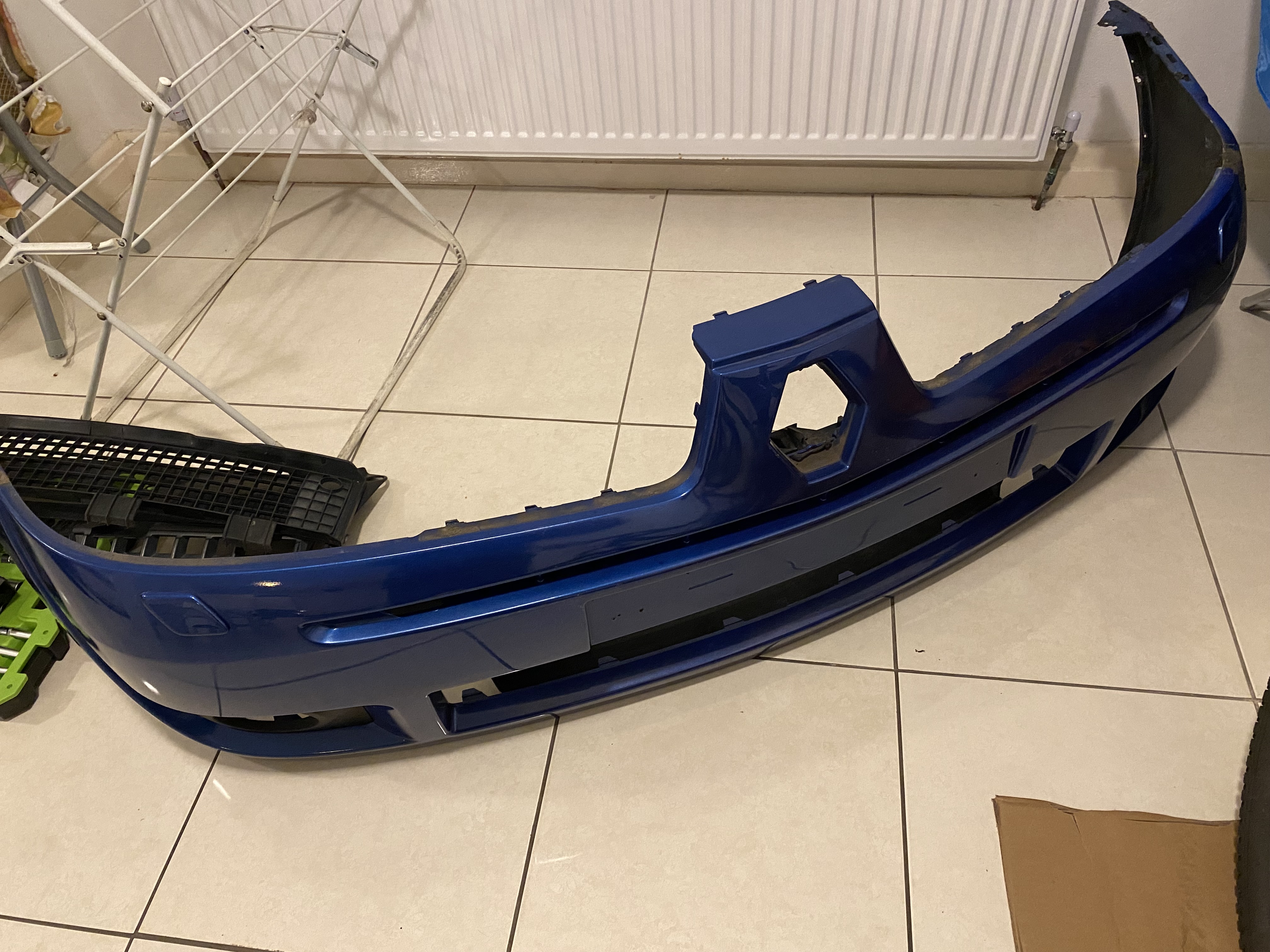

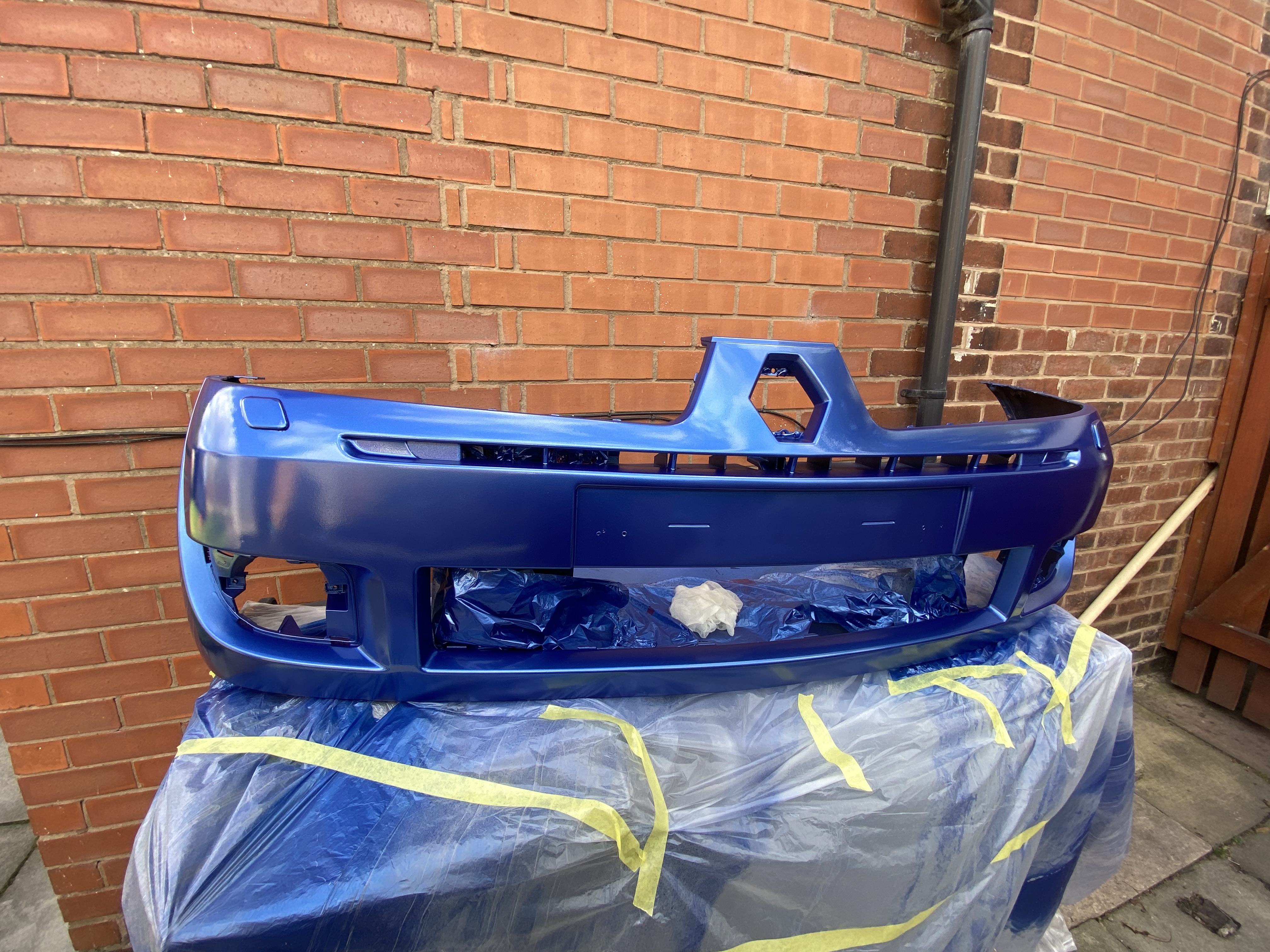

Next up was the bumper. I’m trying to make a good job of it so I’ve took my time with prep and all that but I’ll not be getting a pro finish, of course. 22 year old car? I’ll live with it.
Sanded, washed, filler’ed, sanded, washed, panel wiped, tack rag wiped, sprayed, sanded, panel wiped…..etc etc. Not bad for a first coat. A couple of bits to sort to get a smoother finish and then several more coat be for a 2K top coat. Hopefully it’ll be ok.

Mid job…

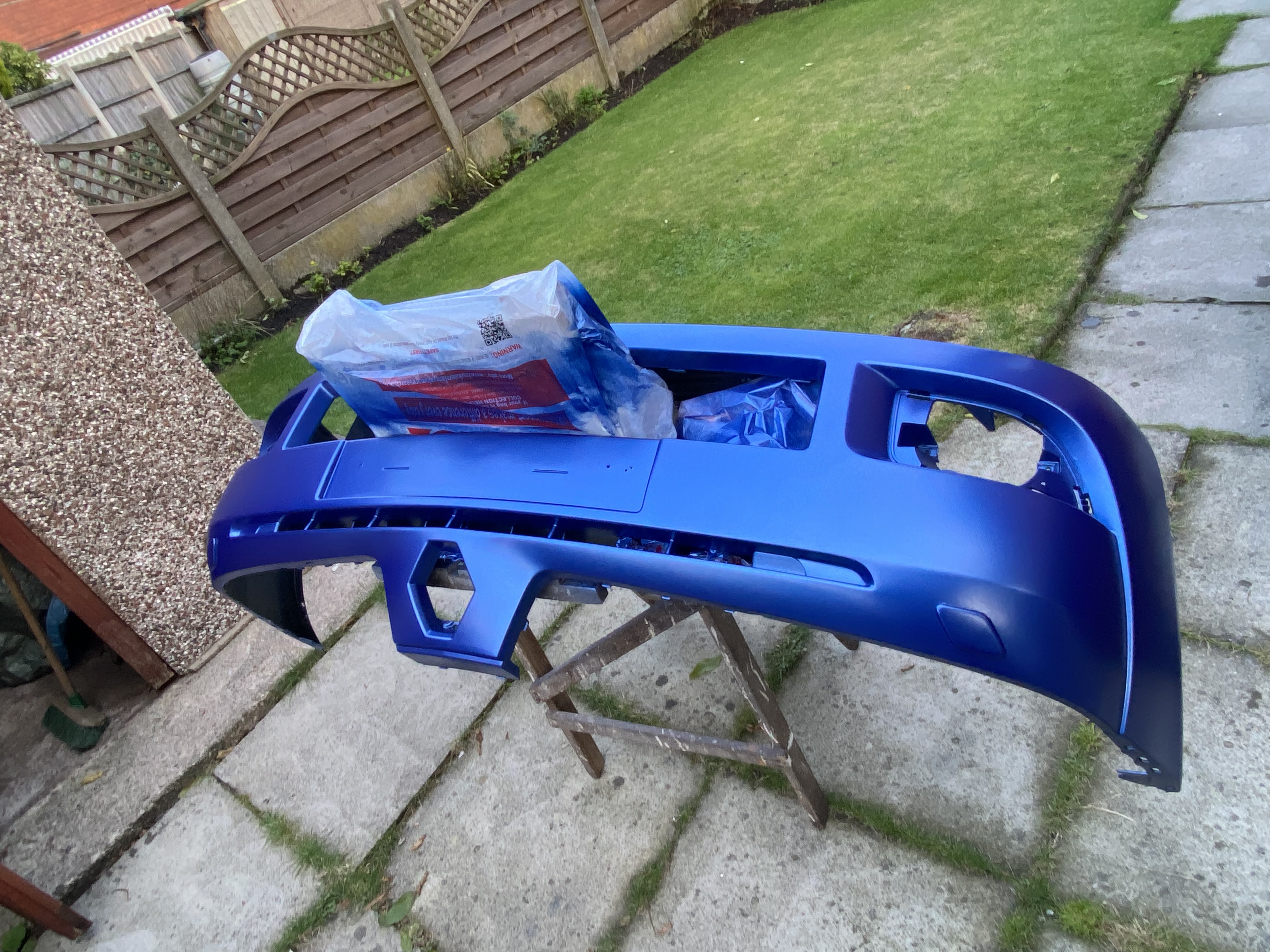

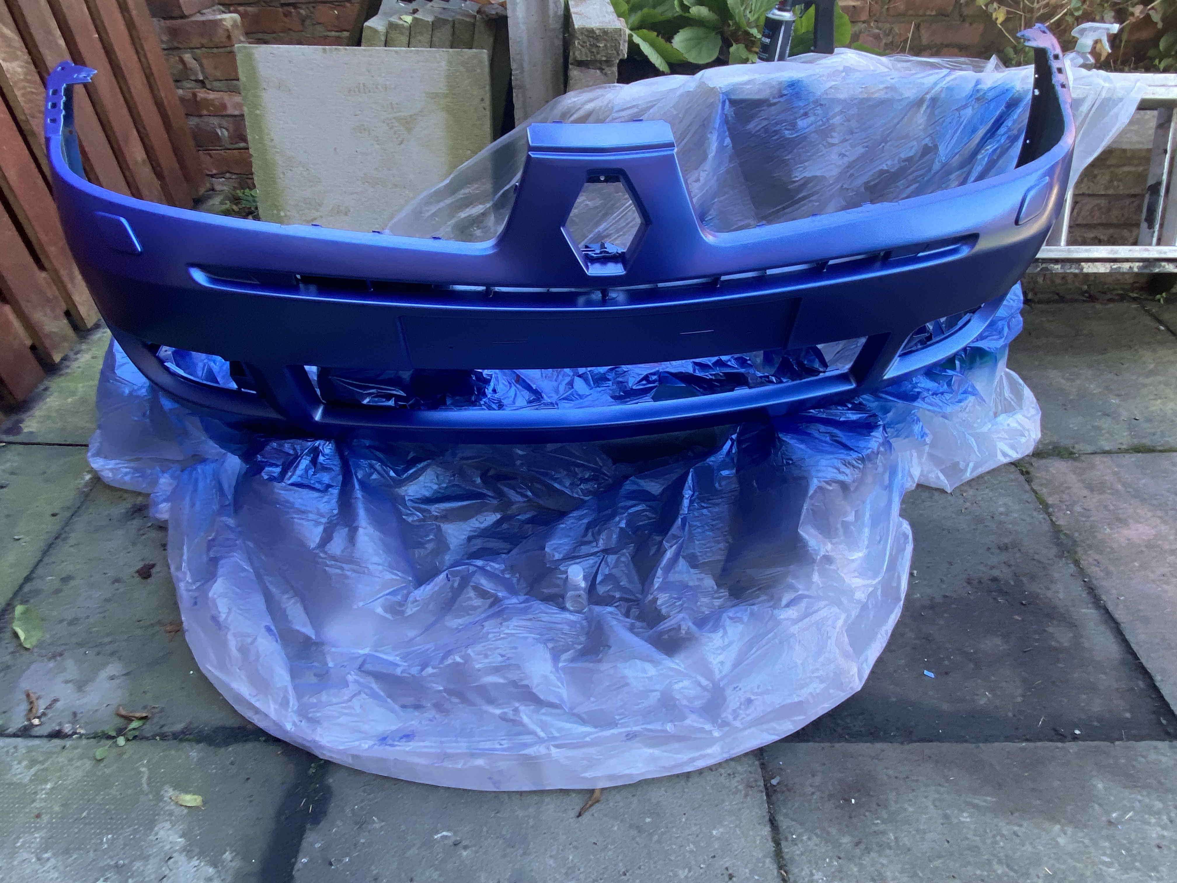

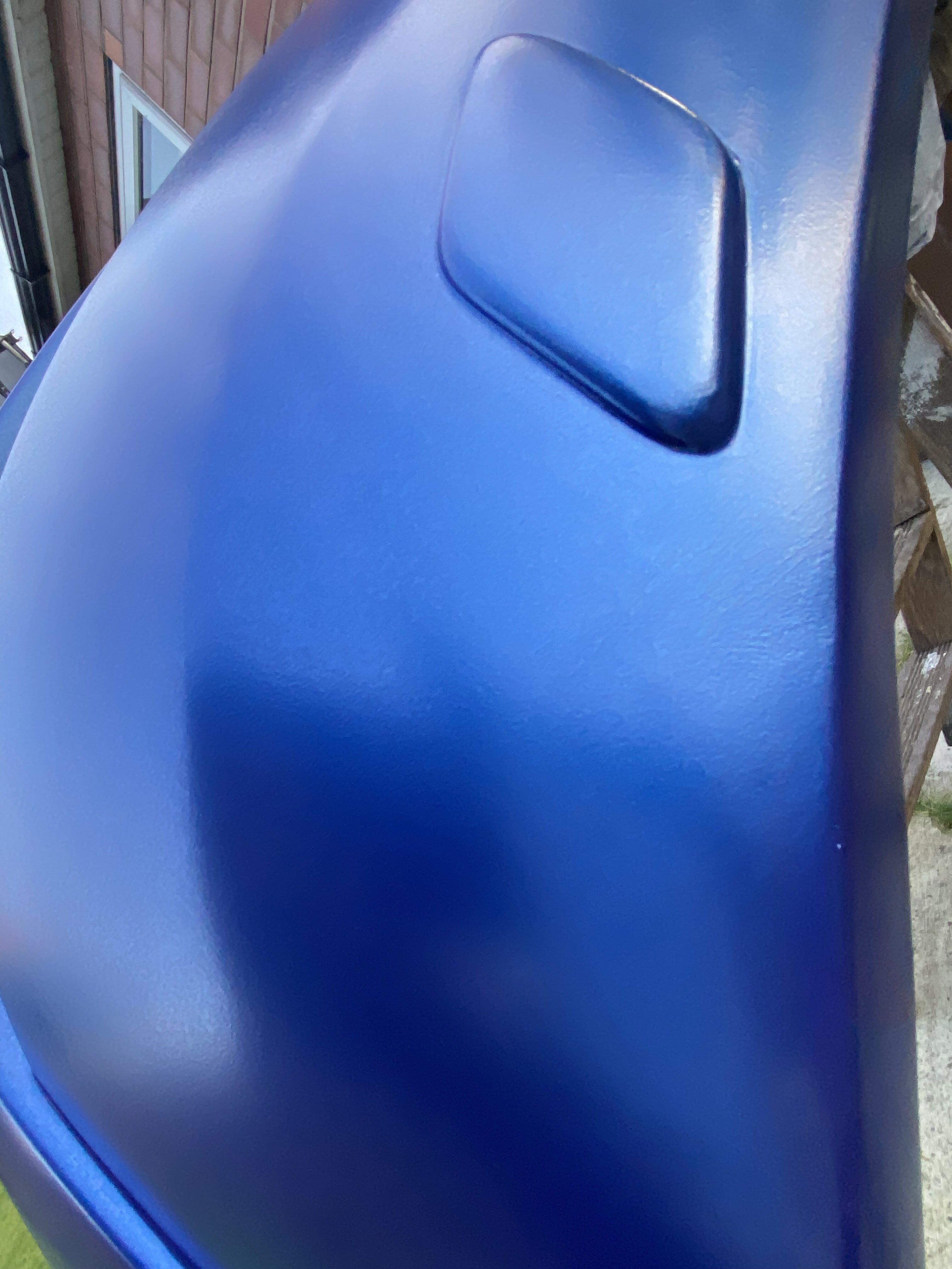

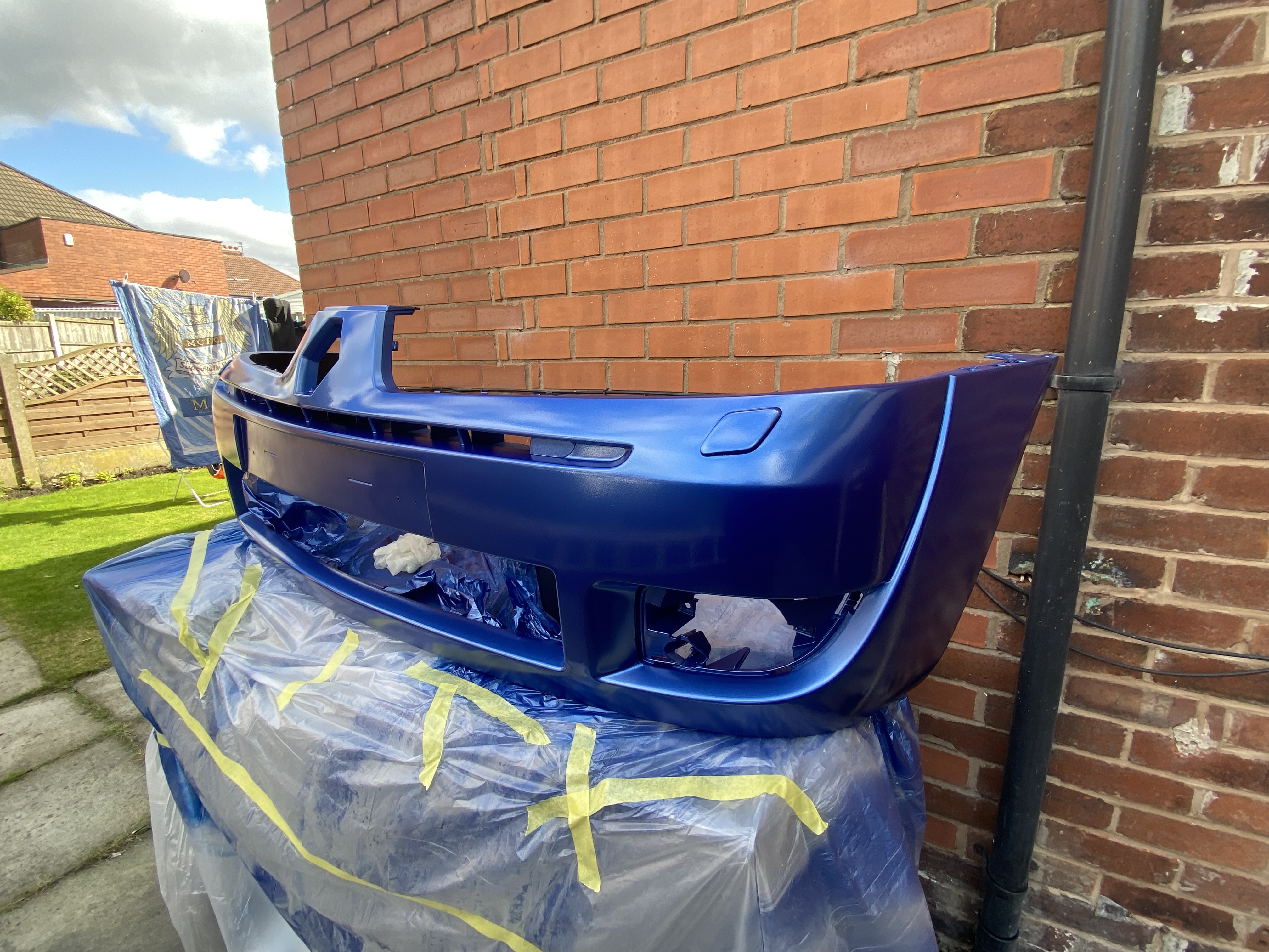

With the weather being okay and no breeze it’s perfect for spraying outside, which is okay since I don’t have a spray booth! I’m going to put the fourth coat of blue on and then after about 40 minutes I’ll be putting on the clear coat. I’m really not looking forward to doing that. Let’s see what the results turn out like…
Really hated doing this outside. As has been said many times there’s no way to get a pro finish with rattle cans in the back garden. I’ve just applied one dust coating of the 2K and then after 10 mins another coat. I followed that with another 10 minute wait and then went for a ‘wetter’ coat, holding the can much closer to the bumper. It needs to dry fully before I move it. I can see some imperfections in the bumper itself but had you seen before I worked on it you’d have thought I had found it in the local tip!
I’m glad it’s over. Hopefully it’ll dry well and I can buff out any bits that the wet paint has picked up, although there aren’t many I can see. I have also ordered two new black stickers that go on the bumper.

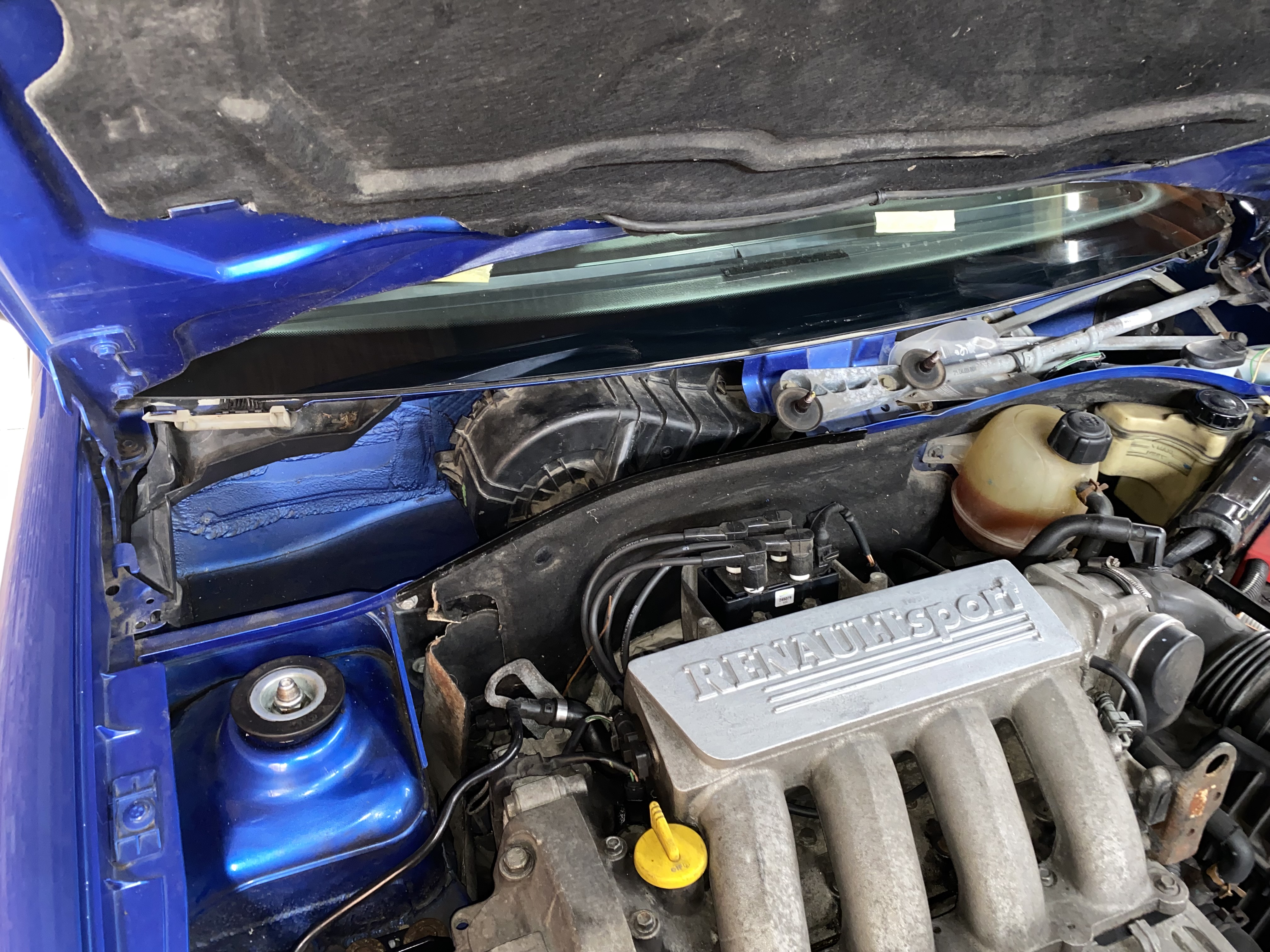

Next stop, whilst I’m waiting for that 2K to go off, is to get the wiper arms off and give them a spray up. The scuttle panel was off last year when I did the blower, possibly one of the worst jobs you can do on these cars, so everything came off okay. I’ve heard a lot about the scuttle drain but I couldn’t see anything apart from this large hole which goes under the car. Is this the one that you have to make sure it’s clear or it floods the inside of the car?
