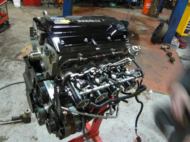

I decided this was a great opportunity to make a fresh Forged ITB F7R lump. So i set about a long project of fully rebuilding the current and putting the ITBs on it with the ITB meganne F7R head from the cup engine, the cup engine only ran a standard bottom end though, hence i thought id build a nice shiny fresh one. Using the old forged pistons from the hybrid lump with new piston rings.
The final spec came too.... (after many thousands of ££££)
- Rebuilt Meganne F7R Cylinder head, with de-lipped valves, all new stem seals and gaskets. Headwork carried out by Craig @APD (not FULLY worked though).
- Catcam GOLD uprated Springs and Retainers
- Catcam 5502320 (11.75mm x 278 degree)
- Catcam TruLock Pulleys + DTI setup
- Williams F7R bottom end, rebuilt.
- Forged H/C JE Pistons 11.2:1 CR
- Forged Rods
- ALl new gaskets and seals.
- New ACL/Glyco, main end, big end bearings, thrust bearings
- CYlinder block rehone
- New JE Proseal Piston rings (Gapped by craig @ APD)
Jenvey 45mm Parralell DCOE ITB's
90mm Air Horns
Fibreglass air filter backplate
Webber FPR
Custom fuel rail
SHort Chadil Inlet Mnaifoldm fully port matched to the cylinder head.
289cc New SIemens injectors
VEMS stanalone management system and a completely homeade loom by myself.
Custom alloy low profile radiator and compact fan.
