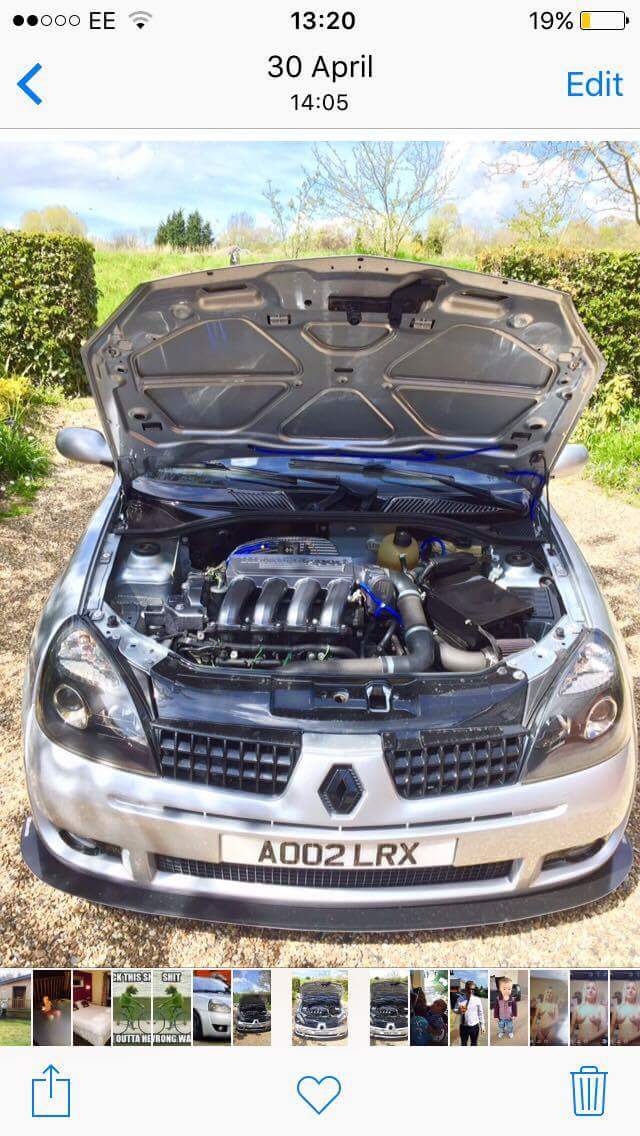

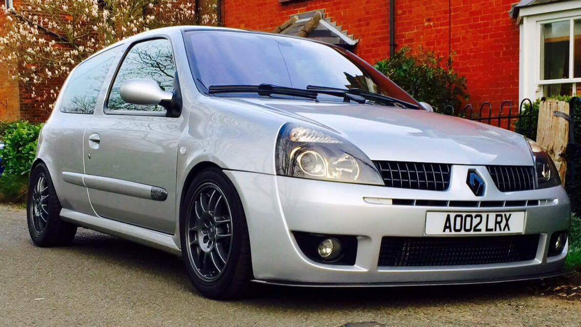

Hello,

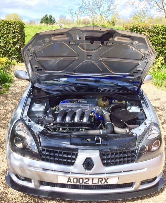

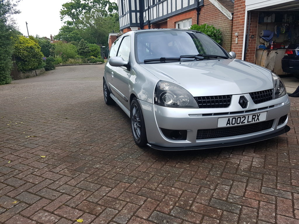

Just signed up to be a paid member and just become the owner of a Clio 172 turbo, pretty decent spec and main focus will be fast road/ track use.
This is the spec i have found put up by a previous owner:
Clio 172 low boost turbo
T28 / T25 Hybrid Turbo Charger
Forge dv
Turbo Oil Feed pipe
Turbo Oil Drain Pipe
Turbo Exhaust Manifold
Turbo Exhaust Downpipe Kit
Turbo Intercooler kit with Black Alloy Pipes / silicone hoses
K&N Air Filter with AEM FIC ECU and Custom file for OEM ECU
Larger Fuel Injectors
High Volume Fuel Pump
Alloy Turbo Heatshield
Ktec solid engine mounts with uprated gearbox dogbone mount
Aircon delete kit
Carbon cannister deleted
Cambelt, depasher pulley and aux belt was done at same time as turbo conversion. Conversion was done at 68k.
Had new power steering pump and water pump as well.
Ktec coilovers
Ktec 2.5" bore exhaust system
Drilled and grooved disc's on front with mintex pads all round
Polybushed anti roll bar bushes
Corbeau bucket seats
Sparco 4 point harness's
Omp deep dish steering wheel
Flocked dash with boost gauages custom made in centre consol
Suede gear gaitor
Cup spoiler painted in vw united grey along with roof
Rear wiper delete with gloss black blanking plate
Gloss black scuttle panel
Gloss black fuse cover and battery cover in engine bay
All bumper trims/grills gloss black
Cm composites splitter
Slightly tinted front headlights, properly done out of the gun(tinted 2k lacquer) no rattle can paint on this car at all!
Custom side bullet trims
Running 232 bhp and 237 torque with print out,
Plans are to look at suspension and geo set ups then just use it really, need to find out the best plugs/oil that are reccomended for these, i have emailed Engine dynamics but no response as of yet.

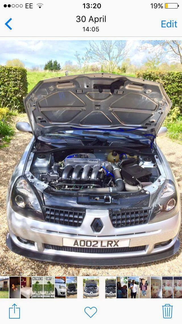

  172 LB Clio
Yes its an Engine Dynamics kit, I drove a clioturbo 182 before this and the engine dynamics kit seems to blow this one out of the water, might just have been the car but te power delivery is lovely
  RB Clio 182
Thats weird because clioturbo use proper garrett units and adapteonic ecu's, unless it was the new style module low boost version that efi use.

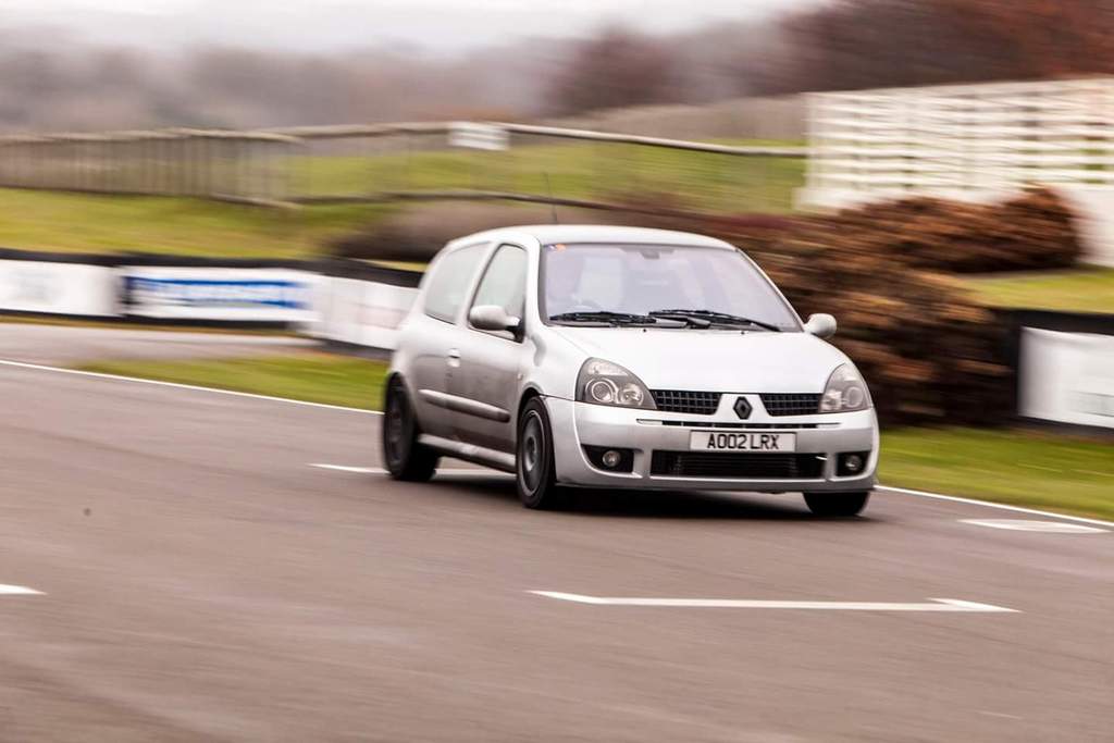

Small update:
Trackday went well, didn't get a huge amount of track time due to weather etc but was a good shakedown of what the car could do. The one thing that was apparent was the need for a LSD. Mid-corner in cold damp conditions I was constantly battling with one wheel spinning and where there is very little lag trying to modulate the throttle to reduce the wheels spinning was proving difficult.
I ditched the ktec coilovers for a brand new set of cup shocks and grams springs and they feel alot better on the road. They are still stiff but if feels like the dampers are doing something now as before they were a bit crashy. And I have bought a heel and toe accelertor pedal I need to fit soon.

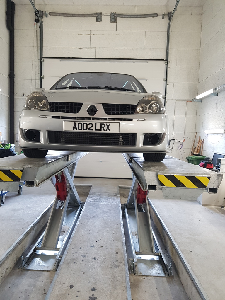

I am taking the car to EFI Parts this coming Thursday to get the map tweaked and a few bits added; and then the next few weeks I will remove the gearbox and fit a M-factory Diff an get the gearbox inspected and replace what it needs. I want to buy a cage at the same time as this so when the box comes back it is ready to go. Unsure of what cage I want yet but I'm thinking a full cage through dash is my best bet. As the cost is not a huge amount more for a full cage.
I also am going to get a PMS shifter and a flat steering wheel to replace the dished omp as I feel a flatter wheel will be more comfortable.

Went to EFI yesterday. Chris was awesome, car was running 215bhp to start with as Chris said the fuelling had been tweaked after 5.5k to drop all of the power off. He did a bit of fettling and it is up to 232bhp with decent power all the way to redline. Not that it needs any more power but it feels alot smoother.

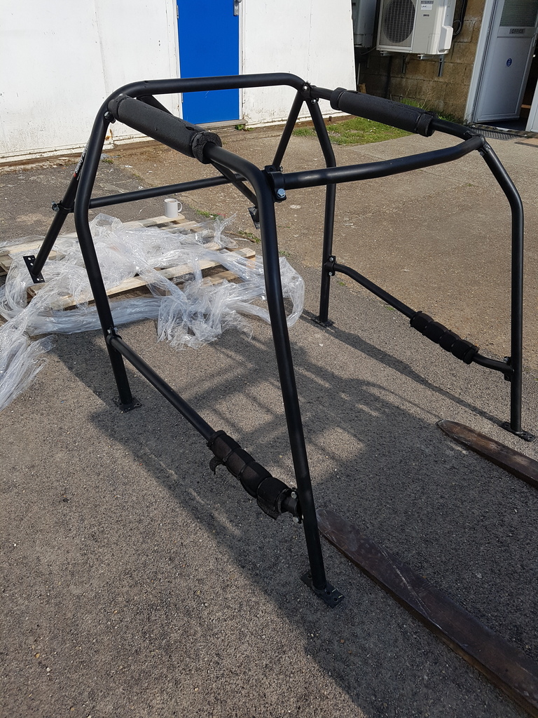

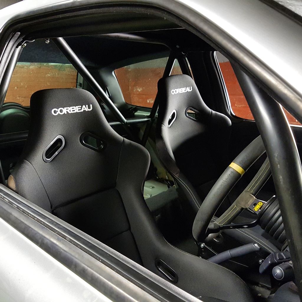

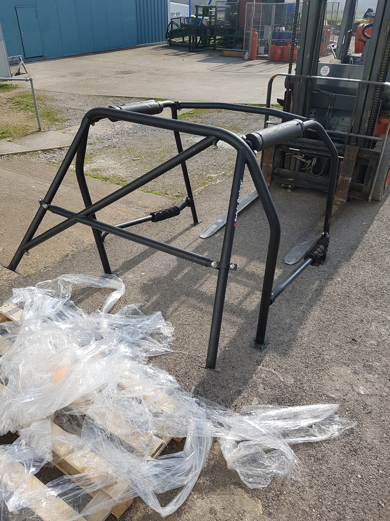

I have purchased a safety devices full cage (dash dodger) and will be fitting in the next coming weeks hopefully. Just need to get some footplates welded to the car.
And I also ditched the seat runners as they were pretty bodged together! Will be glad when the cage is in and I can get the harnesses mounted more safely!
  172 LB Clio
So I have been busy with the clio over the last month.

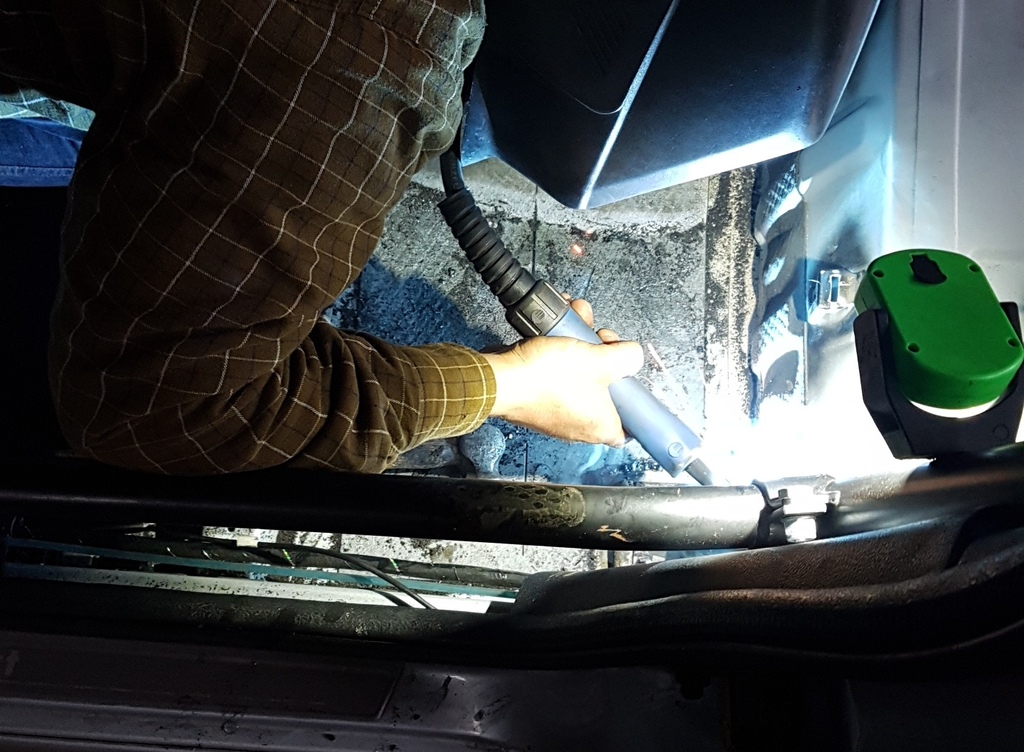

Just after purchasing the roll cage I put a wanted post for an LSD gearbox, this was my last effort sourcing one before sending my own box away to be refurbished and a quaife/m-factory diff fitted. I managed to get hold of a freshly rebuilt phase 1 gearbox with a quaife lsd fitted, also managed to purchase a rear anti roll bar, as new clutch and some dynamat sound insulation.

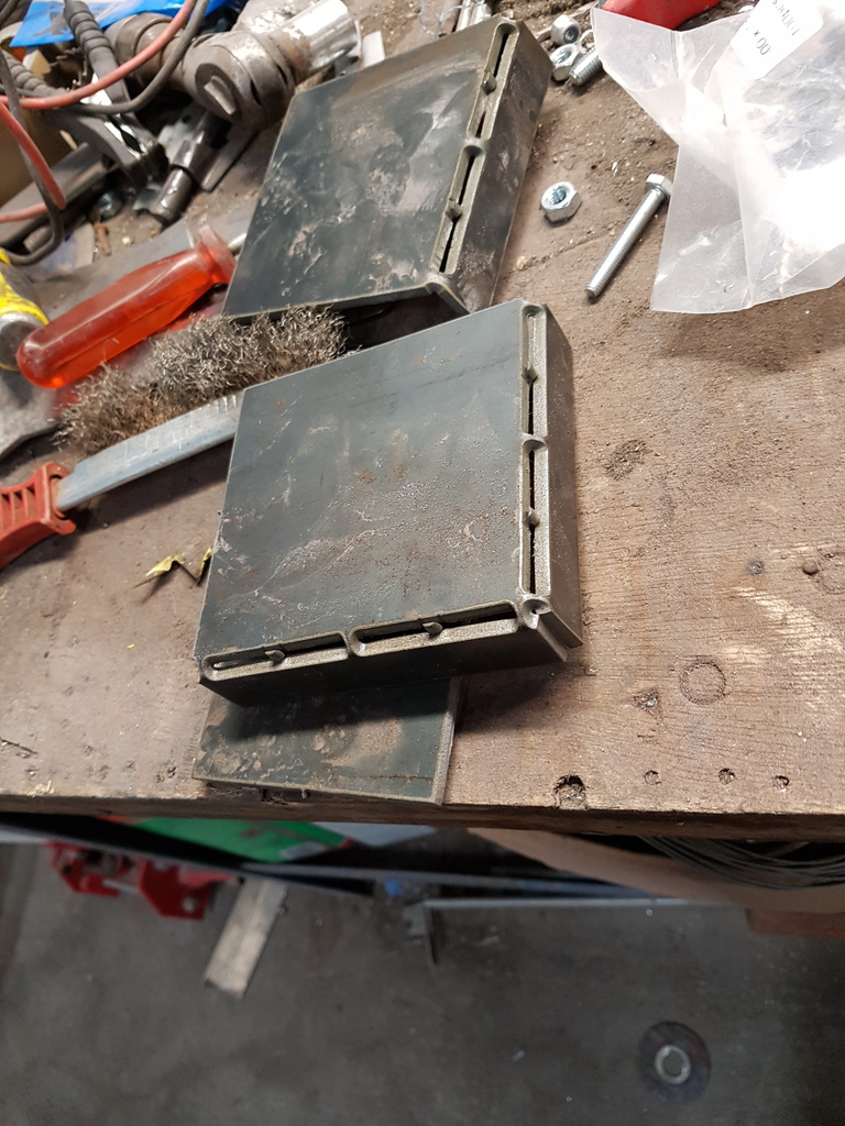

The roll cage is pretty much complete now, I had to make some base plates up and had a good friend weld them in for me. We managed to retain the rear doorcards and not hack too much of the interior to pieces as I didn't want to strip it completely.

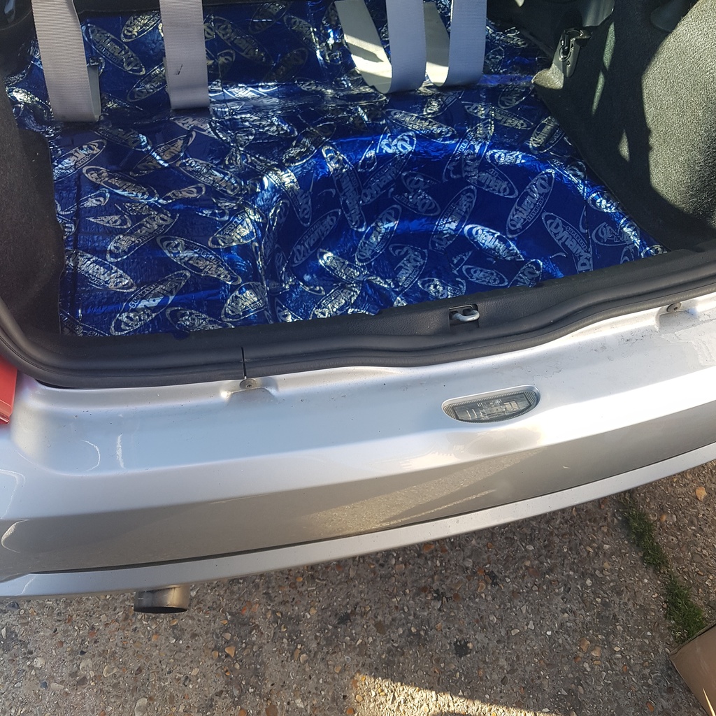

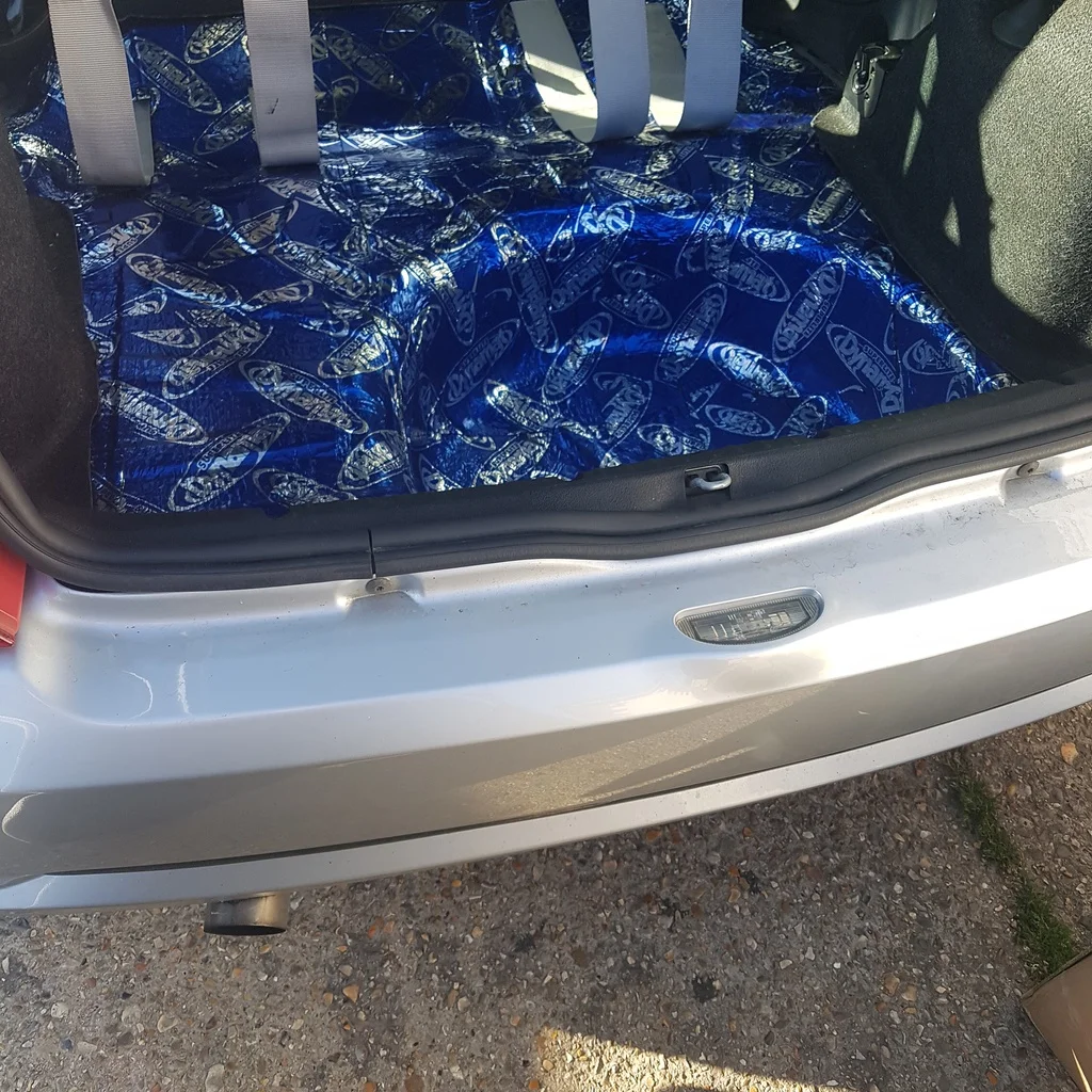

I have dynamatted the rear wheel well and rear of vehicle. It has done really well to dull the exhaust noise in the cabin, I am tempted to get some extra panels to do the inside of the boot itself.
