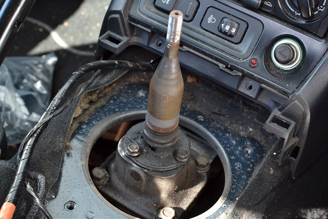

Changed the shift boots on this today, what a difference that's made!
I think its recommended to do when they get older and with this now approaching 100,000 miles i went for it, only took me an hour to do.
mid-way through taking them off

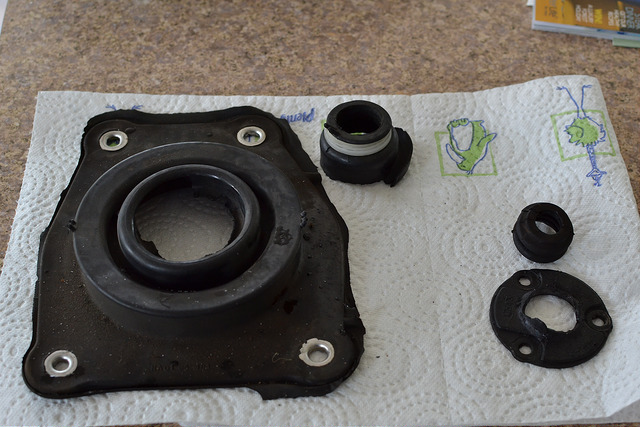

The old boots were completely ripped around the middle and in 2 pieces.
Put some fresh oil in the turret and replaced the small nylon cup these have at the base of the gear stick and put it all back together. The shift has improved quite a lot. Its noticeably tighter and better to use.

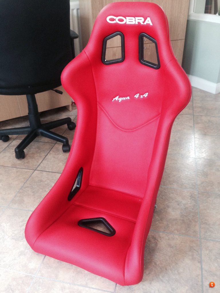

Dude, you could have had a full leather OEM interior for the price of that seat!
Of course, that would mean less scene points ;)
Euan94
  Volvo C30
Yeah that wouldn't do any good for my JDMness.
I have bought this for the right reasons though as I tend to find myself bracing to stop me sliding about.

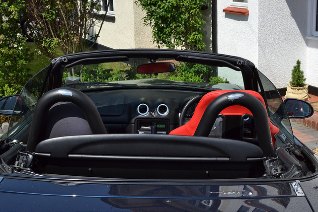

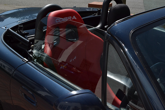

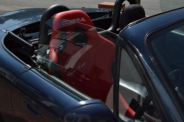

So the seat eventually got fitted a couple of weeks ago, I tried to mount them on the sliders from the original seat but once mounted it was sitting far too high so I plumped for some mx5 specific floor mounts.
Very happy with it, and its not that uncomfortable, did nearly 3 hours non stop and wasn't crippled when i got out.
Anyway, some terrible photos for the moment, which also highlight the plastidip coming away on the roll bar.
