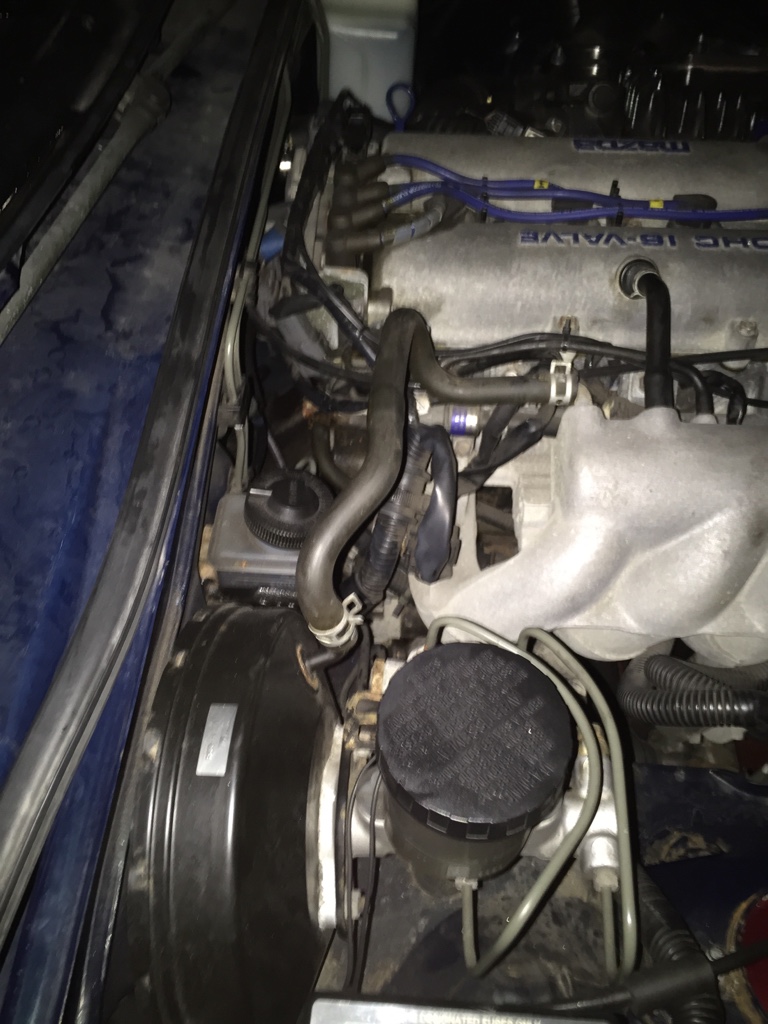

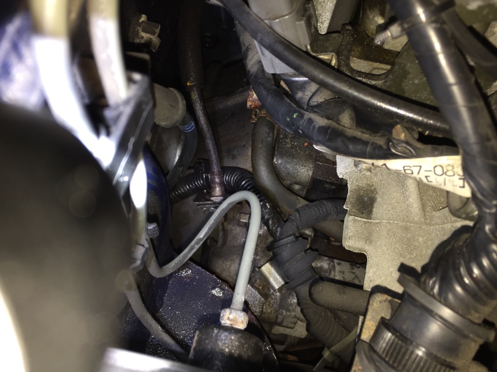

I've just got a couple of pictures. It's the other side on the inlet side unfortunately. Not sure which hose I need but I would like to get one asap and then change to silicone in the near future.

Try the picture again. The first shows the hose itself, doing a 90 degree bend. The second shows the area where the hose is behind the inlet manifold.

So it turns out lots of people describe the changing off this hose as the most awkward job you can do on a 5!
You can either remove the inlet manifold, which is apparently an absolute arse of a job, but gets you access to the pipe
Or go in from the underneath but still have no space to work.
Still, replacement hoses and jubilee clips coming tomorrow and then I can attack it with desperation to drive the car. I may result to using a borescope from work to help though!

So the hose is on, was a right pain but just went in from the top and used some locking long nose pliers and didn't need to take the inlet manifold off thankfully. I'll fill the system tomorrow and then go for a drive!
