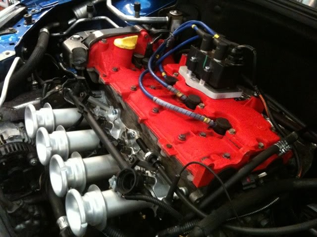

Thought id start a little project thread, somewhee to add all the little bits i have done, and will do to the car. I have no major plans at the moment, but i didnt with my last car and it ended up like this...

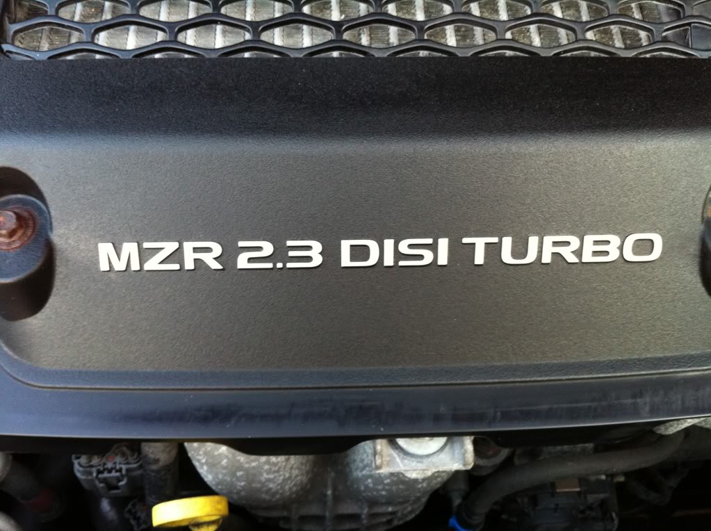

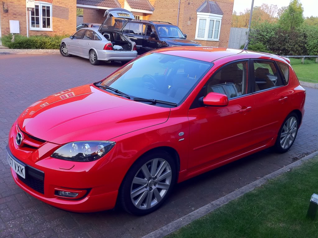

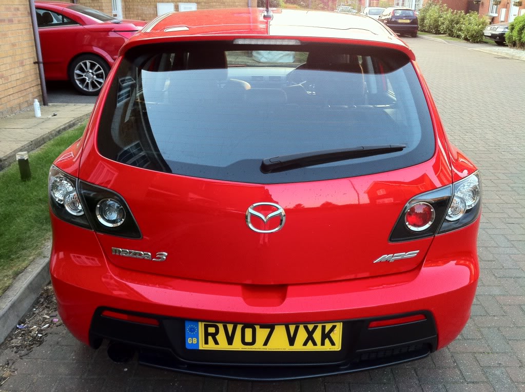

So my car as i picked her up!
In great condition, with just over 50k on the clock, 1 owner from new and full Mazda main dealer service history.

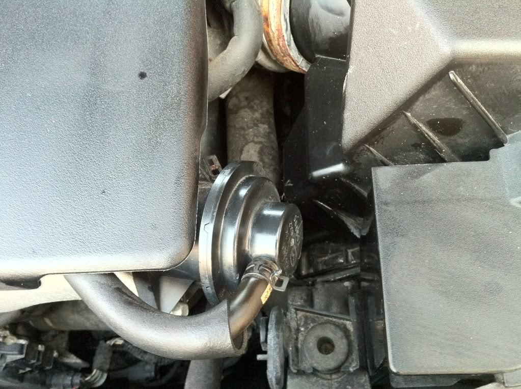

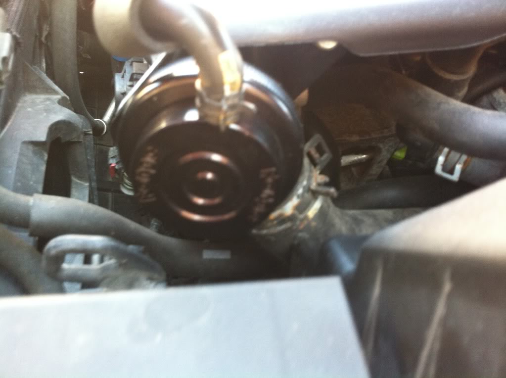

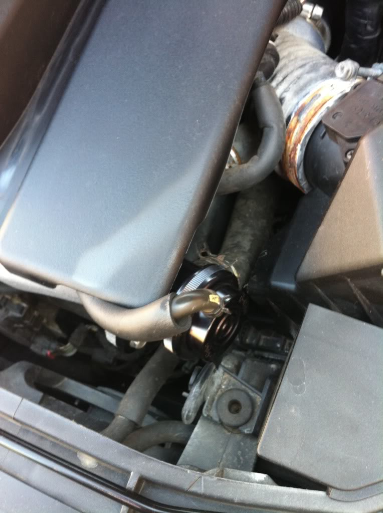

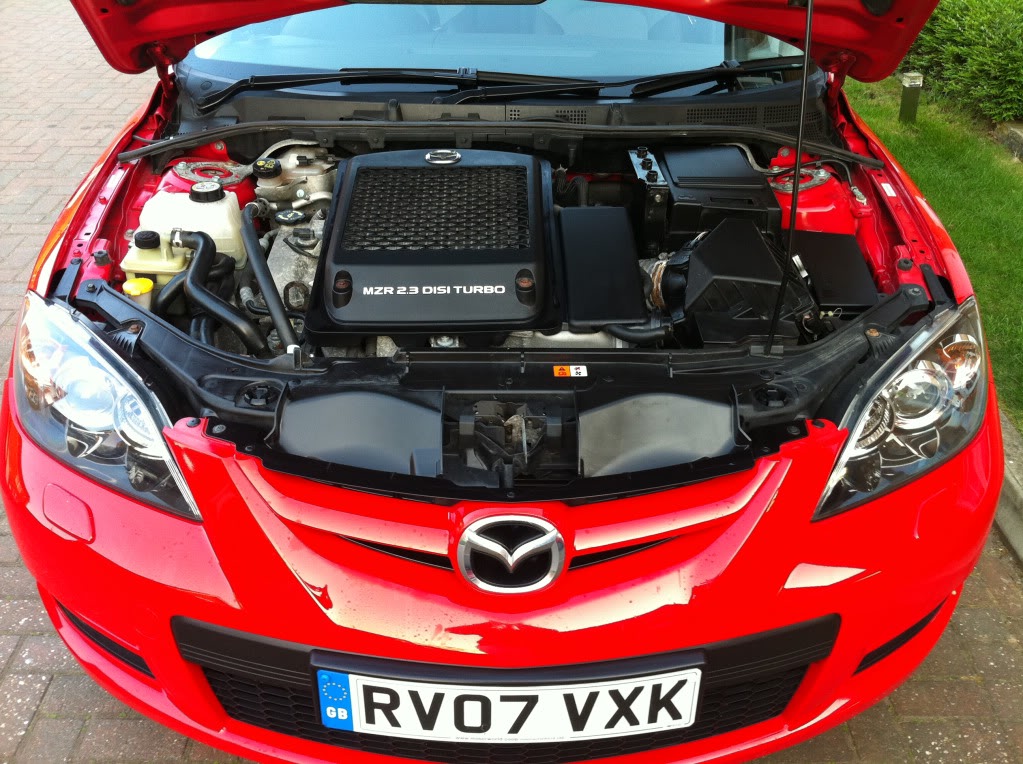

I managed to get a forge valve from a lad on MPSowners.co.uk for £40, so fitted that too.
Before:
After:
To be honest, other than being shiny i cant feel any real difference and the sound is still the same as it was. The only time I've noticed a slight noise from it is if i build boost in 4th, and then let off and its gives a "ping" type noise. But i guess its serviceable and more reliable.

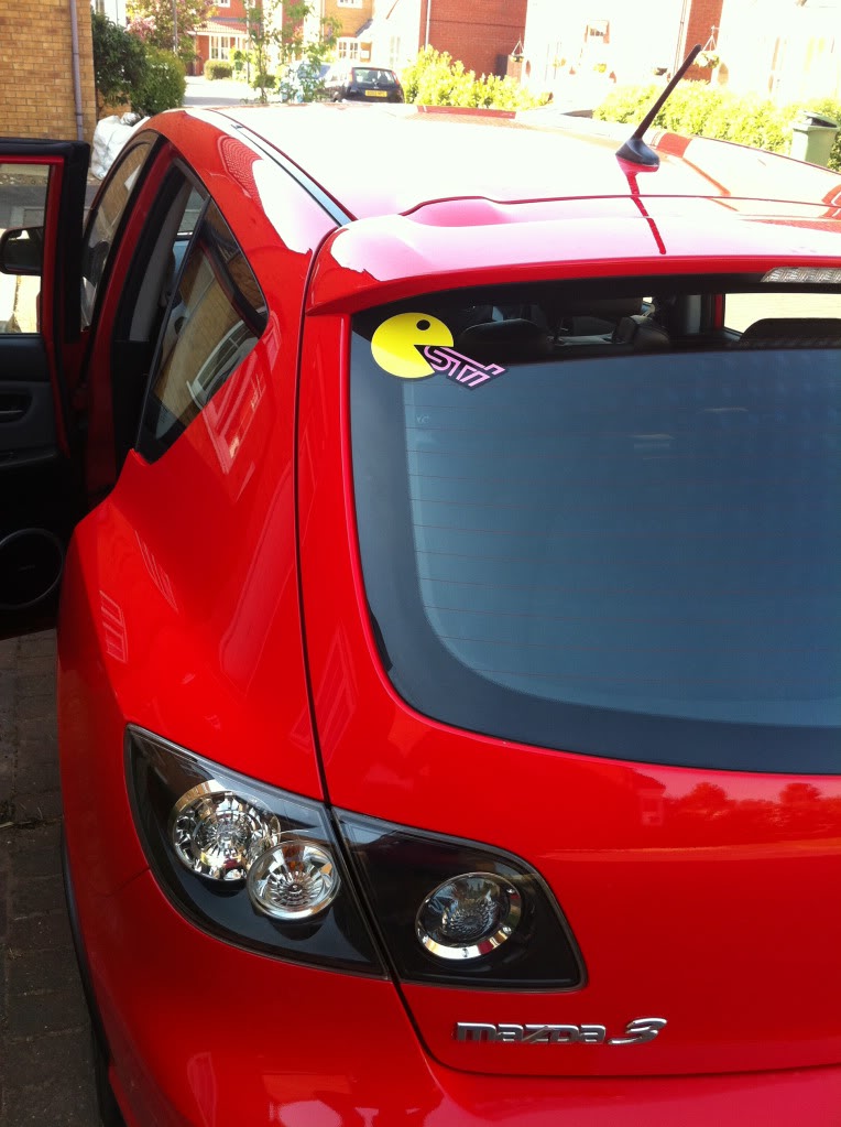

And after a play around with my mate in his 05' STI, i fitted this!

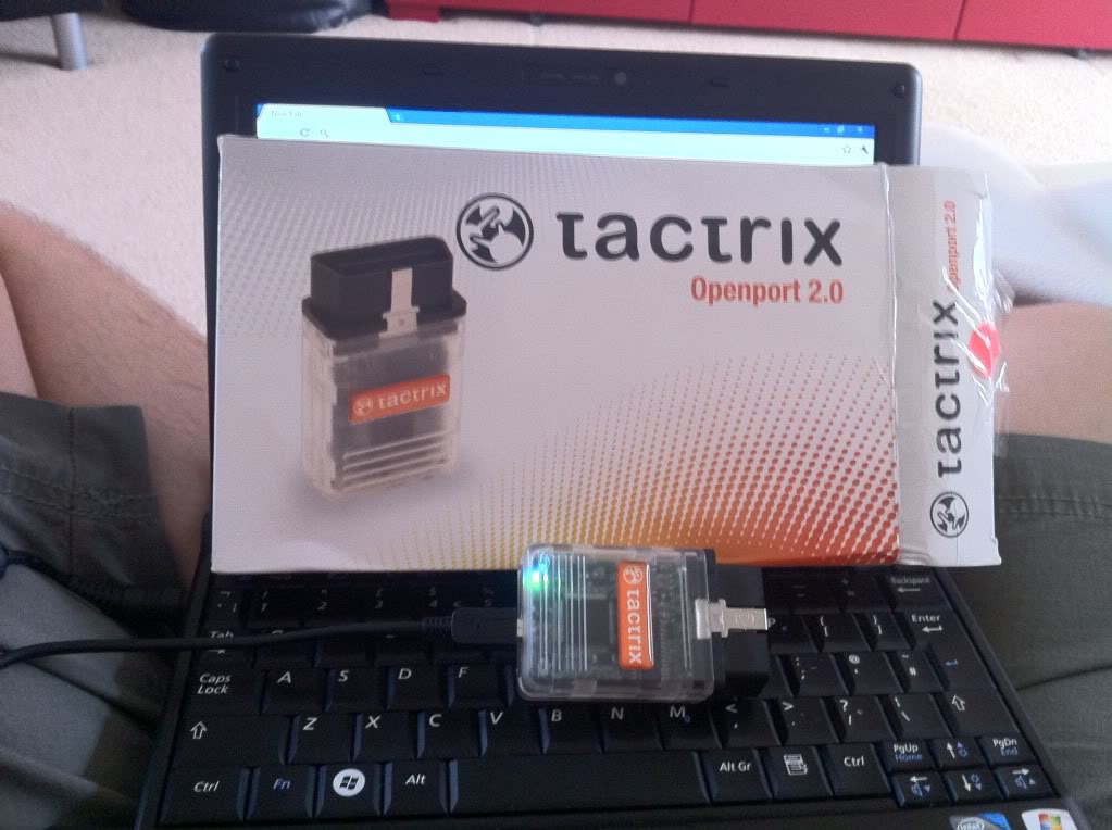

I have ordered a few bits too, one of which arrived today from the USA, i ordered it on monday, delivered today, immense!
For use with the Versa-tuner software once it is released, allowing me to map the car as and when i choose, also has downloadable maps published by other users so quite cool!

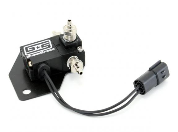

The final part Im waiting for from the USA is a Grimmspeed BCS, that i will initially use in two port mode, and then get the car mapped in interrupt mode to reduce waste gate duty cycles, and get the boost on faster!

Recirc valve will help more once car is mapped. On the Megane it supposedly helps improve throttle response with Stage 2.
That just sounds dangerous, purely as people, like me, would just wind the boost right up. Then. BANG. Just like the 90's with bleed valves on R5 GTT & ERST/FRST's lol ...
The software won allow any dangerous, or potentially dangerous settings to be used, it still keeps the factory over boost parameters etc, and monitors the AFR to ensure you don't do anything too stupid! The most dangerous bit would be to fit the boost controller i have bought in interrupt mode with no tuning, would kill its self and over boost massively!

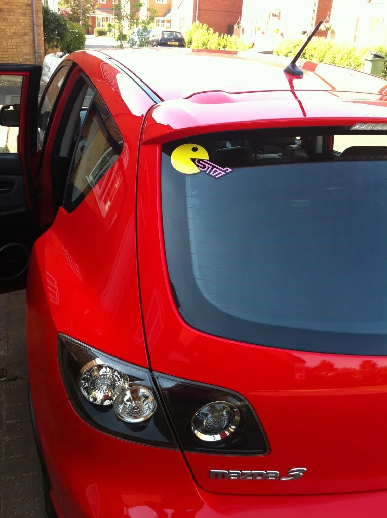

been for a little blat with my mate in his R32 again, hehehe, upsets him a lot lol
