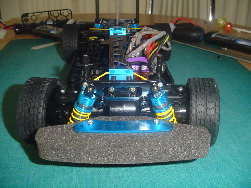

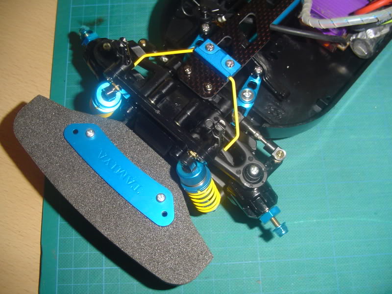

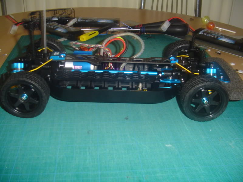

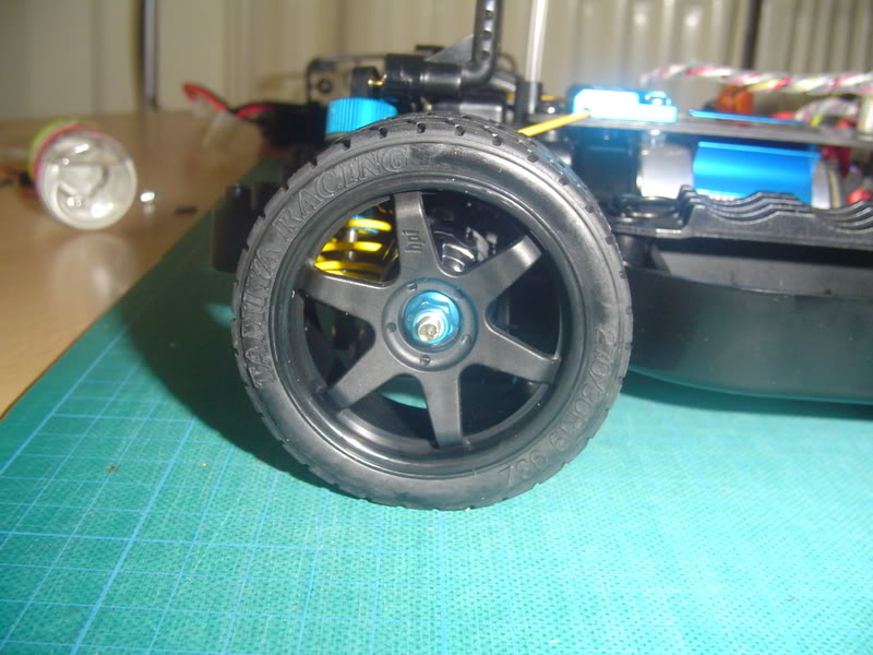

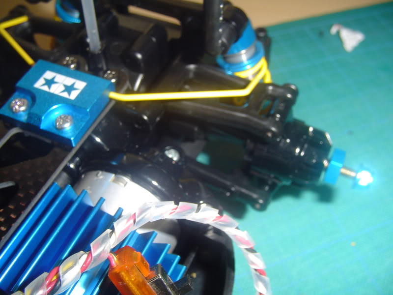

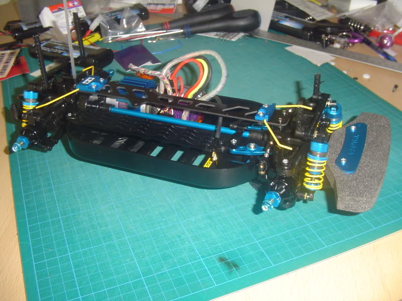

Unfortunately its in radio controlled form. Its a Tamiya TT01, which is pretty much the most BASIC R/C 4wd touring car on the market and costs about £79.99 in kit form.

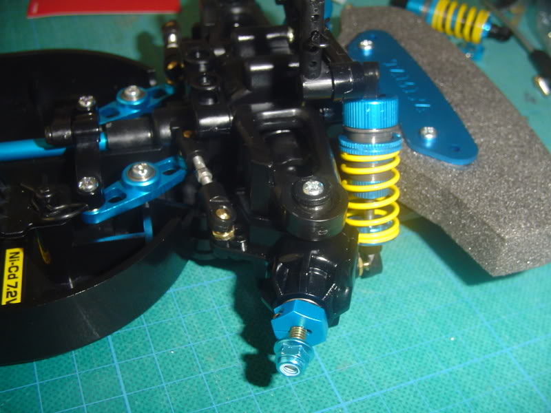

Now I used to be really into R/C cars (I mean really, went round the uK racing etc etc) But quit to fund my modified real car (biggest mistake ever) However, now I'm a bit better off, and not modding real cars I've started again. Like I said, I started with the most basic touring car you can get however, Theres a twist. Imagine taking a 1.0 VW Lupo, putting top of the range coilovers and top of the range drive shafts and bullet proofing the drivetrain. Imagine then getting the chassis stiffened up (in the case carbon fibre upper decks and front and rear suspension stabilisers. Imagine then putting in making EVERYTHING adjustable, So you can adjust the camber and toe in/out at all for corners, and then put in some top of the range LSD's.
All this is for a reason. Imagine in this same race prepped Lupo, you are putting in an engine out of a Porsche Carrera GT. Even people on the R/C forums think im a loon, and TBH I think my choice of motor is a little OTT, but hey!
The Spec list is for anyone who is stlll reading is:
Tamiya TT-01 Turnbuckle Tie-Rod Set (TGS) #53662 TT01
Tamiya TT-01 Aluminum Racing Steering Set #53670 TT01
Tamiya TT-01 Aluminum Motor Heat Sink #53664 TT01 EVO
Tamiya Urethane Bumper Small (TT-01 , TGS) #51019 TT01
Tamiya Aluminum Bumper Stopper (TT-01, TGS) #53682 TT01
Tamiya TT-01R Front #3455877 & #3455878 Propeller Joint
Tamiya TT-01 Metal Motor Mount #53666 TT01
Tamiya TT-01 Ball Bearing Set #53497 TT01
Tamiya 4mm Aluminum Flange Lock Nuts (Blue) #53159
Tamiya TT-01 Aluminum Propeller Shaft #53620 TT01 Prop

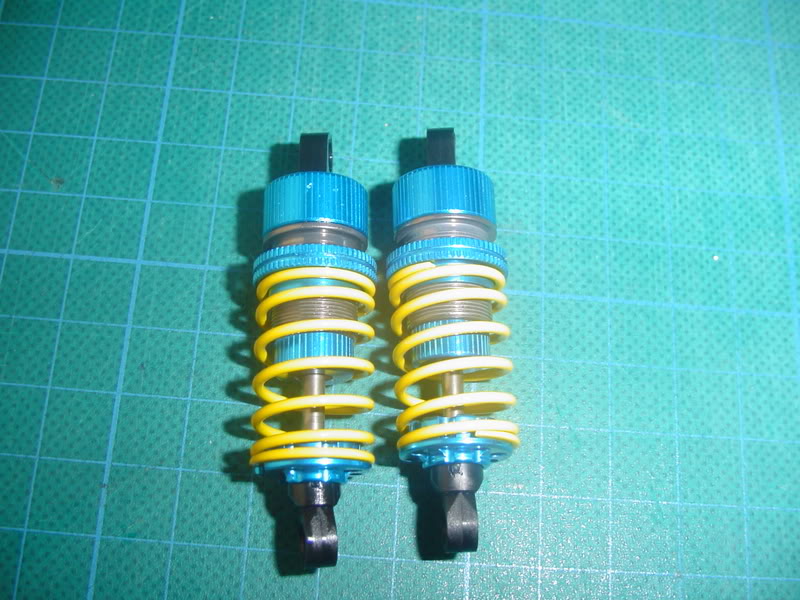

Tamiya Race Factory Low Friction Aluminum Damper Set (1 Pair) #53155
Tamiya Aluminum Damper Retainer (1mm Down Type) #53876
Tamiya TT-01 Stabilizer Set (Rear) #53695
Tamiya TT-01 Stabilizer Set (Front) #53694
Also not in pics is the adjustable upper arm set (still waiting for delivery, hence why stabiliser bars aren't bolted down, The LSD differential, and rear ball differential (I'm going to see how standard diffs hold up first) Tobee craft Aluminim drive shafts.
The motor/ESC combo is the real party piece, its a Novak GTB ESC and a Novak Velociti 5.5R Racing Brushless motor with sintered Rotor. This motor is rated at 7,400 rpm per volt, (I'm running 7.2 volt, so the motor is revving to over 50,000rpm :)
Oh and I've even got some "real" Volk TE37 rims on it :D
Pics of the shell later :)
