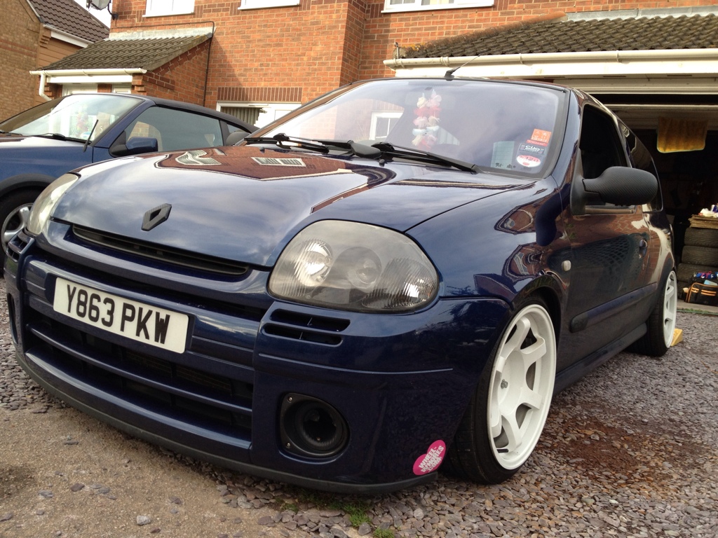

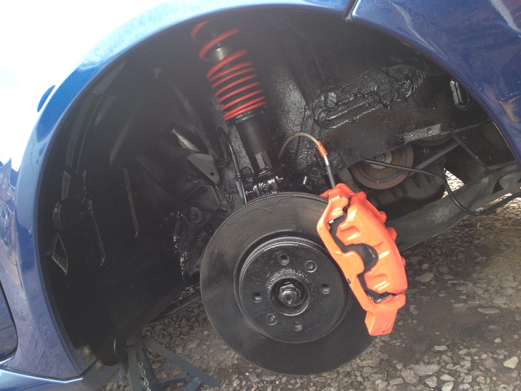

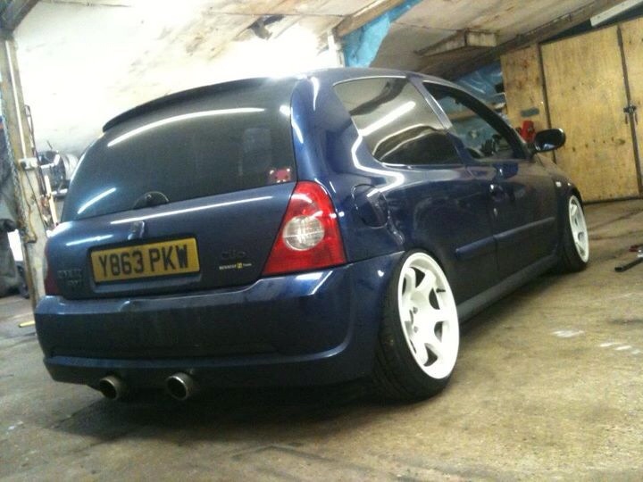

Played about with the coilies and rear springs and after alot of adjusting and wheels on n off a thousand times, It ended up like this, no scrubbidge. My thinking behind running it so low is to slow me down a bit as its so easy to get 'I'm a race driver' syndrome in these clios lol and I like my licence more than my sump lol :) It's the practicality over looking awesome argument. Anyways..one finished pic:
looking good mate looking good. bet your well happy. get some more pics up though from different angles.
Right, coilies finally turned up and here the results from last nights efforts:
Rear wasn't jacked up at all in this photo I promise ;):
Done:
Needs a major clean and need to nip the rear arches up a little for a bit more clearance, but quite chuffed with how it turned out :)

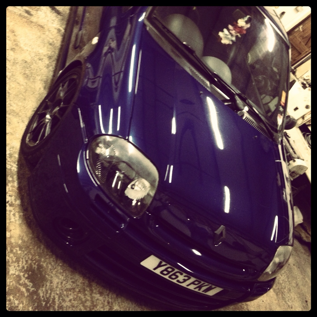

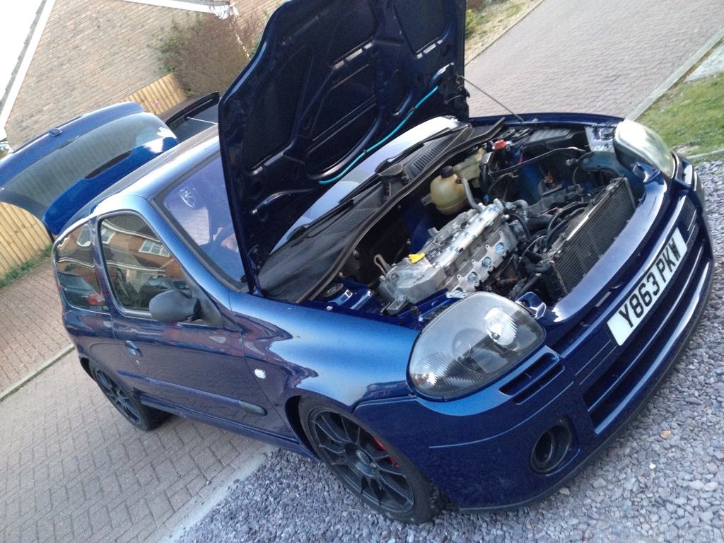

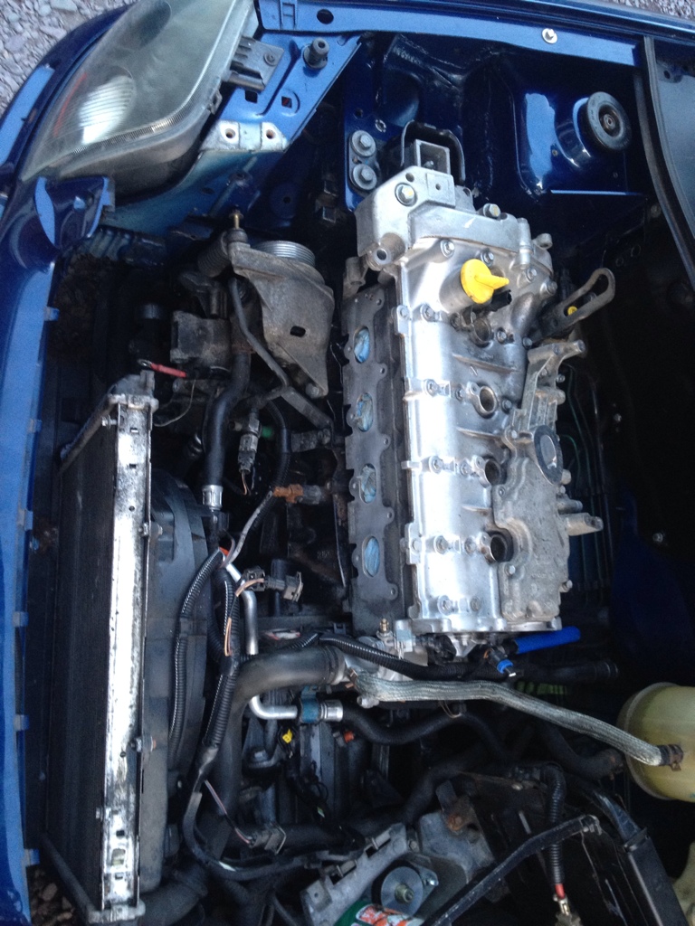

Haven't updated this in aages the clio has been off the road for a few months and I have bought a derv to roll around in, I am currently prepping the car for throttle bodies, rotas are tucked away awaiting a powdercoat, also sorting bits n bobs for MOT.
This is how the bay is looking at the moment removed the air con today and have ordered a pure Motorsport delete kit.
Also fitted 182 breather plate:
Freshened up the arches a bit:
Arty snap in the workshop:
aand how she sat after today:

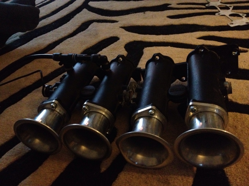

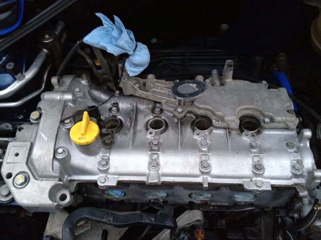

UPDATES -
Recieved these:

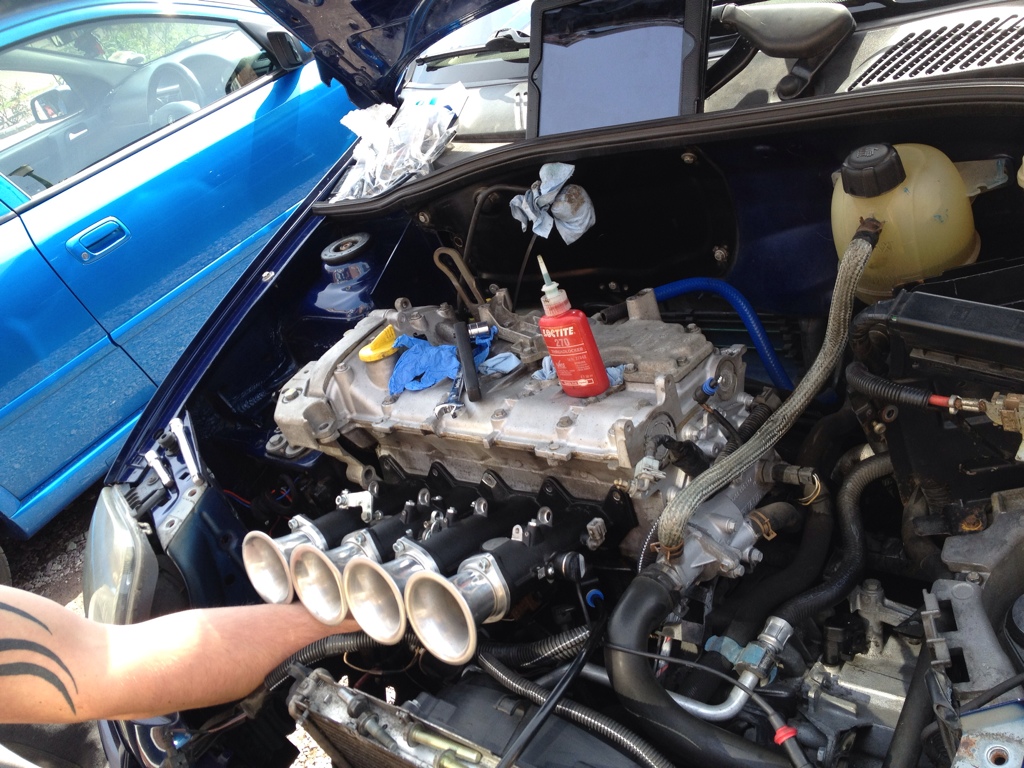

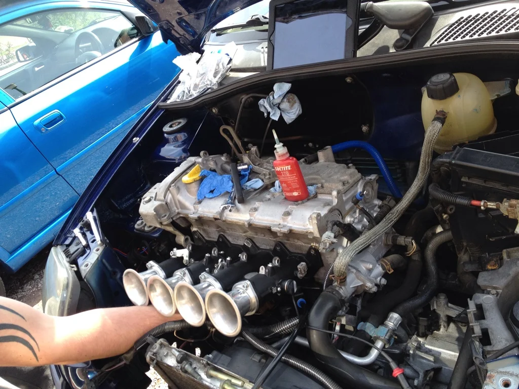

Today with muchos help from mates got to fitting them...
Trial fit:

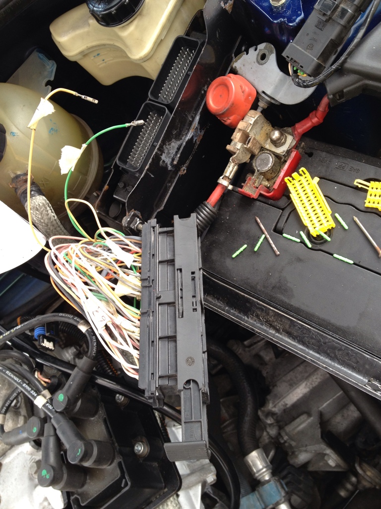

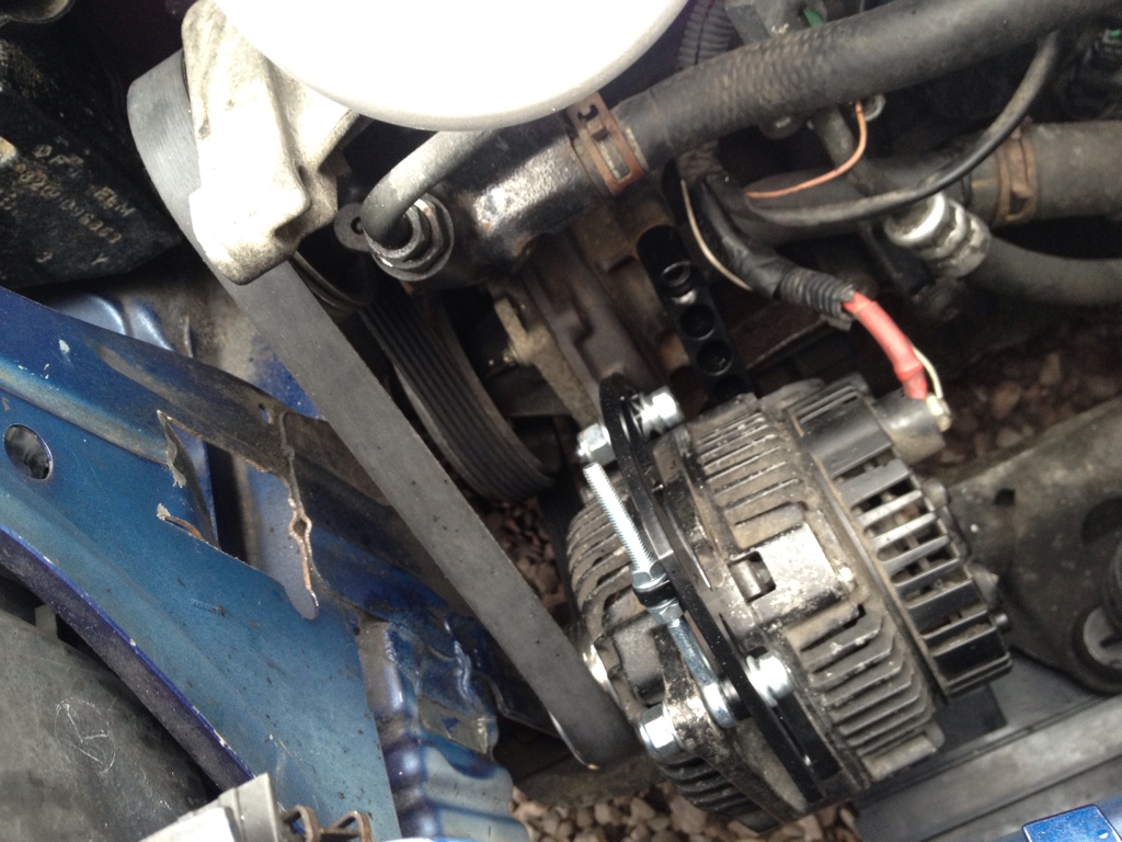

Then pure Motorsport delete kit fitted, very helpful quick service from these guys :)

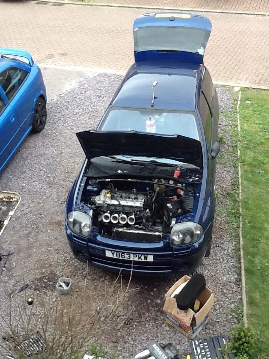

Got pretty much everything back together just need to get hold of a different tps sensor as this one is for a ph2 if anyone could shed any light on that I'm guessing Ktec? Also need to get hold of the mapping software & serial cable as it didn't come with the kit again Im guessing Ktec for that. Pics:
Thats it so far :)
Re: My Odyssey PH1 A Little Different..itbs fitted :)

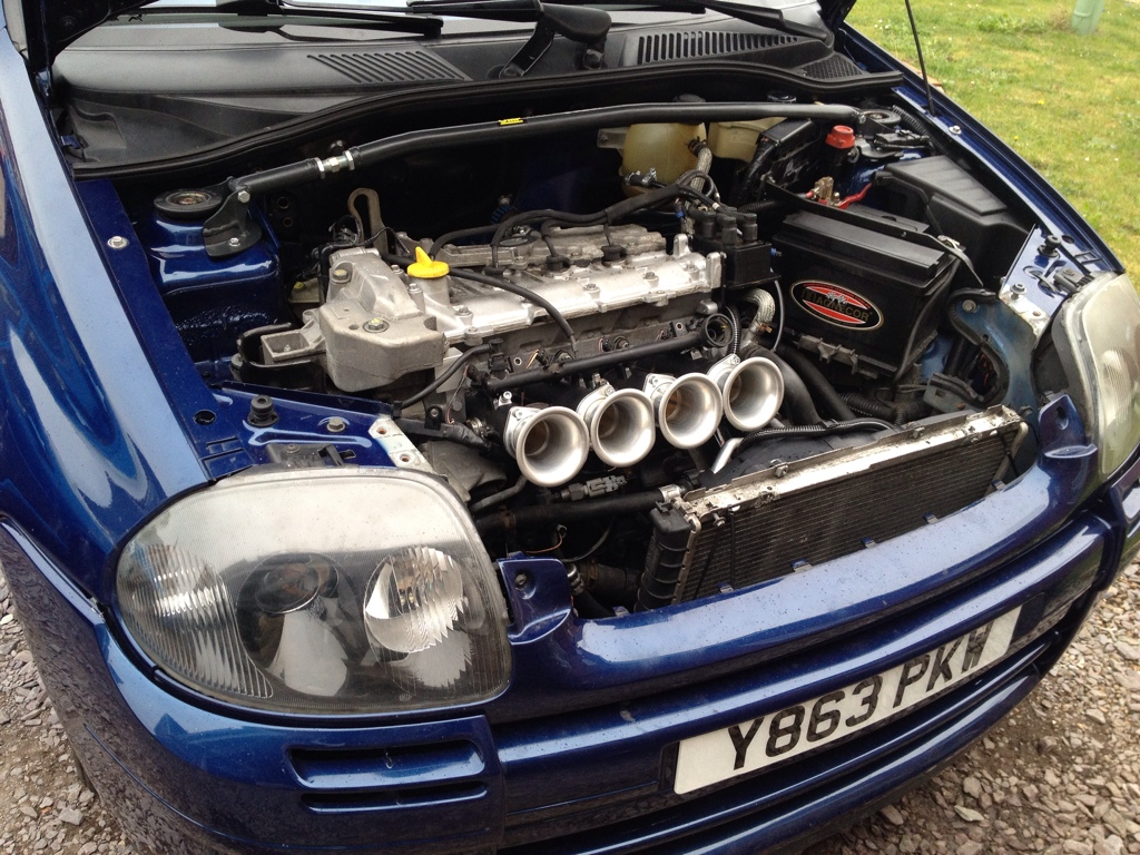

Another update :)
After speaking to a very helpful Sean from Ktec I re-wired the tps sensor into the oem loom and also made all the pin changes to the oem loom to match the gen90 ecu, so after a few hours fiddling about..
got everything ready to start the car so we tried it and it just kept cranking over, checked fuel and the pump wasn't priming on turn of the key so checked the ecu loom again had missed a pin swap so sorted that, tapped the fuel cut off and it primed again but still wouldn't start. This time there was no spark and worked out in the end the relays are screwed, but got it running for the first time sounds a bit rough but not far off :) once I've replaced the relays and refitted the ecu I will balance the bodies.

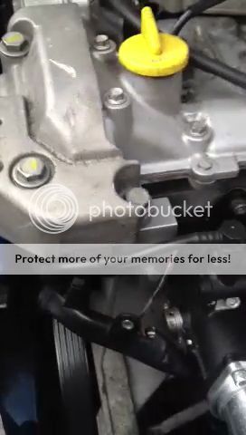

Quick vid of first run... :)
f9d9a7d8.mp4
