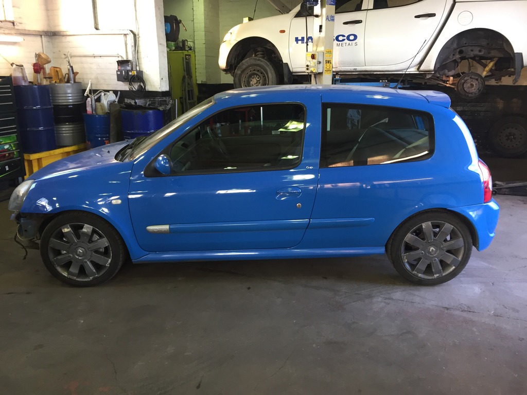

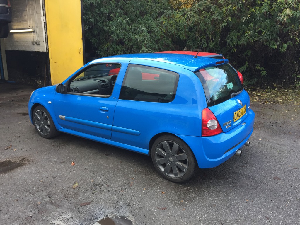

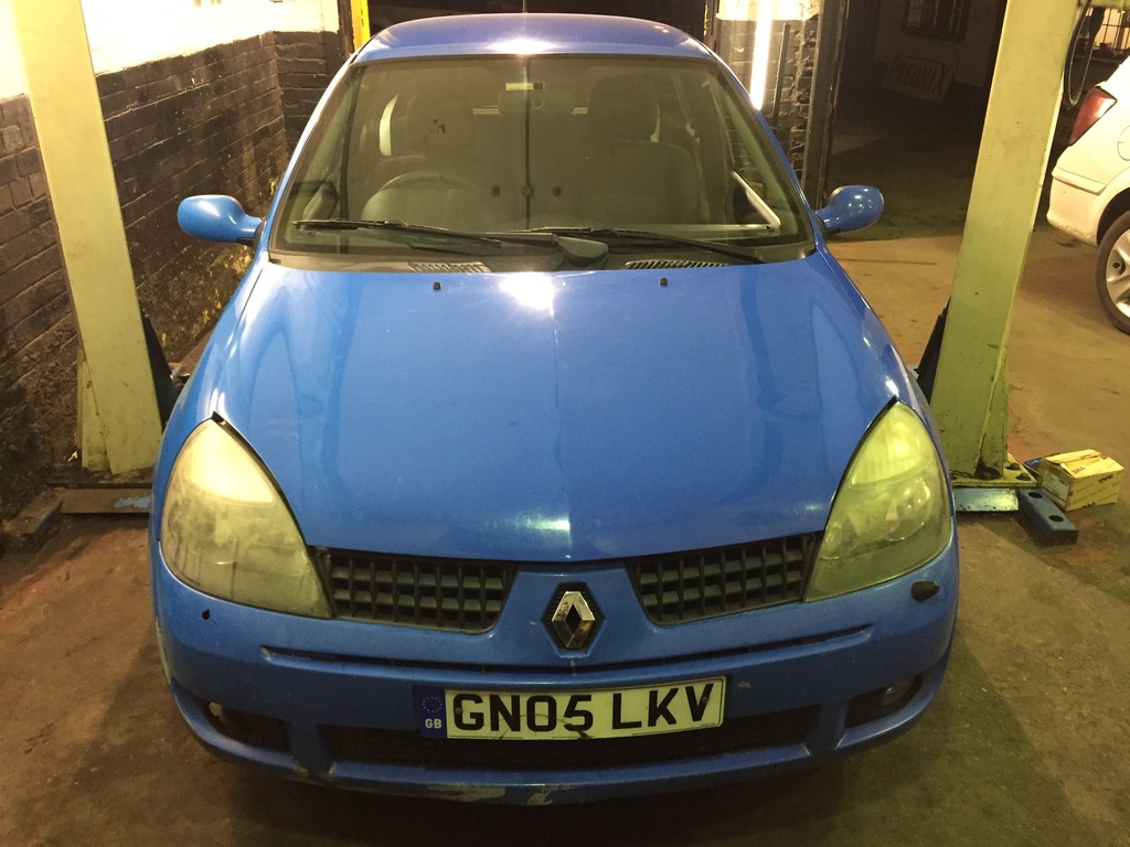

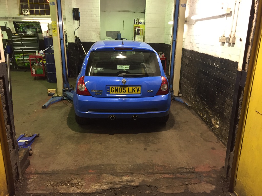

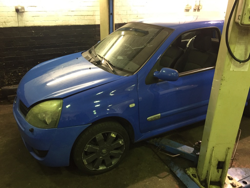

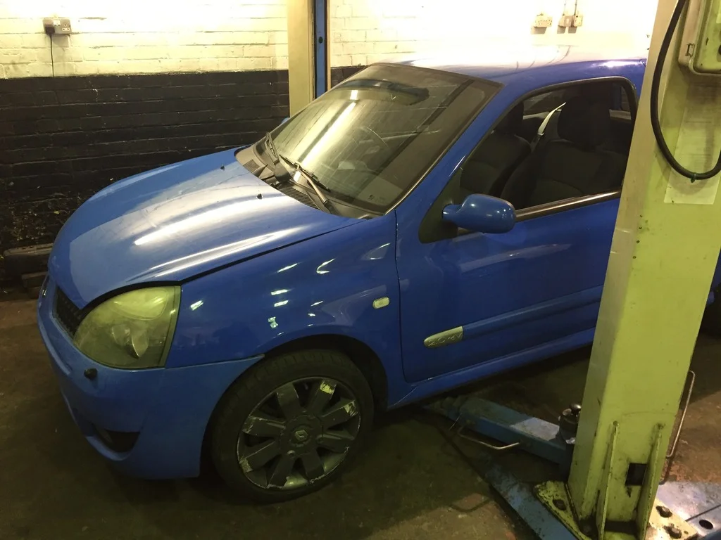

anyway onto the clio, this is how it looked as it arrived
pulled it in onto the ramp to have a check over
as you can see, not mint, but other than the front bumper, wheels and headlights a straight enough looking car.

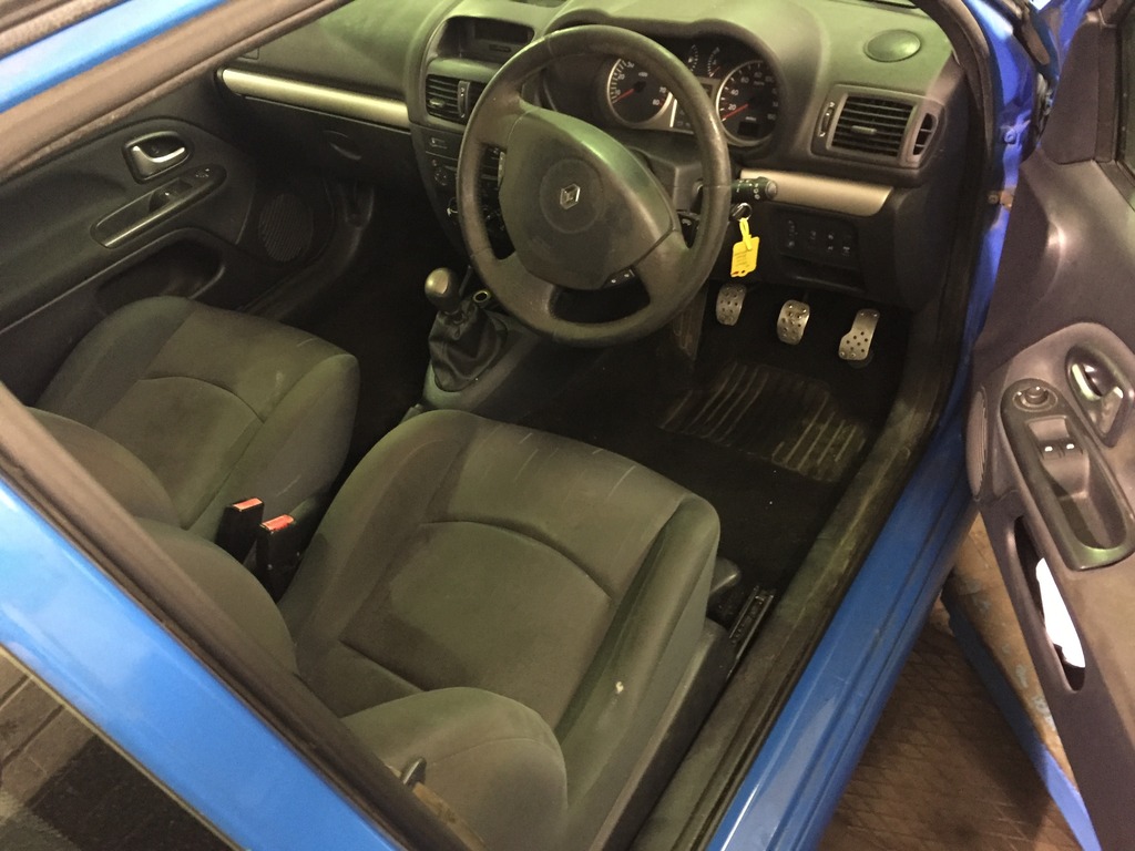

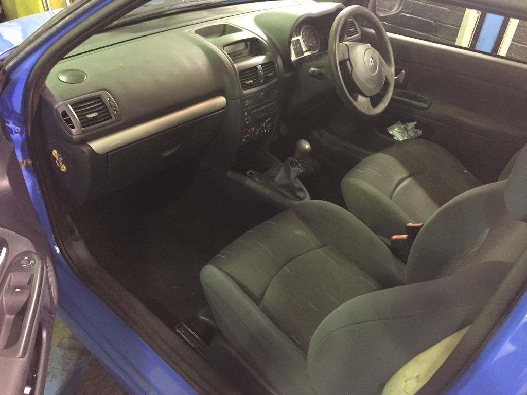

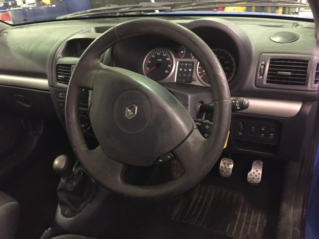

the interior how ever left a lot to be desired.
steering wheel which i can only presume has been in some kind of fire

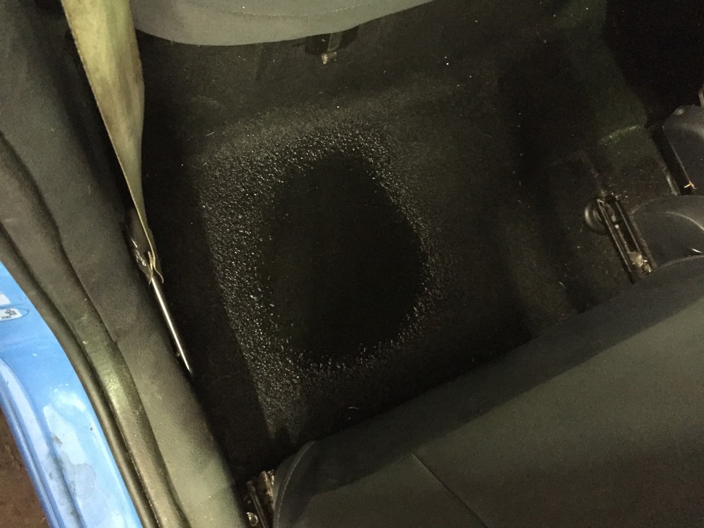

and this in the foot well

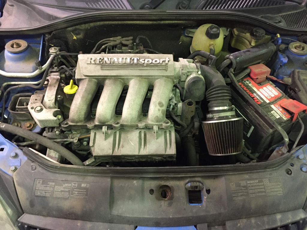

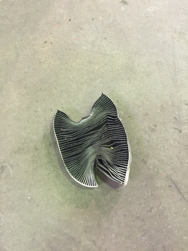

also got this beauty under the bonnet.
not sure wether to get a standard airbox to replace it or make one of the pipes to have the filter behind the nearside headlight?

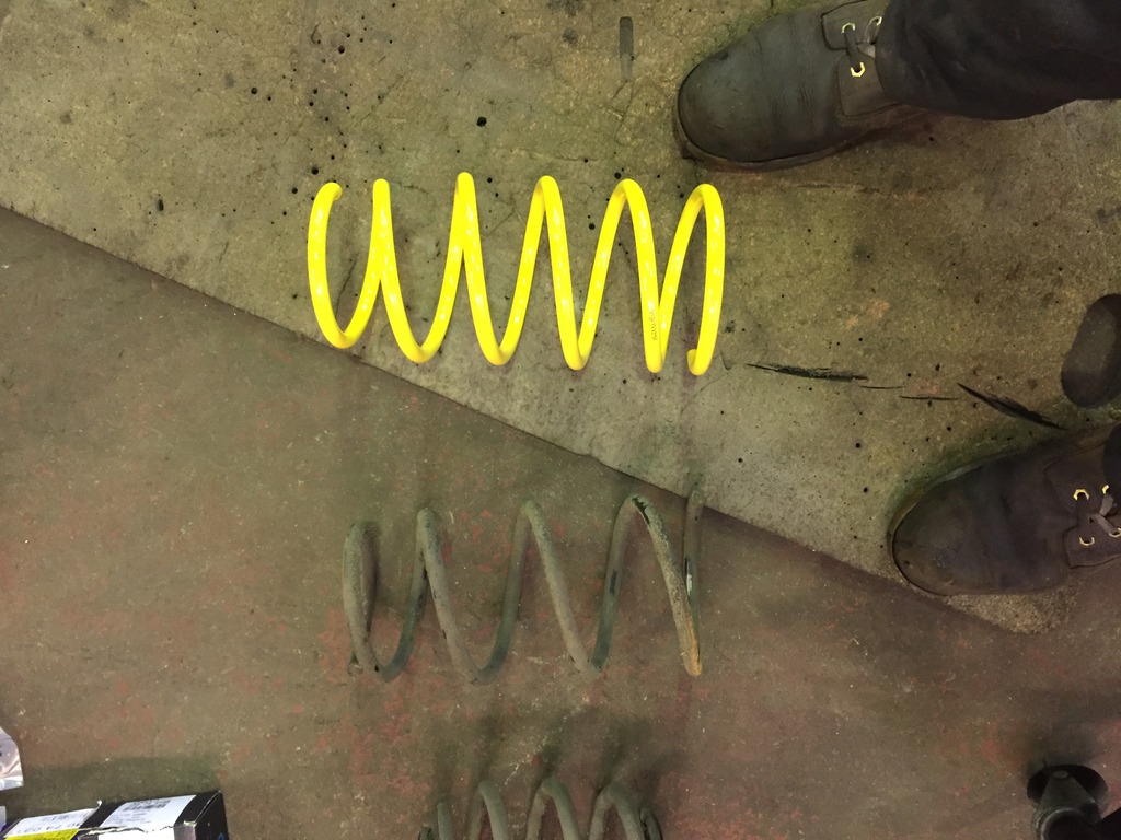

-broken nearside rear spring
-incorrect offside front spring

Standard, but filthy, interior for a cup. All of those steering wheels melt unfortunately.
Other than that it's a decent base for a cheap track car.

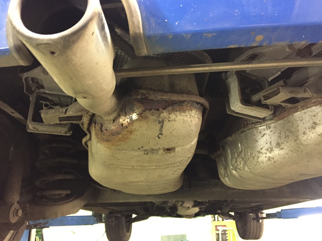

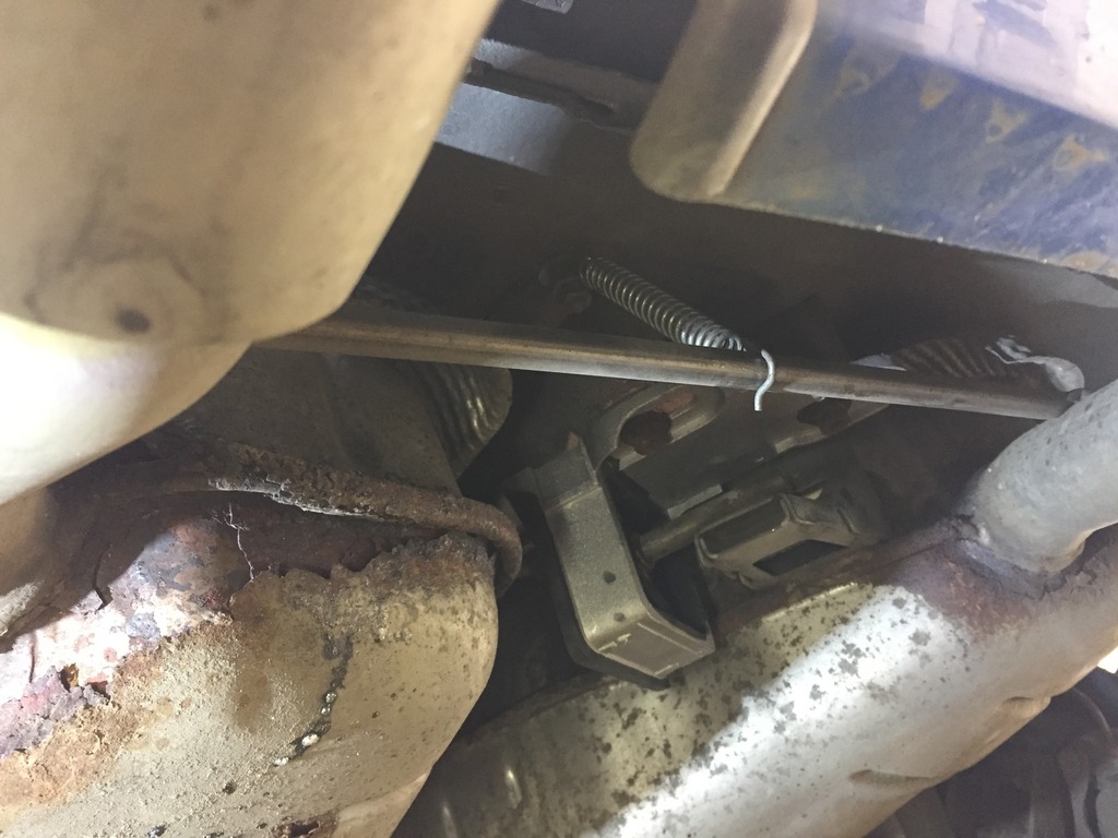

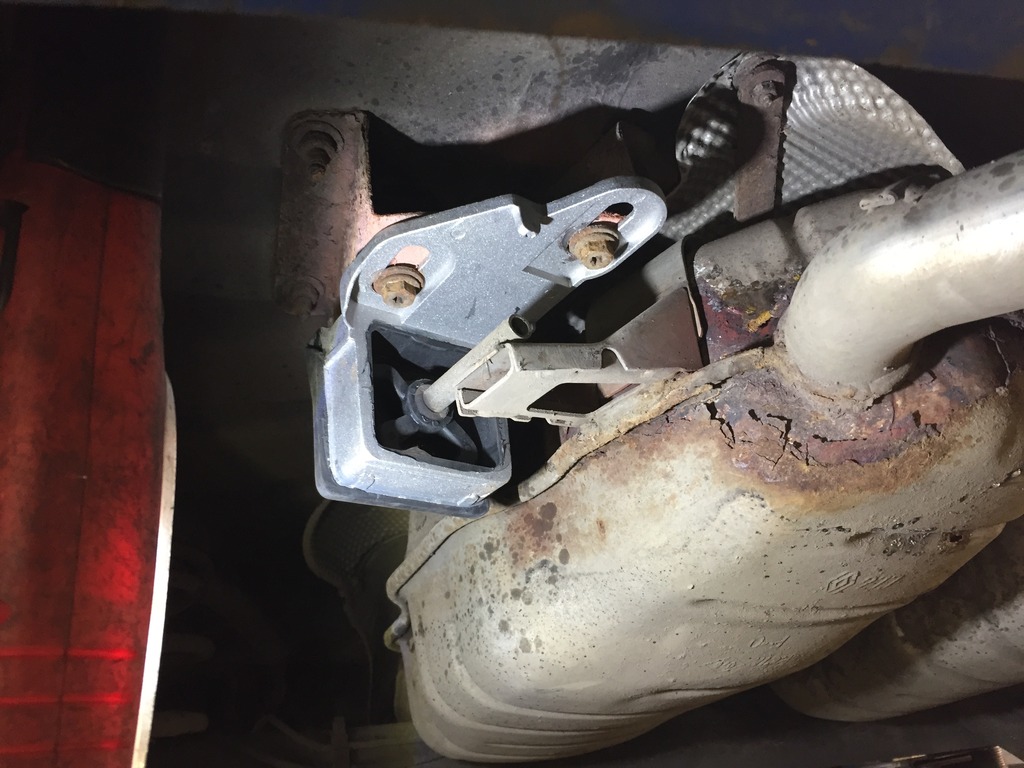

I changed the exhaust hangers and clamp today after work, as it was hanging down in the centre, and i was worried it would end up getting dragged off when the car was being moved.
before:
after:

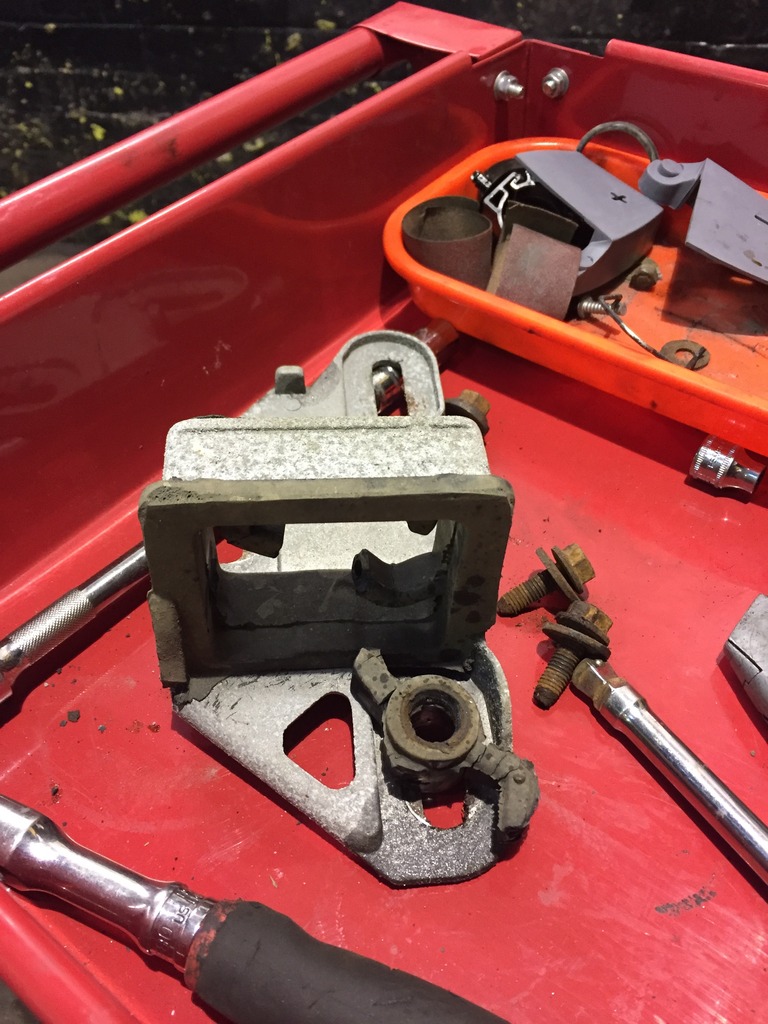

I've changed both rear mounts, the centre hanger and the V clamp between the cat and centre silencer, exhaust sits better now and doesn't rattle either :) exhausts are a bit scabby but seem ok for now.
the old mounts had had it:

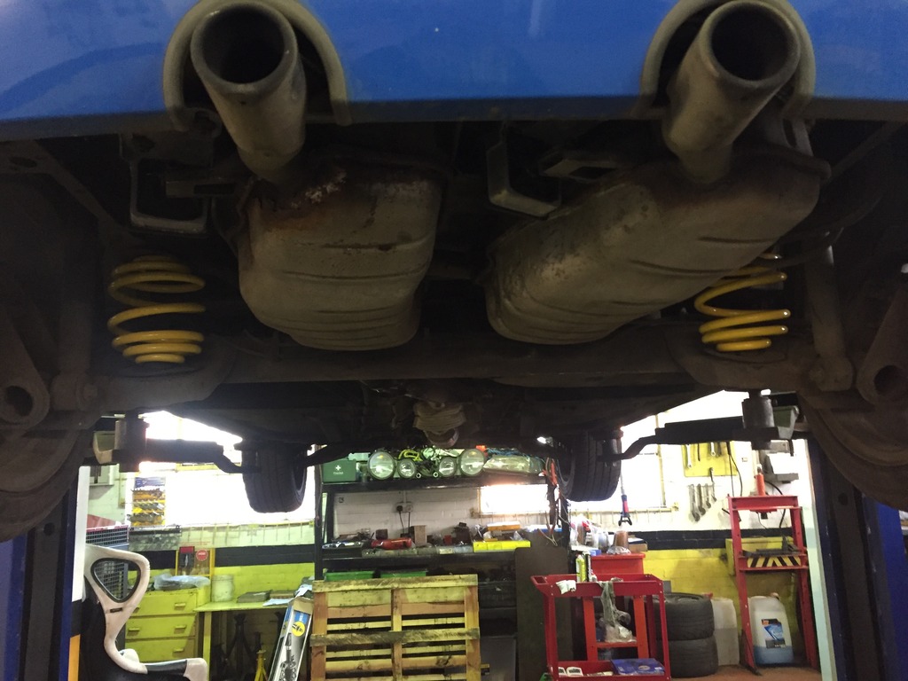

also found this spring, not sure if the previous owner had added this as a bodge rather than replacing the hangers or if its supposed to be there:
It sounds a lot better for 20 mins work haha

the pictures don't do the filth of the interior any justice either, its bad!

Go for a standard airbox with a performance filter, been proved offers better performance than any induction kit. Generally looks like the interior and exterior will clean up okay. Heres some of my tips:

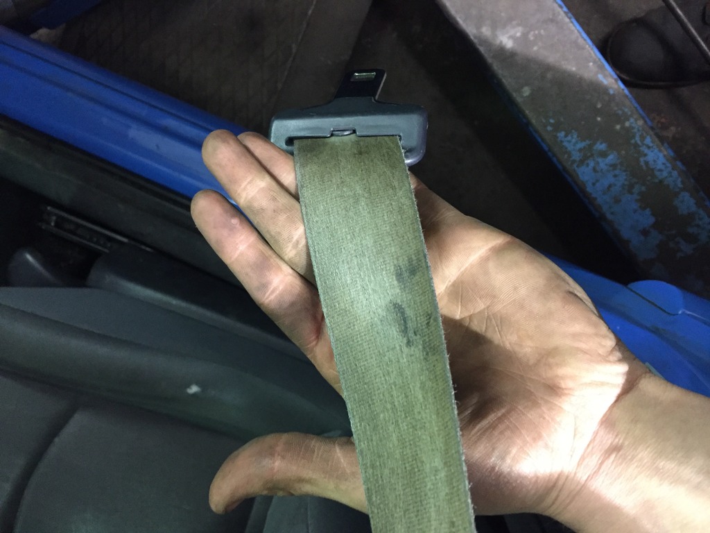

Seatbelts - Hot bucket of soapy water, remove screws at base of belts so you can pull them outside the car and give them a good soaking/scrub. They'll come up great.

Or fatty induction kit, like Ktec but cheaper. £40 ish. Noise and no performance loss

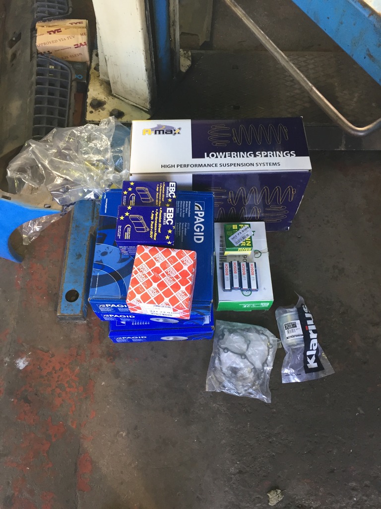

So i had a few hours on the car today, got the bumper whipped off and a few bits turned up:
Spent a few quid on some stuff, nothing to expensive, trying to do this on a bit of a budget haha, the lowering kit I've gone for as it was £38+vat through my work, pagid discs and ebc yellows, again not the best pads but should do the job, I've got litres of castrol srf fluid from the bmw so ill bleed the brakes through with that.
The cambelt kit and a dephaser pulley just the usual stuff, a sump gasket and some service bits....

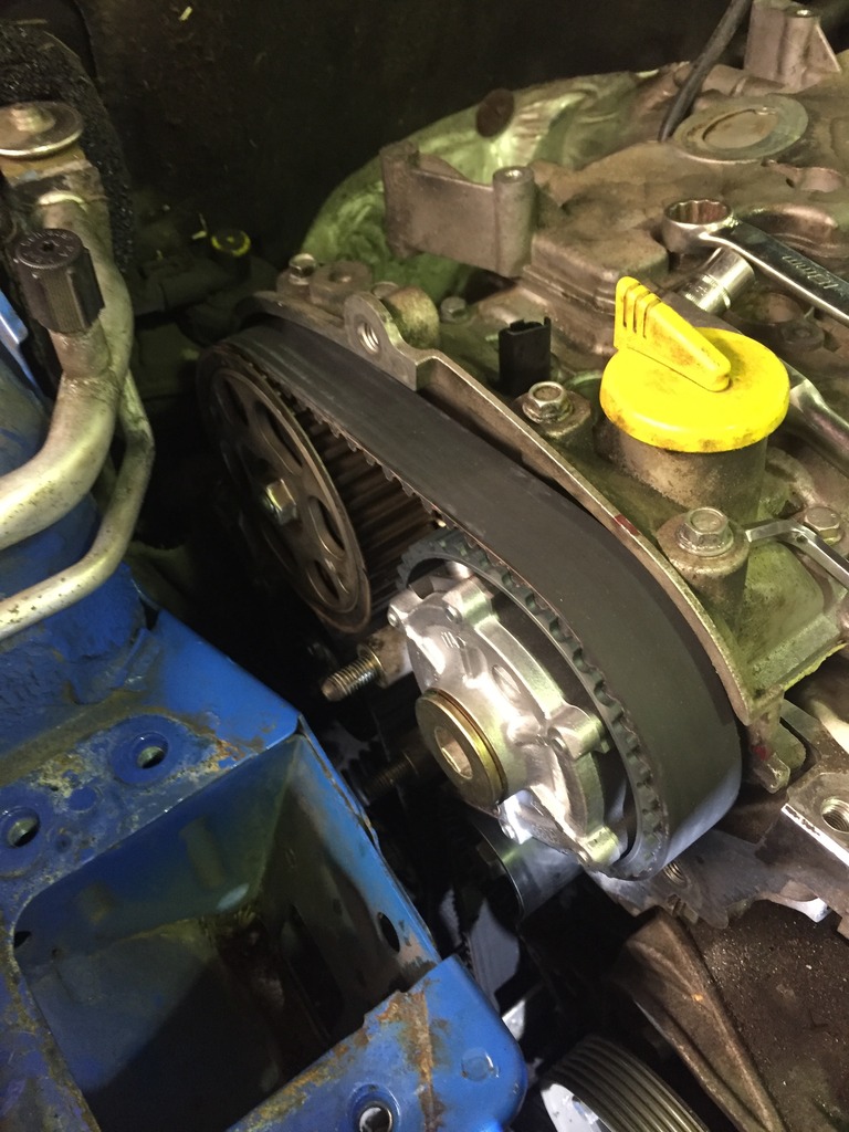

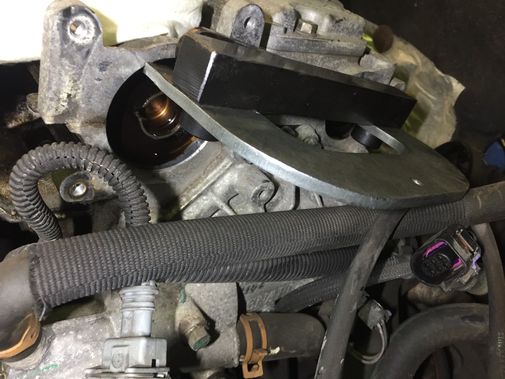

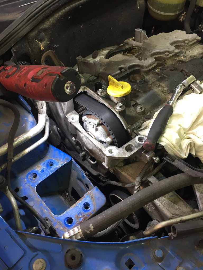

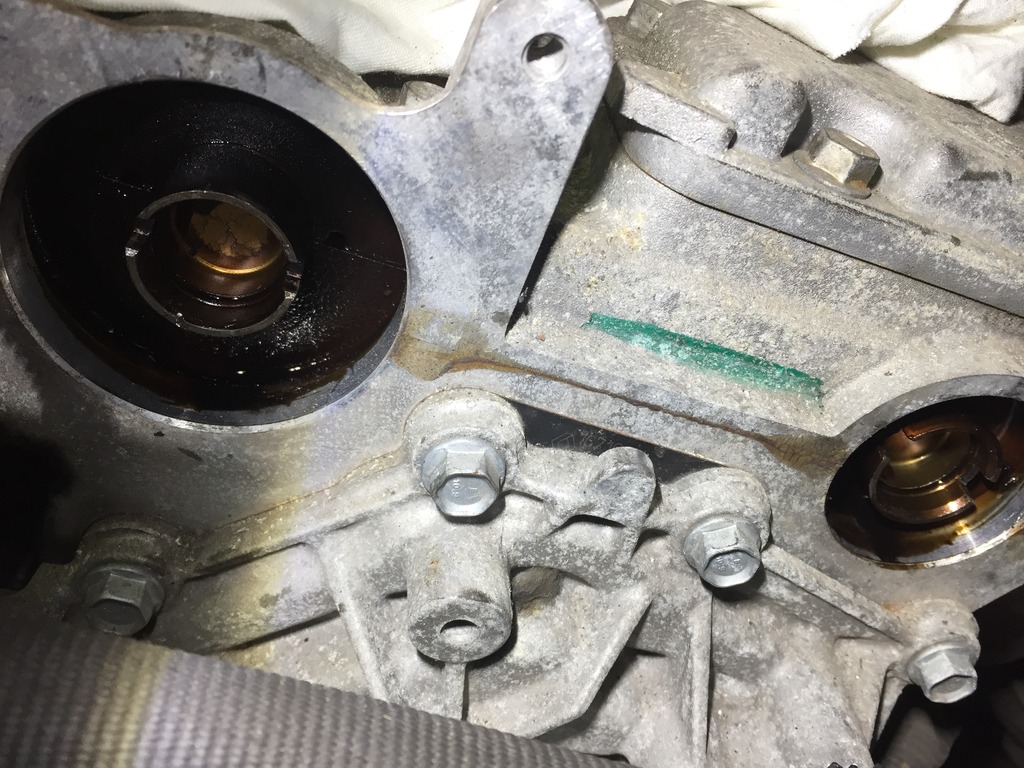

So i thought id get the horrible job out the way first, so made a start on the cambelt, and resealing the rocker cover at the same time.
old belt:
the belt had been changed previously, and it seems the timing is out exhaust cam slightly out of time, this picture is with the crank pin in:
when i tried to fit the tool it highlights how far out it is, fitted in the ex cam it was miles above the inlet:

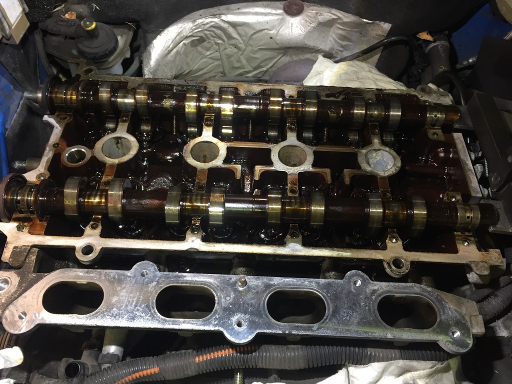

obligatory cam shaft photo, looks as id expect for nearly 130k:
sealed it with some sealant we use on certain Vag engines, super thin when compressed, rocker went back on all torqued up to spec, put the new dephaser pulley and full timing belt kit on...
was straight forward enough, been a while since I've done this type of engine so just took my time, but all timed up perfect, we have the pulley immobiliser tool which made getting them off and back tight a lot easier, worst part of the job seemed ti be getting the lower timing cover back on haha, going to finish the job in the morning, change oil and filter and then make a start on the brakes, maybe do a bit of cleaning too

Did you get ebc yellow stuff? Interested to know your thoughts as I didn't rate them. Pagid own pads are great tbh.
  182, M3, Astra Van
I went for yellow stuffs yeah, i used them on a puma engined fiesta track car a few years back (similar weight id say, but less power) and they were good, they may have changed the compounds since then how ever, they do blue stuff now which they didn't back then... The srf fluid helps massively with fade aswell, and i think i may do the brake ducts from the fog lamps, one is missing anyway.
I've used pagid motorsport Rs29's in the bmw and they are unreal, but thats with ap callipers and 265 front tyres, i was hoping the standard brakes with decent fluid and yellows will be up to the job on the clio
@Luano591 Those springs will be fine as long as your shocks are fairly fresh, looked at yellow stuff myself as they were great in my old 6MPS but only lasted a day at Oulton.

You'll want to swap those spark plugs for ngk.
I used to slate ebc until my new car came with yellows.
I'd easily put them on par with ds2500 on a daily driver for half the cost.

Watch out for pagid stuff as a lot of it now isn't pagid, just stuff in paid box. That's the benefit of Euro owning the name.
As long as the Bosch plugs are the correct ones they'll be fine. It's when people have the super4 they don't run properly.

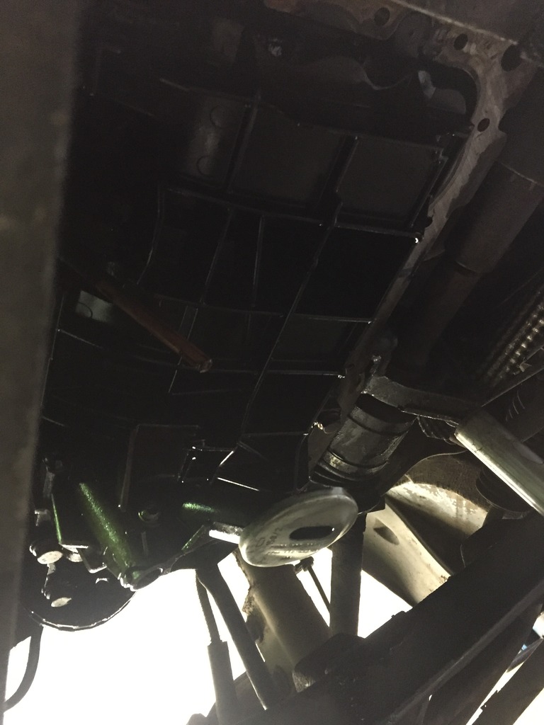

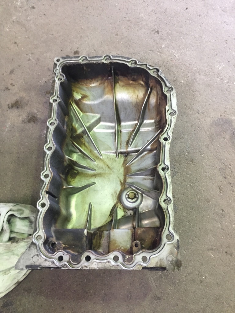

Got round to finishing the sump off today, took the dog bone off and the 13mm out the slam panel and it whipped out easy.
crap picture of the inside:
fairly clean for a nearly 130k motor i thought. Gave the sump a quick rinse out, no swarf or anything untoward to be found in here which was a bit of a relief

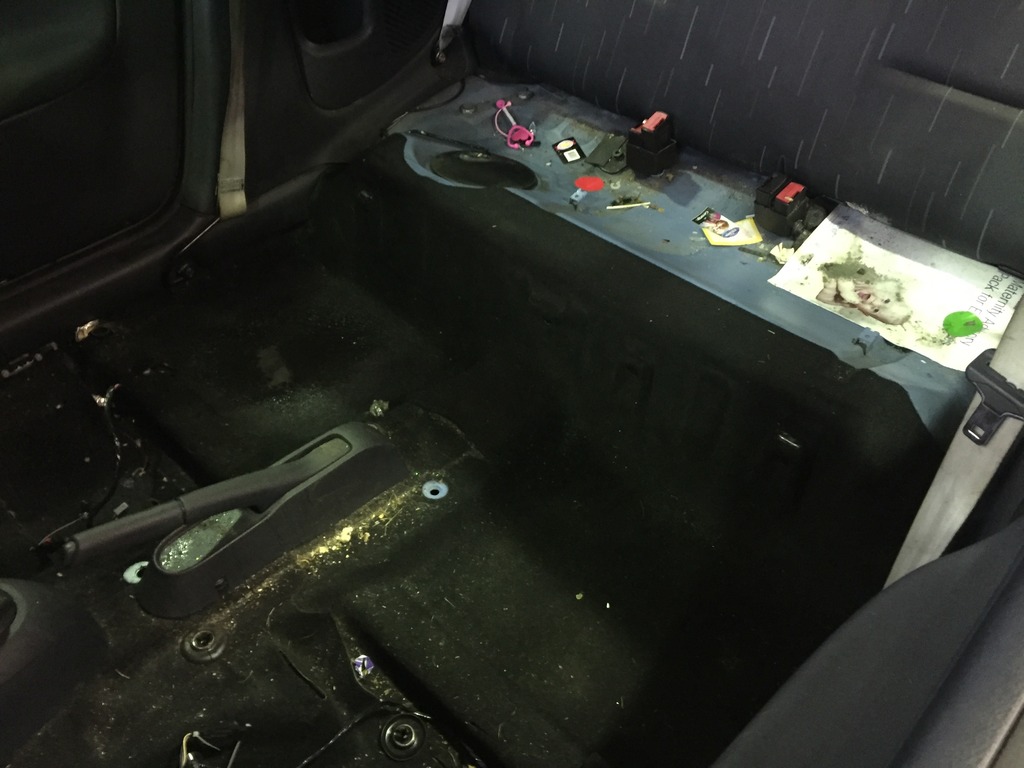

Thought id just pop the new pollen filter in, here is what i found haha

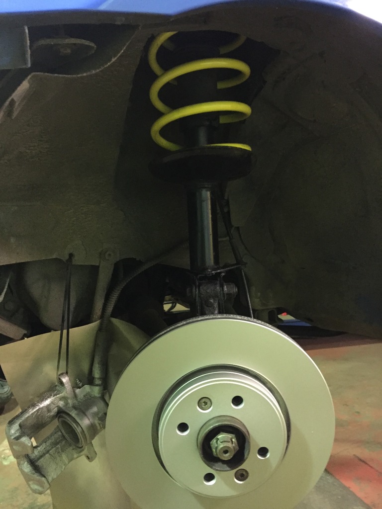

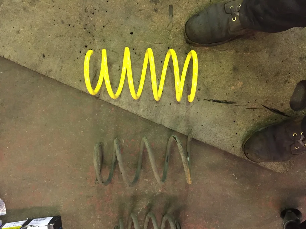

Anyway, popped that together, fitted the lowering kit, just on the old shock absorbers for now, a new set is ordered but I wanted to get it through its mot, old shocks don't look to bad for the age in all fairness, gave them a clean and bobbed it all back together.

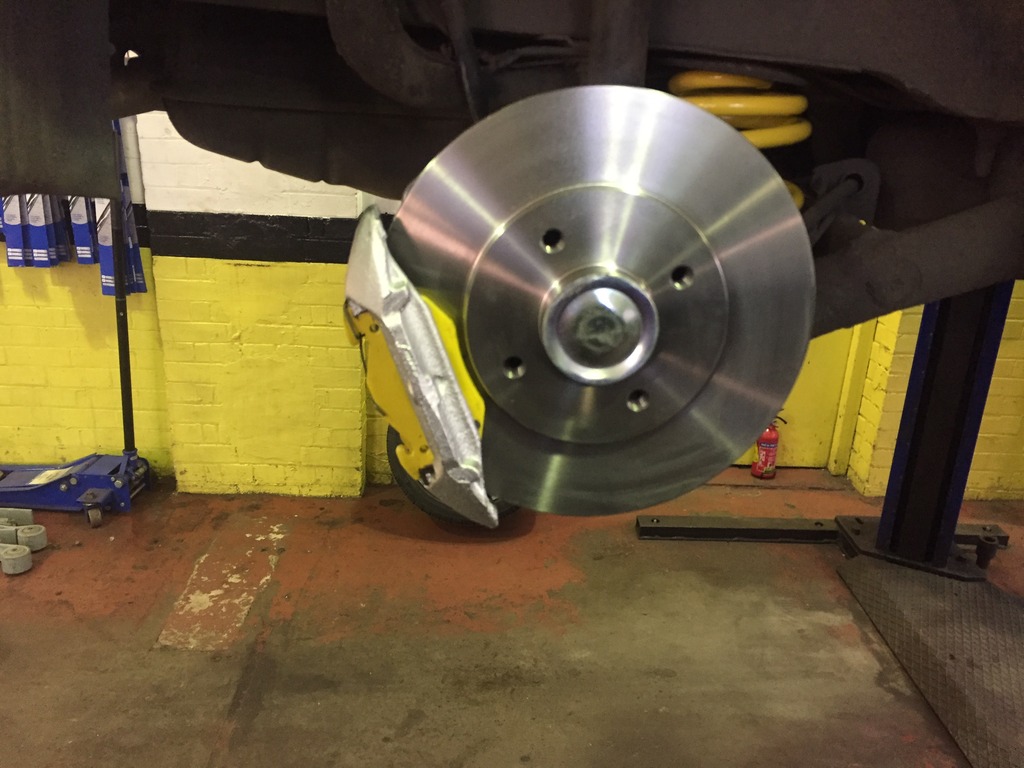

Also made a start on fitting the front discs and pads, but got distracted giving the callipers/carriers a bit of a spruce, as can be seen above, nothing fancy and not perfect but should look better at a glance etc, ill do the same with the rears when i get round to fitting them.
comparison of the new vs old spring:

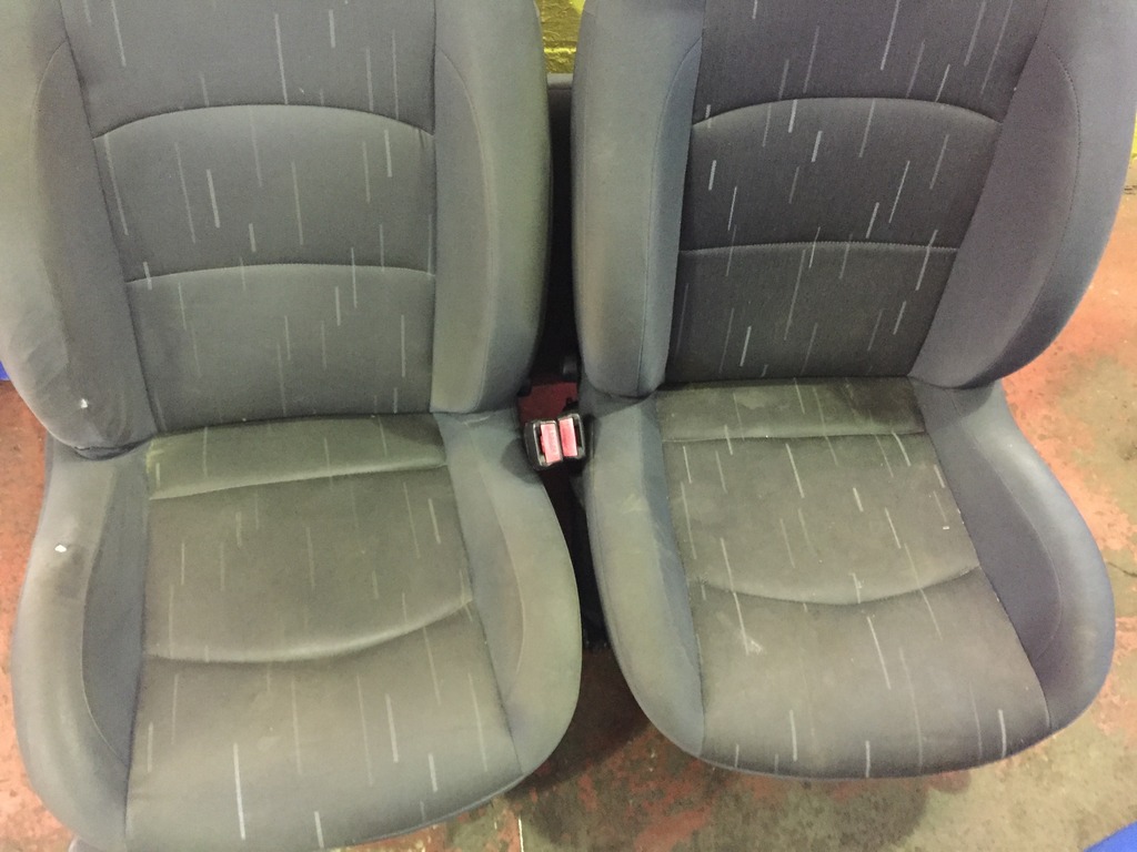

Oh it's bad! It's a Poorly cared for example
get some pictures up lets see this haha!! little pic of the interior of mine now the seats are out... found £2, car was a bargain now!!
the seats them selves...

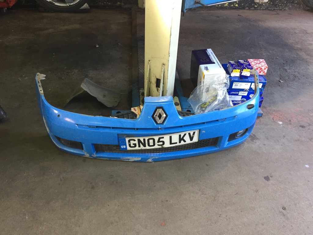

Got the rear brakes finished today, look better for a little spruce up i think.
Then some parts turned up, any guesses?

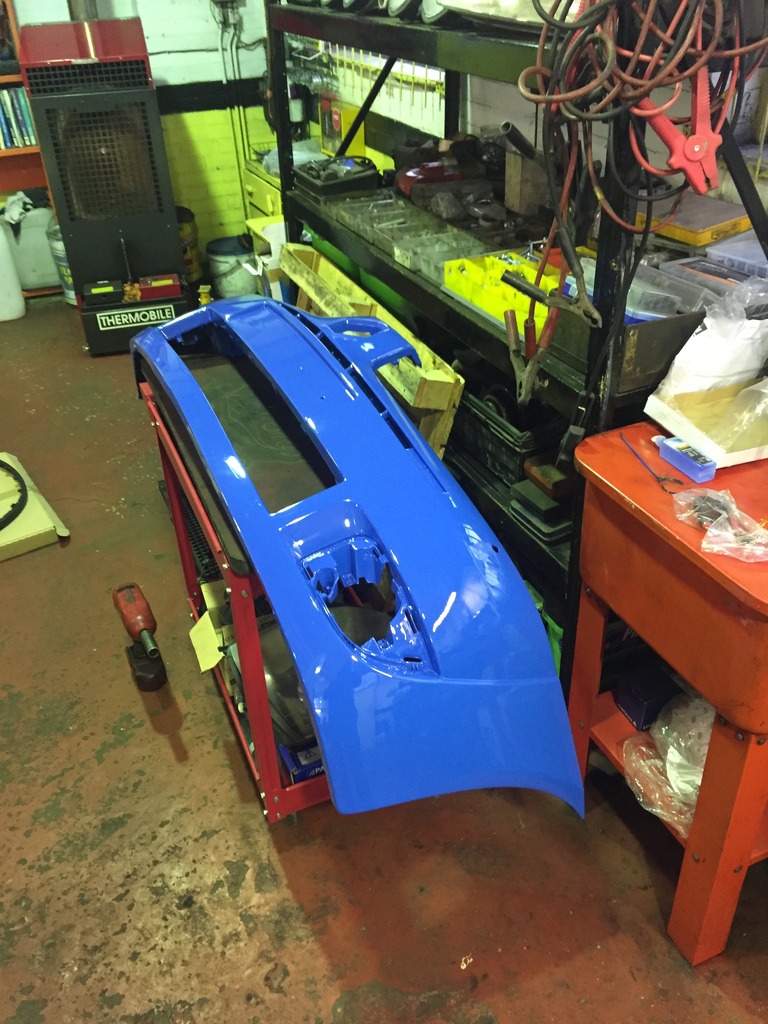

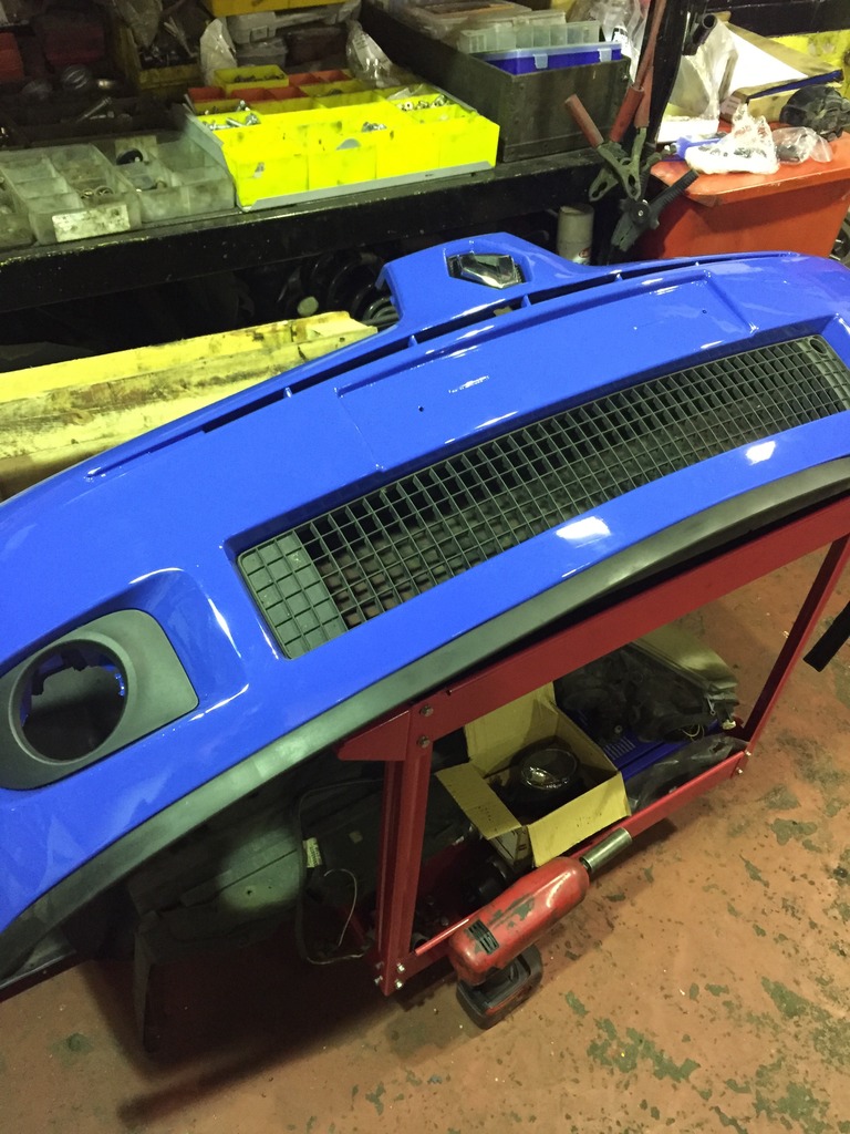

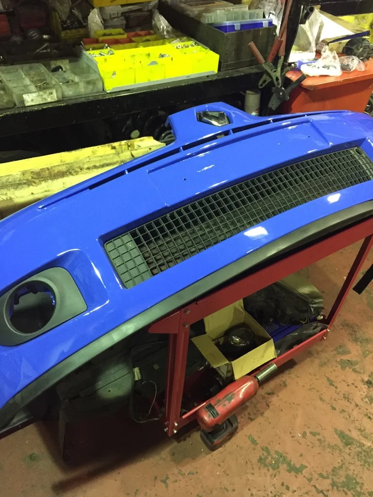

And the bumper came back from paint, looks much better
popped the grills back in and started fitting the lip, then my drill went flat, and i was ready for tea so i left it half on haha
Ill get that finished tomorrow, do the headlights tomorrow aswell, and the wheels should be back, then can hopefully get the bumper and under trays/arch liners back on saturday morning.
Its coming together

Shame they painted the little black tabs on the front bumper. Now everyone will assume it's been a category A write off lol
  182, M3, Astra Van
i know haha, its my own fault really, i forgot to say they needed masking off and it was done as a bit of a favour so can't do much about it, hopefully ill be able to talk it down to cat D and light water damage lol
