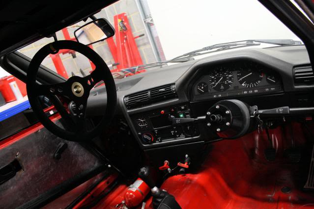

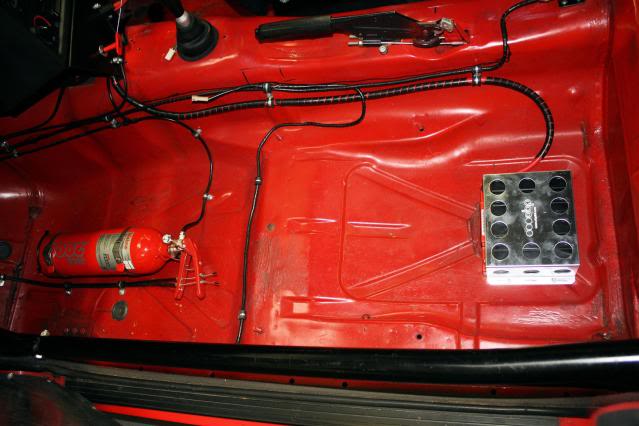

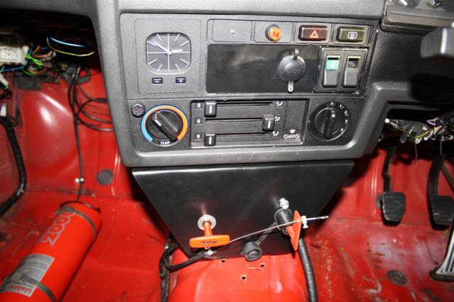

The first thing I did was make a panel for my extinguisher pull cable and interior battery cut off switch to sit between the dash and the tunnel. Then a blanking panel for the radio slot with a 12v socket and electric fan switch:

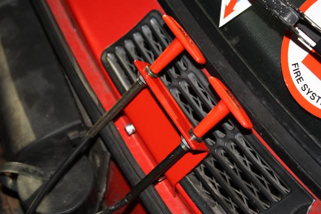

And a bracket to hold the external extinguisher pull and battery pull cables:
I previously had a Halfords battery in the boot. I came accross a well priced Odyssey 25 battery so I moved the cables and mounted it on the passenger side. I mounted it far enough back so I can still fit a passenger seat in.
To help getting in and out I bought a quick release steering boss off eBay. There is some play in it so I will be sending it back in due course for a replacement!

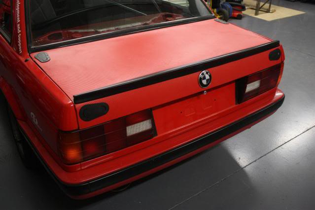

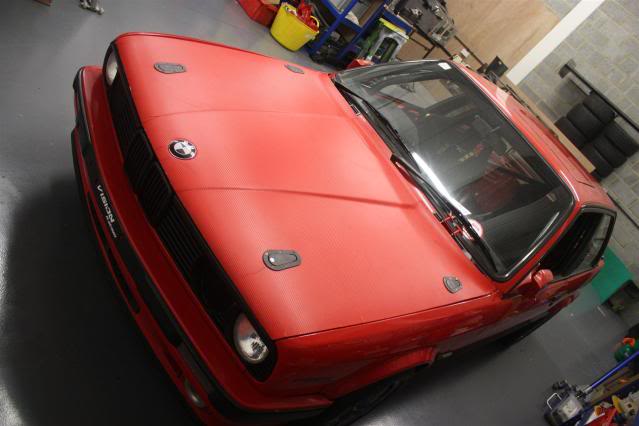

Next up was some weight saving in the shape of a glass fibre boot lid and bonnet. Will. helped me with vinyl wrapping them and I then fixed them down with Aero catches. A good ~20kg saved there!

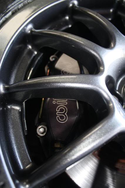

To help further with weight loss, and to give the Wilwood 4pots (with 280mm Audi discs) I have fitted some room, I bought some TD1.2's and fitted them with a set of Dunlop 02G's I had sitting in the workshop. They're ET15 which will also give more clearance in for the coilovers. People have problems with standard offset wheels because of where the adjuster colar sits on most coil over kits, it causes it to rub on the tyre!

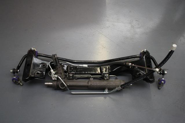

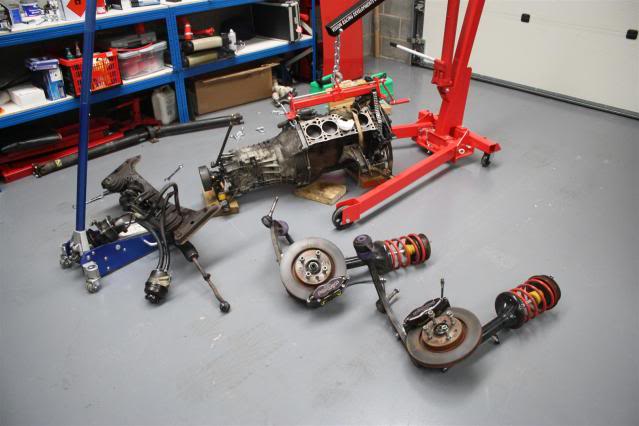

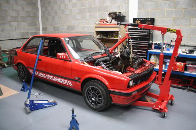

I then turned my attention to removing the engine as it had a head gasket problem, along with the front suspension and subframe assembly:

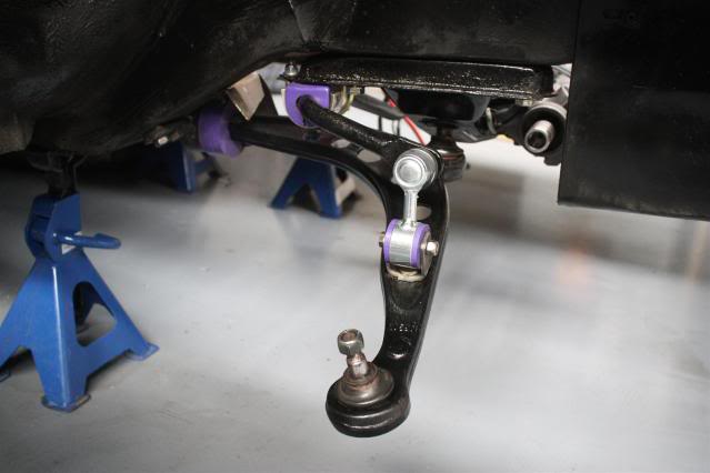

I gave the sub frame, ARB and wishbones a good clean and a few coats of black paint. Once they were done, I rebuilt the subframe with new Powerflex bushes, drop links and fitted an E46 3 turn LTL steering rack:

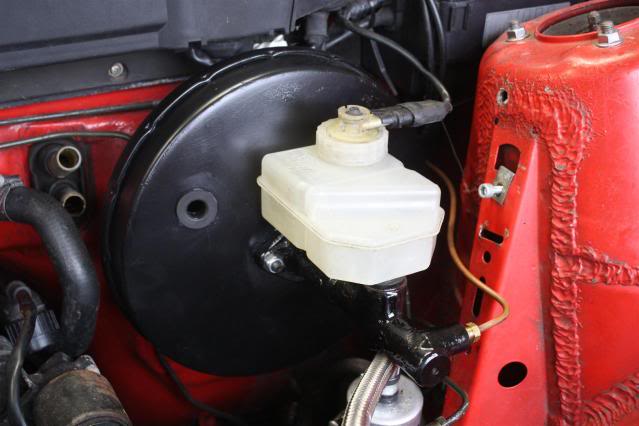

While I was there tarted up the servo and brake master cylinder:

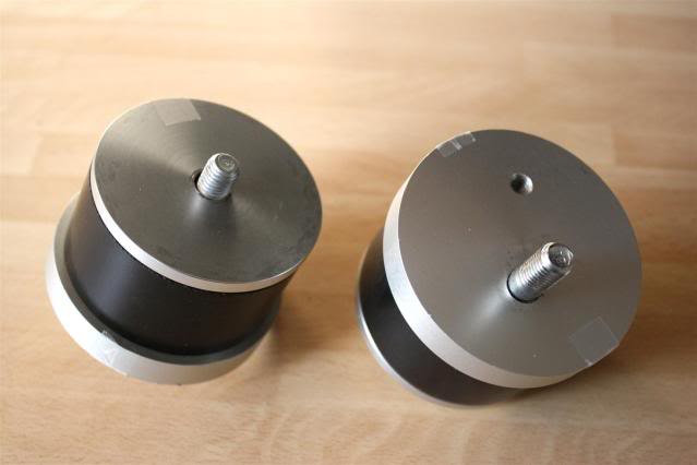

Aaaand got some nice shiney poly and aluminium engine mounts for an absolute steel from the USA:

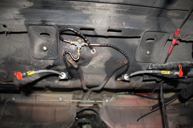

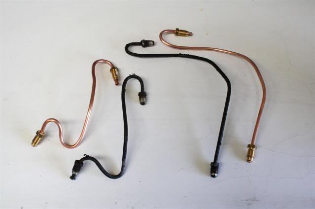

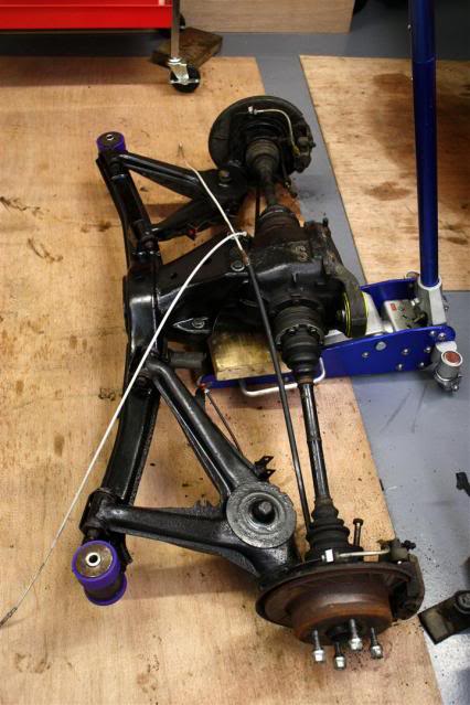

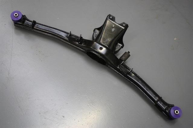

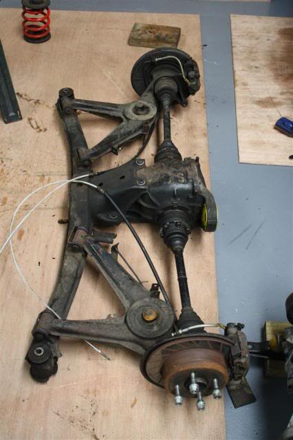

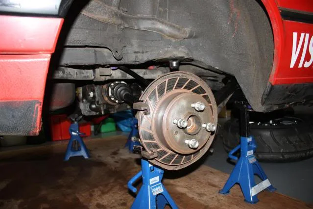

Then on to the rear to refresh the rear subframe and brake lines:
More hammerite and Powerflex purpleness:
Rebuilt with my 4.1 LSD:
And back on again:
I've got a set of rear calipers from a touring which are maginaly bigger to rebuild and fit.

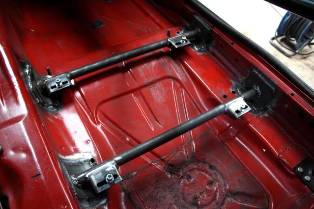

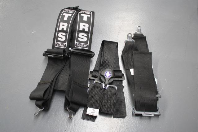

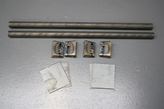

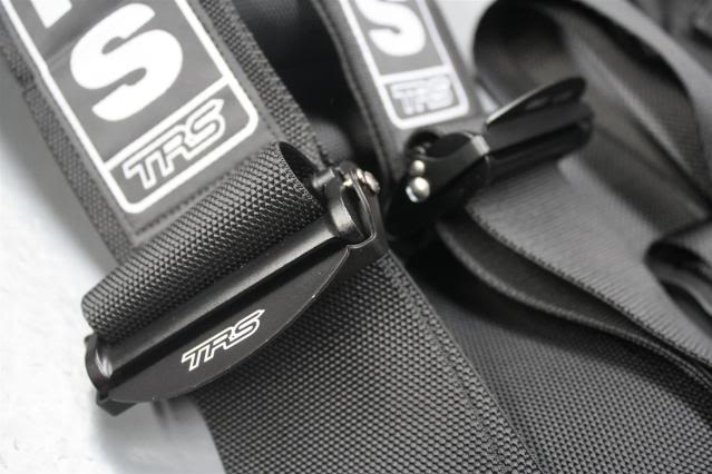

Lastly I bought a new TRS harness and a seat cross member kit to weld in to mount my Suzuka pro a bit more betterer. Need to get some one in to weld them as I don't possess the skillz.

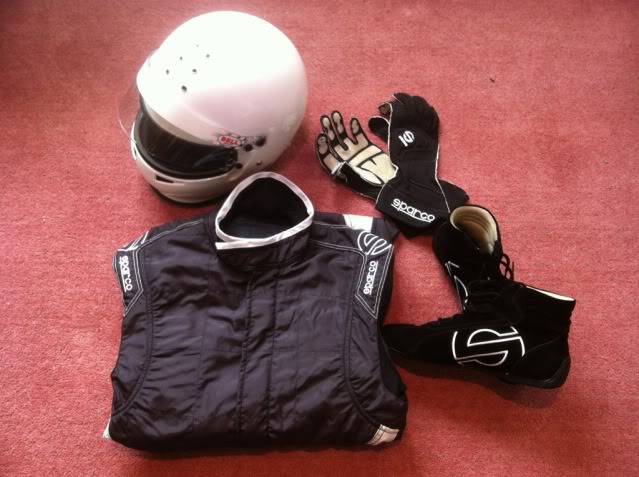

On the getting race ready front. I did my ARDS at Combe a few weeks ago now and got my lisence through really quick from the MSA:
And I got all my kit together as well the other day. The team I work for (Generation AMR) are a Sparco dealer and have an epic offer on at the moment on the top spec 3 layer X-light suits so I picked up one of them with a pair of the X-light top spec gloves and an entry pair of boots. The helmet I got else where and is a Bell RS3 pro (kevlar shell, noticably lighter than the normal ones too). Just need to club some cash together for some fireproof under wear and thats that!
Thats me broke now!

Looks s**t x
Not bad vinyl wrapping skills for my first proper attempt :)

Looks s**t x

Little bit of progress. I got my weld in seat frames sorted. I've still got to make some fillets to box in the plates welded to the sill but once there in I'll get it all painted. The material on the tunnel is a tad thin and the chap who welded the spreader plates in did have a few problems but it's in and I'm happy with it.
Next up is getting some harness eye spreader plates for the lap and crotch straps welded in, then look at mounting for the shoulder straps.
