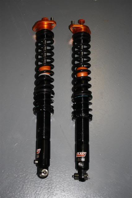

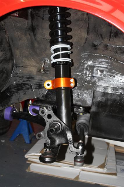

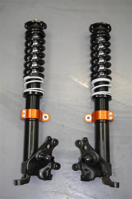

A day I never thought would come, has infact happened. The FedEx man knocked at my door with a box which contained my new coil overs! I've been waiting a total of 20 weeks for these to arrive. Sadly the adjuster plates for the front camber adjustable top mounts have a few big scuffs and knocks on them; quite frankly they look used and not what should be expected from a kit which retails at over £2k! So they are going back for replacements. The fronts also came with provisions to link the ARB directly to the damper housing, something I will look to connect up in future.

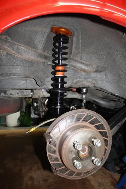

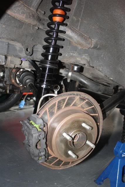

I've fitted the rears up and also did a test fit of one of the front dampers before removing to get the adjustment plates sent off.
Here they are:
I need to get the fronts built up with the bearings, calipers and discs ready to fit properly.

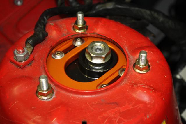

Seen good videos of that too.
Nice coilovers, shame about the damage something that seems to happen a lot with motorsports parts.

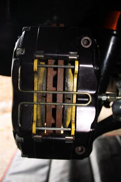

I built up the front legs today with the wheel bearings, brake calipers and discs and got the car back in the ground again to take the old cage out and test fit a new one I've got. I have run into a problem with the TD wheels mounting onto the hubs. The 'bell' of the G60 discs I'm running are 2mm thinner therefore the larger part of the hub which the discs sit on is sitting in the open. With the old BBS wheels this wasn't a problem as they have quite a chamfer on them and as a result missed the 'lip'which has been created. The TD 1.2 wheels do not have such a large chamfer so the wheel isn't sitting far enough back and isn't touching the disc. Net result, the disc moves with the wheel bolted up so:

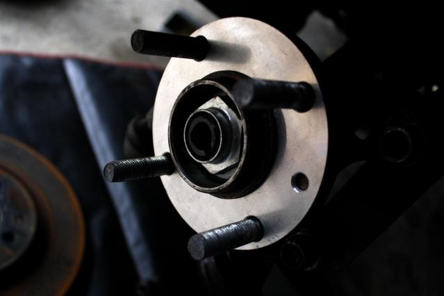

Option 1: get the wheels machined
Option 2: get some spacers machined to sit behind the disc (I seem to remember a write up Geoff_bob did that indicated that this was the correct way, as the offset of the disc is also slightly different to that of the E30 and should correct both problems).
I think I'll be going for option 2 as being the simplest :)

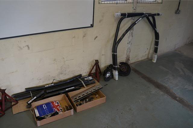

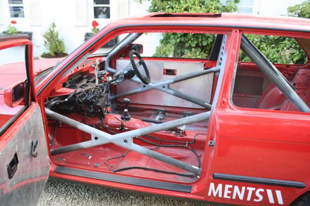

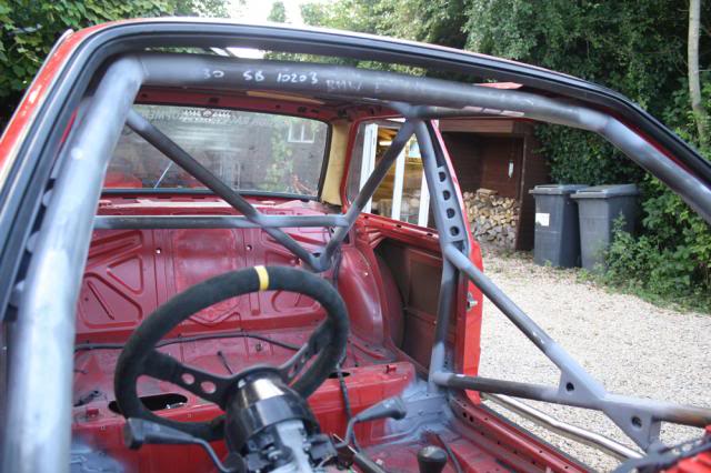

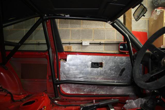

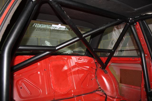

As previously mentioned I removed the roll cage that was fitted and it was collected today by the buyer, nice and easy! It is being replaced with a Safety Devices B9 which I test fitted today with help from my PA, Russ :cheers:. Next task is to get some boxes measured and made up for the B-pillar hoop and have the captive nut plates welded into the front. Here's some pics of the dry fit any way:
Also got some harnese eye bolt spreader plates to have welded to the floor too. Looking forward to it all being fitted and testing the seat with the 6 point harness.

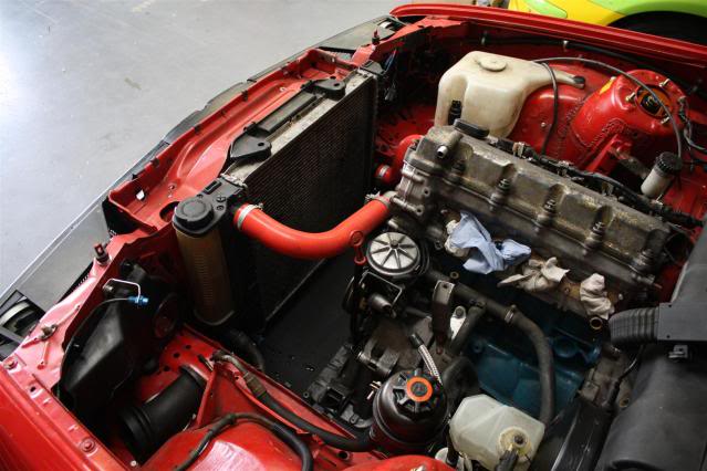

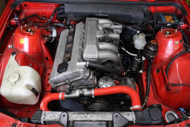

I bought an M42 (1.8 16v, the same as what was in there before) race engine that was used in TTRS. It’s had quite a bit of work done to it and I plan to do a couple more bits and then get it live mapped and see what extra can be had out of it. When I removed the coils from the spark plugs I was a tad horrified to find that the 1 and 2 plug ‘galleries’ where full of oil. After looking at it is looks as if the cam cover seals may have leaked, this must be the only explanation so I also used the best set of seals I had on the self to hopefully put a stop to that happening again. I split the gearbox, flywheel and clutch from the old engine and fitted it all up to the new one. I also pressure washed off the gearbox and I was pleasantly surprised at how nicely it came up.
Once the engine was I fitted my electric fan to my E36 328i radiator and got that in there:
I have about 3 engines worth of cam covers, upper and lower inlet manifolds, so I cherry picked the best set and got them fitted on. I have also used my COP plate which bolts straight through the cam cover so will support the coils nicely (the threads in the head on my old engine were fubar so it’s nice to be able to properly bolt them down). After that I connected up the Z3 1.9 gear linkage set up which I had fitted before and fitted the alternator and PAS pump.

• I've got a standard airbox and K&N panel filter to fit. (It was rolling roaded with this set up and it has been proven with many other cars its genuinely the best set up for this engine)
• Order some hoses for the water system

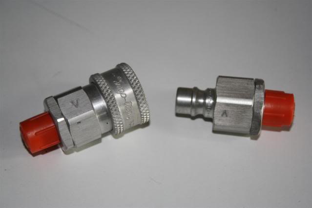

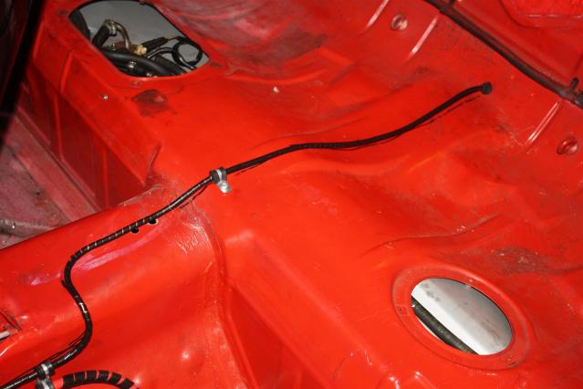

I have left the fuel lines disconnected as I will be fitting a dry brake for sampling (as required by the MSA) and also for draining the tank so the fuel level can be kept accurate. I need to get some lengths of pipe and some adaptors and find the best place for it to be fitted.

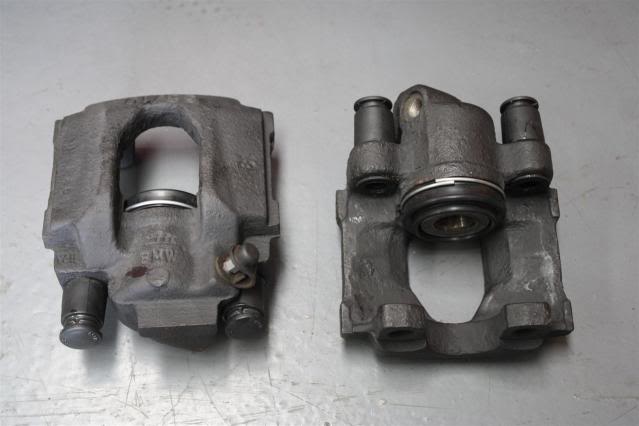

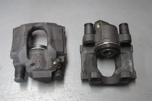

Lastly, I bought a caliper recon kit and some high temp paint from the local parts place and rebuilt my touring rear calipers. The paint turned out to be more matt grey than black but I thought: 1. They look far better than when rusty and 2. A blind man would like to see it. I am going to move my brake bias valve forward so I won’t be bleeding the brakes just yet.

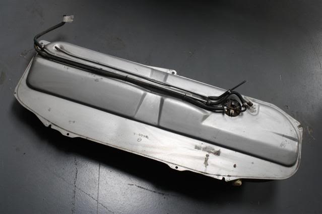

I’ve got a busy few weeks ahead and I have organised getting an exhaust system made while I’m away. I got to work on getting the fuel tank built and fitted along with the prop shaft. It’s nice to now have the running gear complete again.
The tank ready to go in:

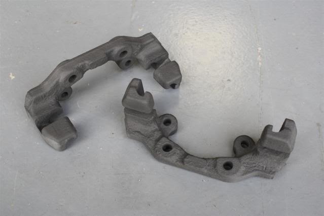

After painting and rebuilding the rear calipers I also sprayed the carriers and got them bolted on. I fitted them with the old EBC Green pads which have been in the car since I’ve had it. I will be looking to changed them at some point.

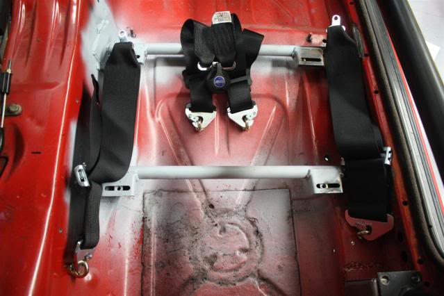

Got my harness eyes mounted as well. I spent a bit of time with the seat in fafing about trying to find the best places for them. The inner tunnel one was the most annoying one to get right but the angles look good and in keeping with the diagrams in the blue book.

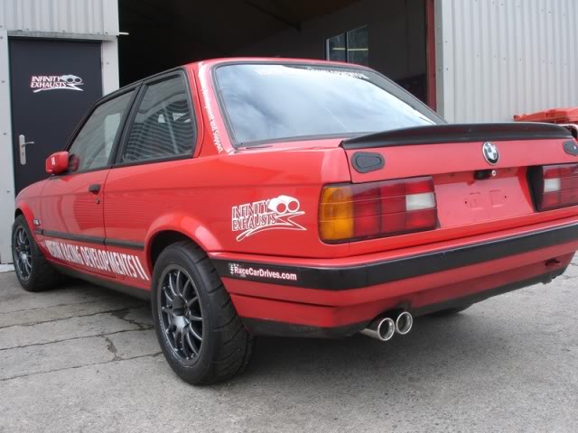

Other than that I got lots of little jobs such as wiring on the engine and giving the car a bit of a clean and tidy for its trip to Infinity Exhausts (www.infinity-exhausts.co.uk) next week.
:cheers:

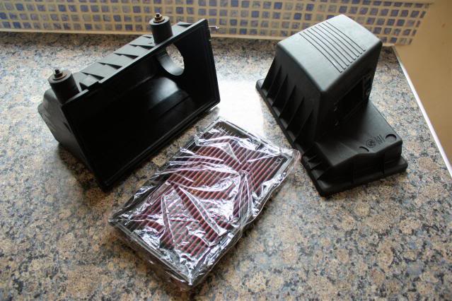

My airbox arrived the other day and so did my K&N panel filter. The airbox was a bit dirty (as it would be having been sat on a road car for 20+ years) so I gave it a wash in our parts cleaner at work; it fires the cleaning stuff out at like 300psi, that soon moved the crap and they came up really nice :D . Will get them on next time I'm home:

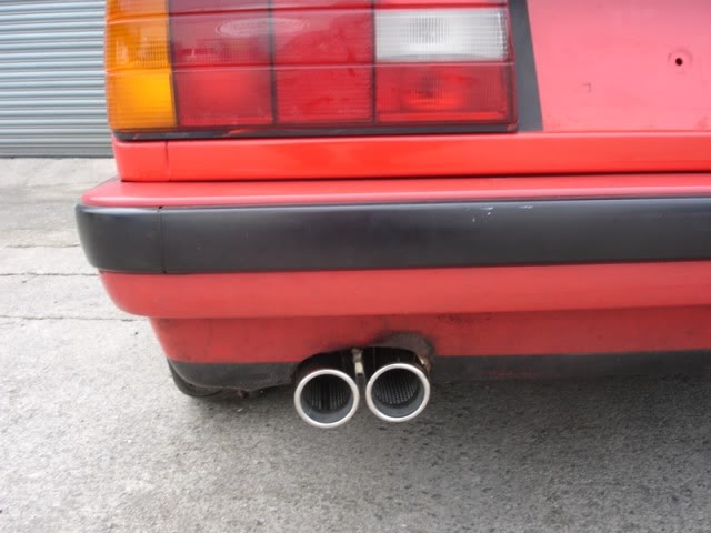

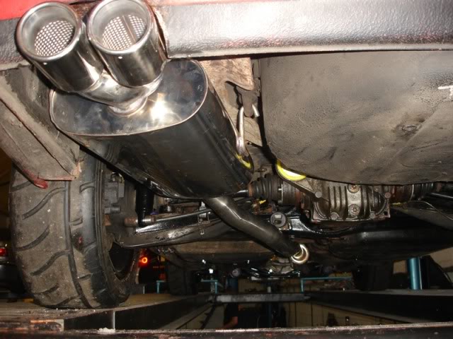

My exhaust is done, Infinity have sent me some pictures as I won't be able to see it in the 'metal' for a few weeks. Dead chuffed with it looks like they've done a great job. I just need to paint the valence so it looks better.

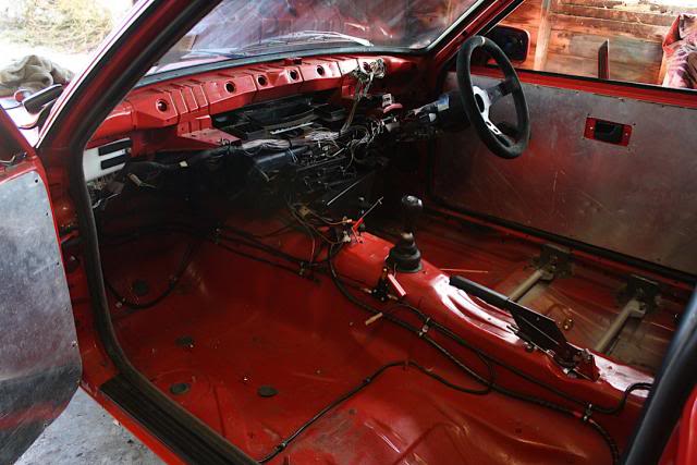

Christmas and New Year has provided me with some time at home and time at home means time on the car. A friend of mine whose race car I ran owns an engineering company so I frequently call on him to knock bits up for me:

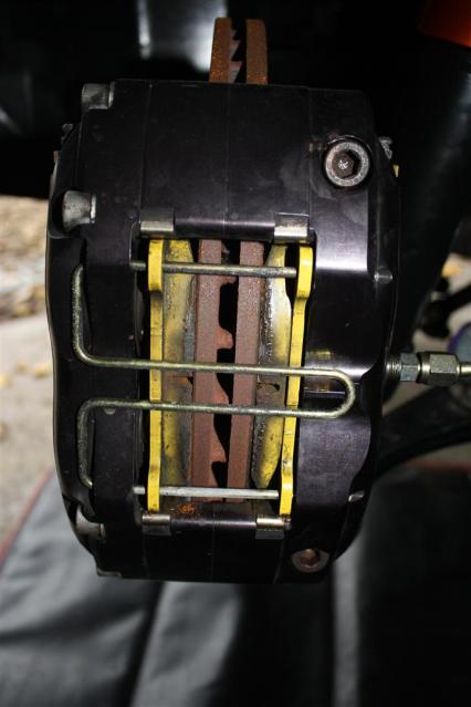

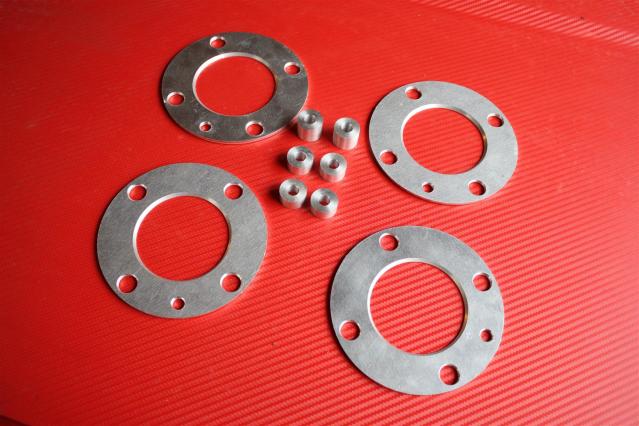

I've been focusing on the brakes mainly to try and get them wrapped up. Firstly I got to fitted my brake disc spacers. The Audi G60 discs had a slightly different offset to the E30 ones and the disc had been running offset in the caliper like so:
Some 3mm spacers as per Geoff_bob's drawings have cured this issue and also another issue of the new wheels not clamping the disc properly.
Only problem I found with the spacers is that the drawing has the retaining screw hole in the wrong place for the E30 hub and therefore will need re-drilling to allow the use of one. The hole needs to be 13mm from the edge not 10mm.

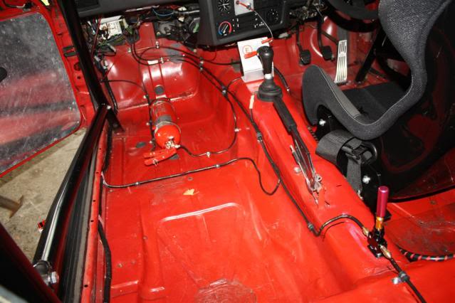

I also fitted up some spacers to my steering column to replace my temporary washers. I've dropped the column by 10mm which makes a big difference at the steering wheel. I have some 15mm ones as well to play with.

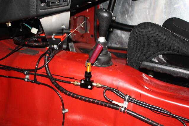

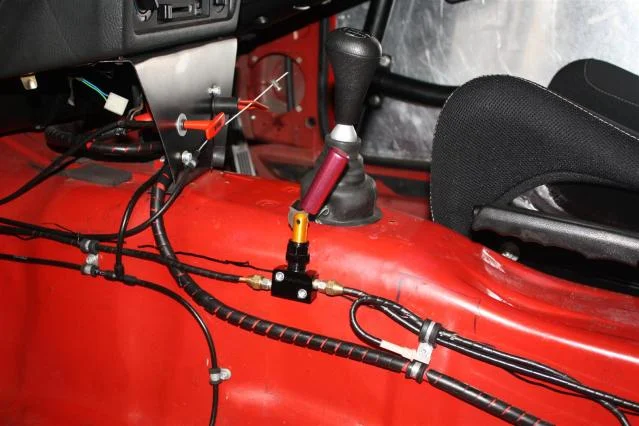

Next up on the job list was moving the brake bias valve. It was previously here (lower right):
The problem was I couldn't reach it with my harness done up so I decided to move it forward. It now sits next to the gear stick and can be adjusted from the seat. Simple enough job, just needed to make the ‘front’ pipe shorter then make up a new longer ‘rear’ pipe:

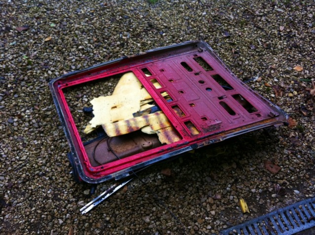

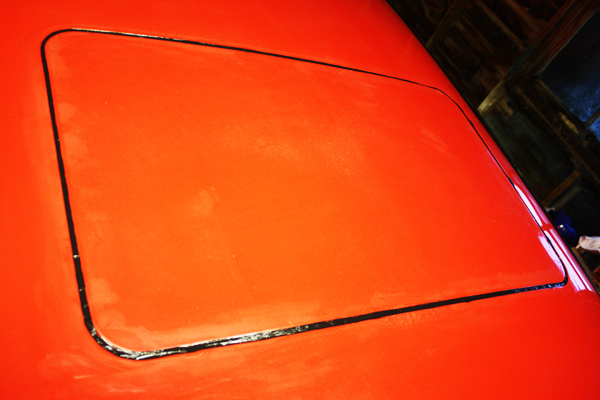

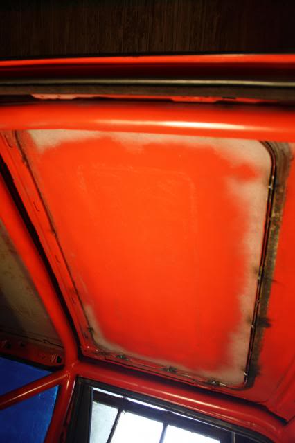

This was my sunroof:
All stripped out...
Ready for this:
Et voila:

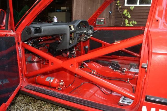

Some paint and the dash refitted:

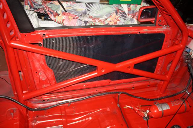

Along with some super fast carbon door cards for added BS factor:

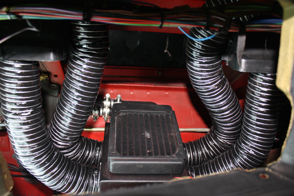

Light weight heater:
Sunroof skin tack welded back in:

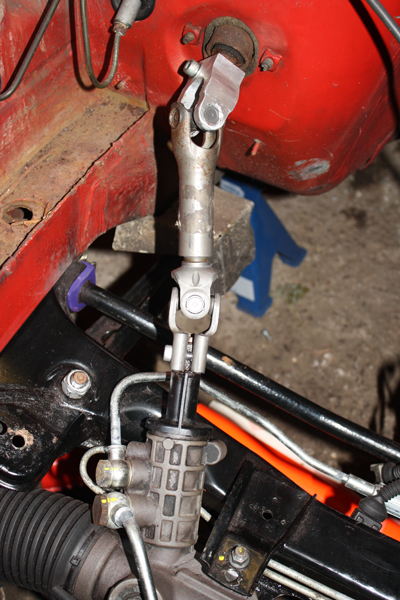

Fitted my Corsa/E30 linkage for my E46 rack. Also changed the nuts on the rack bolts to proper K nuts:

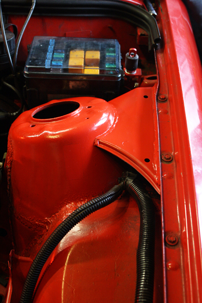

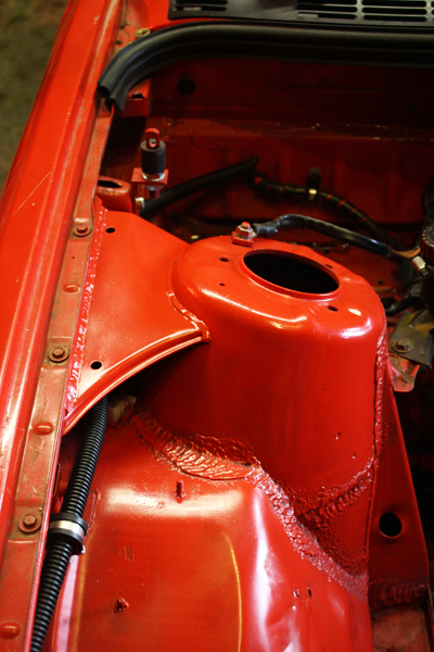

My fabricator mate poped over again and welded my turret reinforcement places in. Once that was done I got to painting:

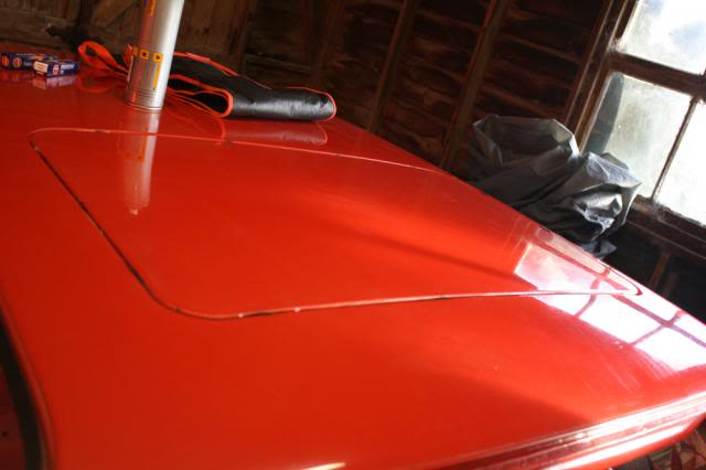

Dad was feeling in a helpful/bored mood so he wandered outside and decided he wanted to seal the sunroof up so I left him to it :D

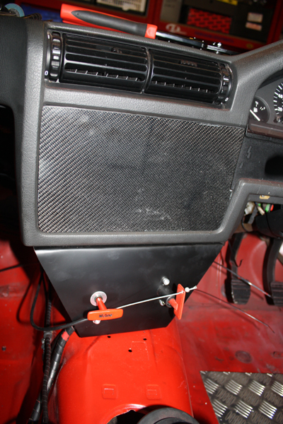

Also finally got round to making my carbon facia for the dash centre console:

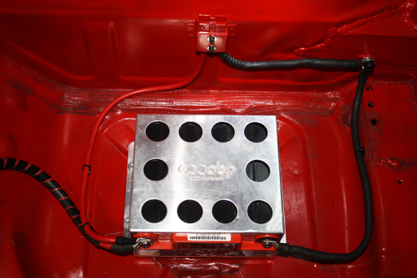

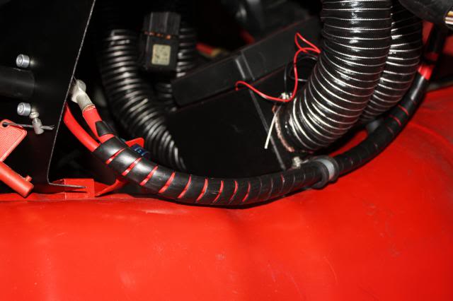

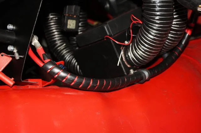

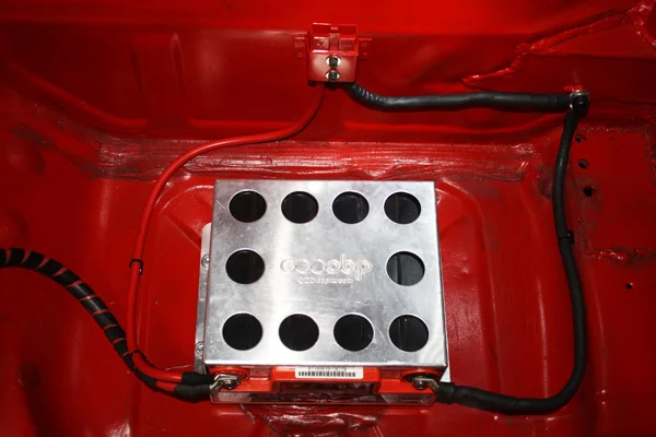

Bought myself some proper battery cable cutters and crimpers and sorted my battery cables out with anderson plug. Then did the bits under the dash too:
