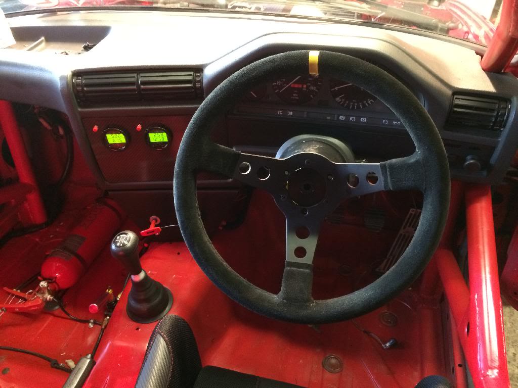

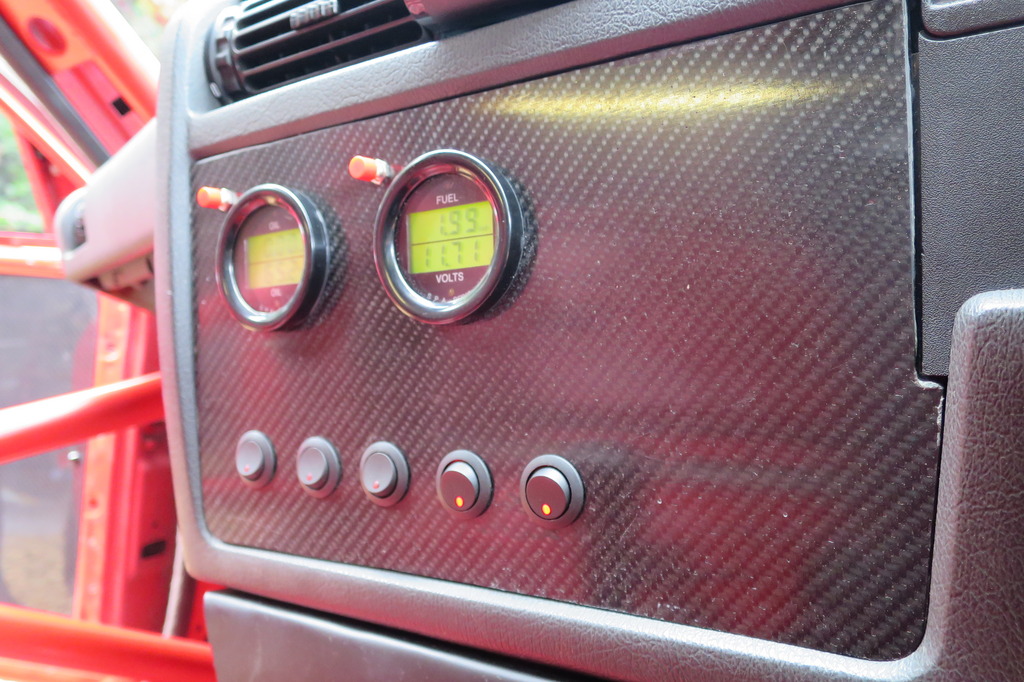

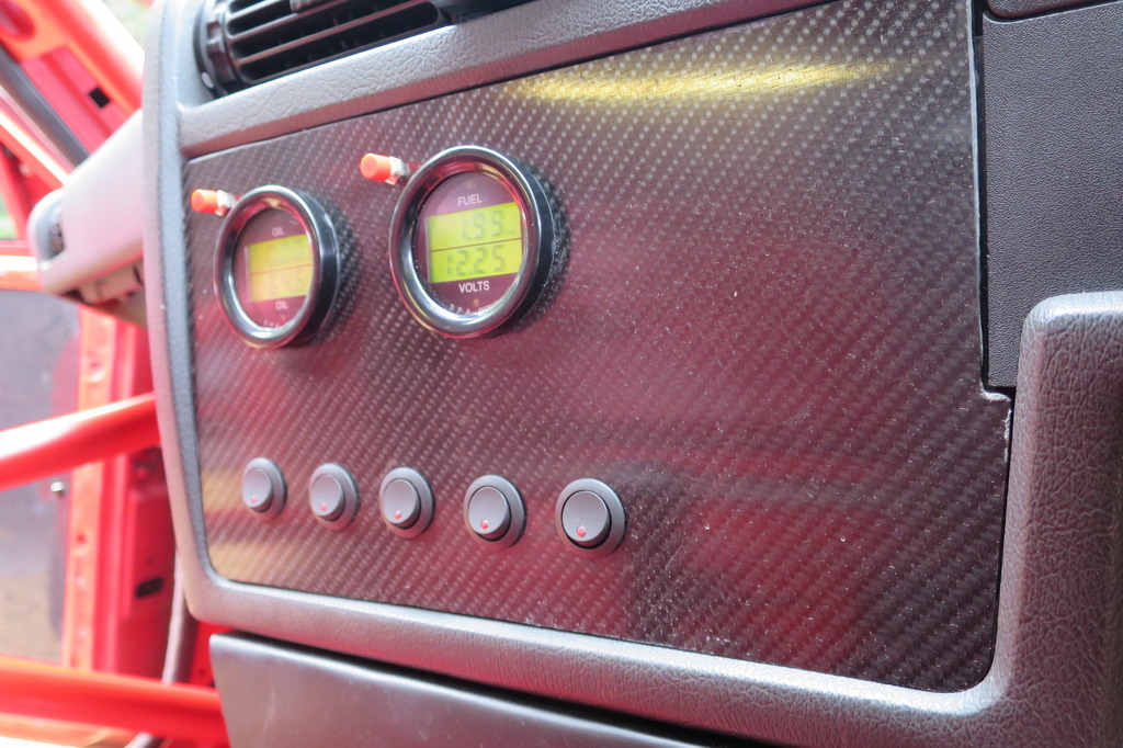

A couple of small jobs were required on the car. I fitted some switches to my dash. Only two of them are wired up at the moment. One powers the rad fan manual over ride and the other for my heater/demister. I also rewired my gauges as well so they are on an ignition fed live as opposed to being connected directly to the battery feed. Wired the switches up to the light comes on when the switch is active:

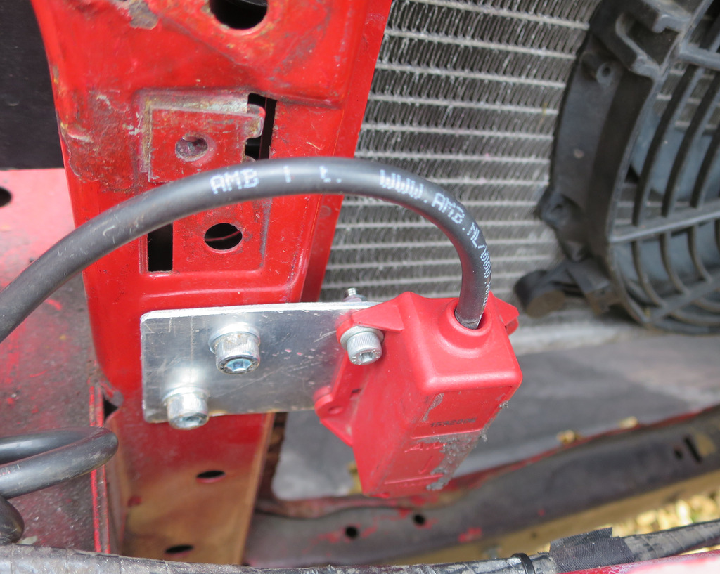

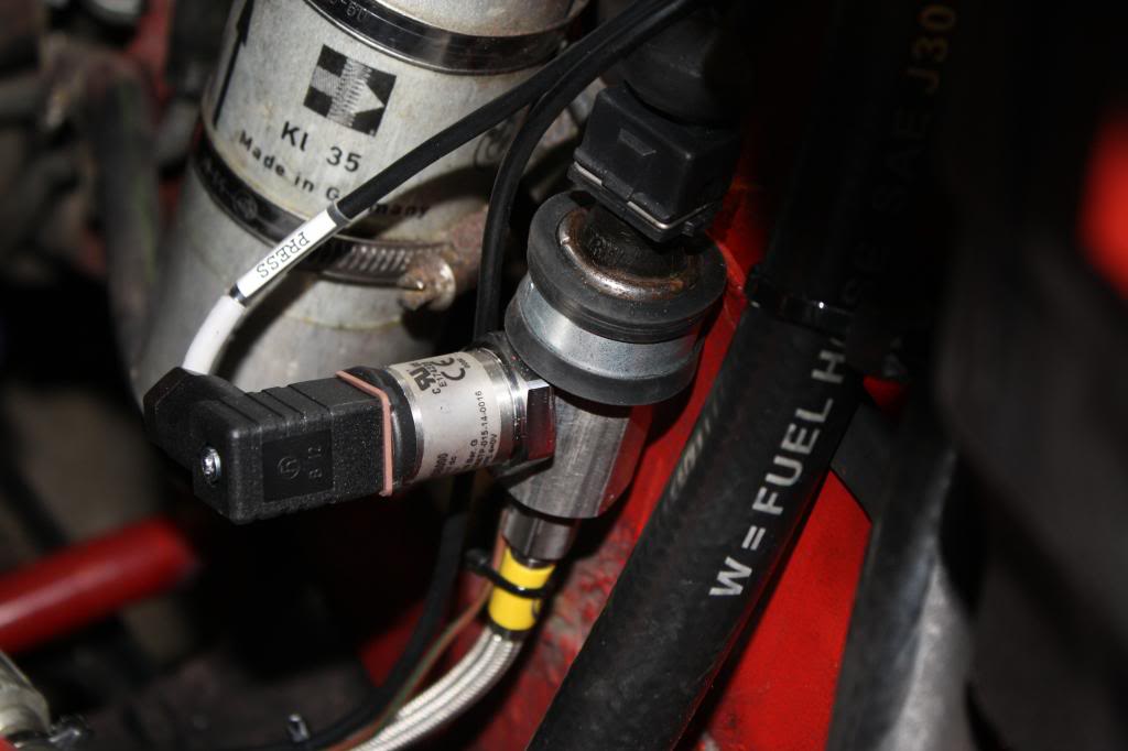

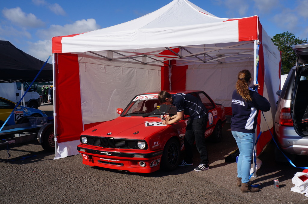

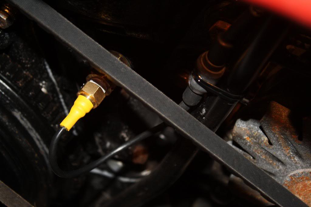

The other requirement was to fit my transponder which is what tells race control and the timing which car is which. I've used the redundant screen wash pump ignition live to power that and mounted it at the front:

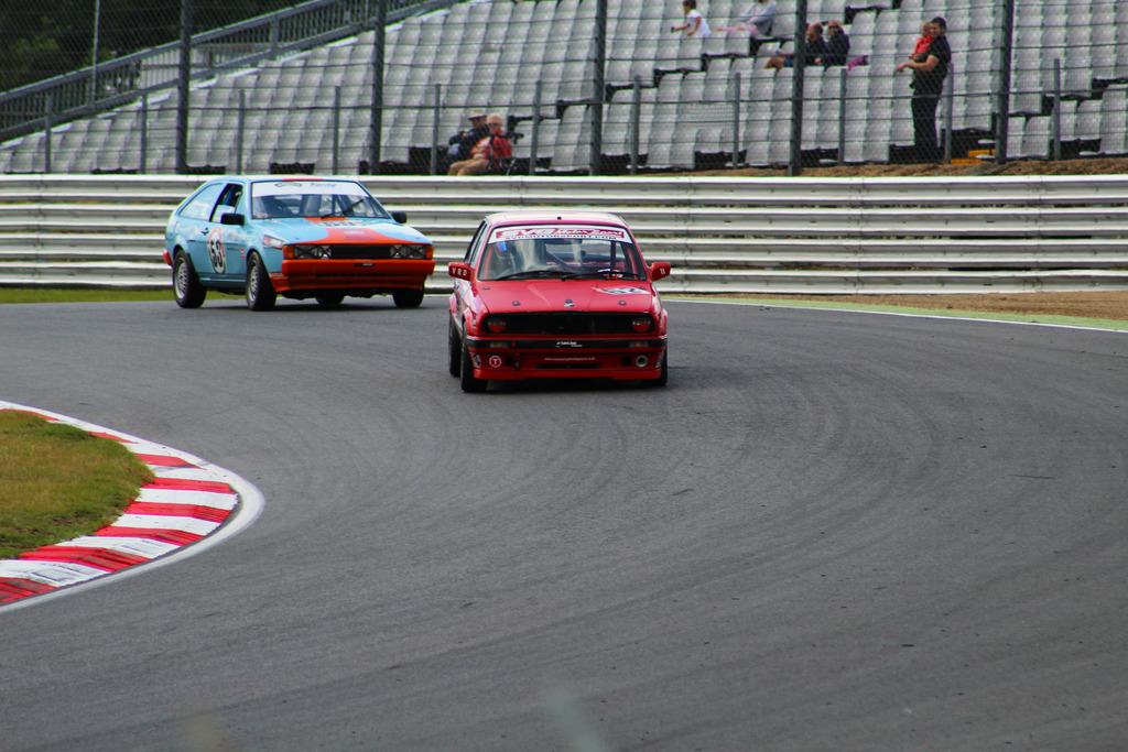

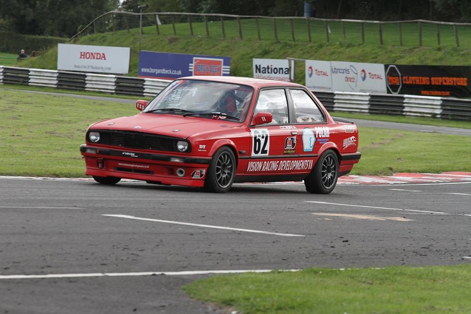

For now some photo's which my dear mother took:

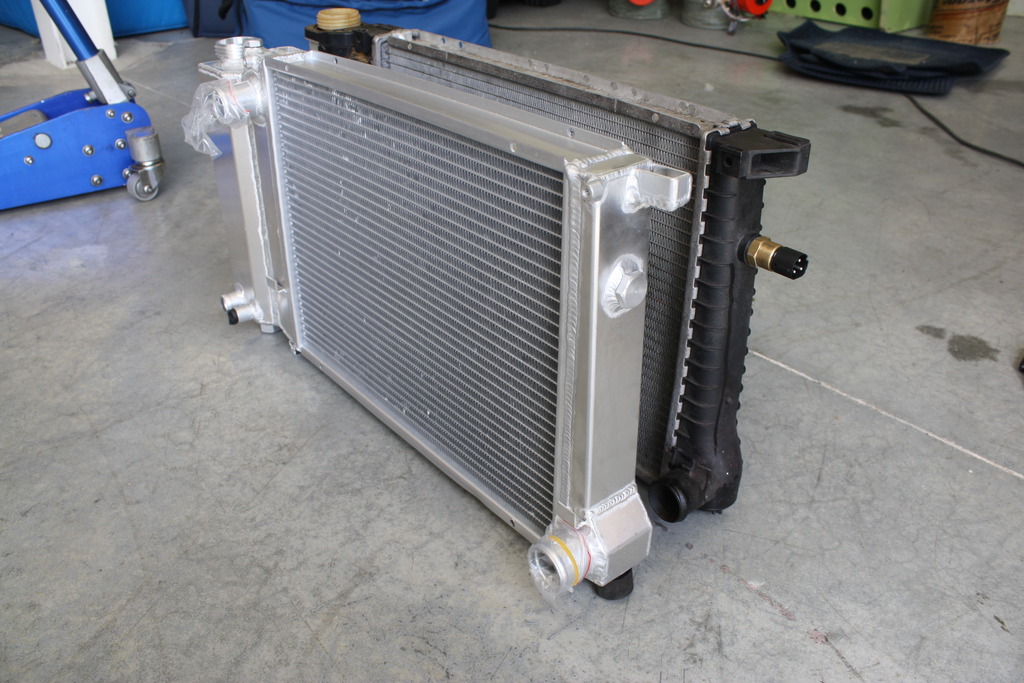

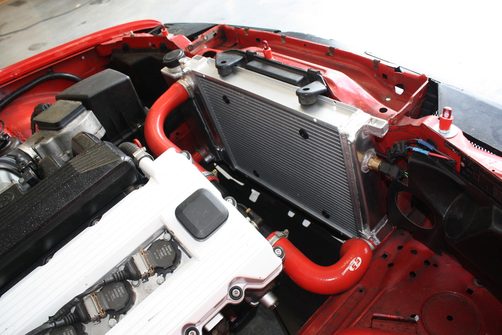

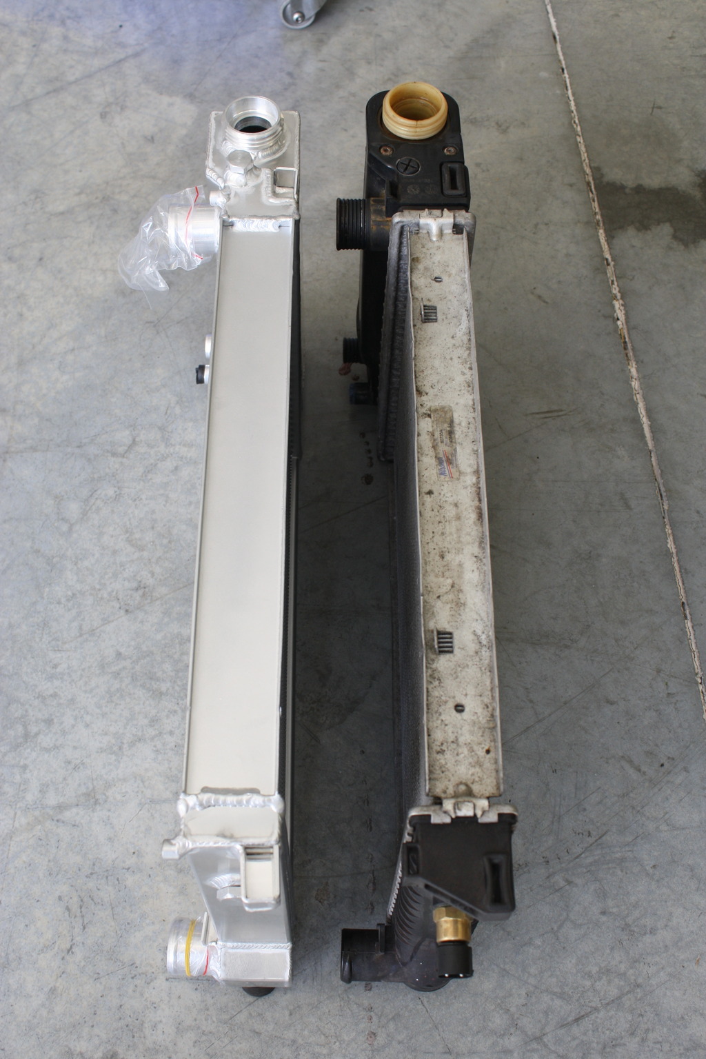

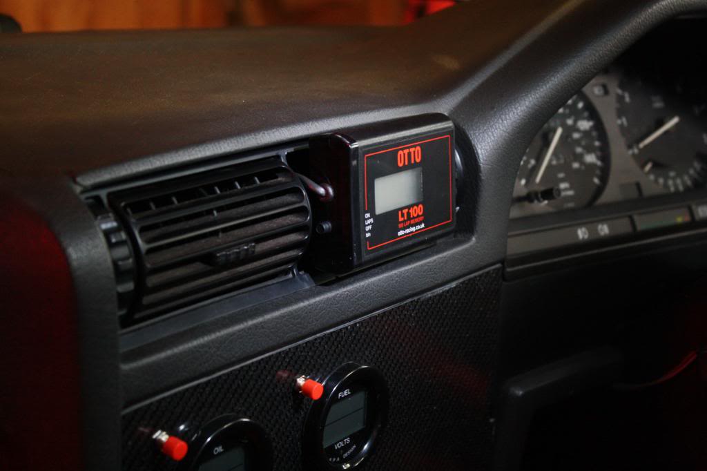

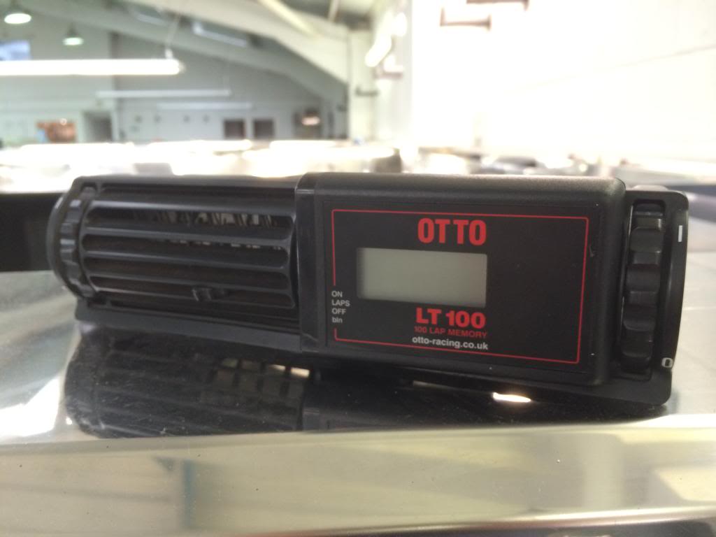

Had a little post Donington/pre Brands Hatch prep day yesterday. I had bought a few bits and bobs to put on the car this last week. First is a Direnza aluminium radiator. It has a slightly thicker core so will hopefully take more heat away from the engine and keep those oil temperatures in check as a result.

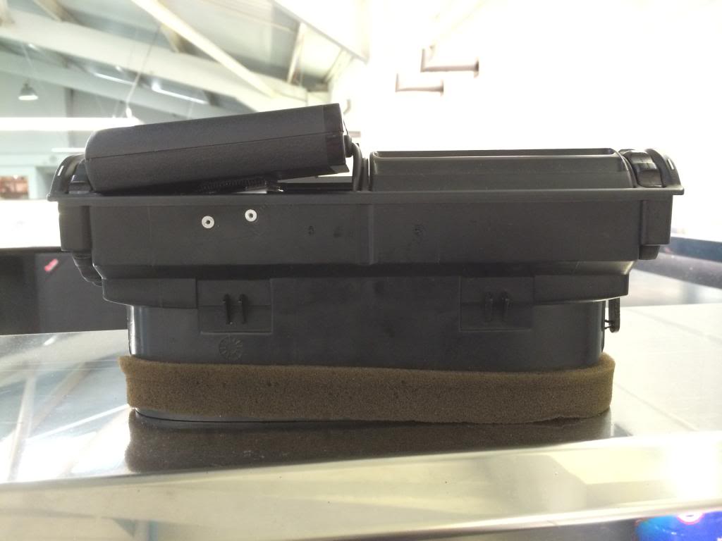

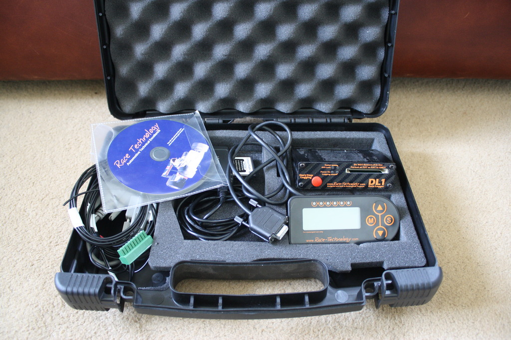

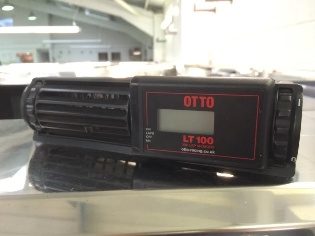

At Donington I forgot to ask any one to put my lap timer beacon on the pit wall, net result is I wasn't able to get my lap times on my OTTO lap timer. This wasn't the end of the world as it was more about just getting into the swing of things but the info would have been nice. 'Back in the day' when I used to look after cars in Kumho BMW Championship all of them used Race Technology DL1 data loggers with a Dash 3 display. The DL1 uses a GPS sensor to map the circuit and give you your lap times based on this. You can set markers and do quite a lot of stuff with it which I have yet to sit down and properly look at. So the bonus of this is my lap times will be displayed without having to place (and potentially forget) a beacon on the pit wall and the data is recorded so it can be analysed after the session. One of the chaps who I used to do some bits for in that championship did me a bit of a deal on his old DL1 Mk2 and Dash 3 full pairing so I had that off of him.
I'm going to mount the whole lot in the dash vents so I have removed them and will take it all to work and make it all fit in to fit when I get to Brands Hatch. I have fitted the GPS sensor and wired the basic power in so all I need to do is plug it in.

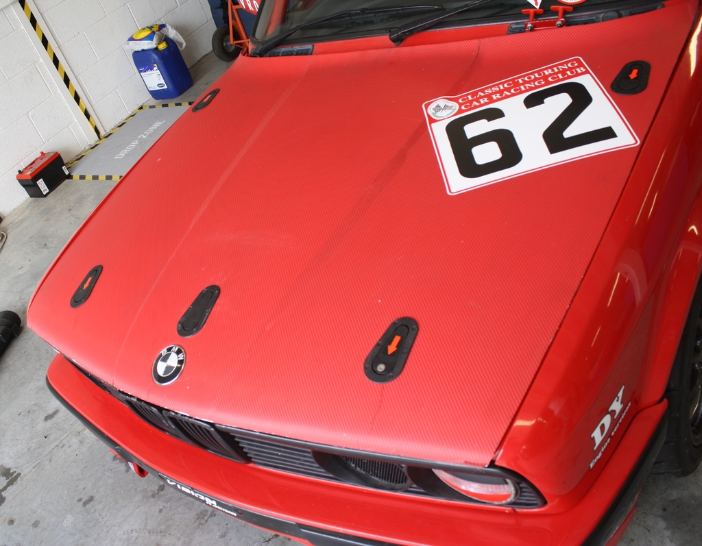

Finally for this time, many of you said I would need it when I fitted my bonnet originally and after the weekend I decided it probably was a good idea, to fit an Aerocatch to the centre of the bonnet. It wasn't lifting too badly but it was starting to flap a little bit on the long straights. I had one which was my emergency spare as I've seen them snapped and broken quite a few times by people being rough with them or in a collision.
I took a bit of time getting it lined up with the badge and trying to fine the best place for the pin. I used a pencil grinder to cut the hole out which made life much easier than previous efforts stitch drilling and filing due to lack of compressed air. I need to get some more arrows so they all match now and that'll be a good job done.
