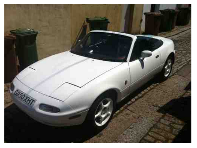

After browsing ebay for many hours and weeks hunting for a bargain, I finally came across this....

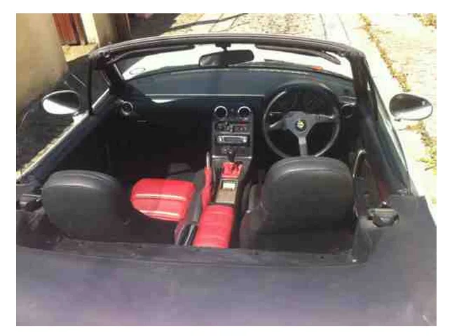

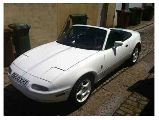

A 1990 Mk1 Mx5 1.6 115000 Miles, Mot'd Till march been owned by the same person for the last 7 years. Red/Black leather seats, K&N Induction recent going over of the under body, sealed and welding done.
It was delivered by the owner to my door for £450.
Engine and gearbox is in perfect running order no dodgy Idle or smoke. Few patches of rust here and there but its 21 years old!

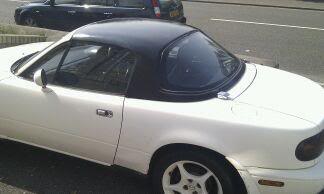

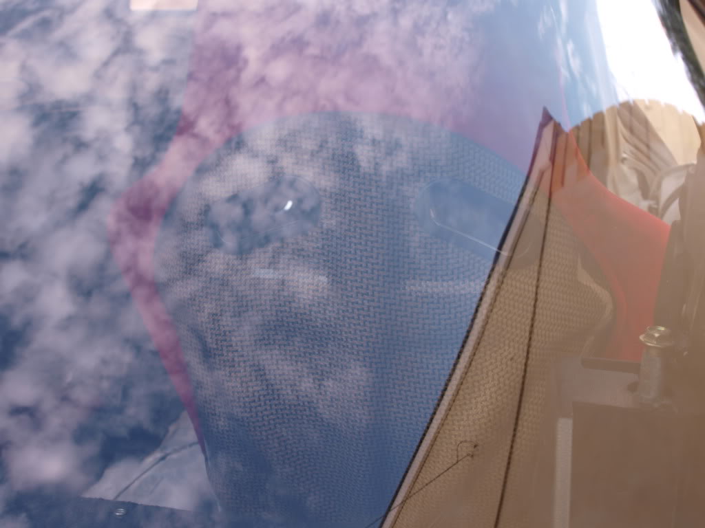

Bought a Fiber glass hard top to keep it weather proof through in winter months. A steal at £140

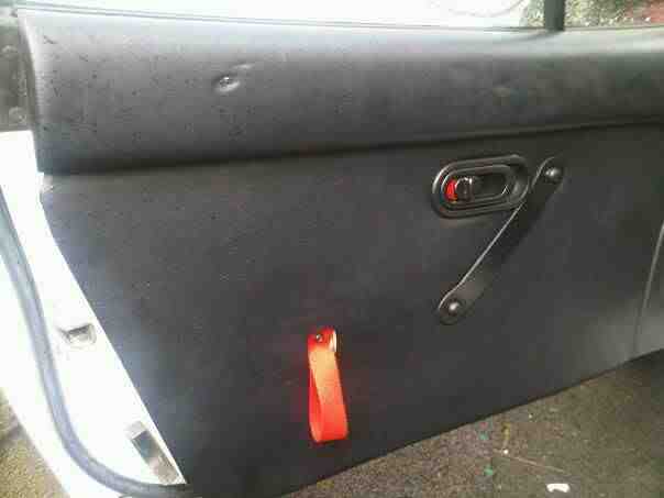

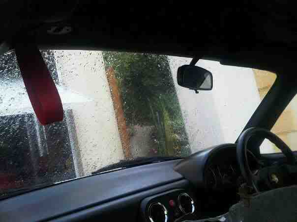

Fitted door straps :

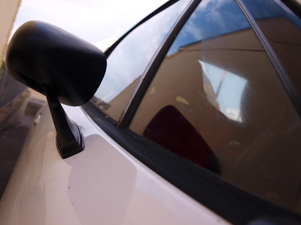

Made grab handles

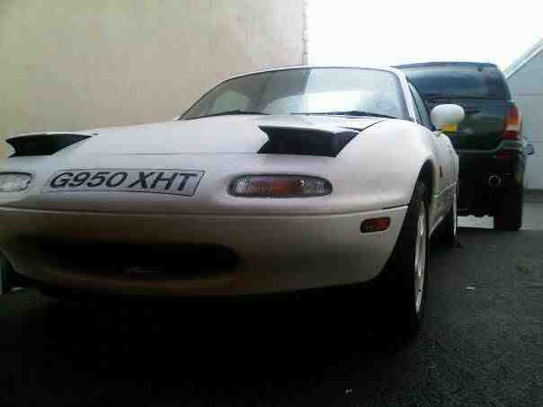

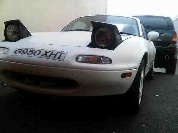

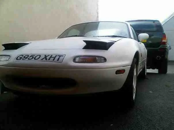

Sleepy eye kit. I also removed the 2 front tow hooks as they were seriously rusted and fitted a mesh grill to tidy up the front.

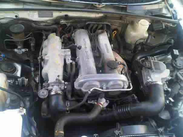

Engine wise i removed the charcoal canister and fitted the factory air box back on as the previous owners attempt at induction was shocking. Going to get a free flow filter on to it and run a Caf feed off the rear of the box down to the lower part of the front bumper.

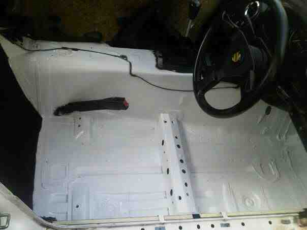

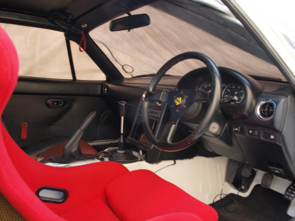

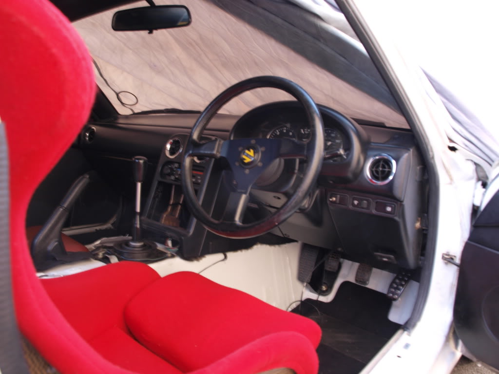

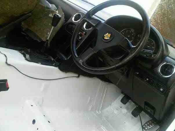

I then set about striping the drivers side of the interior and giving it a lick of paint. Ready for my carbon kevlar bucket seat next week.
The hardtop is going to be carbon wrapped and I also ripped the soft top out. All in aid of weight loss :p
