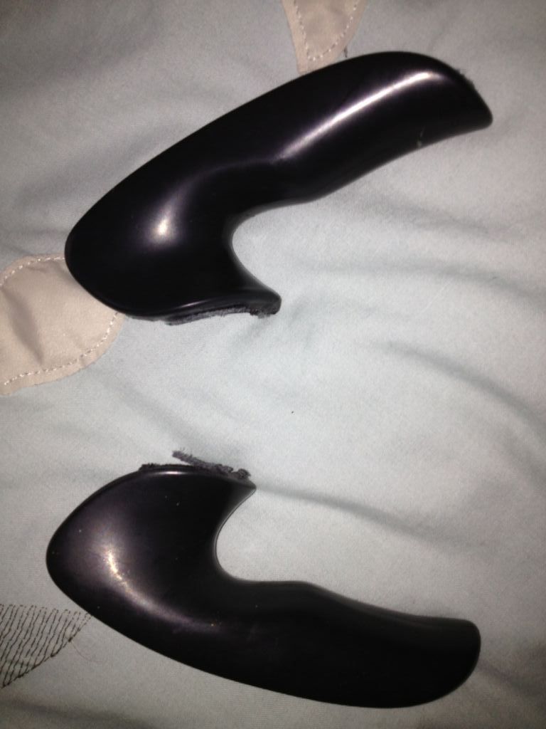

I know theres a few guides out there for making new thumb grips for the torn ones. Its not going to look the best but Here are my efforts so far.

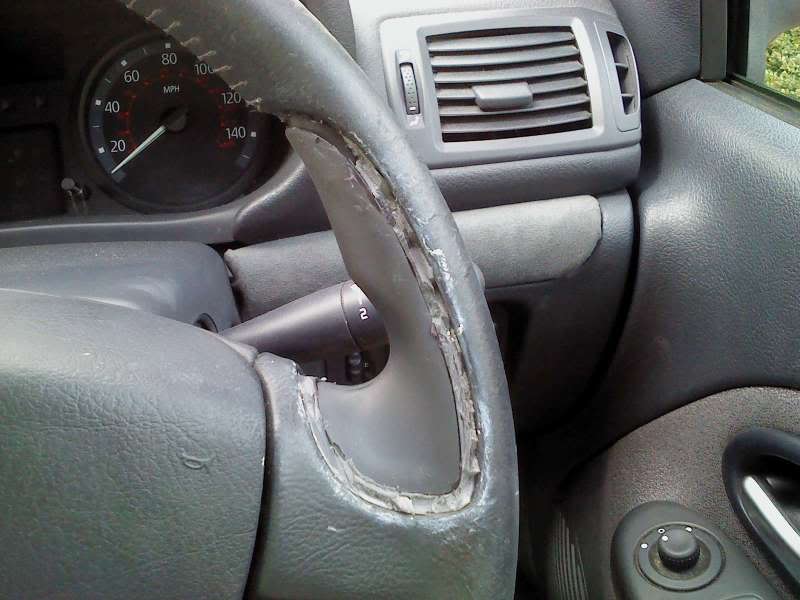

first I picked off all the rubber so your left with this
then I wrapped where the grip was in masking tape so the puttey wouldnt stick to the steering wheel

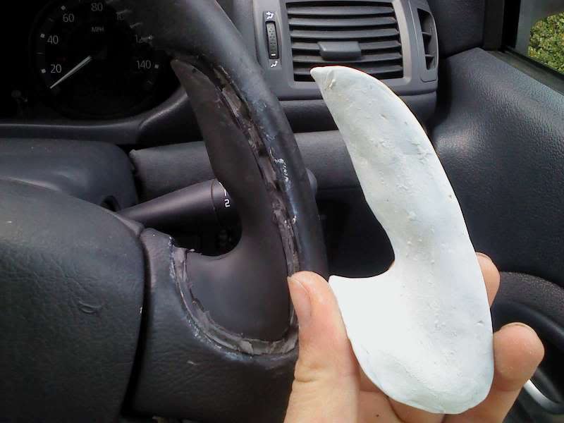

then I mixed up some repair puttey ( i got mine from halfords for £5.50) and made a pancake shape with it.
I then worked it into the grip area to make the grip shape.
After a few hours it was rock hard and I teased it away from the wheel.

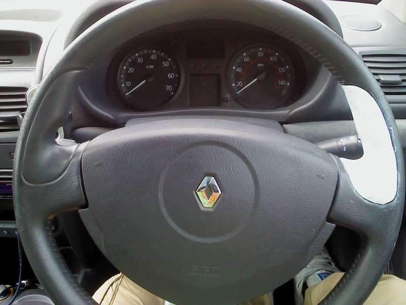

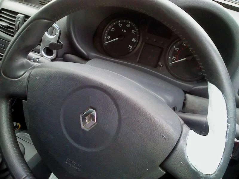

Hey presto, a rough shape of the grip ready to be sanded and painted. When your done, just glue the bugger in!
I will update on mine when its all finished.

Need to make an effort like you have. Looks good so far.
