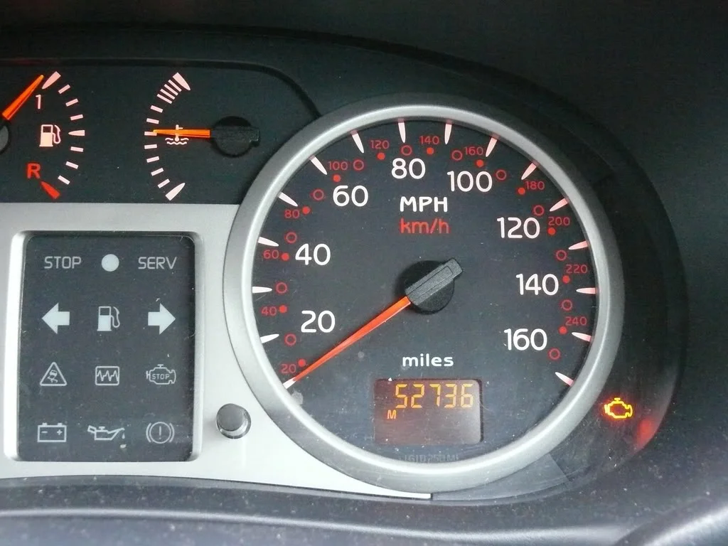

My Toxic Fume Monitoring Warning Light came on?
Car  Megane RS 275 Trophy
Hi all can any body help me with this one?
My Toxic Fume Monitoring Warning Light came on today I have a standard exhaust no DE-cat and as you can see from the pic the car has done 53736 miles and by the look of the pic (IT NEEDS A BLOODY GOOD CLEAN:o )
Am I OK to use the car or do I need to get this sorted if I get it sorted what needs doing and at what sort of cost?
Don't worry about it, it will probably go off in a few days.
If it doesn't you could check the lambda sensors that go into the exhaust haven't come loose.
Sam
Will have a look at that, I have a 150 mile trip tomorrow and was worried about driving the car, so it's fine to drive with the light on?
Should be fine to drive round on you need to find out what the problem is most likly the lambeda sensor brken but it could be anything realy.
I've got an OBD II code reader that can read the fault and reset the light. I'm around St Helens/Warrington etc daily, and Liverpool all other times.
If you came to me I could give you a fault code/list of problem(s).
For nowt obviously
