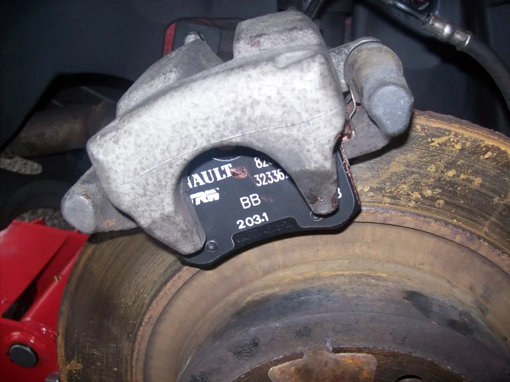

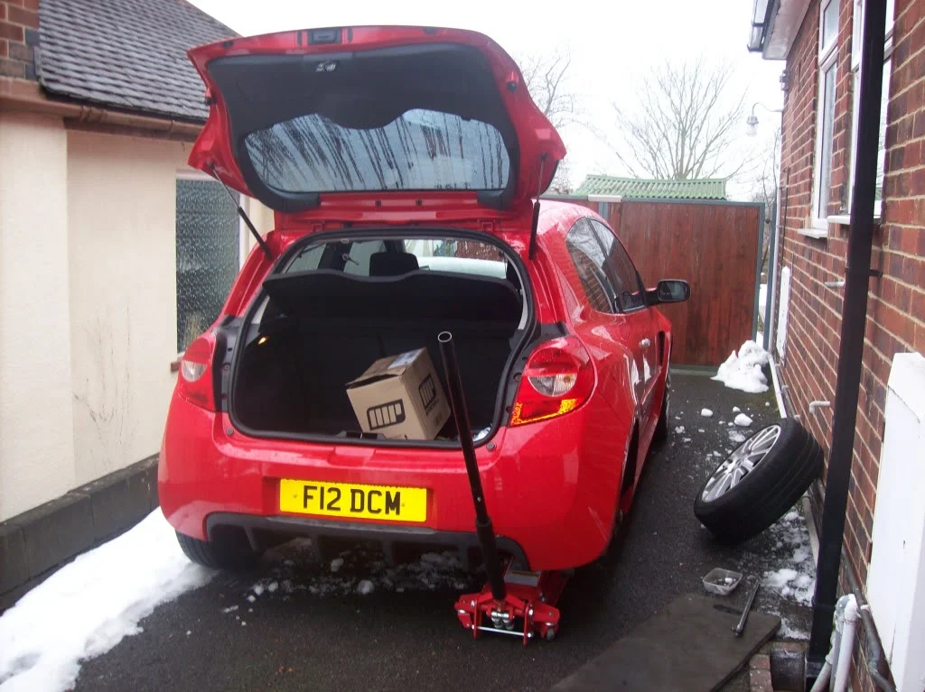

Well today has been the first time I have laid a spanner to my 197, came out of work the other morning after a long night shift to find my handbrake wouldn't release. After giving it some abuse it realeased but the pads were still binding a little so seeing as they were rather low I thought I'd replace them.

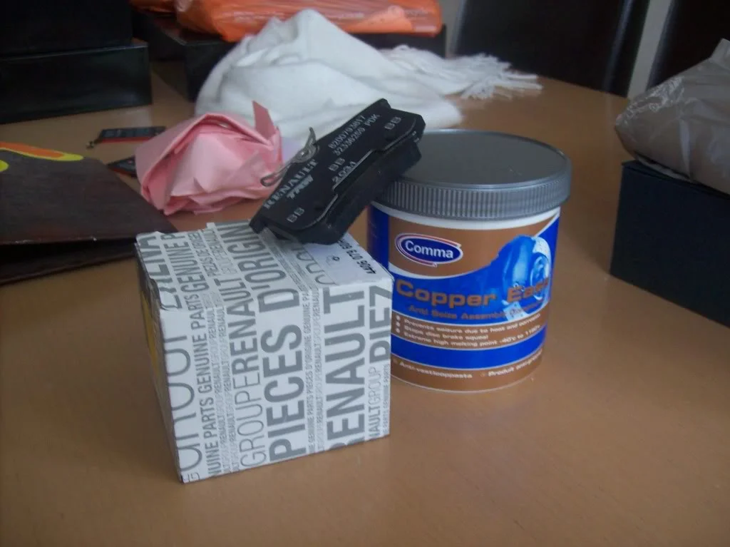

New pads from my local dealer
Not the best weather conditions for work.

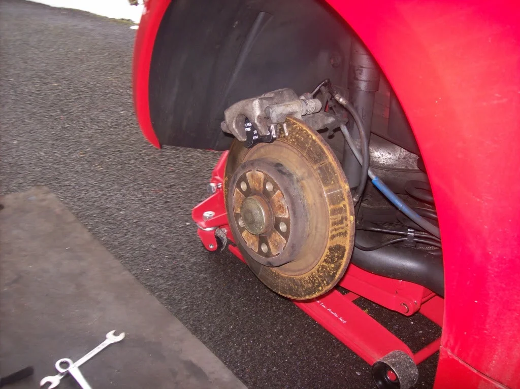

Car jacked up

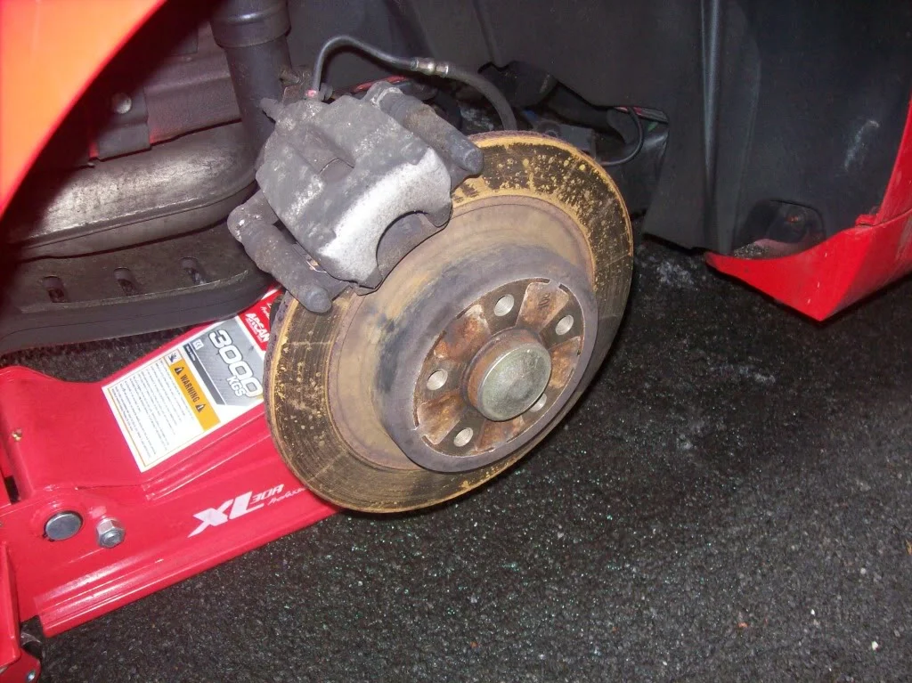

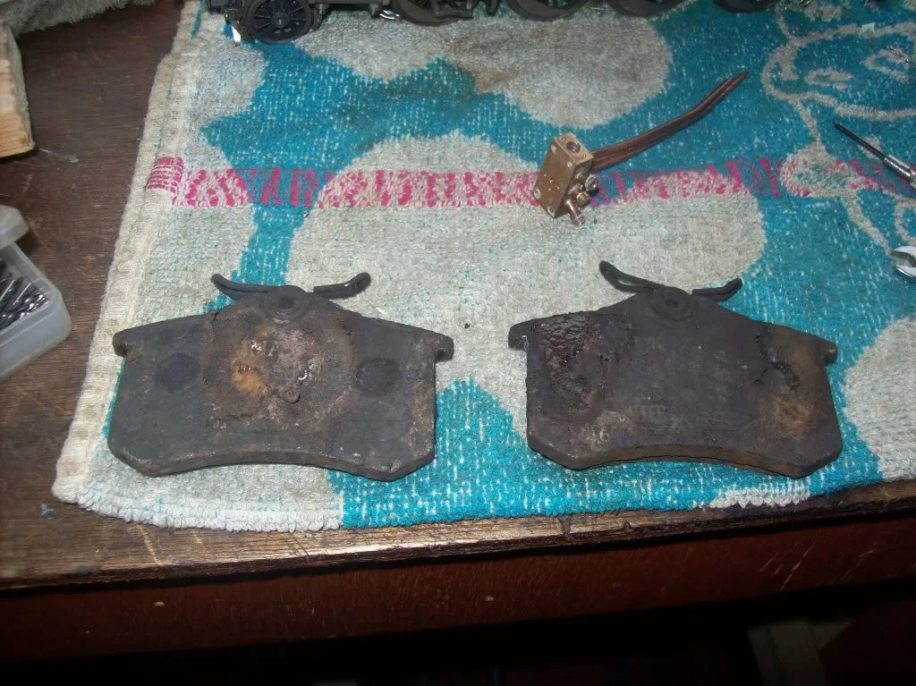

The old brakes looking sorry for themselves, measured discs with vernier caliper guages to check thickness is within spec.
Old pads have certainly seen better days

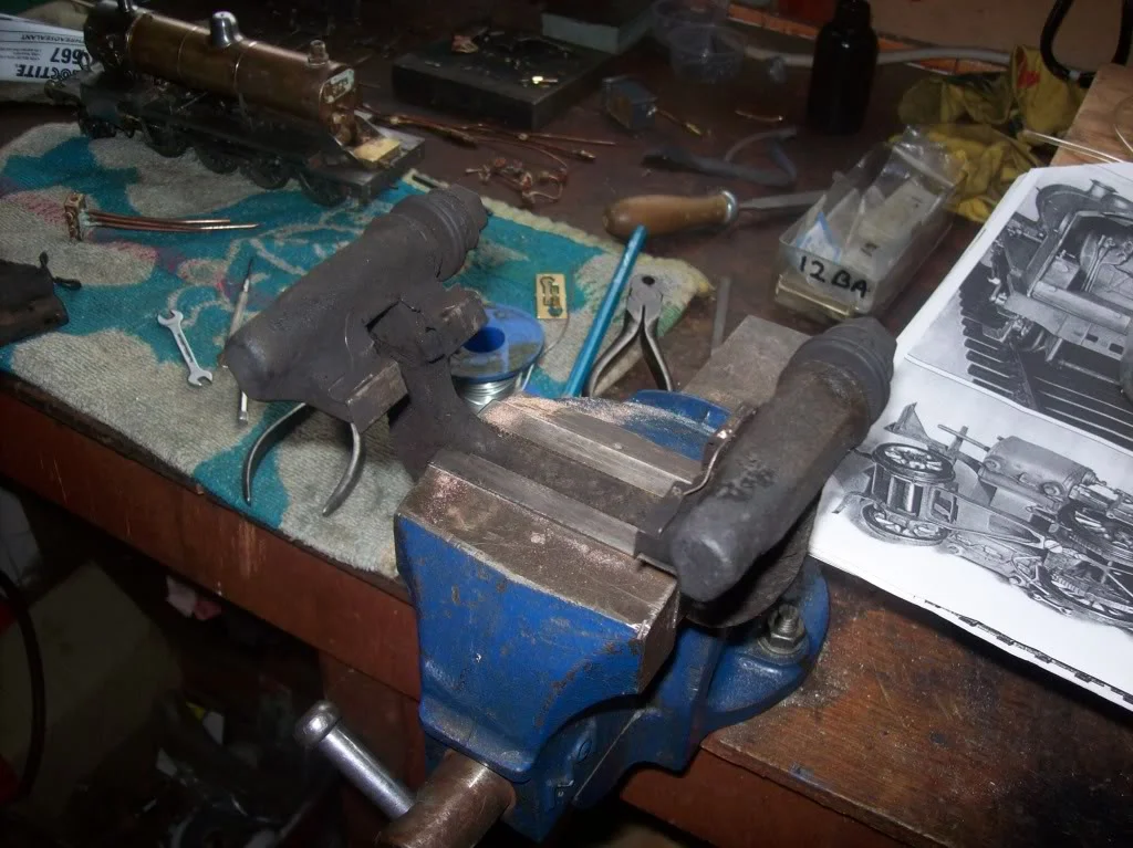

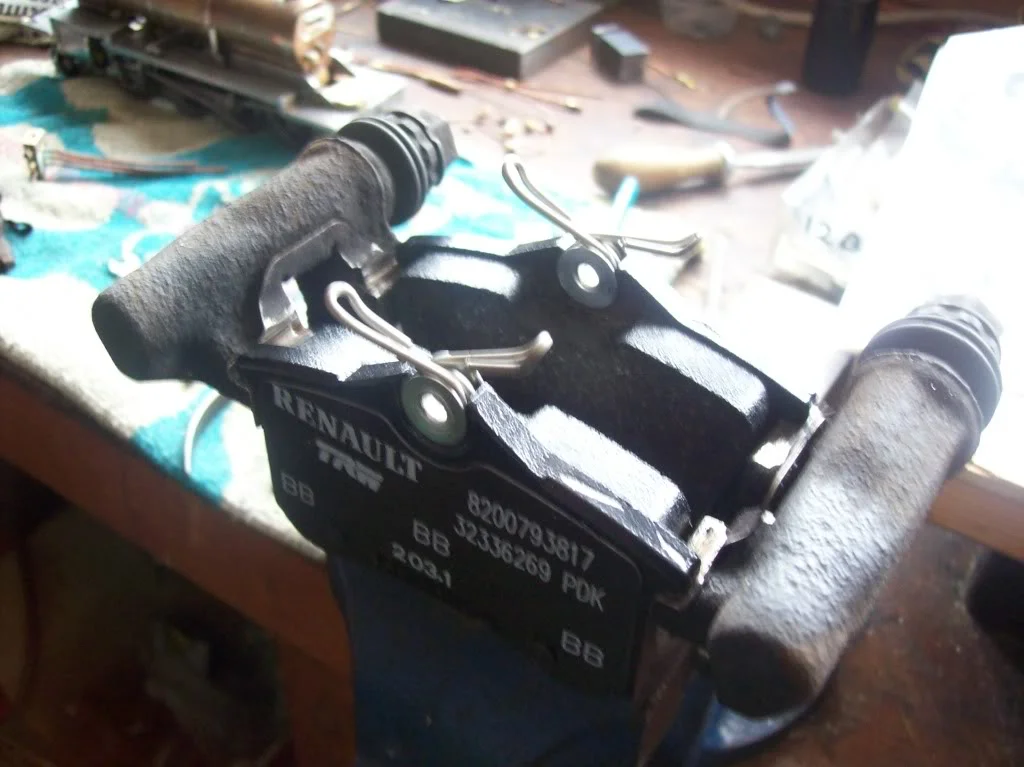

Giving the pad carrier a nice clean up in the vice.
Trial fitting the new pads making sure they slide nice an free.
All fitted :)
Then just to repeat on other side an road test an glad to say its sorted it :)

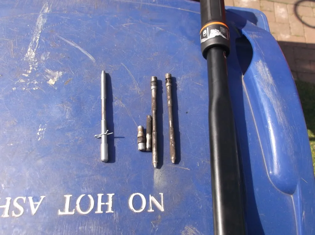

Well bin a while since last update but bin busy with other stuff (work, fixing others motors etc), well on me last update I mentioned I'd brought some ds2500 front pads as I didn't rate the standard stuff. Well no wonder I didn't rate um, front pads looked low so I thought I'd better get me arse into gear an change um. Well I was well prepared, new brake pins (diiferent design that don't get stuck) an nice weather. Started on the passenger side, pins shot out nice an swift an outer pad was removed with ease. As for the inner pad that was a different story, it hadn't worn so much so it was clearly stuck in position so no wonder they were naff so I un bolted the caliper for better access an knocked the old pad out.
Refitted the new pads an moved onto the drivers side. Well pin number 1 shot out but pin number 2 was playing silly sods. Hitting it that hard it started to bend so I pulled out the angle grinder an cut the old one out. Then a little more work with hammer an punch it was out. So after 20mins all was good an new pads were in. Didn't take many pics cause I just wanted to get on but heres a few.
Old pins an old knackered pin next to new design pin.
Tools, tools an me in action.

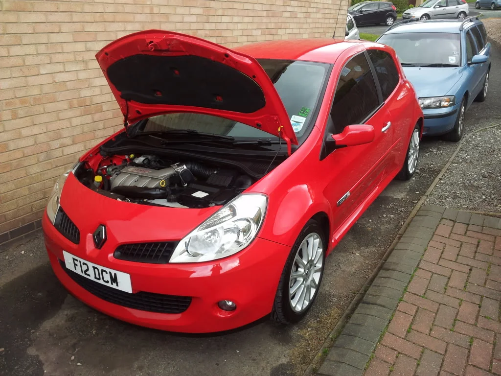

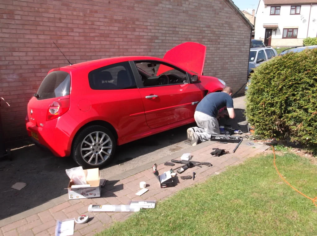

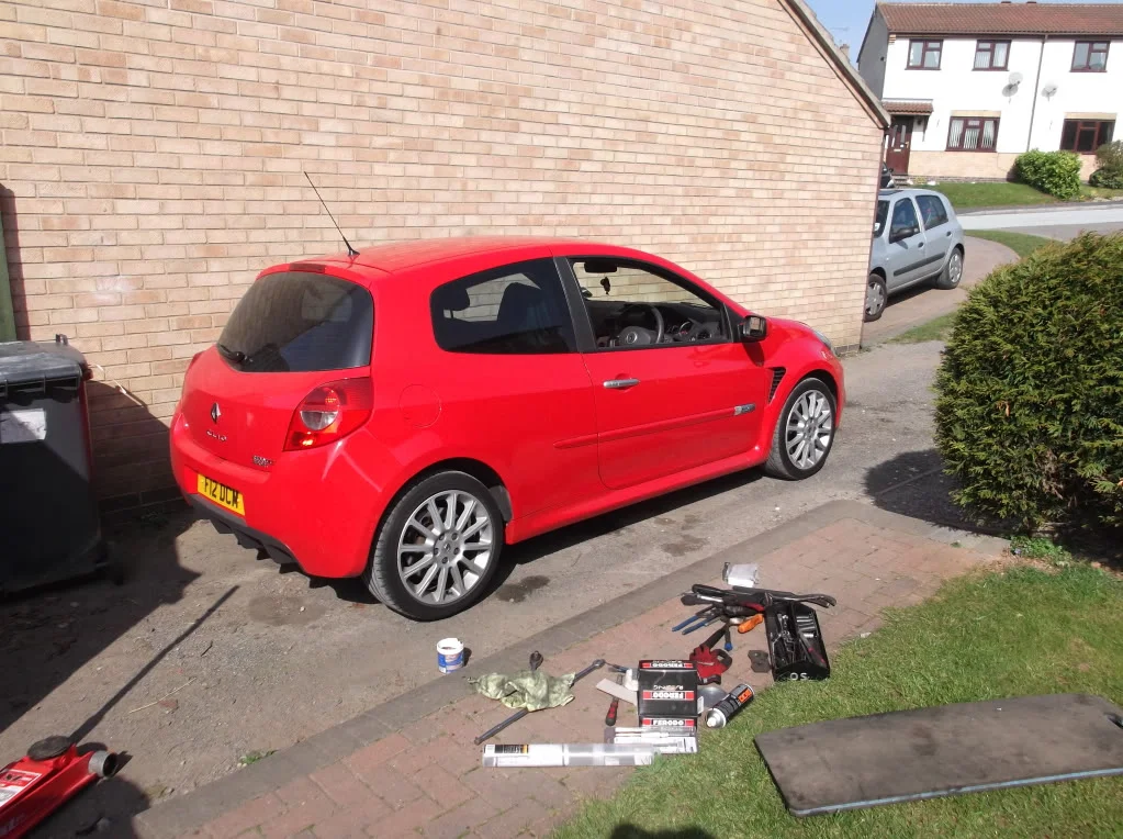

Well finally got round to servicing the 197 today (always to busy sorting other folks motors), so thought I'd post up some pictures.

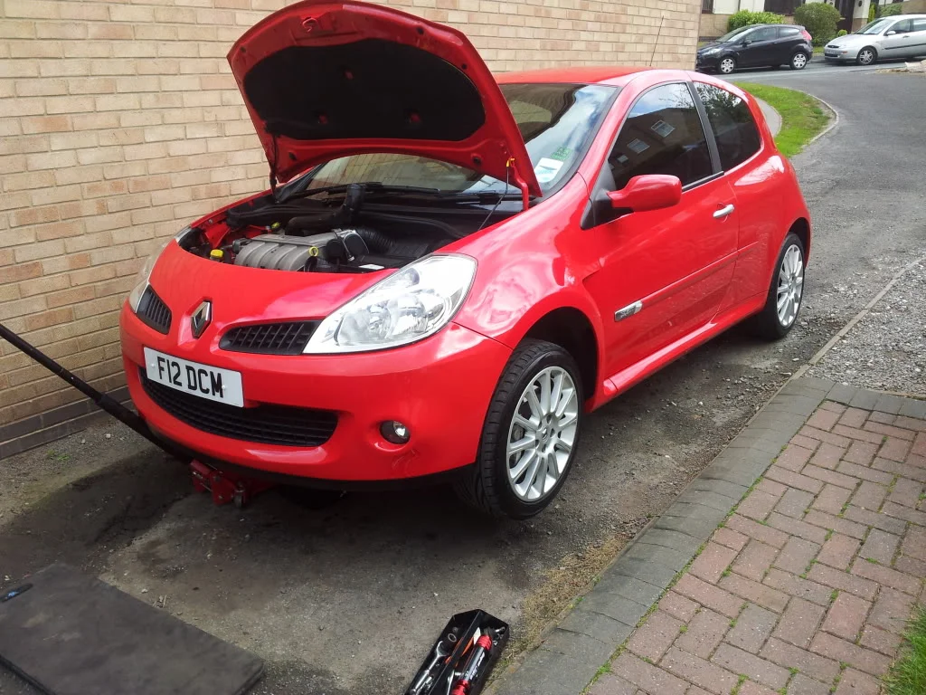

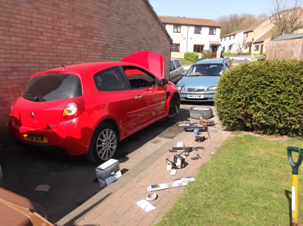

So heres the 197 sat ready an waiting for some tlc, an the sun beaming down for a change!

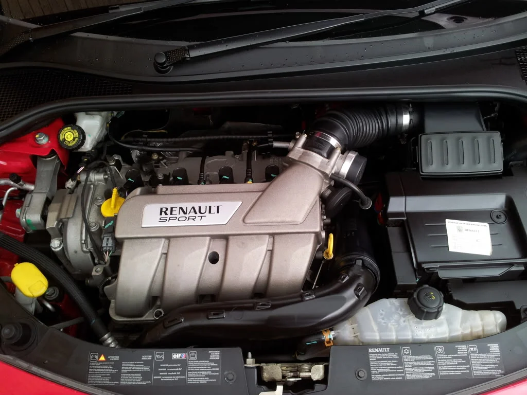

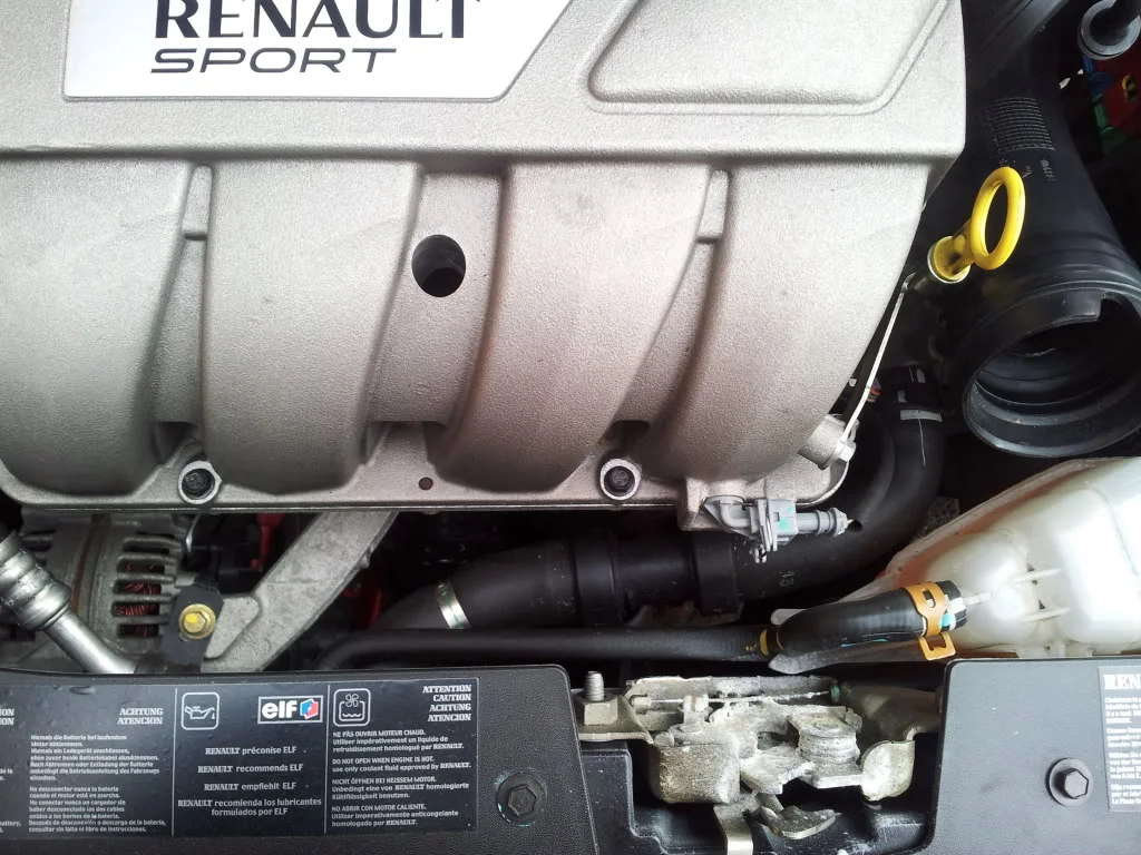

Nice clean bay, always a pleasure to work on

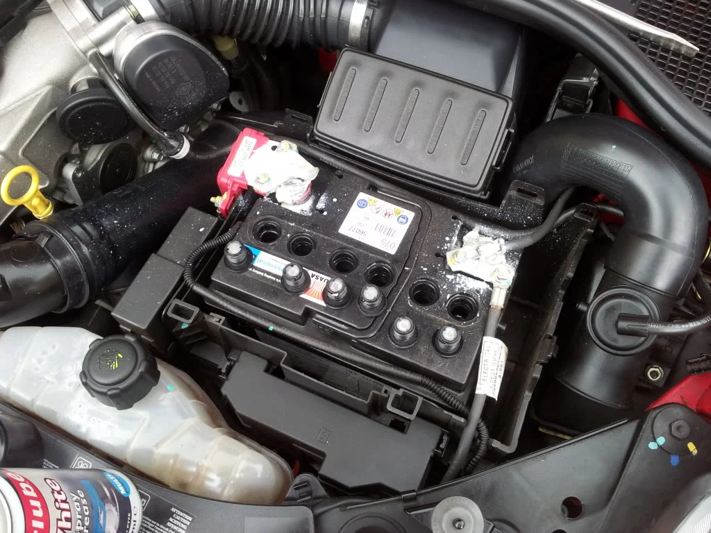

First of abit of battery maintenance, checking the electrolyte levels an grease the terminals

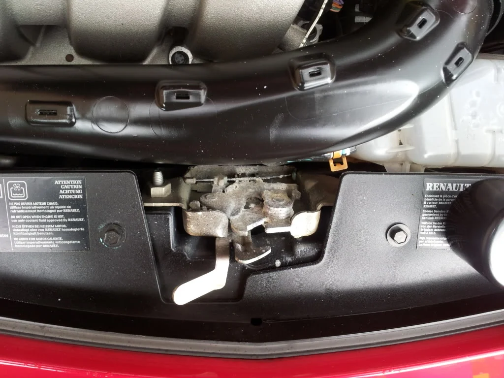

Then check the bonnet release an all the other locks an hinges on the car an give them abit of grease.

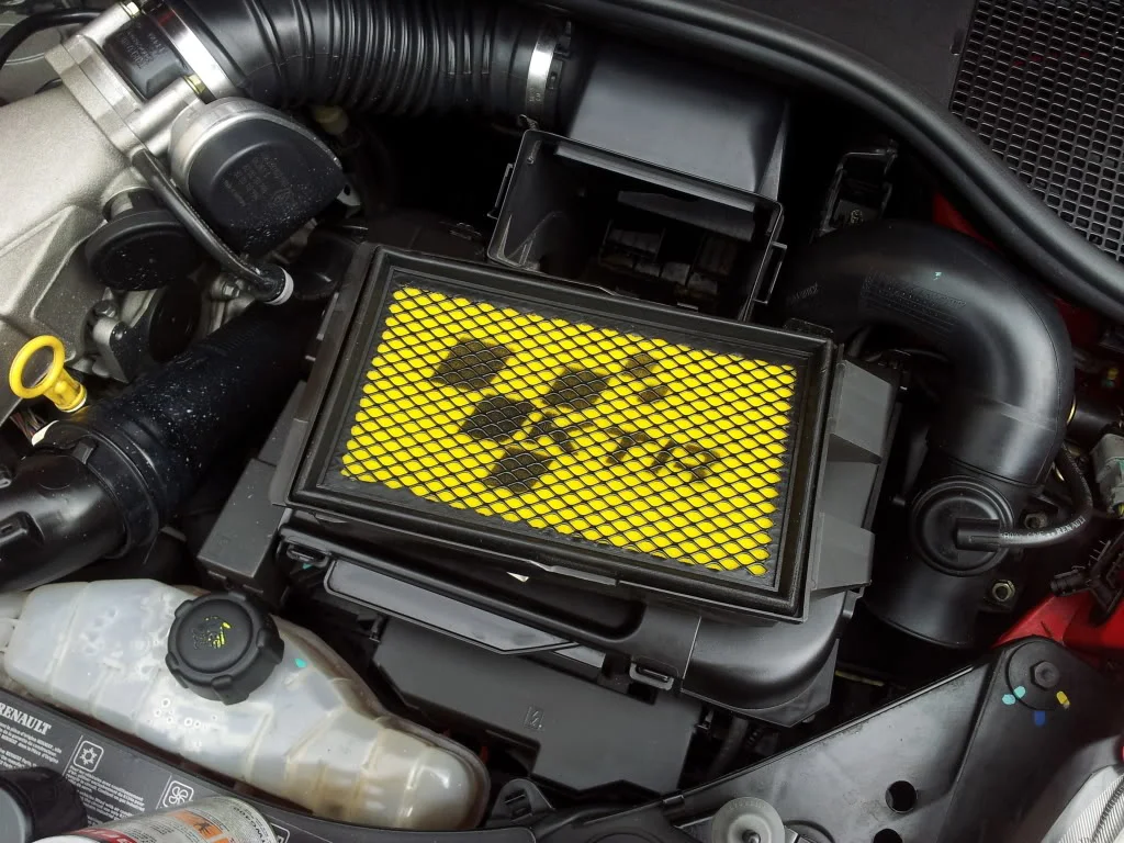

Then check the air filter element (was only replaced other week but always worth a check)

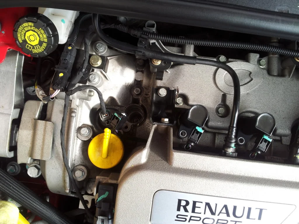

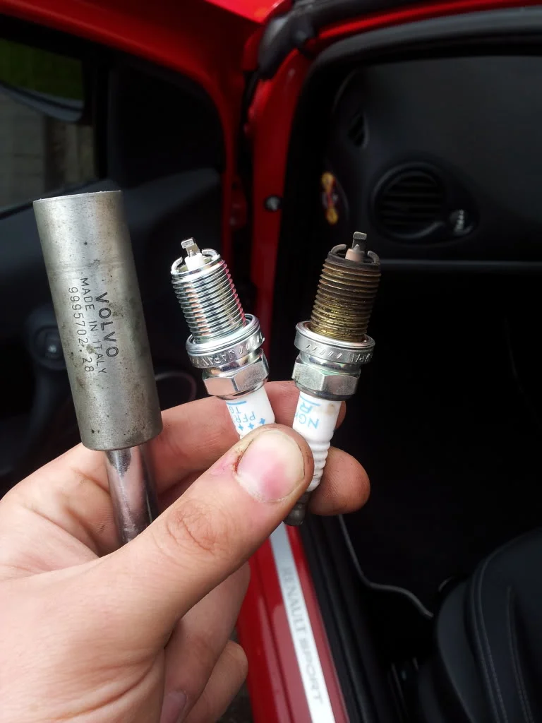

Then down to changing the plugs,

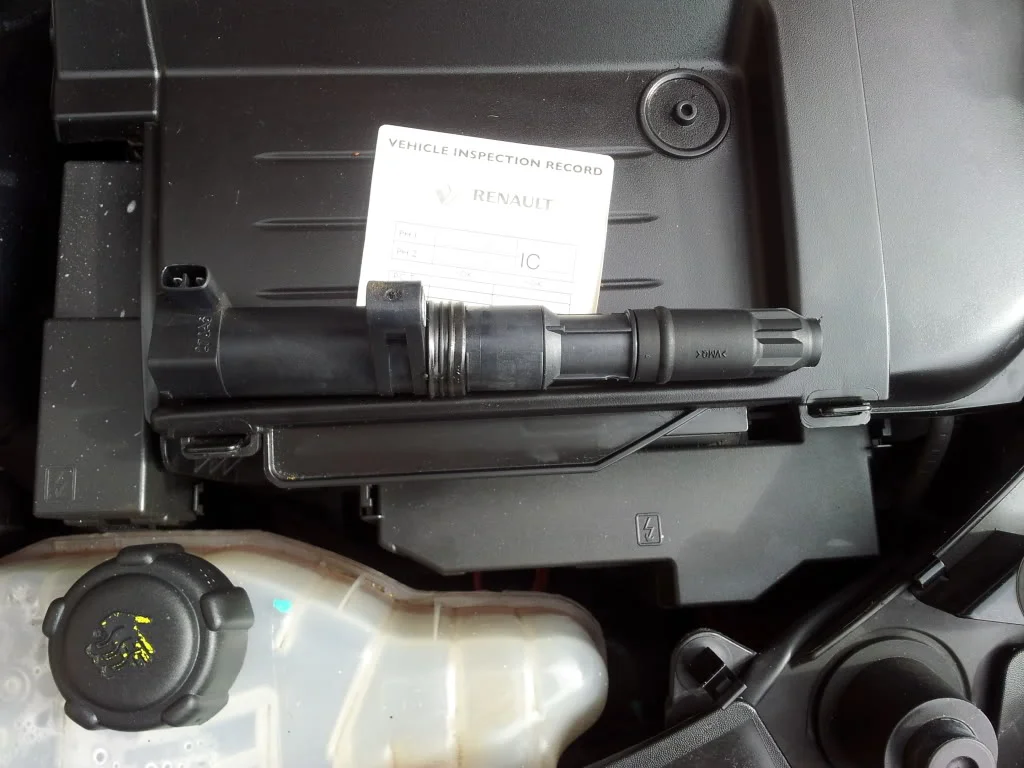

checking all the coils for any visual damage
new an old (an a cheeky volvo plug socket)

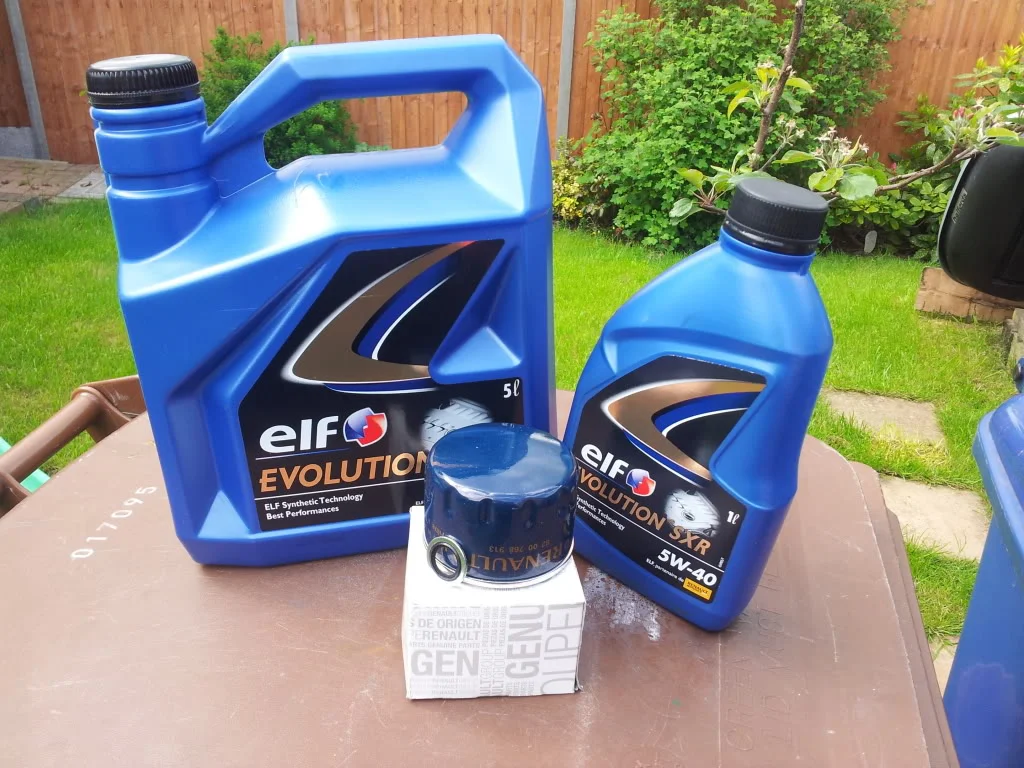

New oil an filter

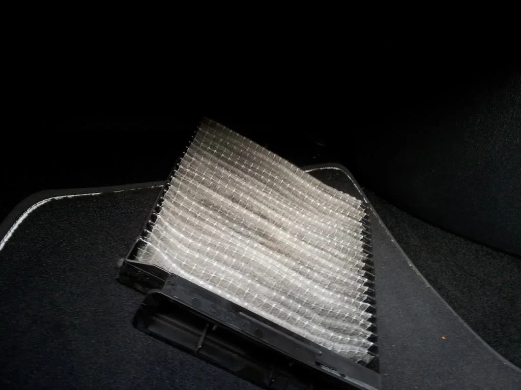

then onto the pollen filter, must say it was one of the easiest ever (change for a renault)
new filter

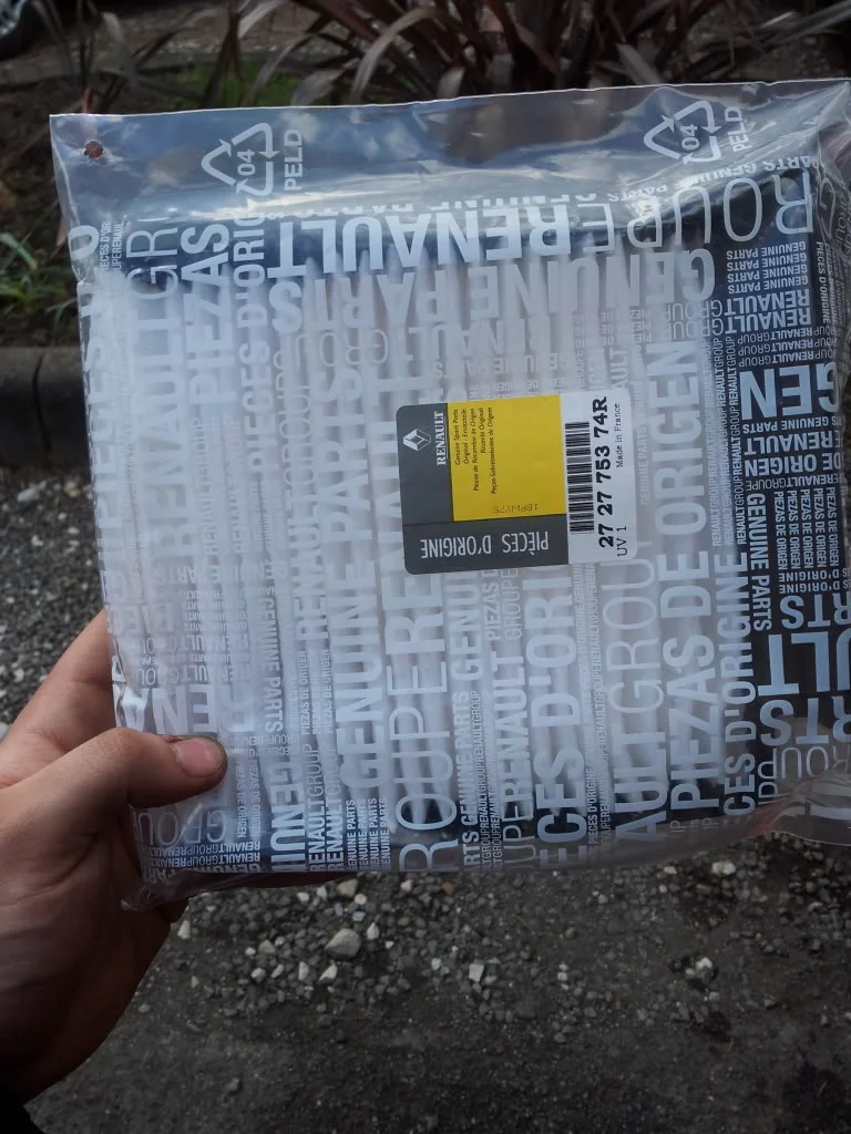

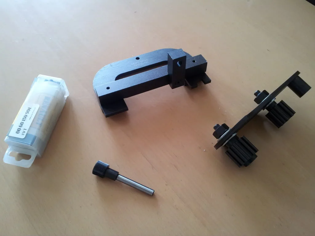

An heres a little teaser for my next installment, little package from me renault dealer
Cambelt locking tools
Been borrowing them for quite a while from me friendly renault dealer but thought it was about time i'd by myself a set.
