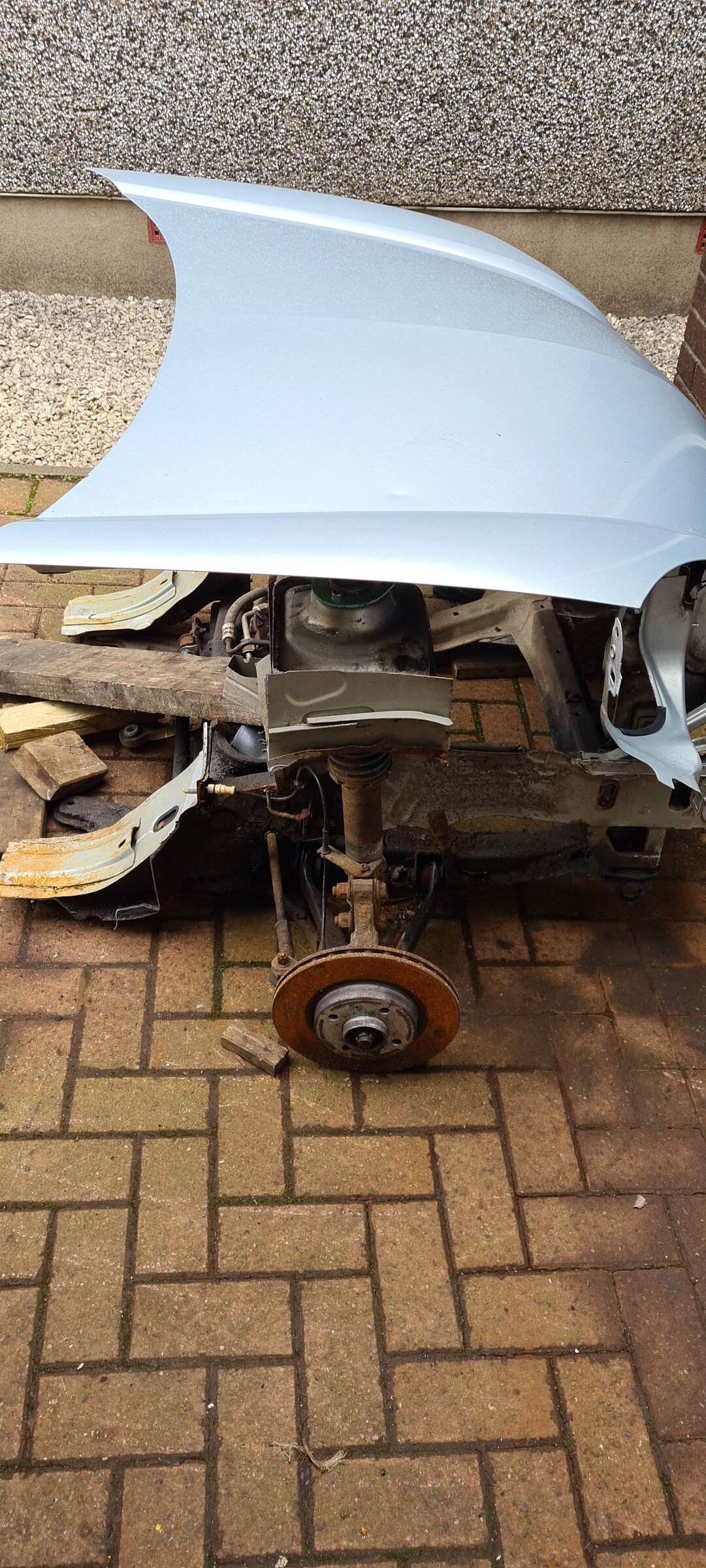

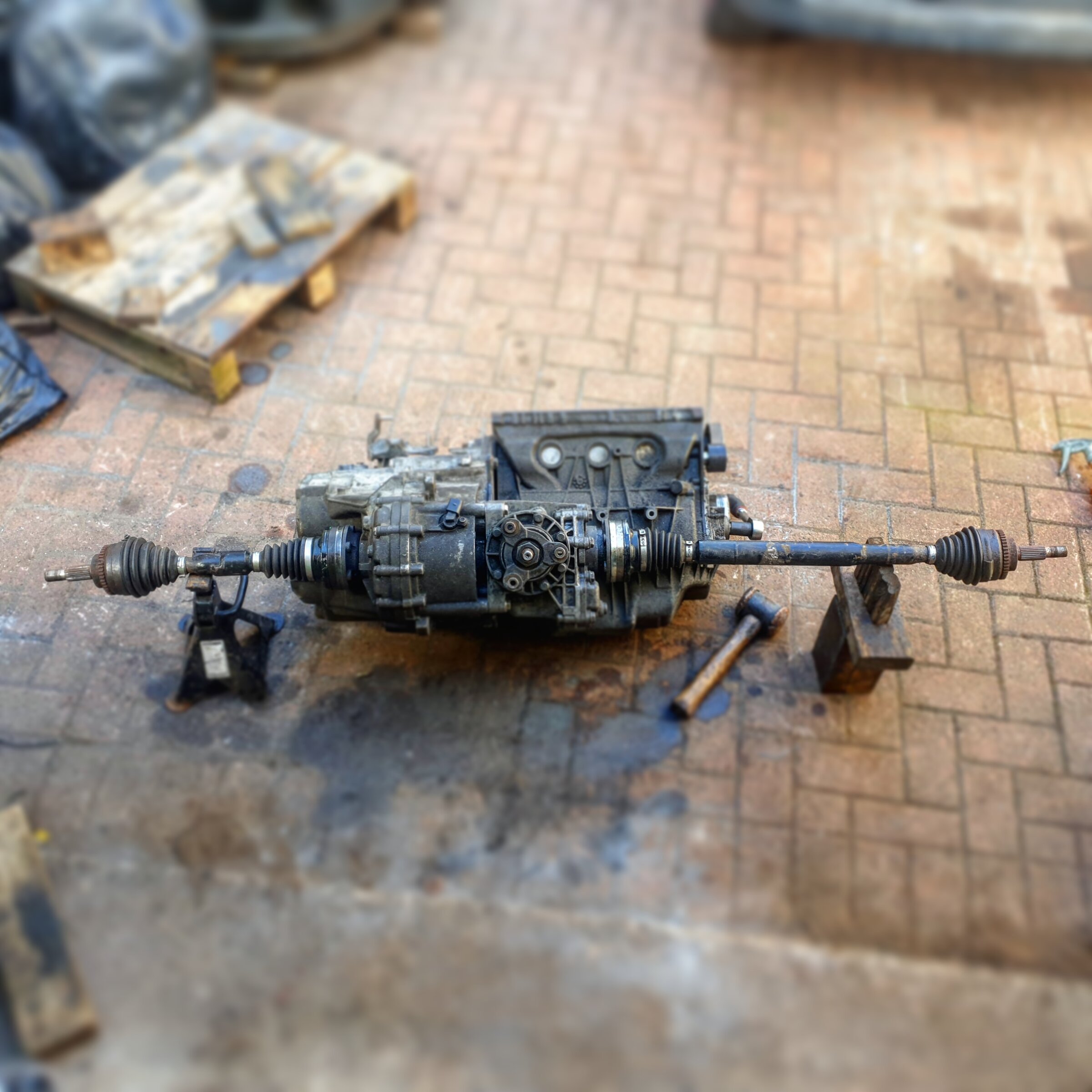

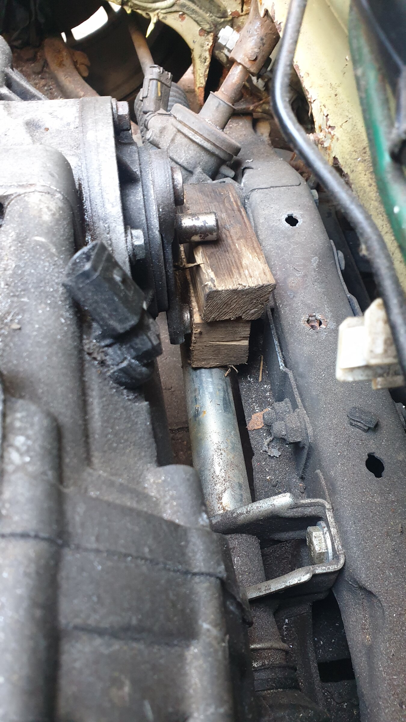

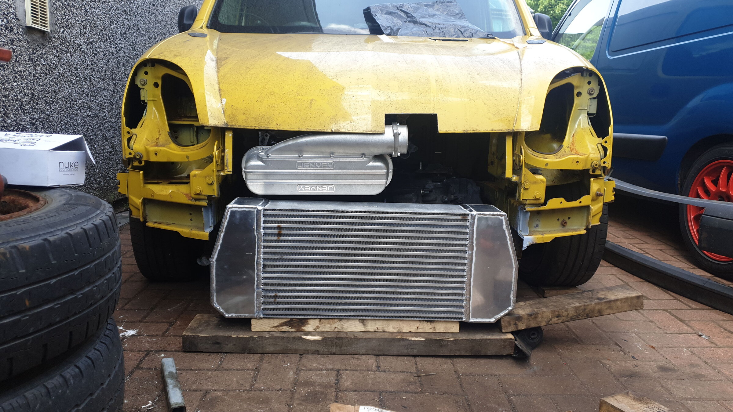

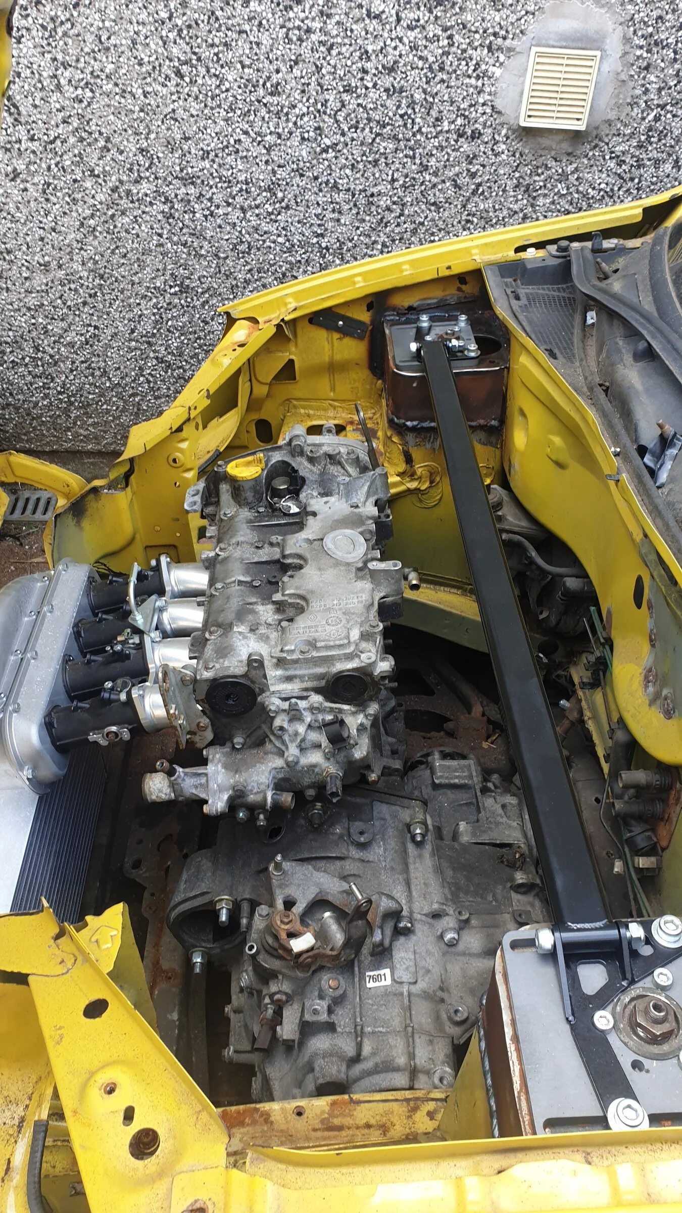

Got stuck into the quattro box seeing what's what with it. Got it on still close and have some issues but looks like It'll work

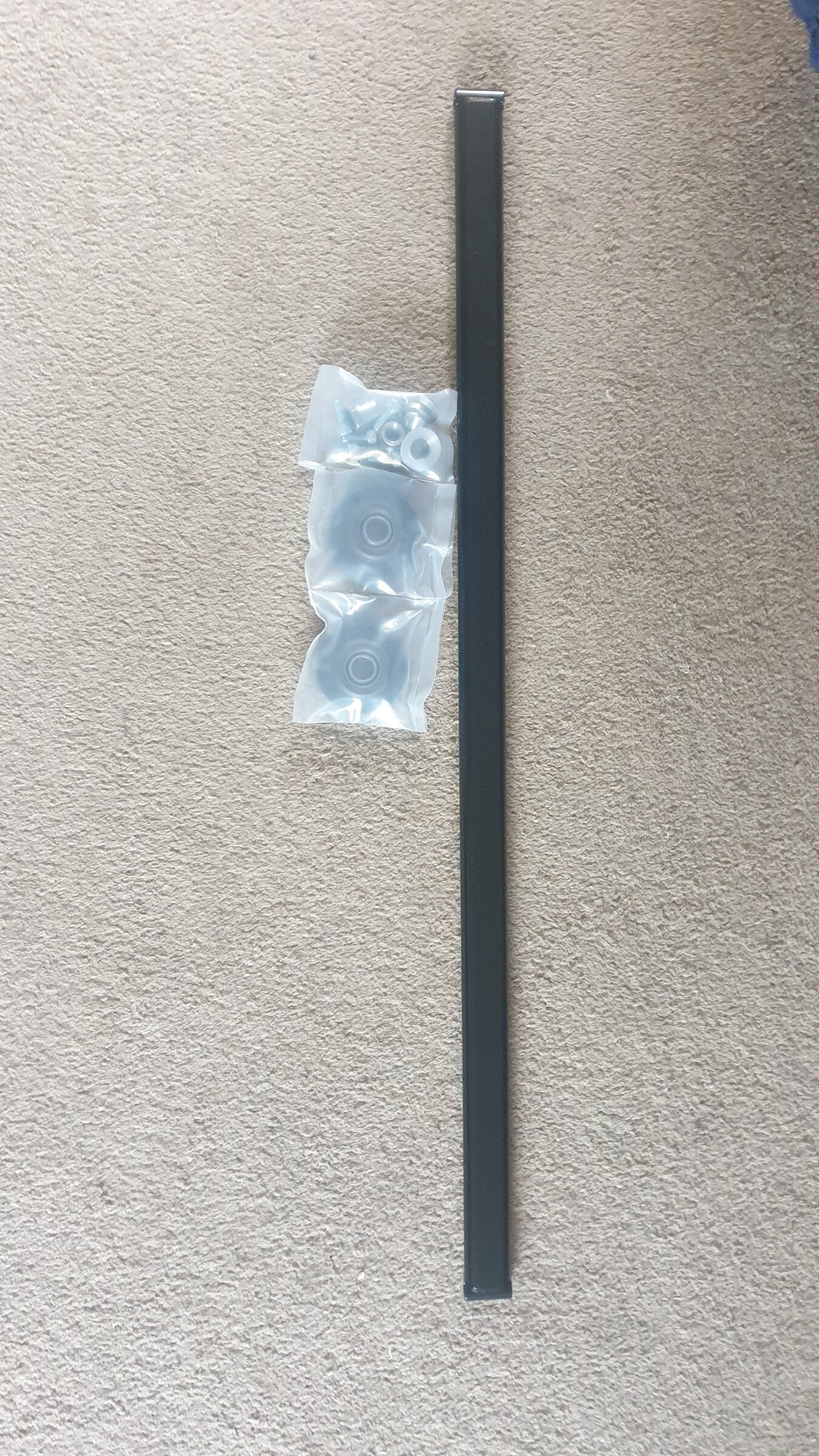

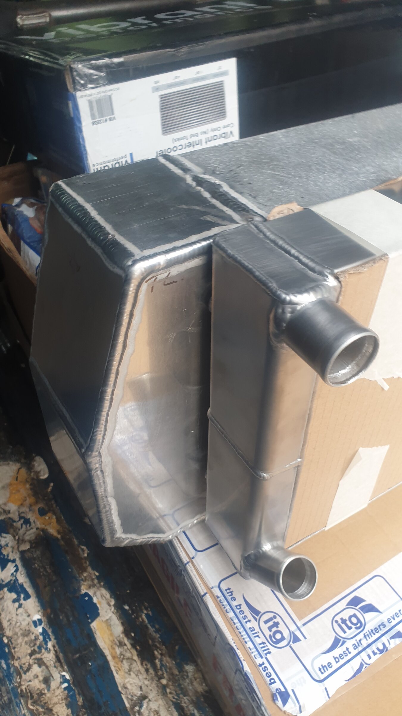

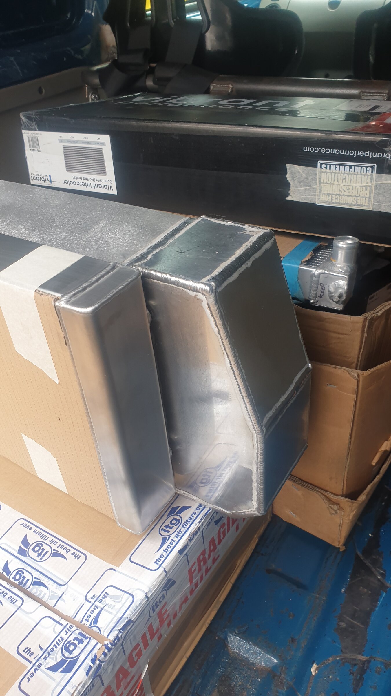

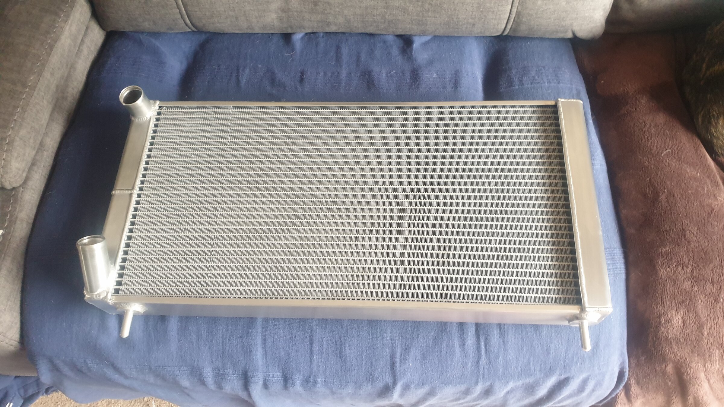

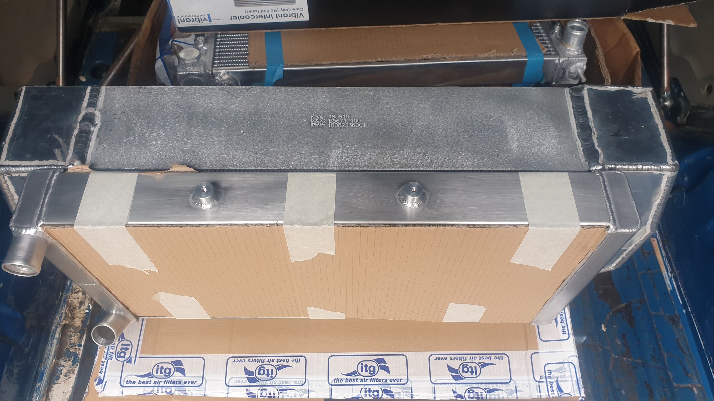

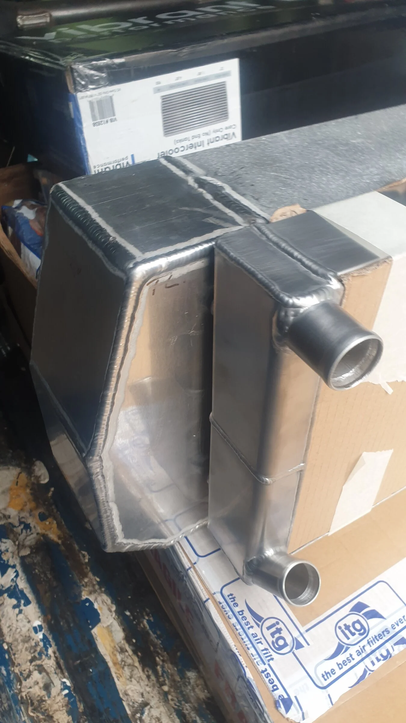

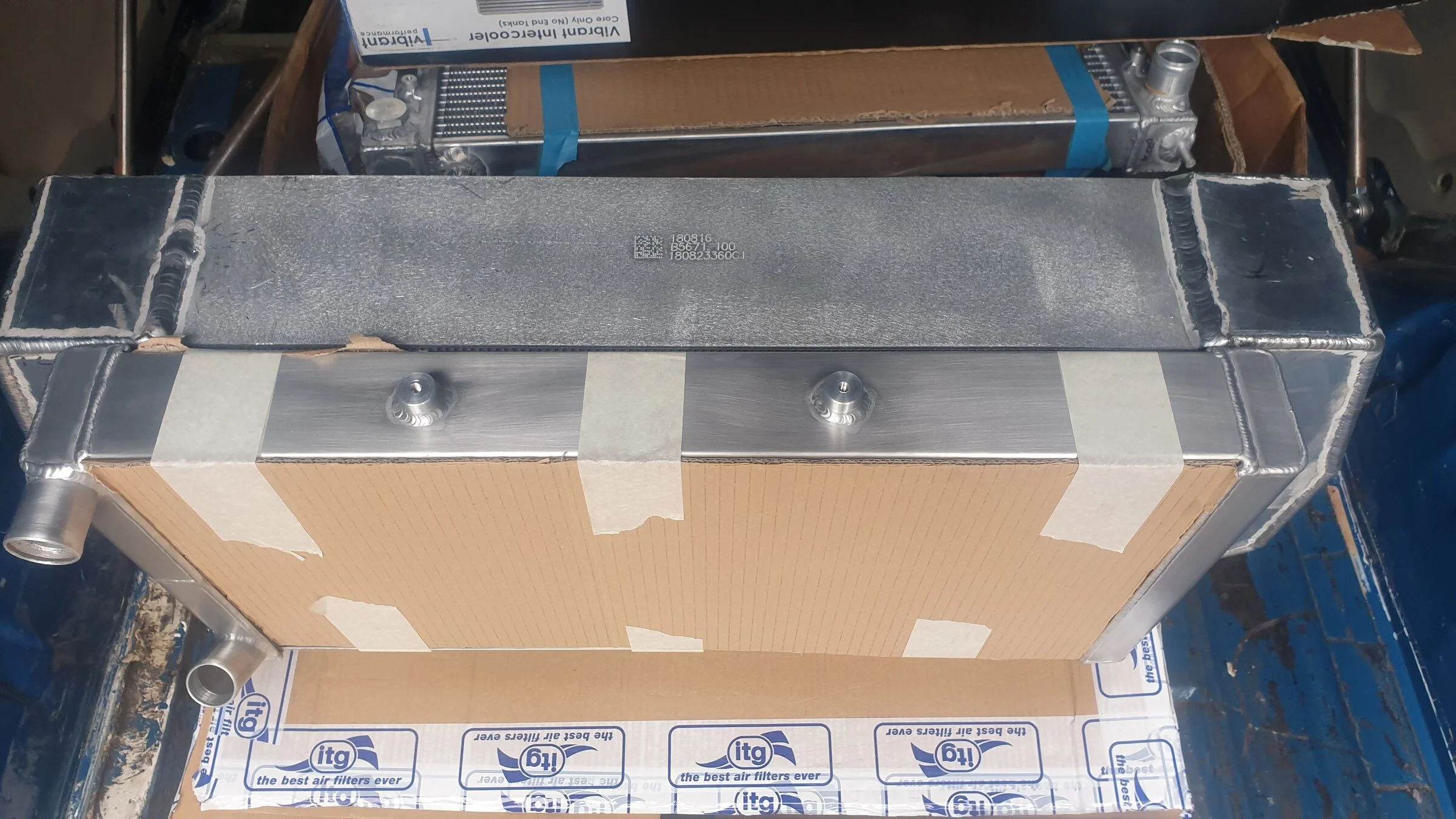

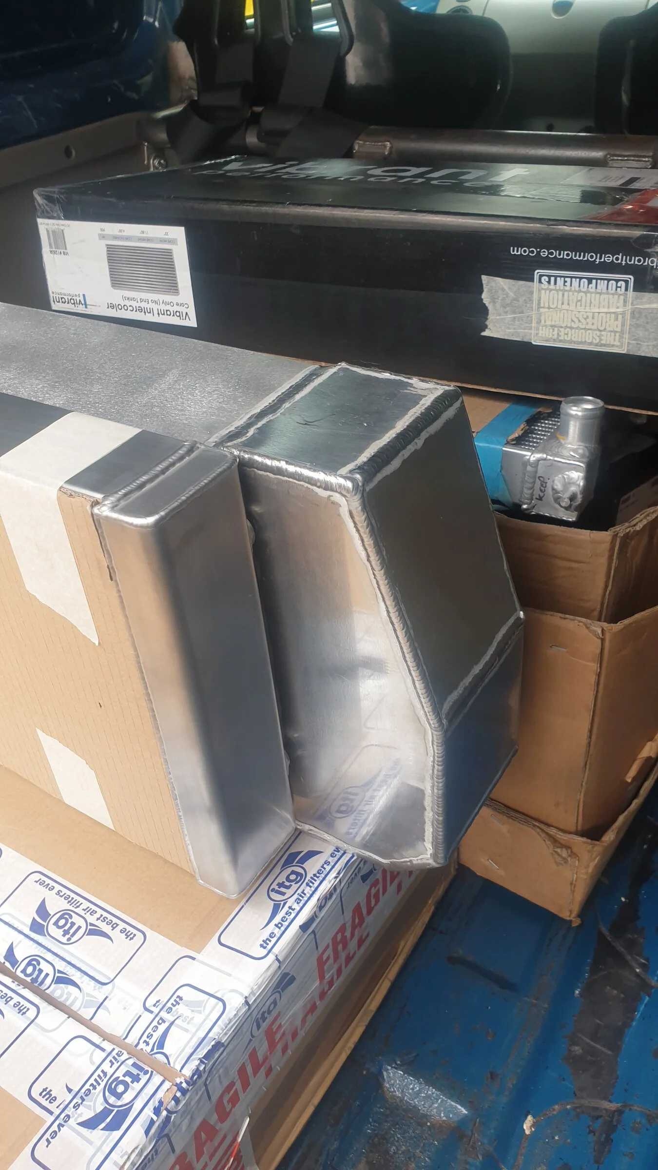

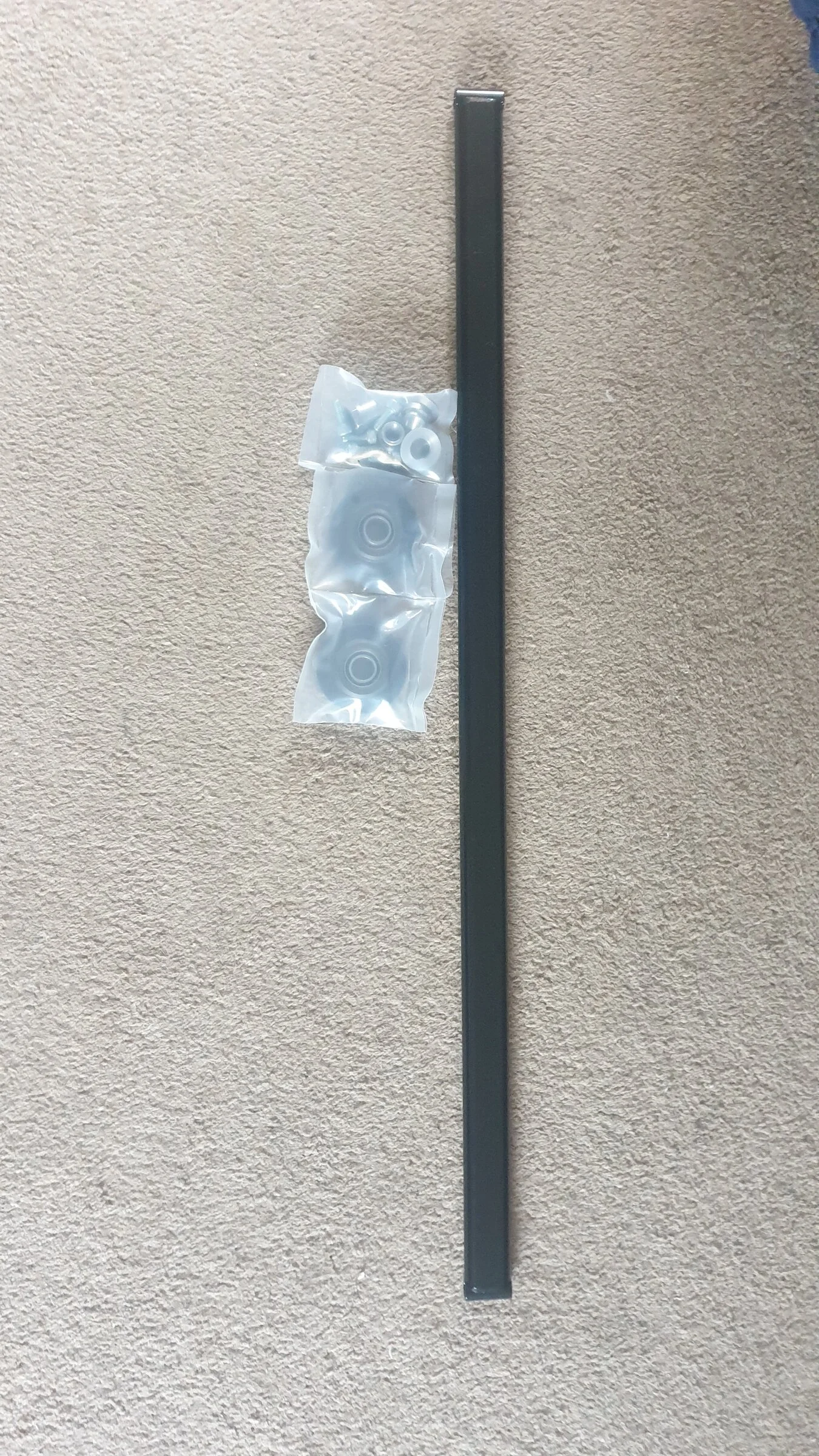

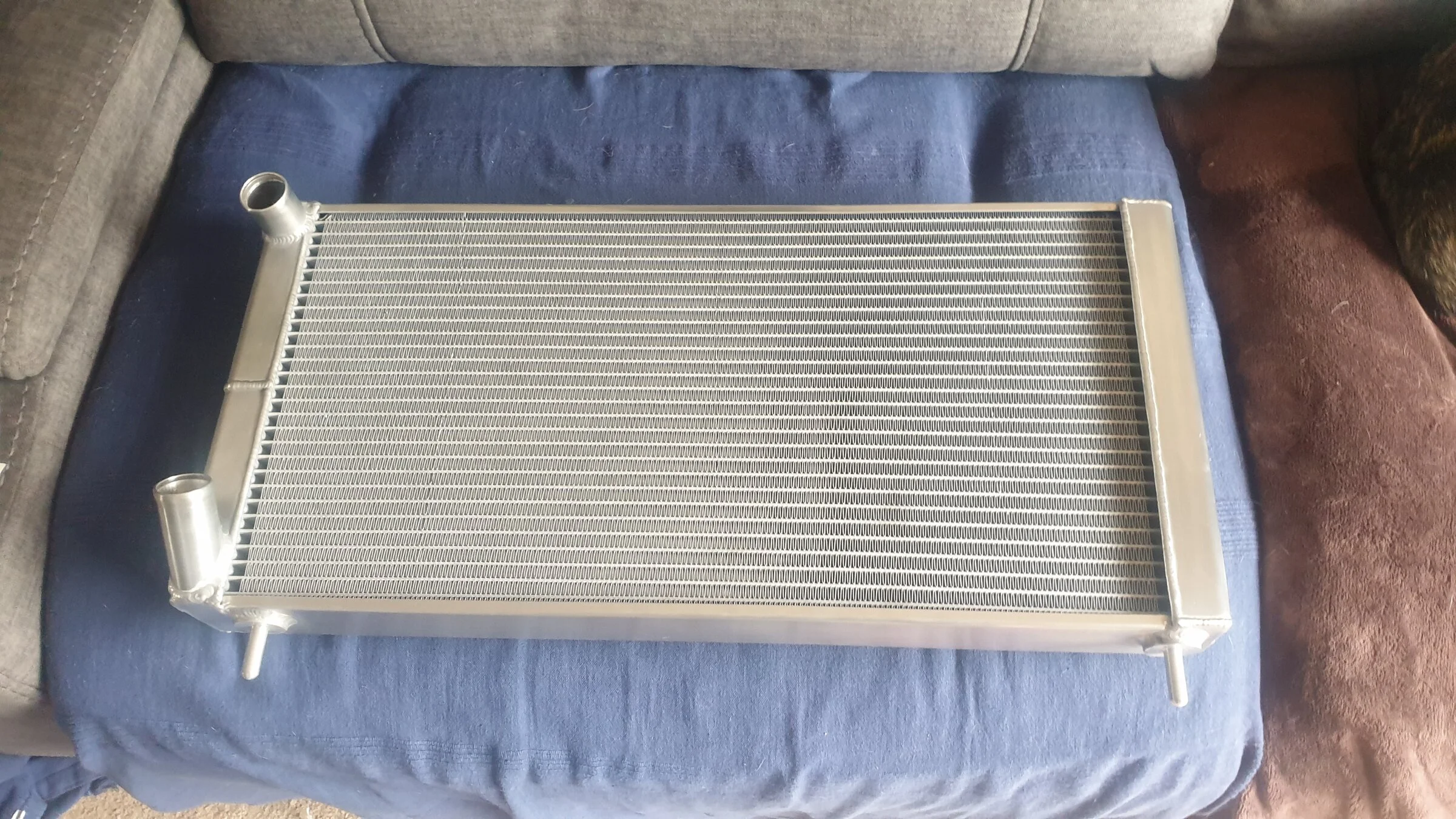

So my pms 50mm rad turned up and new style to mounts along with my brace that's measures for my space with the castor kit as it's different from the normal pms brace.
Rad is perfect side with the intercooler means my cooling for it will seal round the intercooler. Just need to get the engine and box in and see how the itb pendulum sits as it will dictate how my radiator intercooler will be positioned. I dont think it will effect it much.

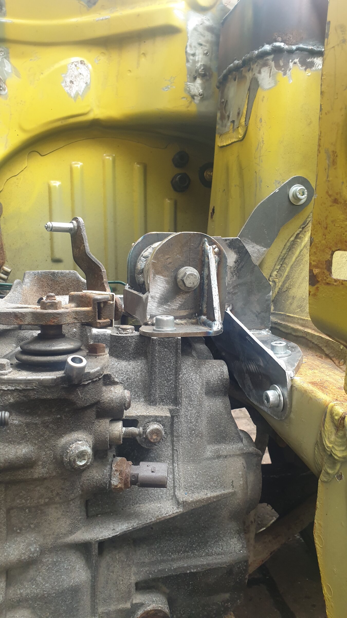

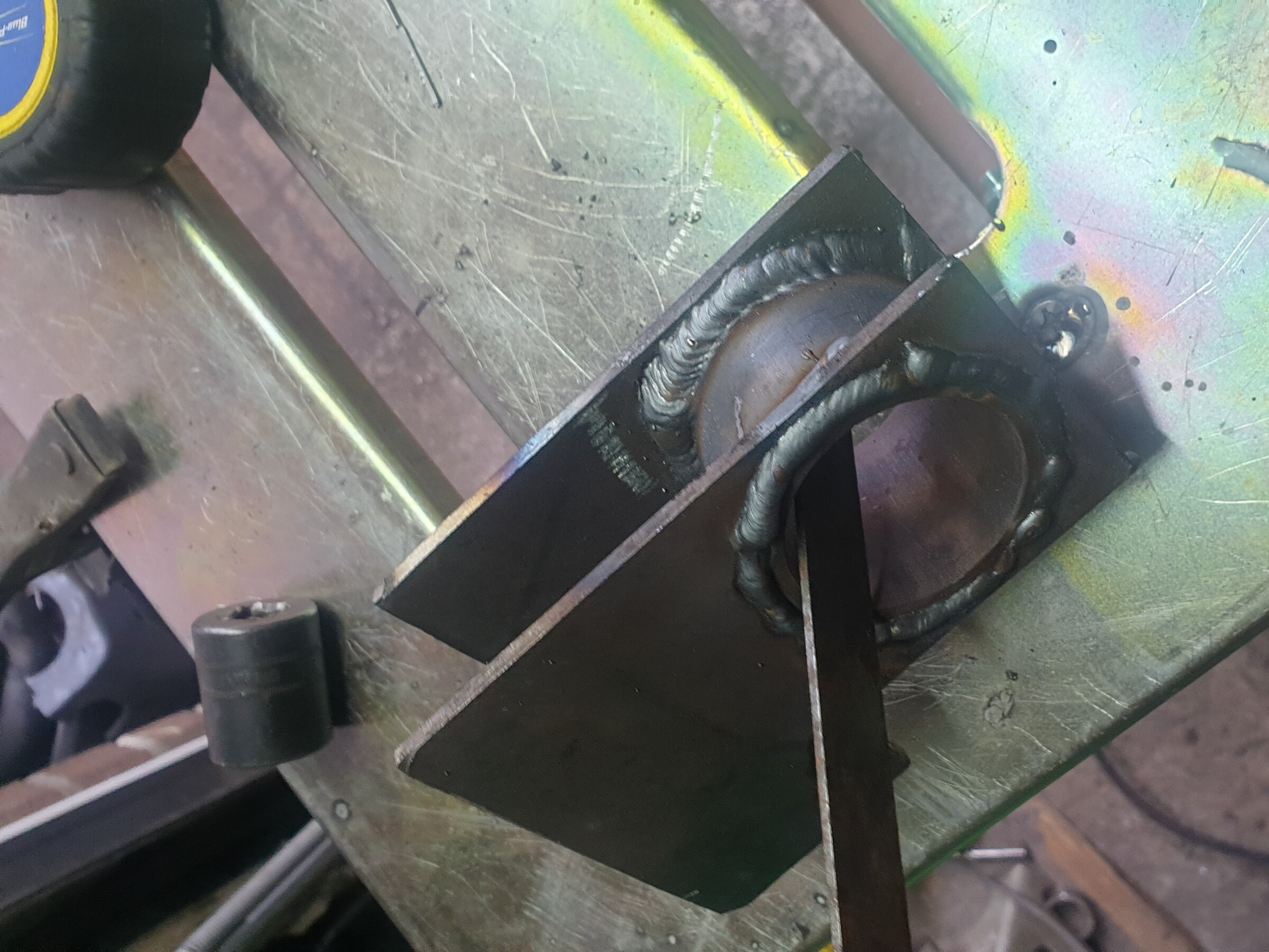

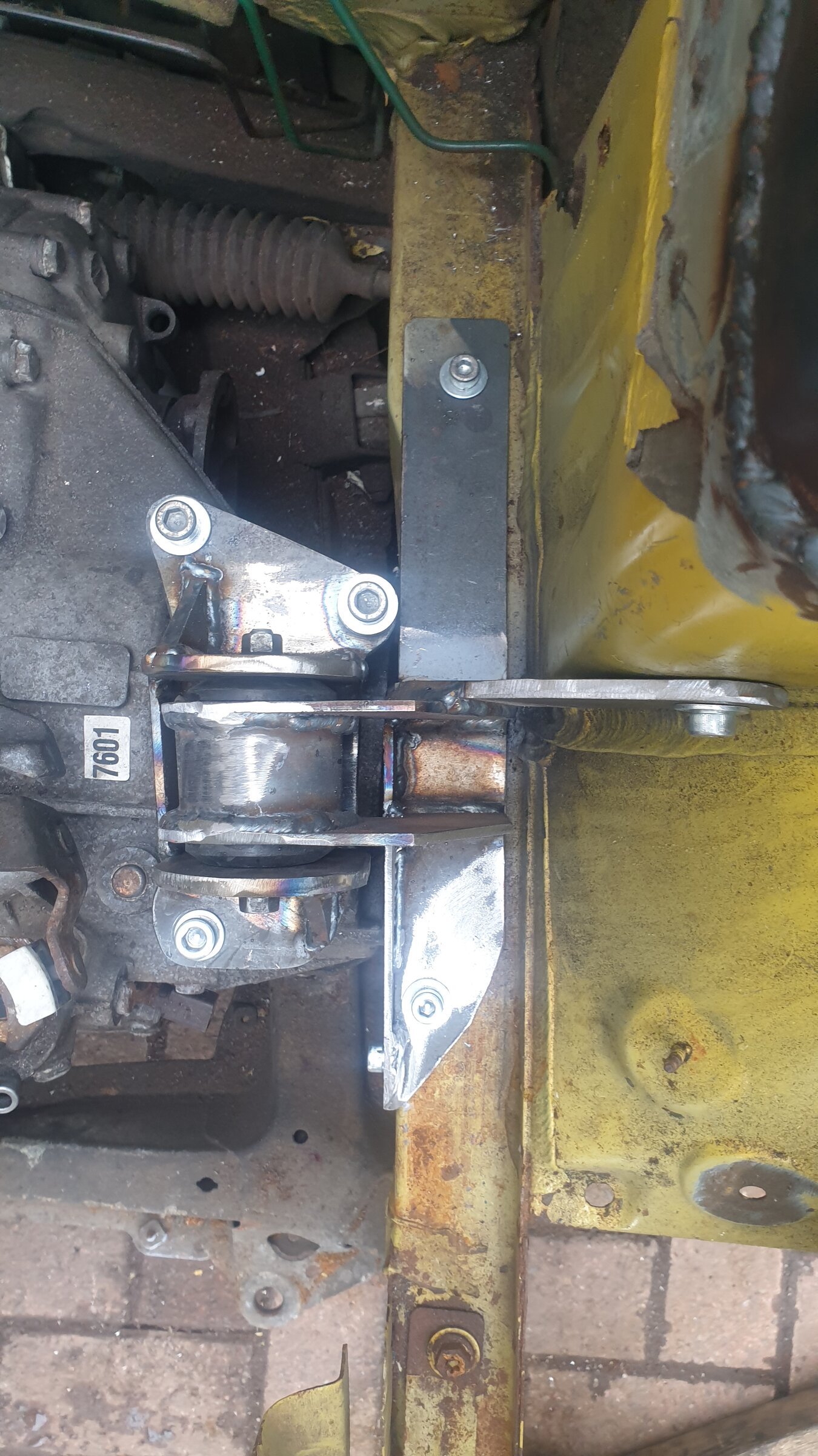

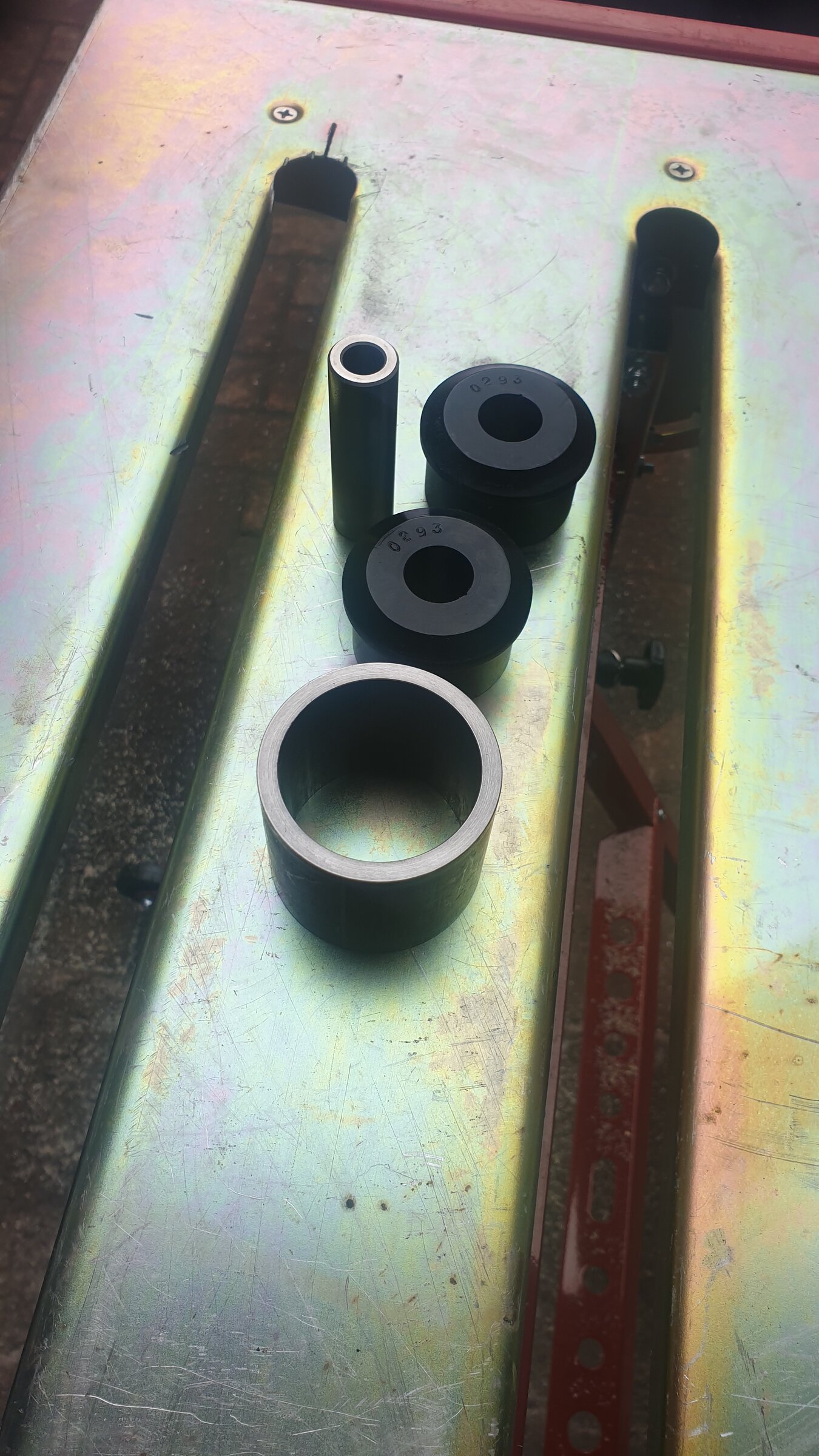

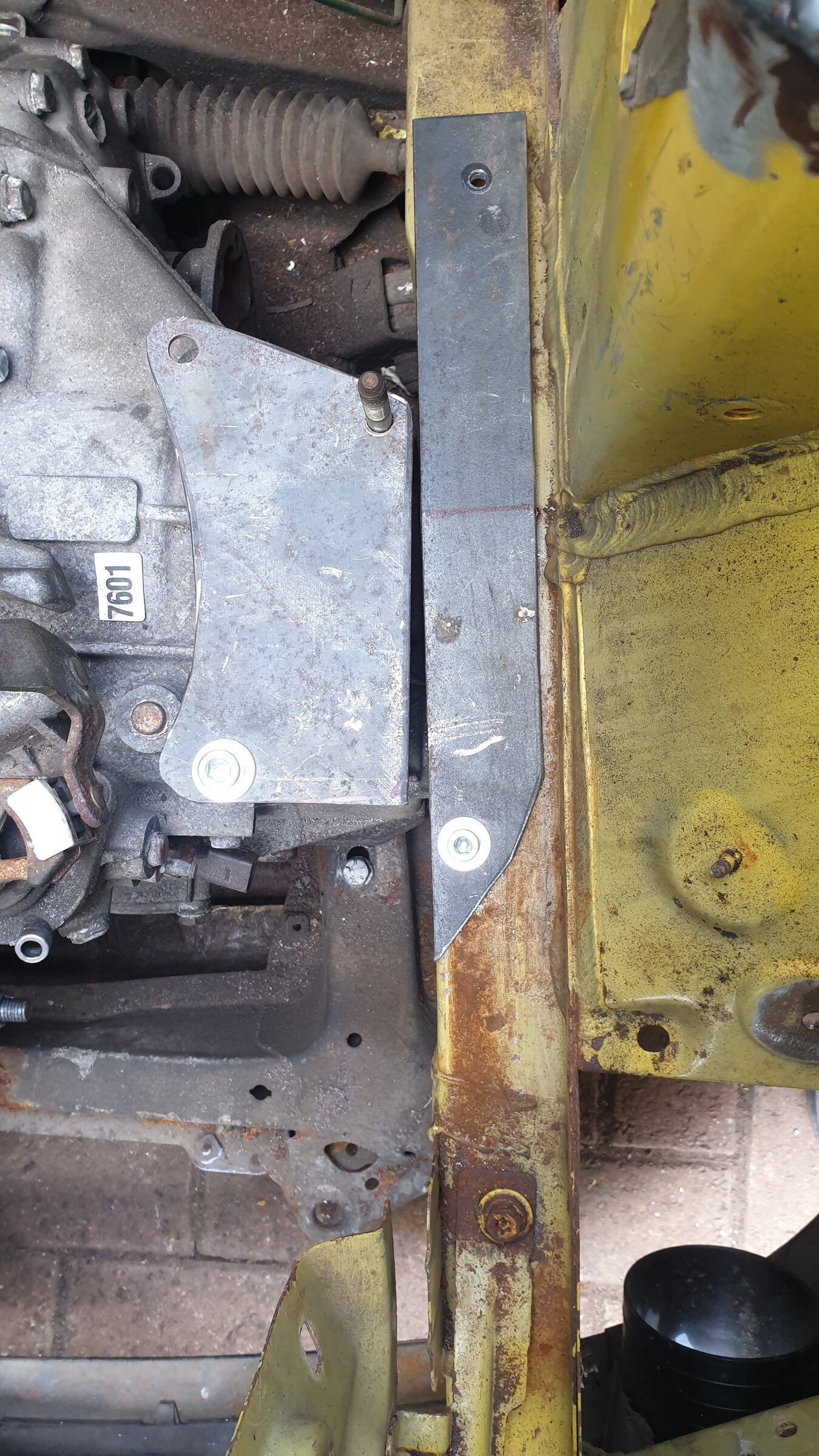

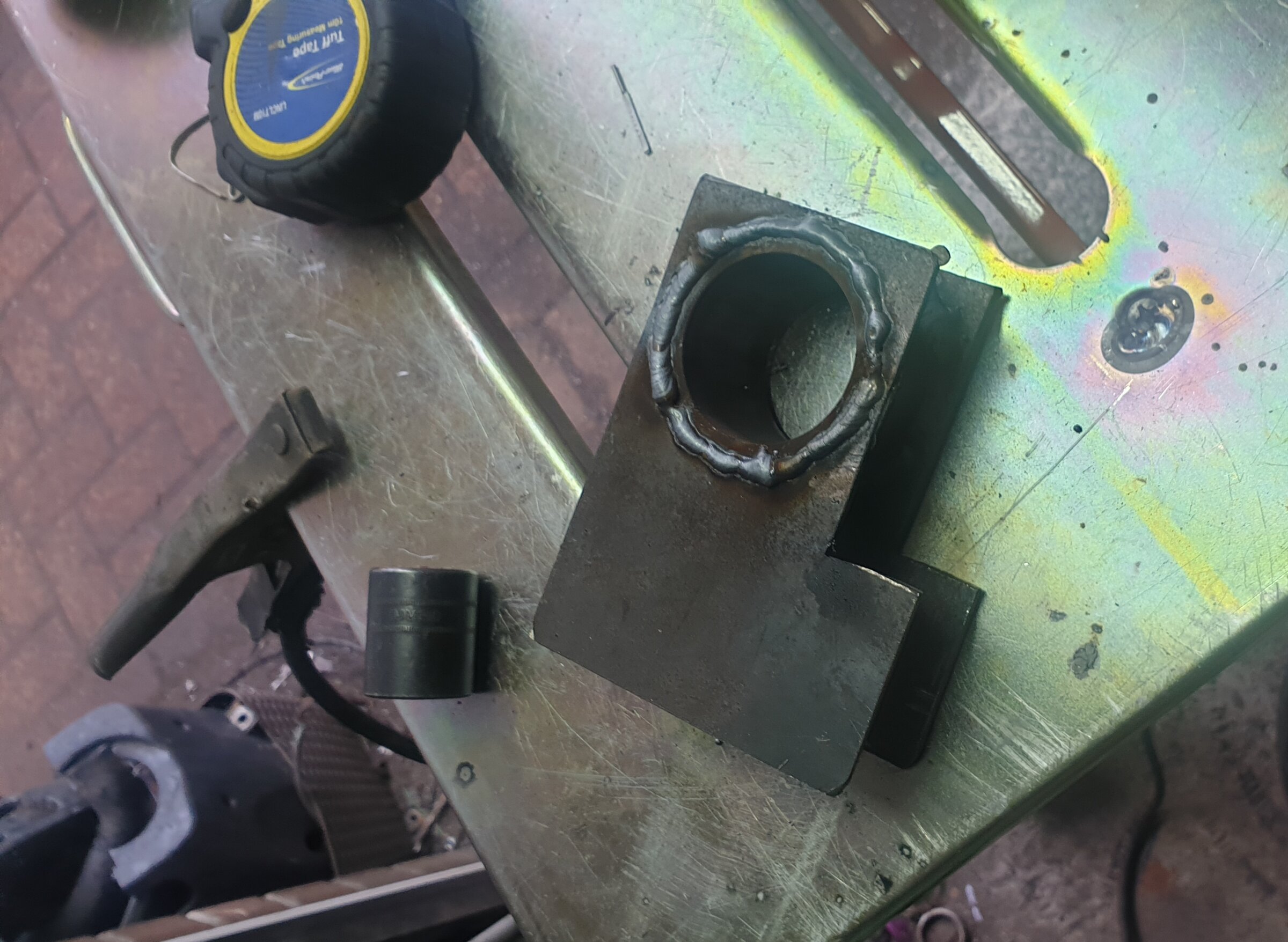

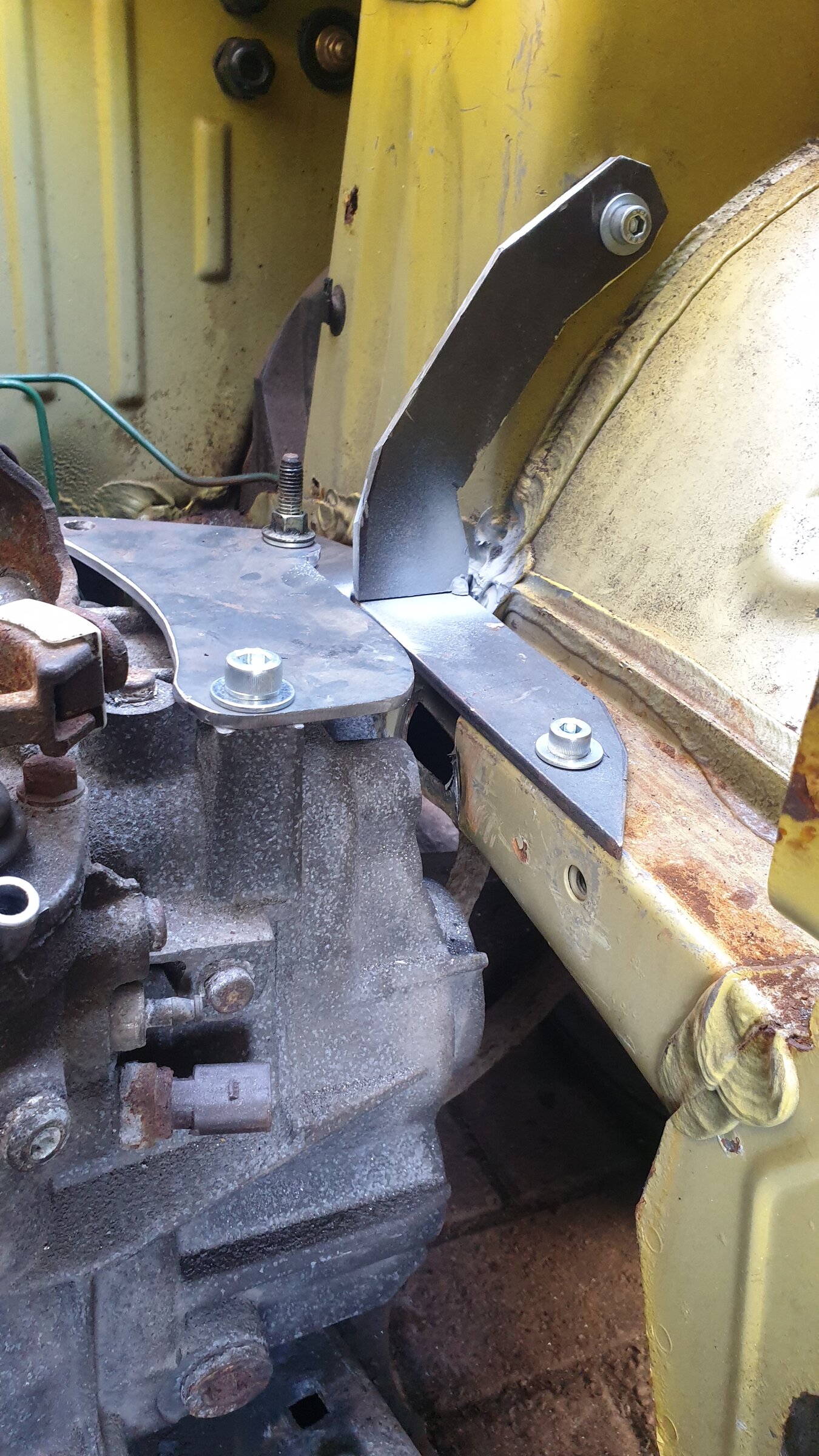

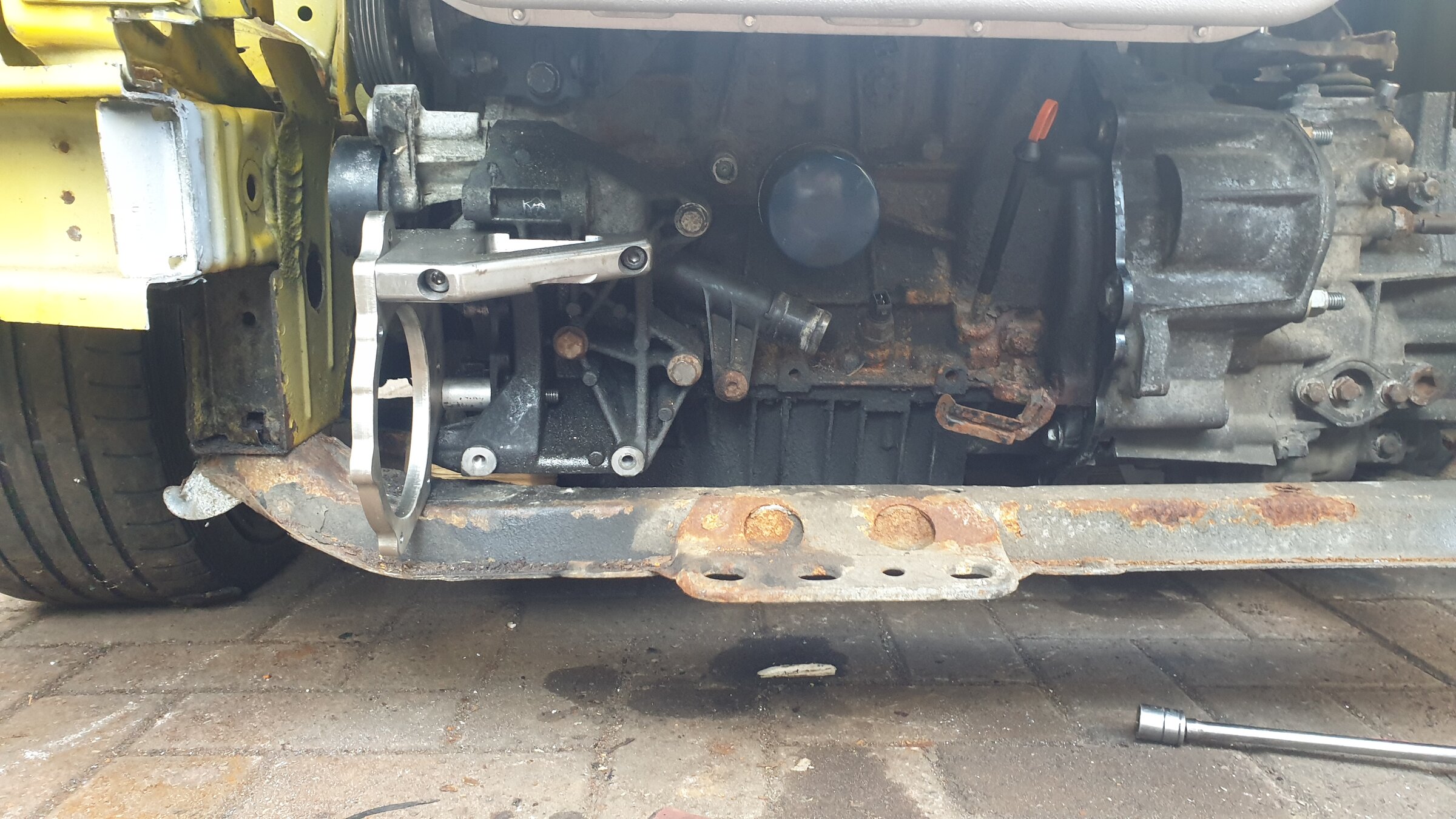

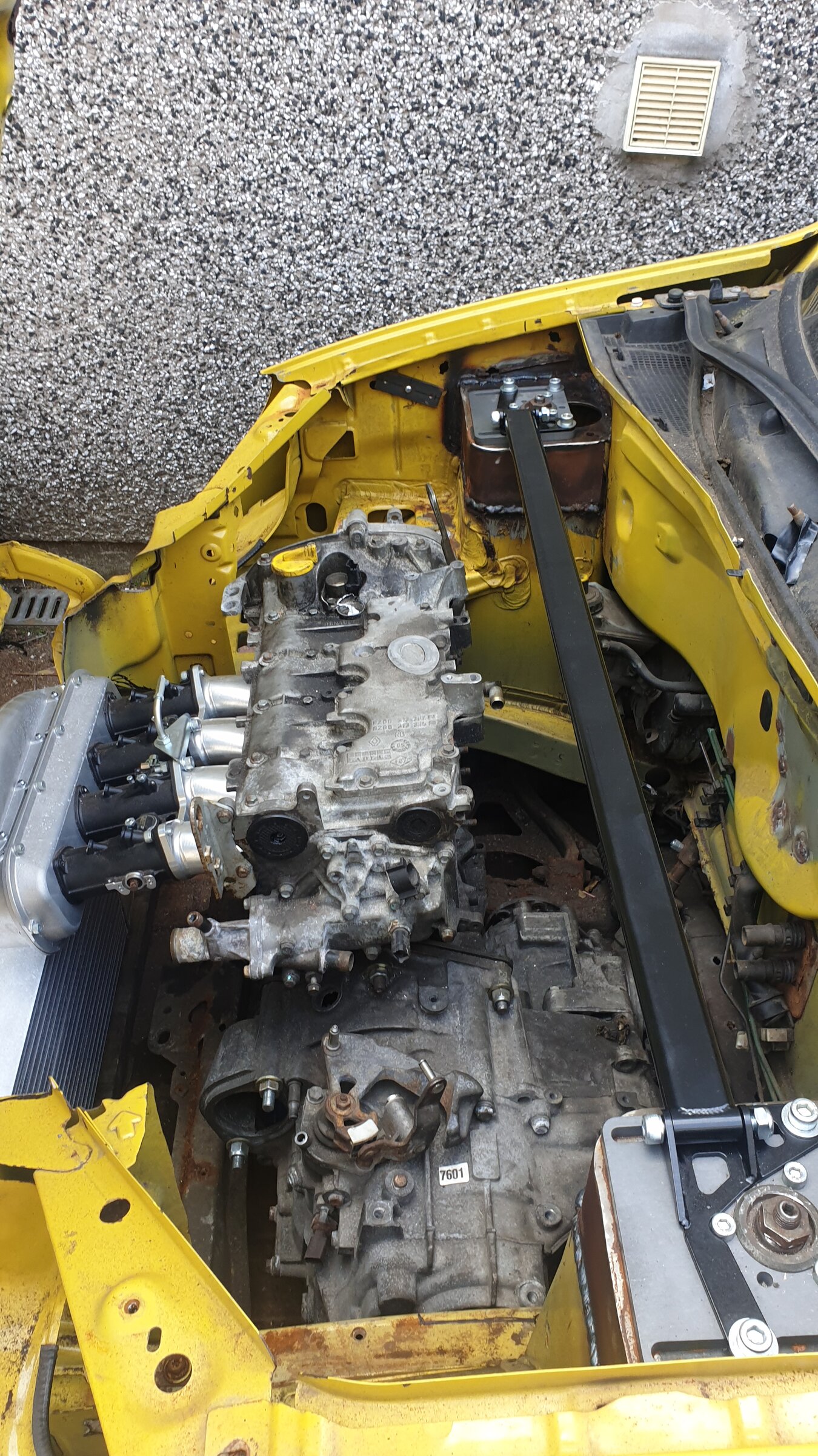

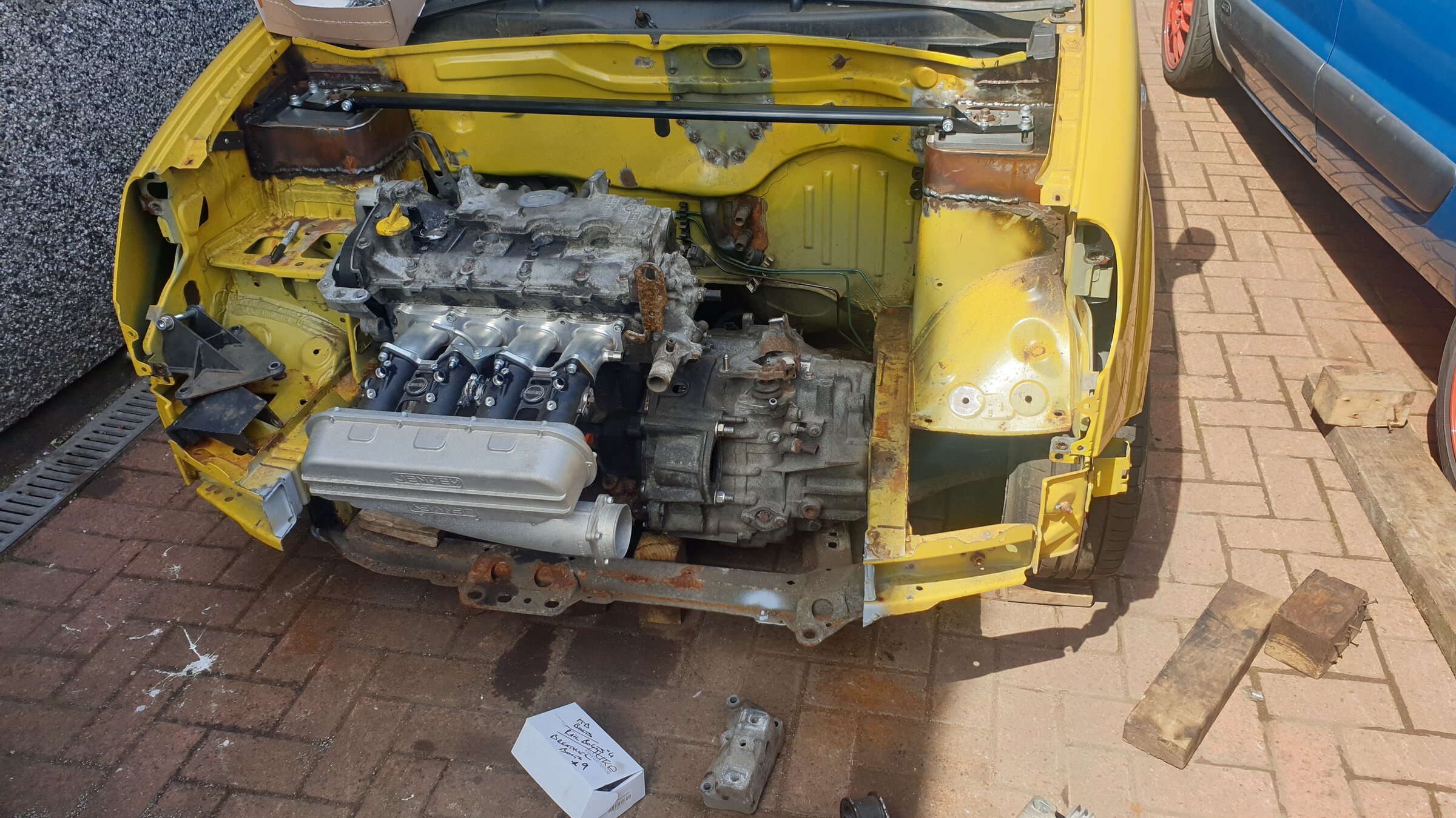

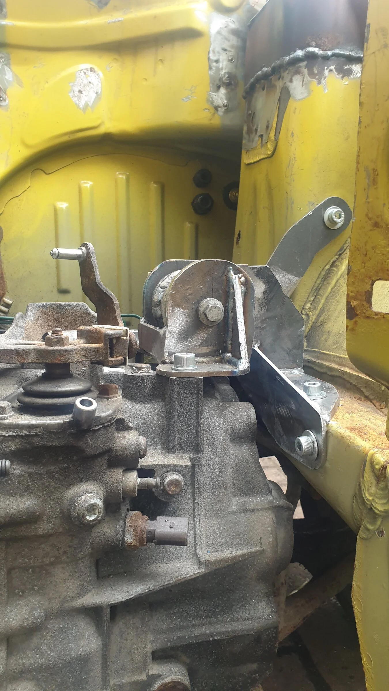

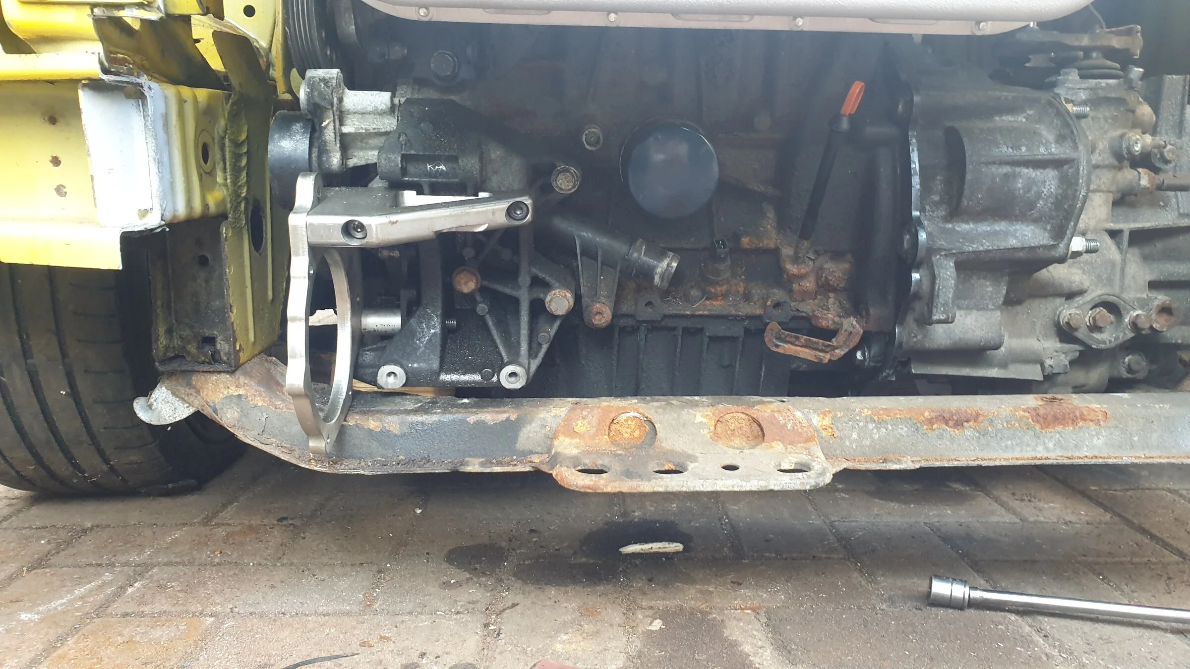

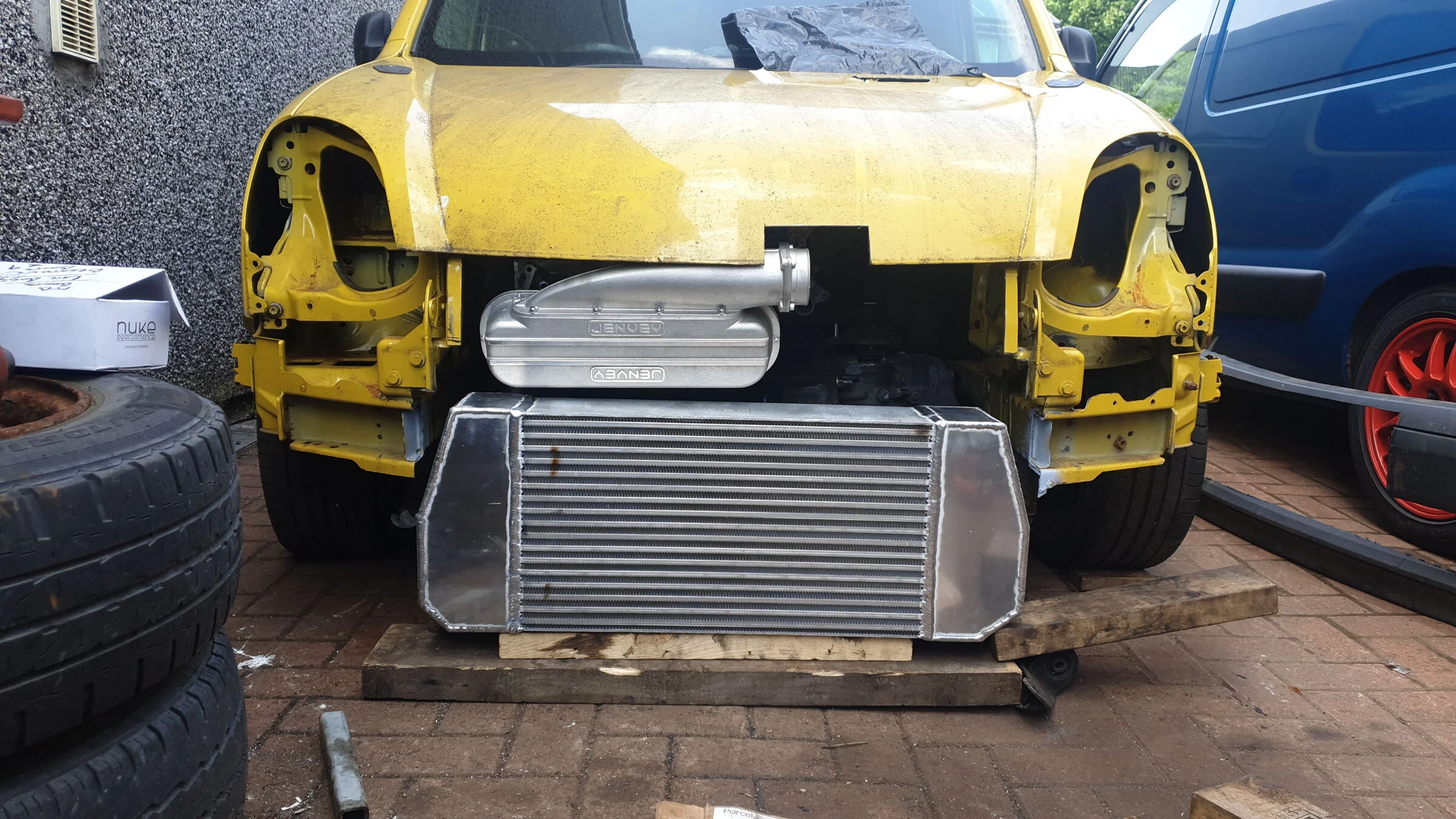

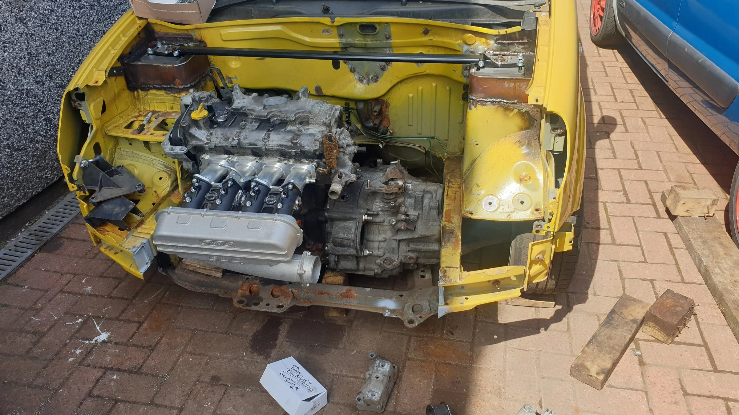

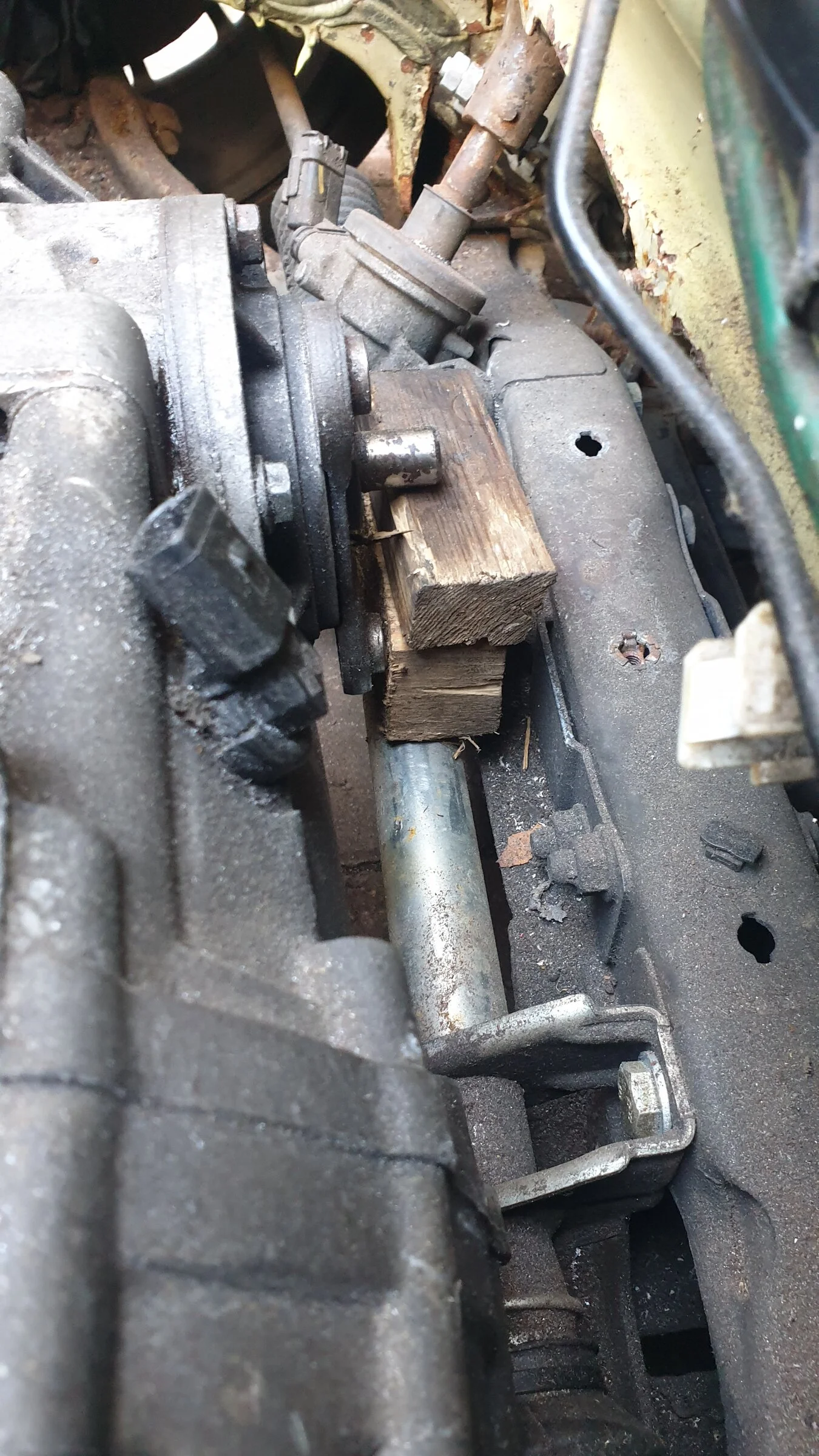

Abit of a small win getting the engine 4x4 box in position to where it needs to been but then get shafted with the alternator /supercharger set up with the itbs. After I repositioned the pendulum. Let alone cutting the bonnet for clearance then finding out it didnt need to be as I'd had adjusted it again

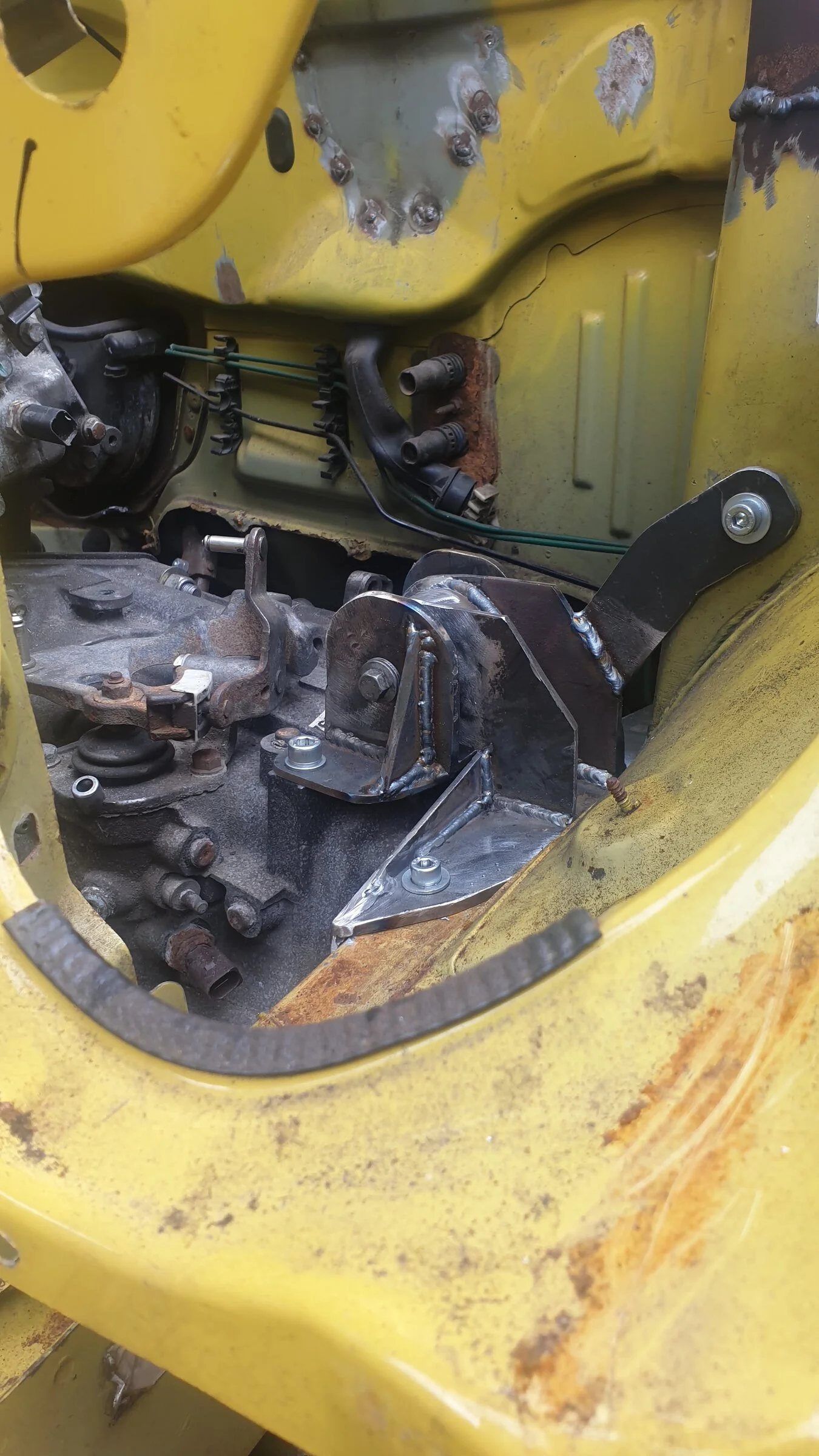

Next it's making mounts which will no doubt be fun

what 4x4 setup is it? And did you have to give PMS the measurements for the strut bar for the new top mounts?
Its alot of work. If I didnt have the itbs or supercharger there would be more of a win with this.
I'm using the mk1 tt quattro. 02m box and gen one rear haldex which my ECU will control to give me 50/50
Yeah you give them the measure ment once you've got the castor kit welded in.

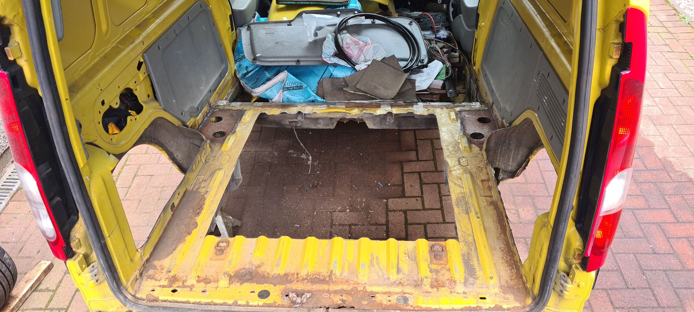

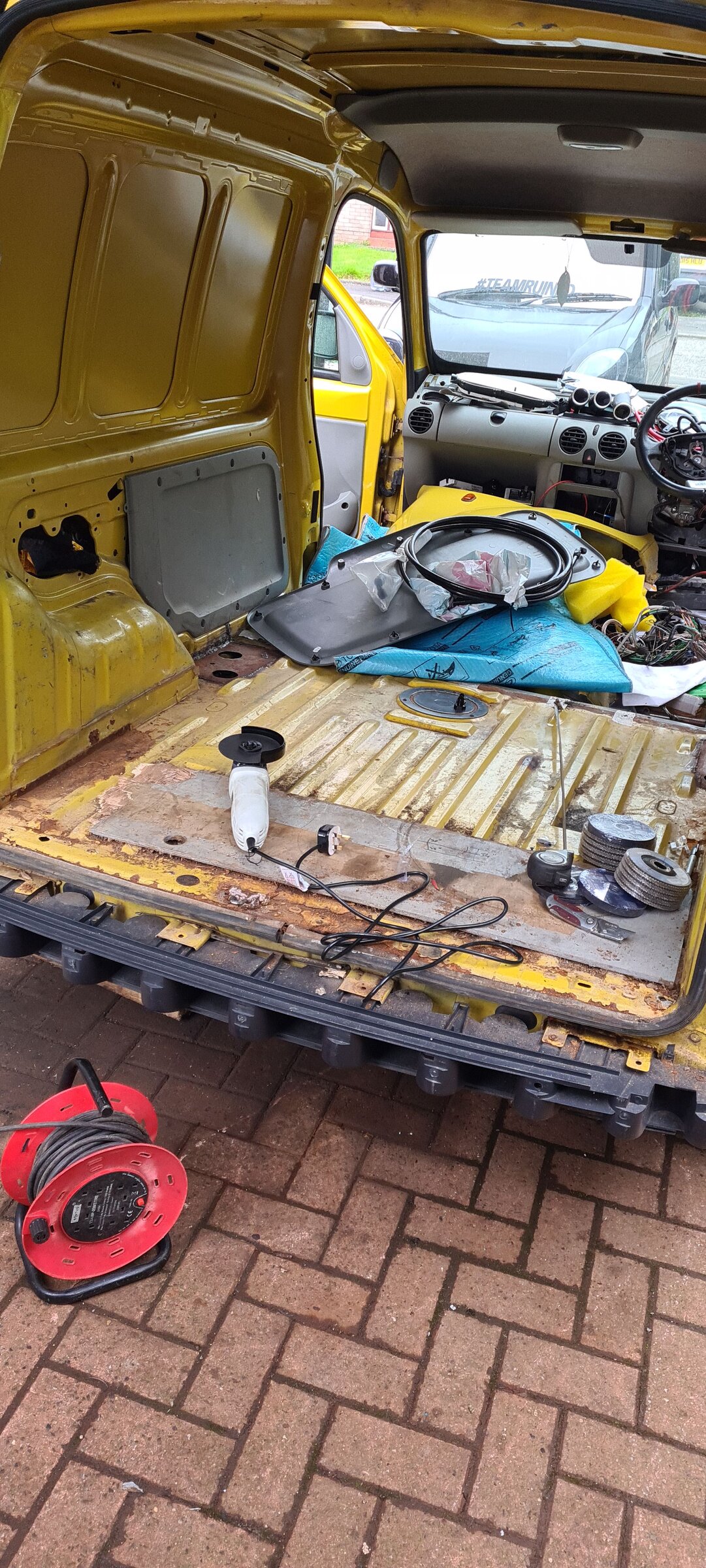

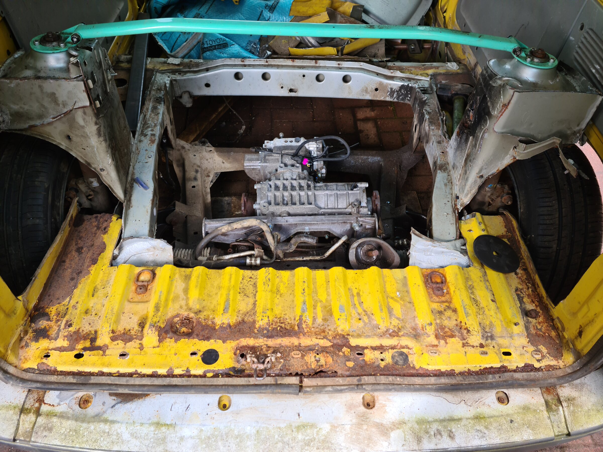

Not done alot since been back at work and got let down to get this conversion done so took a day off, was dry and managed to begin the 1st part of getting rear diff in place
Got to adjust it slightly then tack it in place to then sort out getting strength back in.
