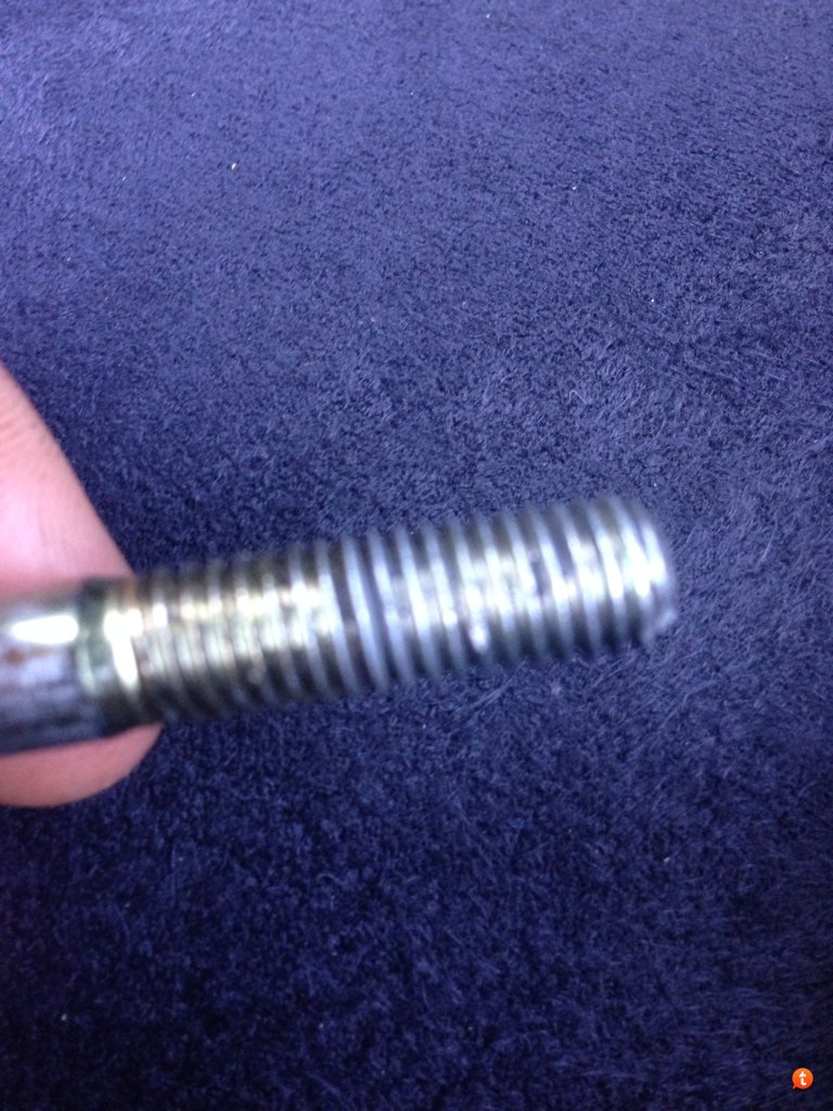

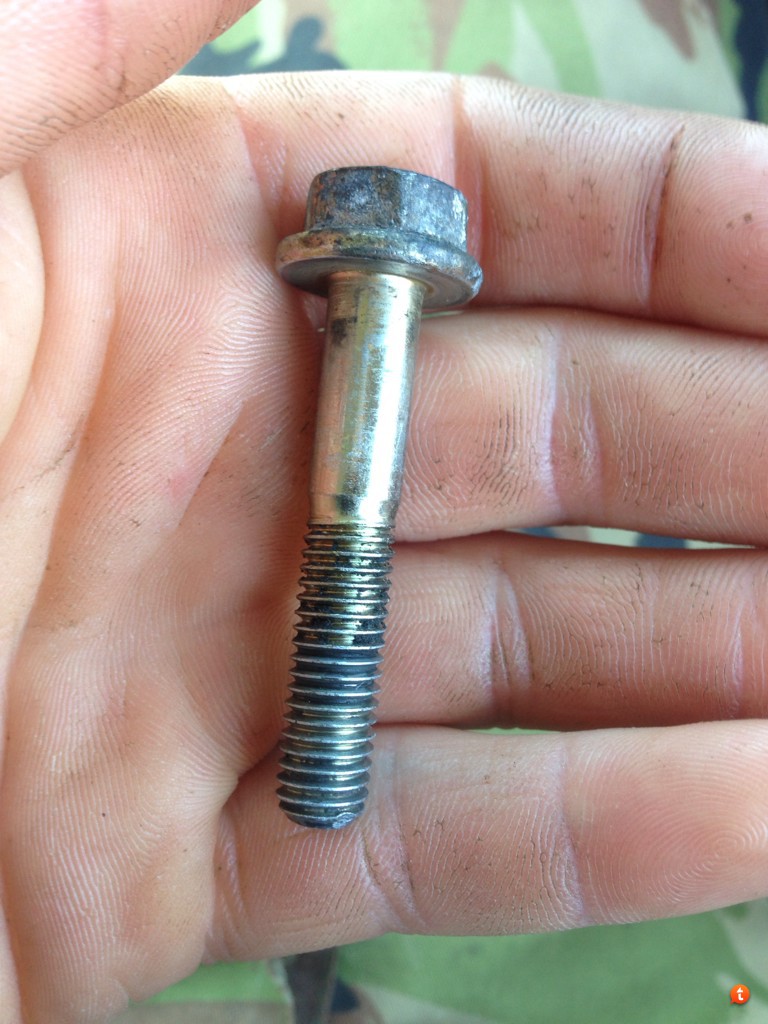

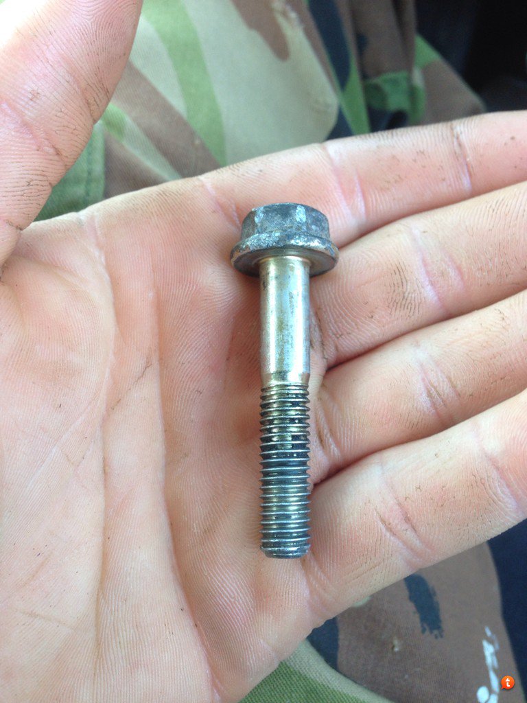

Whilst driving today I herd something come loose on the front of the car and then rattle then dropped out onto the road I managed to pick it up and its a bolt, same happened about a week ago but never managed to find whatever has fallen out, I've looked at what I can around engine bay and Carnt see anything missing/loose but I've just had belts and powersteering pump changed a few weeks ago?....

I've had another look, there is a bolt missing just below the rocker cover above the first branch on exhaust manifold drivers side and engine side of the brake fluid bottle I've tried to hand thread the bolt in but it gets very tight after half a turn or so so maybe thinking its something else?

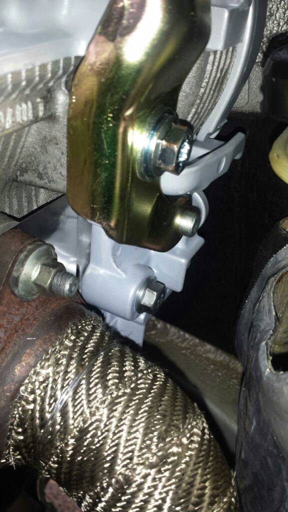

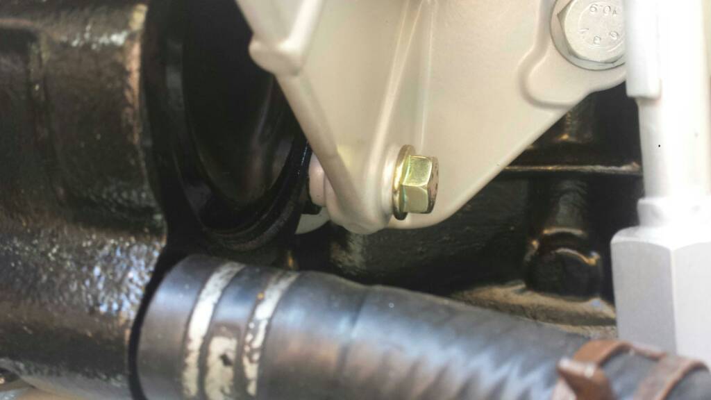

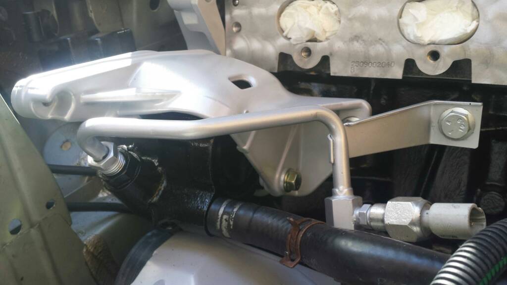

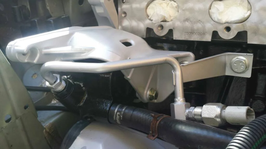

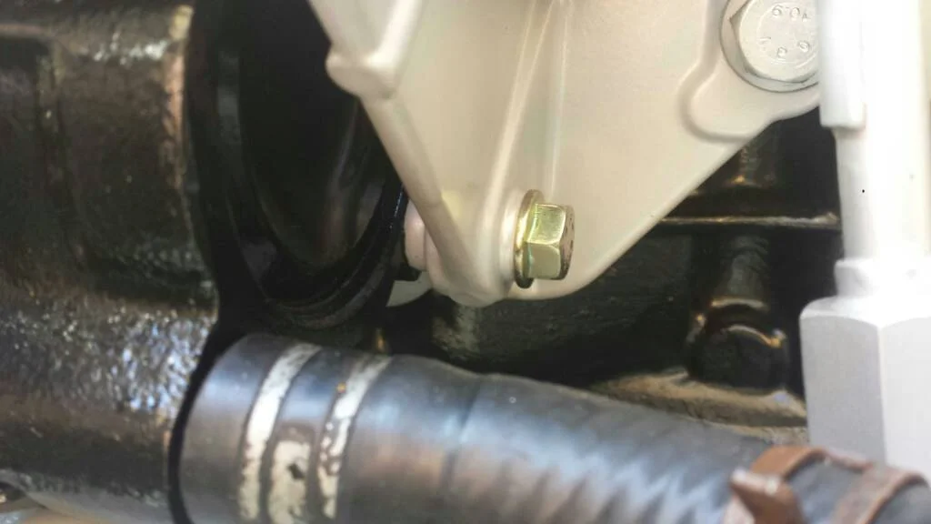

Thanks for that picture I'm missing the rear engine lifting mount but that isn't the bolt ive got, any chance youve got a picture of the power steering pump so I can see better what I'm looking for? Thanks
There you go.

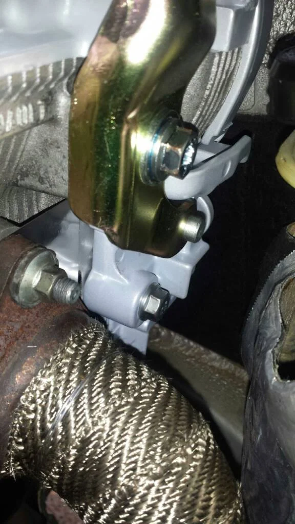

Is the idler tensioner bolt the same? I think the bolt that has came off the tensioner must have dropped and been lost in engine while getting belts done and they have replaced it with a new m8 bolt as the bottom bolt is diferent to the top 1

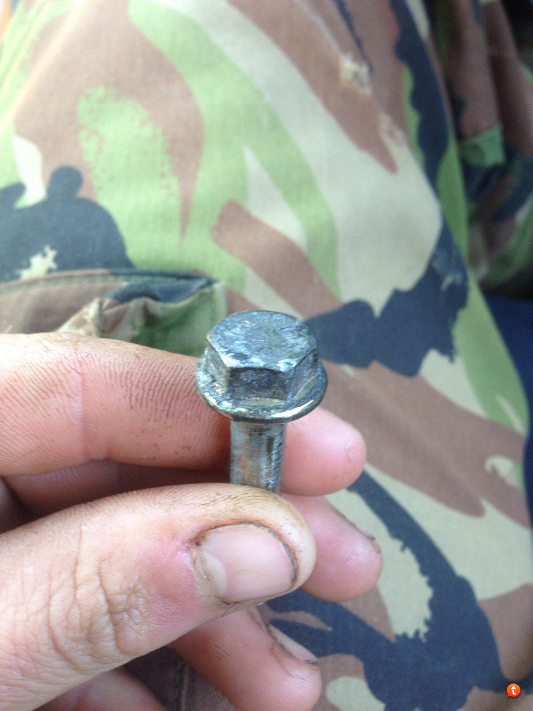

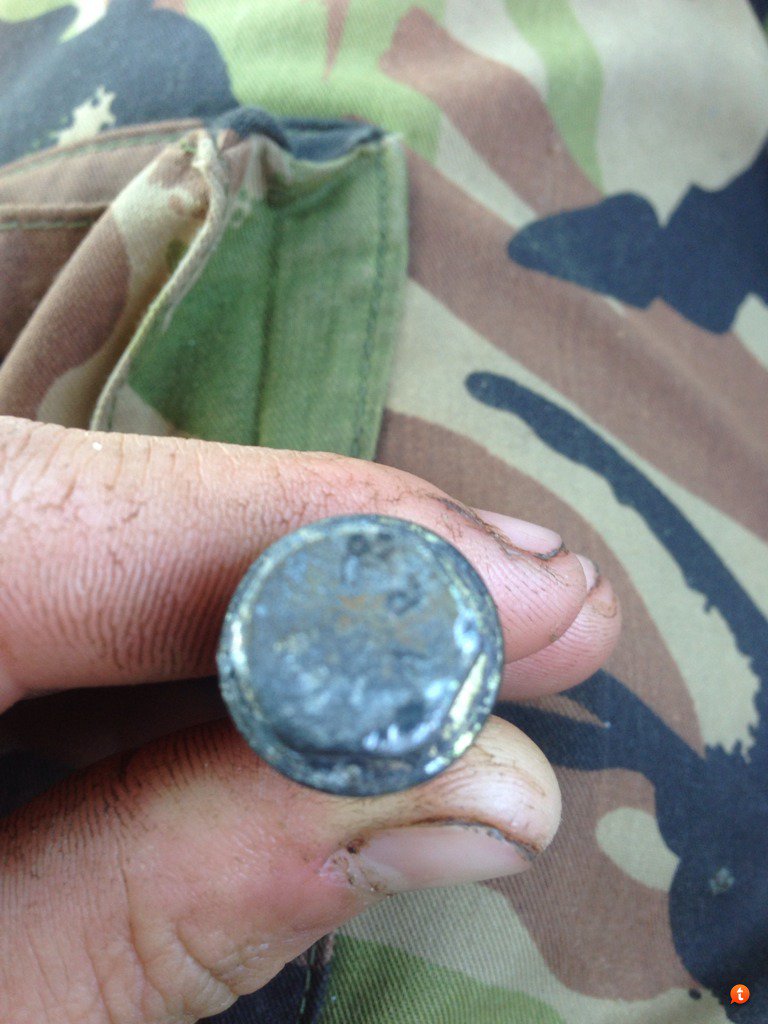

The top bolt looks as if it says oav 8.8 on the head just like the bolt that came off the car has
Pretty sure the bolt thats came off must have been loose in engine bay and has just fell out whilst driving, and wasn't actually in use, if anything more comes of it I'll post on here
