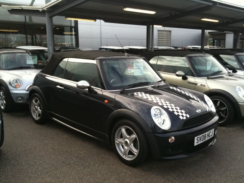

The GF's Mini has black trim round the arches and side skirts, and they are forever looking dull and grey. The black plastic bits...

These bits
