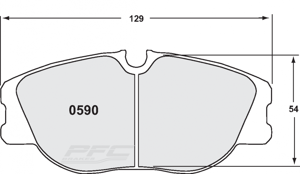

I can supply these at a good price. Only the 97 compound is available now. The padshape fits the Clio RS and the Peugeot 306 GTI6

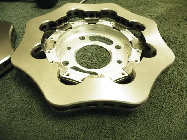

As many already said, save the money on discs, and spend it on the pads. The difference between discs in terms of braking performance is barely noticeable. The main things with premium discs is some of them wear better and some of them are much better at suppressing brake squeal because they're high graphite. Grooved or drilled will just eat pads faster.
Even discs this extreme:
Don't make a huge change to braking performance - do to pad wear though.
