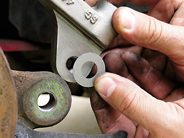

Im a bit stuck at the moment. I need somewhere that would be able to use a lathe to take 2mm off the diameter of some brake discs. I have tried to google everything I can think of but nothing is coming up.
Ive got some 300mm discs and some 4pot calipers and mounts which are great but there is only about 1mm between the edge of the disc and the caliper. When the disc gets hot ( I have been out bedding the pads in) the disc expands a little and rubs against the caliper. I need to take a little bit off the edge of the disc.

It would seem that the brackets though are the original problem,if they were 1mm taller it would save the messing around.

You can get ready-made shims exactly for this. They're essentially very thin penny washers sold in 0.1mm, 0.25mm, 0.5mm etc thicknesses. Place them between the hub & bracket (to move the calliper laterally like in the picture below) or between the bracket & calliper (to move the calliper radially).
Usually get a box of them with high end motorsport callipers to get the most symmetrical fit possible (maximise pad wear, minimise hot spots on the disc etc during long stints)
Much cheaper than taking 2mm off every set of discs you buy :tongueout:

If it was my road car, I'd probably just hunt around for some thin penny washers providing they are as wide as will physically fit (wide shims + correct bolt torque = structurally stiff calliper assembly)
