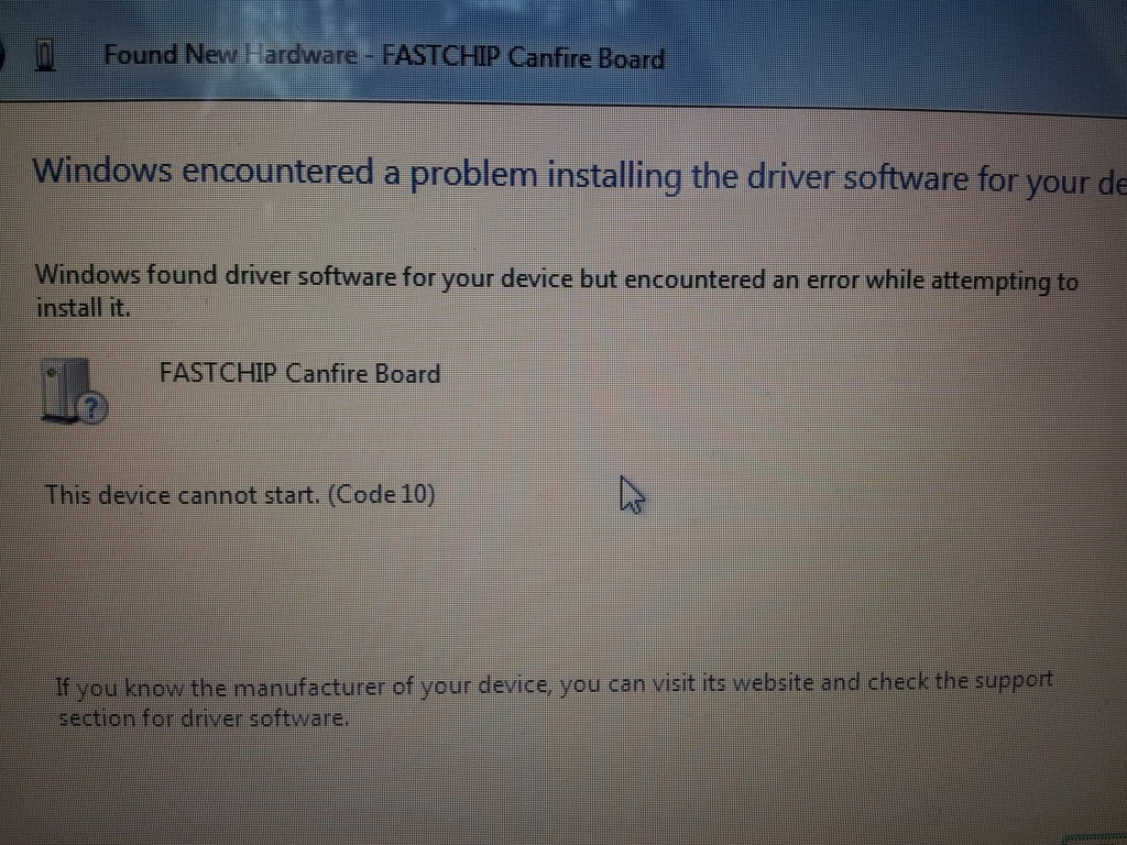

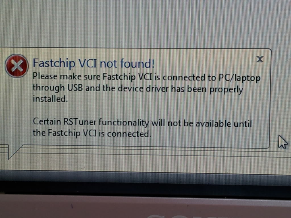

Tried again lastnight on a mates computer that uses windows 7 (im using vista) and it still didn't work.
This is the message i get when i open the rs tuner program.
  Clio 182 Cup
Looks like the device is found but the drivers are not. Go into device manager (Right click Computer -> Properties -> device Manager) and look for any unknown devices. Right click them and uninstalled them. Once that is done uninstall the RS tuner software and reboot the PC.
Install RS Tuner and run it up, then plug the USB cable in and let it discover the device and install the driver once this has been completed it will tell you if it needs a restart or not, follow what is says.
Let me know if you still have problems.
I am running RS Tuner on a MacBook with a Virtual Windows 7 without problems after doing the above.

Are you sure it's connected to the car?
I'm pretty sure it gives a similar message if it isn't.
