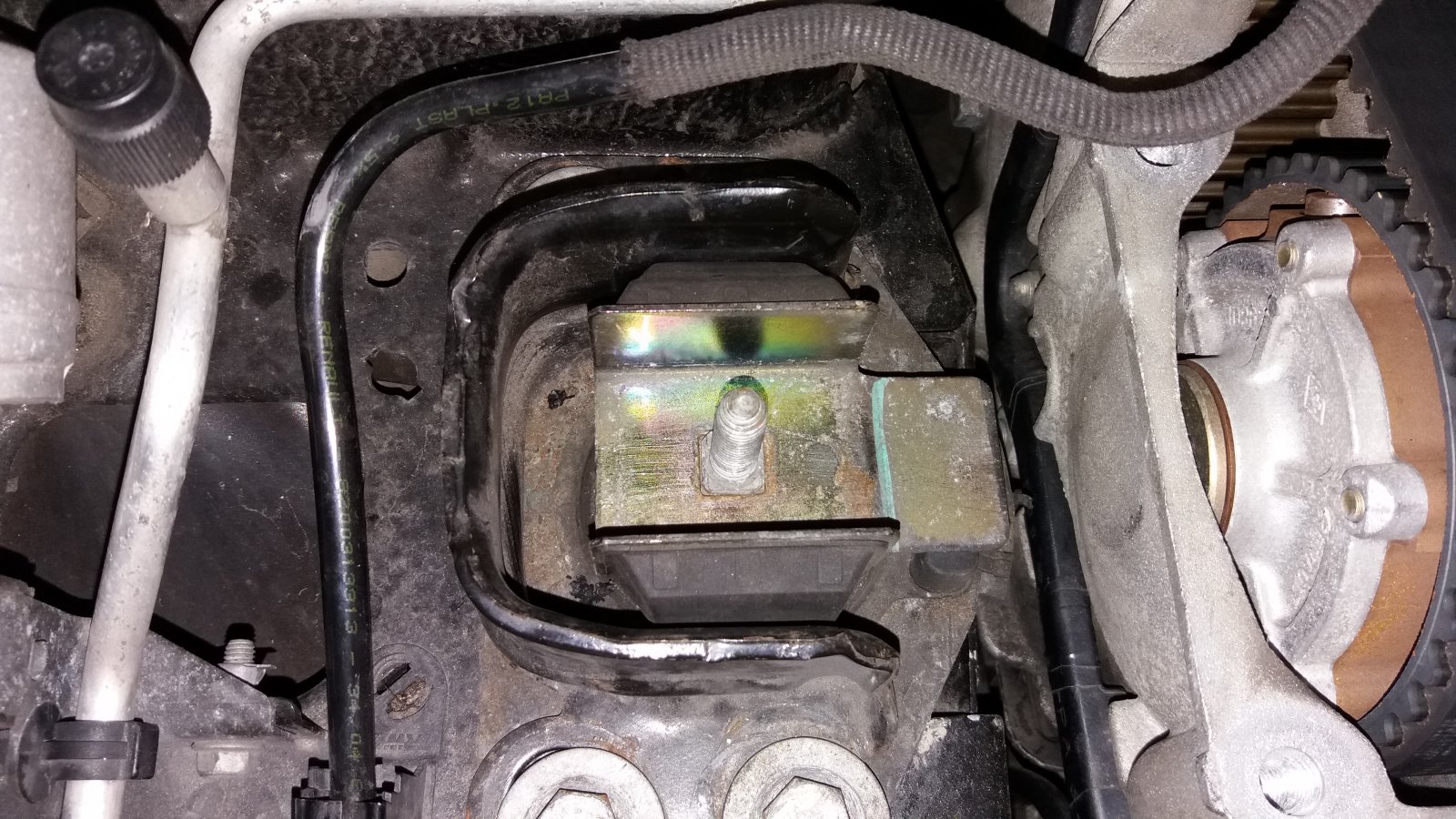

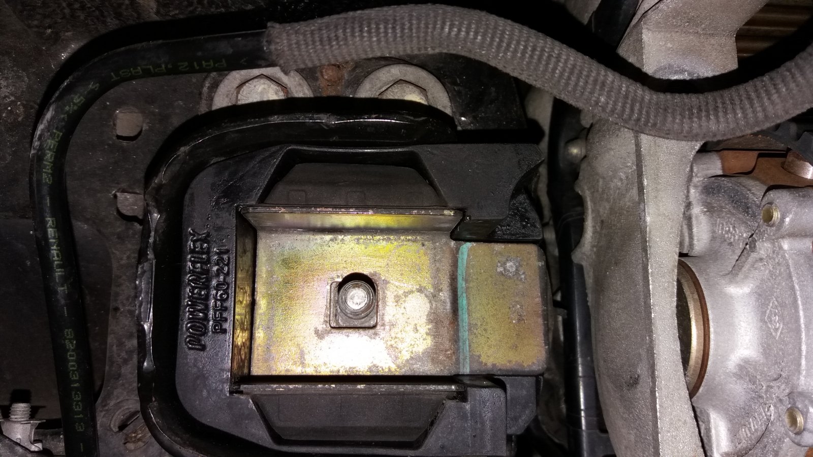

Check the upper engine mount on the drivers side. I had a fair amount of movement and put a powerflex insert in and it made a massive difference. Its about £25 for the insert and is really quick to fit.
Without the insert
With the insert
Thanks got mine ordered today it's a yellow insert though is there much difference?
