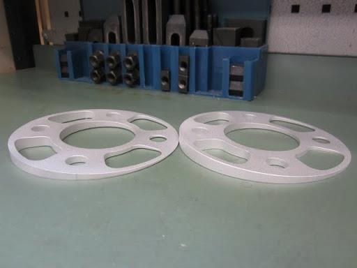

how about camber spacers?
I don't get how those work, surely if the bottom of the wheel is further out when you've fit those spacers, surely then when the wheel rotates the top would be further out, and so on, causing the cars wheels to be all over the place :s am I being stupid? Haha
Camber shims for a sport will fit a non sport with rear drums. Easy to fit just jack the car up remove wheel then the drum comes off by undoing the four bolts at the back. The shim goes between the drum and rear beam. Washers will do the job but a little dodgy.
