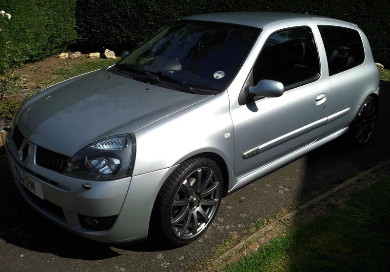

​Picked up an 02 plate 172 yesterday, grinning from ear to ear today, so much fun to drive, feels like a super powered go kart.
Cost me £1430, in the last year it's had a new clutch, cambelt, water pump, exhaust. Back tyres are virtually new, front tyres have loads of tread. New disks/pads/calipers in the last year or two. Had a load of receipts for all work done. Mot until April next year, tax until end of October.
Alloys won't be to everyone's taste but I really do like them. The bodywork has some minor dinks and marks that can be touched up, it is an 11 year old car though so it's expected.
Had a budget of up to £2300 so still have £800 for any unexpected problems.
