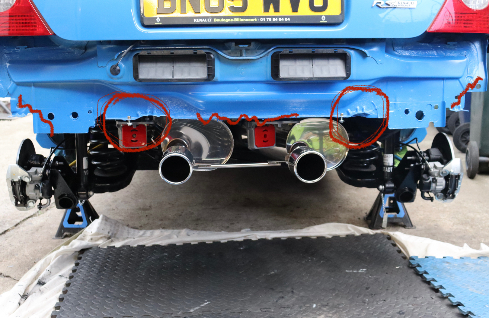

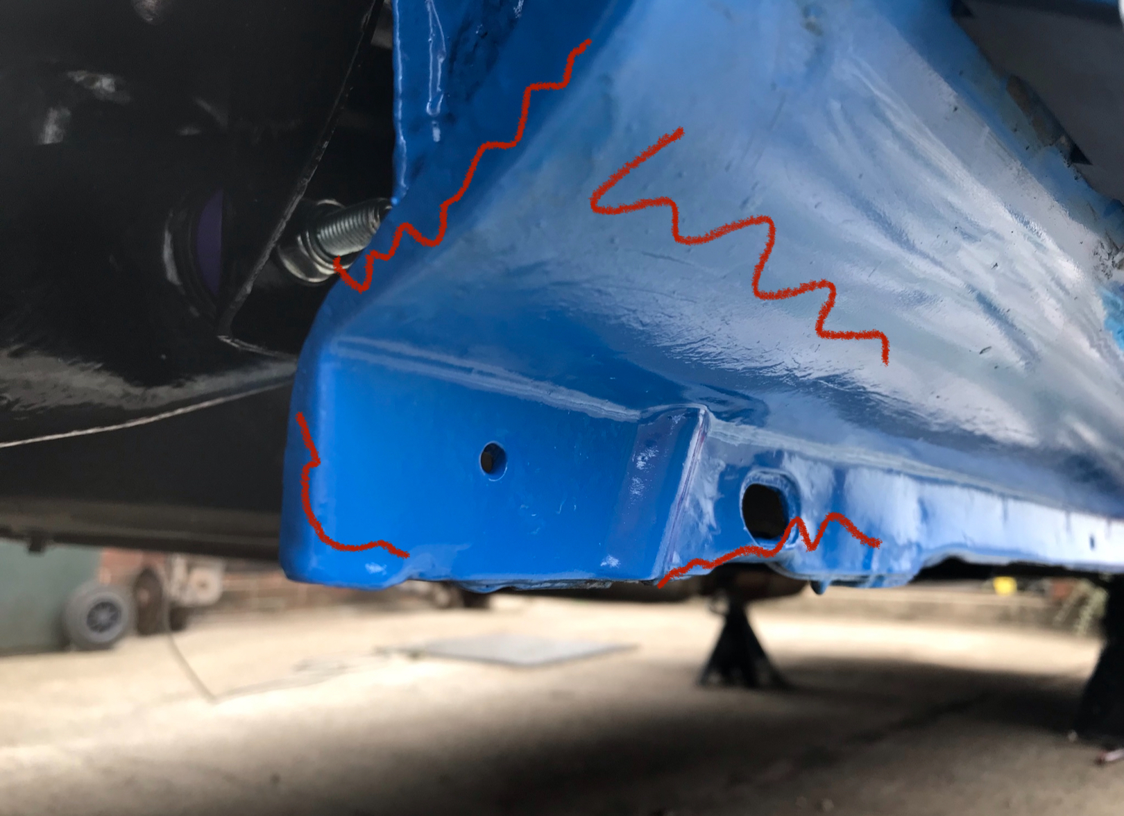

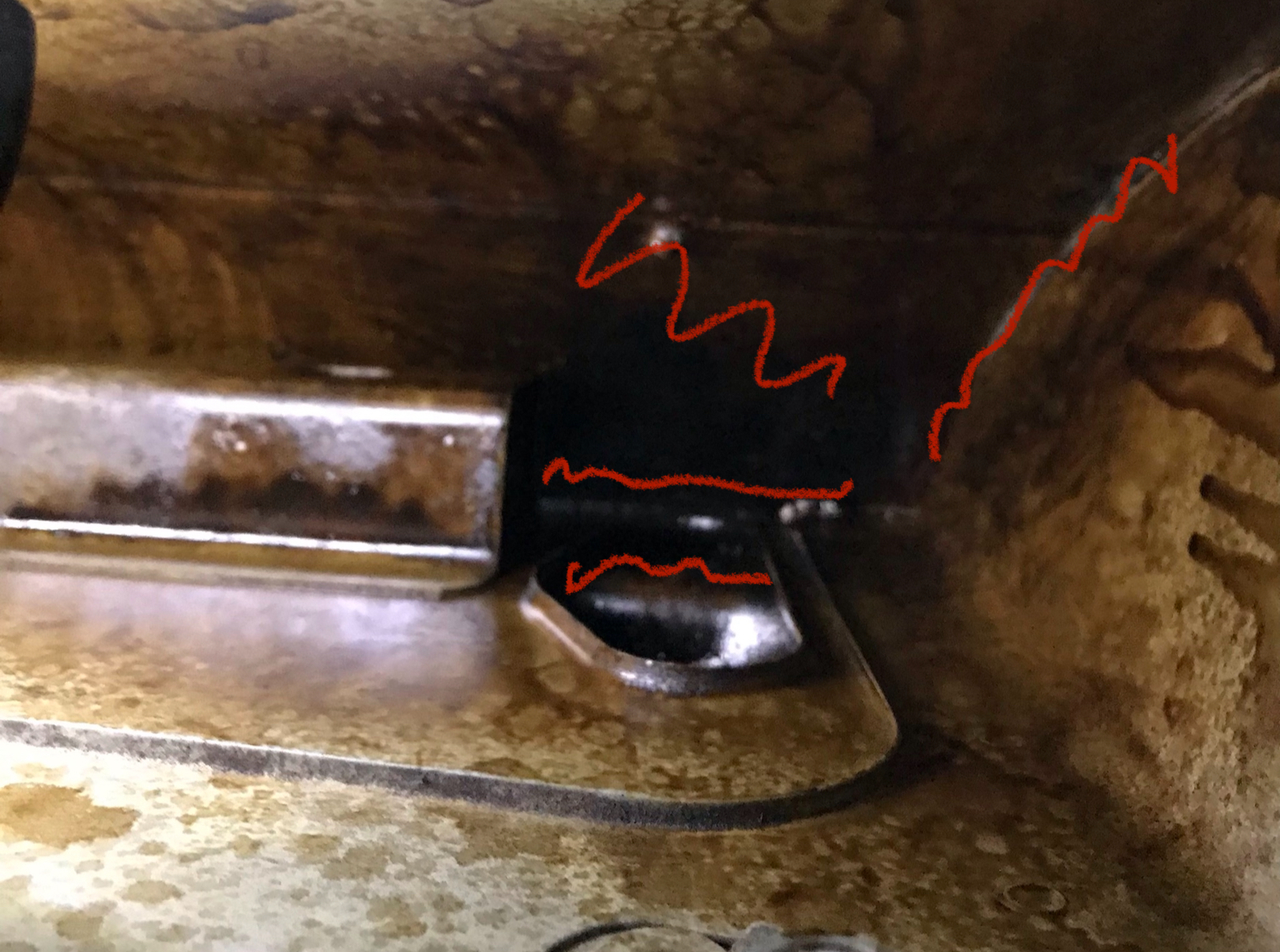

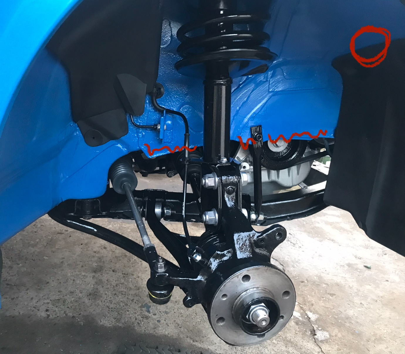

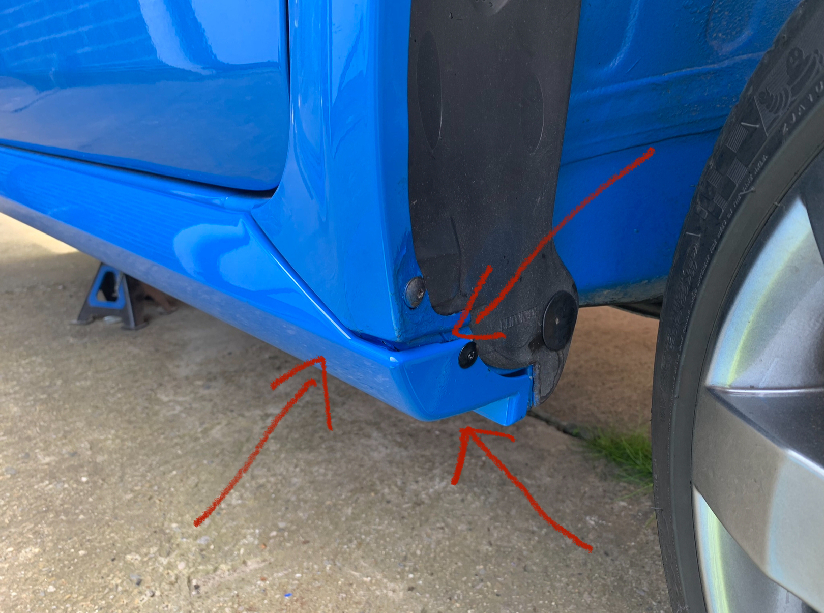

Mr Underhill
The dreaded rust has come up a few times, where do they suffer?
  • Inside petrol flap
  • Rear wings along the bumper line and down towards the lower sill
  • Front lower sills around jacking points where water and dirt gets trapped behind the skirts
  • Chassis legs above the rear spring bumper stops and along the A frame
  • Under the rear exhaust heat shield where the rear pipe bends over the rear subframe and around the petrol tank in that area
  • Front bumper brackets
  • Along the front inner arches
  • Behind the rear bumper where the lower valance meets the upper chassis.
I don’t have all my pics on this phone but I’ve highlighted in Red squiggle for you the typical places to look. Not all places are accessible but somebody who’s looked after their car shouldn’t have an issue with letting you get in and around it.

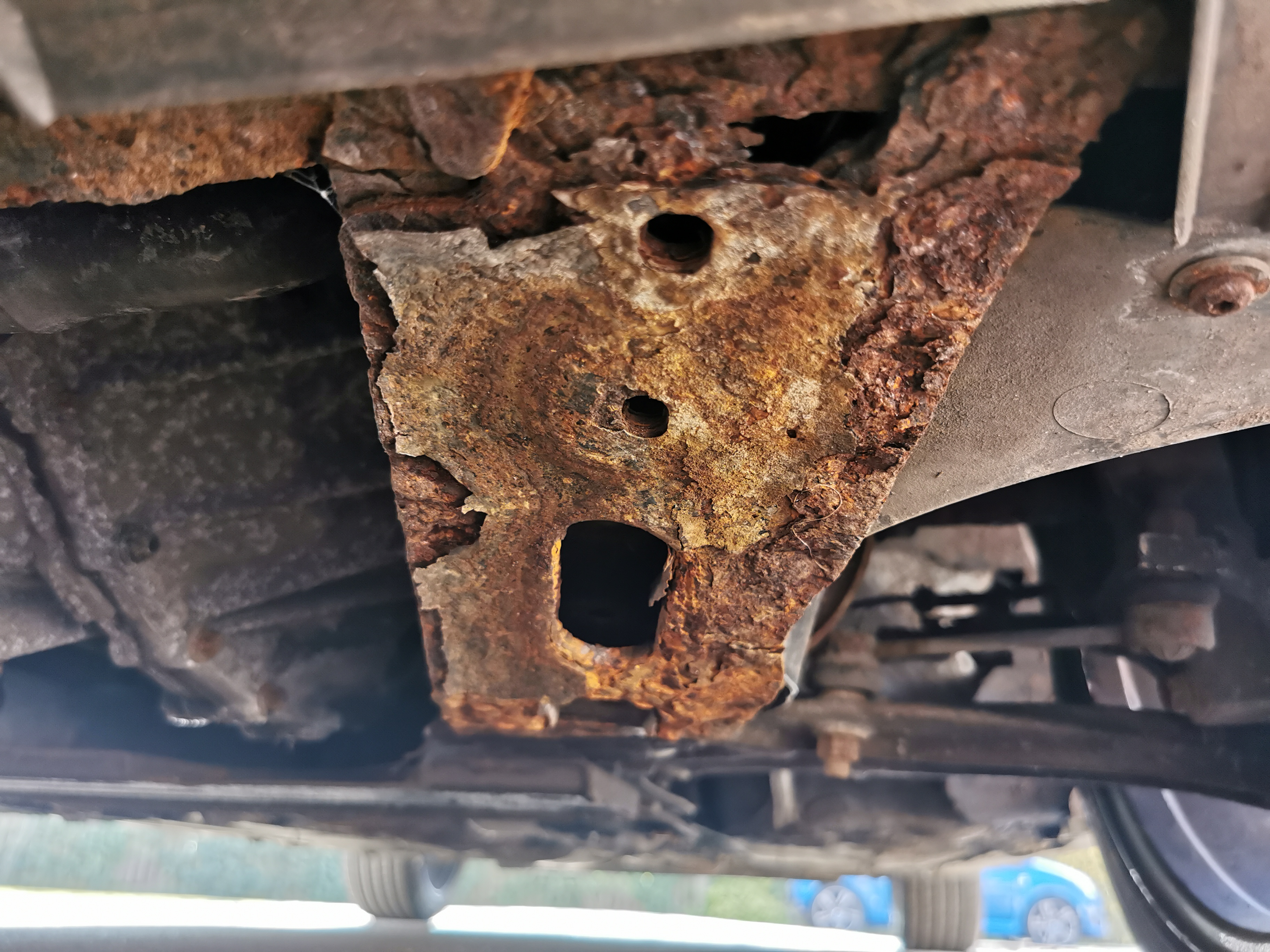

Mr Underhill
Front and rear subframes, more so the rear as the front is galvanised. It’s not structural though and many owners whip these off and have them powder coated.
Clio_fool
Really the only one's with serious rust issues are the phase one's. The 182's are starting to go but a well looked after one shouldn't give you too much to worry about. Crushed jacking points are probably the thing to look carefully at as it'll let moisture in to the sills.
Compared to the mk3 notorious rusty rad support the mk2 looks like a Delorian 😂.
Not sure that's supporting my radiator all that much.

What a comprehensive list (y) , brake servo and behind the ABS valve block were areas I found grot too. Rear exhaust mounting brackets and the bracket that has the headlight level sensor attached to it.
Most will have the front bumper mounts rusting and that wouldn't worry me, but if you see any rust bubbles on the in front of the rear arches I would personally stop and have a good think as that means the rear inner sill is probably good and crusty and thats relatively involved to repair.
