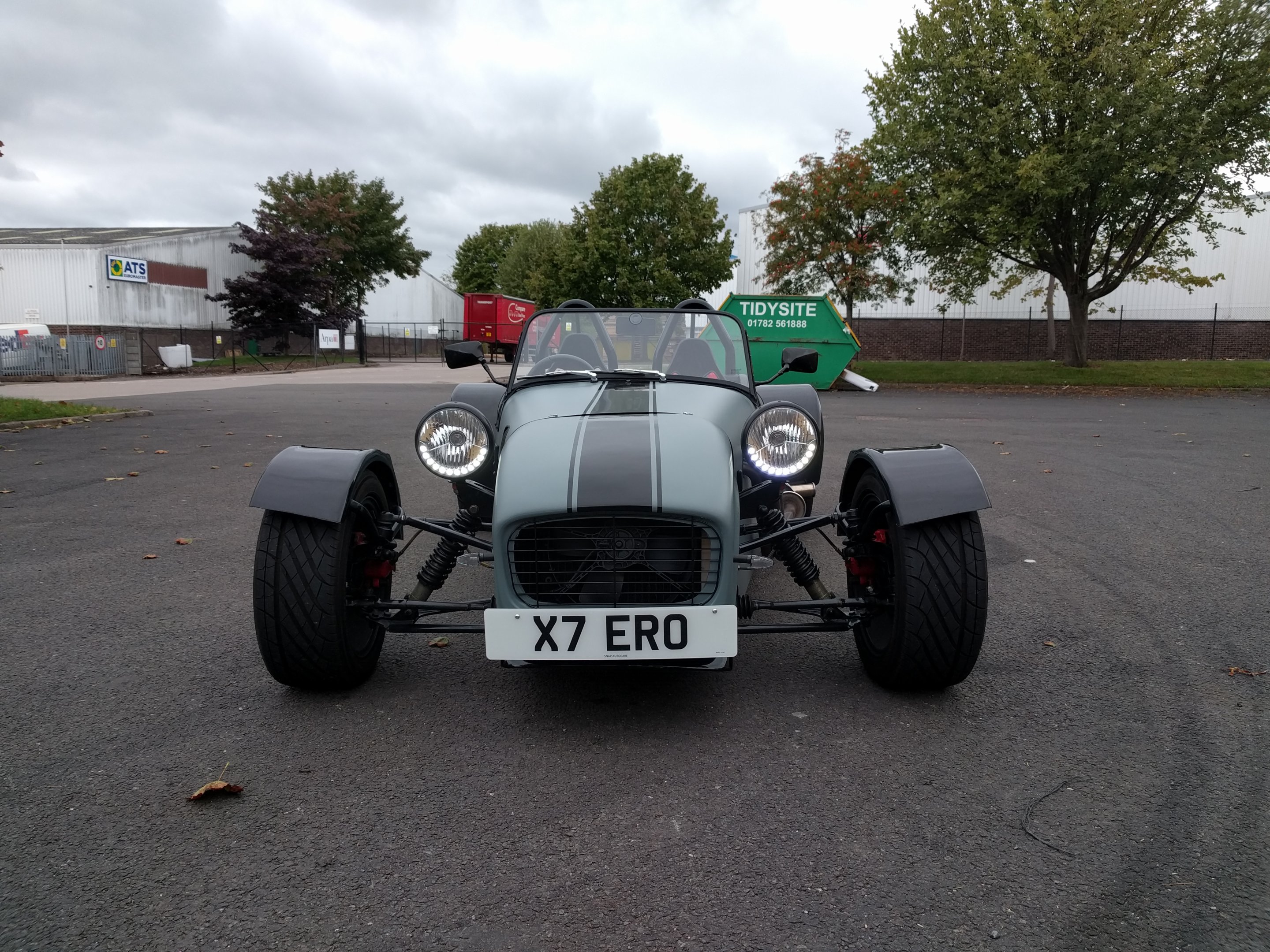

Love it.

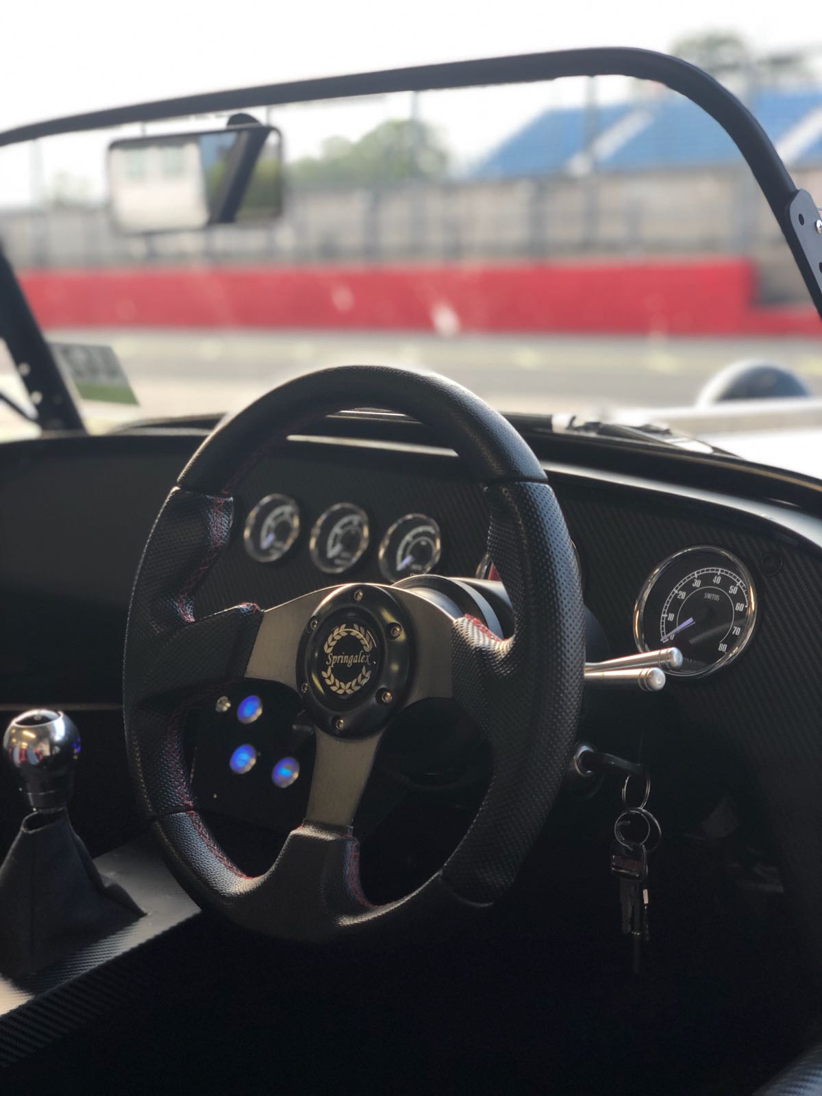

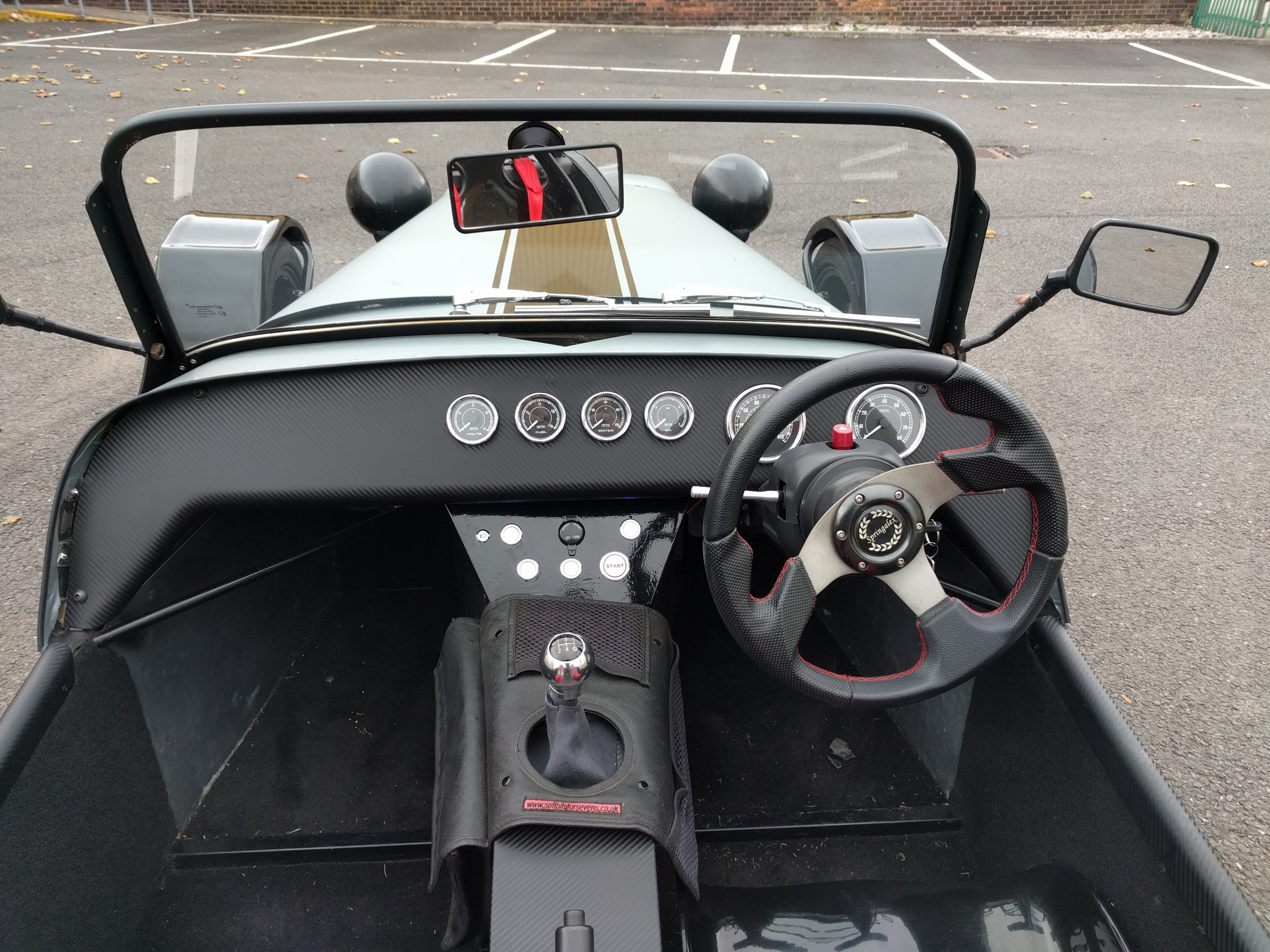

Steering wheel does look like it is from a Saxo owners facebook group. What are you getting instead? OMP trecendo or something?
Would look great with some TD Pro race. What wheels options have you got?

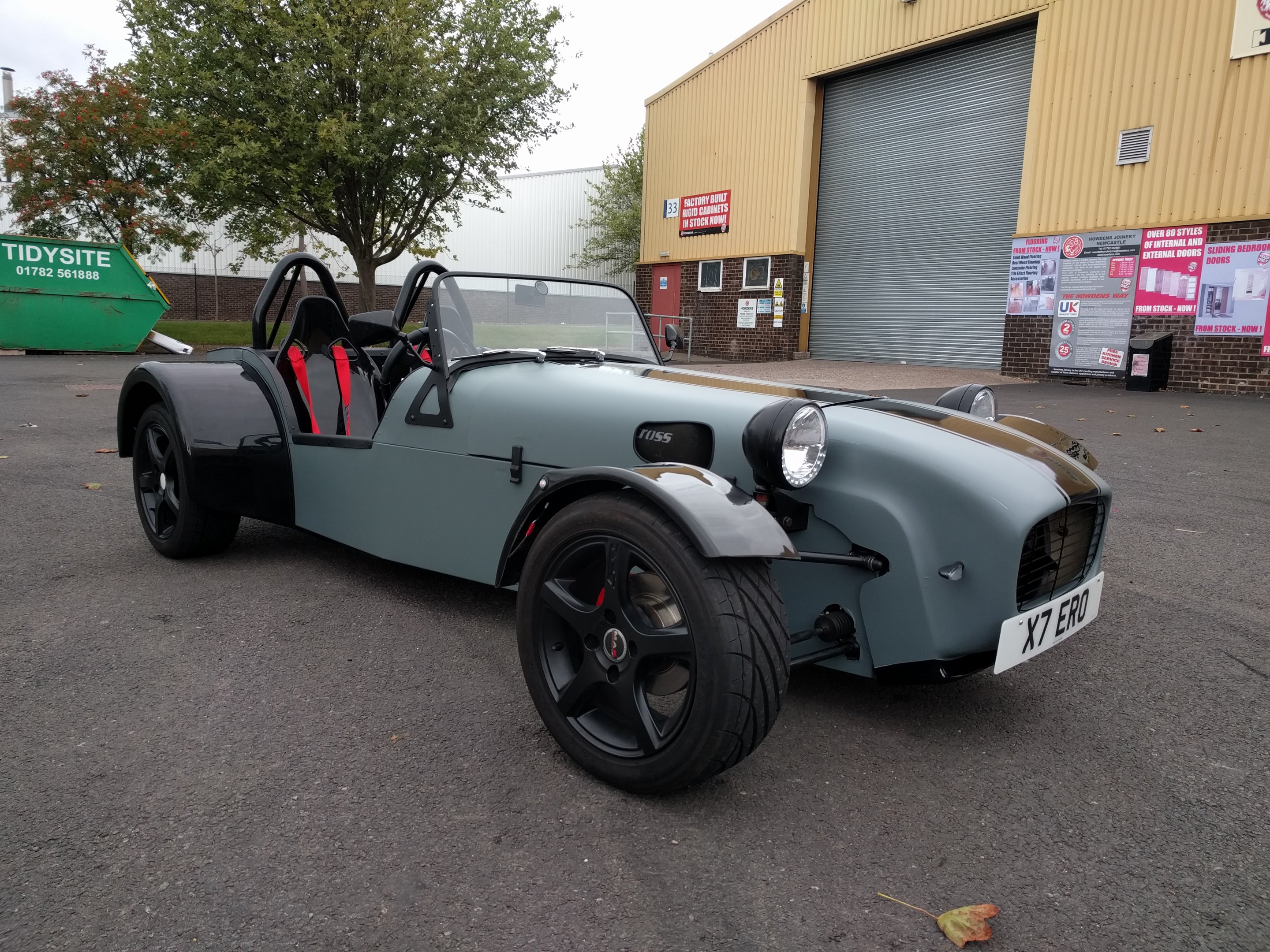

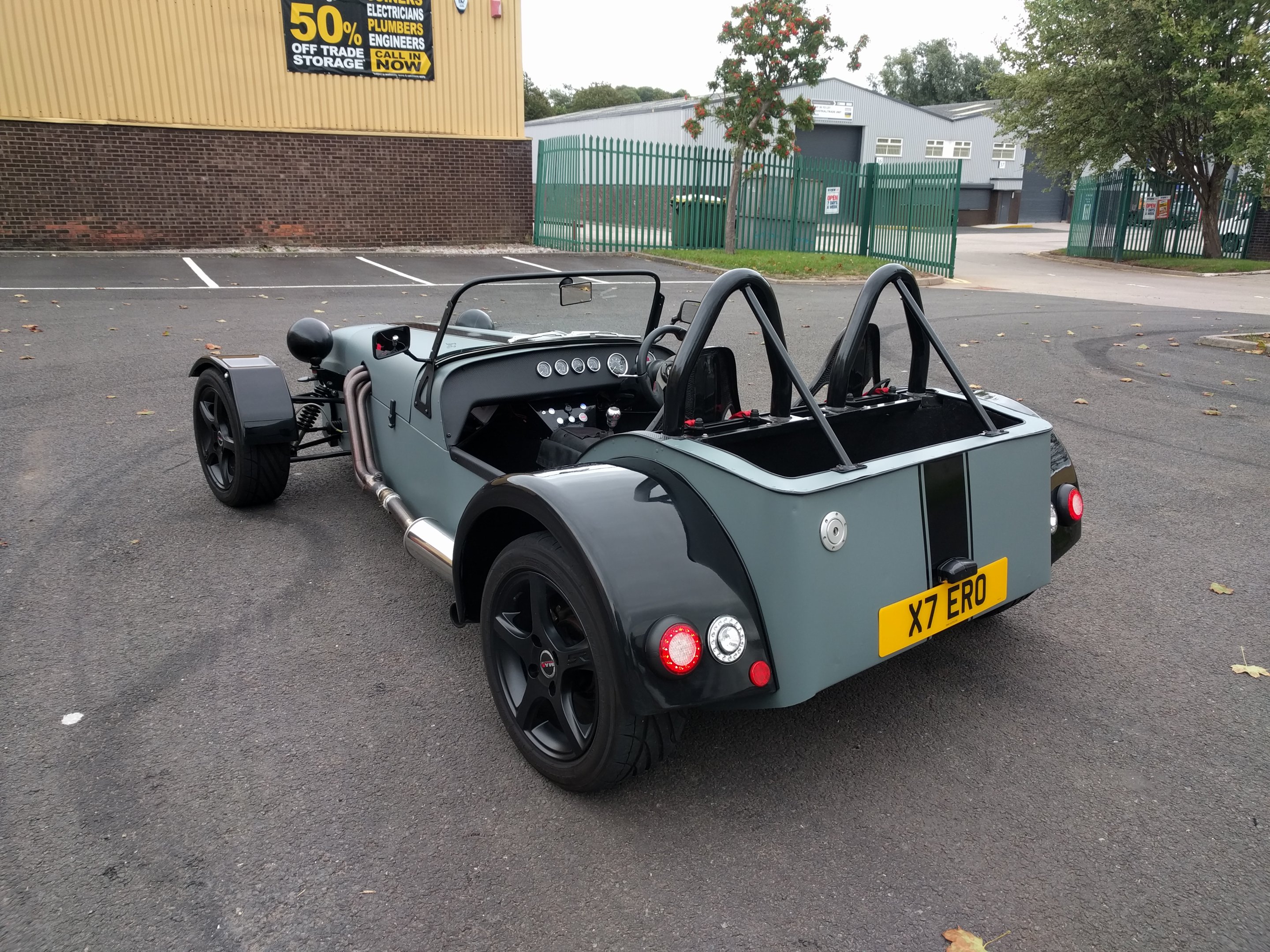

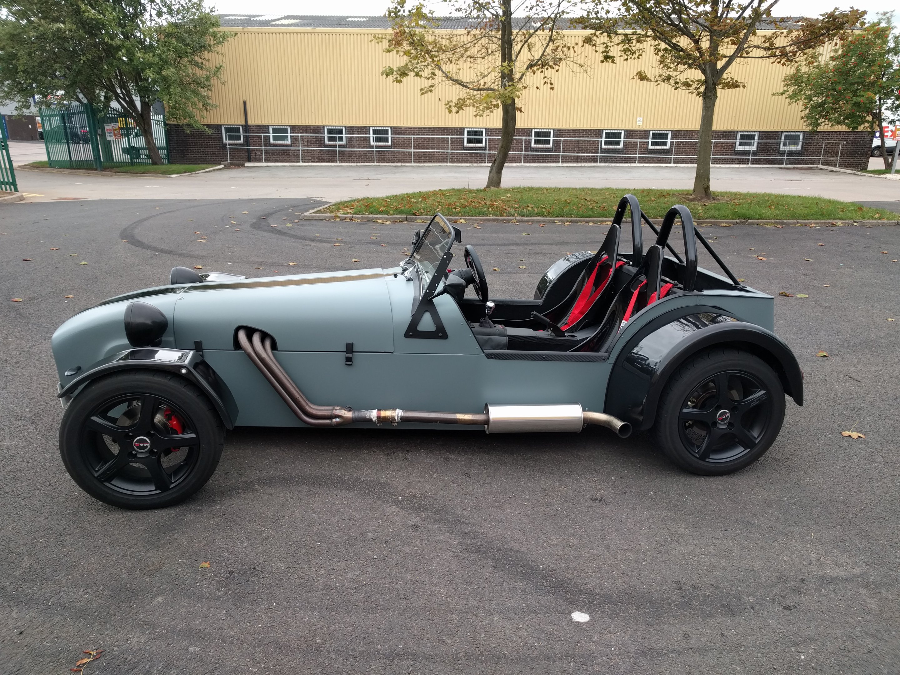

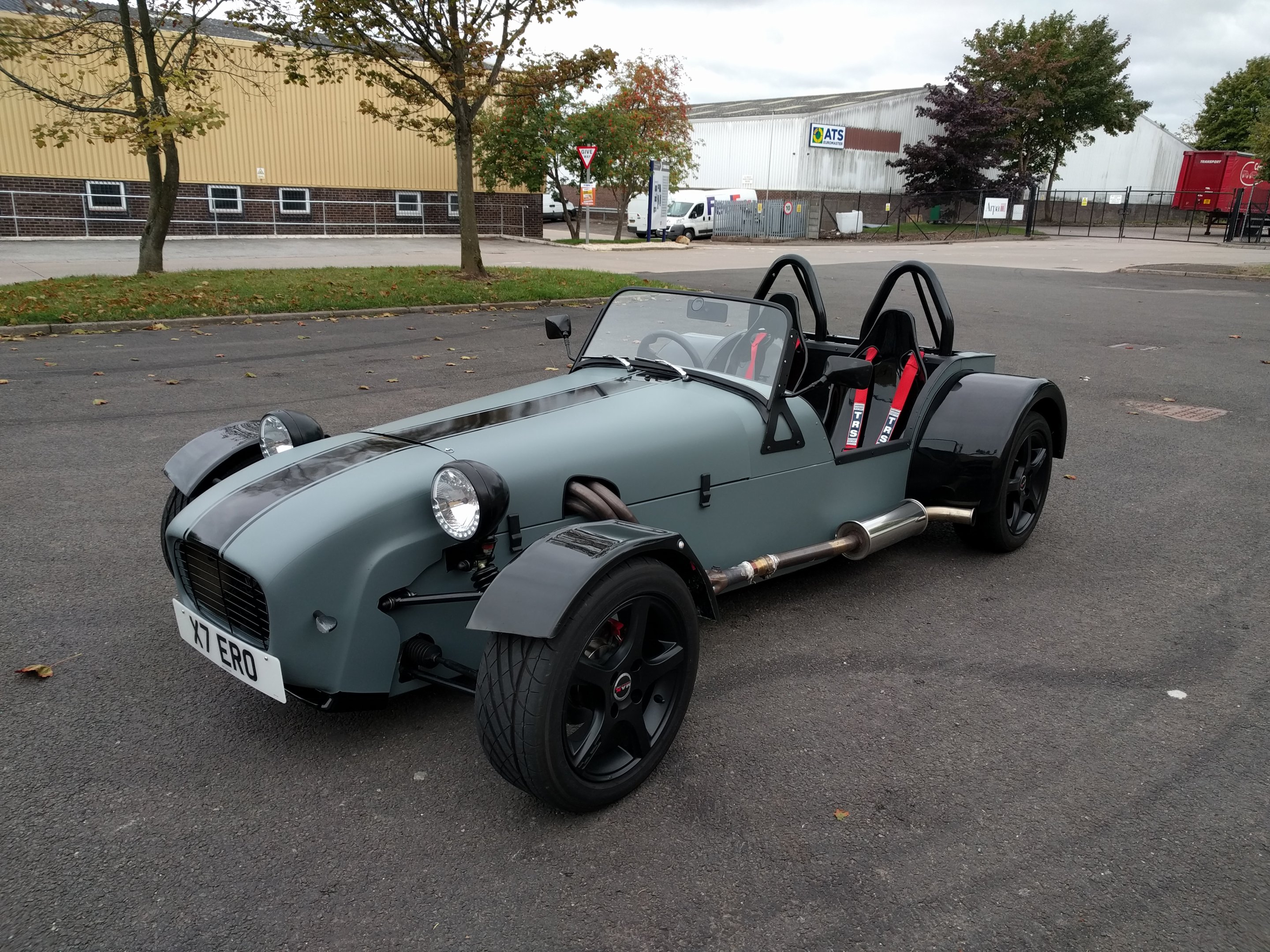

MOT passed with flying colours. Garage was mint and got me to do some of the testing with him. He said it's one of the better built ones he's had come in.
Was pissed up in the garage after the England game till 1am this morning, and then back in there at 6am finishing bits off.
Donnington park this afternoon to get a feel for it!
Love it.
Yeah it'll be some sort of OMP/Sparco wheel, and yeah pro race 1.2s probably. Bit samey samey as all the other kitcars, but they suit them well.

Looks great now. A change of wheels and new steering wheel will finish it off perfectly.

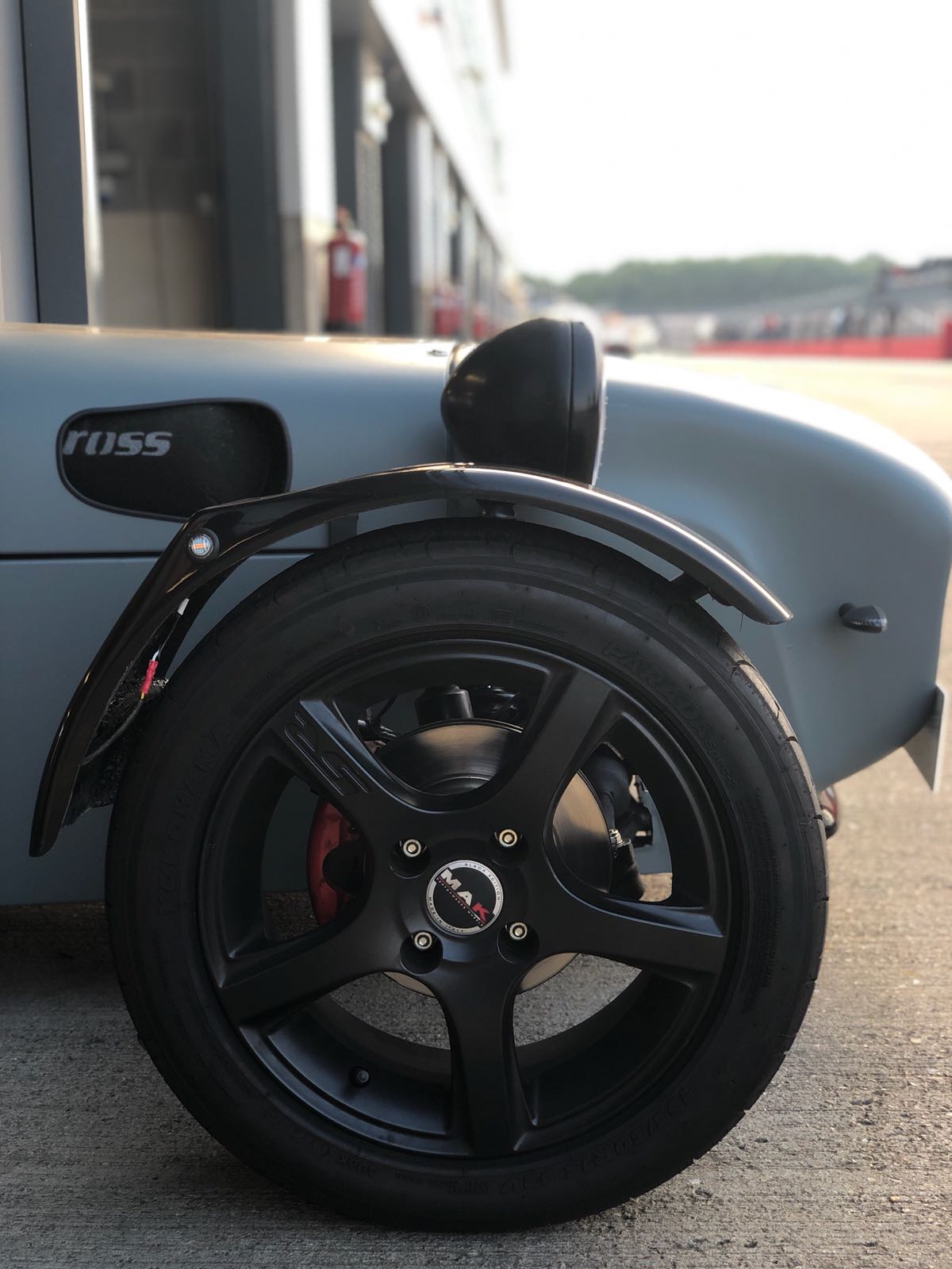

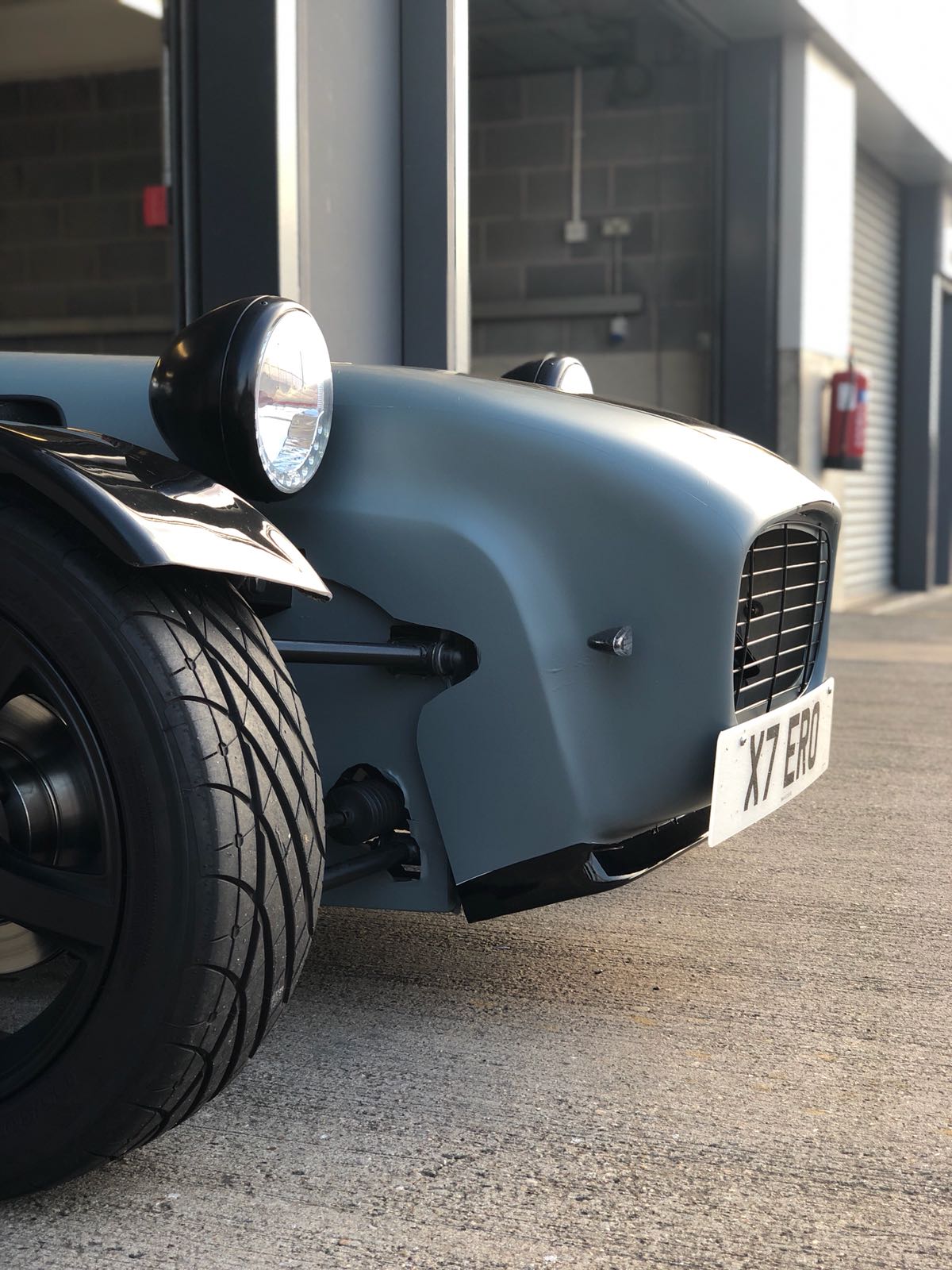

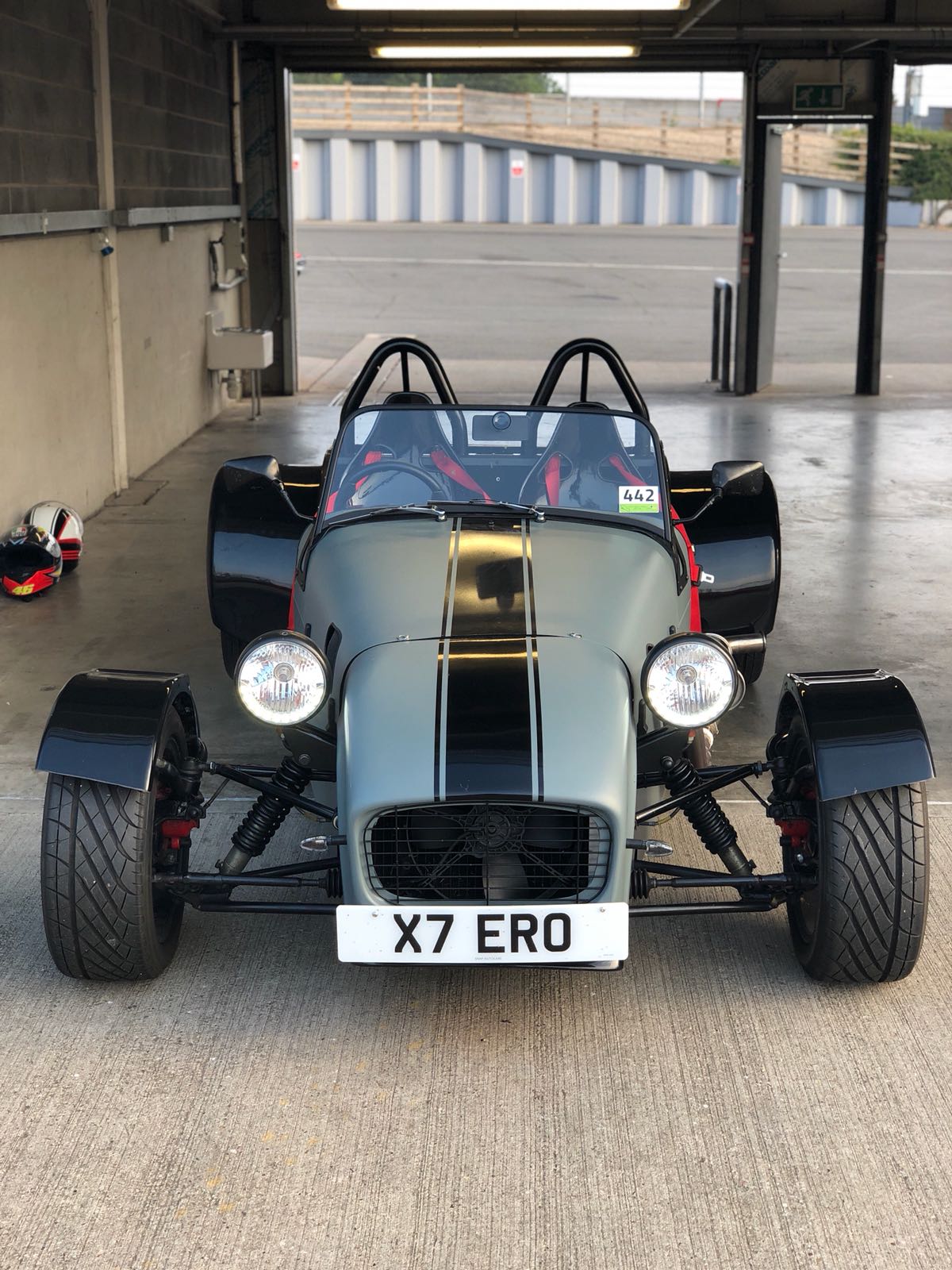

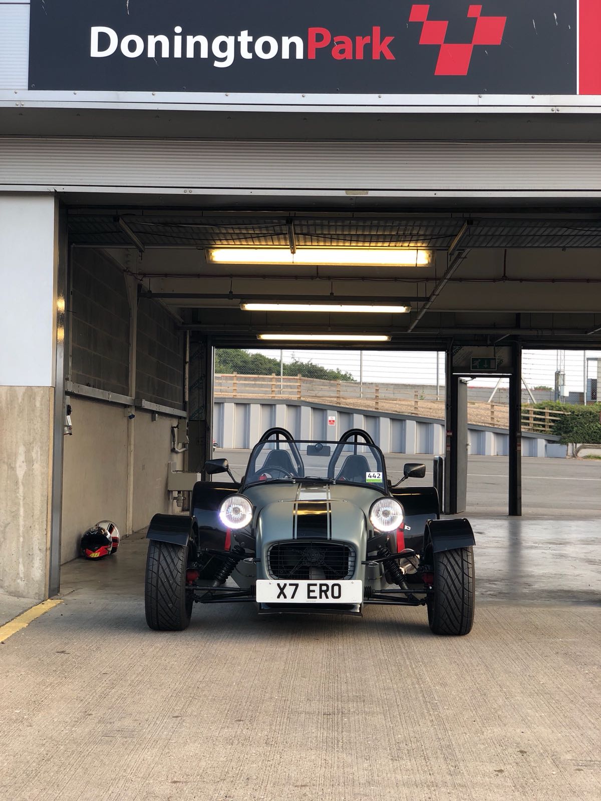

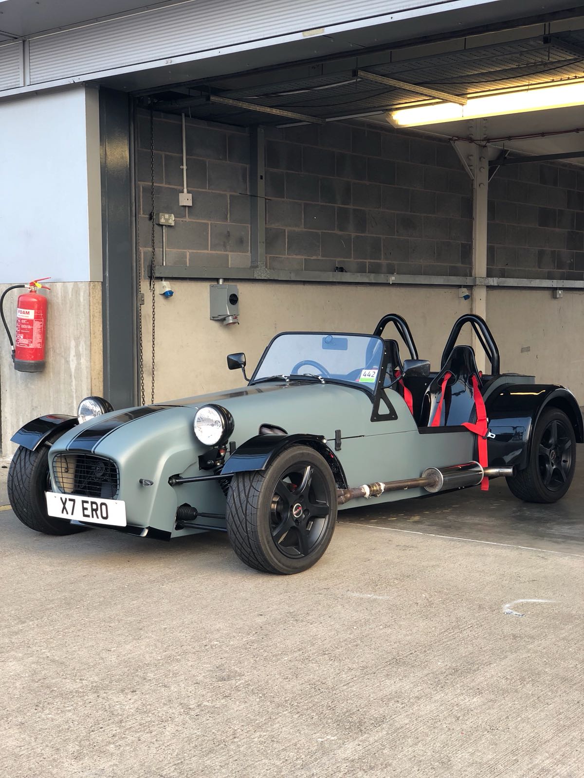

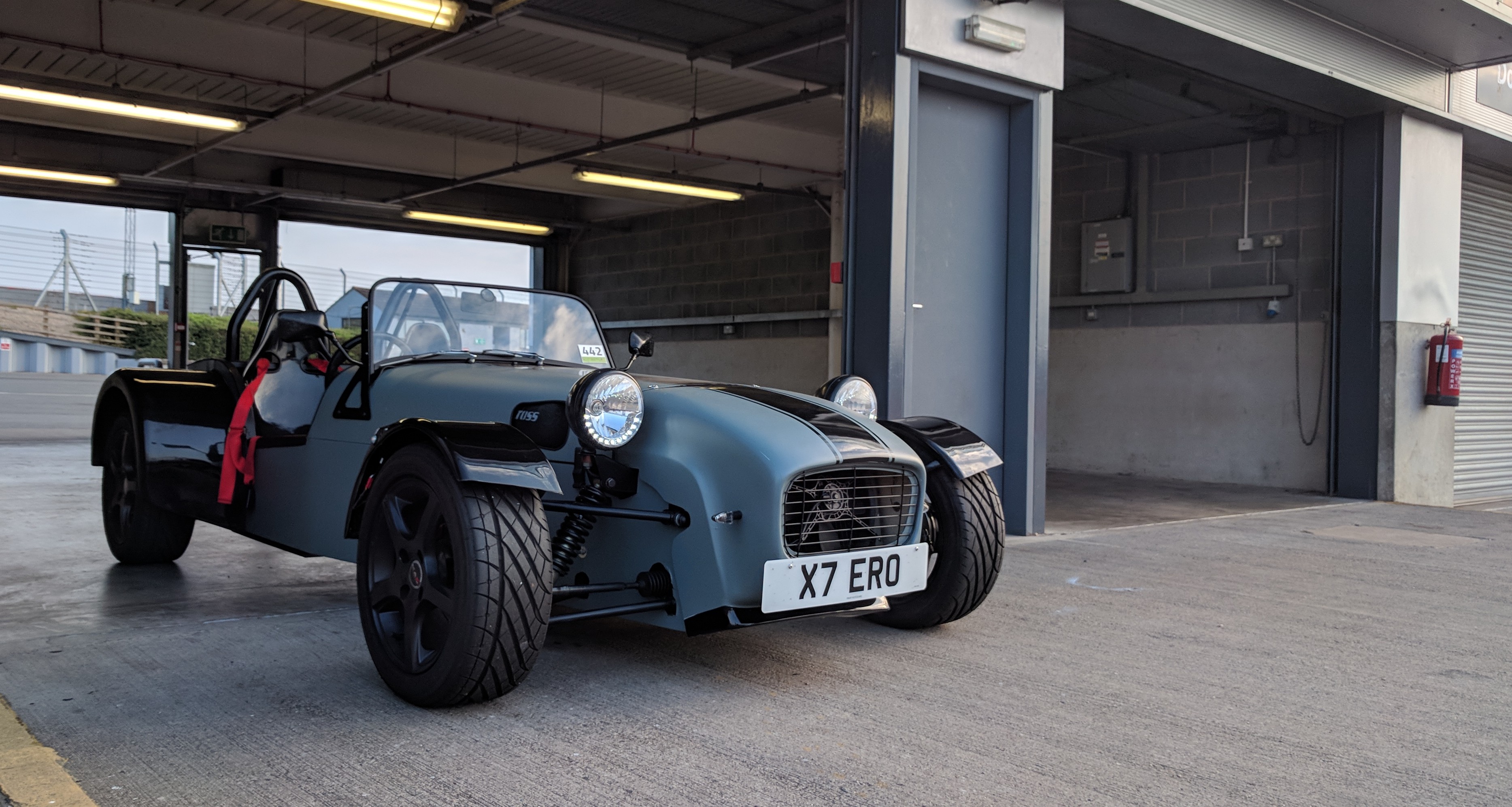

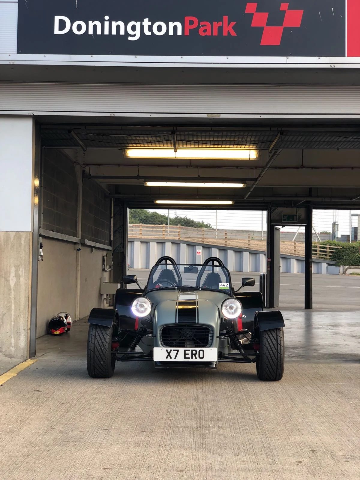

So after it's MOT this morning I came home for a few hours kip, and then set off for the evening session at donnington.
Really enjoyed it, but it certainly wasn't ready to chuck straight on the track! But at least I now know the niggles that need ironing out.
Could only do short stints on track before water temperature was sky high. The gauge is probably massively inaccurate, but it showed 120 degrees at one point. Bit of hissing, and a bit of coolant passing by the rad cap, but left to cool and all was good. Will look into flushing the cooling system, and making sure it's all bled properly etc.
Alignment is miles out, so a proper set up is needed. Also need to get my NS2Rs on.
It made it there and back drama free though, so I'm happy with that. Only problem is, I now ache like f**k!
Anyway, some pics
Oh and yes, the gay MOT friendly plates need to come off

let me know what the geo readings are and we can look at what may suit how you drive.
The temp thing is a concern as seen this happen alot with poor cooling setups on zetecs
i suffered similar for a while and i am going to say it sounds from the header tank pissing water it did get very hot .
i will look back at your pics and tell you what i think but a big decent rad is a must (look on waiteys thread he has had to do the same)

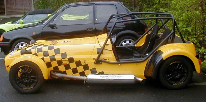

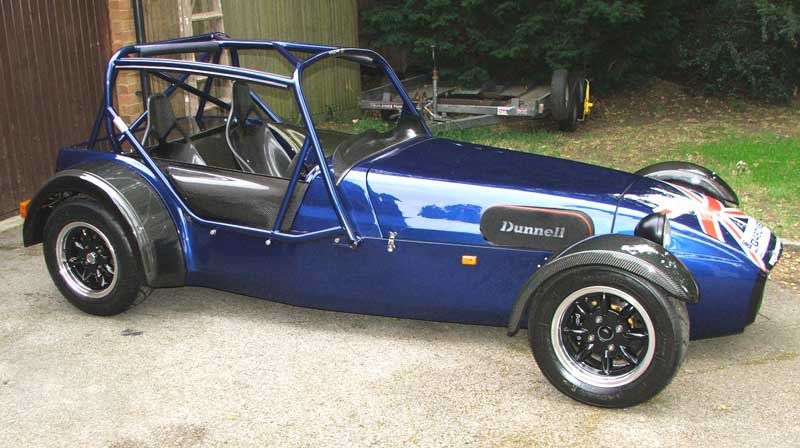

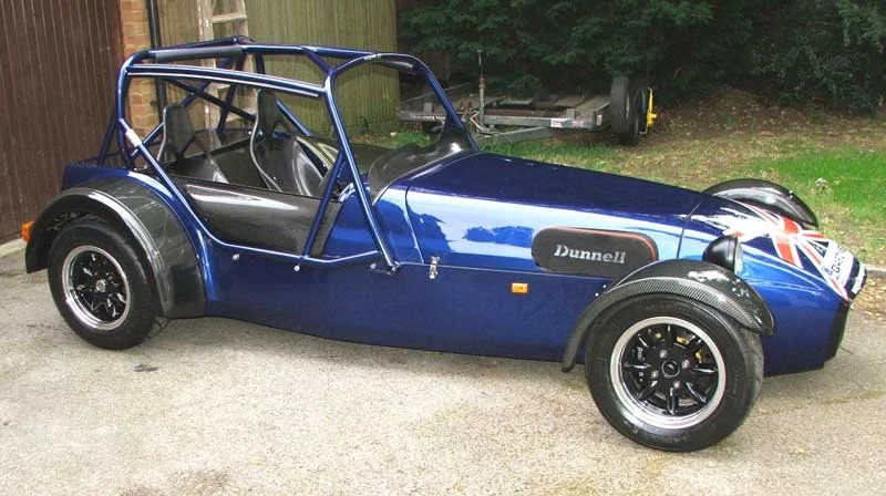

as for the question above about westies and looks
here are my before and afters , always buy on build quality and mechanical spec
and the yellow pic is part changed because it had the cage added at that point and no screen .
it came with roll bar and full screen and doors

i will be honest it was the raceline rail that gave me exactly the problems you have.
i ditched it for the dunnel option.

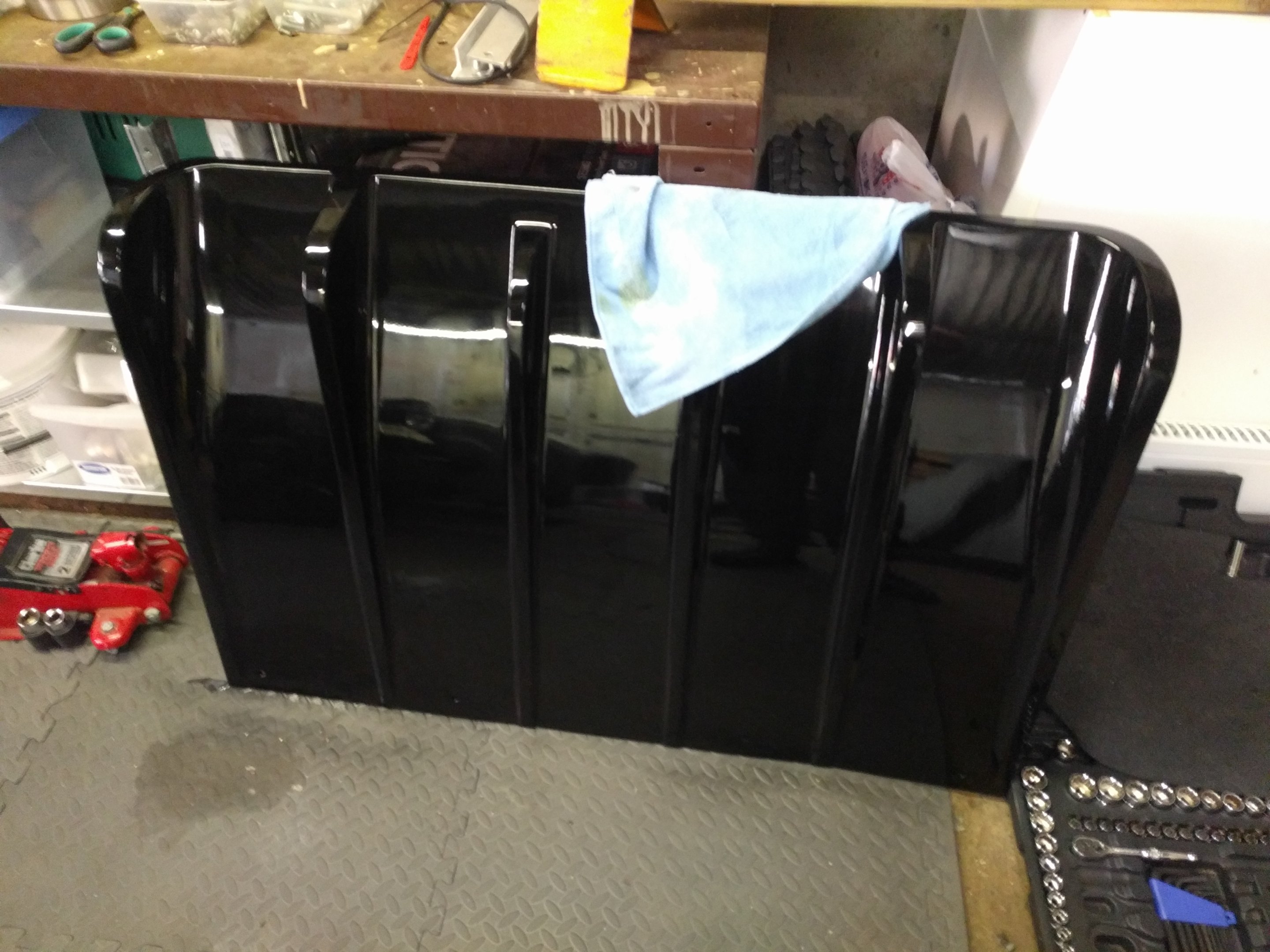

Picked the rear diffuser up from the paint shop earlier. It's civic type r nighthawk black as that's what he had laying about.
Matches the arches perfectly! I'll try get it fitted tomorrow

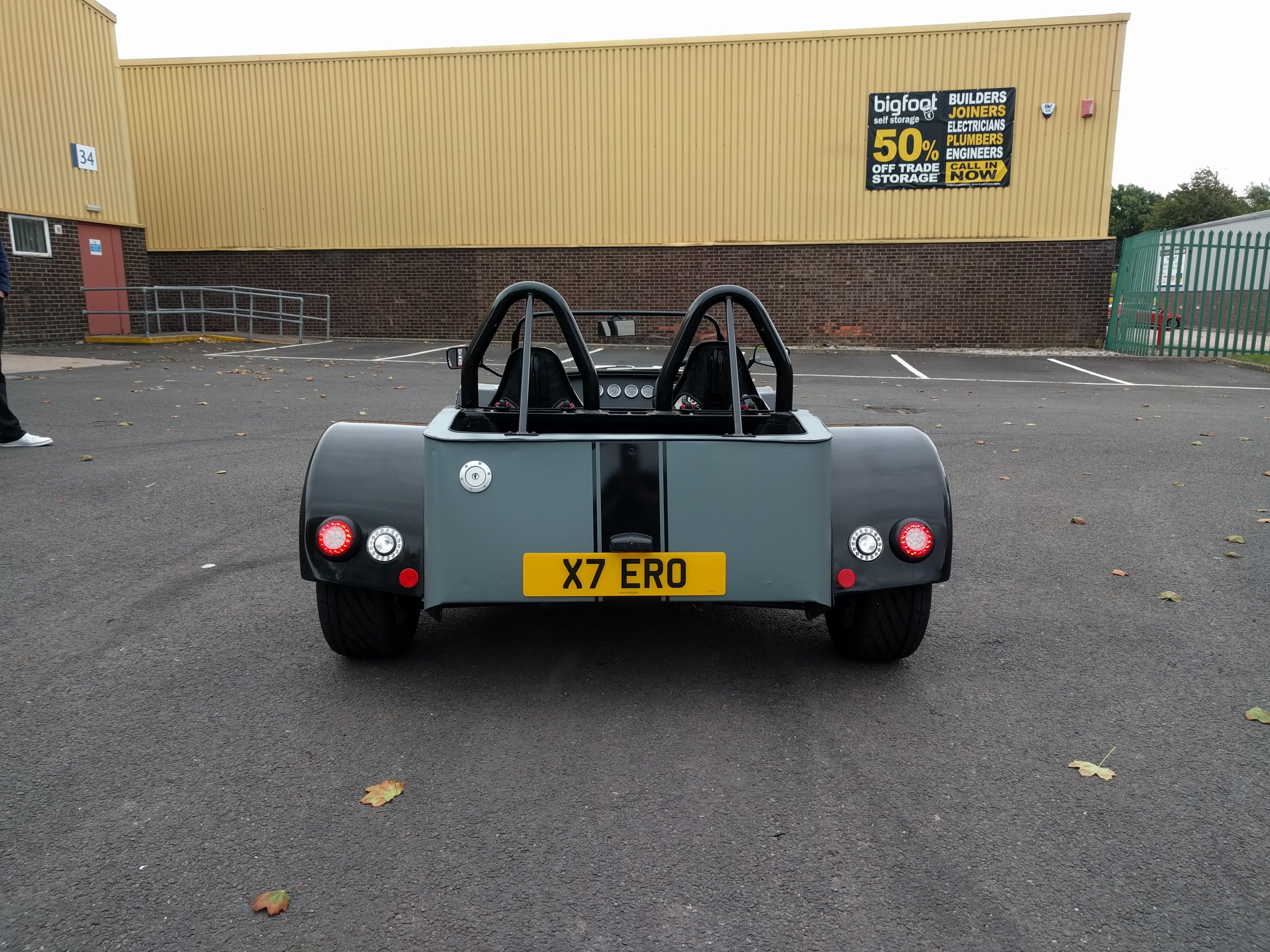

Love the car s'o much. My only gripe is the rear number plate looks huge compared to the rest of the car. Almost look's like it need's a 3/4 plate or somethin'g. (I know you'd be pulled instantly lol')
Ol’ Tarby
  Clio 220 Trophy
What a great advert. Very well written mate.
Mate, the front looks even worse...
Still got my MOT plates on. Haven't got round to swapping them yet lol
