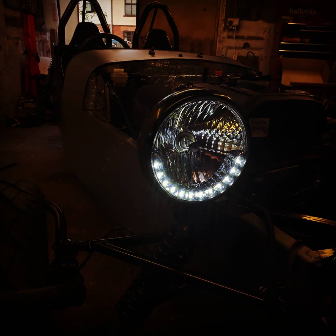

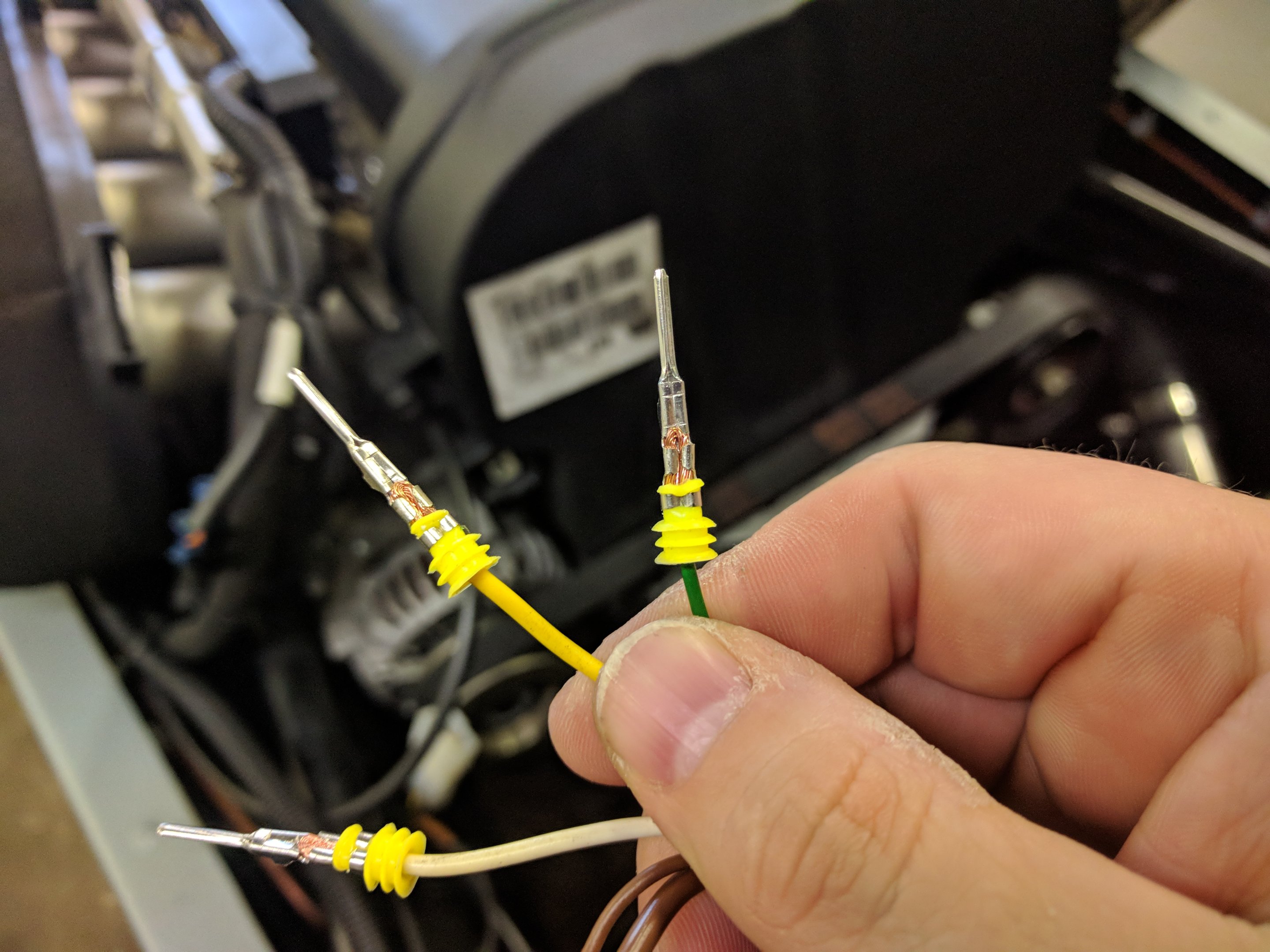

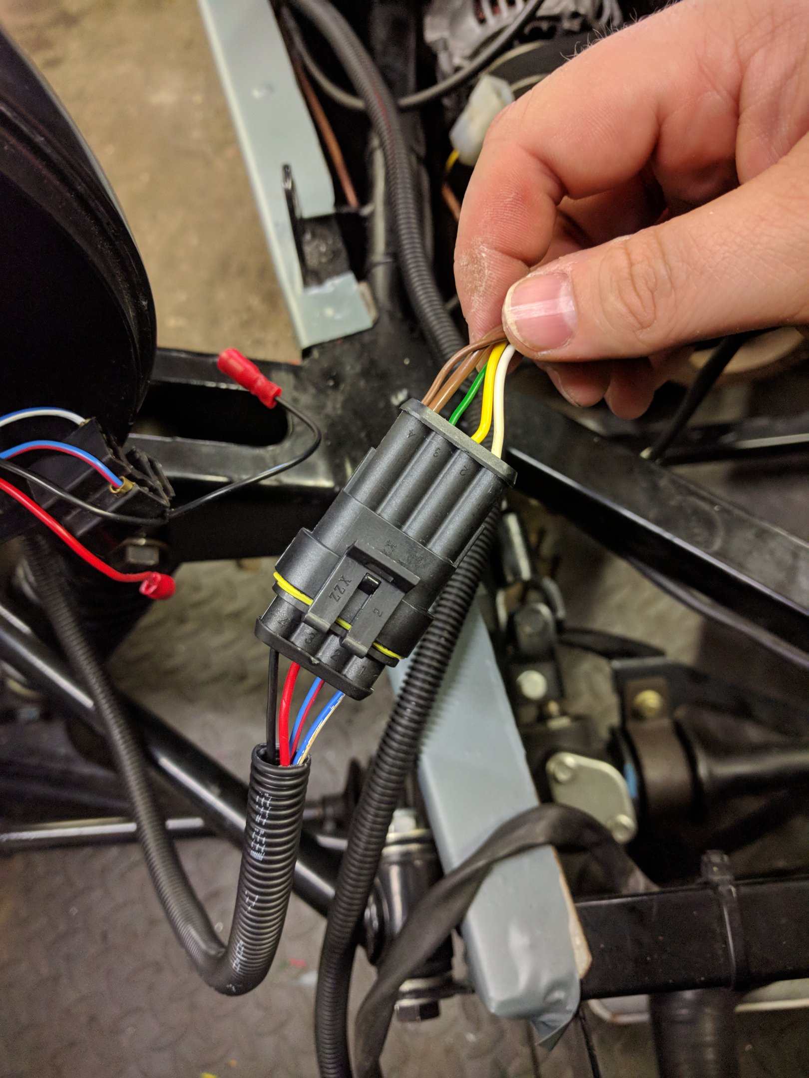

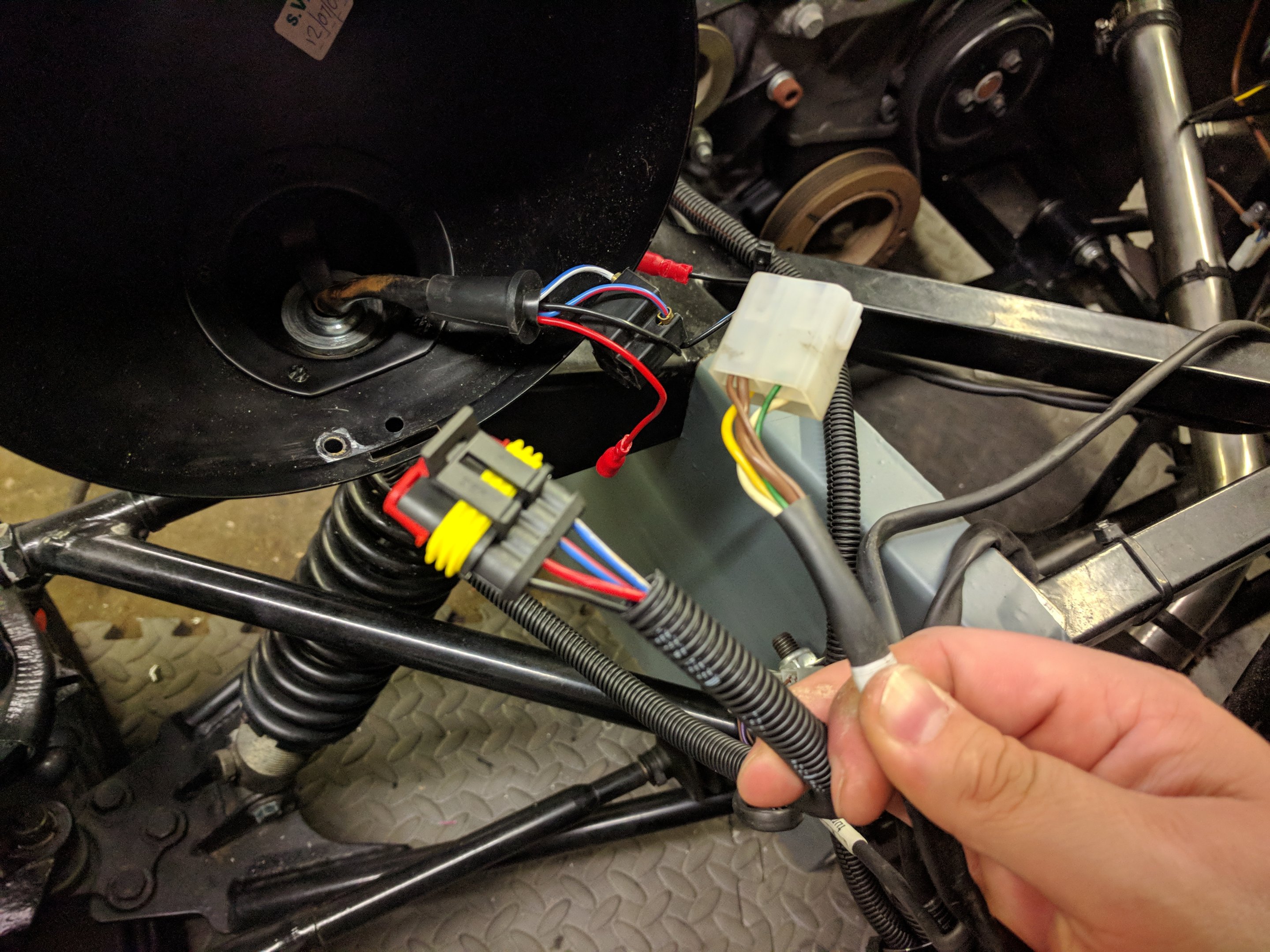

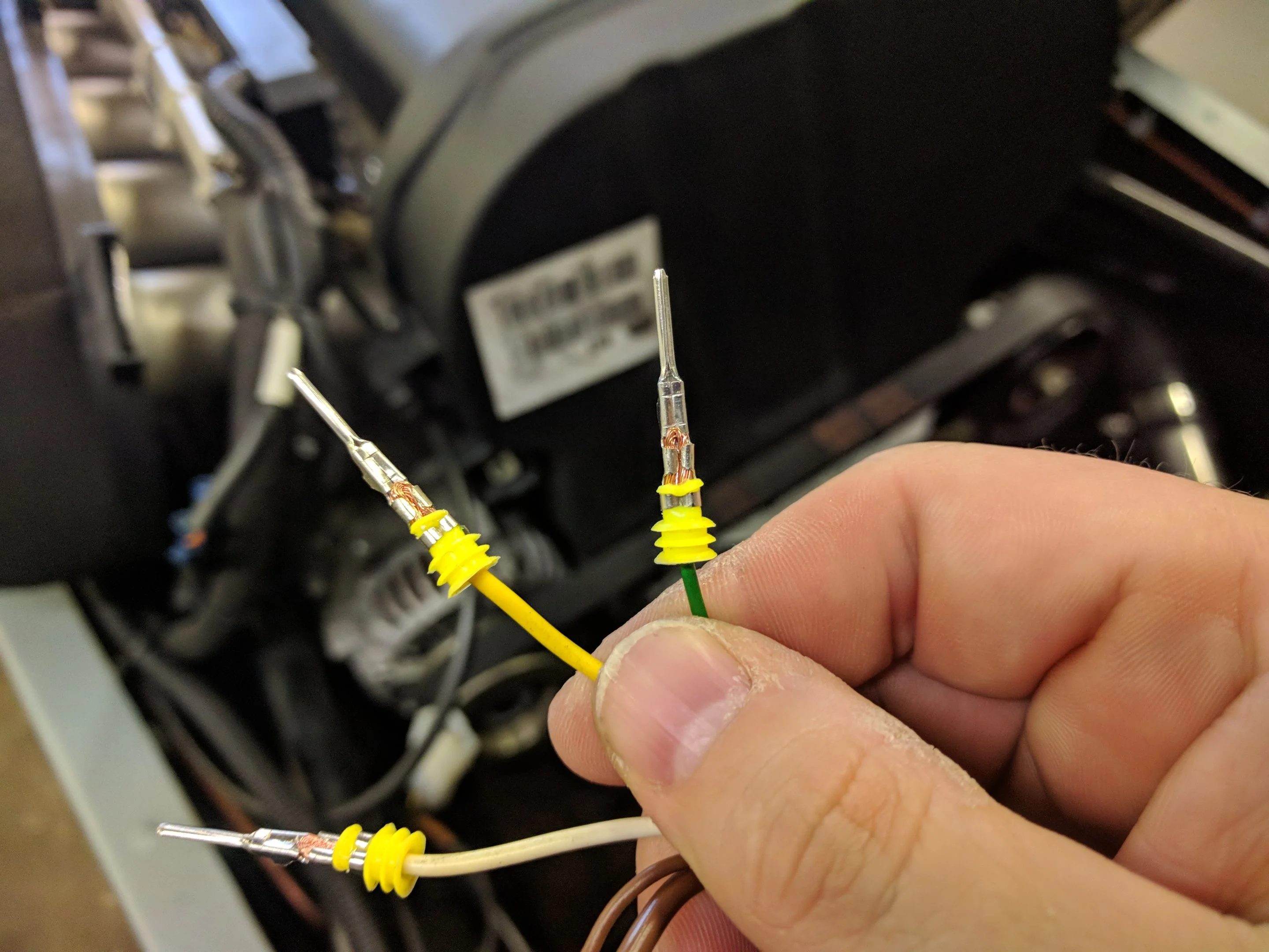

Another job crossed off tonight. New headlights fitted along with new connectors. Replaced the shitty old ones with something a bit better and also waterproof
Old Vs New

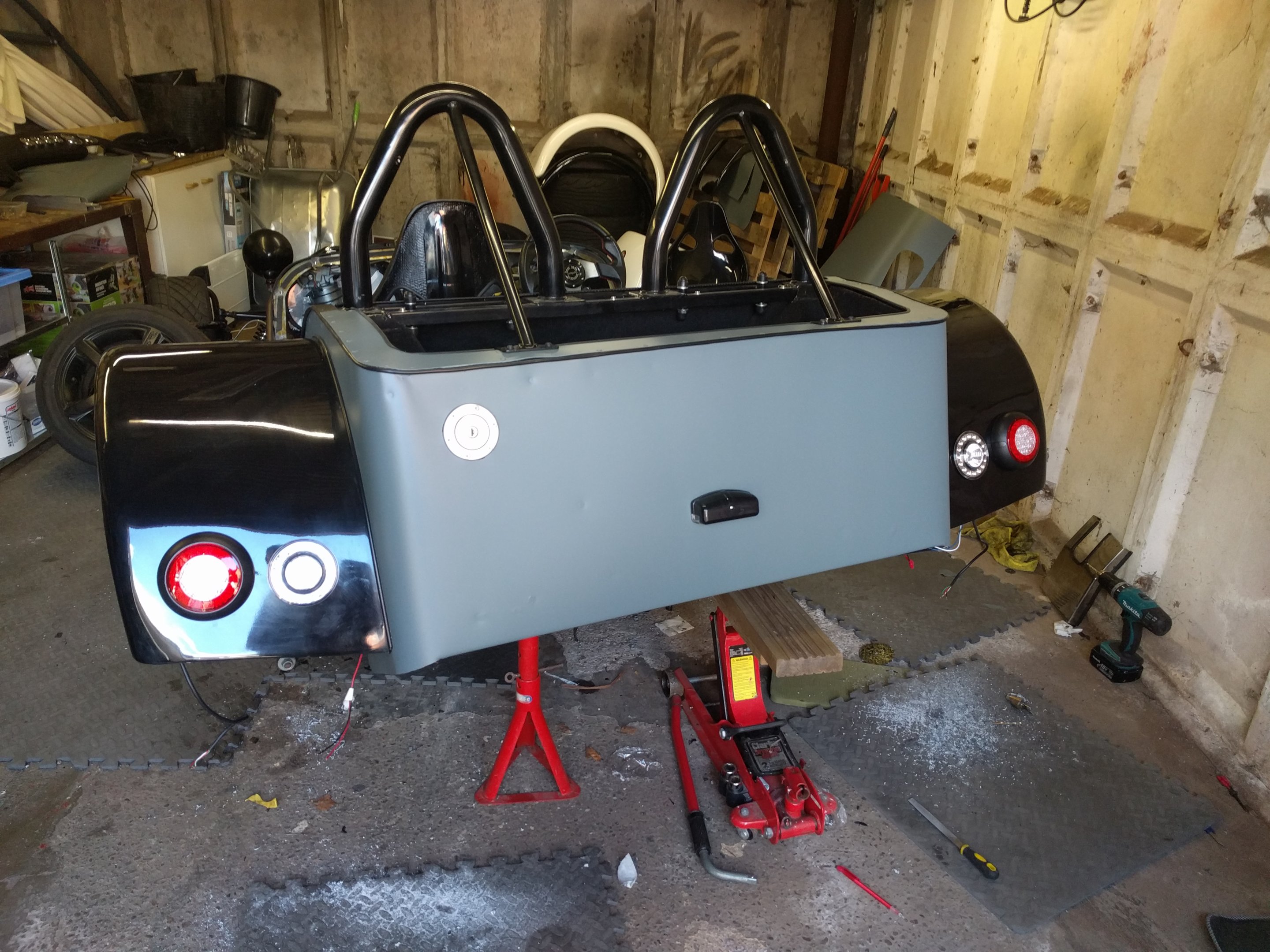

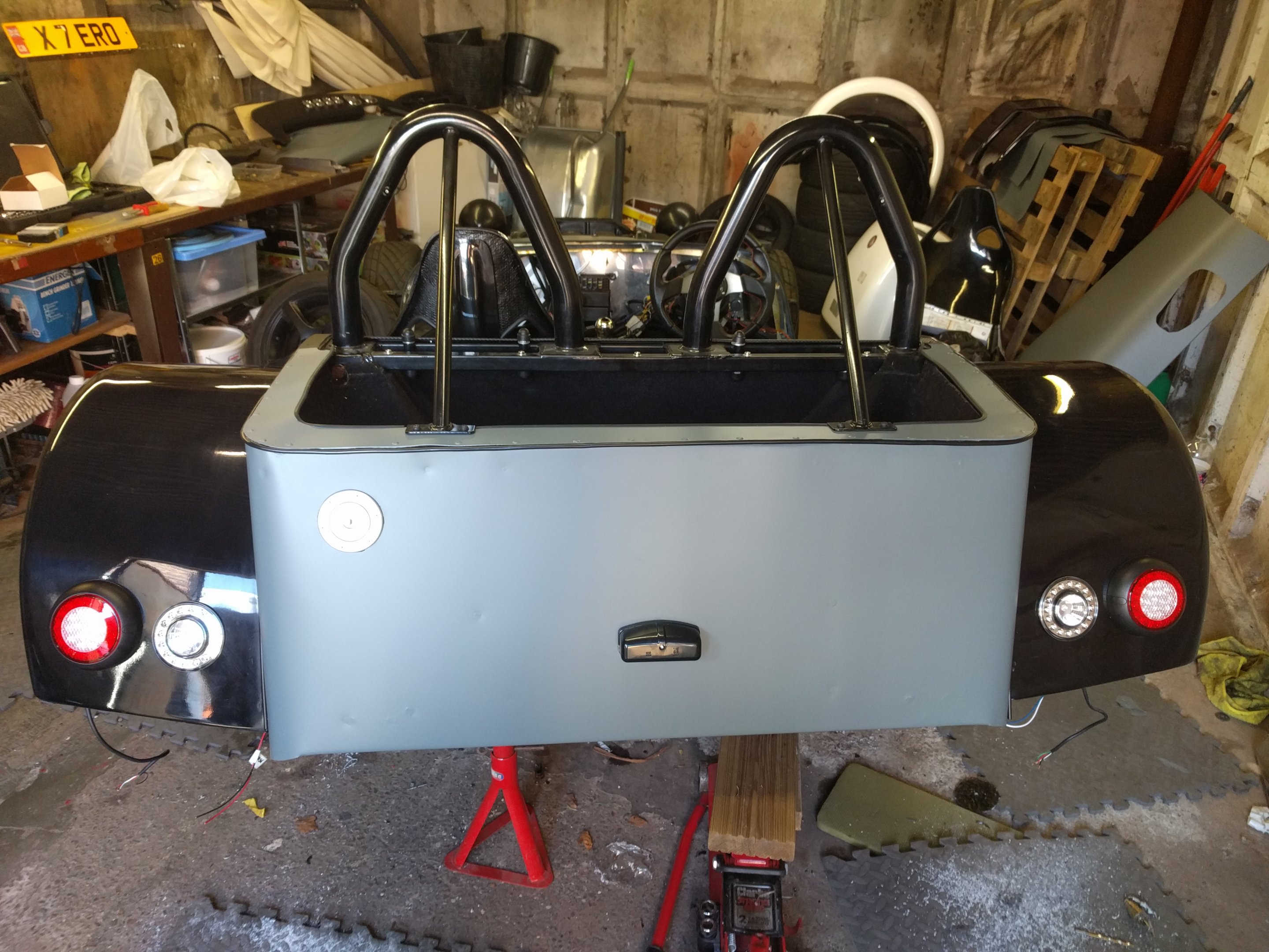

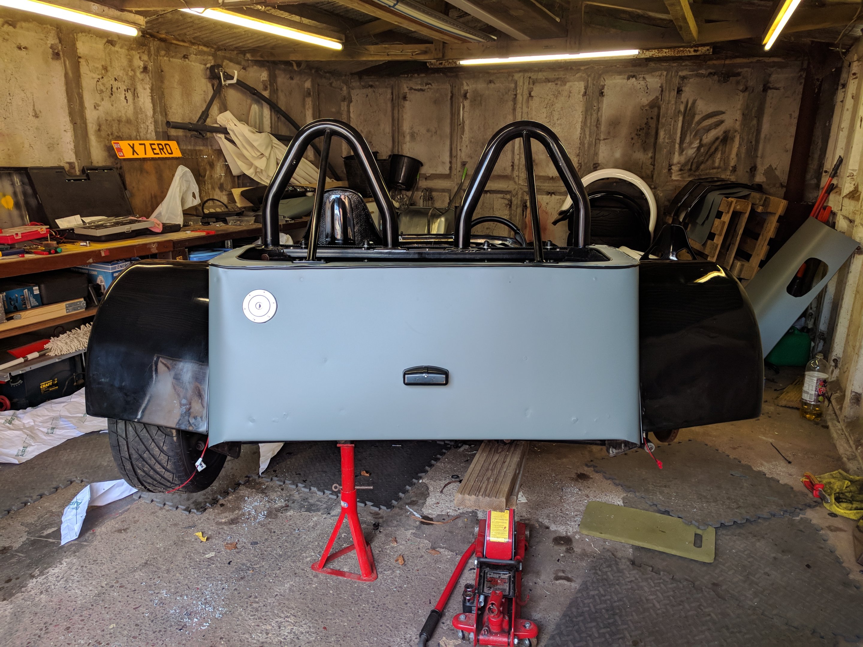

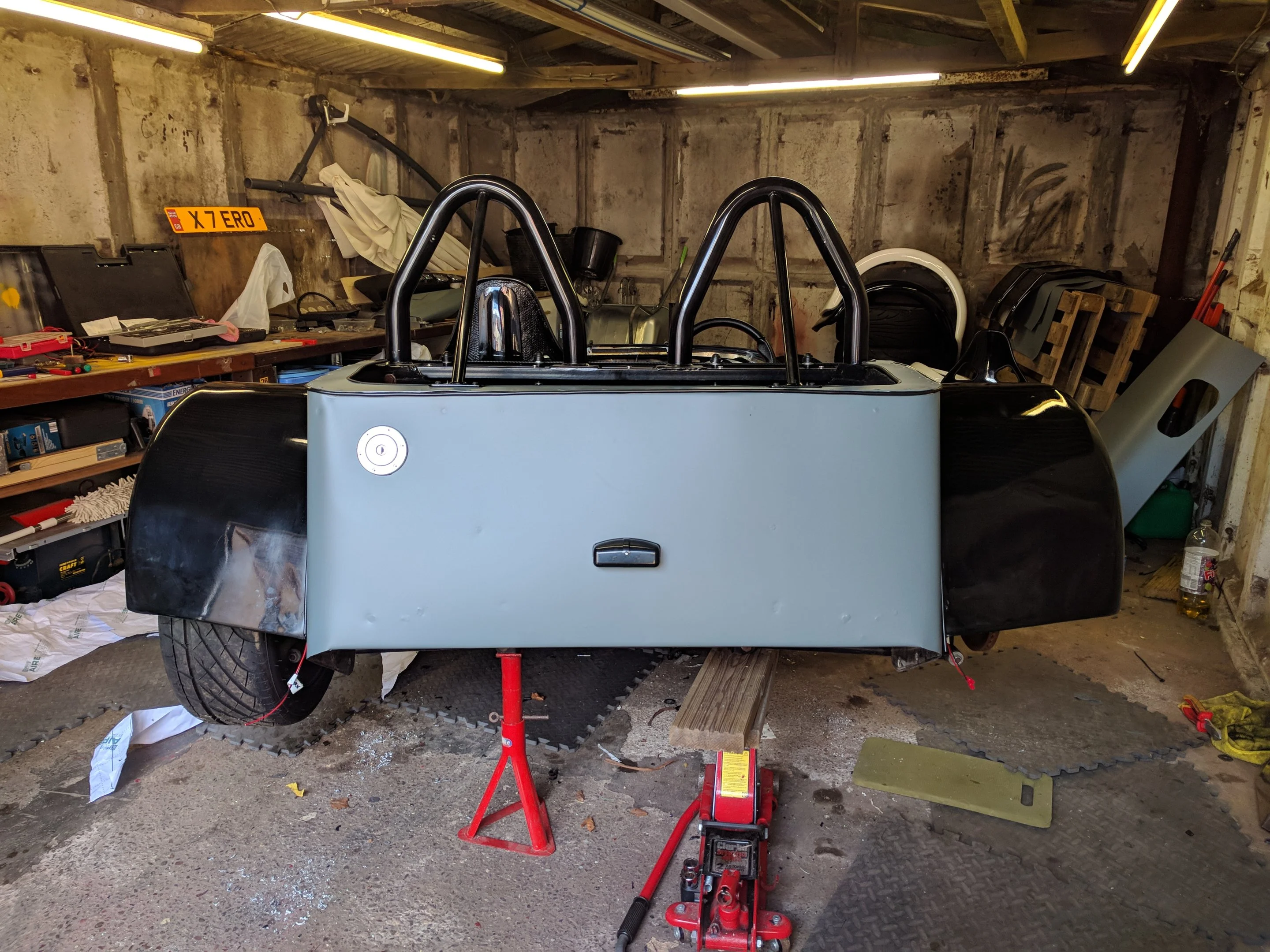

New rear arches arrived this morning aswell. REALLY close now

Fit new rear arches
Fit new rear lights

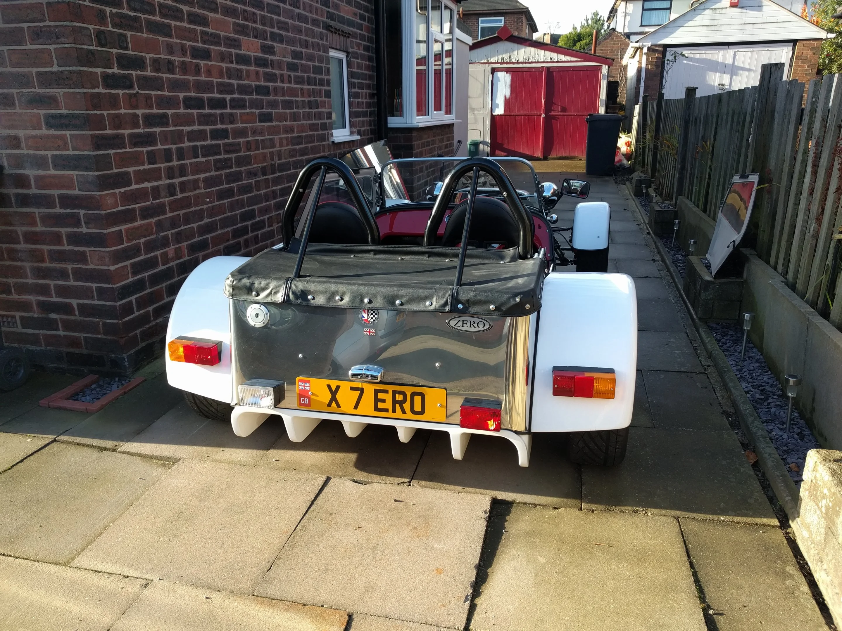

I can sort of see where they were coming from with white and chrome, but the white diffuser, dodgy plate and leather tonneau cover don't help.
I like what you've done with it!
Ol’ Tarby
  Clio 220 Trophy
Cheers mate
Unfortunately I think the tonneau cover will be going back in as there isn't really another solution for covering the boot compartment. Not a simple one anyway.
  BMW M4; S1000 RR
I quite like the molded ones, but you could probably just give that one a going over with some conditioner to give it a bit of life again. It won't be contrasting against everything now either!

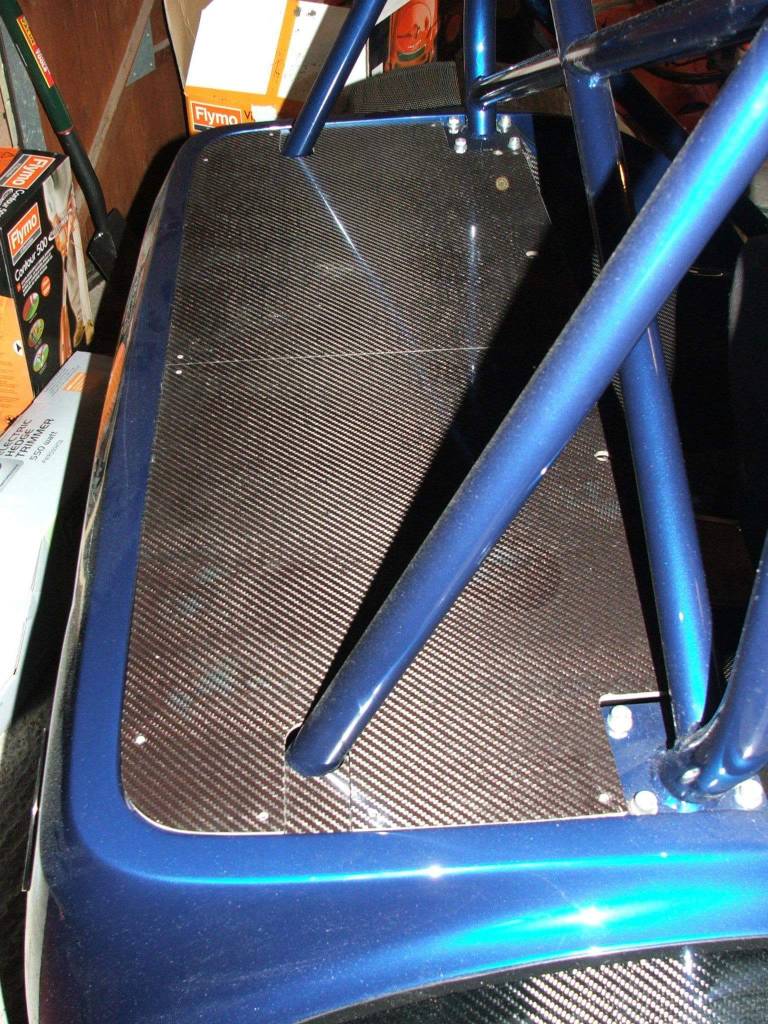

Do you need boot access ? I didn't find the space that useful so I covered it with a sheet of honeycomb carbon sandwich

I'd like to keep it accessible if possible yeah, as granted it's not a huge space, but it'd fit a small tent and a few beers in.
I think I'll look into making something like yours but with a lockable flap in it.

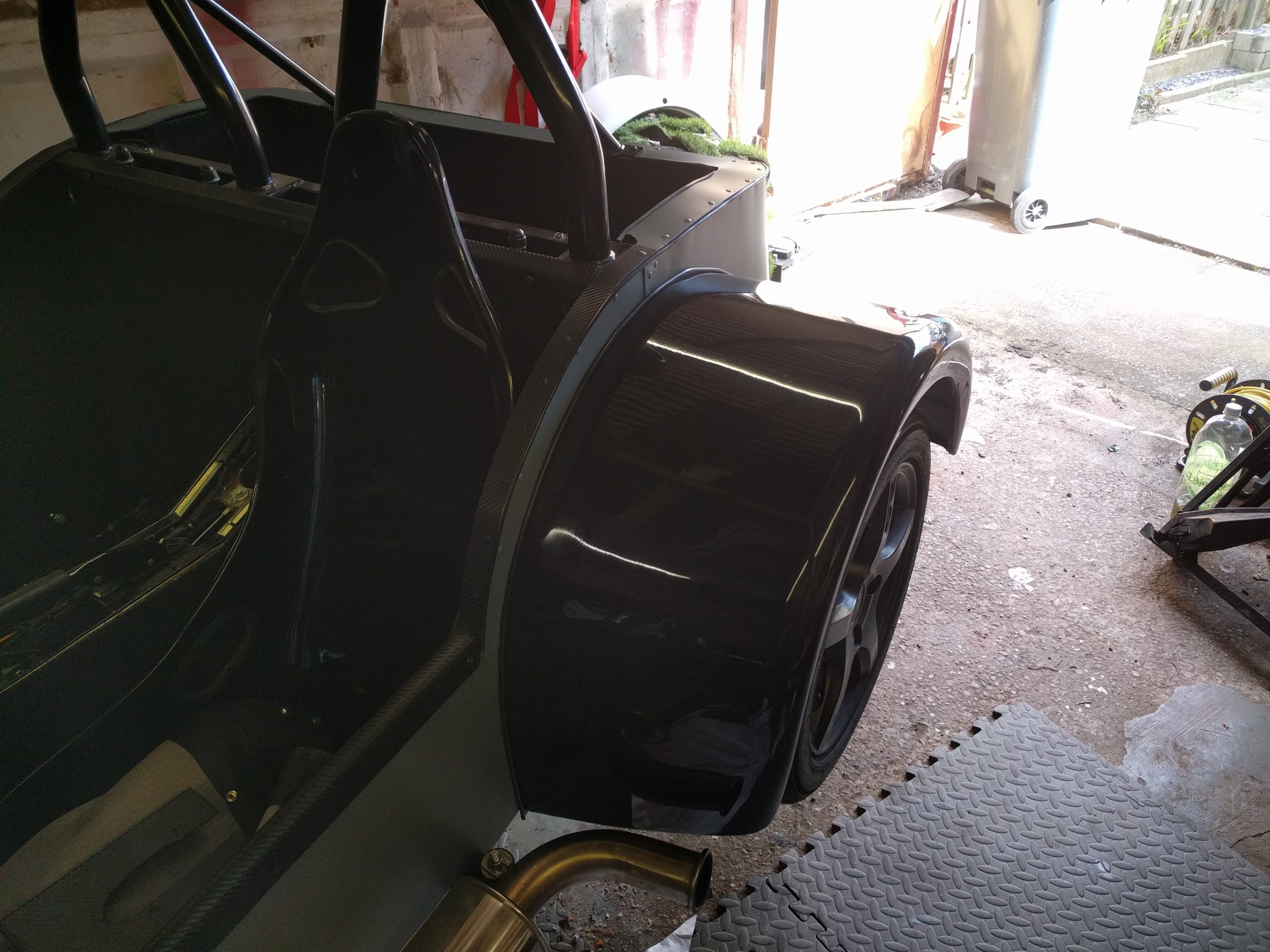

Why are the rear arches so wide?
Same width as the standard arches. Narrow bodys have wider arches apparently as the outer track is the same. So to get the wider body, the arches are narrower. According to the guy who made my arches anyway.
Either way, both standard and these are 315mm wide
