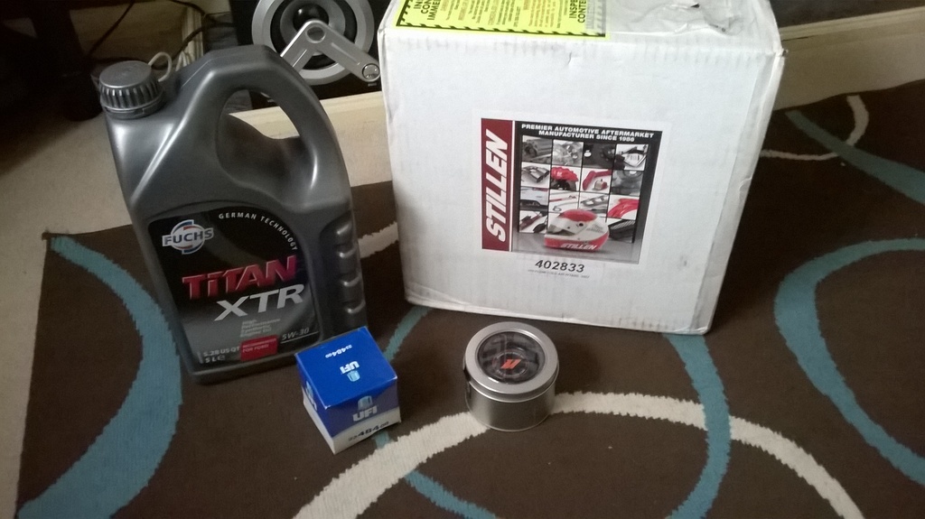

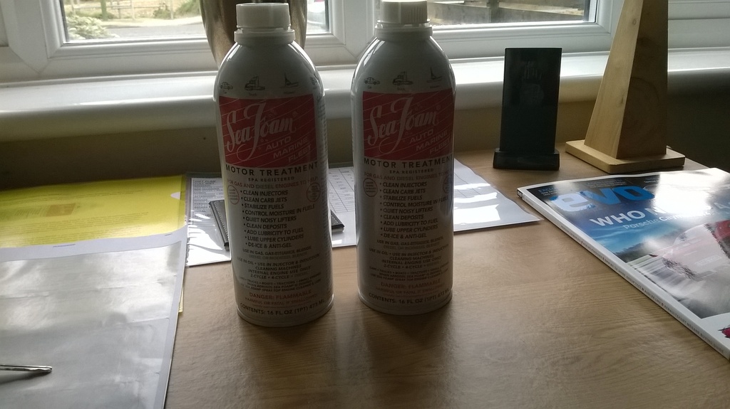

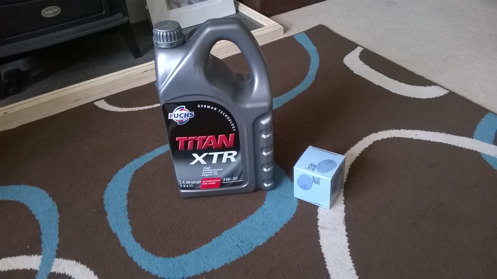

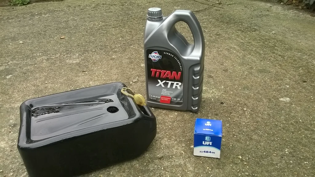

Seafoam was done below
x 1 can in fuel tank
x 3/4 in oil ( run for 100 miles )
x 1/4 in brake booster pipe

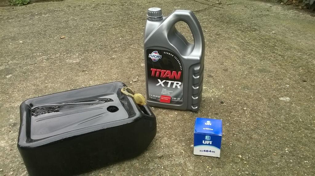

Then to drain the oil and seafoam out and do a fresh oil and filter change

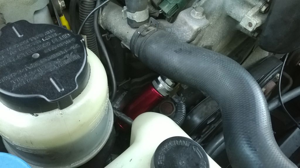

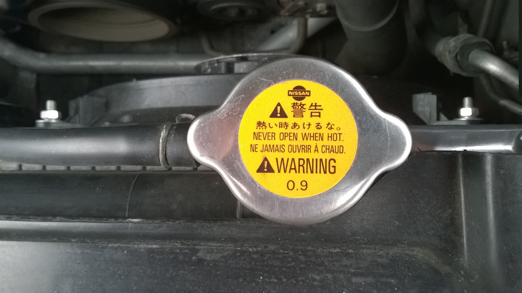

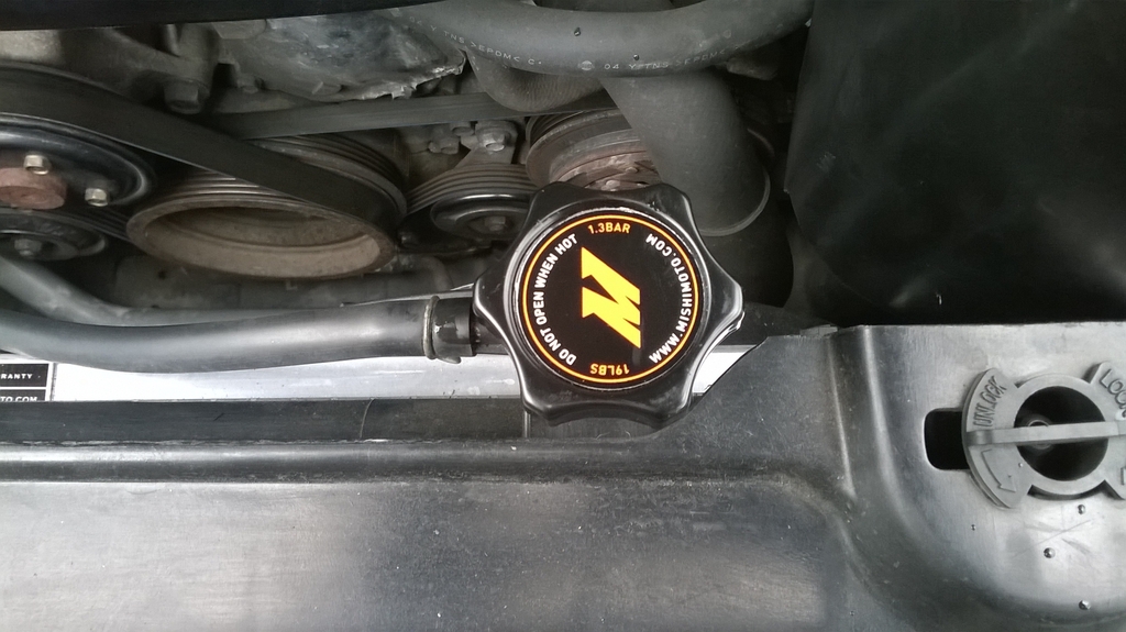

I changed my rad cap from the OEM 0.9 bar one
To a Mishimoto 1.3 bar one

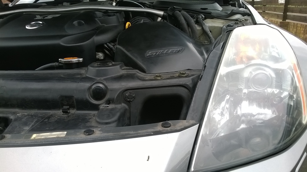

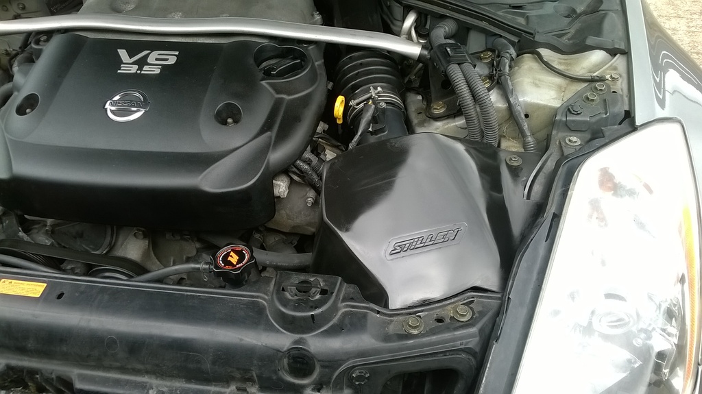

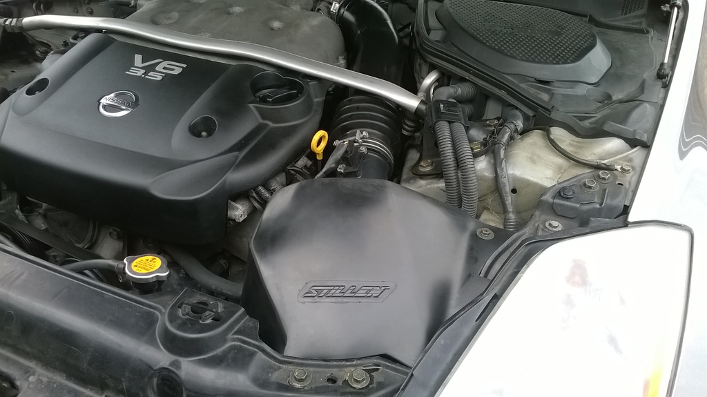

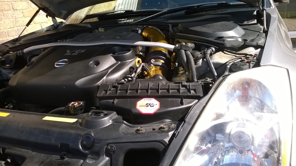

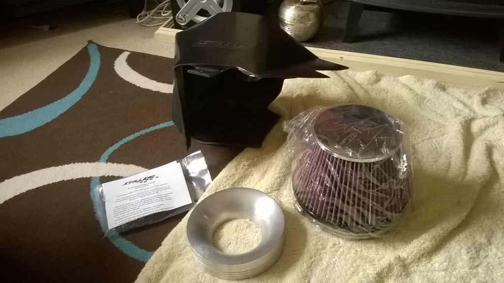

Then last was changing the induction
New Stillen kit with V/S ring
K & N Typhoon Removed
Stillen fitted

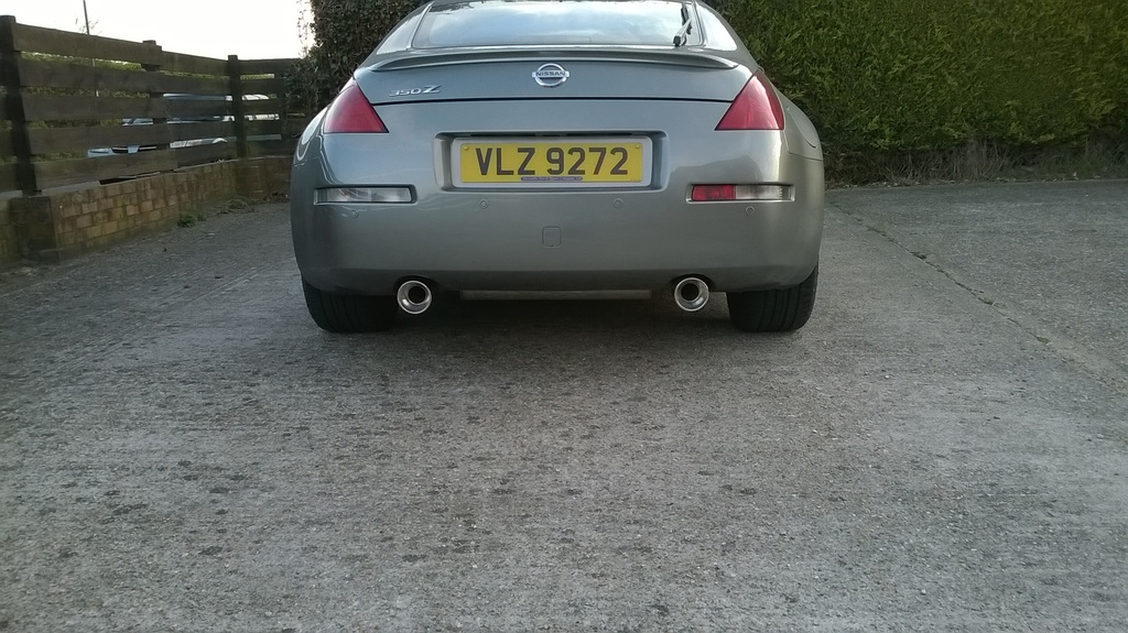

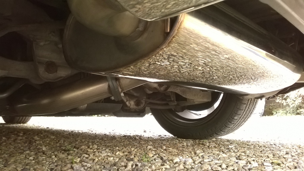

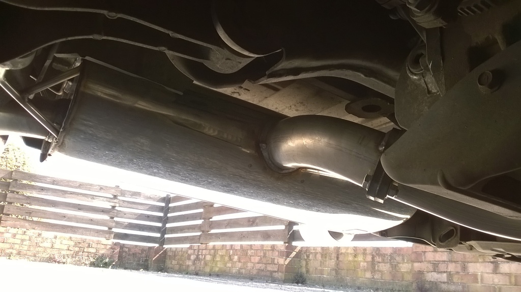

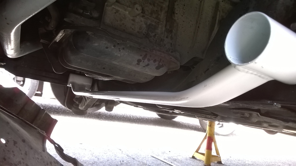

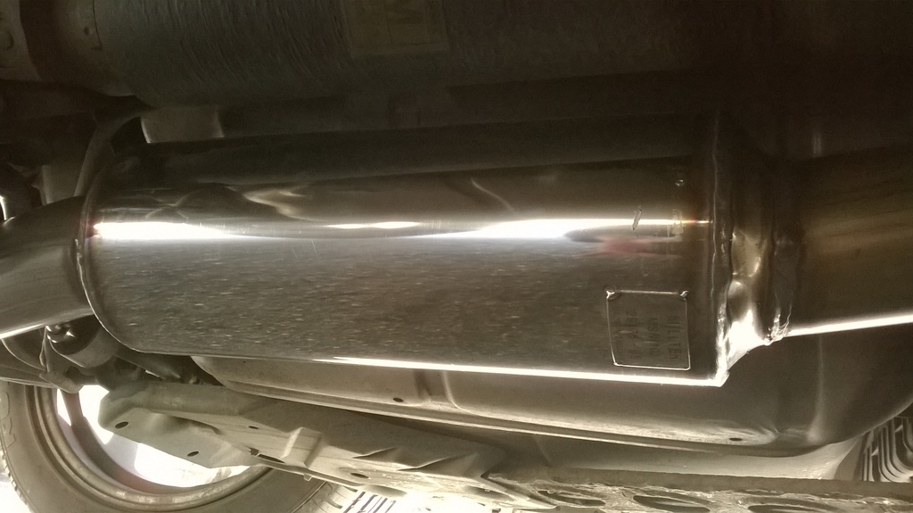

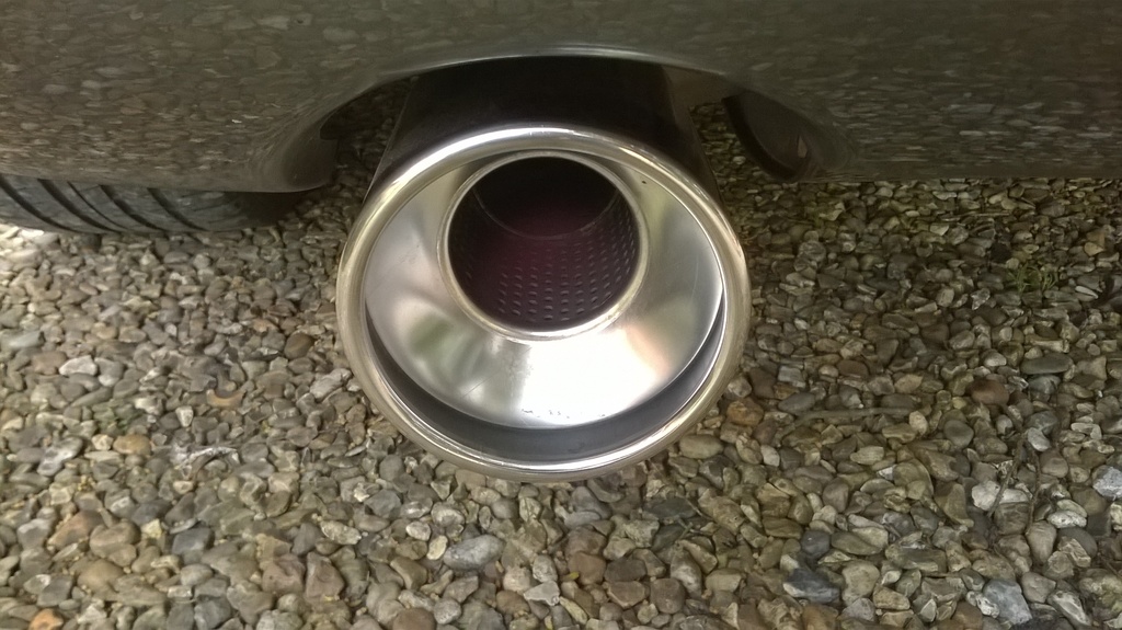

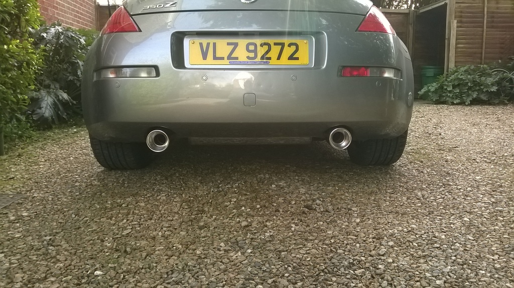

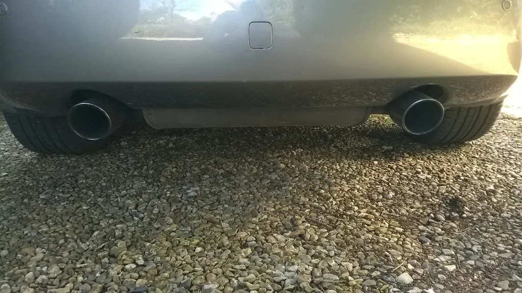

On Friday i went up to Abbey Motorsport for a Milltek Exhaust to be fitted and check the tune on the dyno for the uprev .
Old stock system
The back box pipe had been patched up one already .
New Milltek fitted

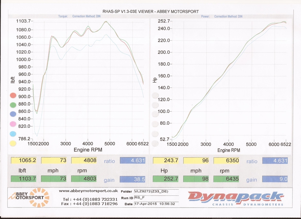

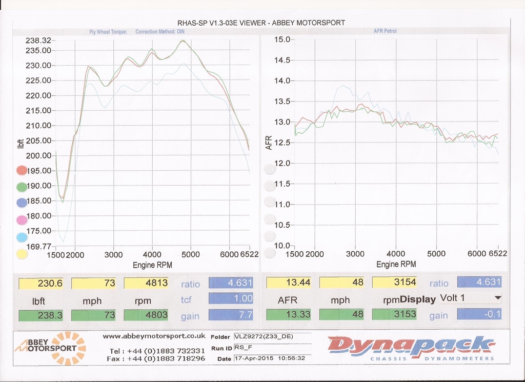

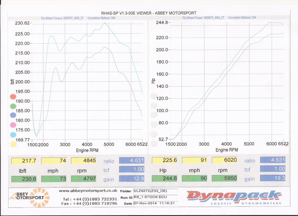

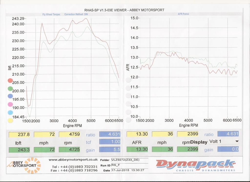

Then the Dyno sheet that I was not expecting .
+ 9 BHP ad + 7.7 LB/FT from last time and the only changes were the Milltek exhaust and Stillen induction ( last map in Blue HFC , K & N Typhoon , HFC , P/spacer , Uprev )
The car started out in November at 225.6 BHP and 217.7 LB/FT
And is now 252.7 BHP and 238.3 LB/FT so that's a + 27.1 BHP and + 20.6 LB/FT gain .

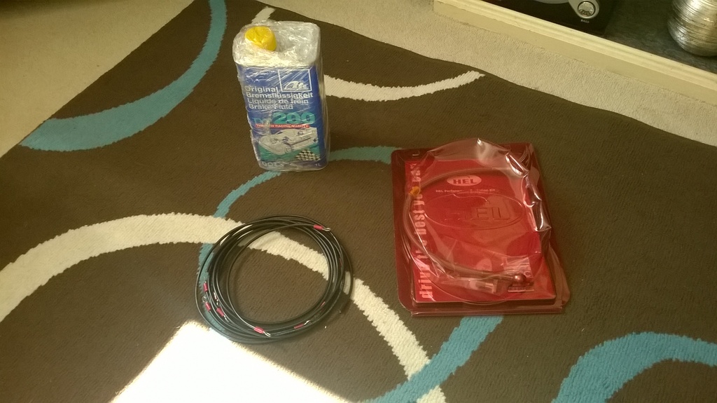

Then on to fitting this little lot

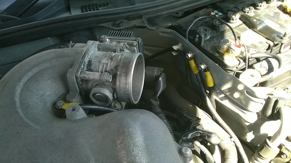

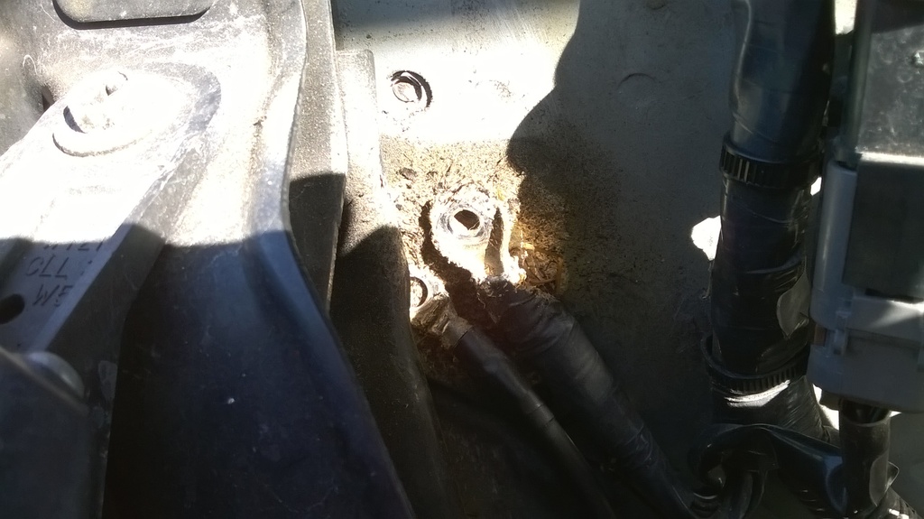

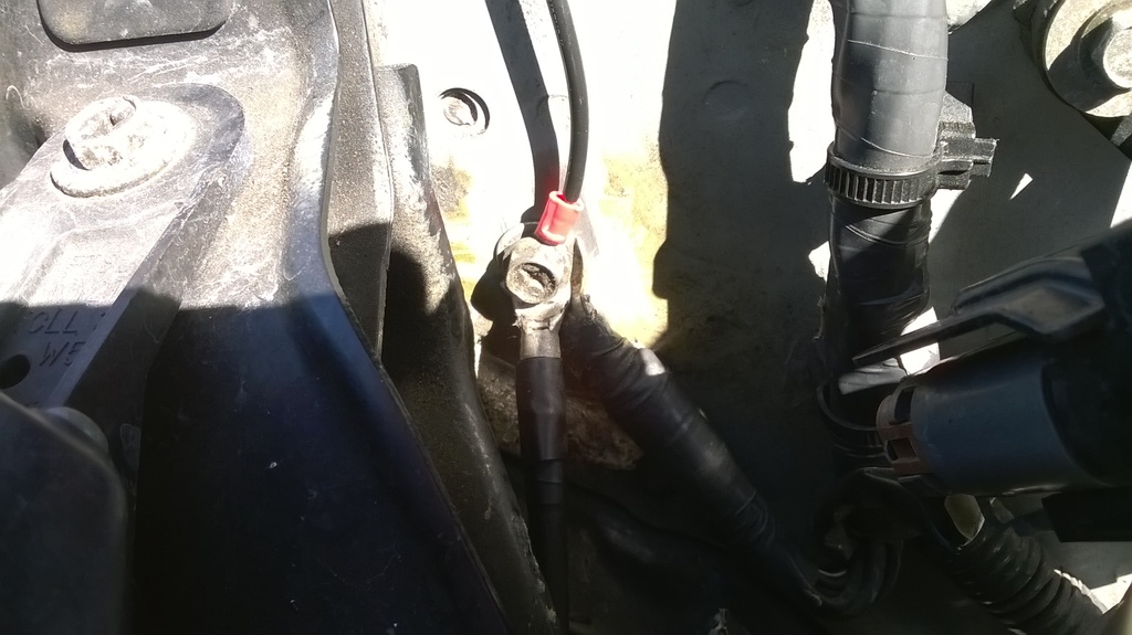

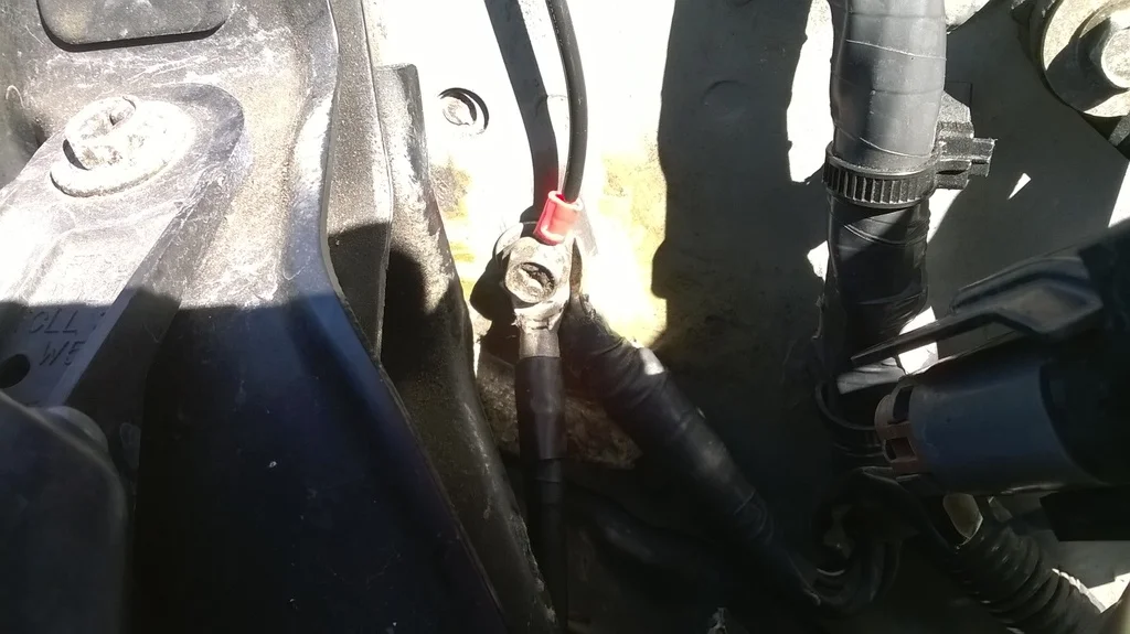

First up a grounding / Earth kit that I made up ( X 10 ) and cleaning the original earths .

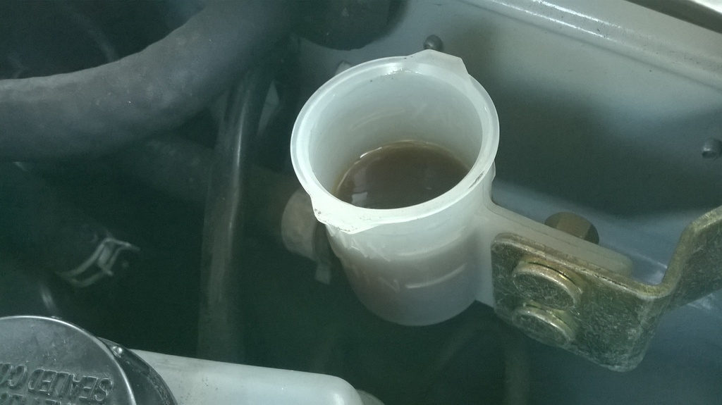

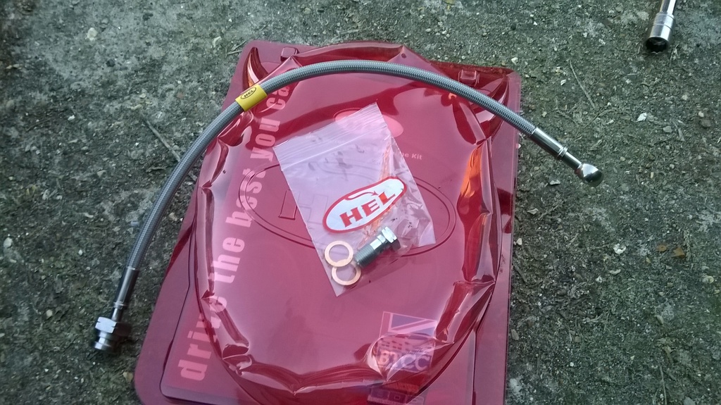

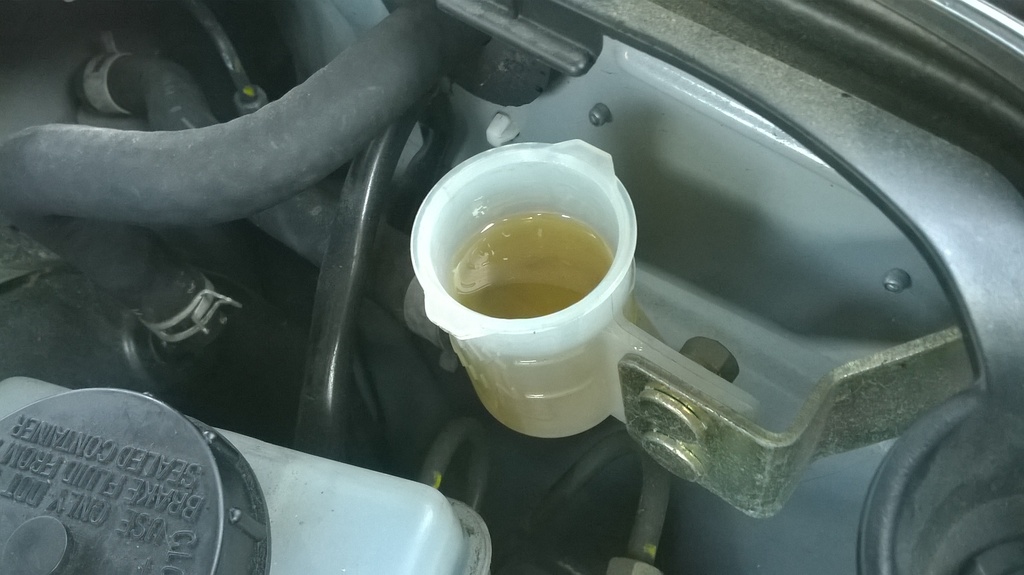

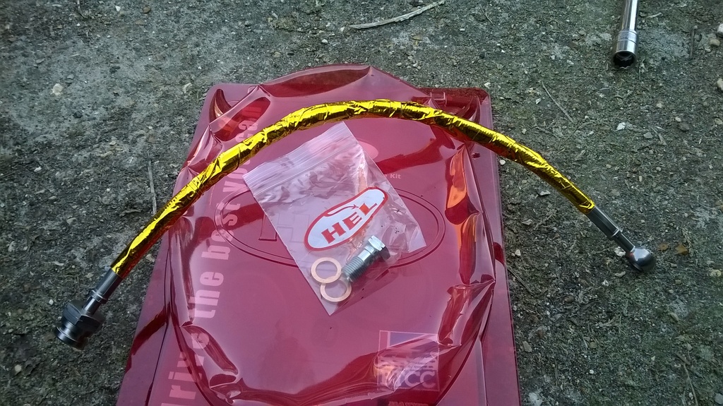

Then on to the clutch fluid flush / change and S/S clutch pipe .
Old clutch fluid not looking so good .
New ATE clutch fluid

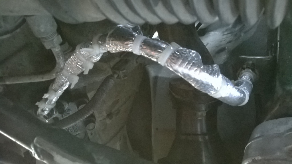

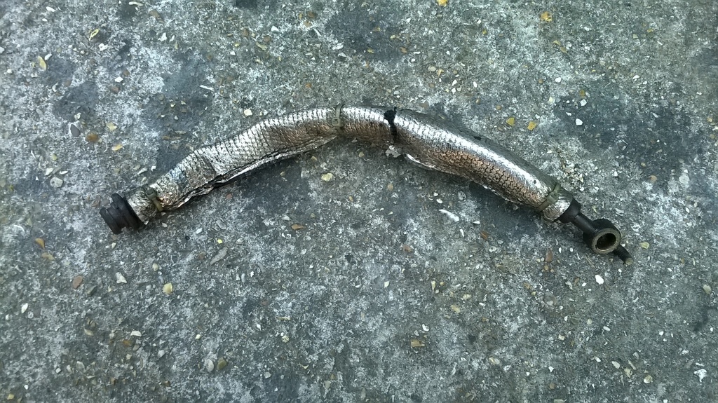

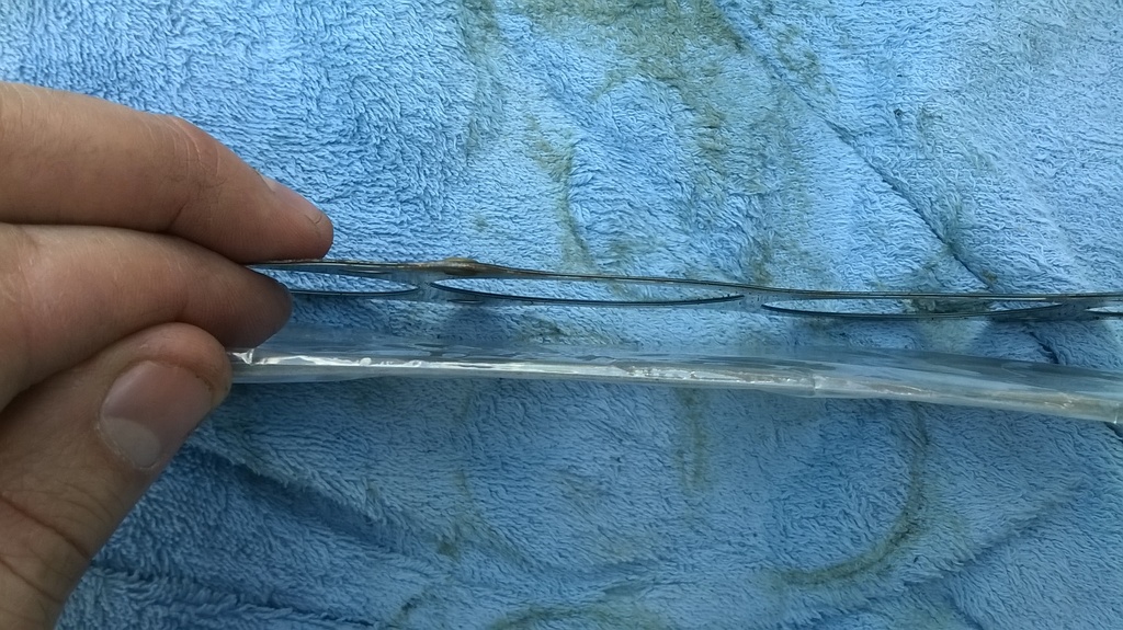

Old cutch pipe .
New one

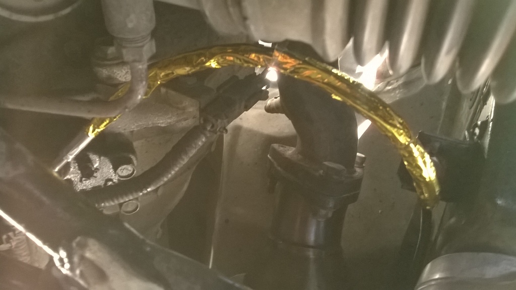

I had some DEI gold heat reflect tape left over so wrapped this around .
And fitted with some protection heat wrap .
Only problem was I had no cutch pressure so had to prime the cutch slave to get the pedal back then bleed the system .

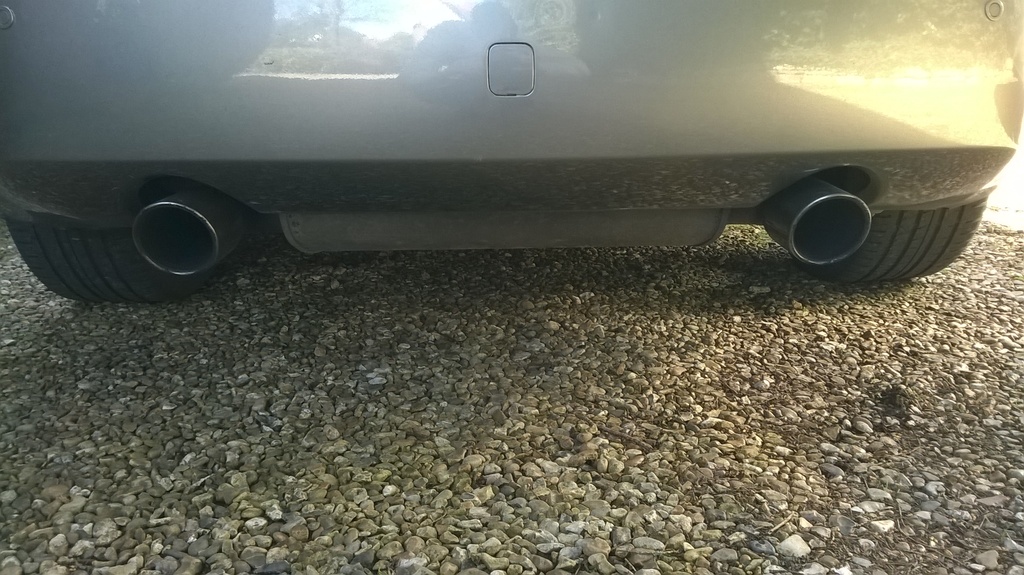

Sound clip of exhaust

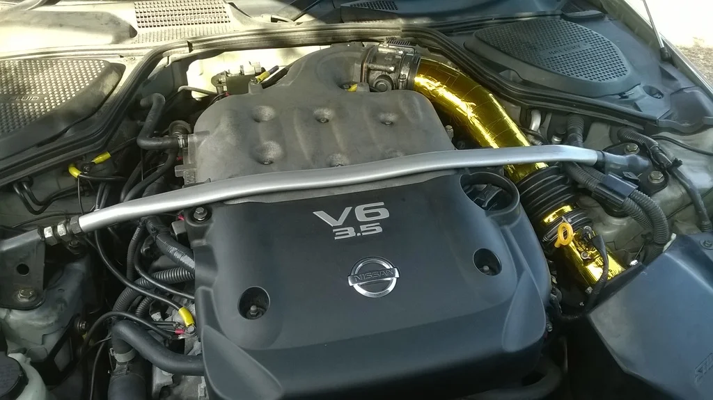

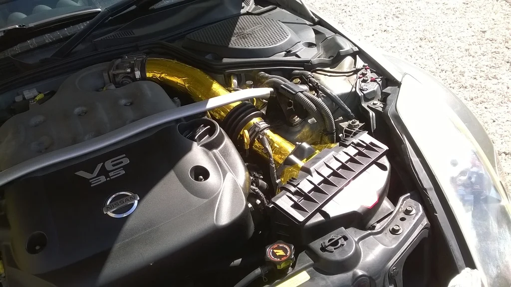

Another small update as some more parts arrived .
Earthing kit to add to the smaller kit that is installed .

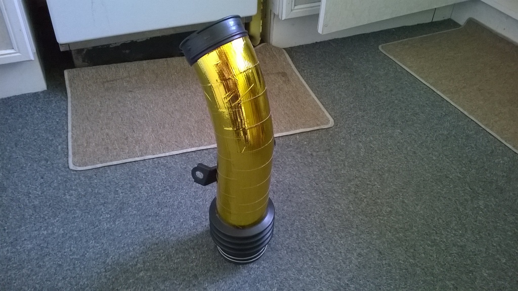

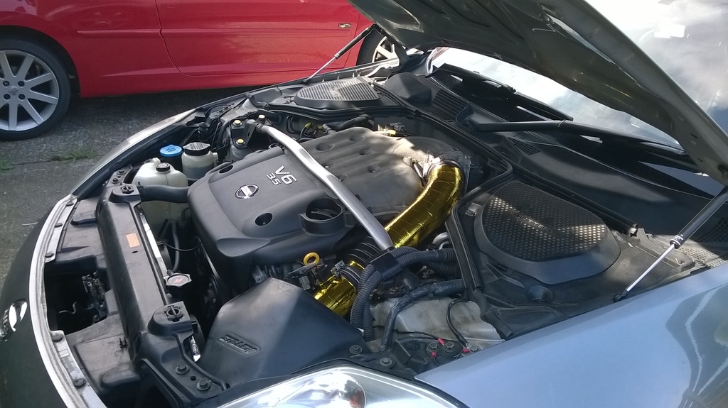

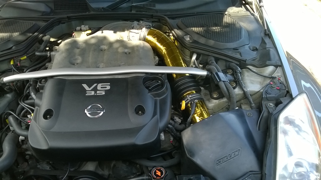

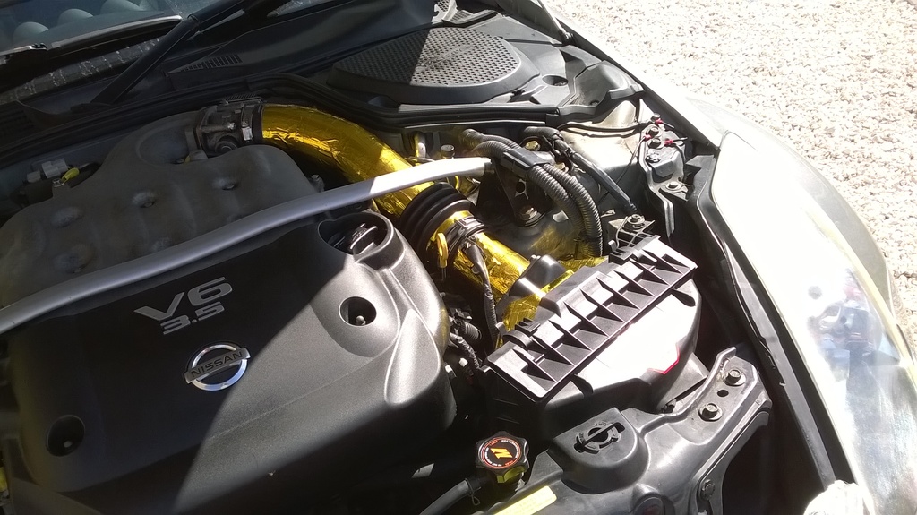

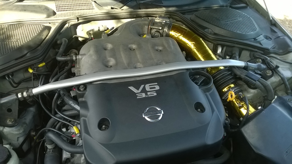

Then wrapping the induction pipe in DEI heat tape ( did this on my old Mr2 Turbo and inlet temps came down )
And to finish off a wax with the G3

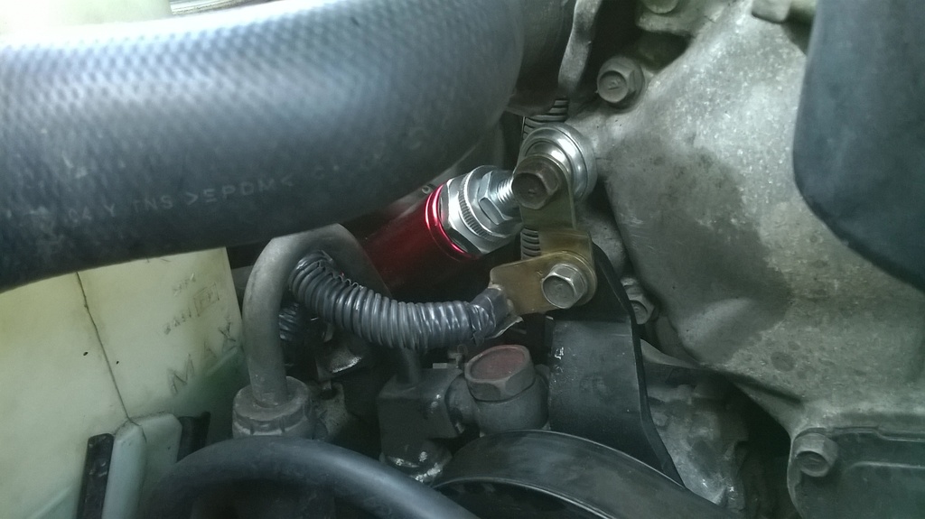

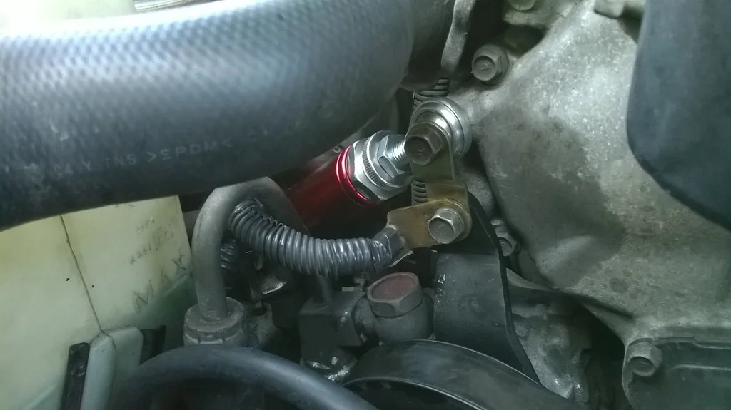

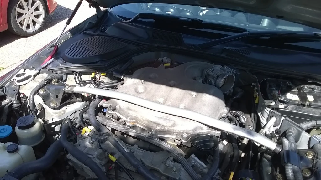

Got a engine torque damper delivered form the USA on Friday
Fitting was ok but space was tight .
All in with earth bracket connected .
There is slightly more noise / vibration in the cabin but nothing that you can feel to much .
Throttle response feels a little more quicker more so in the lower gears .

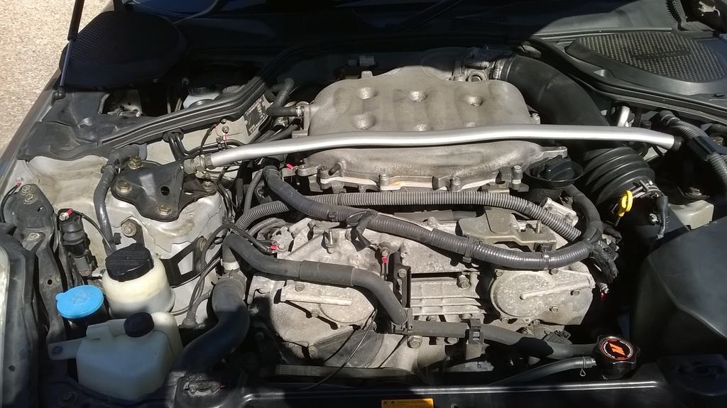

Got another job done at the weekend .

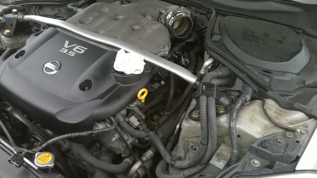

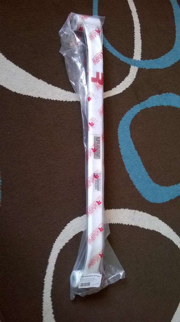

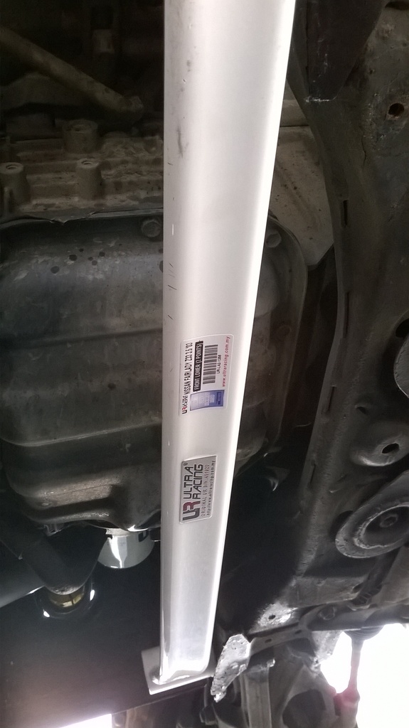

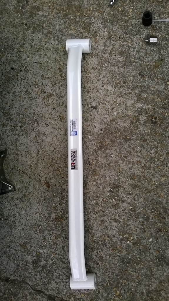

Got my Ultra Racing front under brace in the post .
Out an ready to fit .
Installed
Bolts were a pain to remove but installed well with a nice fit .
Alan

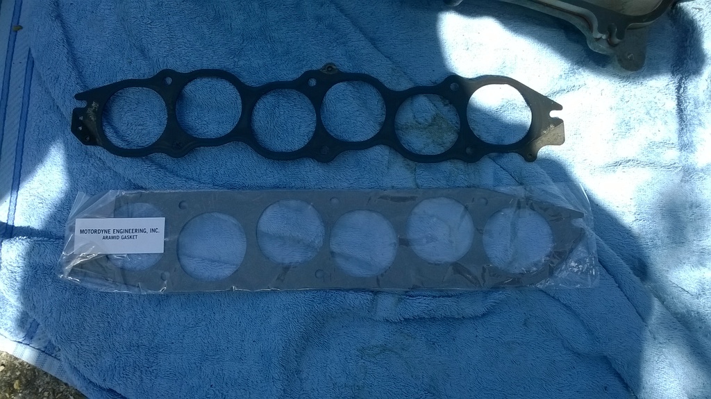

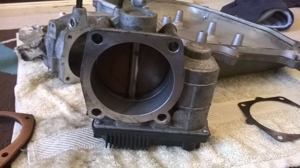

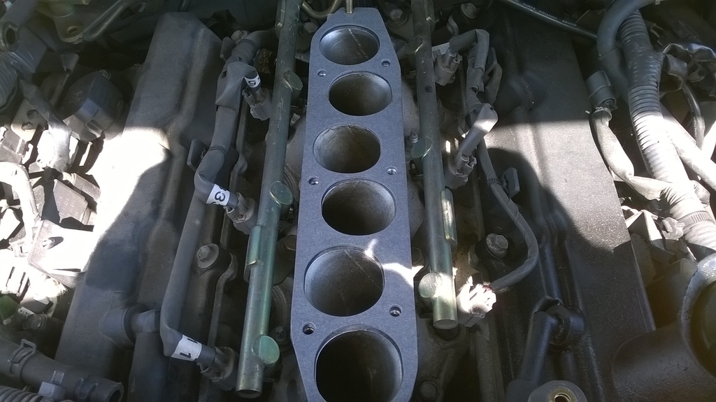

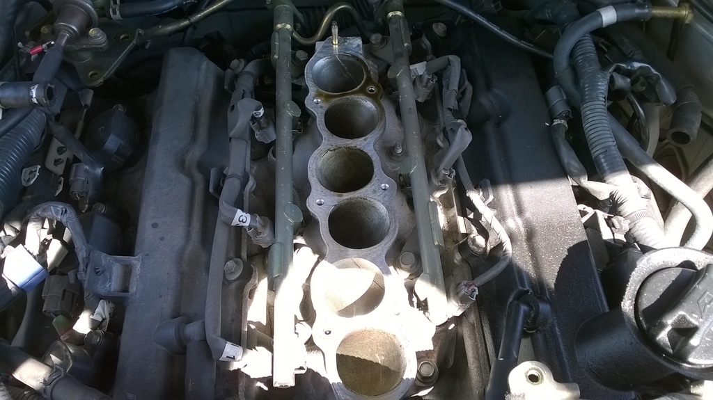

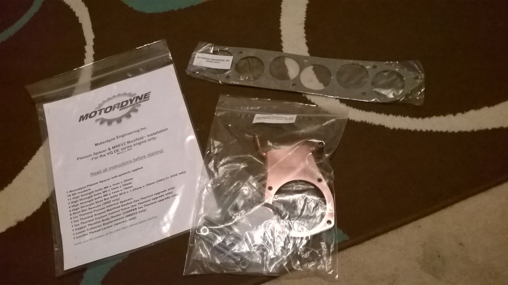

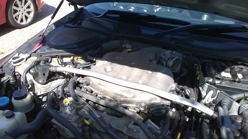

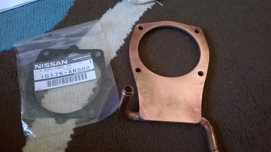

Motordyne copper Iso Thermal upgrade with Aramid gasket and Copper Throttle Body Heater
Removed the pelnum
Removed the old pressed steel gasket ( next to the Aramid gasket )
Few mill thicker
All in place

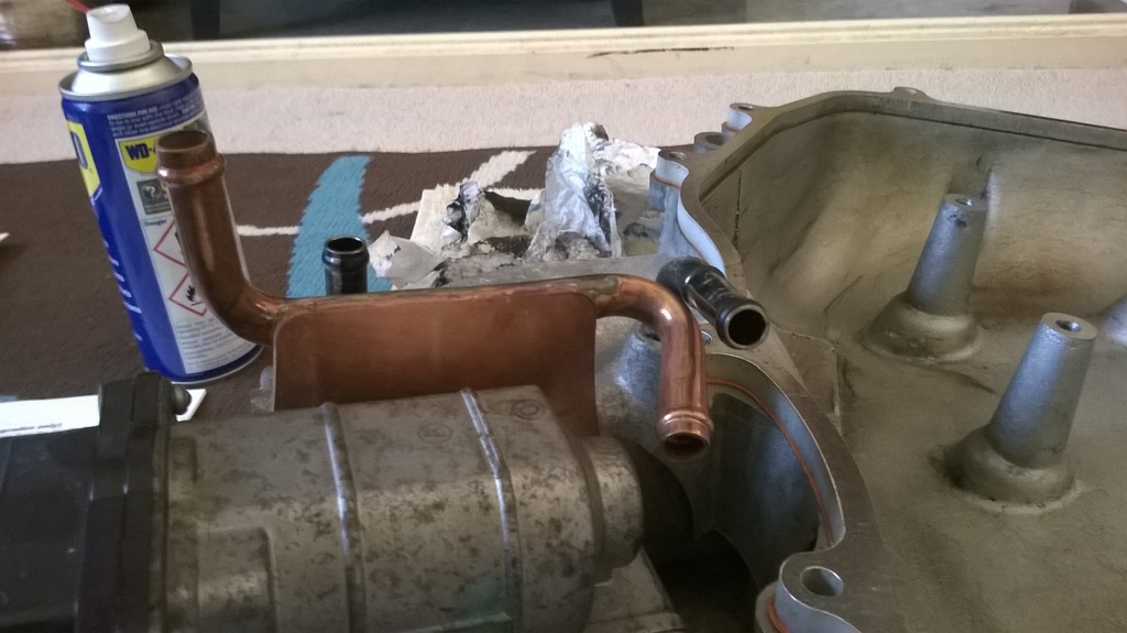

Then throttle body removed
New Copper Throttle Body plate
Installed on to throttle body
All put back together and checked for leeks
Alan

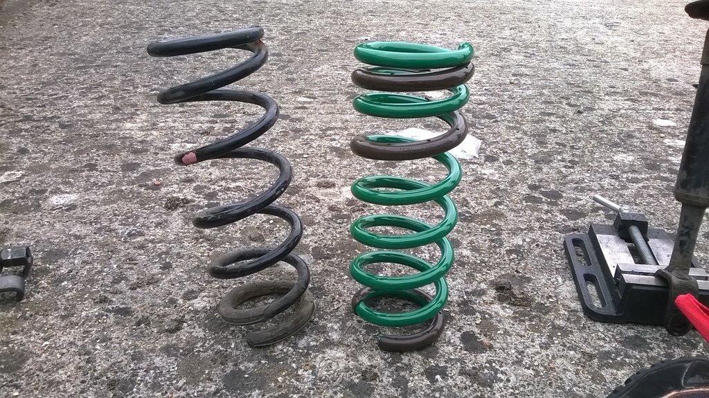

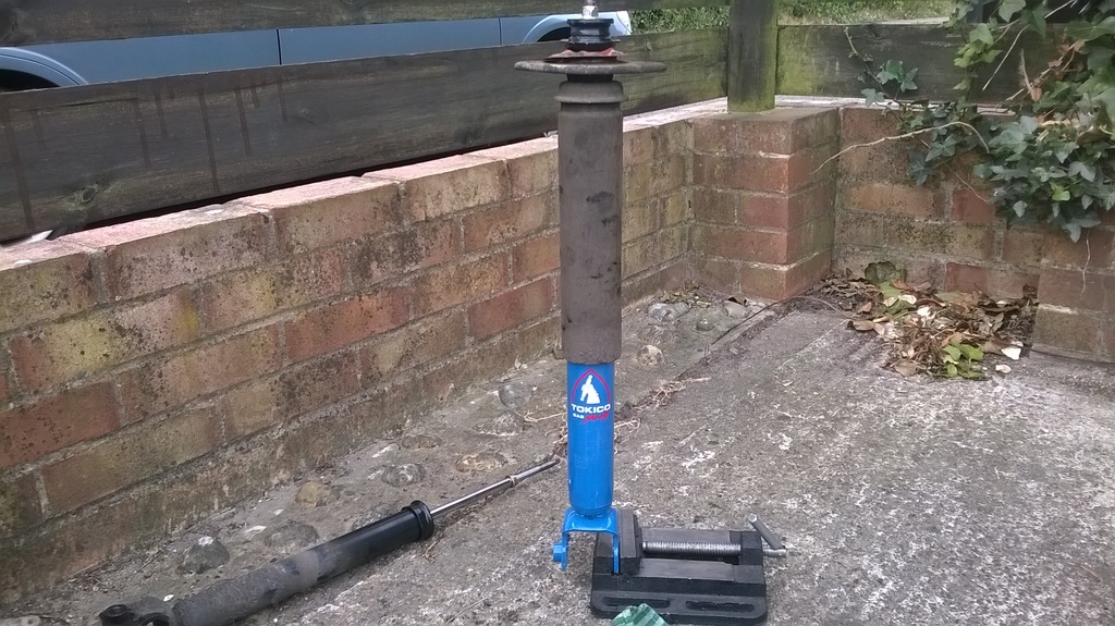

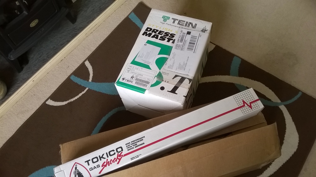

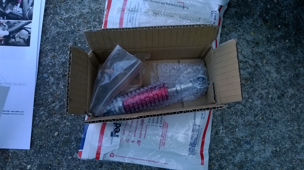

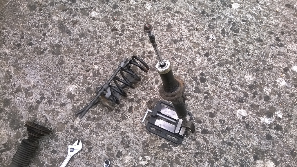

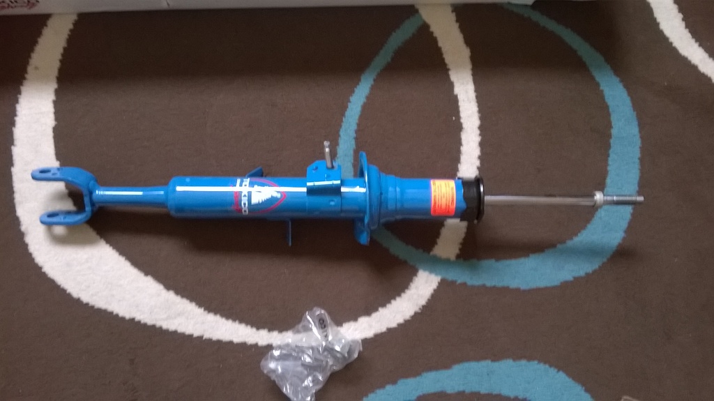

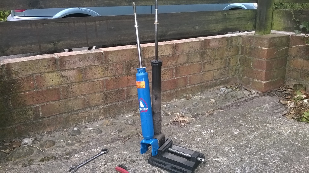

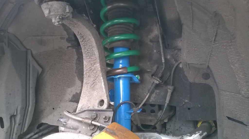

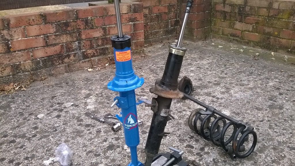

At the weekend I got round to upgrading the suspension at last .
Parts arrived from the USA . Tein springs and Tokico shocks

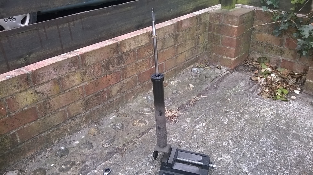

Old shock and spring out ( this set up has done 91K miles so a bit tired )
New Blue Tokico shock
Old vs new shock

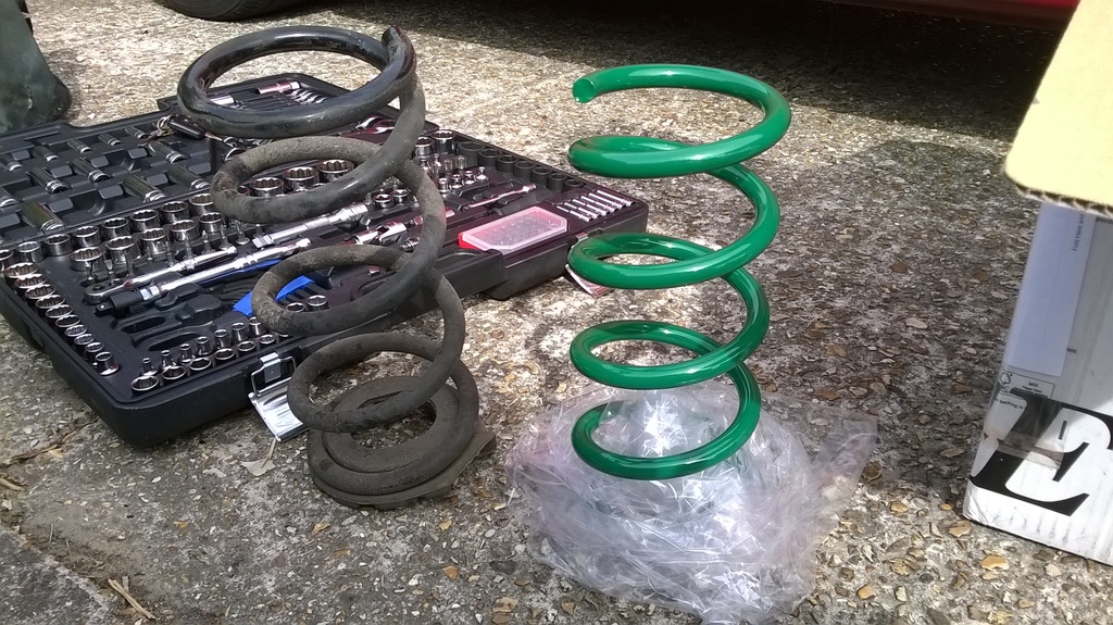

Old vs new spring
Old vs new shock return vid
http://vid298.photobucket.com/albums/mm273/kaveney_photo/WP_20150620_0091_zpsqynrvqhm.mp4

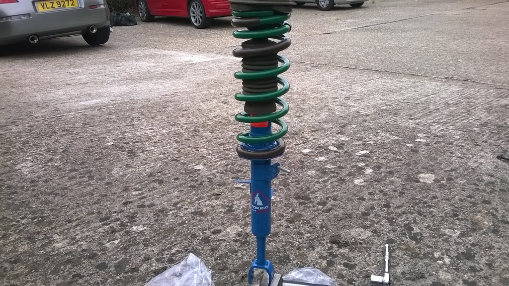

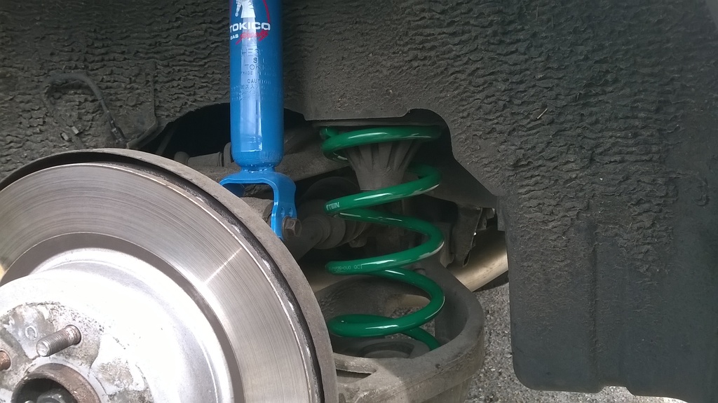

All set up new shock and spring
Installed
Old rear shock
Old vs new
New ready to go on
Rear shock & spring installed
Have only done a few miles but its only a little firmer than stock and should be better in the corners .
Alan

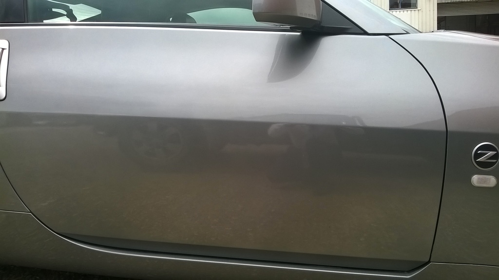

Yesterday I got the car park dents on the drivers door removed that were annoying me .
Small but I could see them .
After
All pulled out with no paint or filler so im happy with that .

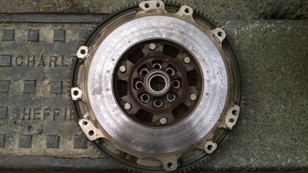

First was a new Exedy clutch and LUK DMF that was fitted and new gear box oil added .

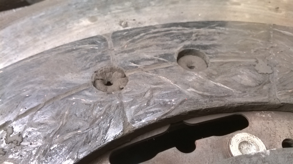

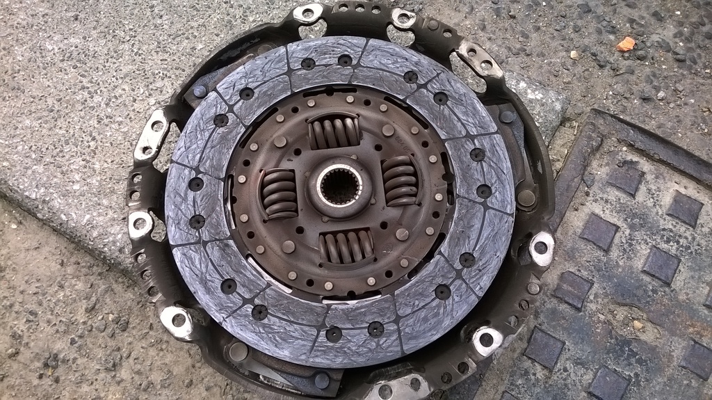

Some pic of the old units that have done 92K miles .
Old DMF
Old Clutch still in ok shape but some of the rivets were getting close .

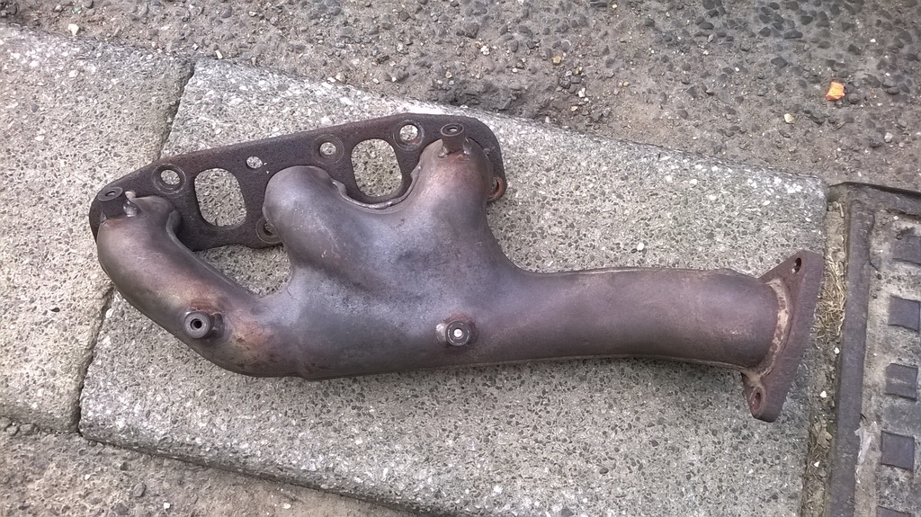

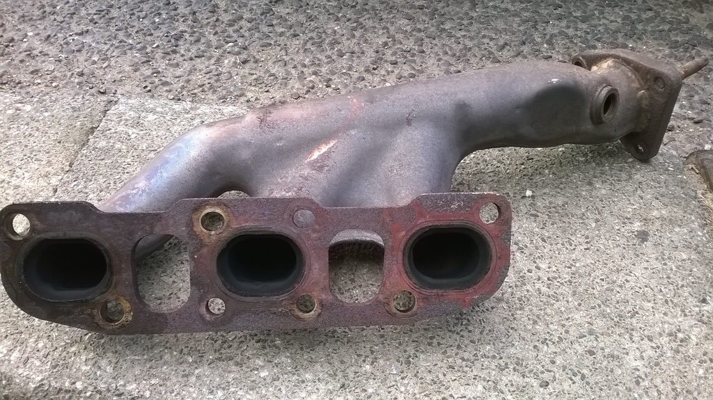

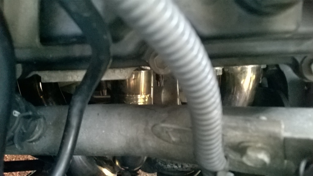

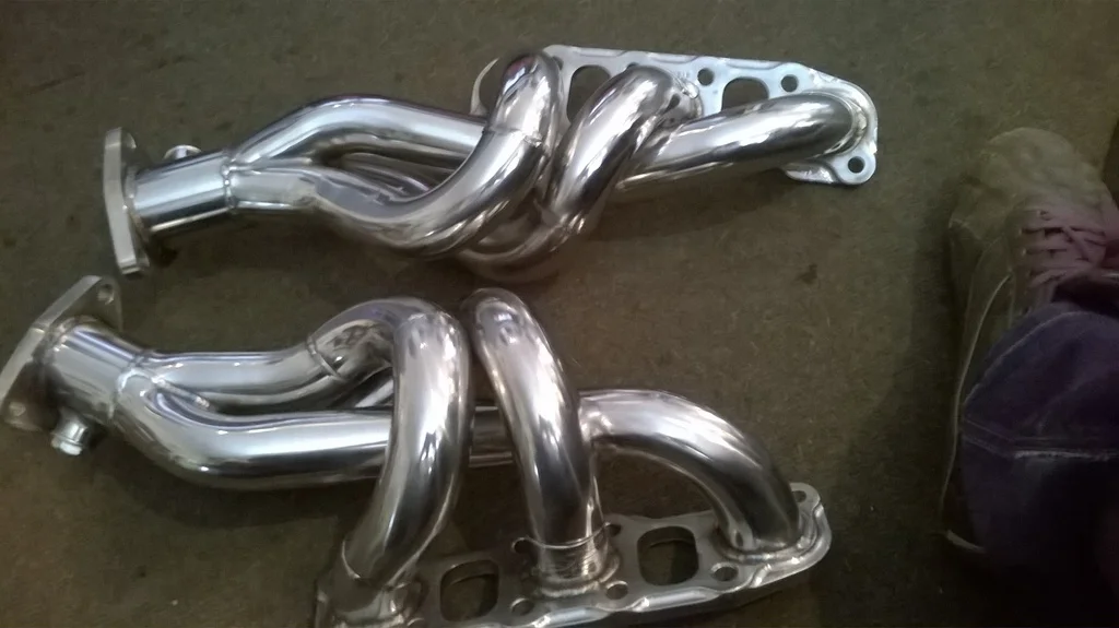

Then as the gearbox was off I had some DC sports S/S manifolds ( headers if you are from the USA ) installed .
Old log type manifold with smallish ports and uneven length tubes .
New DC Sport S/S equal length manifold
Installed .

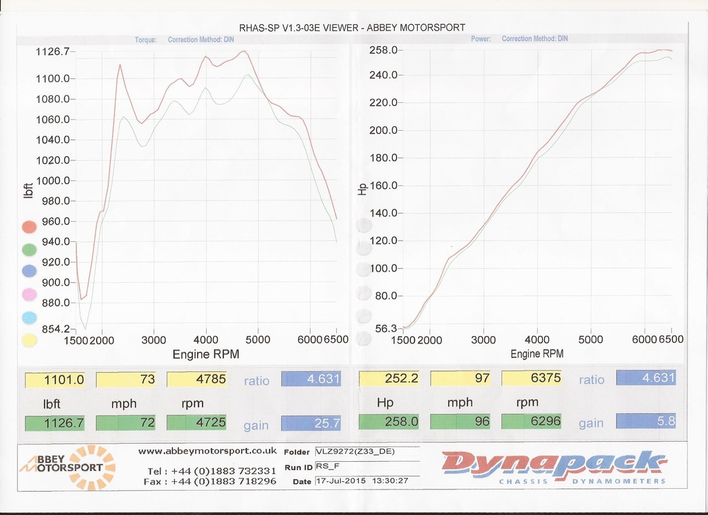

And last to be re mapped on the dyno .
I was told that the manifolds would only give a very small gain in power and torque so the gains are about what I was expecting with the bonus of more power and torque on the whole rev range ( + 11 LB/FT at 2300 RPM ) and not moving the power and torque up all at the top of the rev range .
Alan

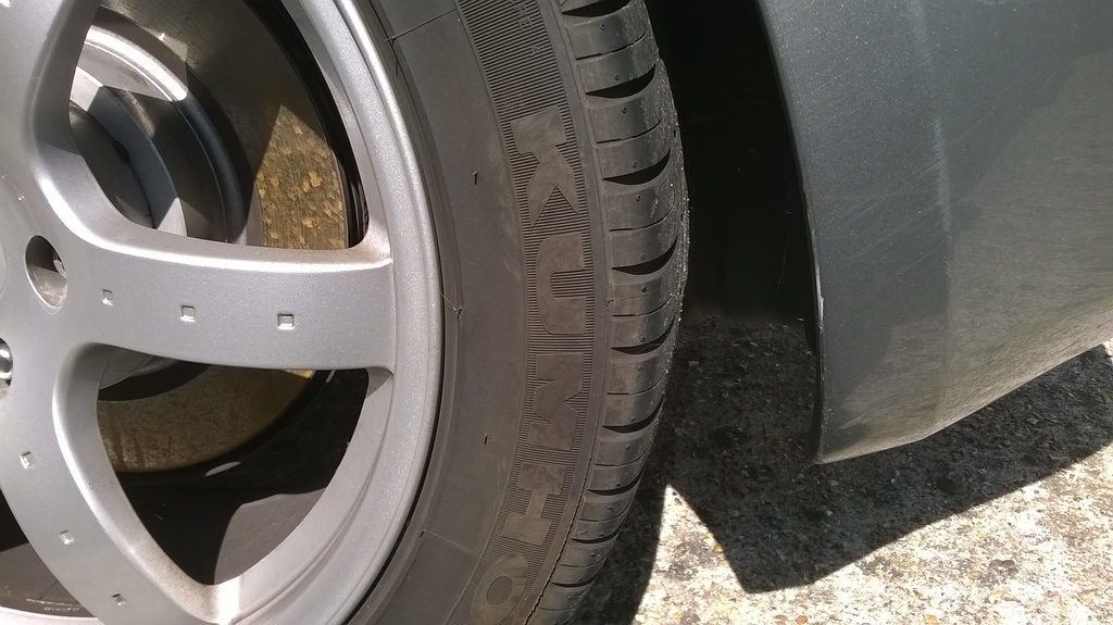

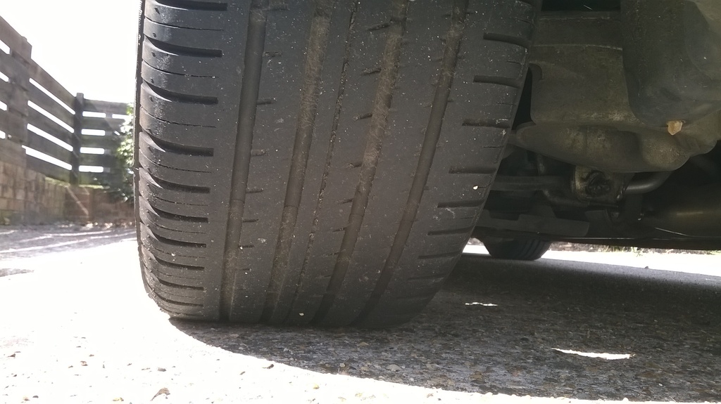

First was to change all x 4 Kumho tyres .
Still some good tread on them .
WP_20150801_0021_zps0ccc3ub0.jpg[/URL

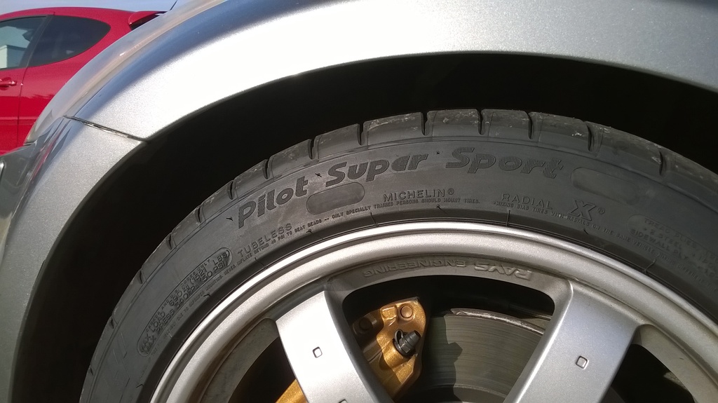

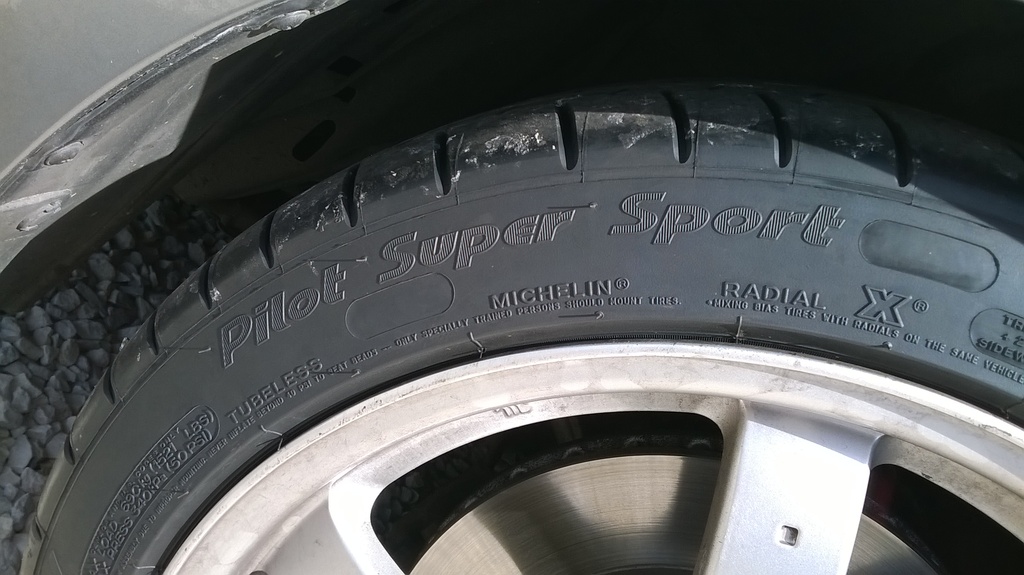

After lots of reading and with the car being my day to day car I went for a full set of Michelin Pilot Super Sports .

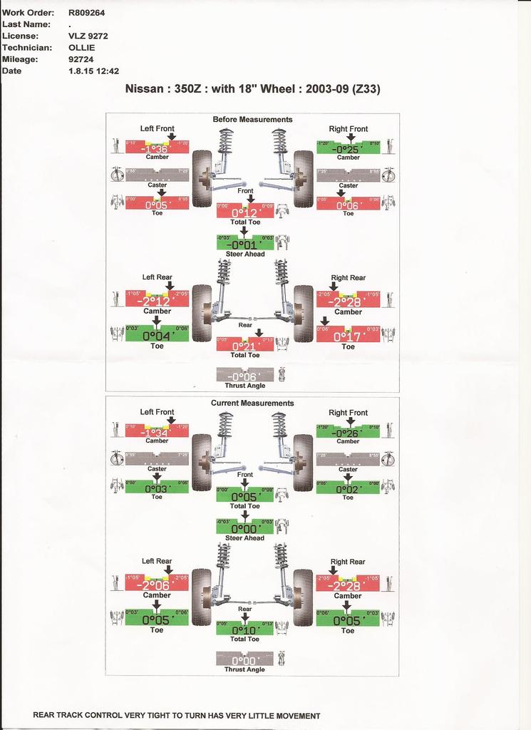

And the tracking done at the same time .
I will look to have a another alignment done soon but this will do for a few weeks .

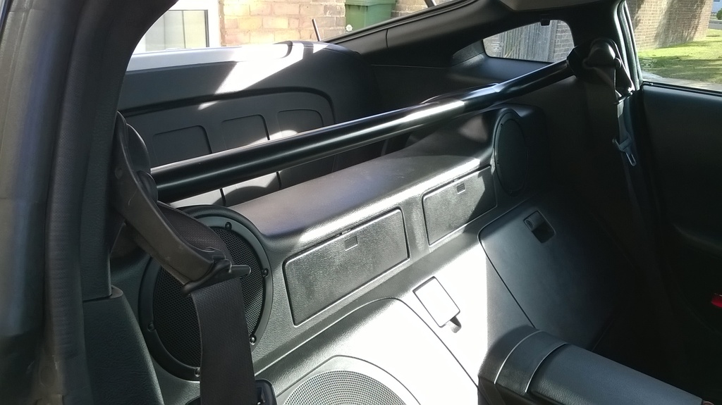

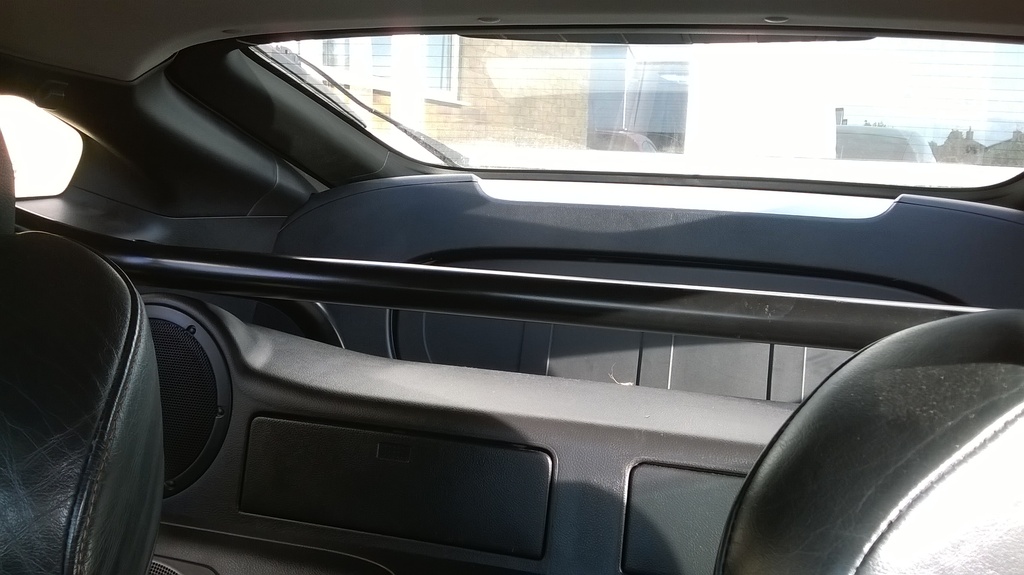

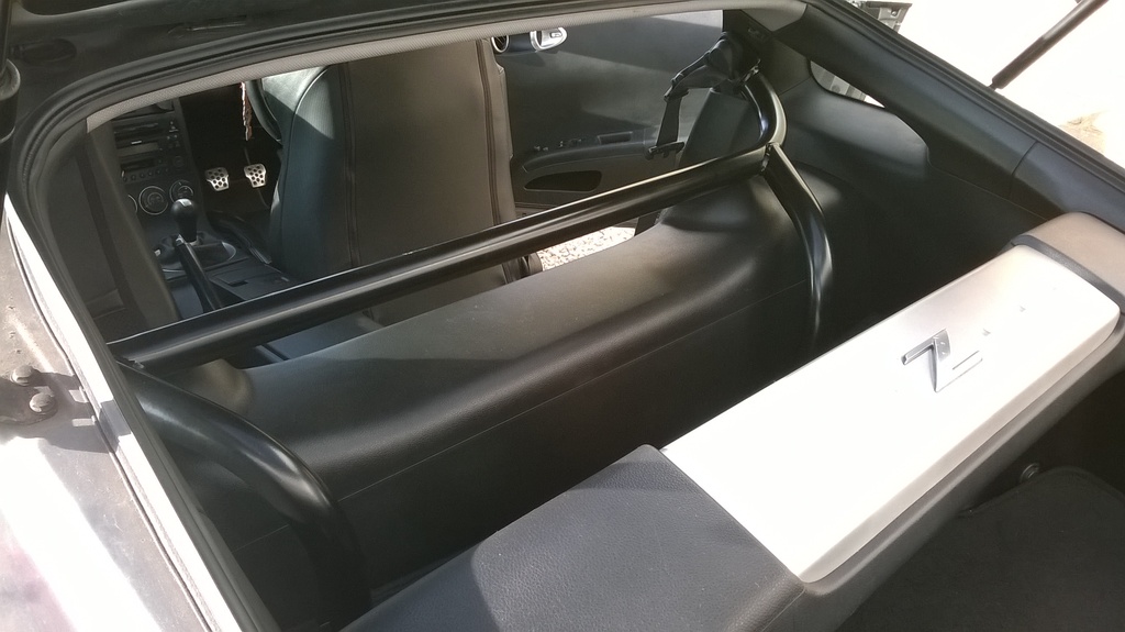

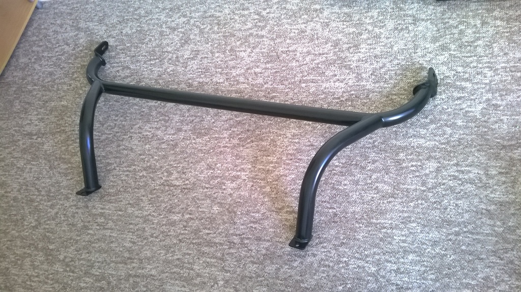

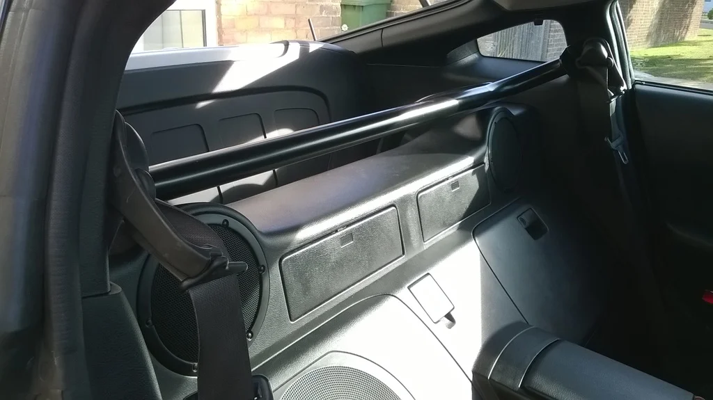

Also received my rear brace .
[URL=http://s298.photobucket.com/user/kaveney_photo/media/WP_20150801_0051_zpspp0lbpoq.jpg.html]WP_20150801_0051_zpspp0lbpoq.jpg[/URL
Fitting was ok and went in nice and tight .

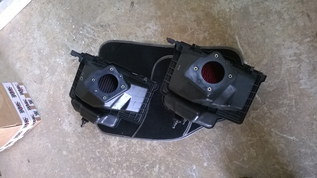

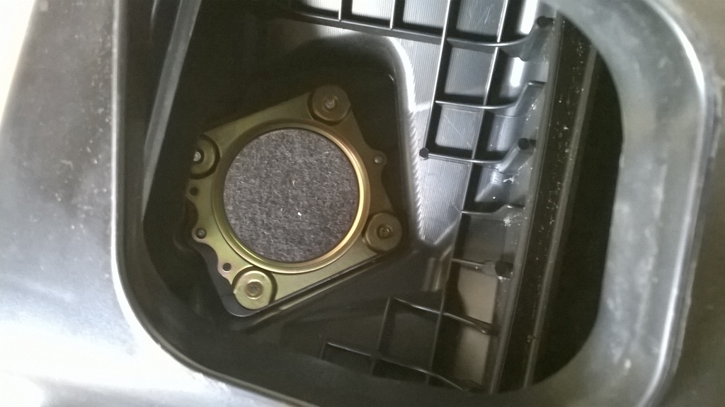

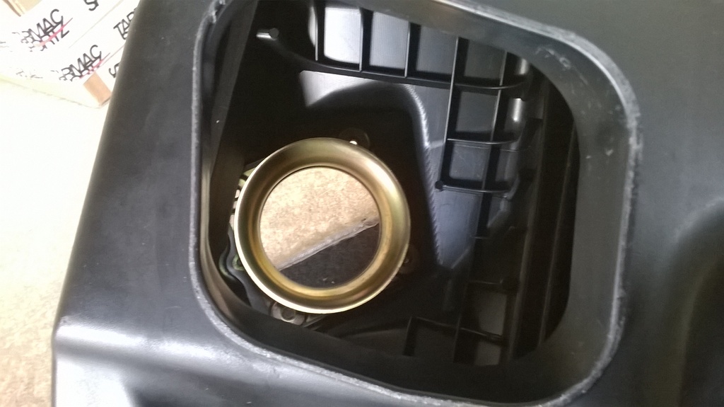

Then last was to remove my Stillen induction and replace this with a 06 350Z air box .
Stillen unit
[URL=http://s298.photobucket.com/user/kaveney_photo/media/WP_20150802_0061_zpskdalibrh.jpg.html]WP_20150802_0061_zpskdalibrh.gif[/URL
Old air box next to 06 air box
[URL=http://s298.photobucket.com/user/kaveney_photo/media/WP_20150802_0011_zps4qwch74a.jpg.html]WP_20150802_0011_zps4qwch74a.jpg[/URL
The inlet velocity stack on the 06 air box is larger and good for a few more BHP and LB/FT
Old
[URL=http://s298.photobucket.com/user/kaveney_photo/media/WP_20150802_0021_zpsu2yrnepc.jpg.html]WP_20150802_0021_zpsu2yrnepc.jpg[/URL
New
[URL=http://s298.photobucket.com/user/kaveney_photo/media/WP_20150802_0031_zpsa7hzpj9d.jpg.html]WP_20150802_0031_zpsa7hzpj9d.jpg[/URL

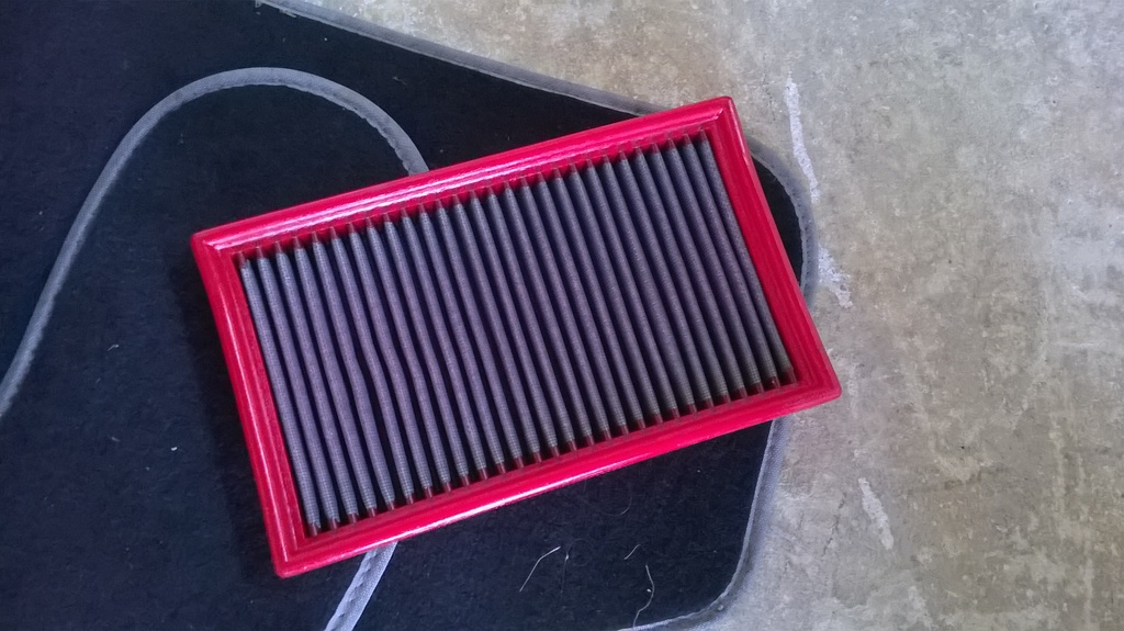

And BMC panel filter to go with the 06 air box
[URL=http://s298.photobucket.com/user/kaveney_photo/media/WP_20150802_0041_zpsvjx7ammr.jpg.html]WP_20150802_0041_zpsvjx7ammr.jpg[/URL
All put in and tightened up .
[URL=http://s298.photobucket.com/user/kaveney_photo/media/WP_20150802_0131_zpscbcgfwqn.jpg.html]WP_20150802_0131_zpscbcgfwqn.jpg[/URL
[URL=http://s298.photobucket.com/user/kaveney_photo/media/WP_20150802_0121_zpsjjchq5xg.jpg.html]WP_20150802_0121_zpsjjchq5xg.jpg[/URL

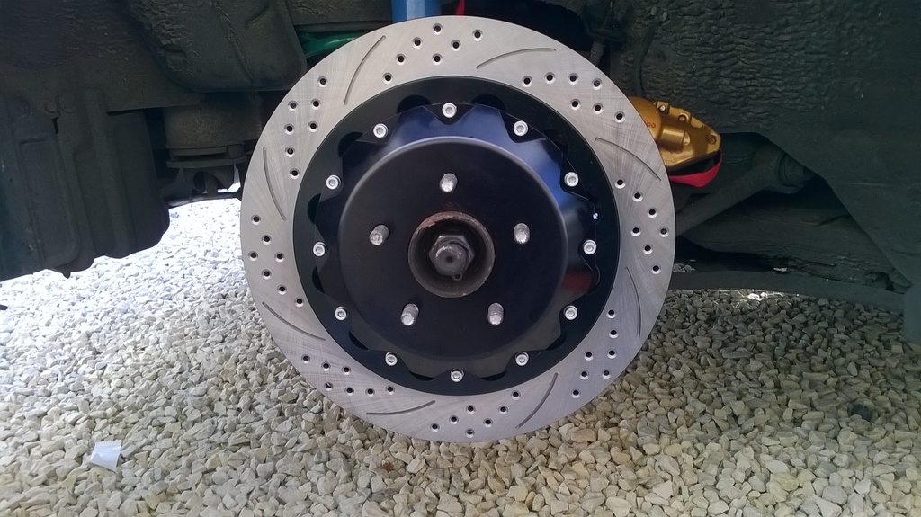

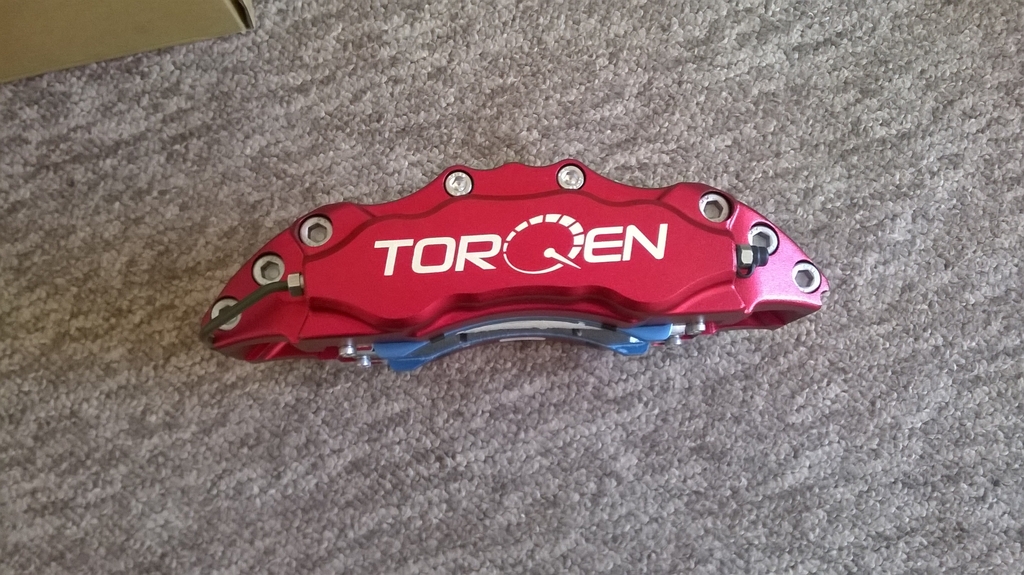

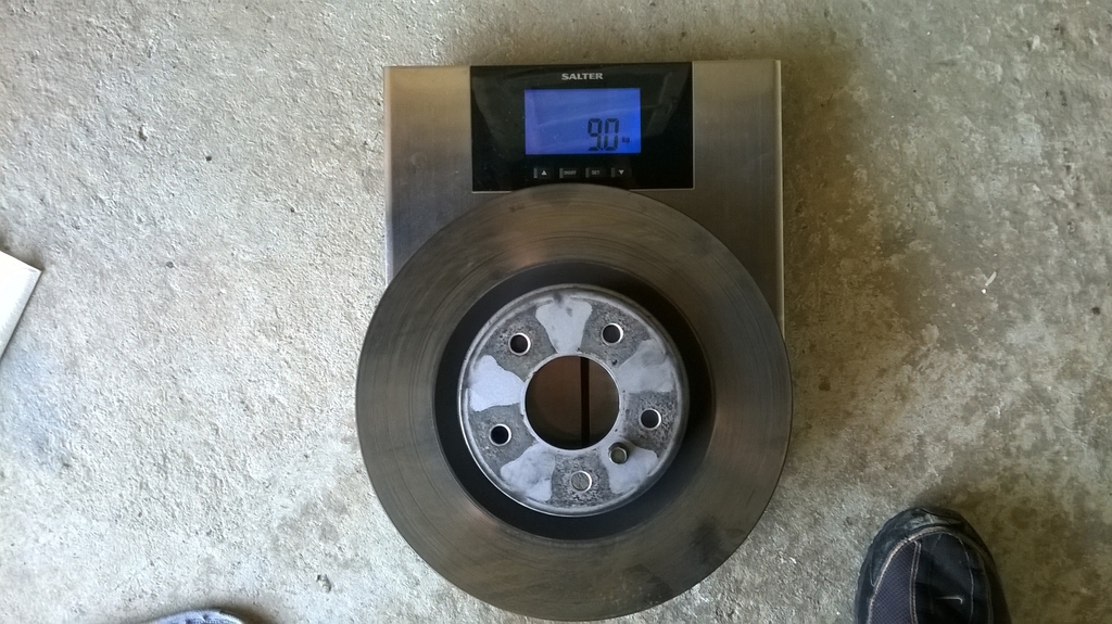

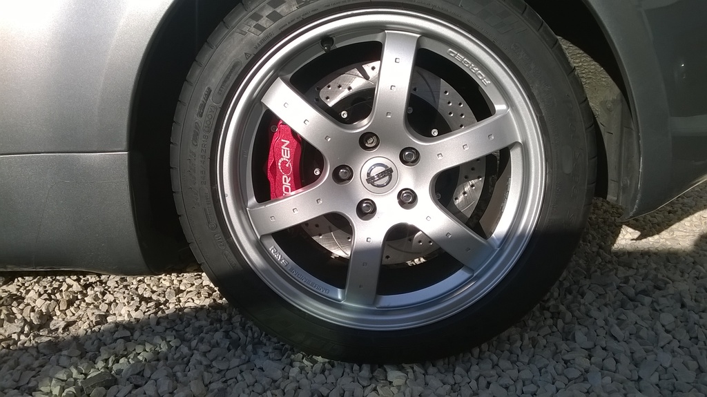

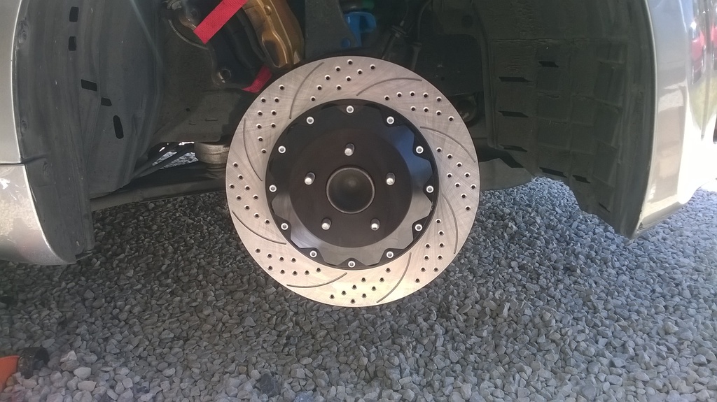

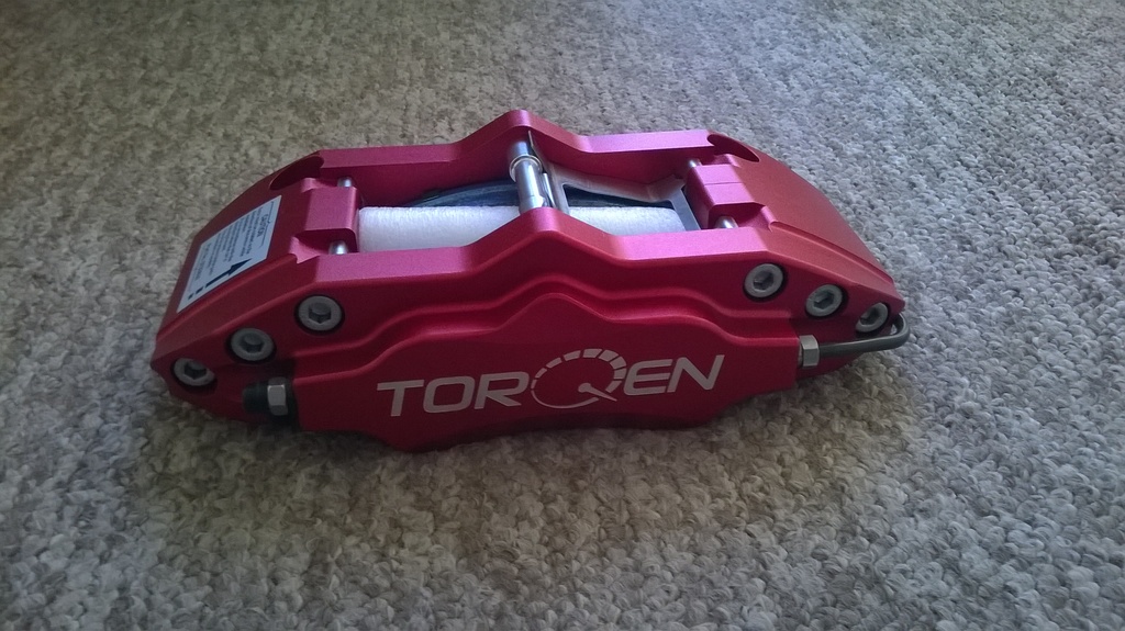

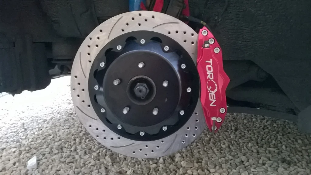

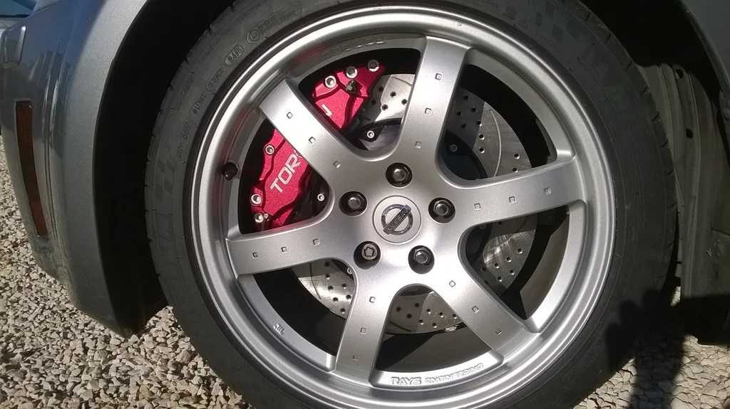

My XXL BBK arrived last week From Torqen so I got round to fitting this at the weekend .

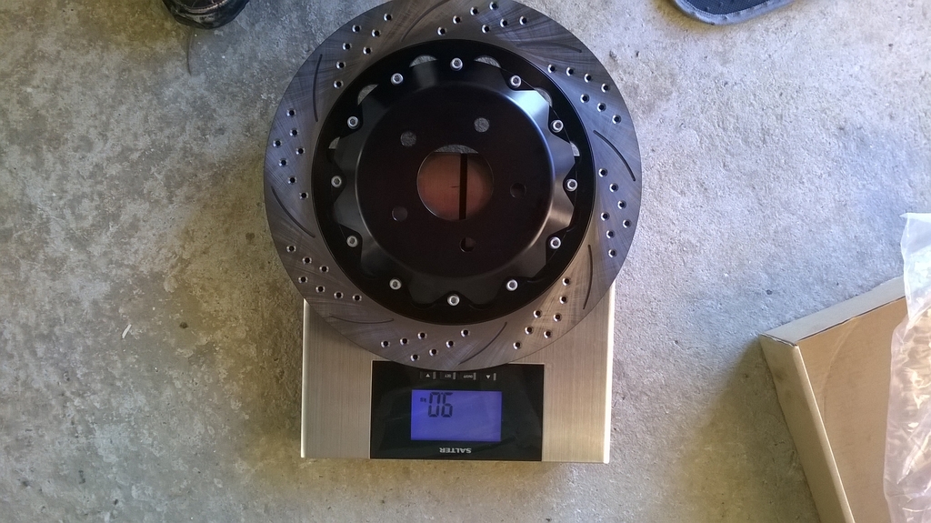

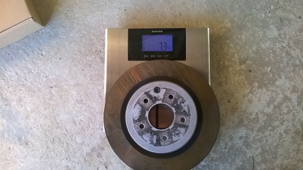

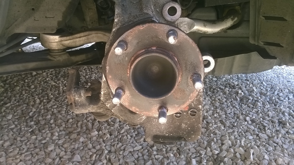

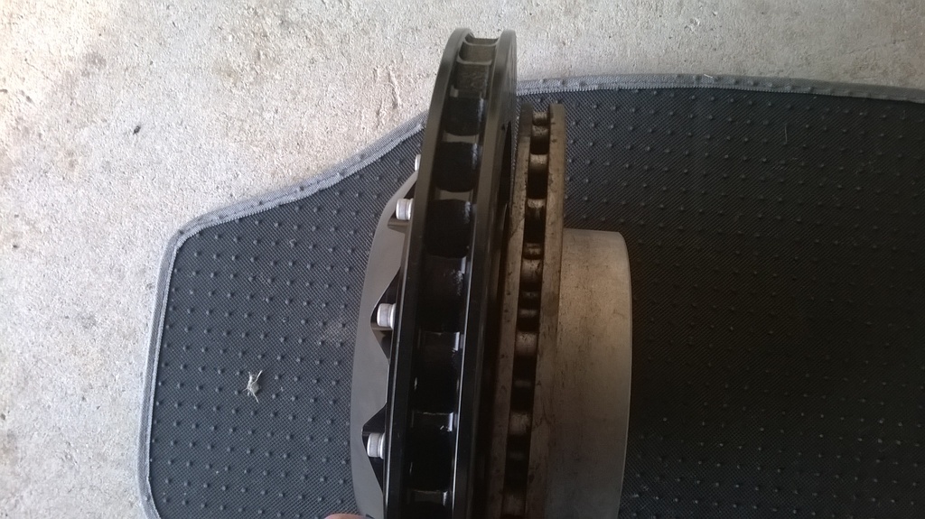

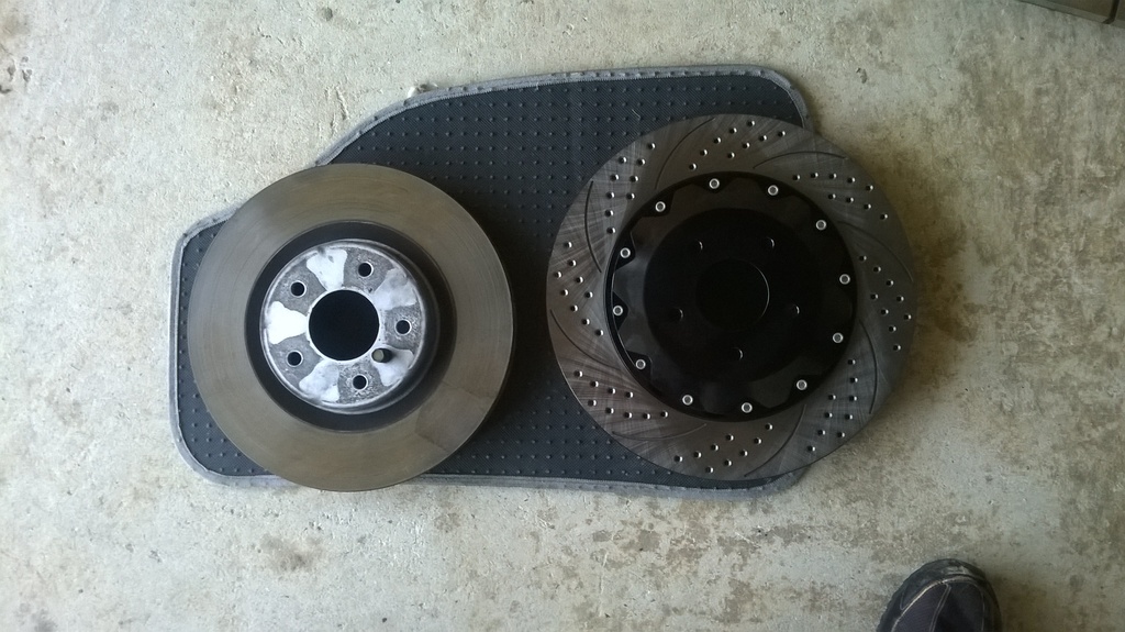

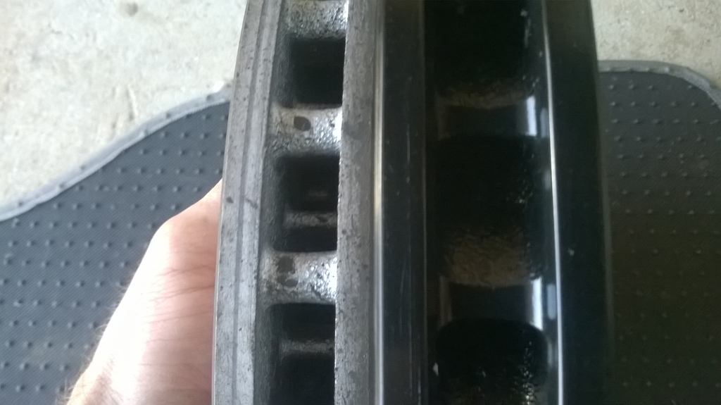

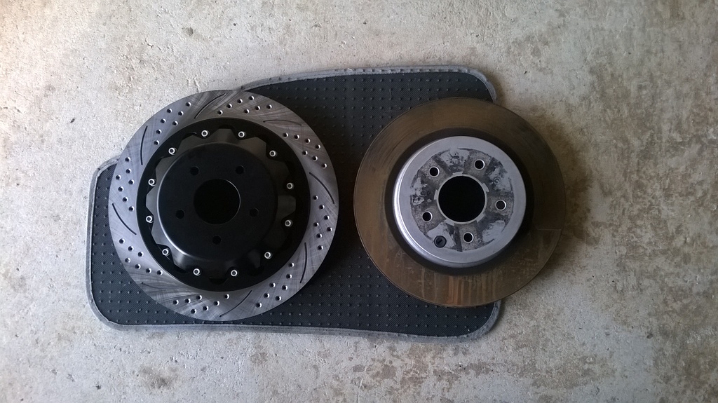

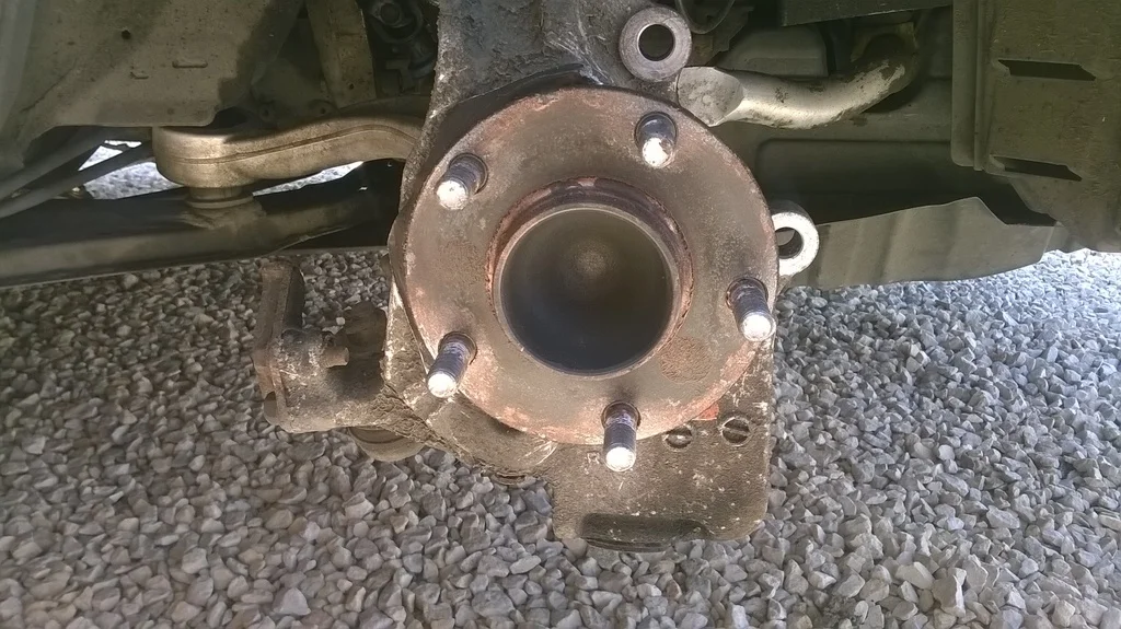

First up was to remove the old disc and thought I would so how heavy they are .
STD Rear 322mm disc @ 7.3 Kg
New rear 356mm disc @ 9.0 Kg
Ols vs new .

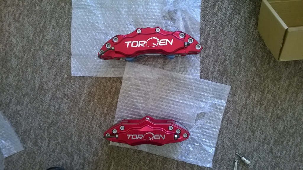

The Rear disc dust shelled needs to be cut to house the bigger disc .
Rear disc installed .

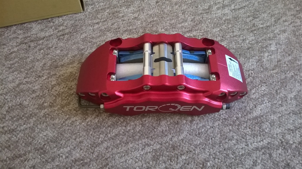

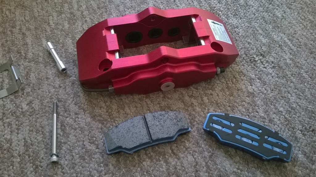

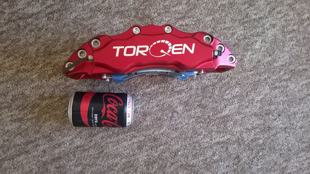

New rear 6 pot calliper is a bit on the large side .
With street pads .
And installed .

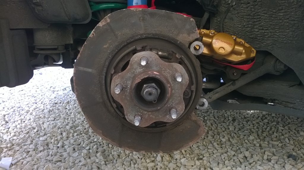

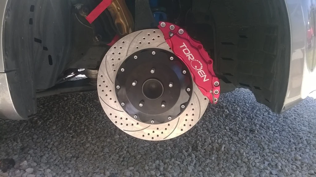

Then on to the front .
Old front disc 324mm @ 9.0 Kg .
New front 356mm @ 9.0 Kg .
Old vs new .
Again the front disc dust shelled needs to be cut to house the bigger disc .
Front disc installed .
New front 8 pot calliper is a monster .
And next to the already large rear 6 pot .
And installed

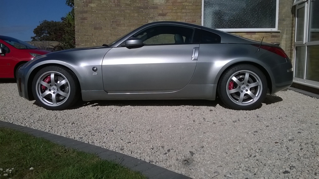

The rear just fit with a few mm of clearance under the std 18” Rays .
The fronts are even more tight but do just fit .
All done and flushed / bleed with super blue fluid .

Just a small update on the BBK I got from Torqen after a day after bedding the system in .
The great think about the kit is that it has the same feel as my old Brembo set up in as far as when you touch the peddle at slow speeds it does not grab or is too sensitive .
I would say at ¼ to ½ peddle travail the force / stopping power is the same as my Brembo set up with DS2500 ( DS2500 when hot ) pads S/S lines and new discs .
From then on at ¾ the car stops like it has hit a tree and I still have not given them the full on stamp .
I will see how much better they get when fully bedding in .
