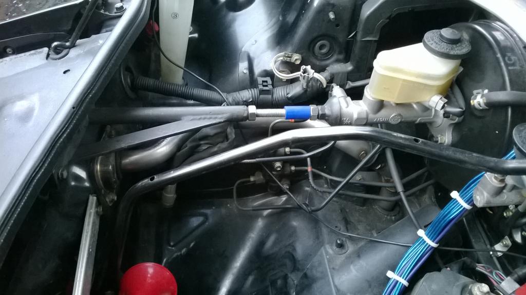

Brake stopper in .
TBH pedal is firmer and feels better on bigger stops so not a wast of money

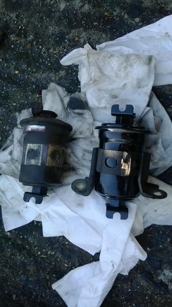

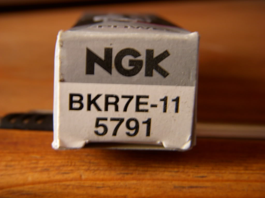

Just an update of some service parts that will be done this weekend
Oil & Filter
Fuel Filter
Grade 7 NGK Plugs
  Fiesta ST Stage 3

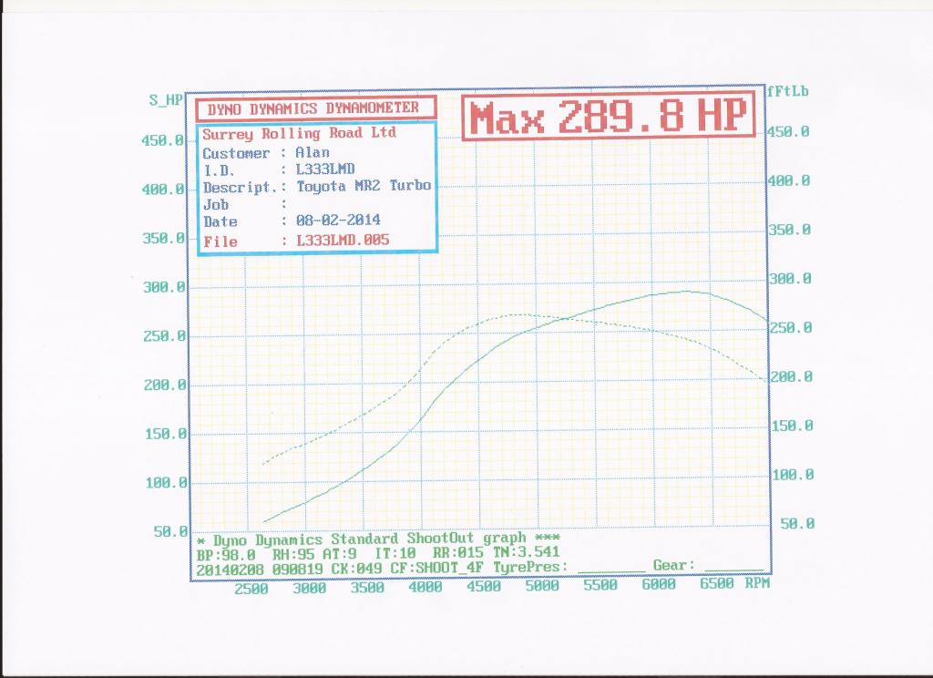

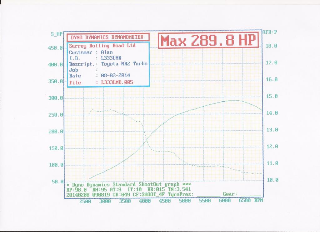

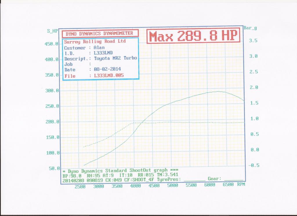

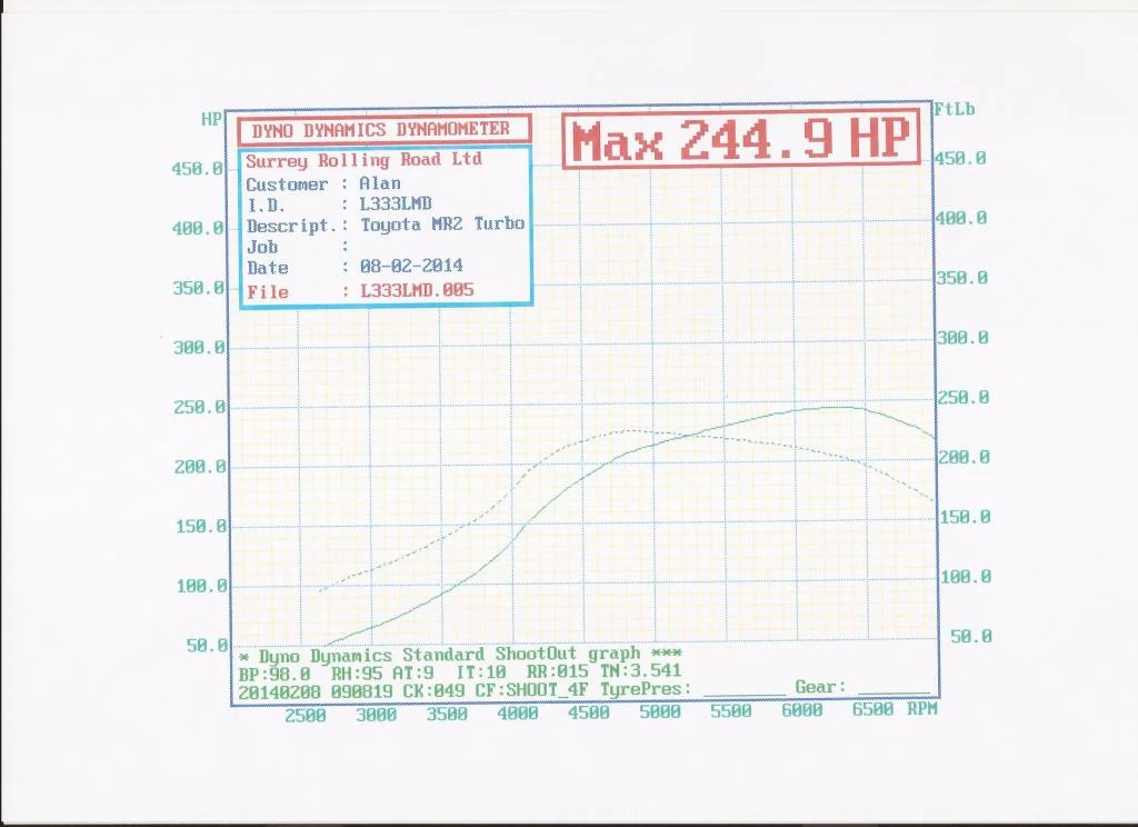

Was 288.00 BHP and 171 LB/FT in 2012 .
Now is 289.8 BHP and 171/LB/FT in 2014
Don't know where the 2 horses came from ( service I guess ) but im very happy with this as its still on the same boost and everything bar the intercooler .
Its only running 0.9 BAR of boost so will up this to 1.15 - 1.2 BAR and then head back down for another run in late march / April ( if you fancy coming and seeing what the Megane does )
AFR one
Boost one well happy as I thought it was running just over 1.0 BAR :)

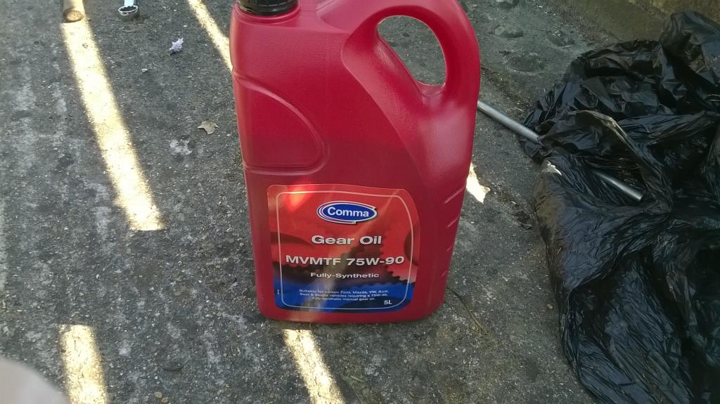

Few thing done at the weekend

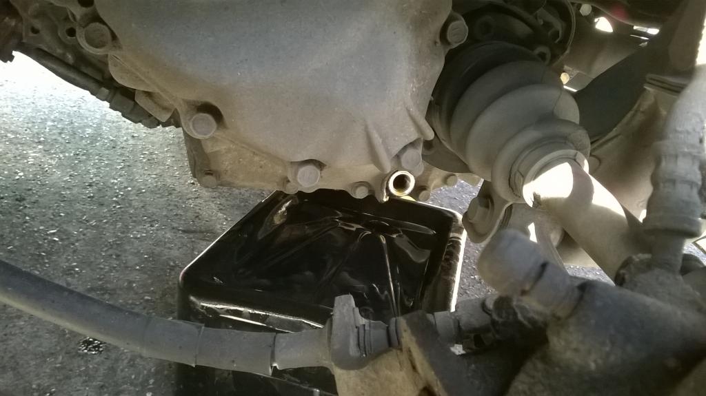

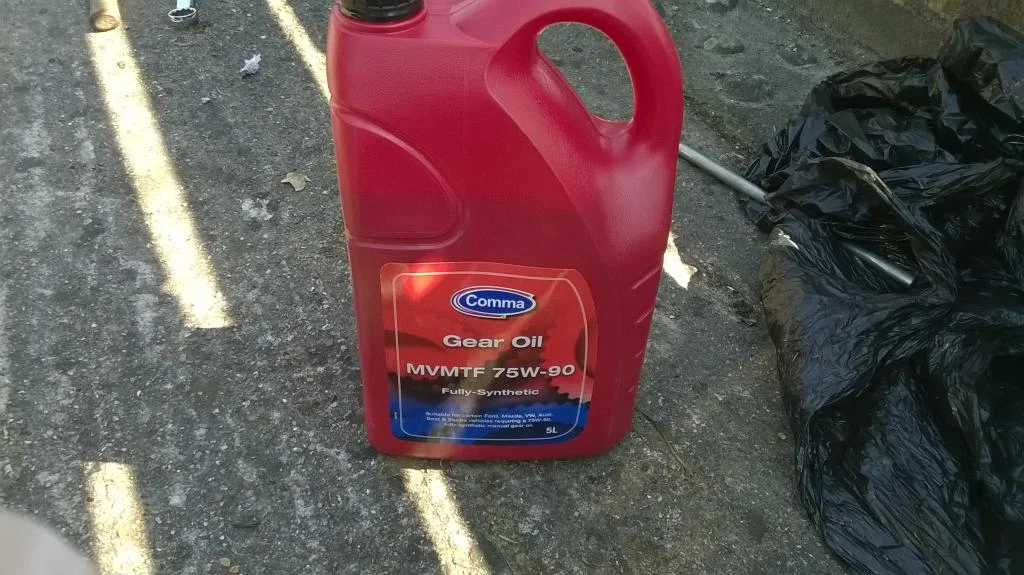

Gear box oil change

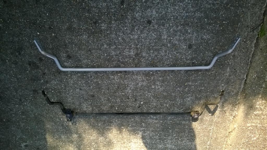

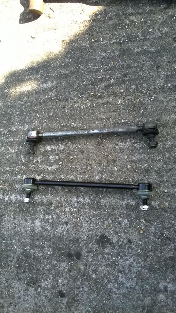

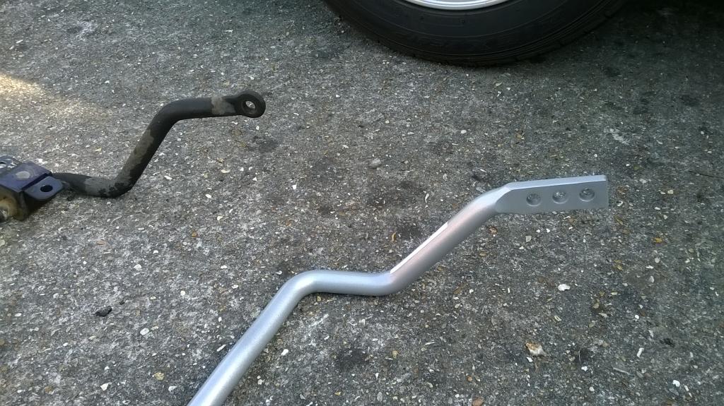

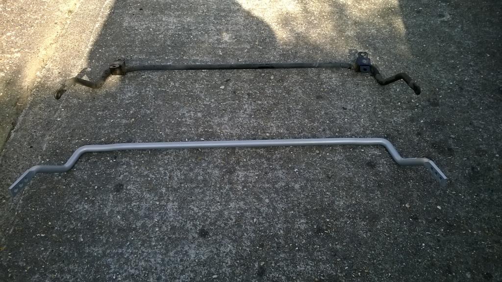

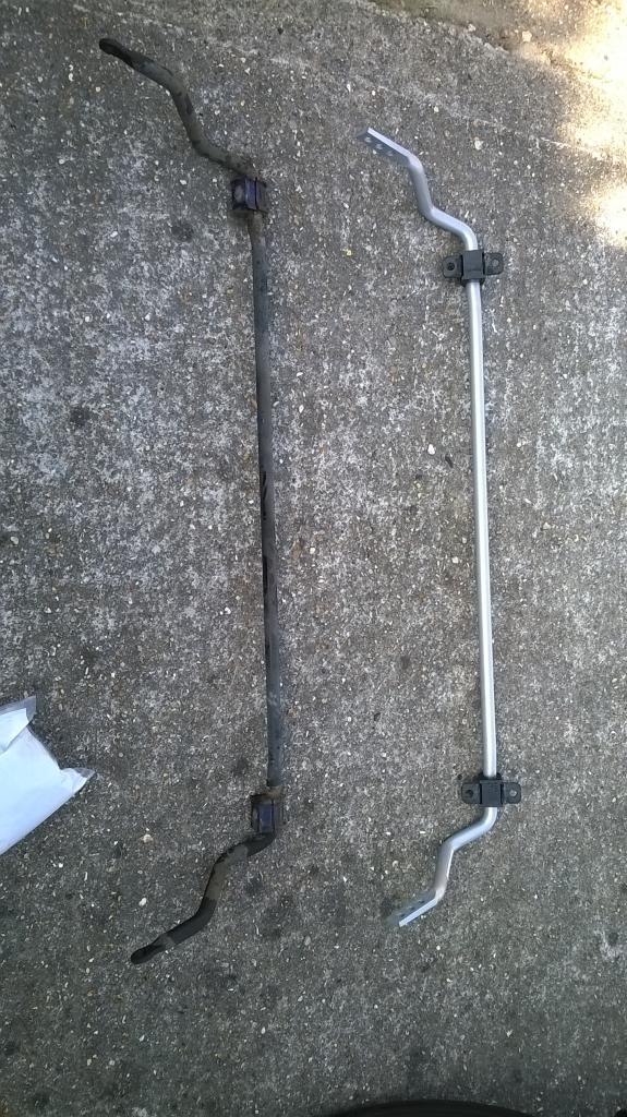

Then put in the Whiteline adjustable FARB set to med with new drop links and bush .
Old vs new
Old 18mm and the new 20mm

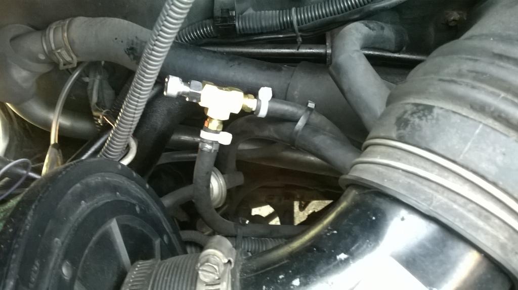

And the new GTS-Chris MBC .

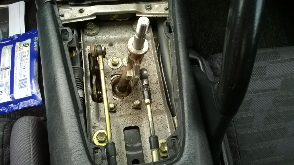

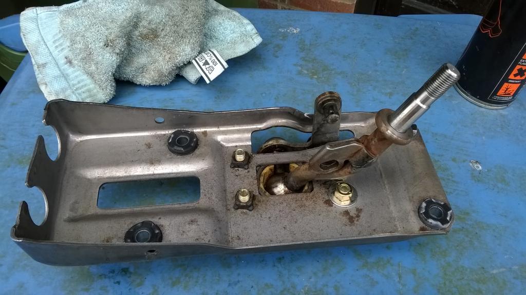

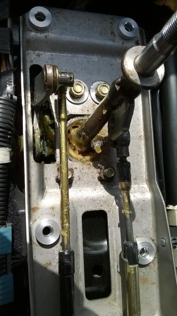

Small update

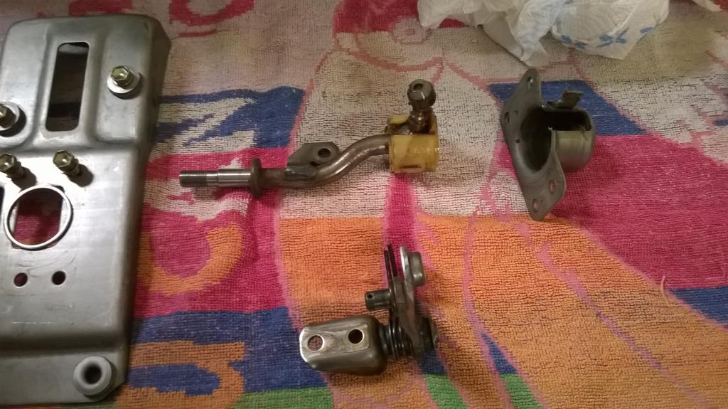

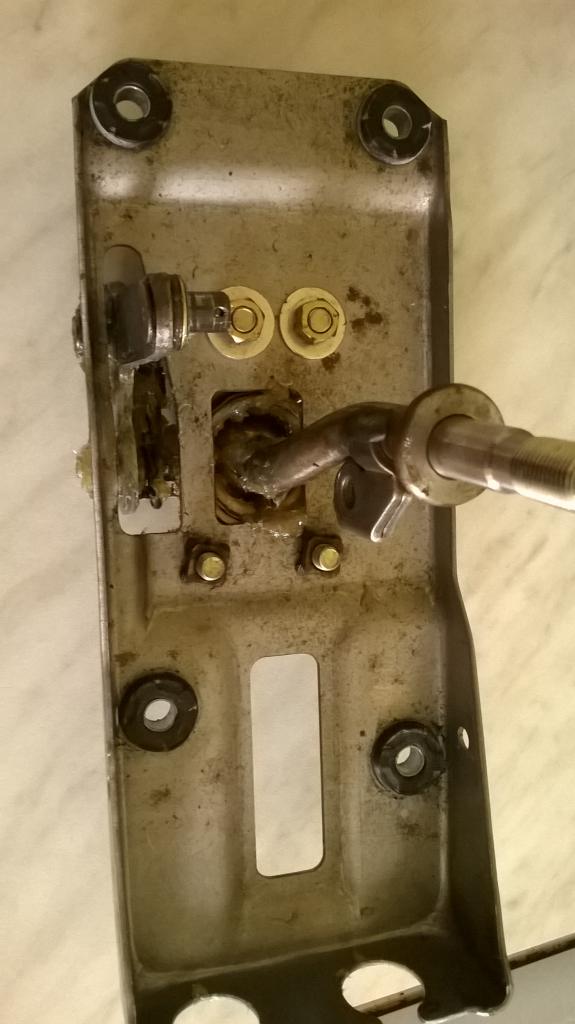

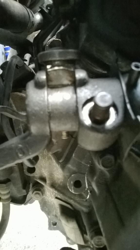

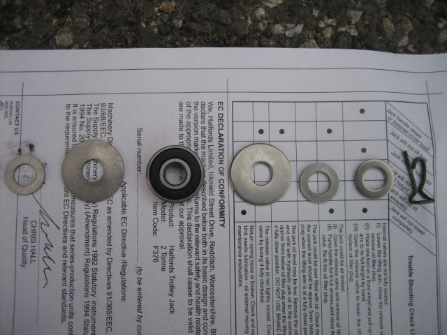

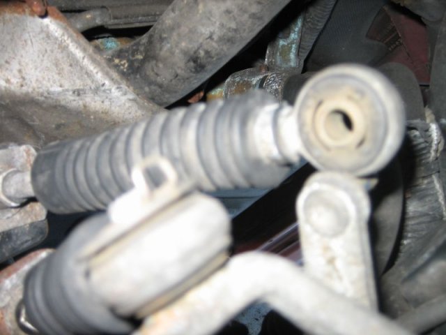

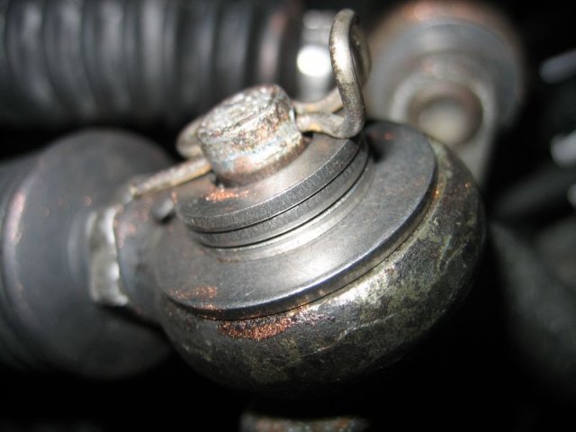

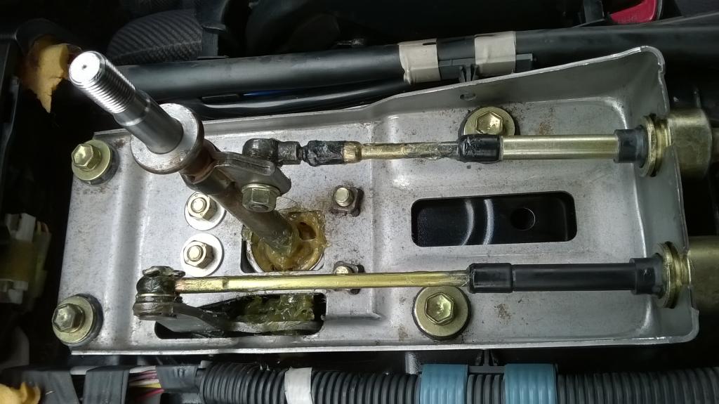

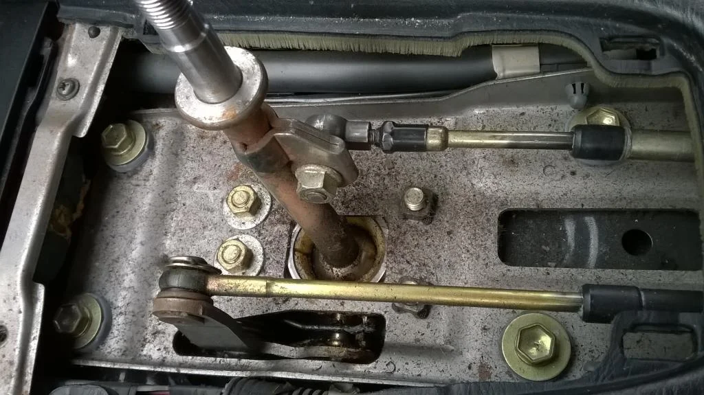

Finished off the last few bits to improve the gear shift .

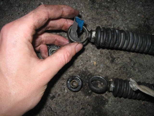

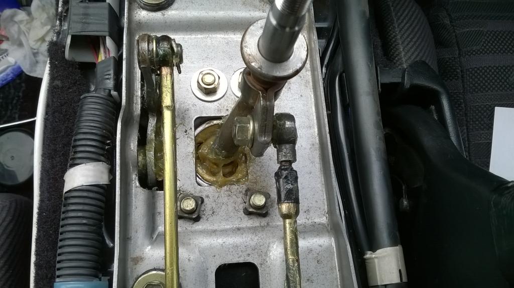

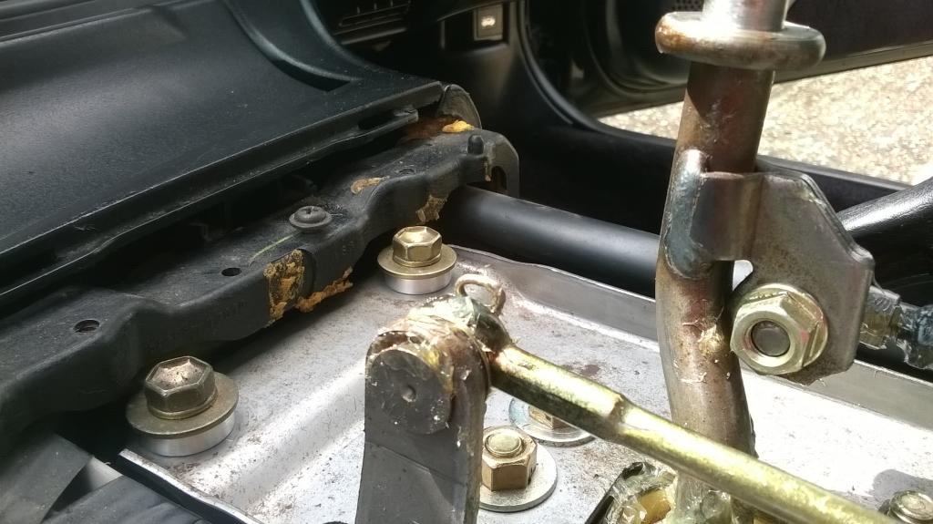

Turned the shifter cube 90 deg so it has fresh metal ( see pic of 20 years of rubbing lol )
Then last was to take apart the gear shifter and de / re grease and add some extra washers to the rubber mounts .
Old dirty grease and plate
Removed and cleaned
Back in cleaned up and with new fresh grease

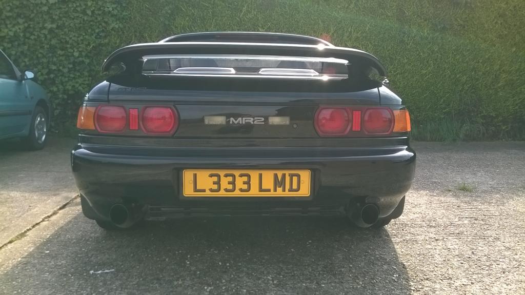

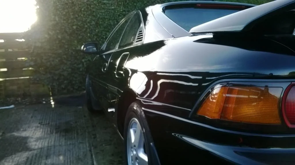

First off was to have a go at the cloudy rear lights
Before
After
Then fitted some heat reflective wrap for my inter cooler cold pipe that runs over the top of the engine bay heating back up the cooled air from the inter cooler ( just roughly fitted this and will tidy up later after some tests )
Then a quick wash and wax to finish .

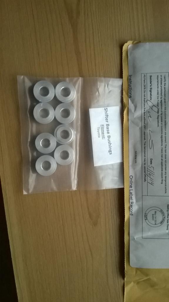

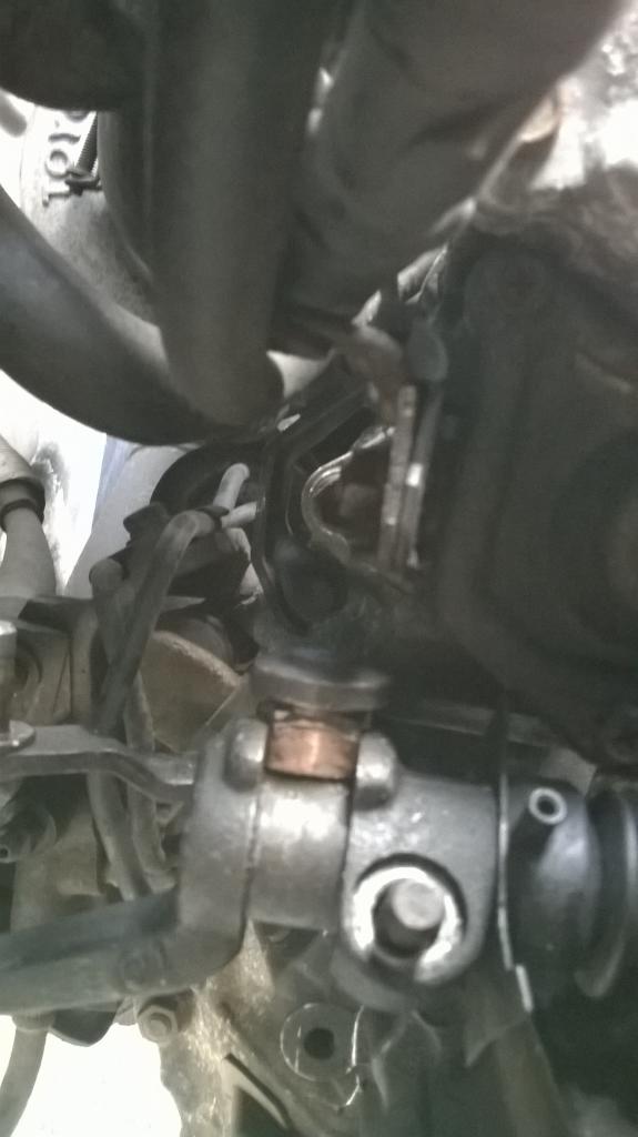

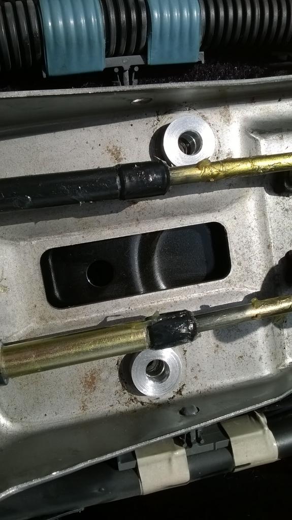

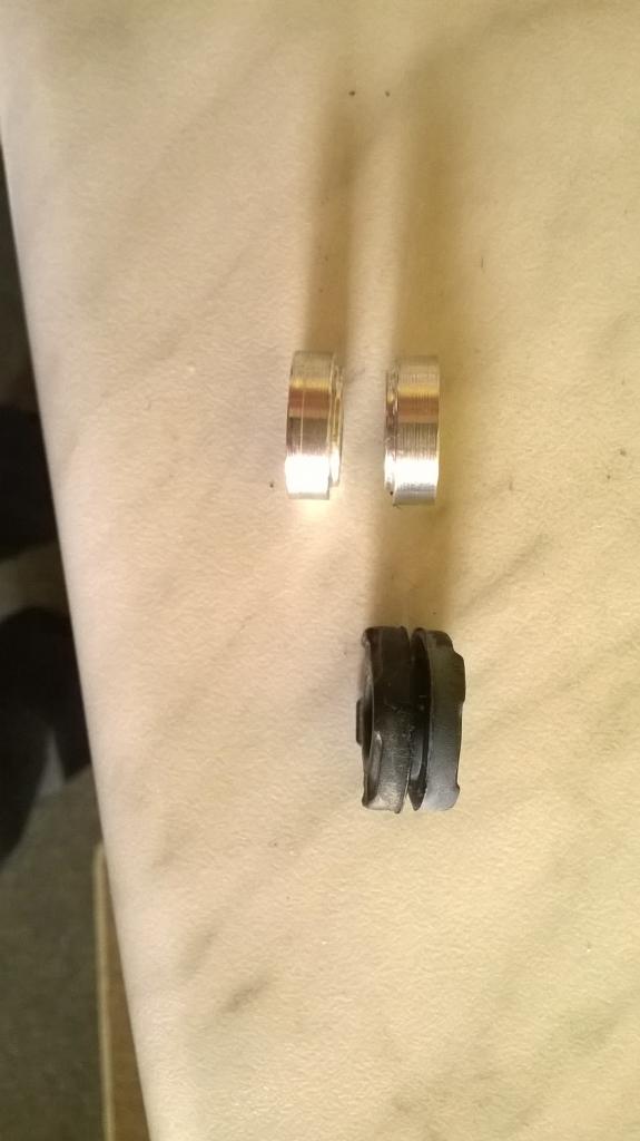

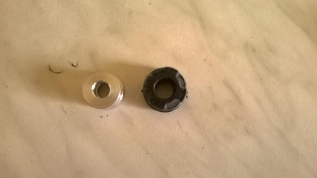

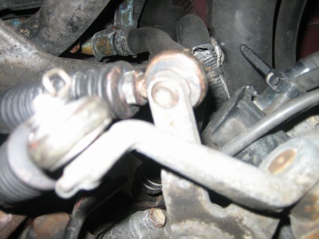

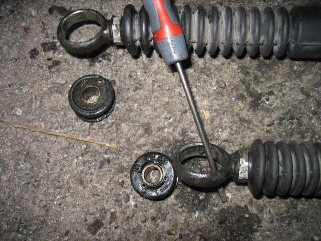

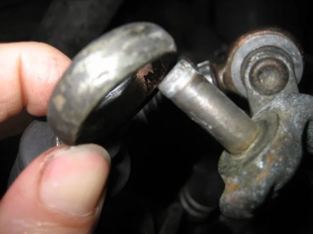

Finished off the final shifter upgrades today with some solid base shifter bush .
This is it now for the shifter upgrades that are gearbox oil change , solid bearing shifter bush , rotated shift cube , clean and re grease shift linkage and solid base shifter bush .
New solid base shifter bush from the USA
Base out with old rubber base bush
Old vs new
in and lined up
All done with bolts all done up .
