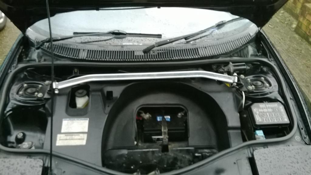

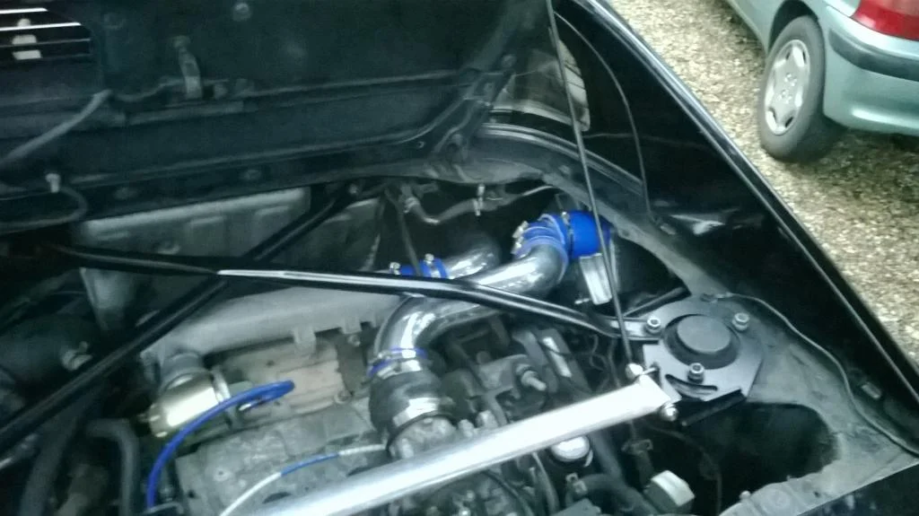

Just an update of the strut braces put in last week taken on phone .

No not yet done all the hard work and just need to bolt up everything but the x 2 conectors in the kit were too small :mad: so will need to order them and finish off at the week end .

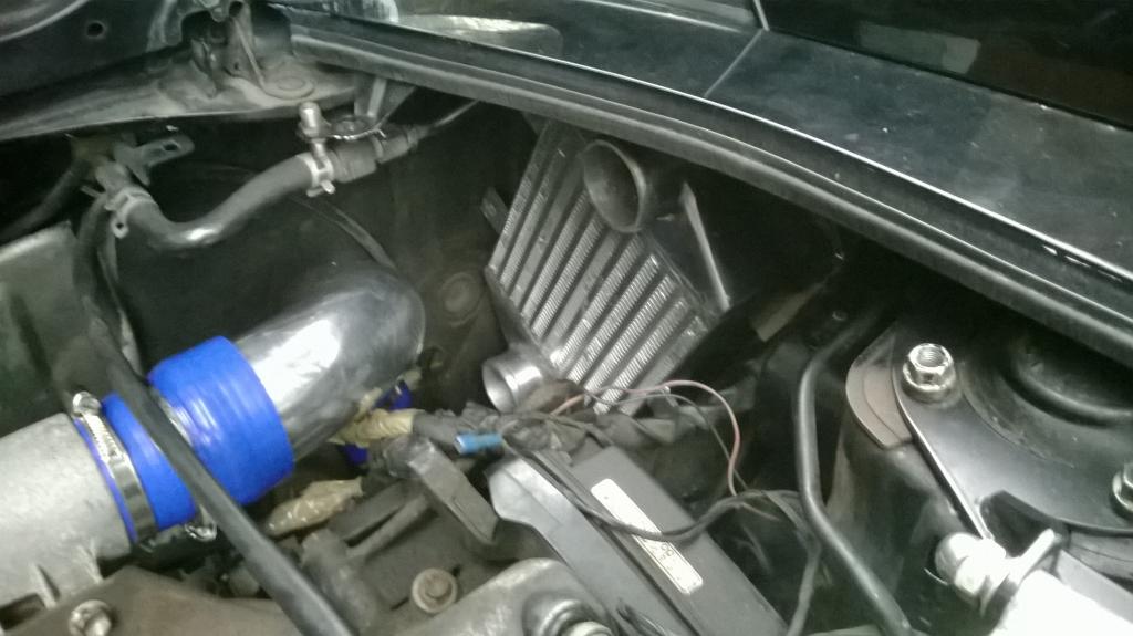

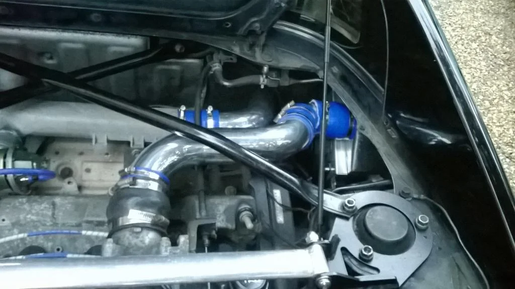

One of the most hard installs iv ever done had the car in bits , wings off body off belts off lol
Some pic below of the fight

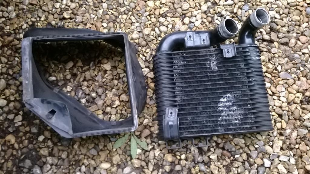

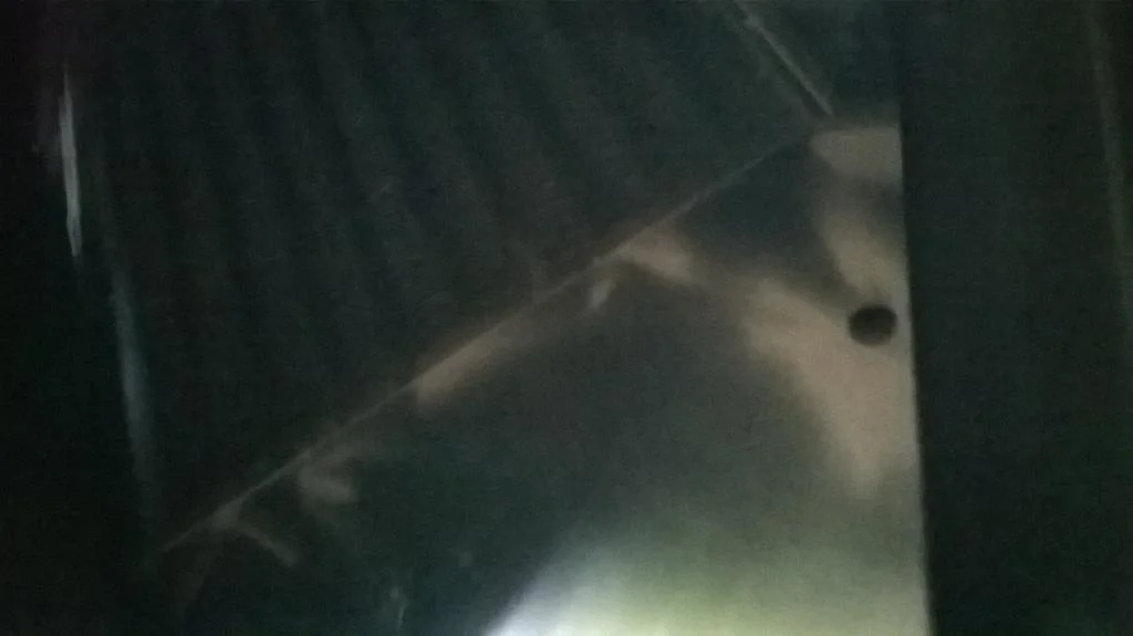

And one of the old intercooler and shroud
and the damage LOL

mad amount of work to fit it LOL
There is just no space and its in so tight .
Just need to get the hose and then fit it check for boost leak then tweek the boost to 1.15 BAR then we are done

Stock one is pants and I was running a risk using it with the extra BHP .

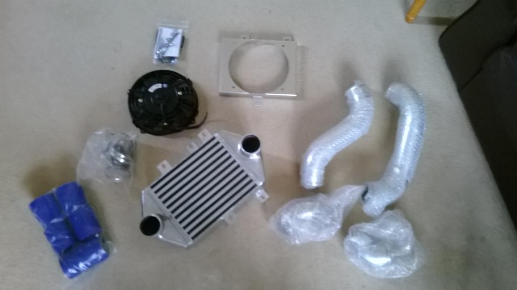

The new Greedy one is over x 2 the size of the old one with bigger inlet and out let pipes and the fan is bigger too :)

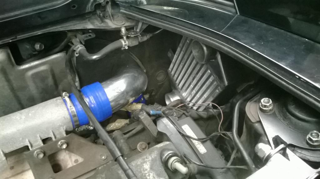

And we are done at last but i will still need to get some better pipes but this will do for now .
Just need to go and check for leeks and then up the boost to 1.15 BAR .

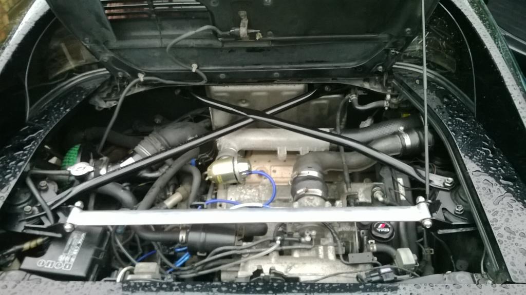

I have fitted front and rear strut braces .

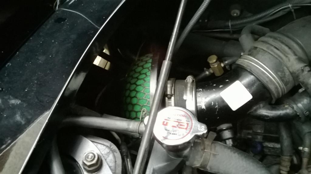

Have put new coil pack , HT leads , Dizzy and roter arm in and just done another full service with fuel filter oil + filter and x 1 grade colder plugs ( grade 7 NGK ) and a new HKS foam filter for the induction .

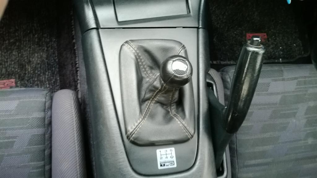

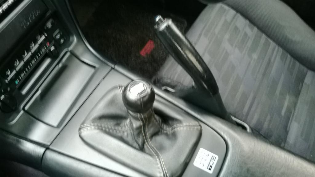

A few other bits are hi performance bulbs ( ring 120 % ones and matching LED side light ) and some TRD bits ( gear knob , oil cap rad cap ) .

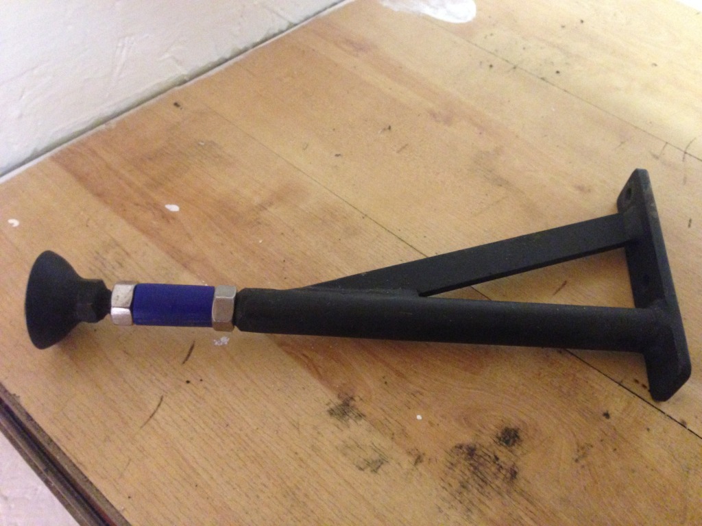

I have a break stopper to put in as well but im not sure what to do next from the below two options ?

  Fiesta ST Stage 3
It prevents the bulkhead from flexing, it gives a firmer feel to the pedal.
One bolt is already present on the stock front bulkhead in front of rad to secure it, you can add another as there is a hole in the stopper, you then adjust the arm out to brace the master cylinder and lock it off.
What does it do?
