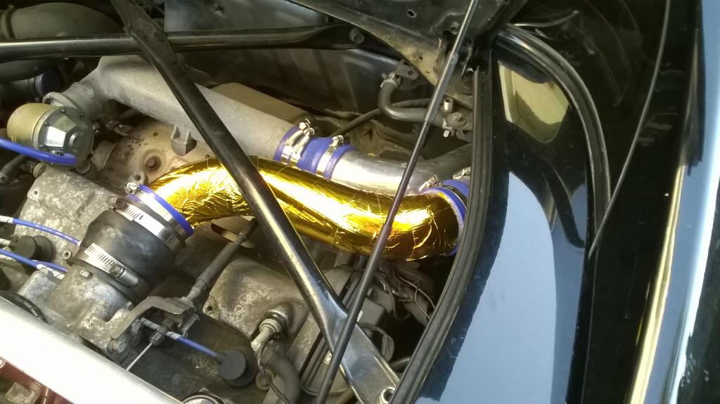

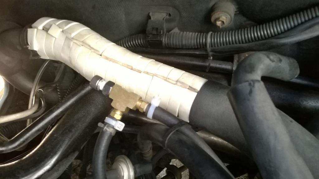

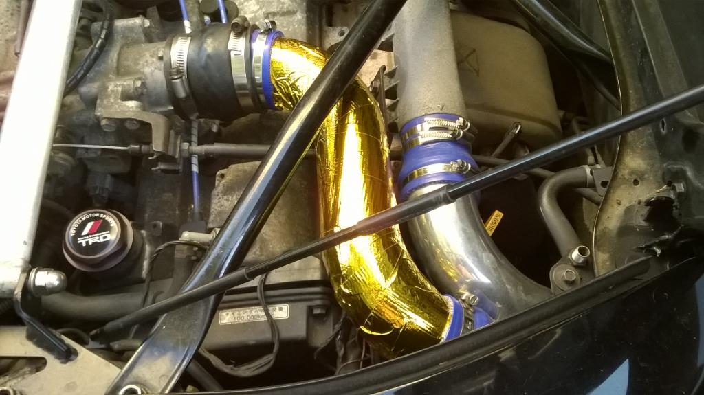

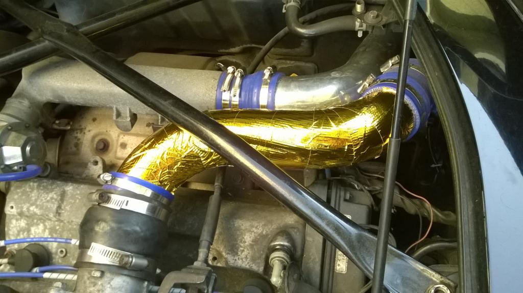

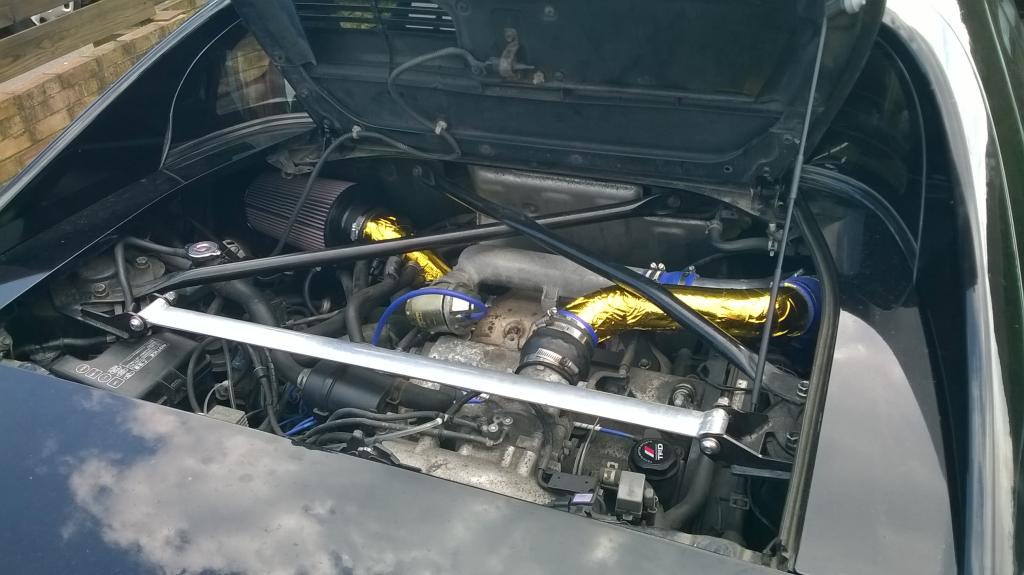

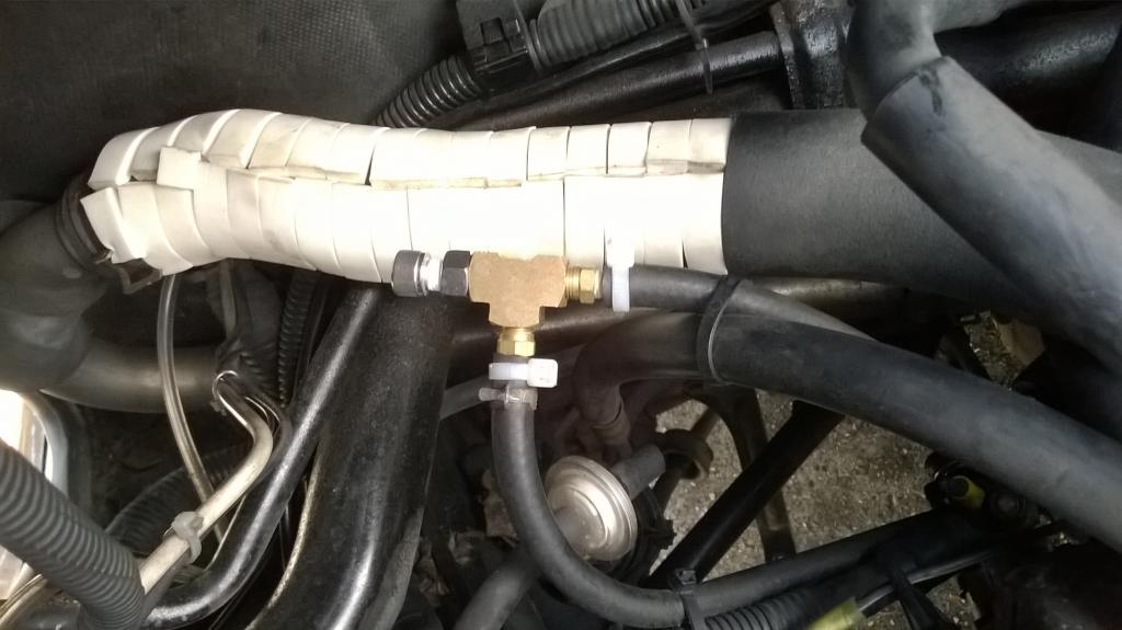

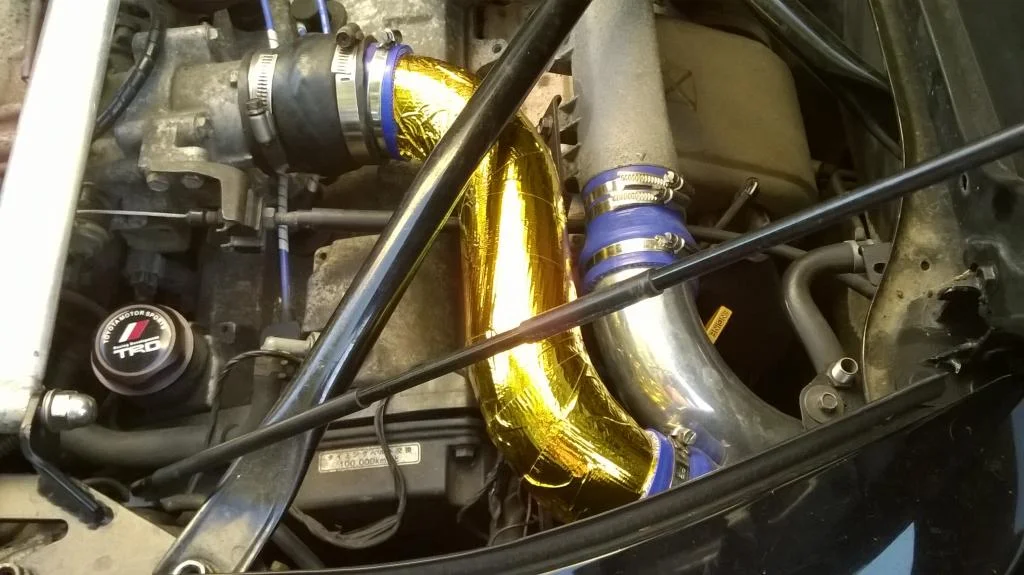

I was not over happy with the silver heat reflective wrap and after reading a few things was told that this would not be the best move as it may trap the heat in the cold intercooler pipe .
After some advise I ordered some DEI gold tape as this will reflective about 80 % of the heat but as it is only thin tape will not insulate the pipe the same as the wrap did .
Was a pain to fit but after a few goes it was on .

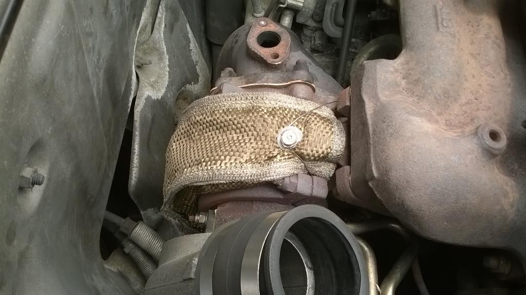

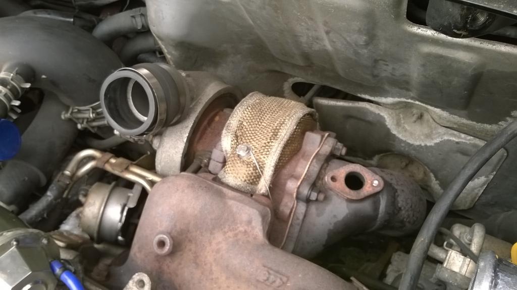

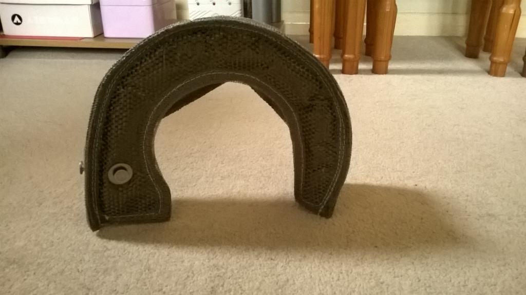

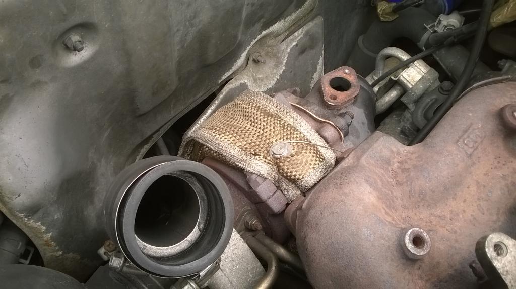

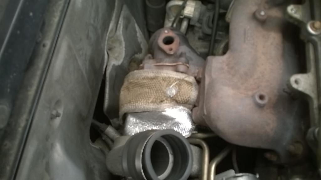

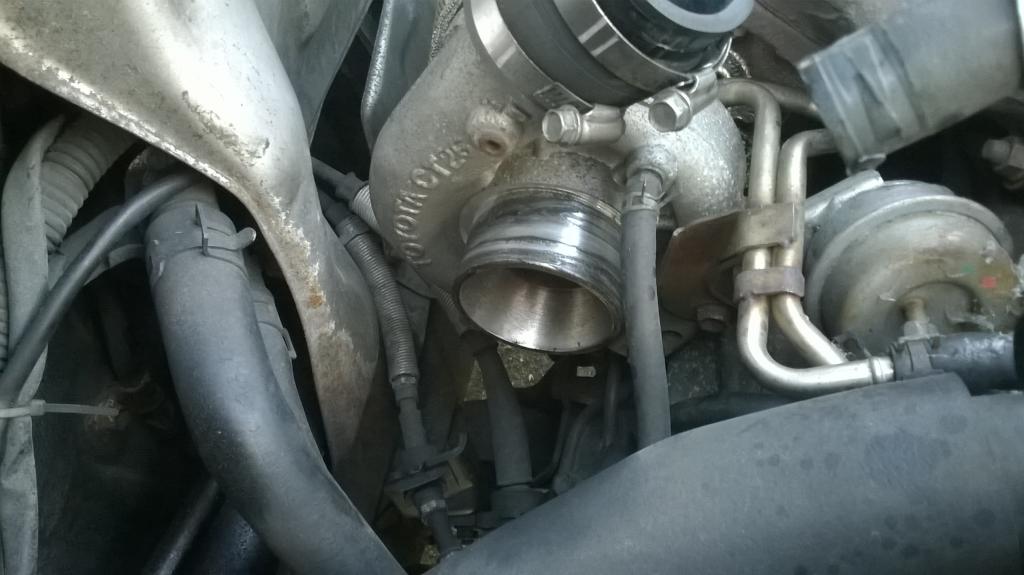

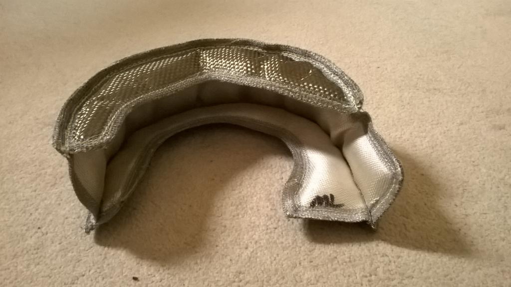

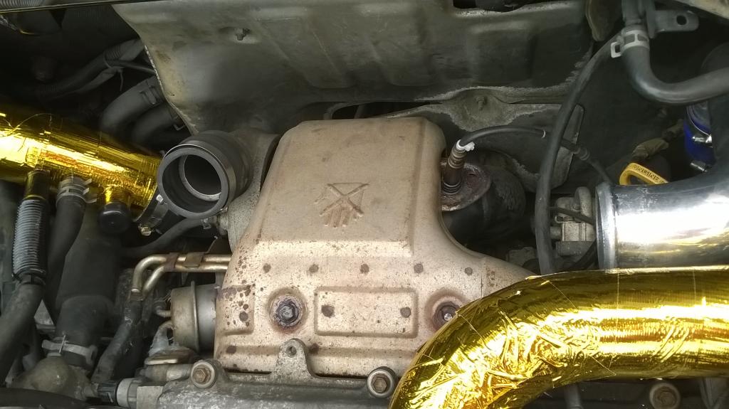

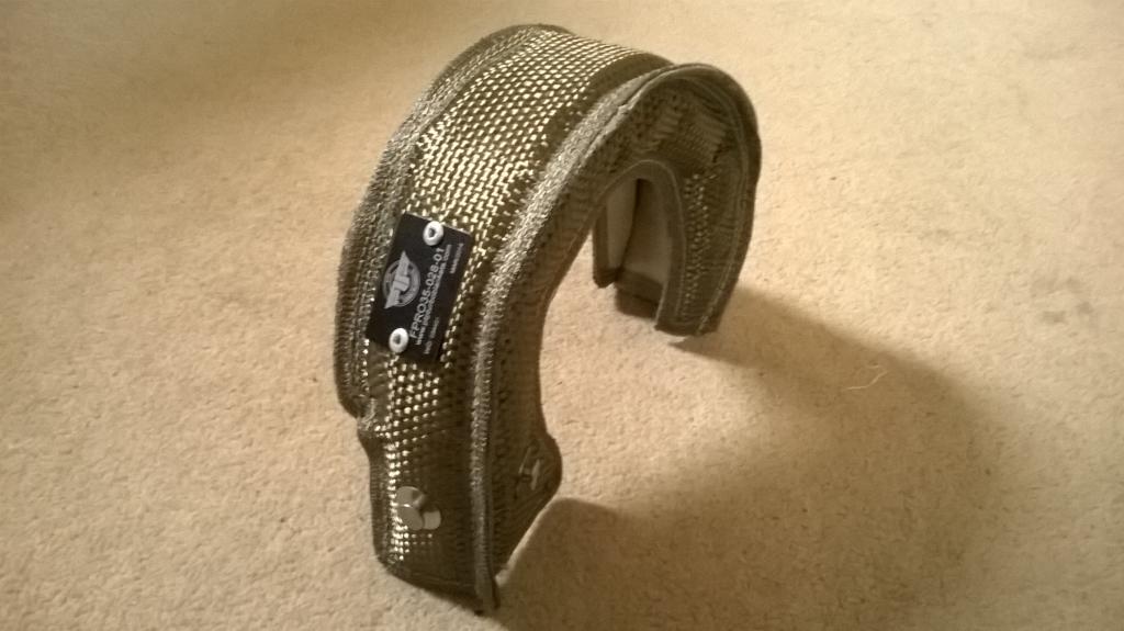

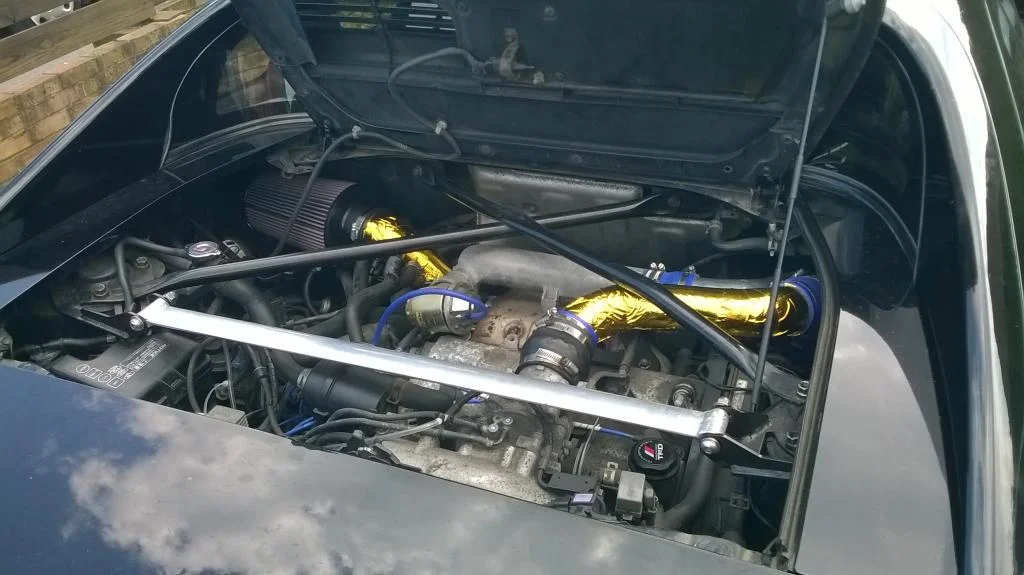

My PTP turbo blanket arrived from the USA .

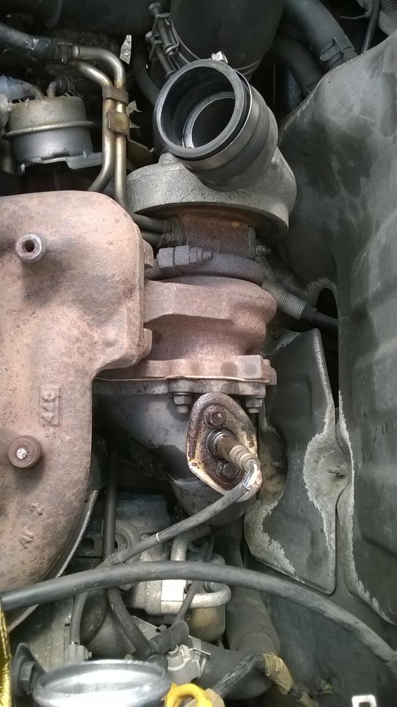

Removed the x brace hot pipe , O2 sensor and the heat shield to get to the turbo .
Was a bit of a pain to fit but after an hour or so it was all on .
All done up and heat shield back on .

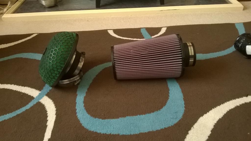

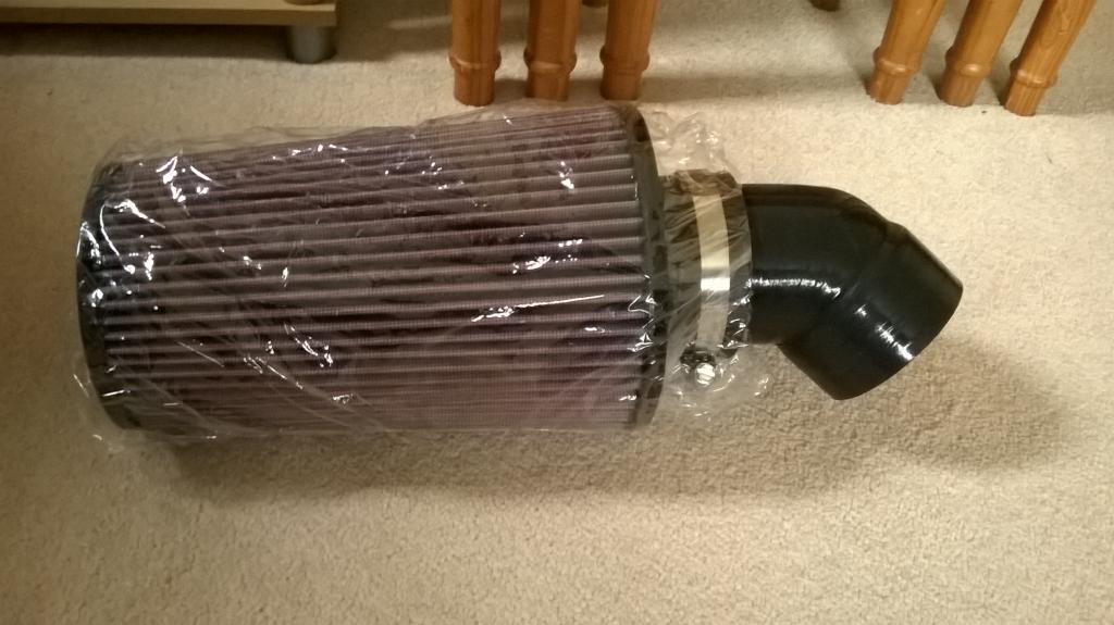

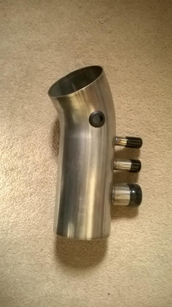

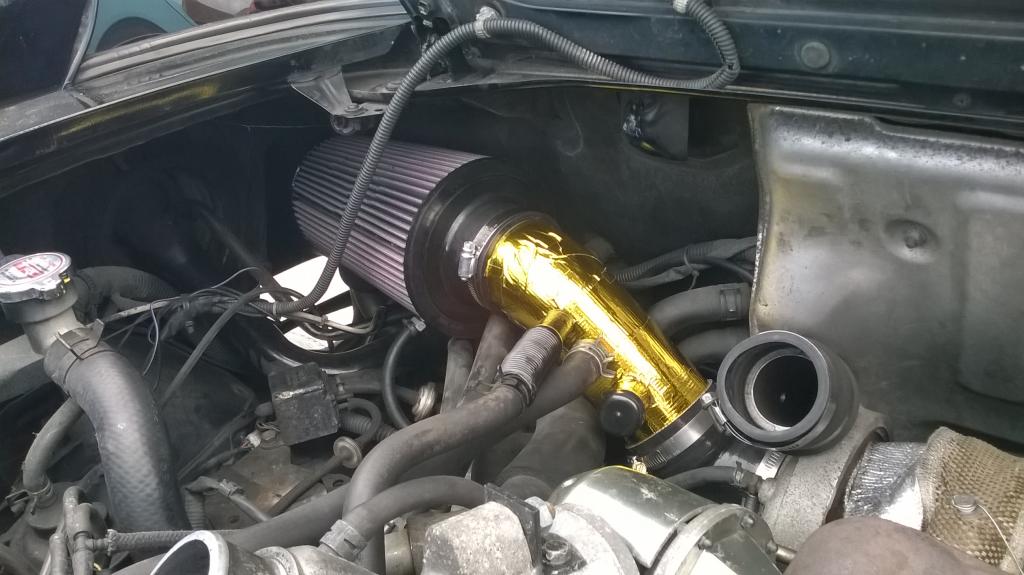

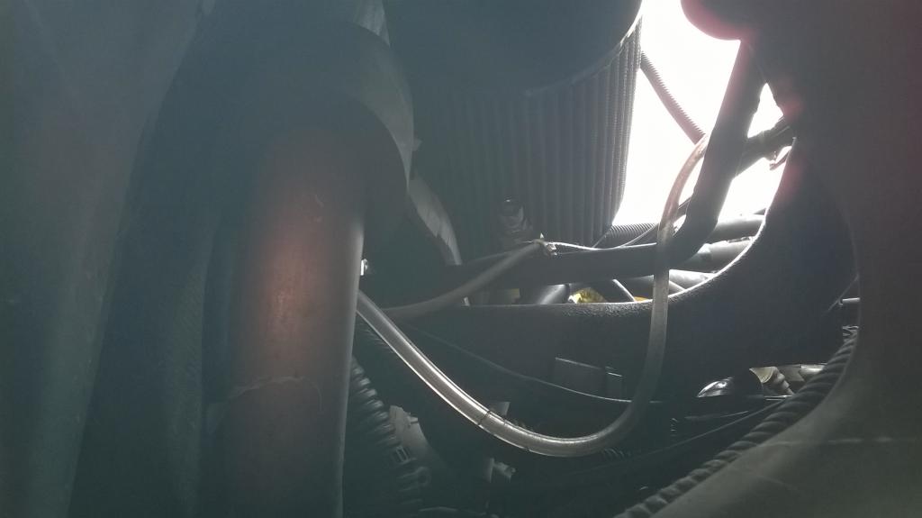

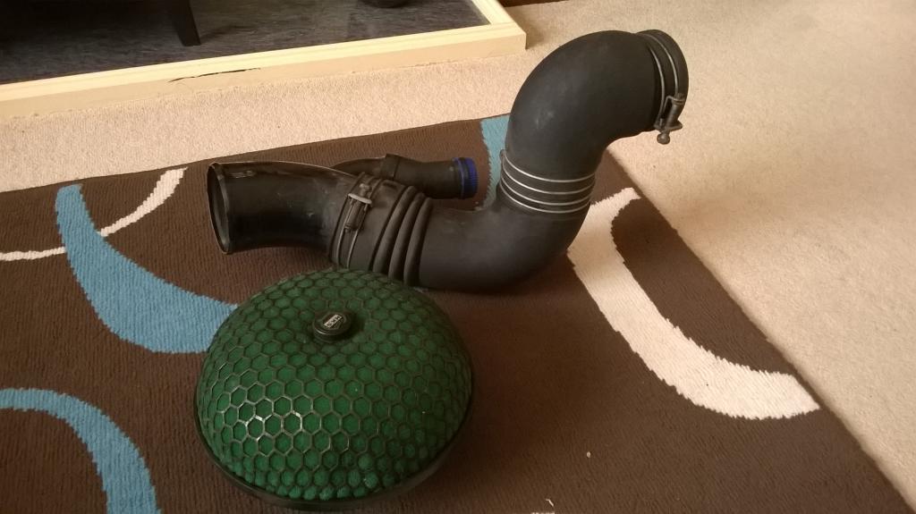

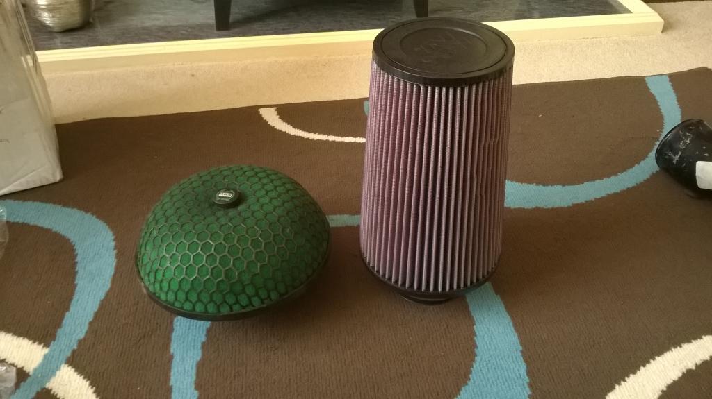

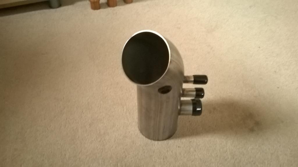

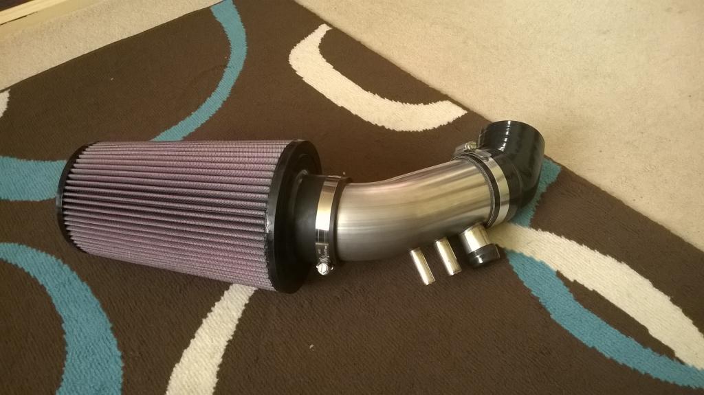

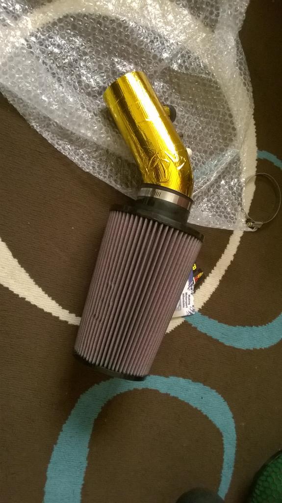

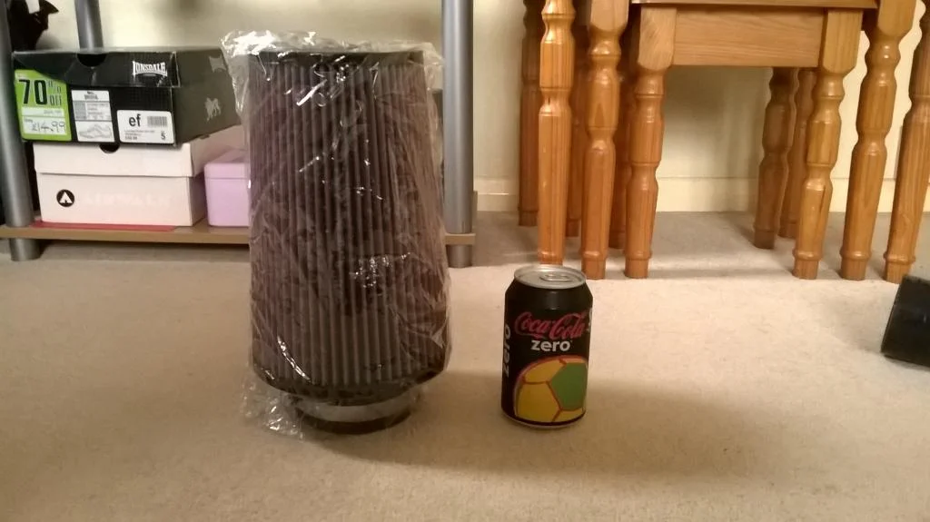

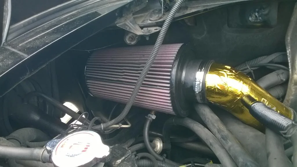

Also had time to fit my 3" intake and filter from KO Racing from the USA .
3" Inlet pipe
K & N Filter
Old HKS intake removed
Old vs New
All set up ready to go on .

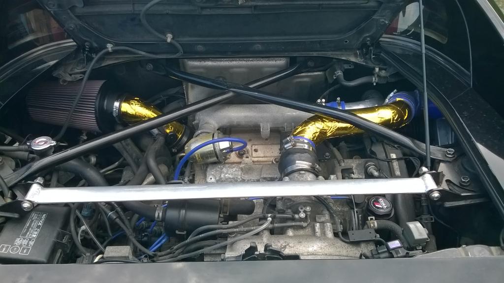

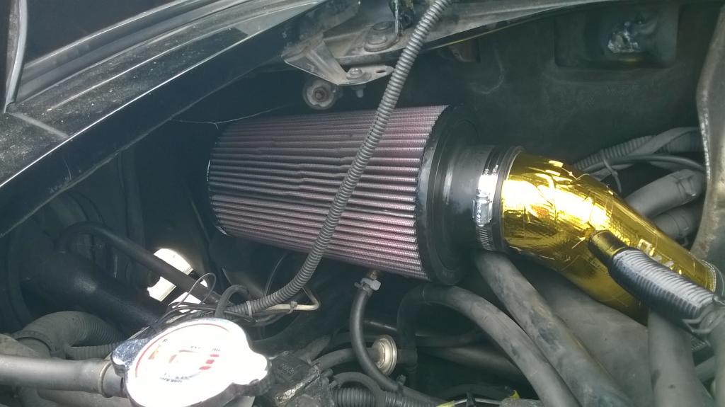

And DEI heat tape on the pipe .

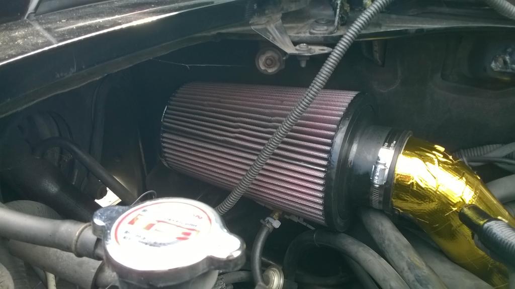

Only problem was as the new induction set up is much bigger it was resting on the hot rad pipe so some sticky feet were used .
All lined up and connected and tightened up .
View from side intake pod .
X brace and bits on to finish off .

The only thing that I'm wondering is why you'd need a blanket for the turbo? I'm sure it gets hot enough without it ;) lol.
  Fiesta ST Stage 3
It gets cold at night and scared :)
been told nothing but good things about them and a few people on IMOC run them with good results .
Keeps the hot side of the turbo hot adding spool and keeps the bay temp down ( all in the below link )
http://ptpturboblankets.com/why_turbo_blankets.php

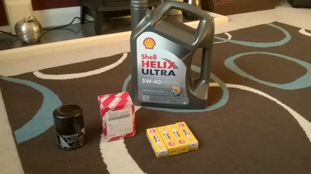

Got my parts through for another service before going to surrey rolling road on the 21/06/14 .
5W-40 oil
Toyota oil filter
NGK one grade colder spark plugs

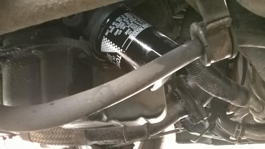

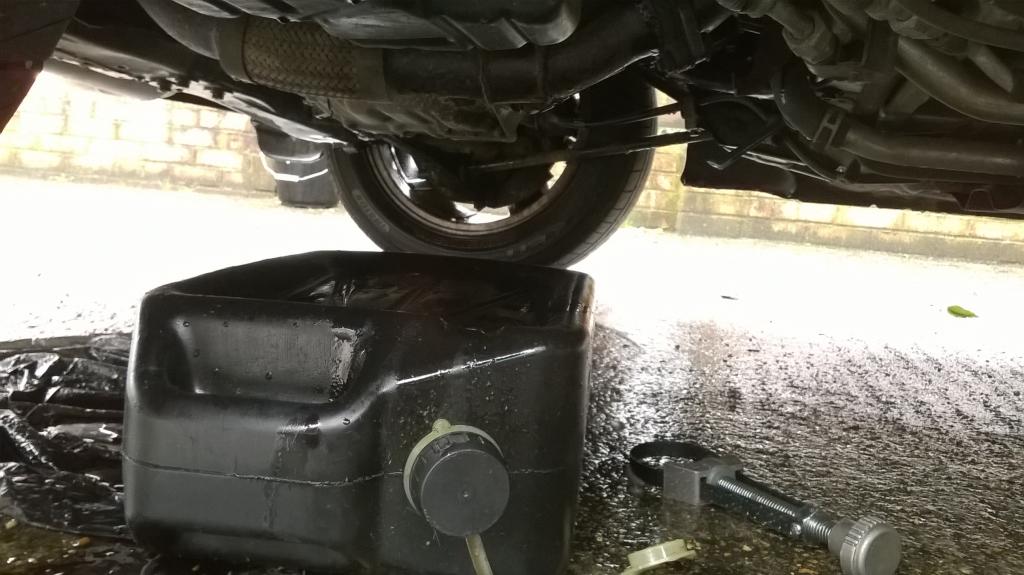

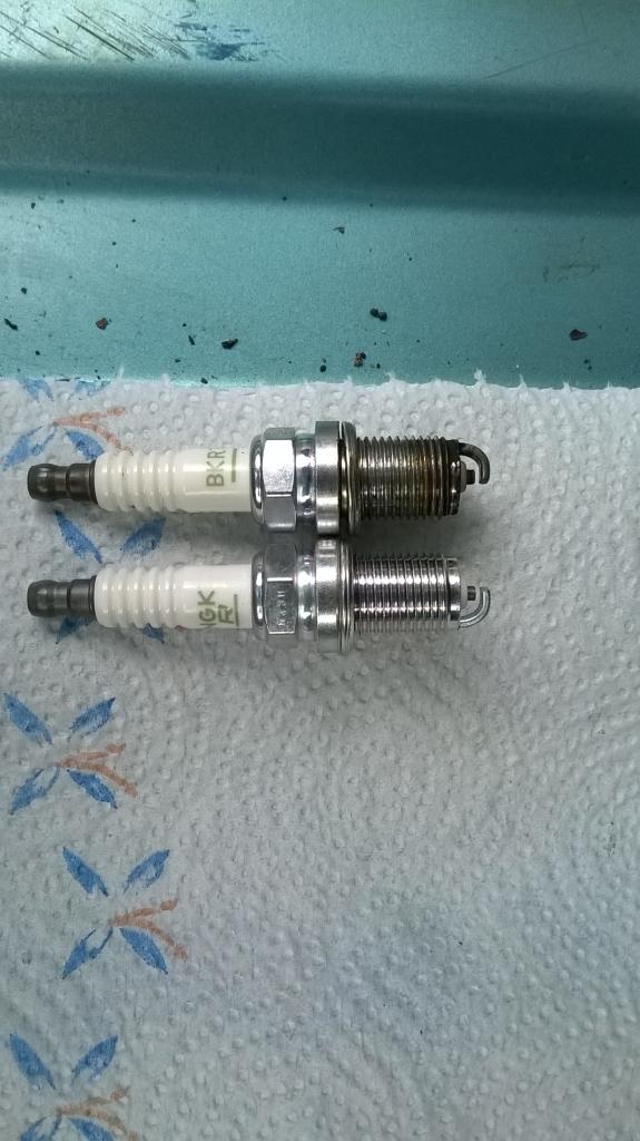

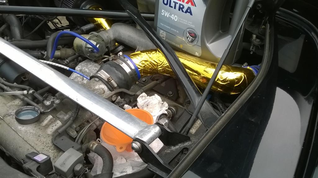

Did a quick service today .
Old oil filter out
New oil filter in
Old oil out
New 5W-40 Shell oil in
And a set of new NGK cold plugs .
Olv vs new

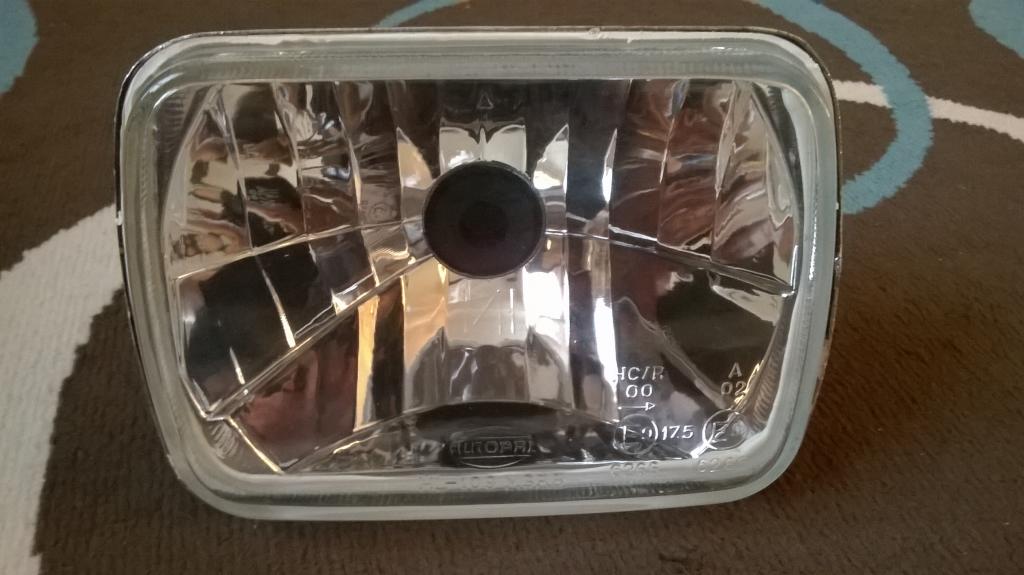

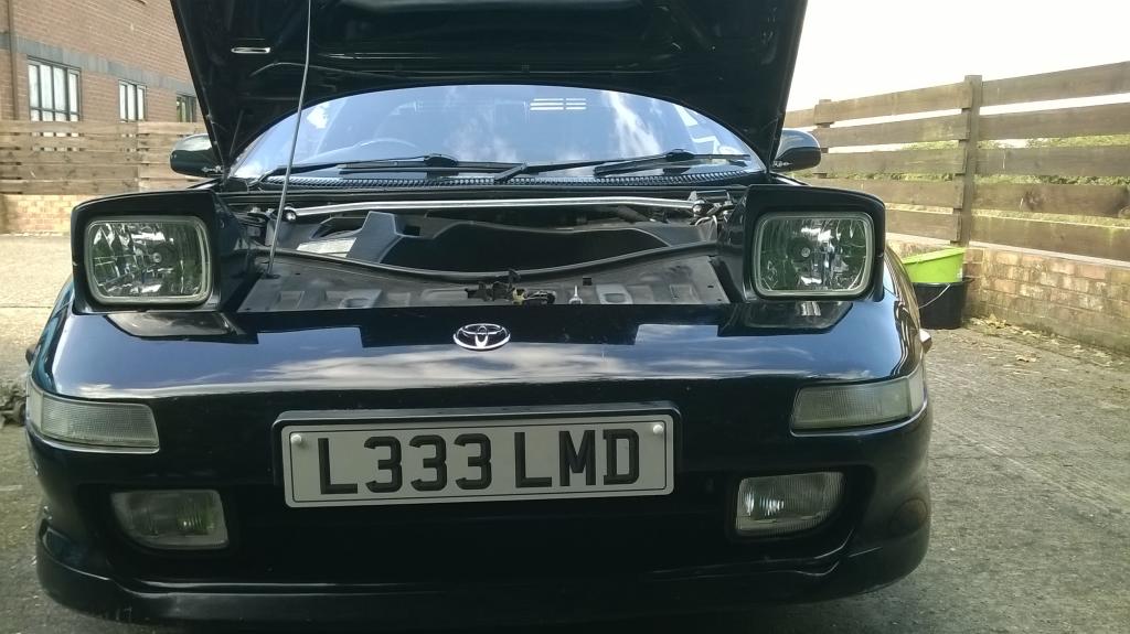

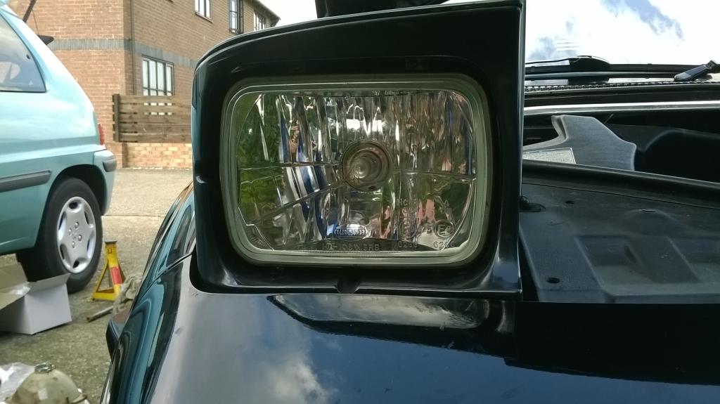

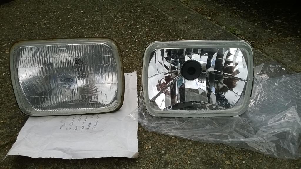

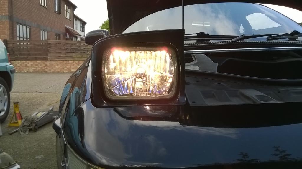

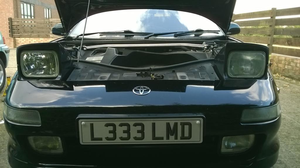

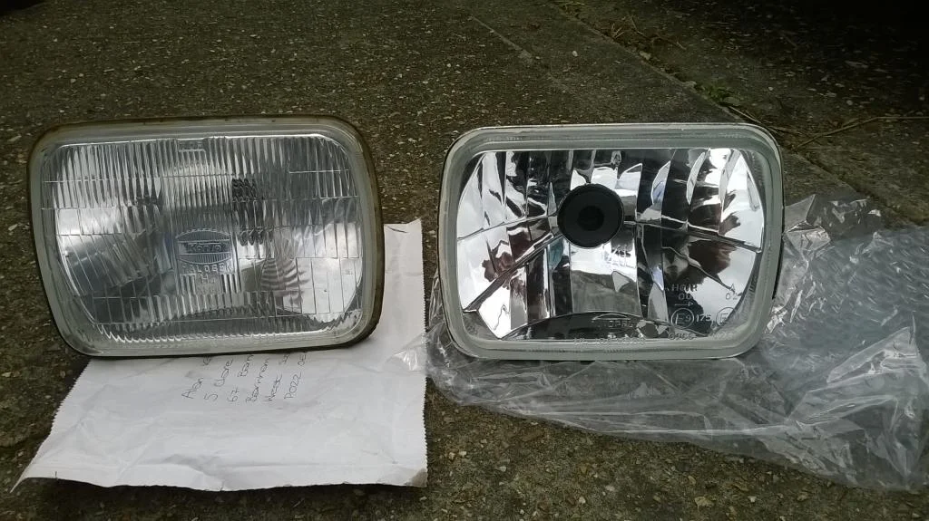

Then had enough time to fit my new clear lens headlights .
old vs new
Old
New
Look much better and and with the Ring xenon gas lamps ( 120 % more light ) there is a big improvement in the light on the road . a longer beem and more light to the side .
Alan
  Fiesta ST Stage 3
Yeah look better but they give around a 30 % more light output due to the reflector and clear lens so not just for the looks as the std lights on the MR2 are sh*t .
Alan
Nice work. Million times better although you never see them..lol

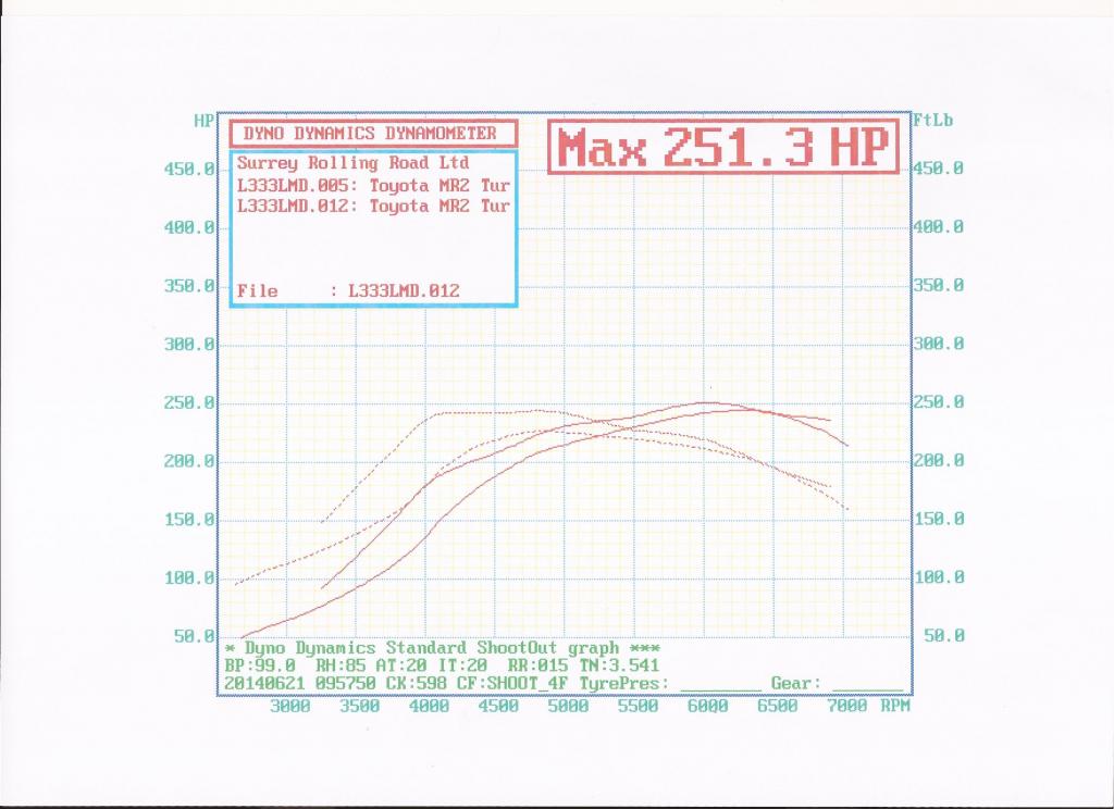

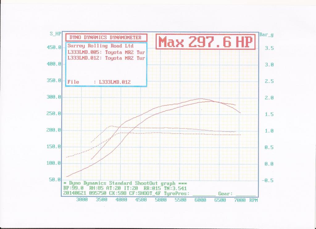

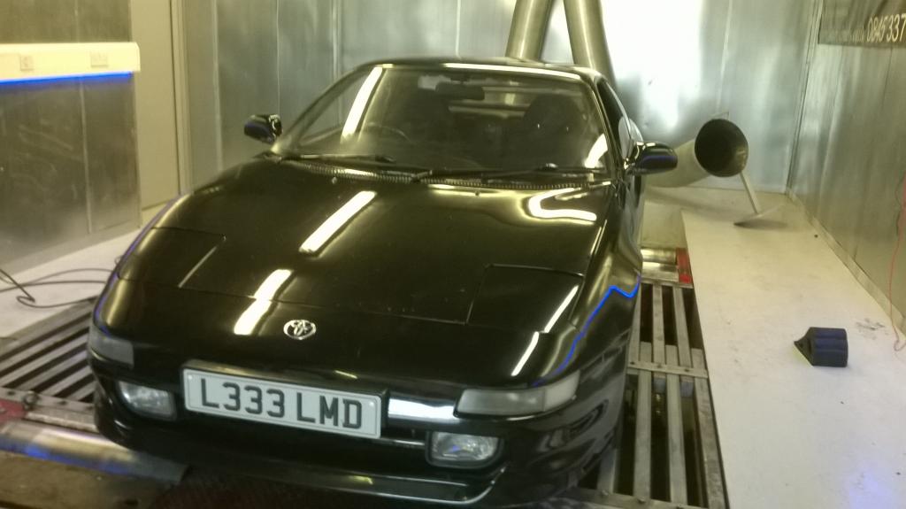

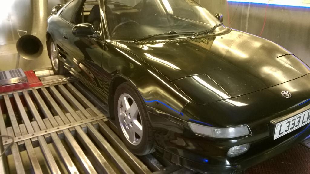

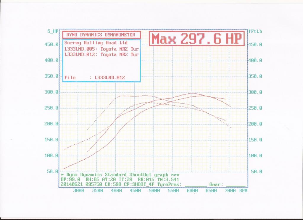

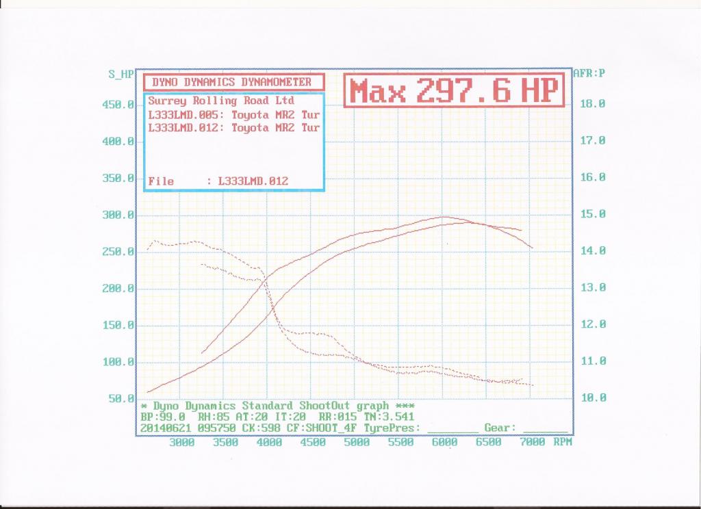

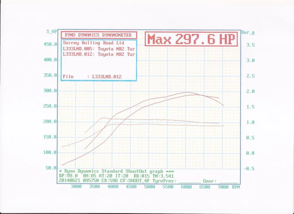

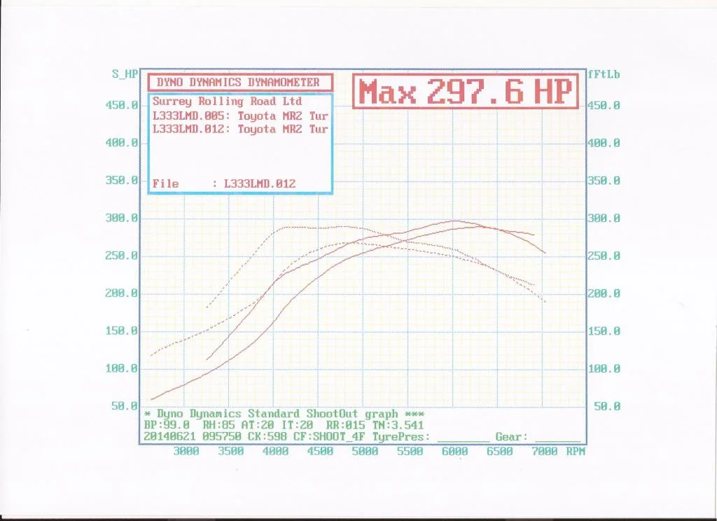

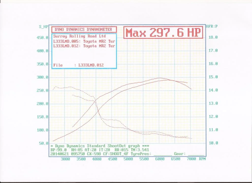

Took the car to Surrey rolling road on Saturday in there new Farnborough address for a run more to check the AFR and boost after turning up the boost last week .
I was the only one booked in after Charlie had a few c
ancelations in the morning so had a good chat about the car and how he was liking the new location .
The run was all done in 23 deg heat ( Charlie said I could have not picked a worst day for a power run LOL ) so will be 5-10 BHP / 5-10 LB/FT more on a less hot day but all was fine withthe AFR and boost that was the main thing .
Also the most gain was made in the mid range @ 4000 RPM with BHP up (48) BHP and Torque up (65) LB/FT
Old graph done at the Cliosport rolling road day in Feb vs new BHP / Torque
Boost in BAR graph
AFR graph
Pic on the rolling road
And a quick vid
The car ran very well in the heat and was spooling up nice and quick . After talking about the AFR and boost Charlie was explaining that the AFR was running very rich at the top end ( all Mr2 turbo do this ) and that he had done quite a few after they have had a Power FC ECU and map ( to sort the fuelling out to run less rich ) that all made around the 350-360 BHP mark .
I may think about this later as the car is quick enough as it is but might be something I come back to after the break and suspension upgrade .
Alan
  Fiesta ST Stage 3
Yes but not at first as I was thinking it would be over 310 BHP and the peak gain was only 8 BHP but the heat was robbing a fair few BHP and the torque and every where in the graph apart from the peak was up a nice bit .
Looking at 4000 rpm only it was on the old set up 160 BHP now 220 BHP (+ 60 BHP) and 210 LB/FT now 280 LB/FT (+ 70 LB/FT)
So yes very happy with that but want to put it back on the rollers when the temps come down a bit to see what she makes then .
