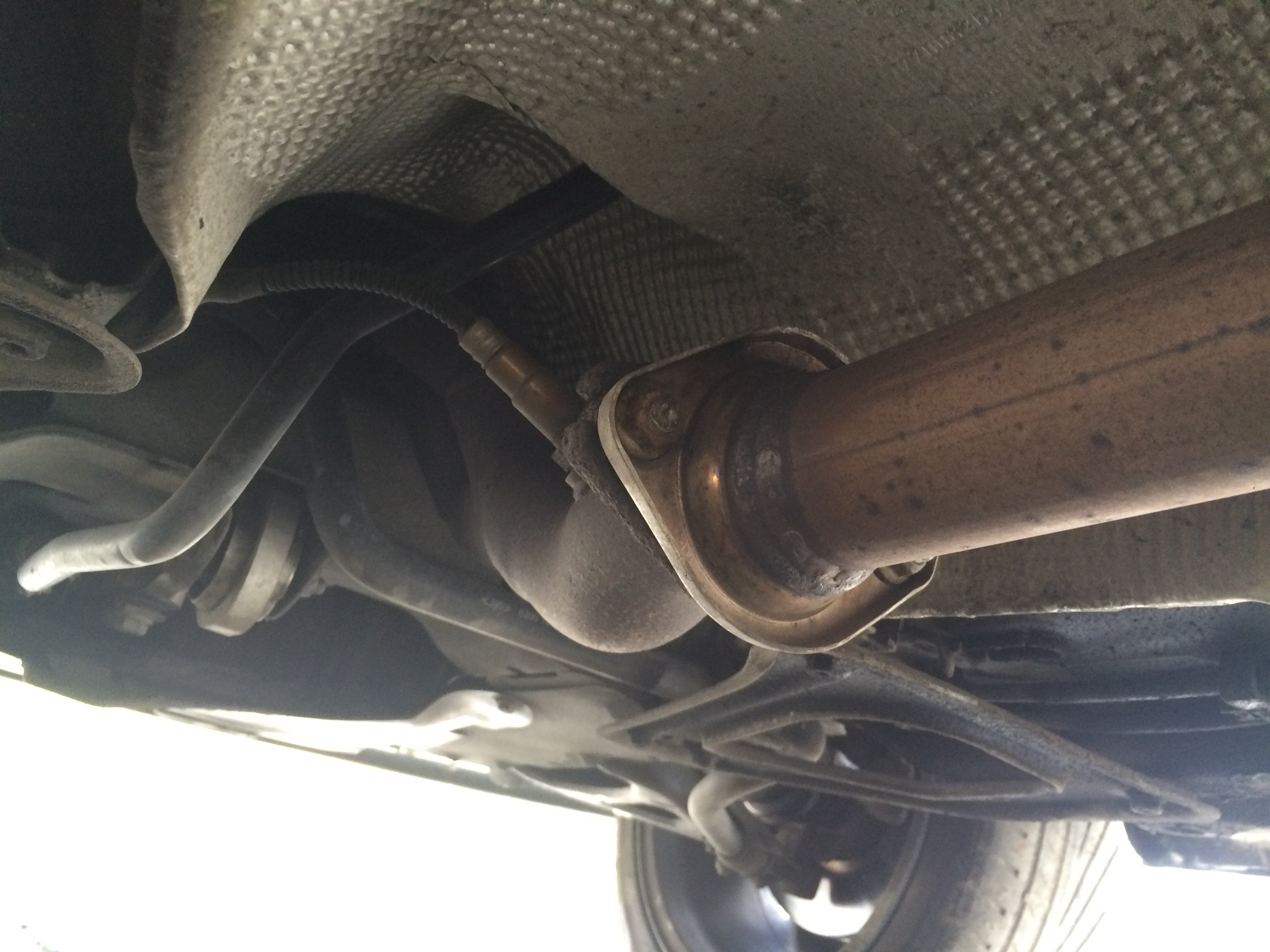

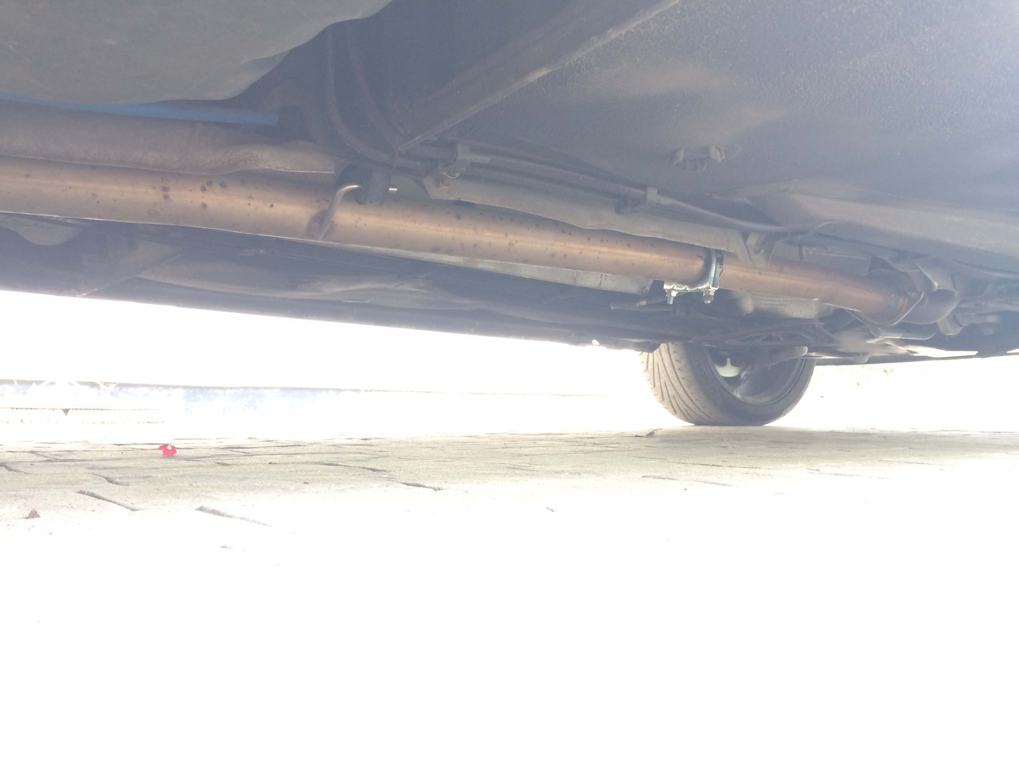

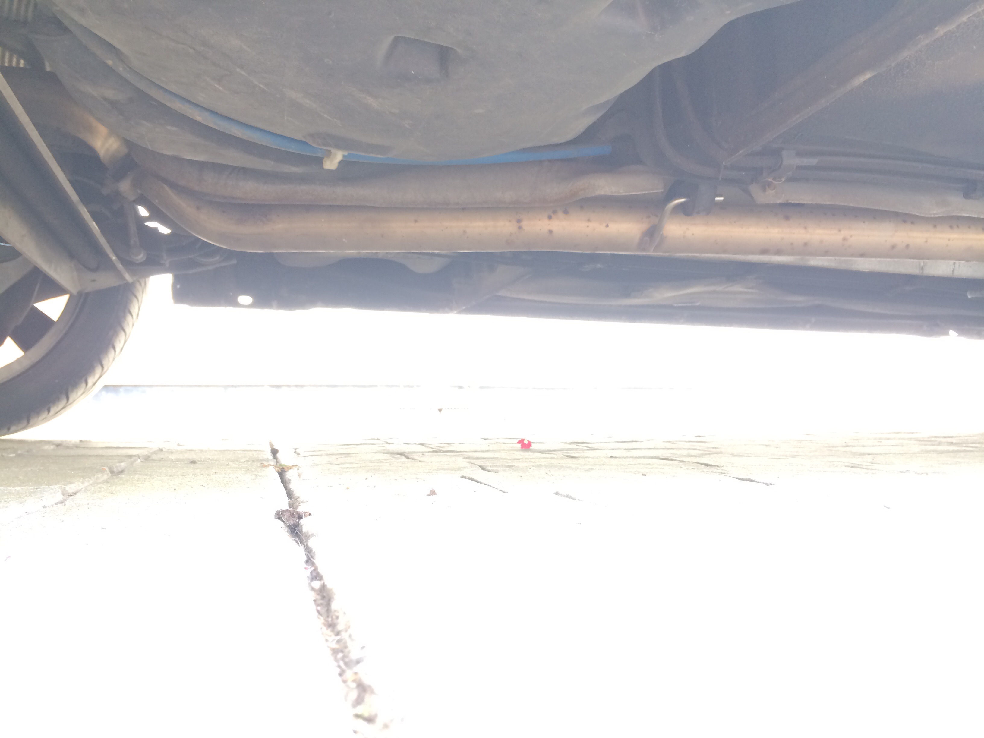

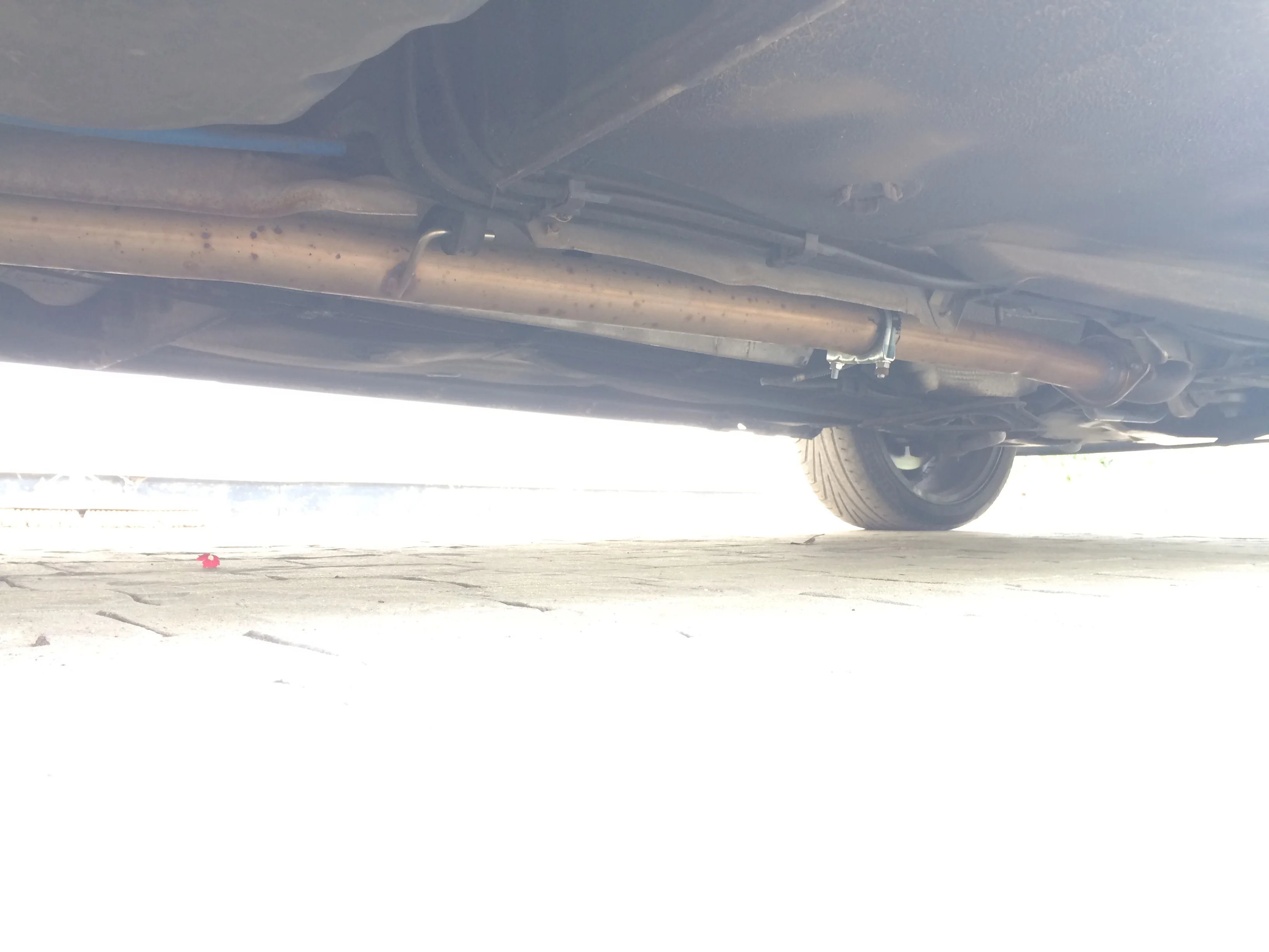

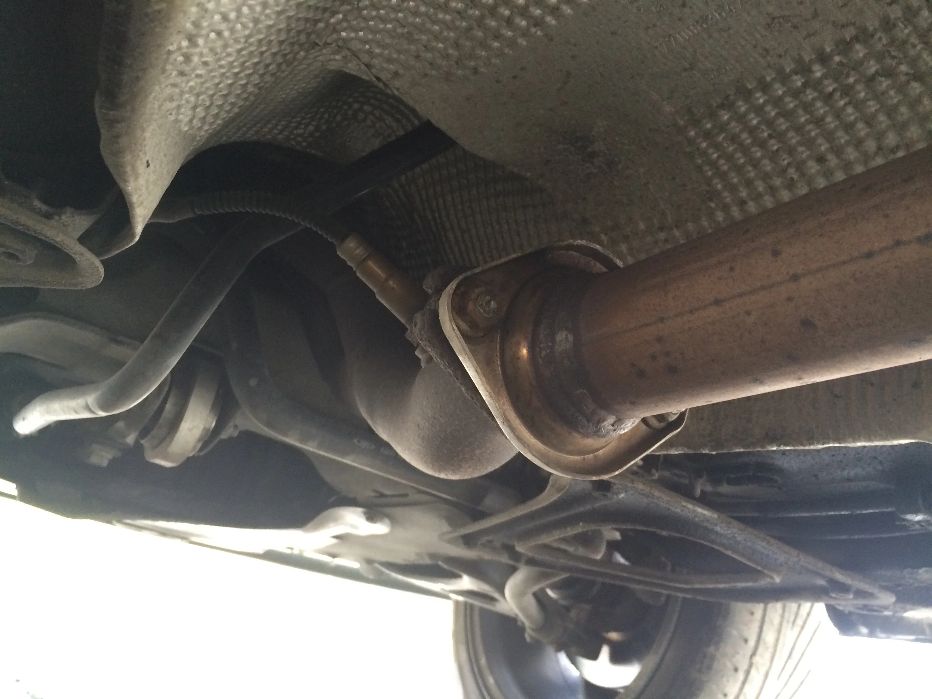

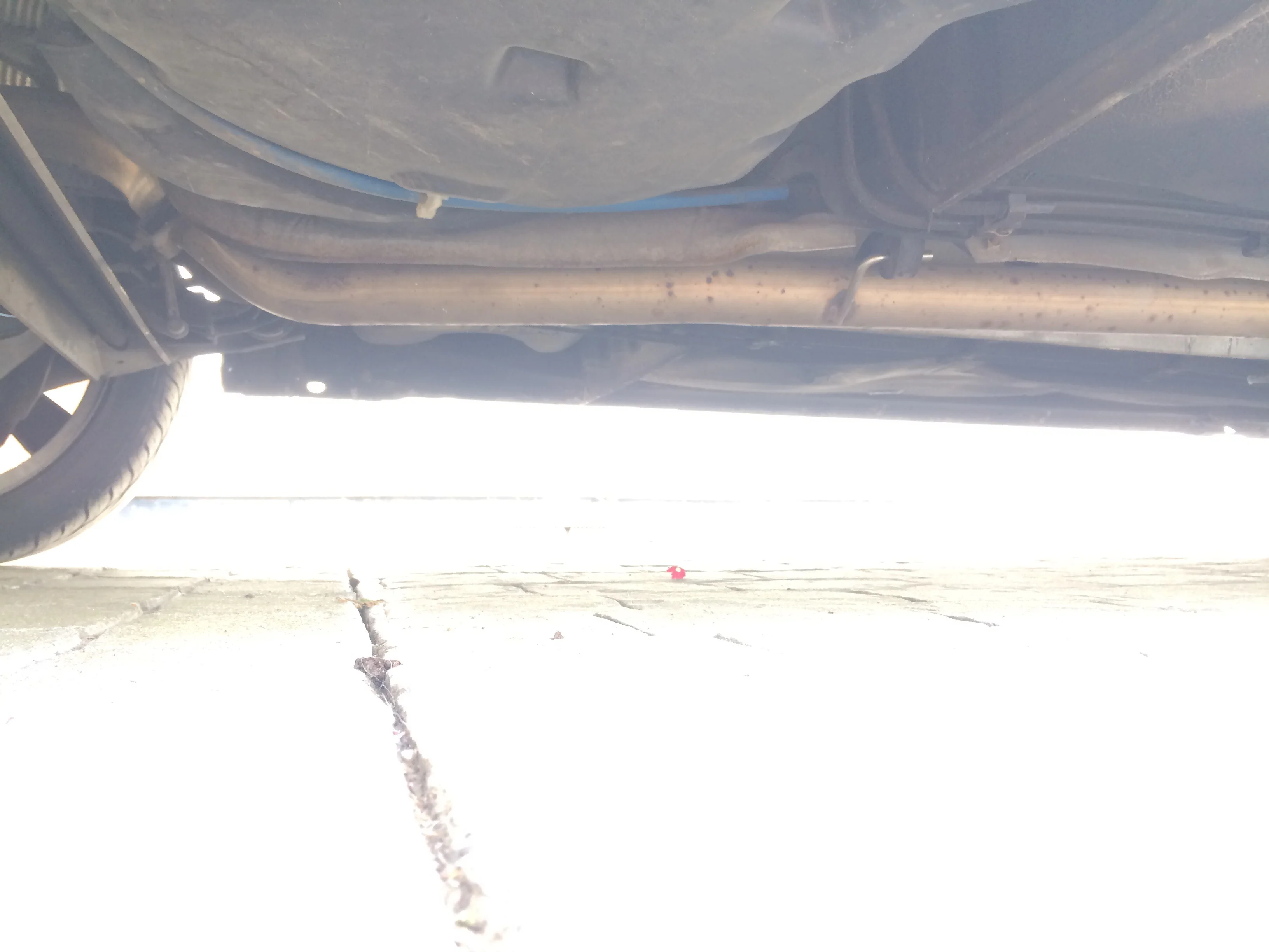

I don't have a centre section as such, just a straight 2.25" pipe from the decat (currently) to the backbox with no joins, so it would be a case of cutting that up to fit a mid section
Here's a photo of the current system :

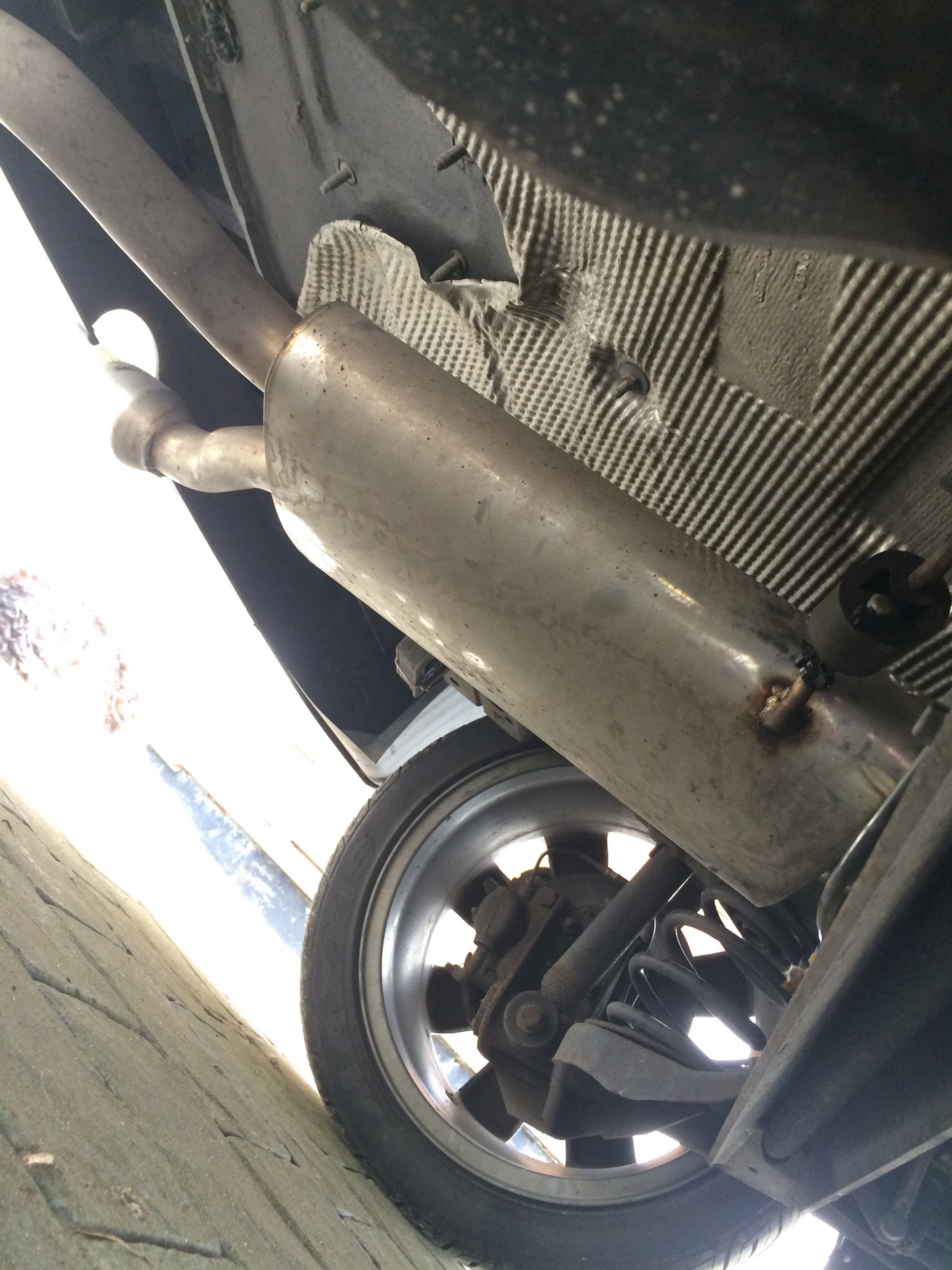

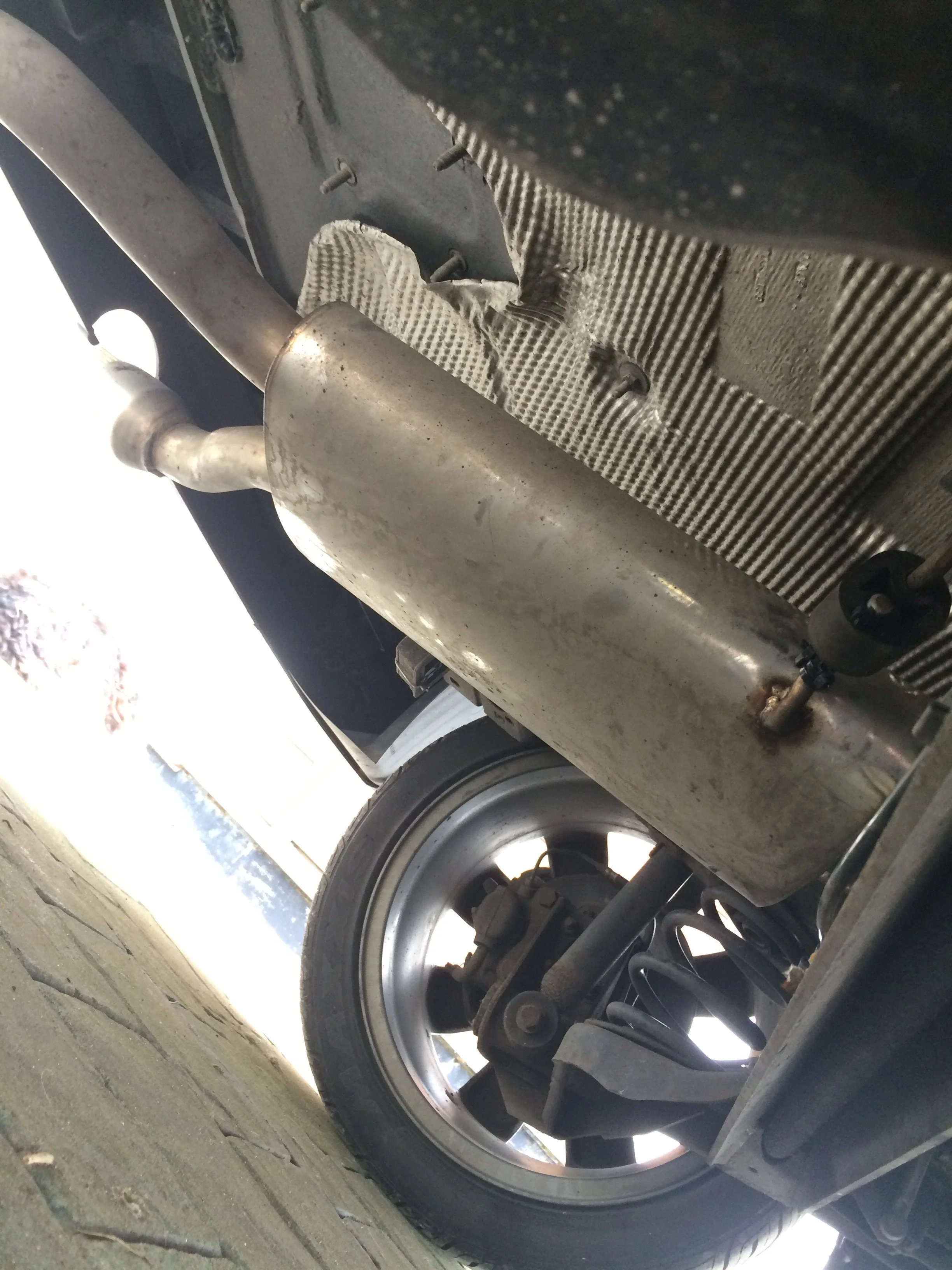

The exhaust is sagging abit too, but I'm not sure if this exhaust used the standard mounts?
I'll try get some better photos of the backbox and see
the cat doesn't hang off any mounts, best bet would be to get a cheap used one off here and have flanged welded on your system. No benefit decating these, may as well make it easier at mot time by having one, and it will quieten your system
Sorry I should of made it clearer - I meant the backbox is sagging a little low, so the backbox mounts
