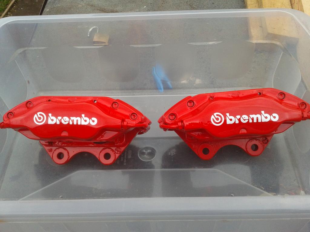

Are these aluminium brackets a safe way to mount callipers?
If made correctly yes, and im sure the pure ones are.
Dont forget most of the 4 pot and 6 pot calipers are aluminium anyway, the bracket doesnt need to be any stronger than the mounting point on the caliper.
All depends on the type of aluminium you use and the thickness. These are realy good and strong.
Because the bracket is rather big an thick it should have no problem at all.
As i said, it already survived several trackdays :p
They've already seen a world of hurt there ;)

Have you fitted the brembos yet? Any good/problems?
Have to get some other grease on the pads so they squeek a bit but other than that works like a charm :cool:
Just a small note, the 300mm discs are a tight tight fit so you can here some scrubbing for the first few miles.
My brembos haven't turned up yet and I need to figure out how big the spacers are that I will need for 182 cup wheels. Could be a while yet.
Looking good smokey!! When you say scrubbing where abouts are they scrubbing?
My calipers are all painted up and ready to fit, George if my brackets eventually turn up and you haven't sorted spacer sizes i will get a 182 wheel out the shed and measure up for you.
Note to anyone looking for these calipers. Go on ebay and message every person who is breaking a 406 v6. You may drop lucky (find un educated person) and get a very good condition pair £50 ;)
The scrubbing is due to the disc expanding a bit when its hot wich makes the disc touch the caliper a tad.
It will solve itself realy easy but just so you guys know.
