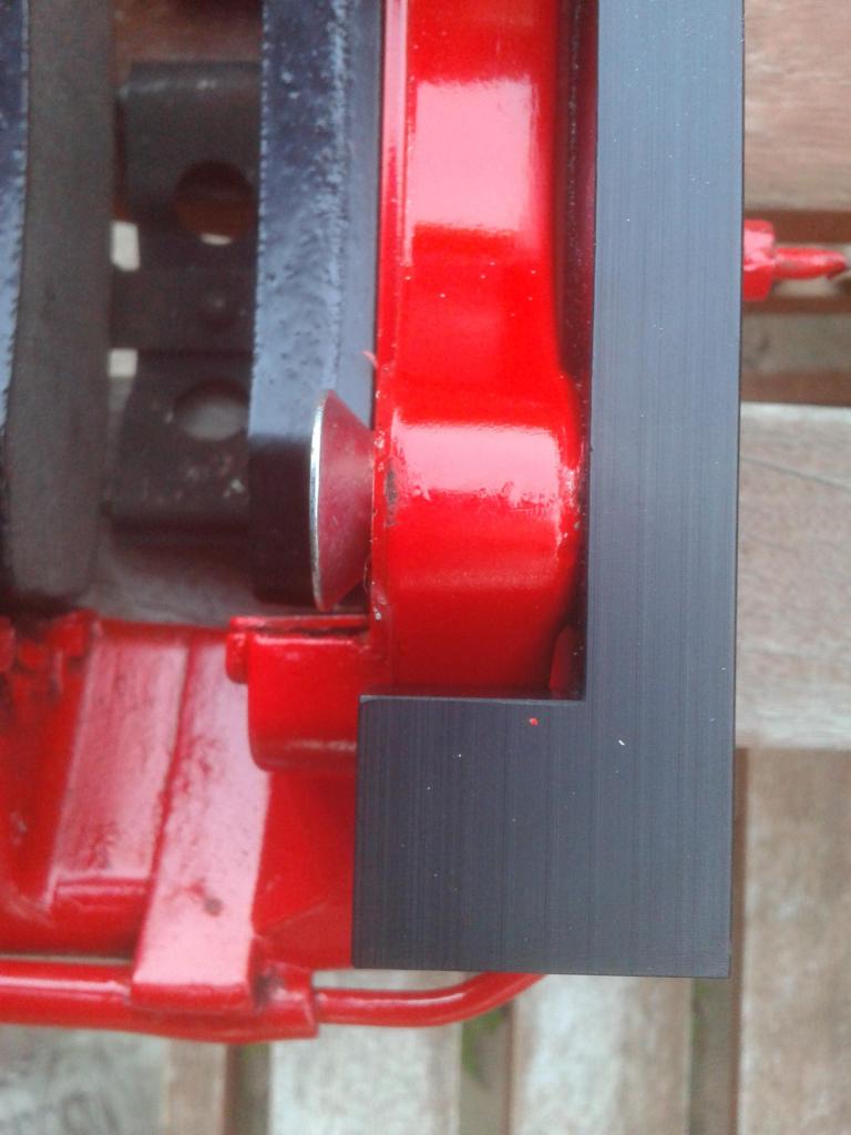

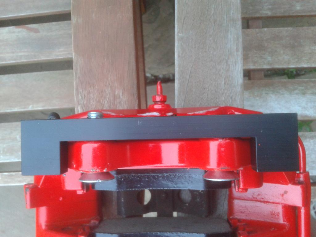

Brackets have now arrived( a month late) and its a great bit of cnc work the bracket.
BUT (make note if you are going to purchase some) the rest is a shower of s**t!!!!! There are four m12 set screws to bolt the bracket to the caliper which are a mis mash of lengths!! And to make it worse the underside of the head on the set screw is 45° chamfered so when you try and bolt the assembley to the hub the heads foul the caliper mounting lugs on the hubs.
So its been a big no go on fitting as i need flush fitting set screws to make them fit. Oh and you only get two bracket to hub bolts!! Well i did.
Shall try and get pics later.
