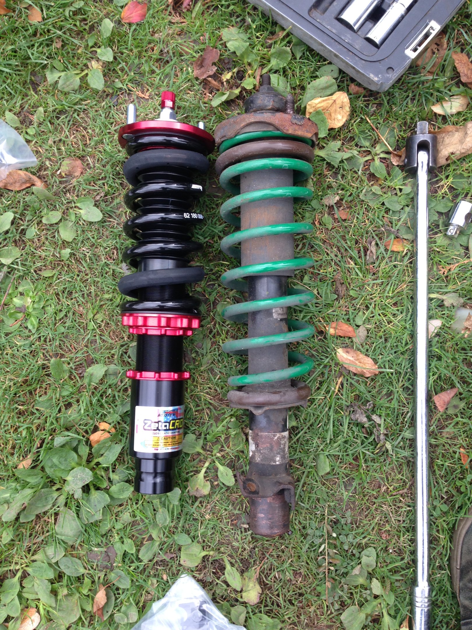

Update!

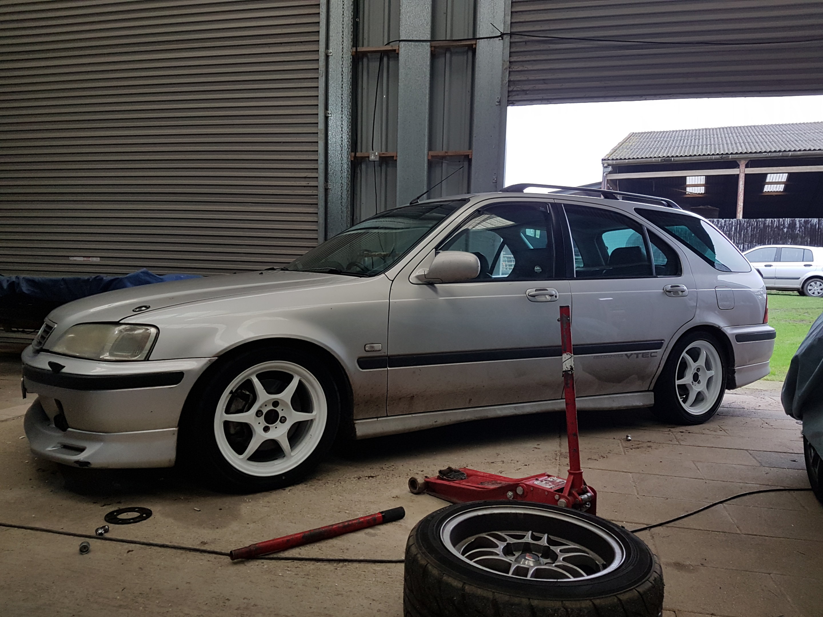

Got the miesterR coilovers fitted, car now actually handles reasonably well, no Clio but then it is an estate car
Can't believe how comfy they are for coilovers, got them maxed out on the damping and the ride is still lovely.
Also tried some Clio wheels which I'm going to do once the tyres are shot on the current set. Will make it look a little more subtle which I like..
The wheels I tried have the wrong tyres, 195 not 205 and they're shot so they look a little small for the car but once they've got the wider tyres on and around 10-15mm spacers should be perfect!

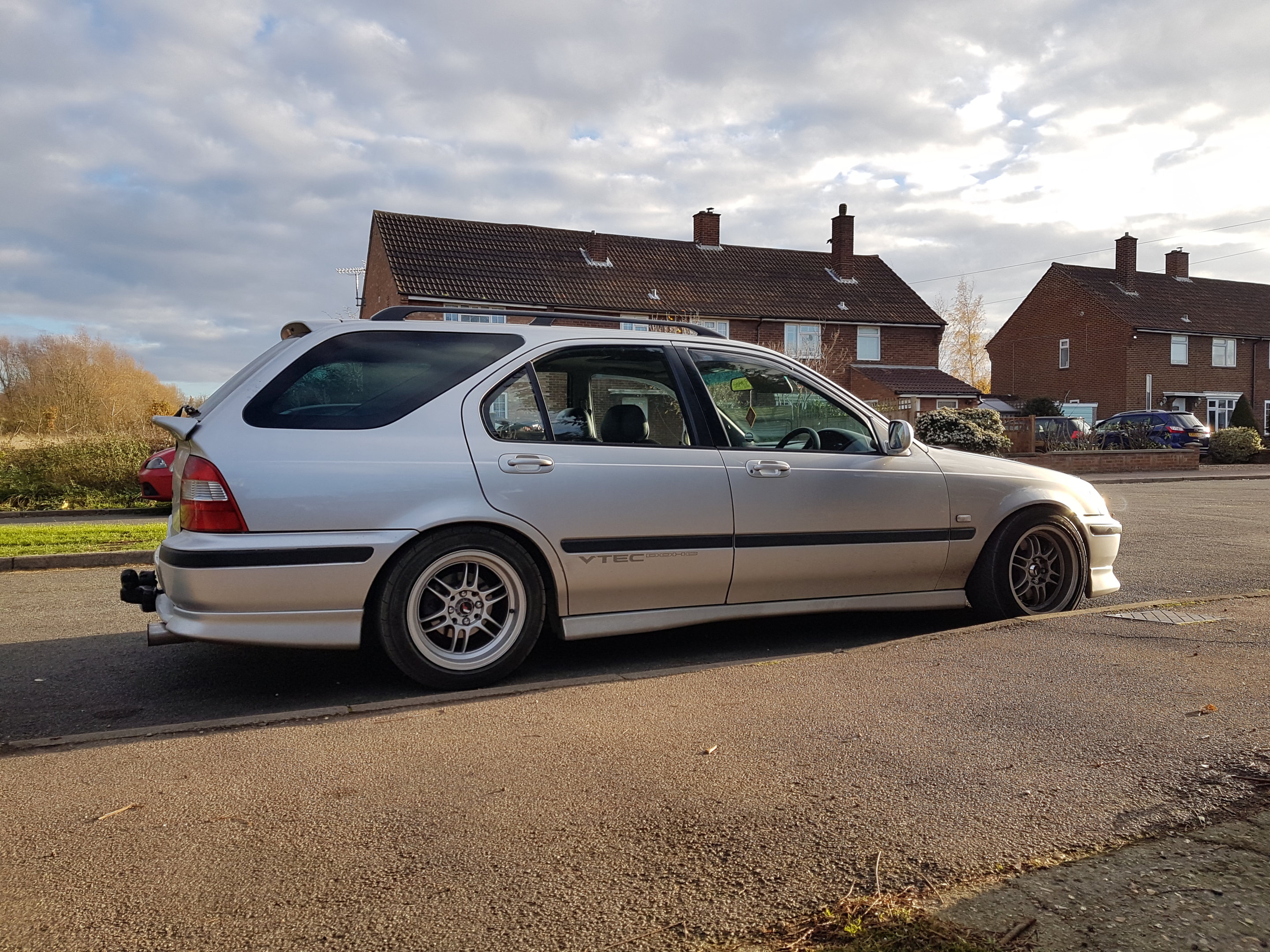

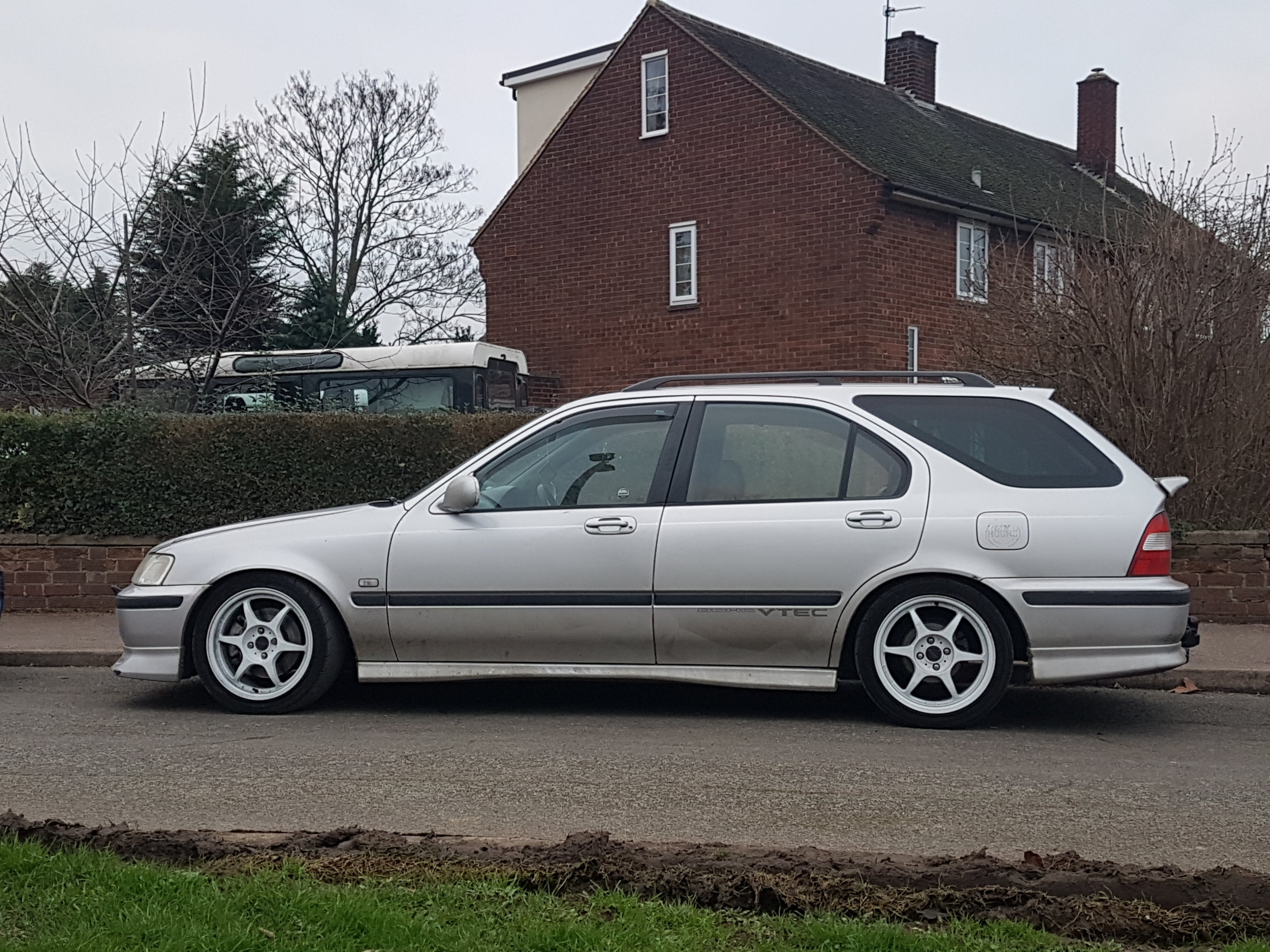

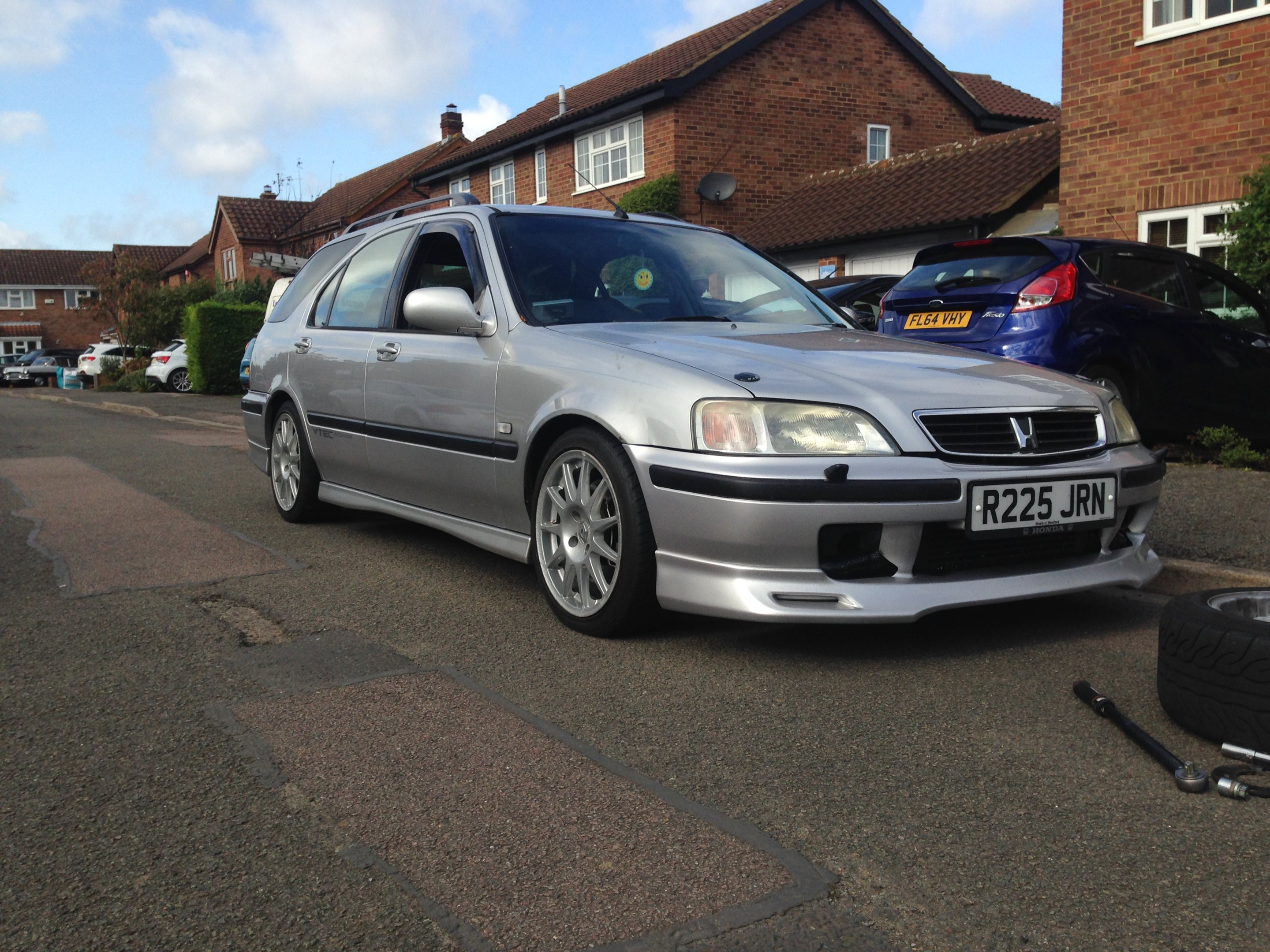

Cars much lower of the coilovers now, its very dirty atm but got a picture of how it sits now anyway..

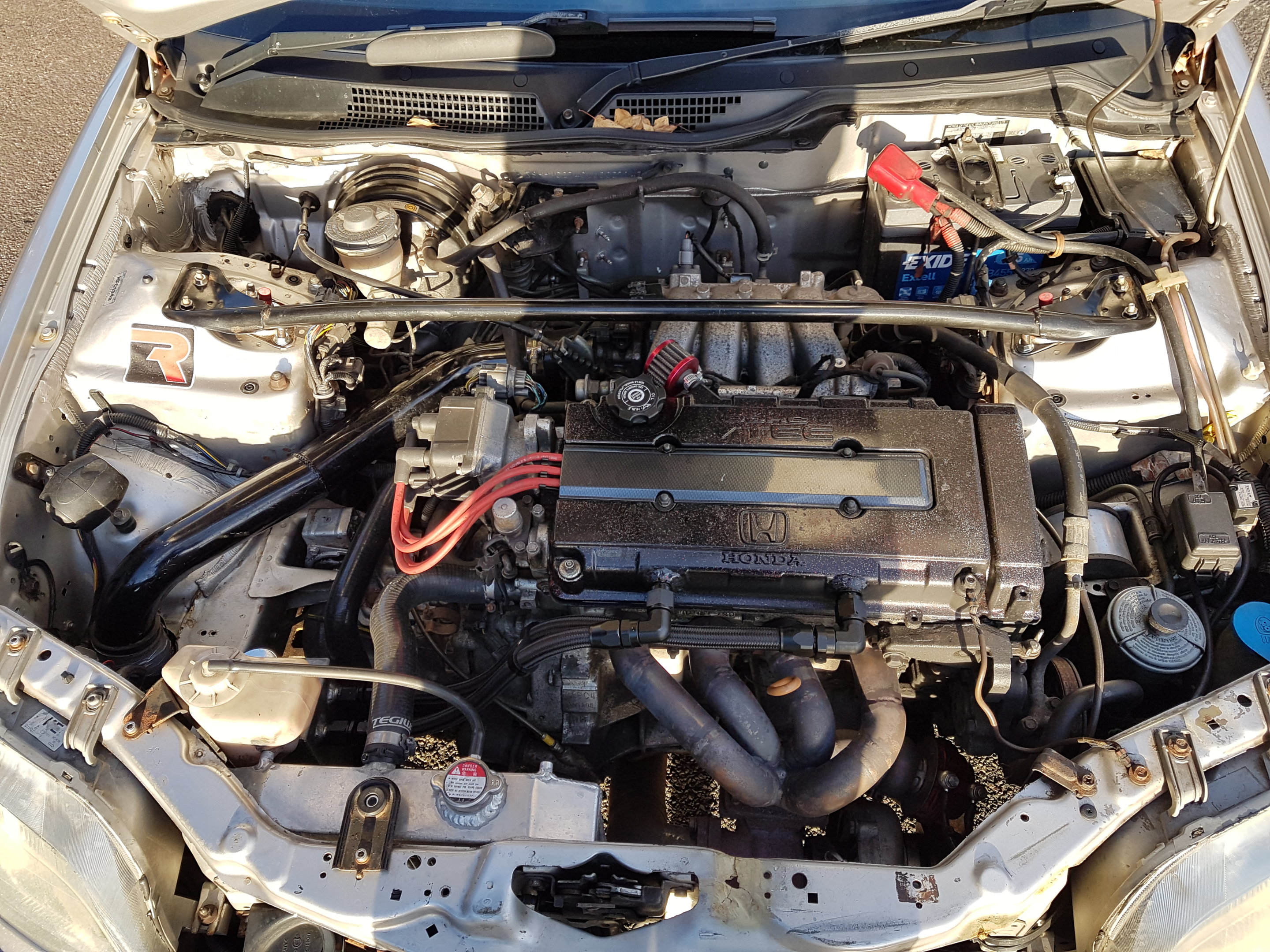

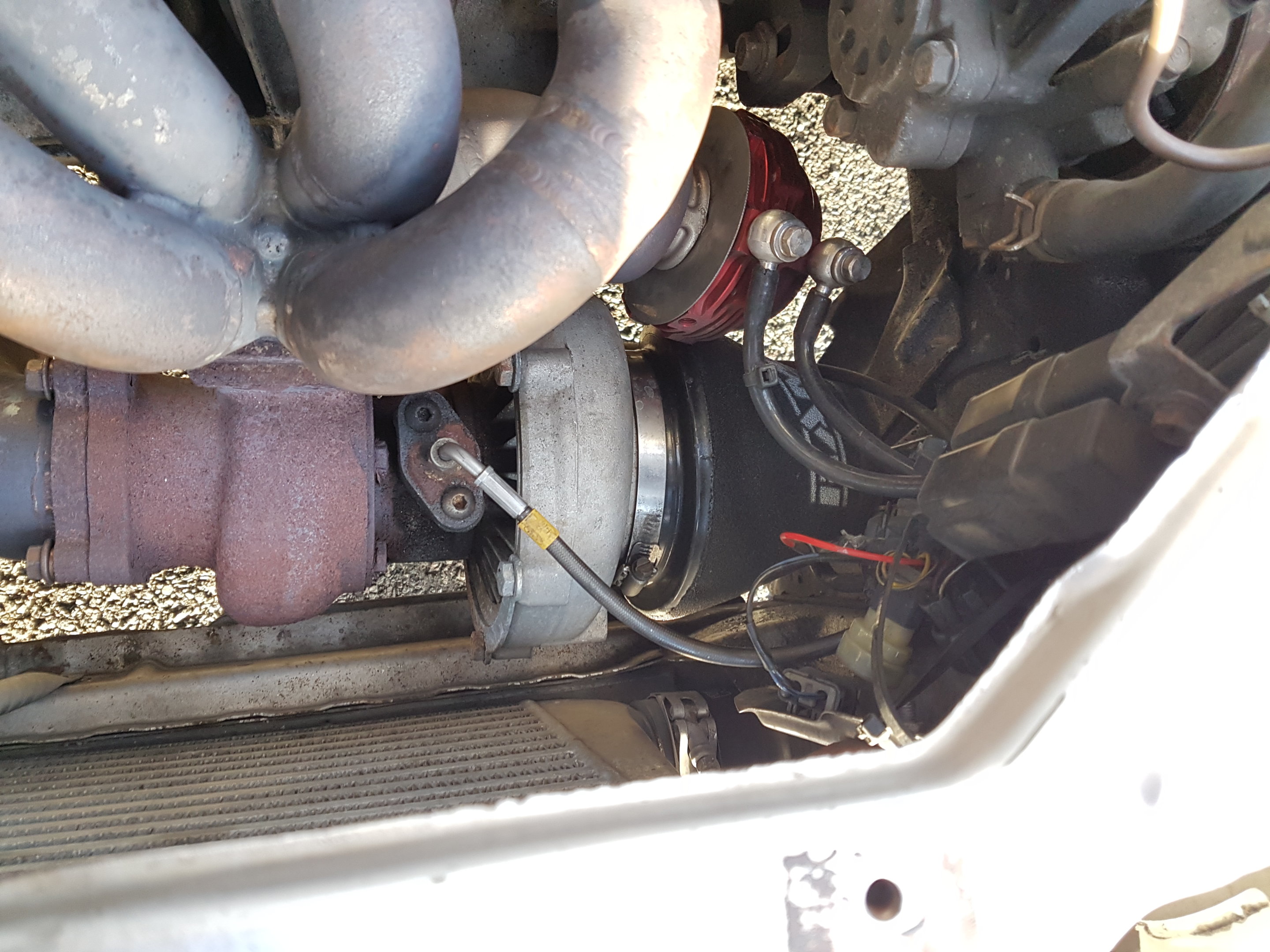

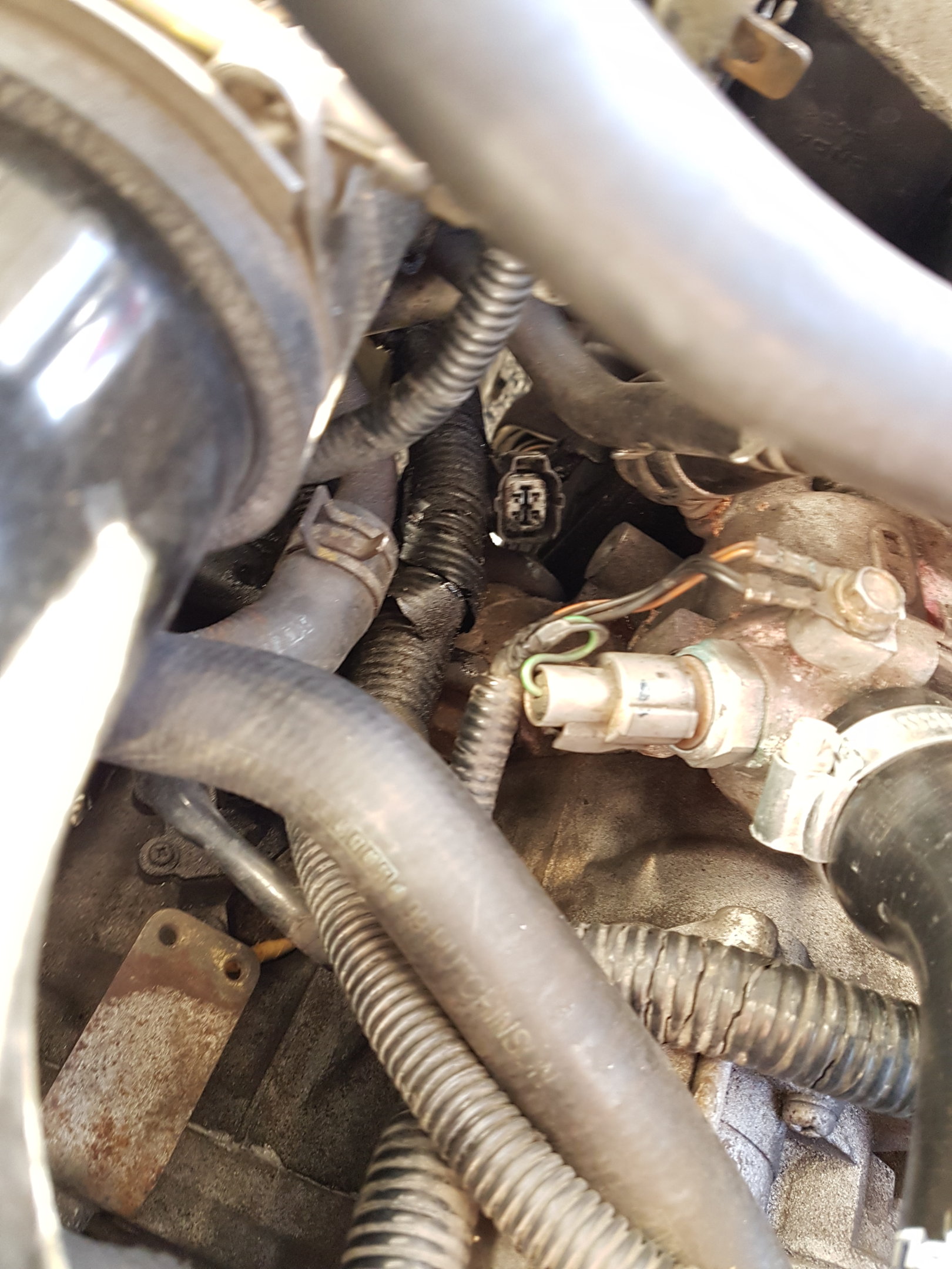

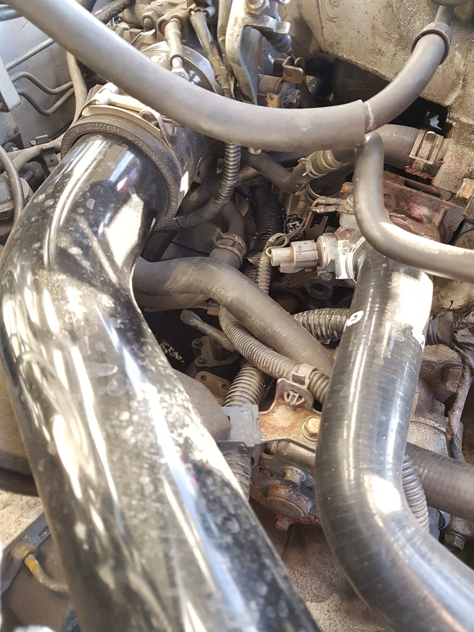

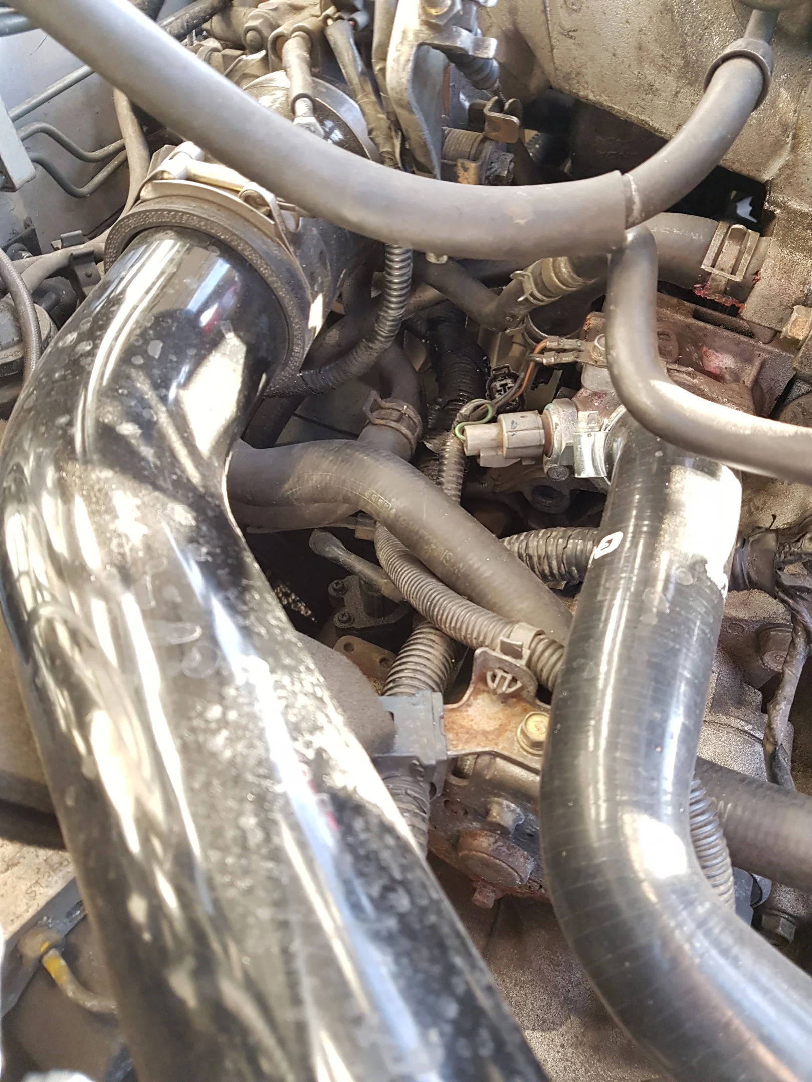

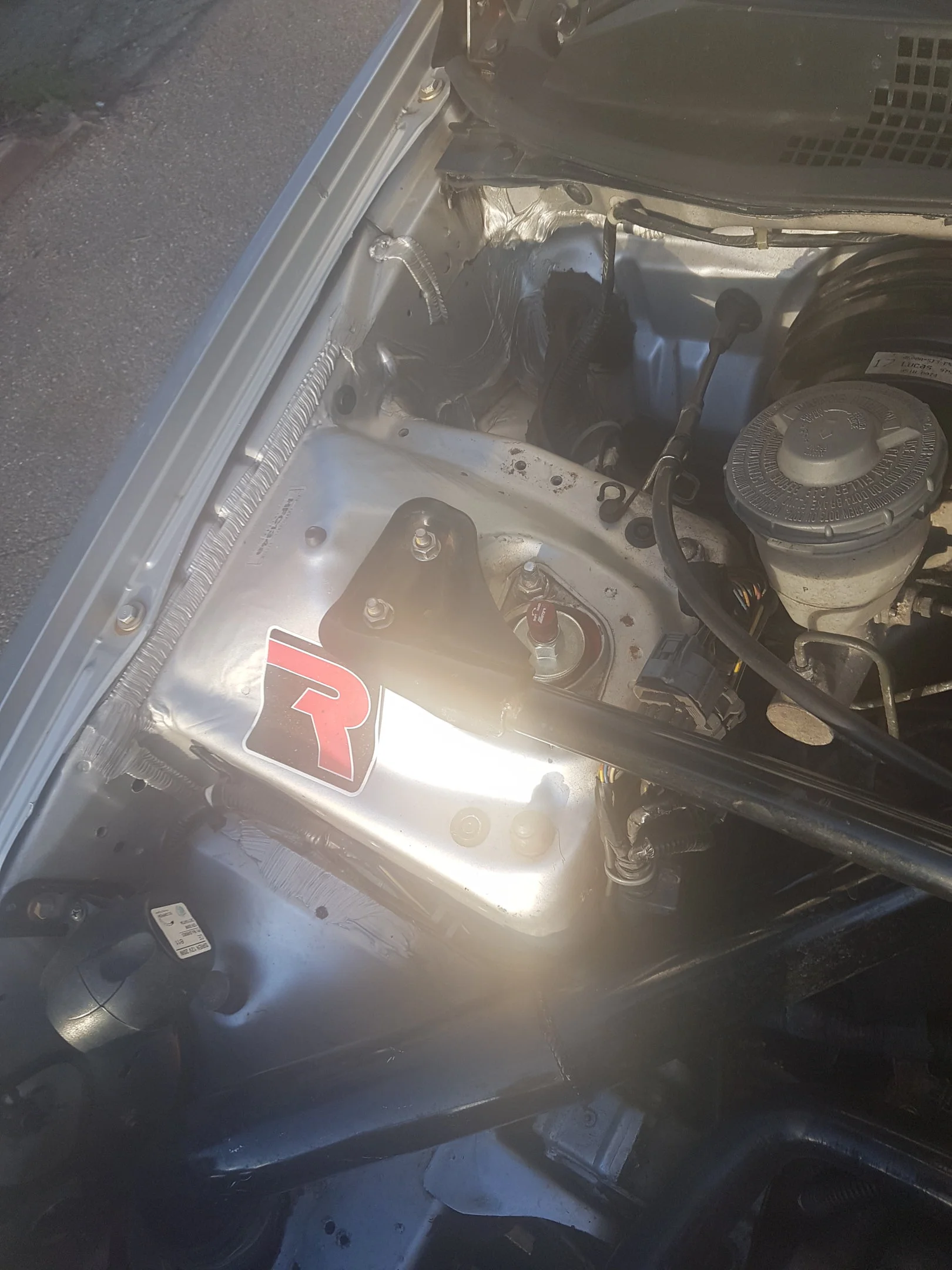

Coming across a few issues with the car now, firstly there is no oxygen sensor which I think is one of the reasons the fuel consumption is so poor atm, going to get a bung welded into the exhaust and refit a standard sensor, am I right in thinking this plug is the one for the oxygen sensor? @AdDaMan @Rojer it sits just below the inlet?
The car is also starting to over boost slightly, (low boost is 0.8 bar and it's getting to 0.87 now) so just going to take it easy untill I get a new external wastegate for it, pretty sure it's just a cheap ebay one atm so will be upgrading to a tidal one most likely.. Also going to fit the new turbo that came with the car as there is a bit of play in the current one and the car does smoke a little when on boost.. (ebay turbo has done well to last 30k miles to be fair) and then I'll take a trip to ricky at race tech to get the map checked and adjusted

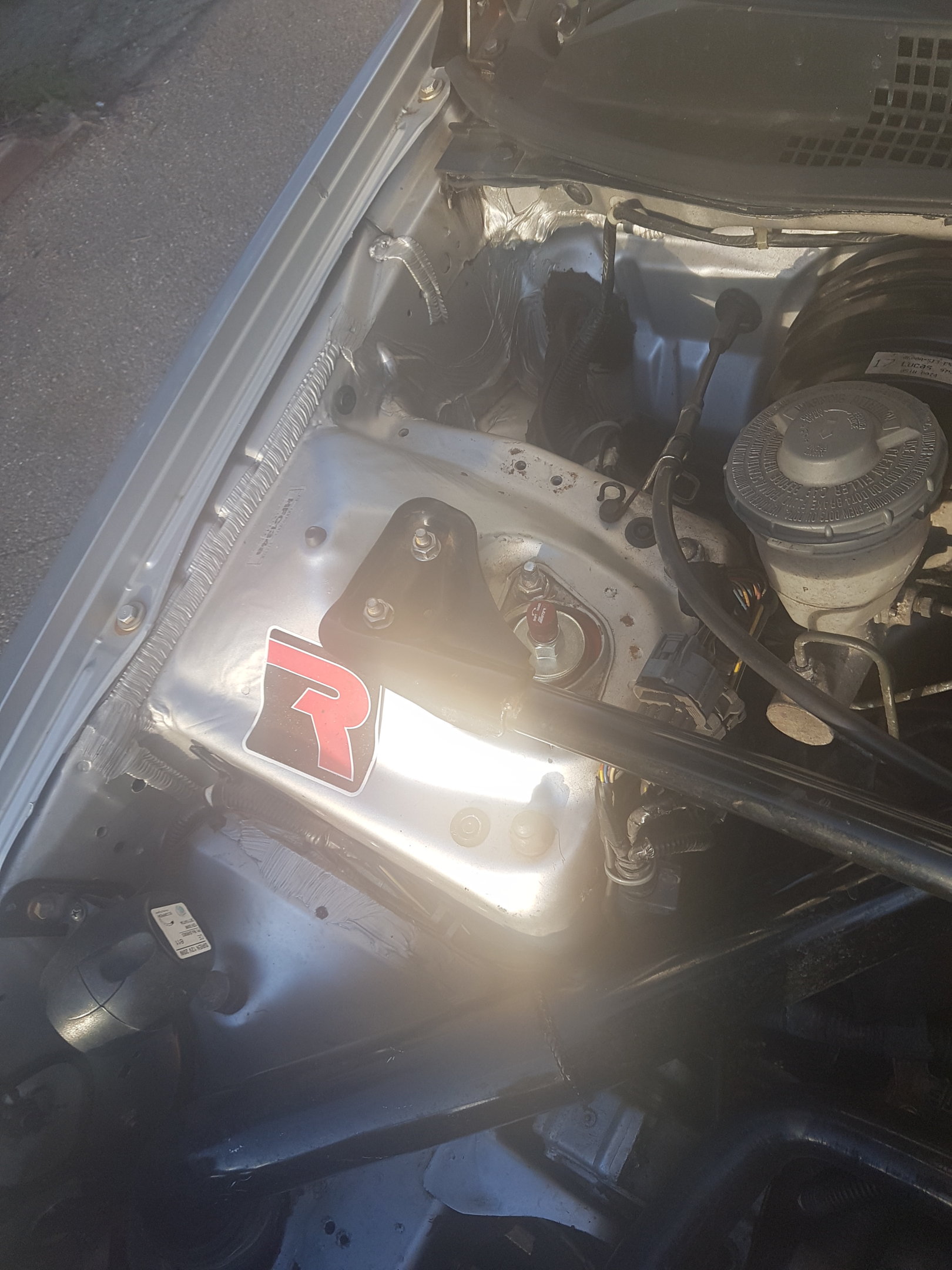

Few pics of the engine bay which I'm going on tidy up soon also!

Overboost may well be caused by denser air, if you have boost controller turn it down by 0.1bar to compensate. If it's wastegate reducing boost will make no difference.
robmuns
  Ph1 172
Will try that! Cheers
AdDaMan
There is a plug down there that’s always empty but that could be the o2 sensor. Doubt that’s your problem though as you have aftermarket ecu I’m guessing? What’s on there? Just a P28? I have put a wideband on mine so no need for the standard o2.
Yeah Its a socketed P28 as far as I know, with an apexi boost controller , wasn't expecting fuel consumption to be great but without an oxygen sensor I'm guessing it's on a set map all the time and not making any adjustments when on part throttle or cruise, might gain me a few mpg getting it working again if it's possible.. Going to fit my innovate wideband sensor anyway so I can keep an eye on things, especially on boost as I have no idea what it's like atm.. Anything I can do to see what ecu it's got exsactly? as I'm only taking the word of the person that built it atm lol
AdDaMan
Yeah just take the lid off the ECU and take a photo of inside. I have Hondata S300 v3 on mine with ECU controlled boost solenoid. Rock steady.
Rojer
Im pretty sure the O2 sensor should be plugged in. Do you see the plug for it on the loom? The previous owner probably unplugged. Better to have wideband as mentioned anyway.

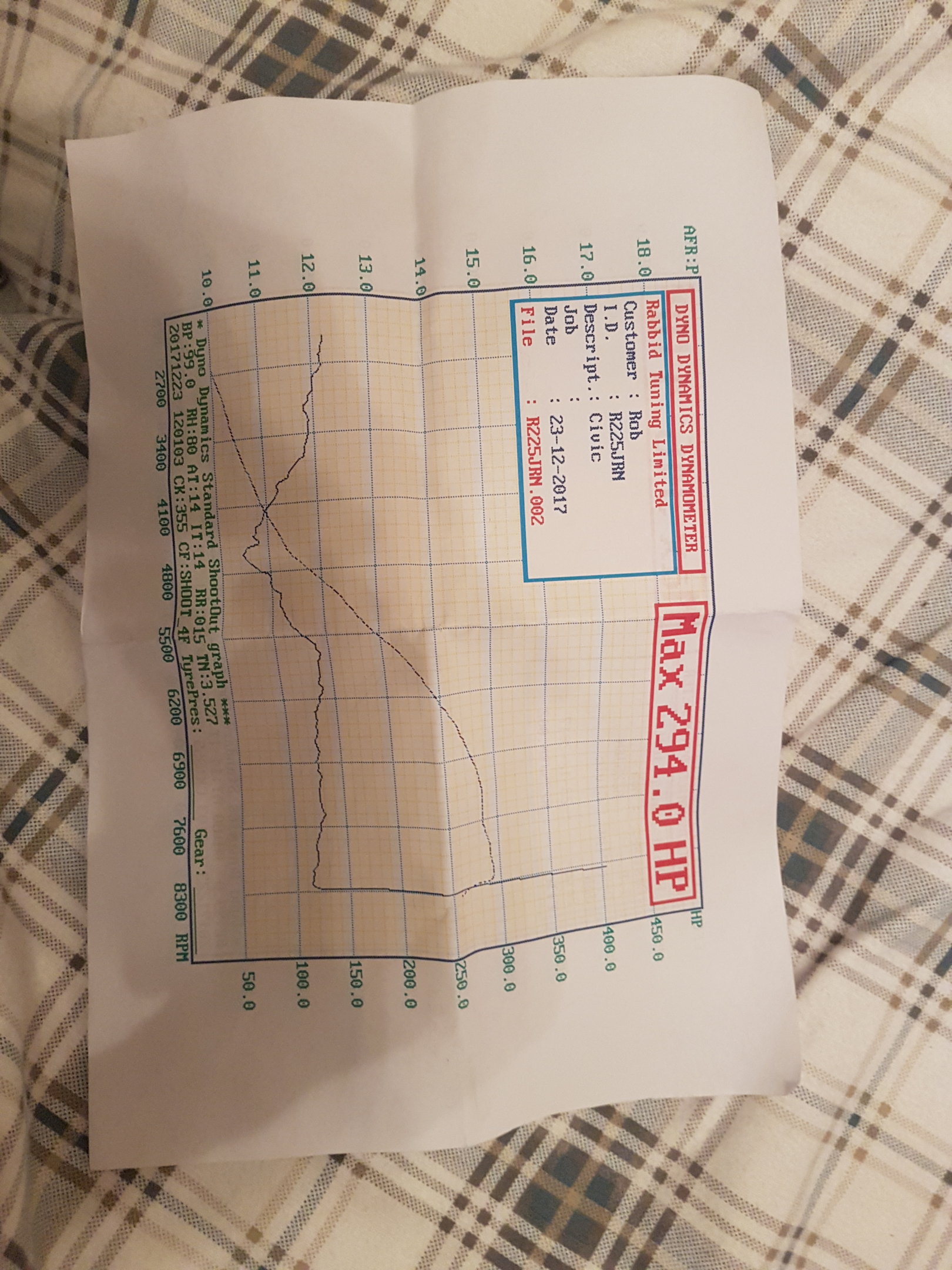

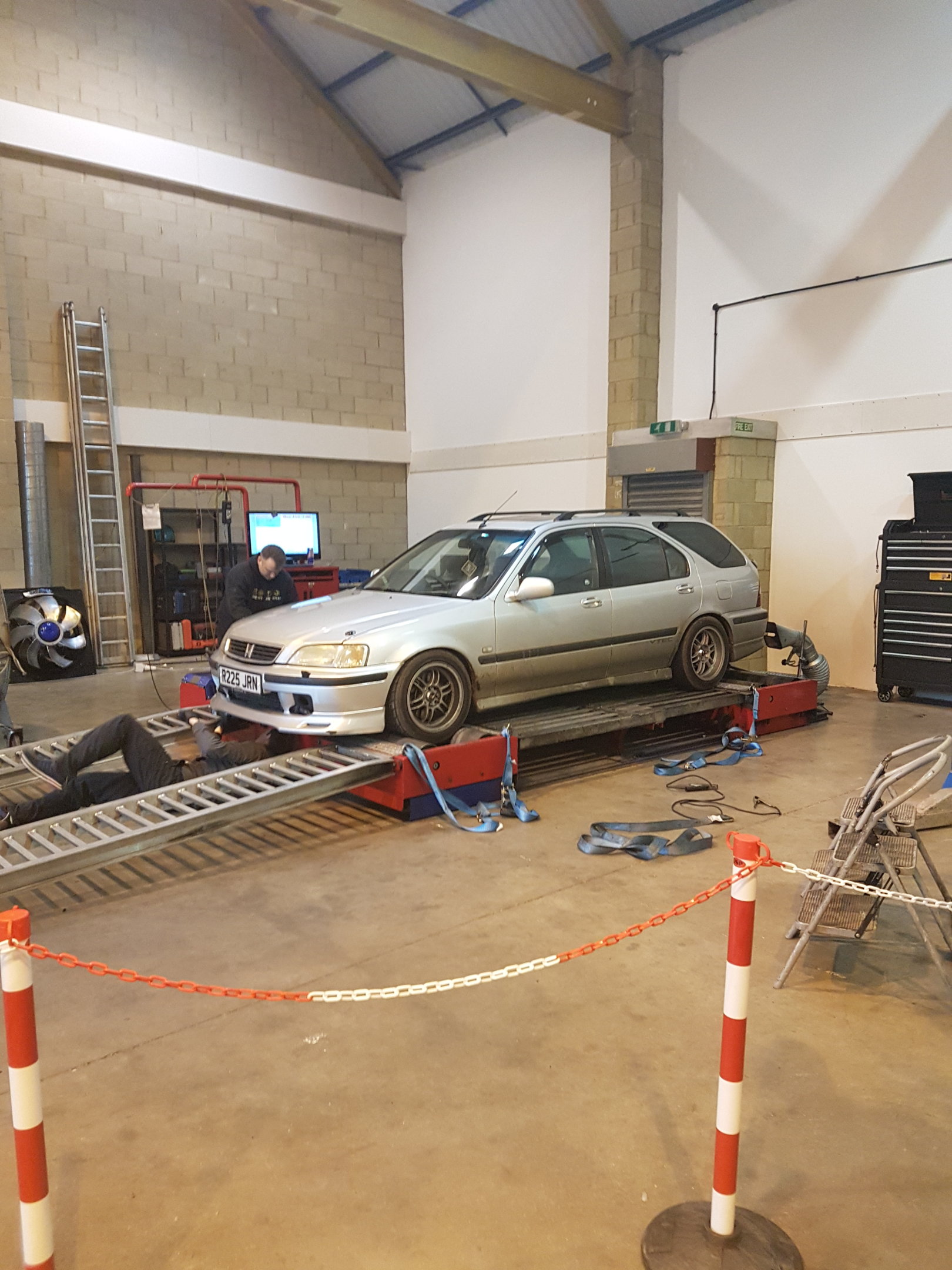

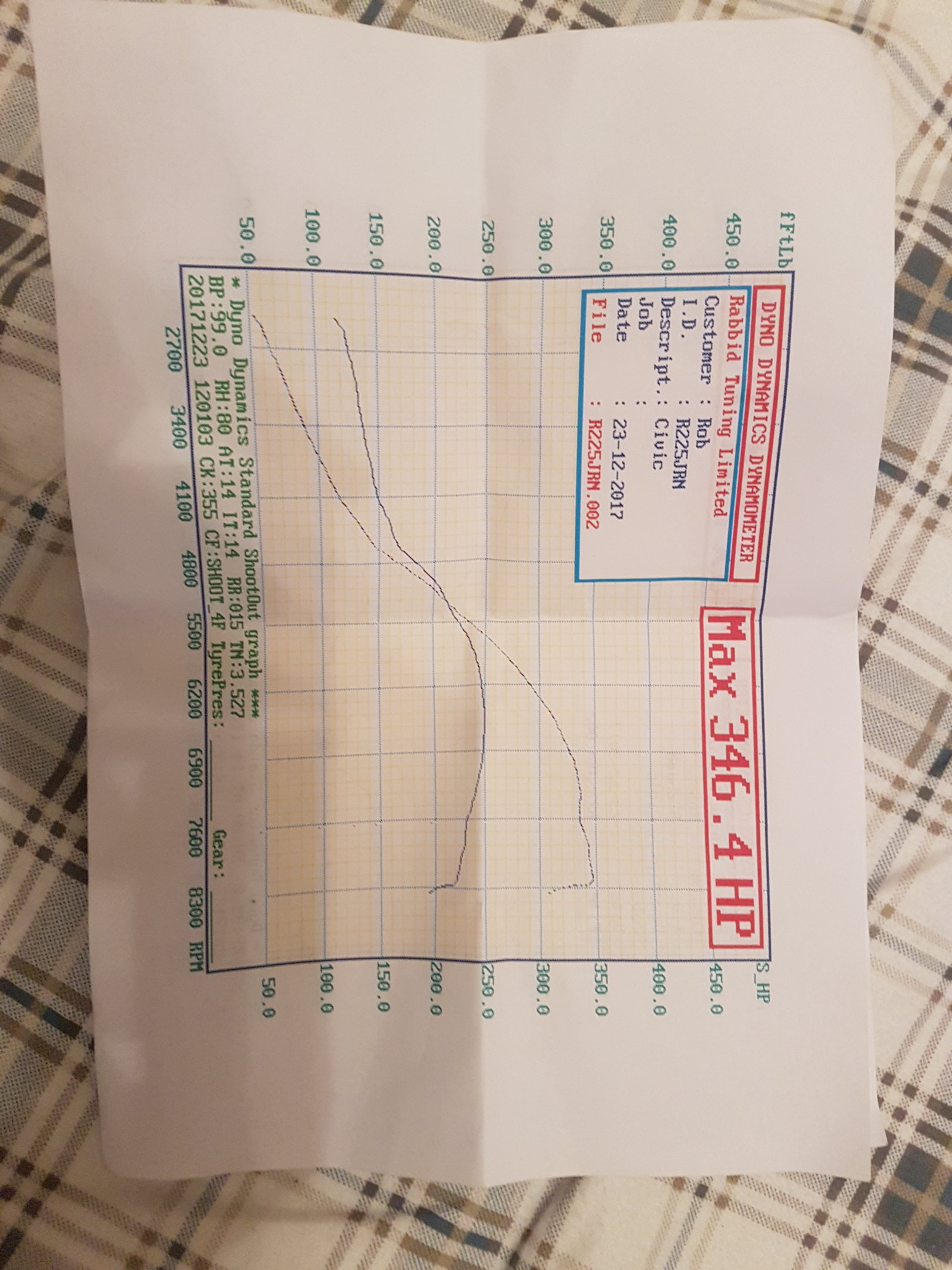

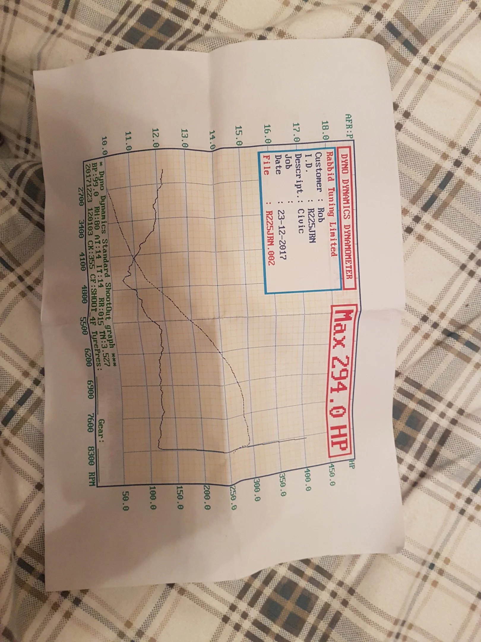

Got the car dynoed, running 346 bhp on high boost so happy with that! Has a rich point on the map as it comes on boost so defiantly does need the map tweeking.

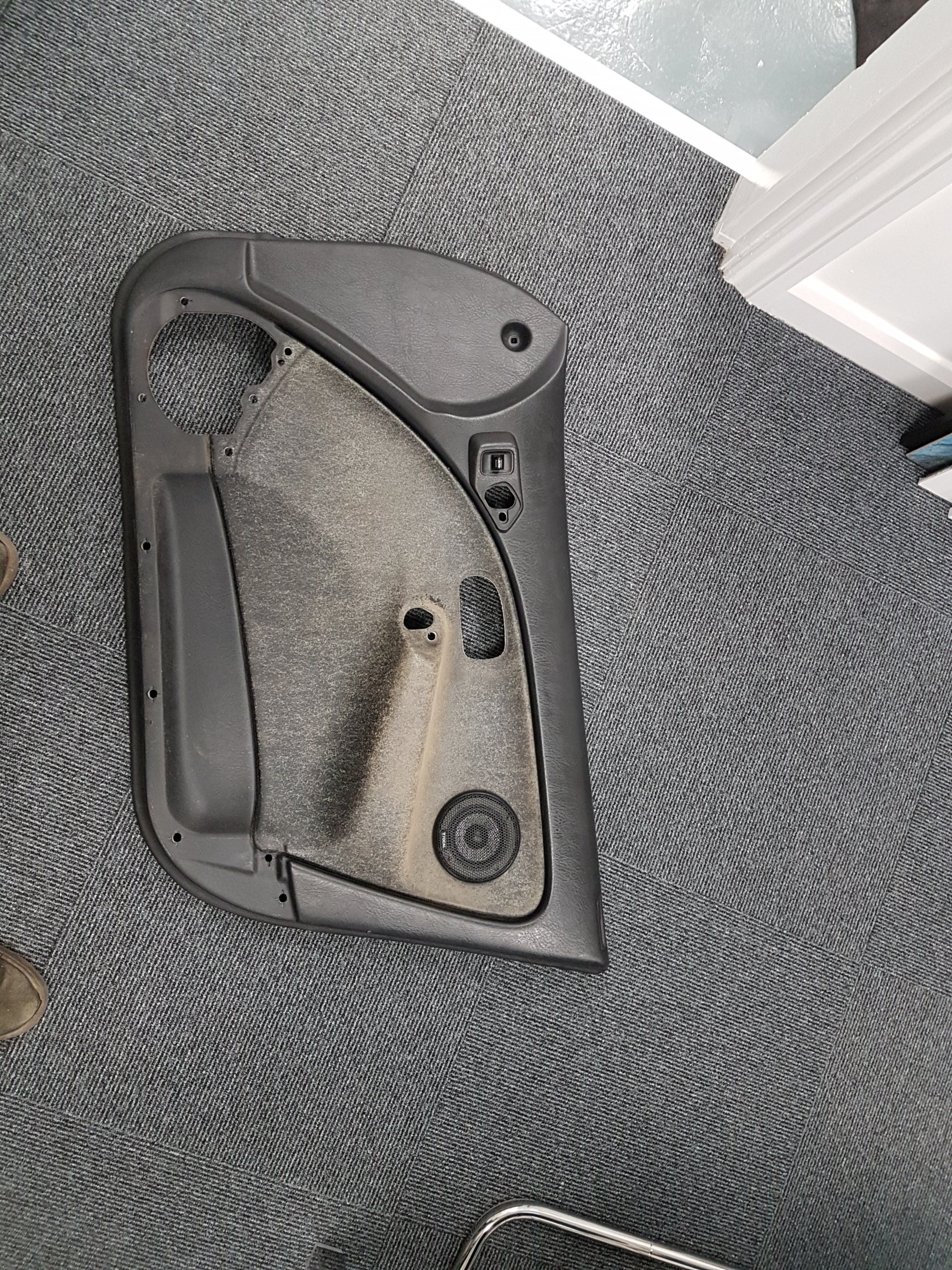

Also starting the audio upgrade for it, got some focal 3 way speakers so mounting the mid bass in the front of the door card and going to sound proof the whole door before fitting the door cards back once i had new fabric put on them. Also got a JBL sub for the rear and want to make a custom box to fit in the side pocket in the boot

AdDaMan
Yeah its going super rich just as VTEC comes in which has been set quite low. What ECU/Software is it?
Also, china spec GT30 i assume?
