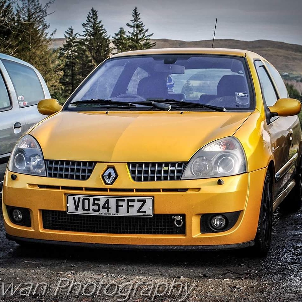

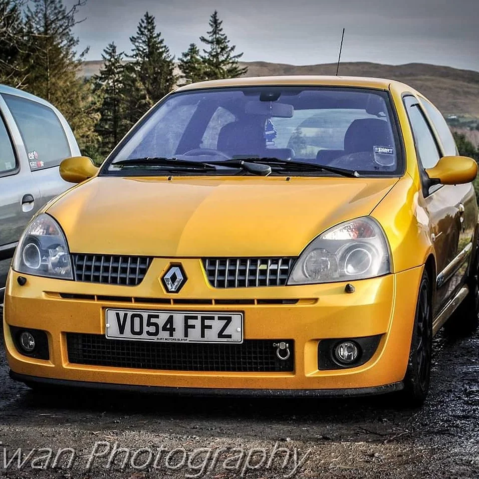

With the age of these cars now people are swapping engines. You probably won't see any difference between acceleration. But i suppose putting a low mileage engine in will hold the clios life more than breaking it. Also im the owner of that LY :)

Nothing wrong with a car with a bit of history! It looks lovely!
