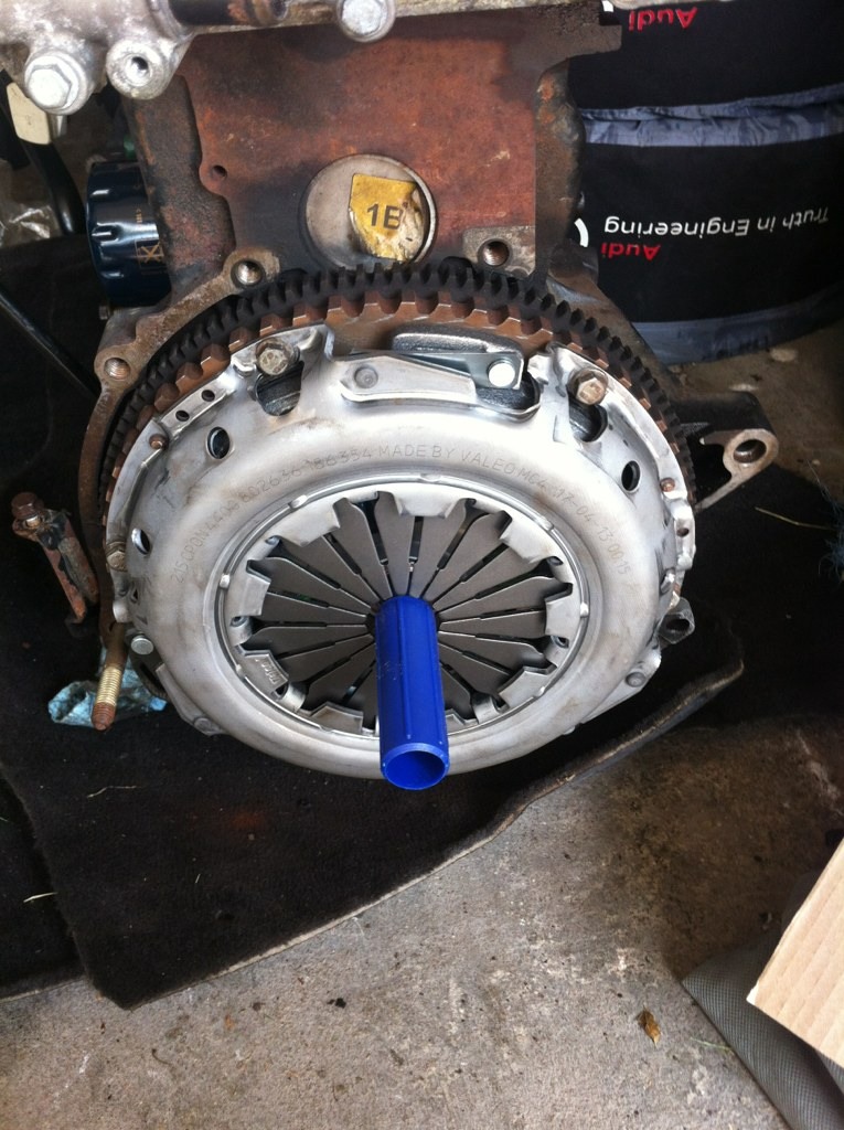

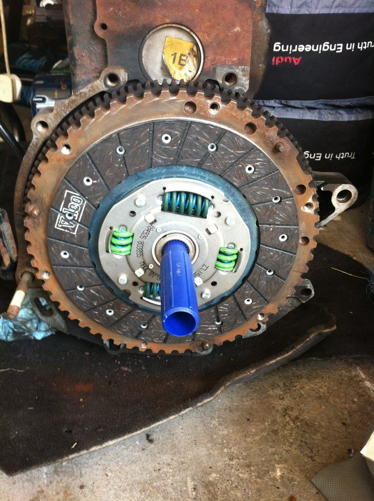

However I have a noise when I depress the clutch...sounds like a something rubbing...makes a grating noise, the noise stops when foot is off the clutch.
Have a biffed up putting the clutch in wrong? I 100% made sure it was aligned and used the correct tool, bolts was torqued correctly.

edit...clutch is a brand new valeo one with new cover.

Does it only give the noise when the clutch gets right to the floor?
Ie if you push it 80% of the way down, does it work normally and no noise?
Sounds like release bearing really knackered from that description, if its happening as soon as the starts to press on the fingers.
Pain if its a new one, was it a genuine one?
I agree with chip, if it starts with light pressure. I had a new one go like that on a different car. Hopefully it is not the thrust bearing.
The smoke steam might just be some moisture in there that will boil off fairly quickly, if it has been stood for a while. I don't think mine smokes from the breather when just ticking over.
Yes it makes sense, I still have the old one from my old gear box, and that one looked a lot better quality than the new one I put in, I did have doubts. Do you reckon I should use the old one?

Another problem which I think is related to the clutch noise, is the gearbox and engine are flexing when the dogbone support bracket is removed, I noticed this when I was tightening it up when the engine went in, I think the imput shaft has made contact with the friction plate damaging it (bent?) in hindsight I should have fitted it before the engine went in.
