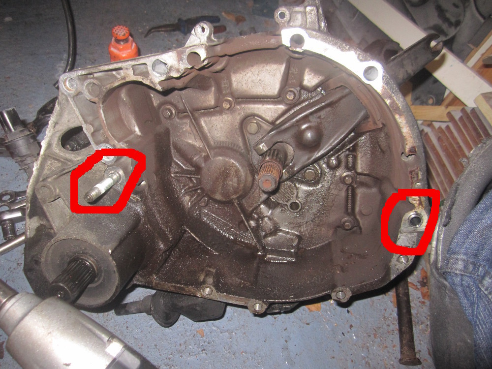

re replacing sump, its simply a case of removing it with gearbox in or out it doesnt really matter how its done, dont use the lower bolts (on the sump) to pull the box in tight to the engine, use the studs ideally or the longer bellhousing bolts. Also have you checked that the new engine doesnt have the little collars or dowels that locate the box to the engine on the bell housing studs. I had this problem, I had a collar on the engine and the box I swapped wit also had a collar stuck in it and wasn't allowing the box to be seated 100%, I would double check this as thinking about it that sounds like your problem. Its hard to explain this dowel/collar without a picture. Send me a pic of the bellhousing on a gearbox that is removed and I will circle it, this is what will be causing the starter to not fit properly and also what broke your sump.

I have circled the bits Morgan means for you.
Good advise Morgan, will try the bolt removal process.
I know what you mean about the dowls, Im 100% I checked this (remember seeing 2)when seating the box and engine together (on ground) So cant see it being that, however Im not ruling it out as I was rushing to get the engine back in. I will let you know if it was a dowel (and hang my head in shame).
Its an easy one to get caught out with tbh, luckily I noticed it before getting too far with the last one I done. FYI they can be pulled out with a set of vice grips. Having them dowels in the engine and gearbox would explain every problem you have listed, good luck :)

So, I found out what the problem was...I think this is prob one of my biggest mechanical **** ups, I found a washer one the captive bolt on the gearbox, there was no dowel, but the washer was throwing the friction plate out, I replaced the clutch and all is fine...what a drama.
