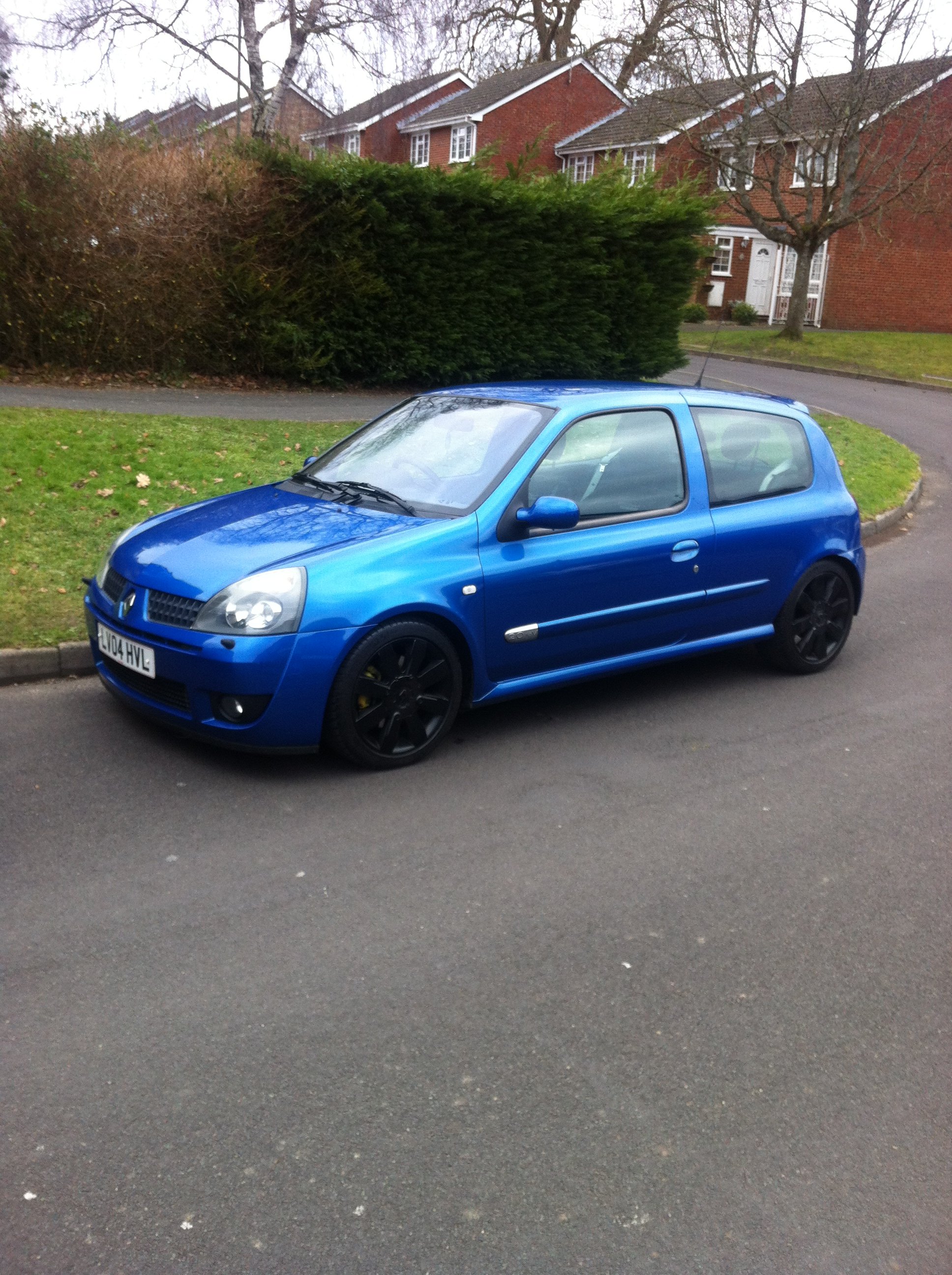

Hey guys,
Based in South of England and just purchased a 182.
Quick question ... I have input the radio code and the time on the display unit. The radio works fine and the clock also but when i turn off the ignition and then restart the ignition the radio needs the code again and the time returns to 00:00. I am guessing something is wrong with memory here?
If anyone knows how to solve this or has experienced this any help would be greatly appreciated :)
Brad
