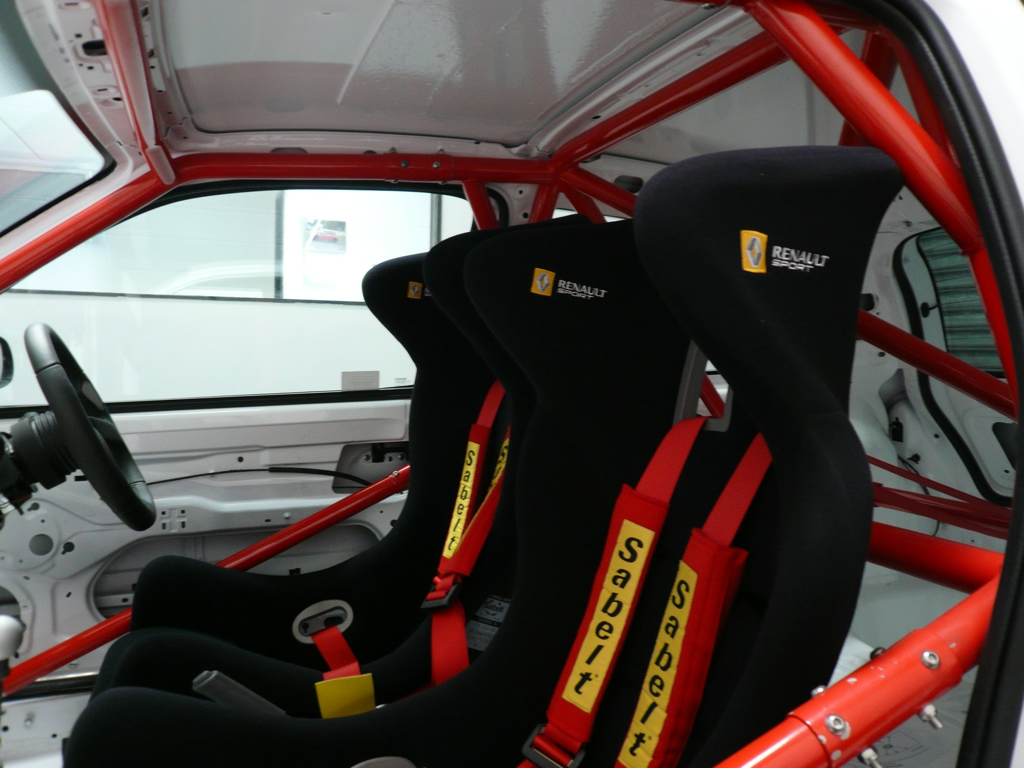

What's wrong with that? It is what mk2 cup racers had IIRC.
Lol no they didn't, this is a Mk2 cup racer cage!
8 I believe and welded
They are 6 point. Yours was bolt in wasn't it?
Plus even if that one in your picture is welded at the 6 floor points, it is not welded to the a/b pillars which is what makes a weld in cage better. Just welding at the same points you would put the bolts in is not going to be much different to just bolting in.
