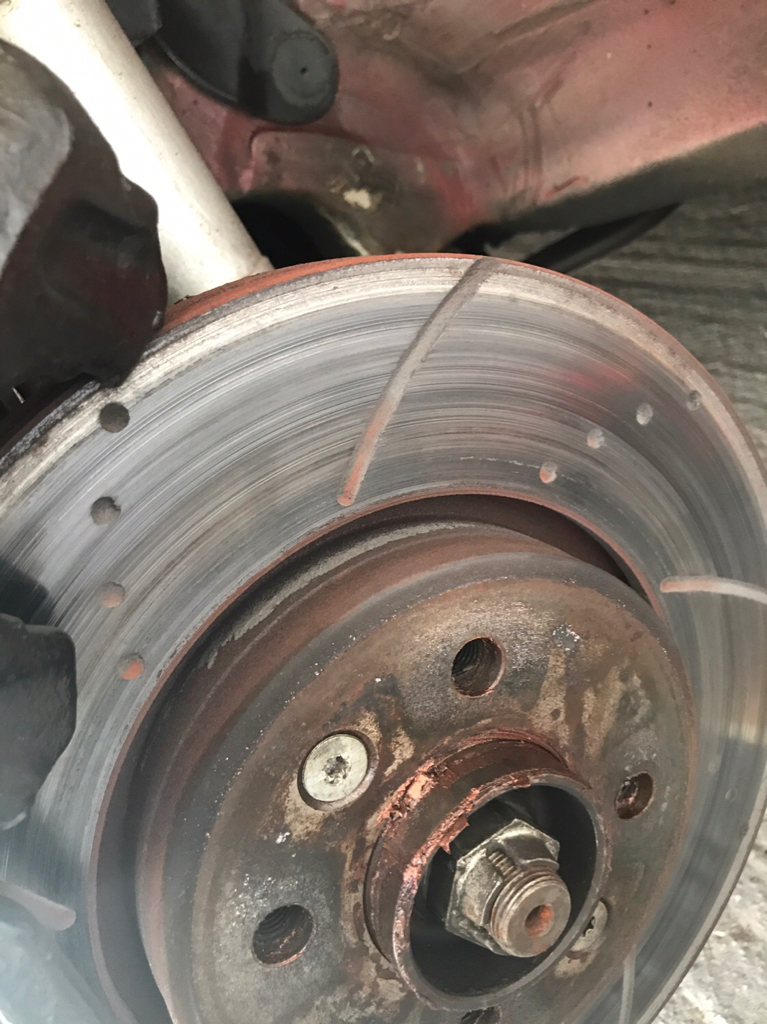

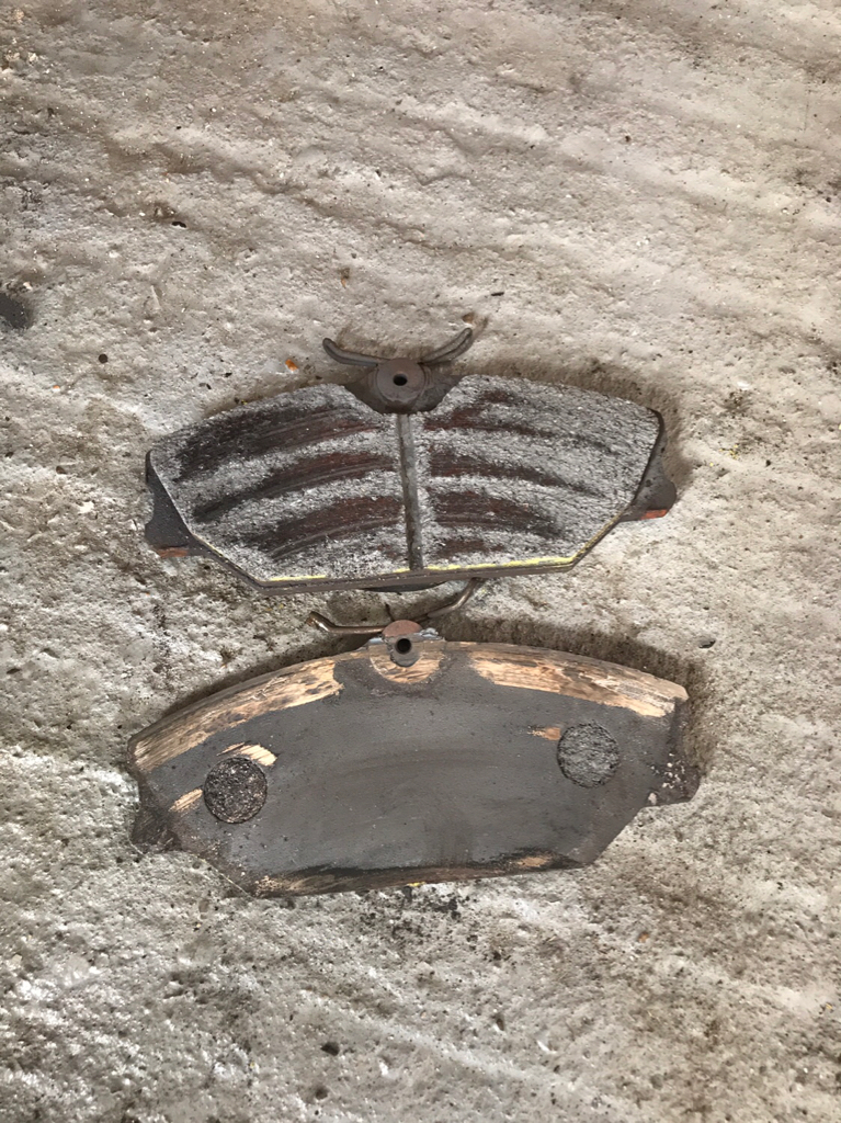

However pretty much my last lap before heading home they started to go.
My missus drove it home, as I had took a another motor with the tools in, luckily it's 20 mins away and when she got back she said it was grinding.
Anyhow I think copper grease was used in the sliders and it's got too hot and turned into a black mess and seized one of the sliders in.
Also is it the grooves/holes causing the marks on the other pad.
