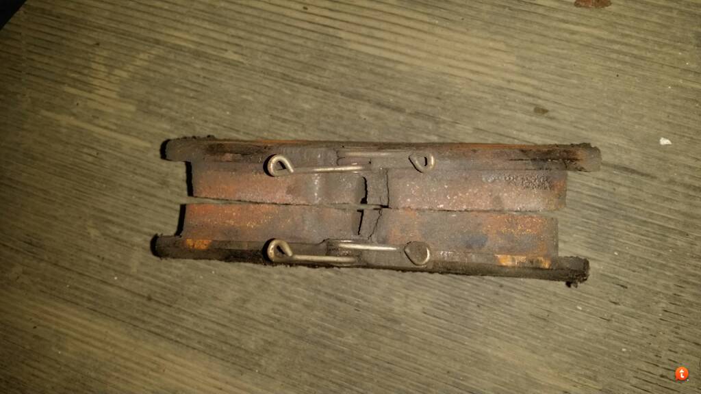

My DS3000's after 1yrs track use:-
Note the tell tale sign that sbridgey was behind them at some point!

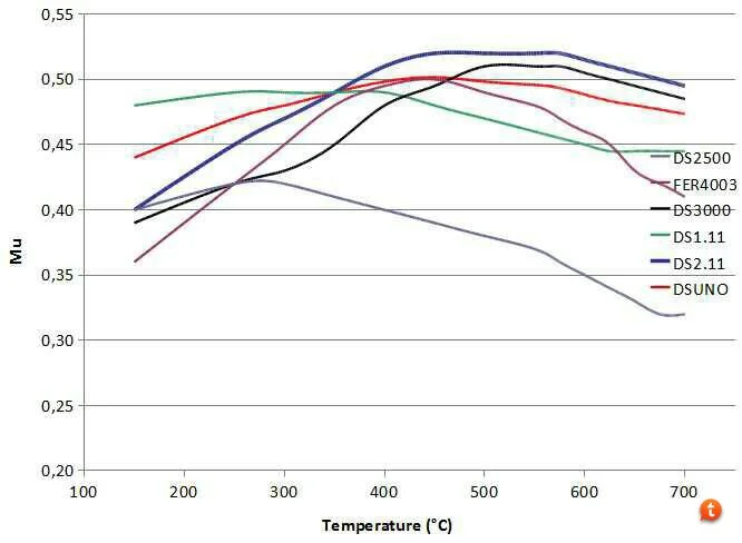

You cannot really compare the DS2500 to the DS3000
